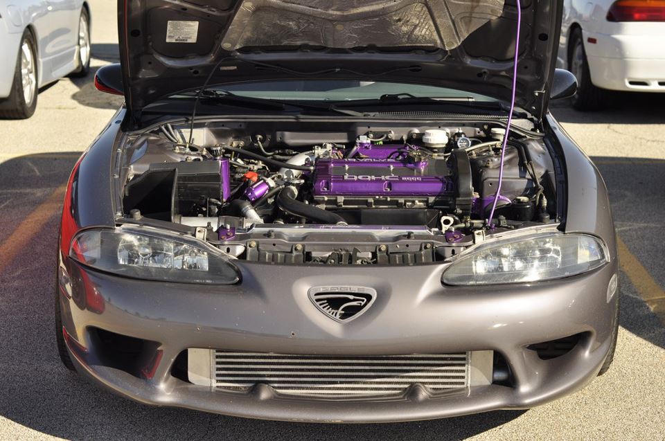

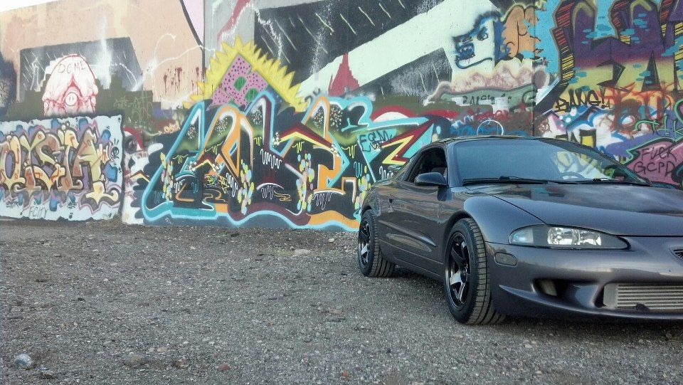

Name is Alex and I drive a 97 awd tsi.
So a few months ago the thrust bearing showed signs of 1/8" of wear. So the talon got parked and I purchased a new daily.

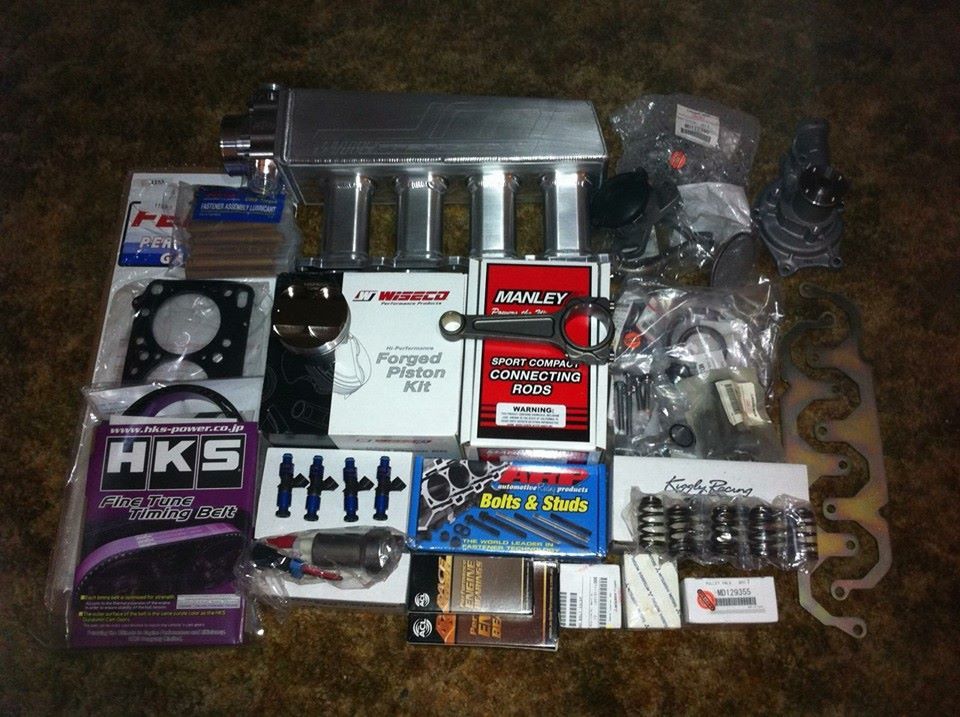

Got the parts list ready and starting to put plans into action.
Bought a Dual ball bearing billet wheel 6265 w/ 1.00 A/r divided t4 housing.
Building a twin scroll t4 FF manifold
Ill keep up on here as I go. Just purchasing parts here and there.
This is the plan (although it may change up here and there)
Engine:
6 bolt .010 bore
Manley I-beams
Wiesco HD pistons (10.5:1)
Kiggly girdle
Polished Oem crank
Arp hardware
L19's and Felpro permatorque HG
Ported 2g race head
+1 valves
Kiggly valve springs
3g lifters
Kelford 280s
BSEK
Oem-waterpump, oil pump, timing kit
Hks timing belt
Fidanza gears
Mighty max forward OFH
Intake:
Jmf race Intake
S90 74mm throttle body
3" cold side pipe
Custom intake pipe
Tial bov
Fuel (switching to E-85):
Fic 2150cc
Walbro 450 lph w/ rewire
-8 feed and filter
Custom fuel rail
Misc:
Jay racing Alt relocate

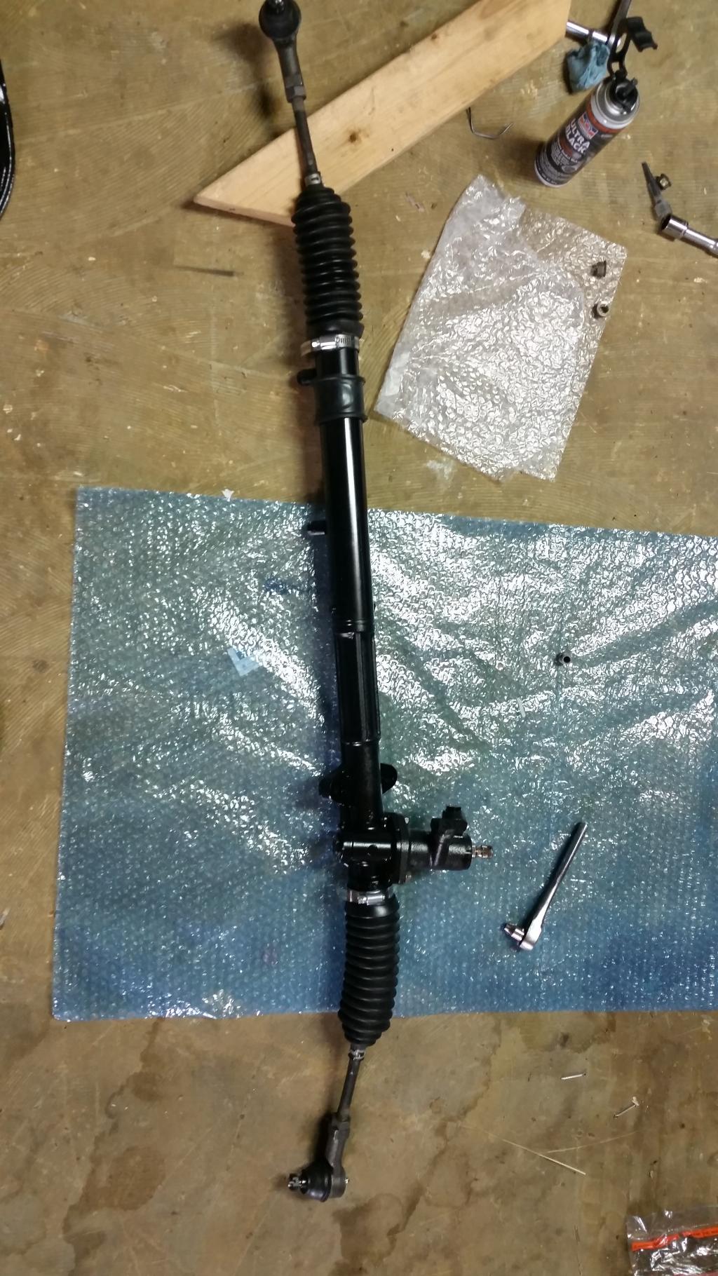

De powered 2g rack
Frame mount dry cell
QM twin disk

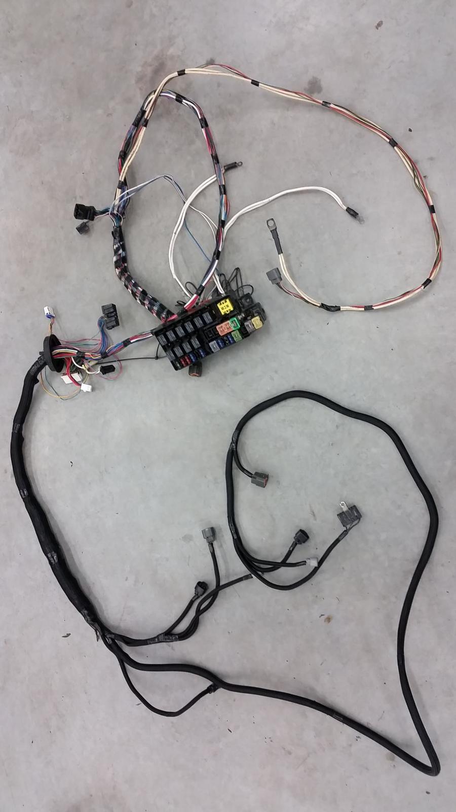

Fuse box relocate and wire tuck/delete
Remove heater core/ sound deadening/ anything else unneeded
Dual Tial Mv-s
Custom fmic
Half radiator
Suspension:
Oem front knuckles and control arms
Rtm sway bars
Prorhane suspension bushings
Solid subframe bushings
Roll fenders (more LOL)
Interior:
Race seats and 5 point harness
Custom seat brackets and harness bar
6 pt cage to come
Exterior:
Paint front bumper and fenders
2ga "twisty" side skirts
Carbon fiber Csl hatch (hopefully)
Heres my current mods that arent changing:
Fuel lab AFPR
-6 return line
Aem wideband.
Prothane mounts
Tre high torque built trans
SS clutch and brake lines
Koni sports/ GC springs
Rota 17x9 w/ 245/45
CF hood
Slowly but surely building it. Critic if you may. Wish me luck.

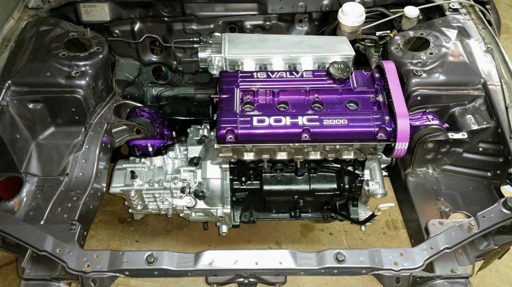

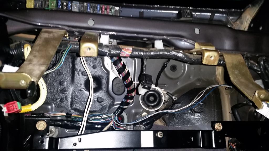

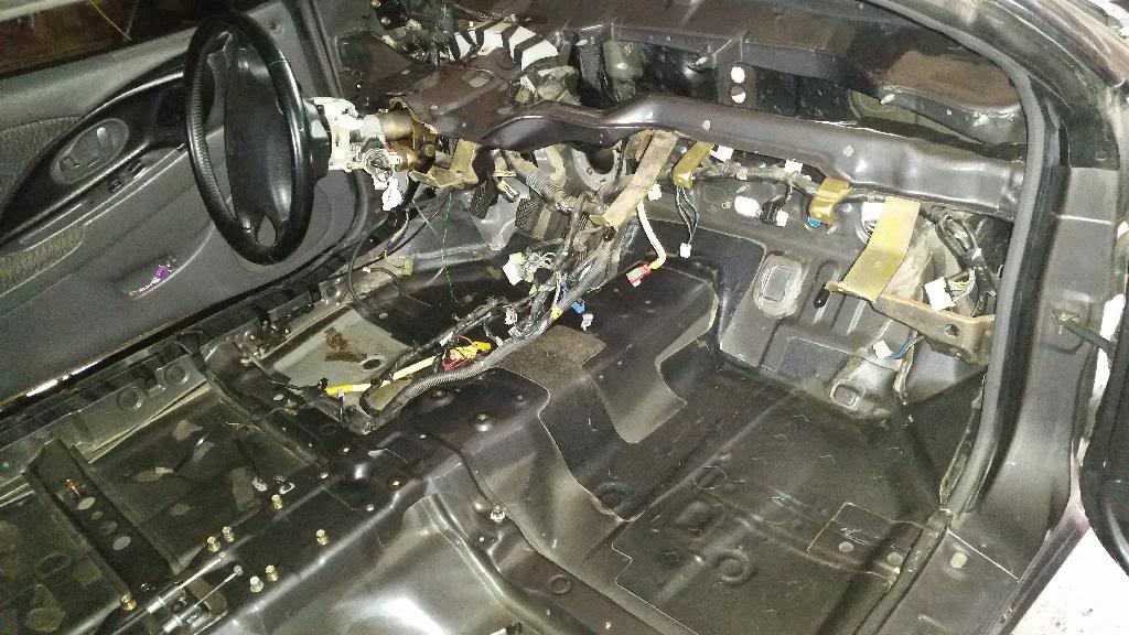

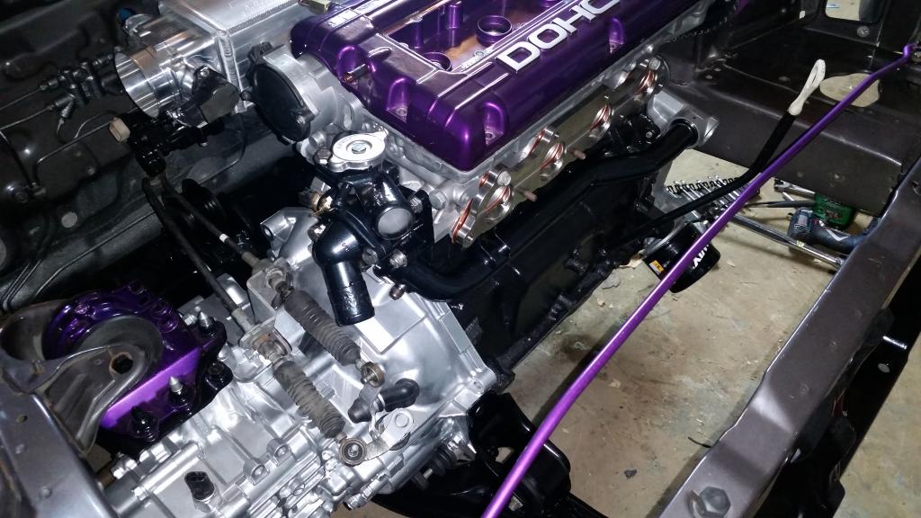

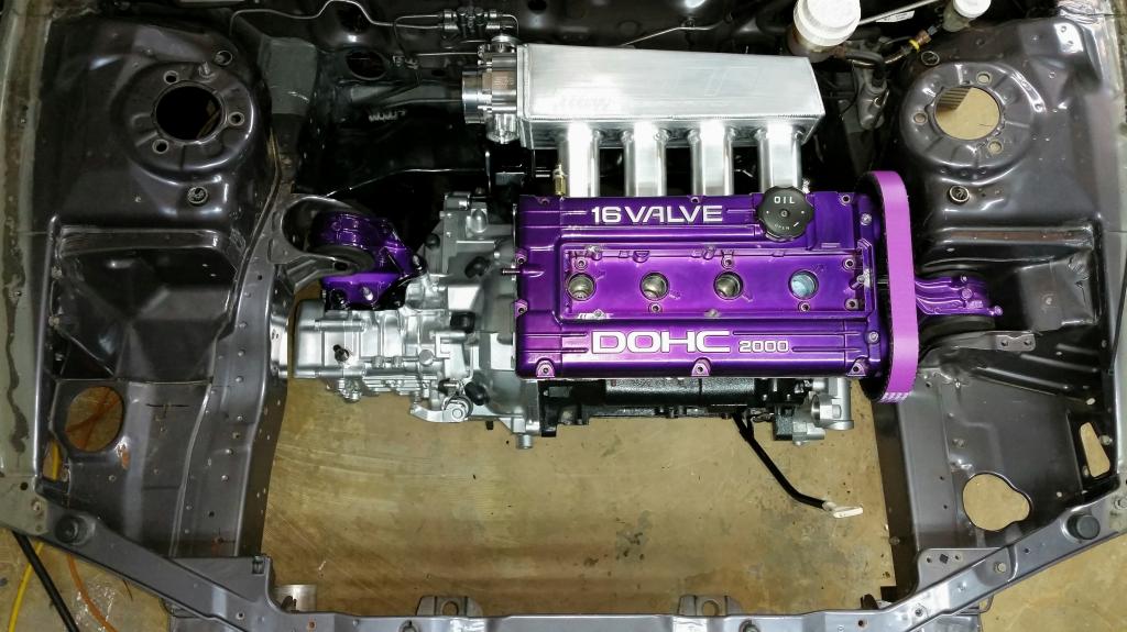

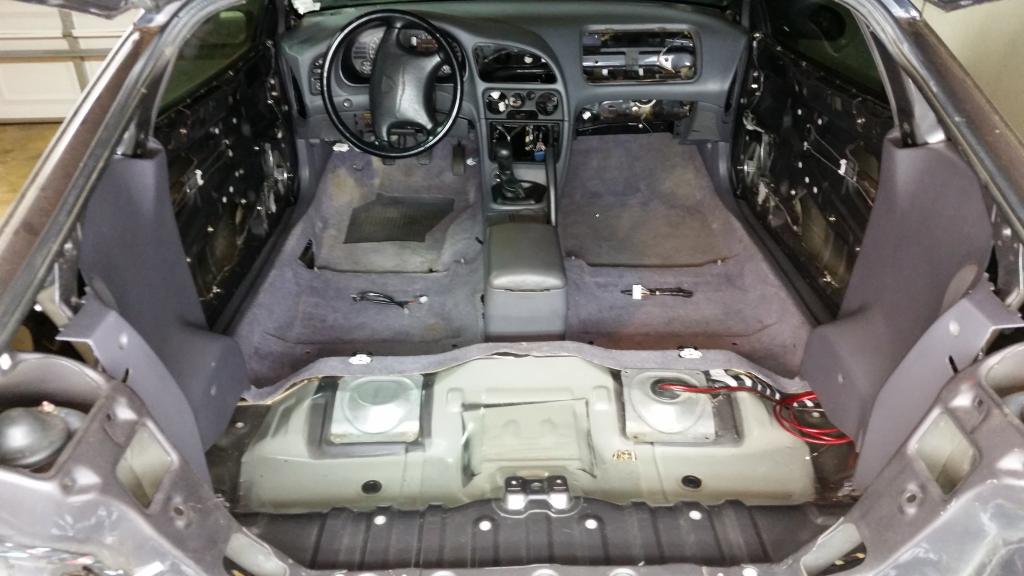

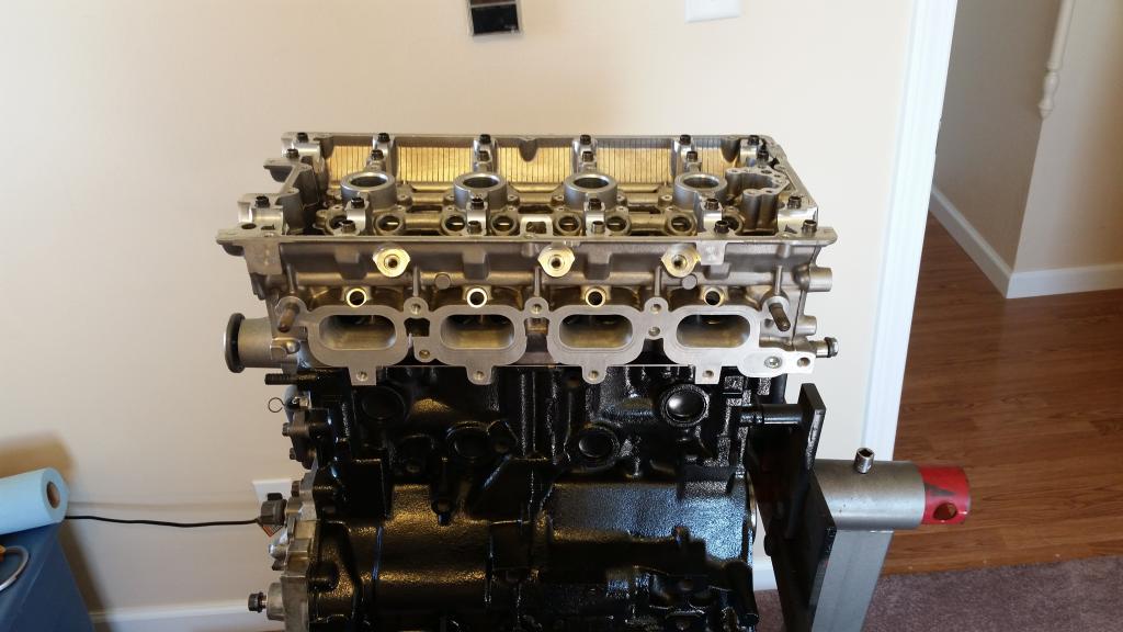

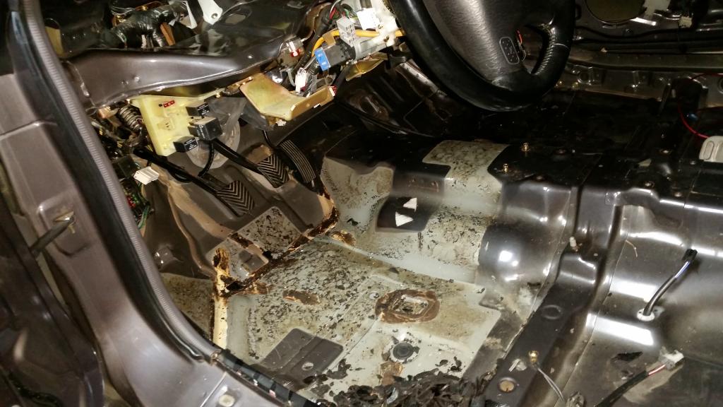

Got going on the interior. Have to start pulling up sound deadening now and tearing down the dash to make a skin. Got the pass. door tar free and stripped.

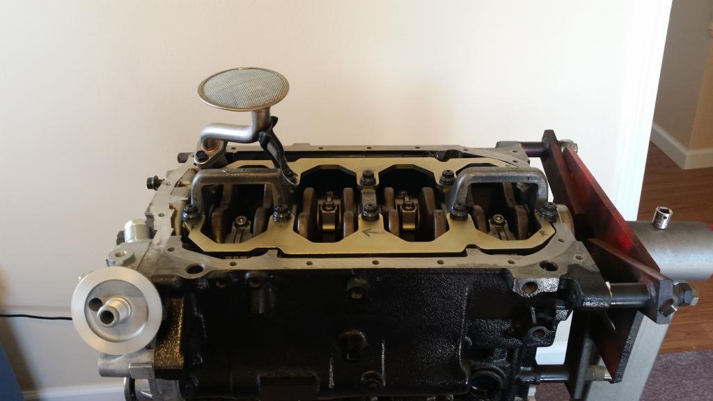

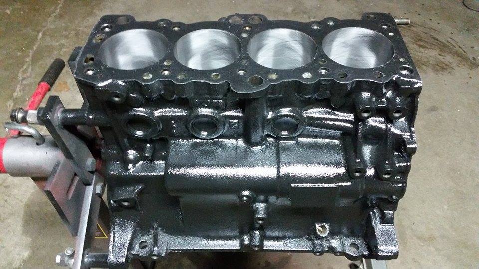

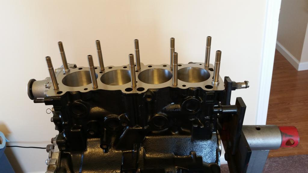

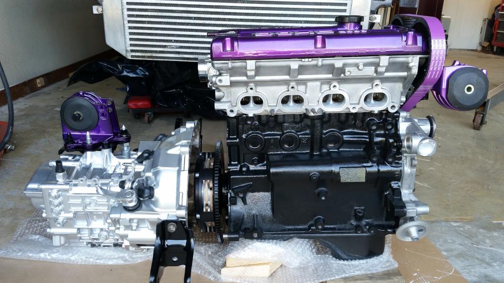

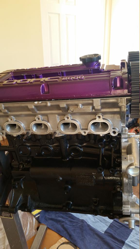

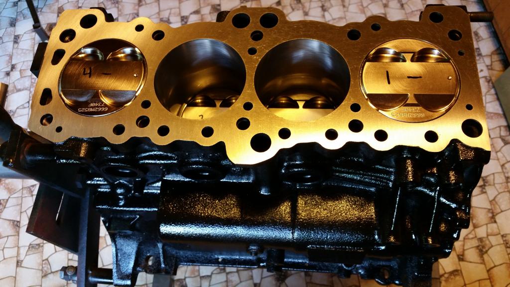

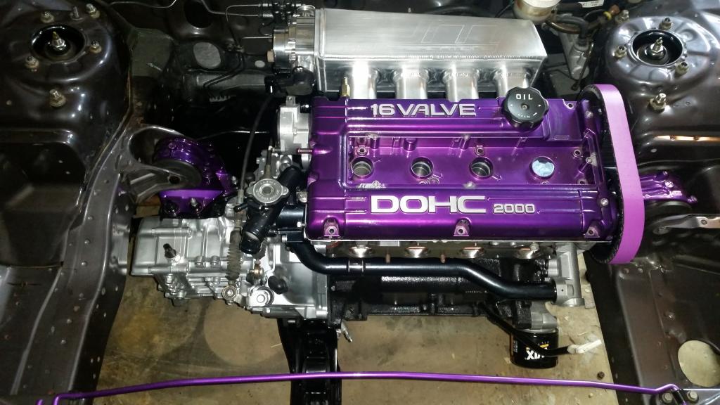

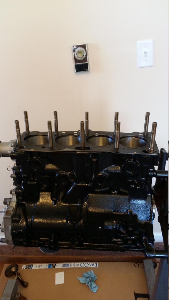

Block back from machine shop. Hot tanked, decked, bored .010, honed w/ torque plate, line honed w/ girdle, and a fresh coat of primer and paint. Internals go in tomorrow.

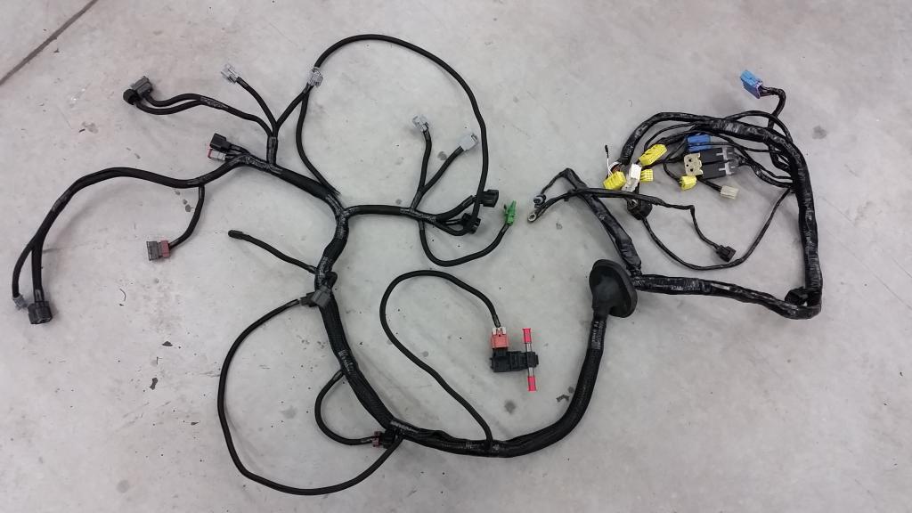

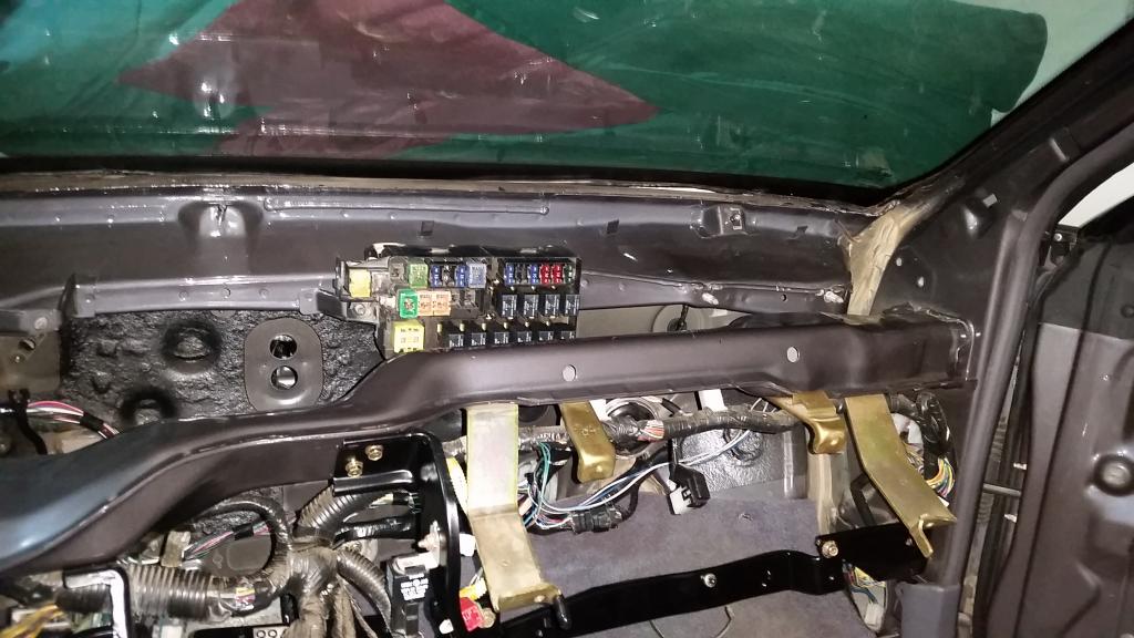

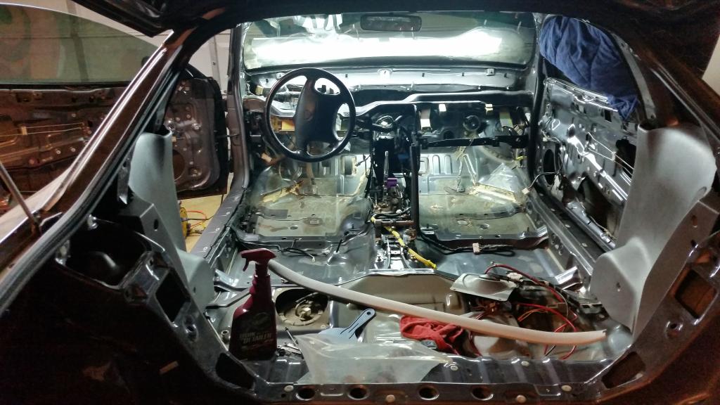

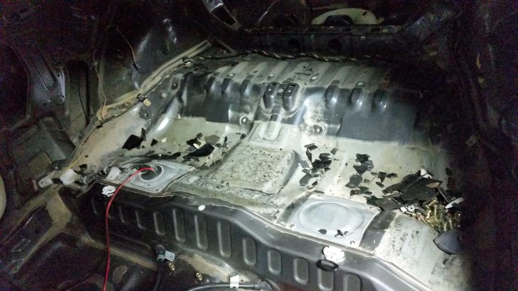

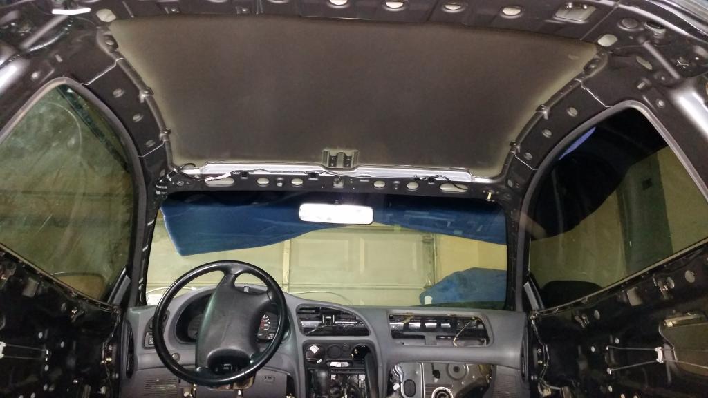

Interior mocked up. Sound deadening and all Misc brackets removed along with rear panels, seats, head liner, air bags, etc.

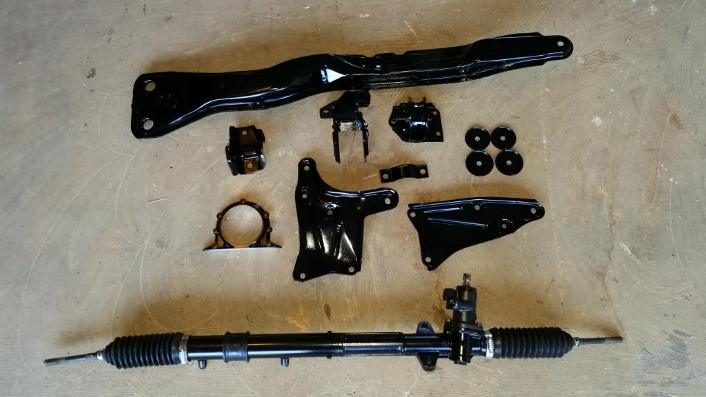

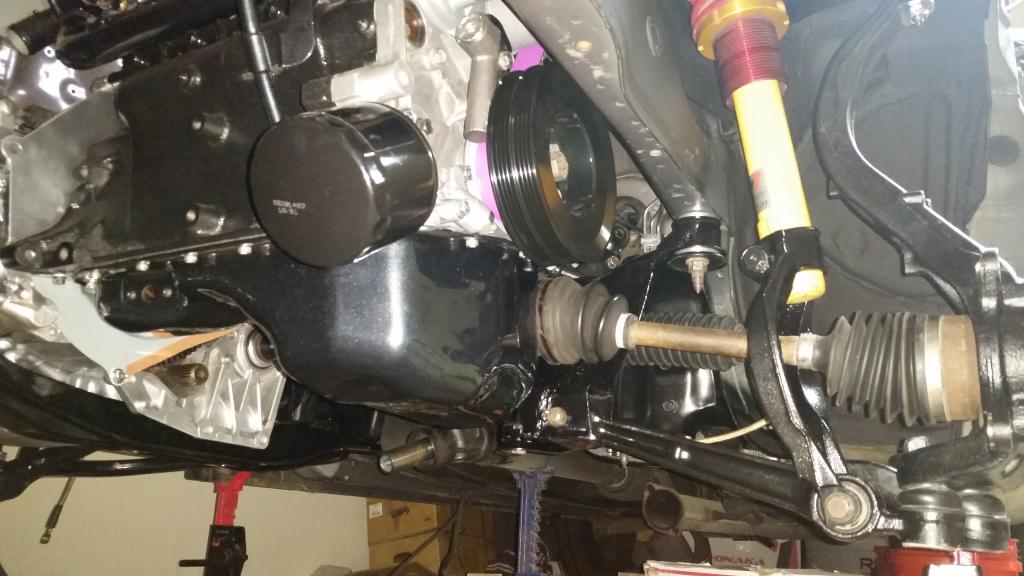

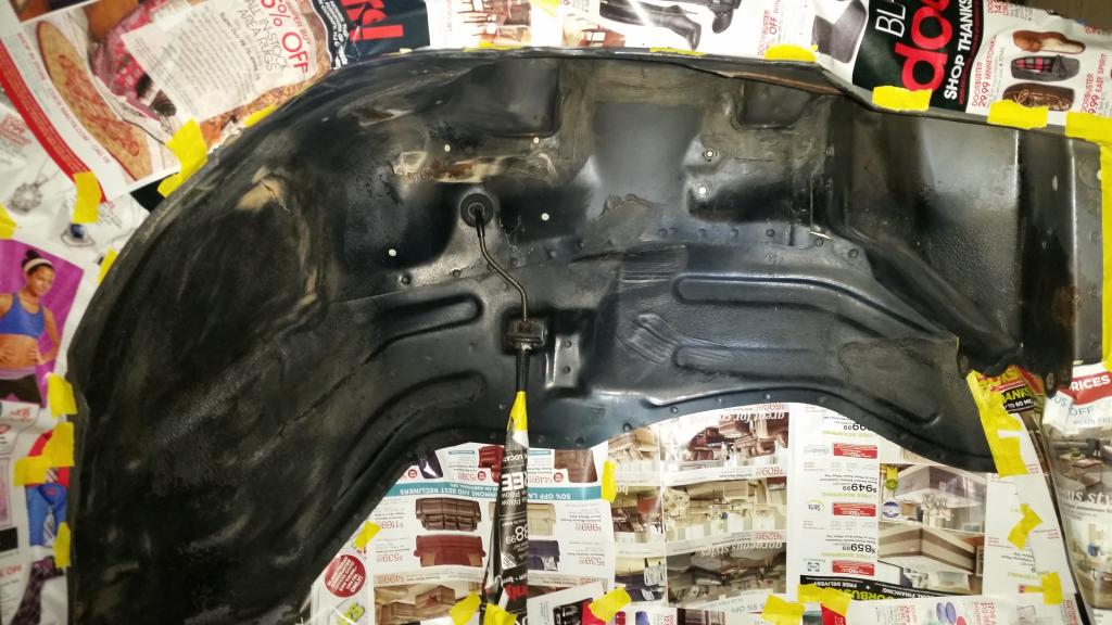

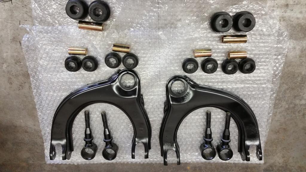

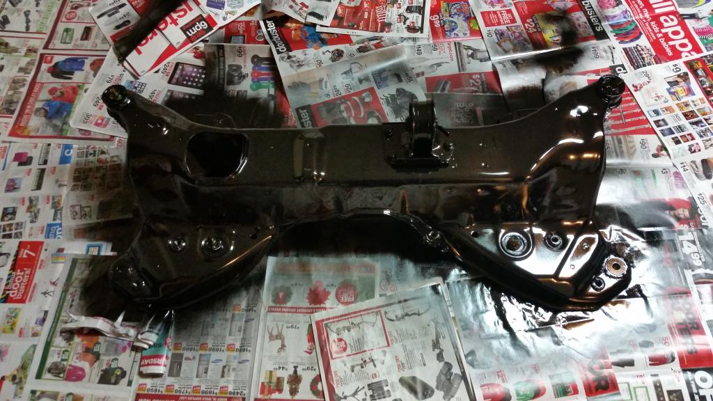

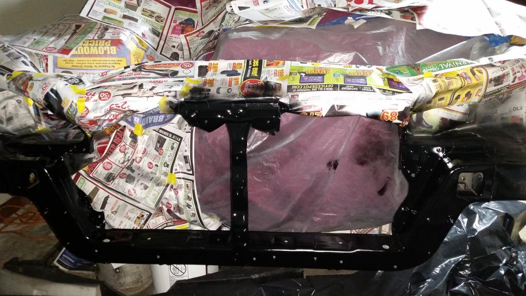

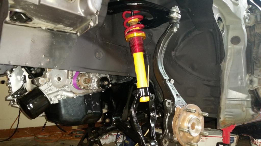

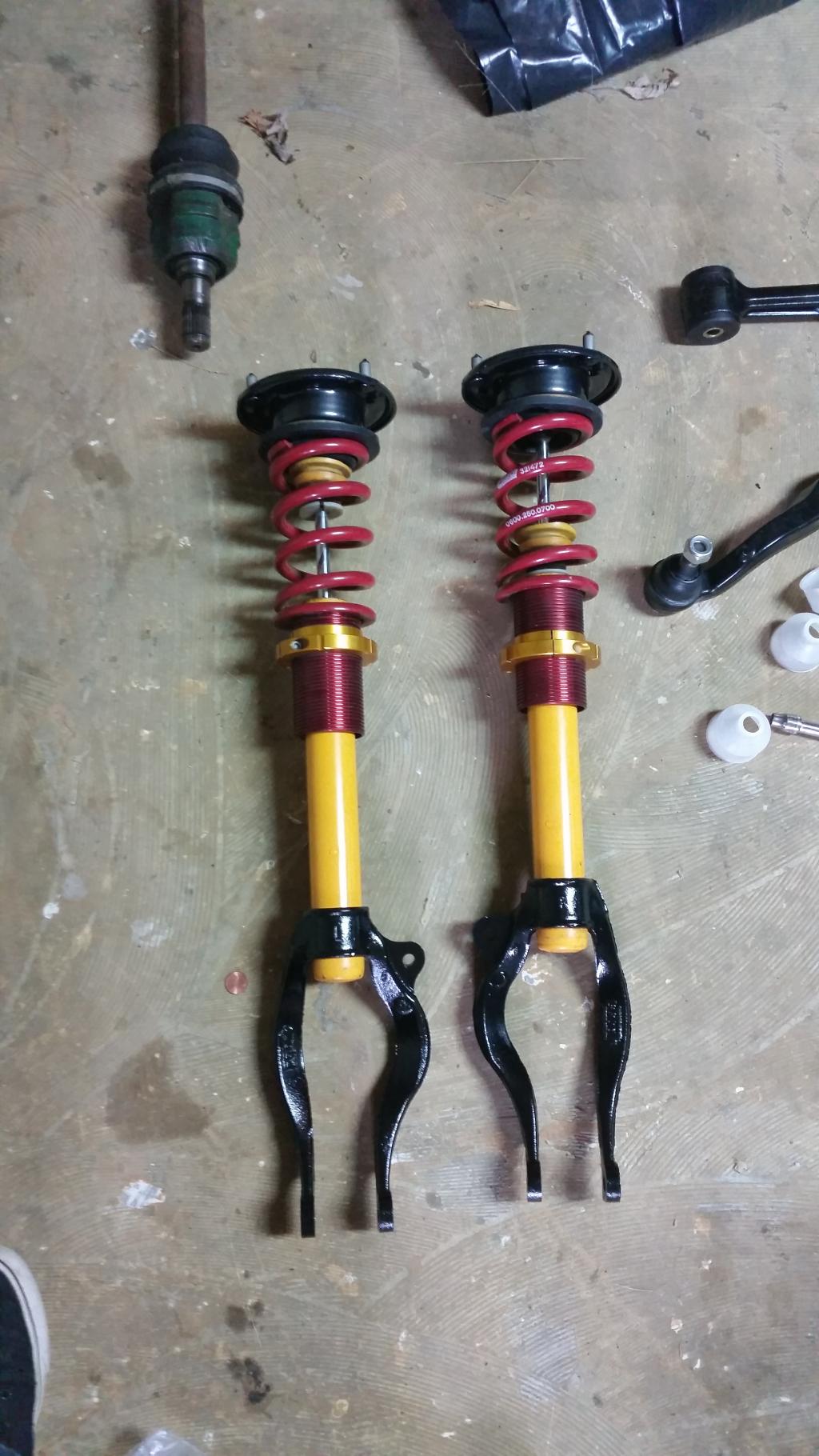

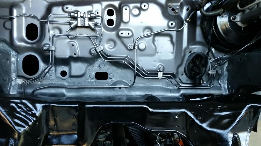

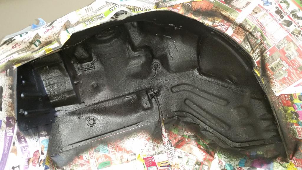

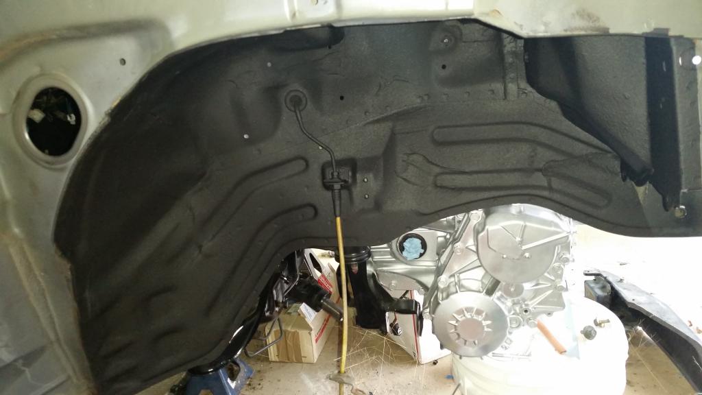

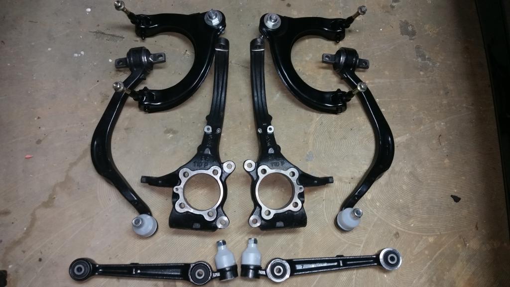

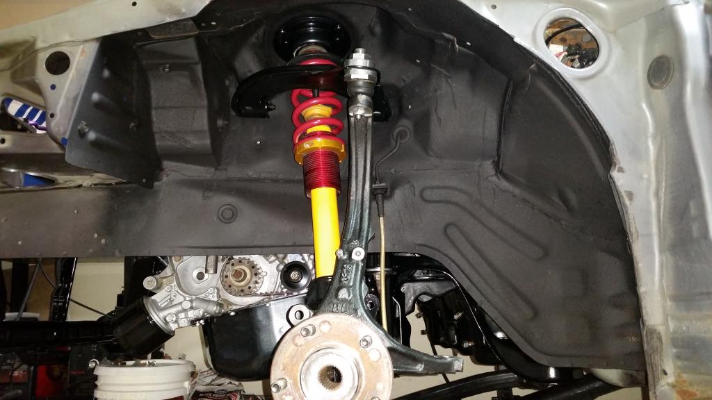

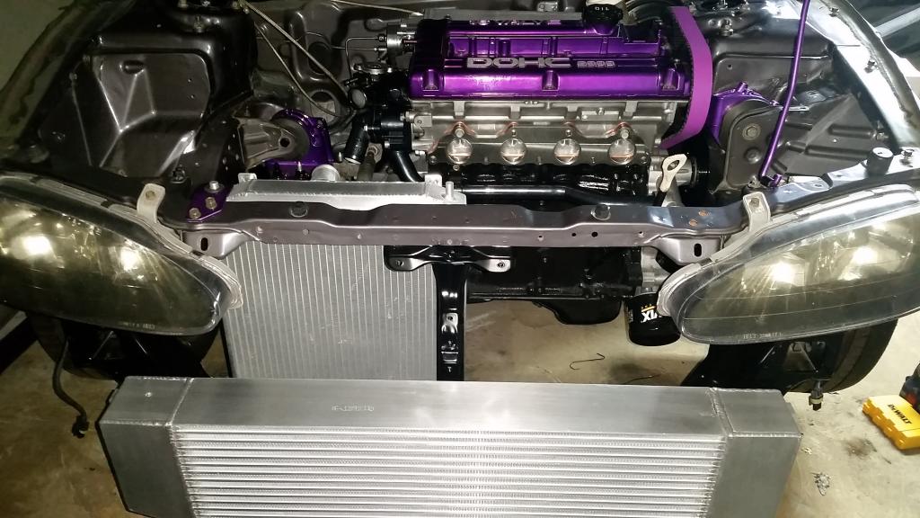

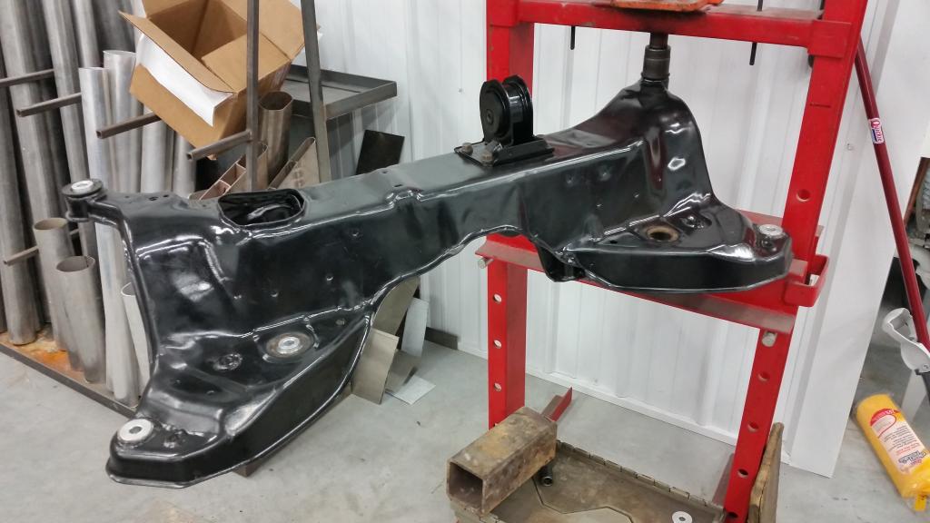

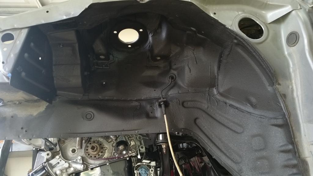

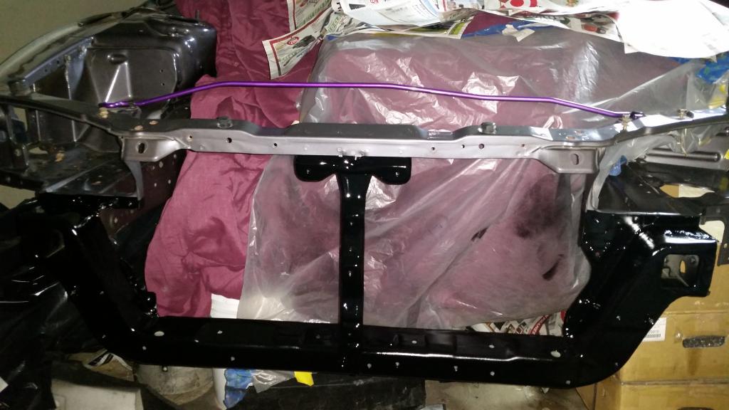

Suspension hung from core support painted and wheel wells redone. Subframe bushings. My heater delete coolant pipes. Starter Fab work on my manifold.
