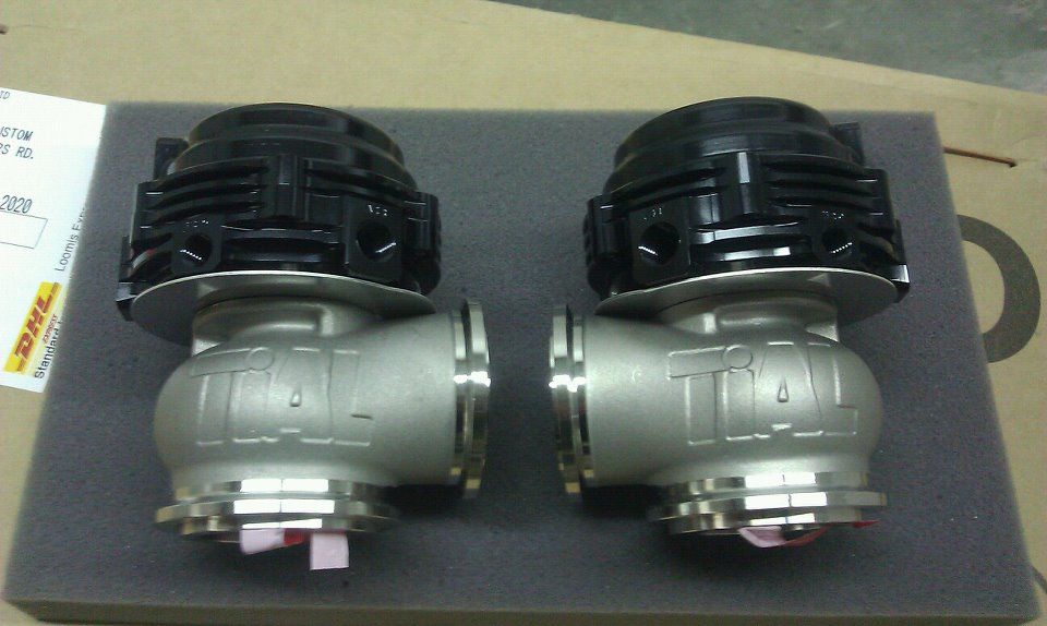

Garrett T67
2x Tial MV-S wastgates

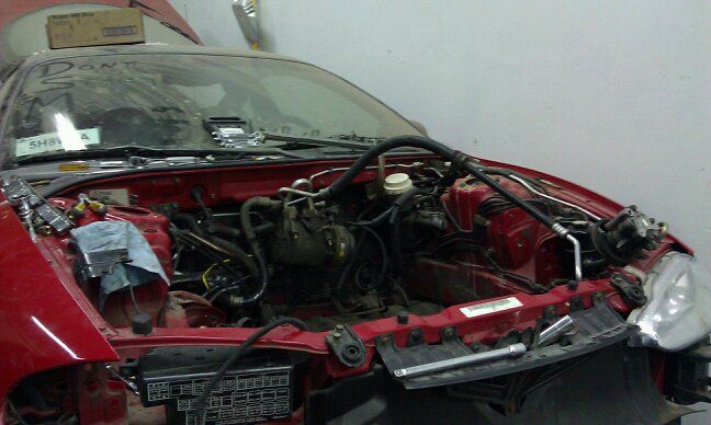

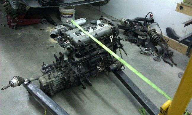

First step was getting the motor and tranny out of the talon, as I need the tranny for the eclipse. (Originally thought I was going to build the eclipse, discovered rust that made me reconsider)
Motor in
Motor out

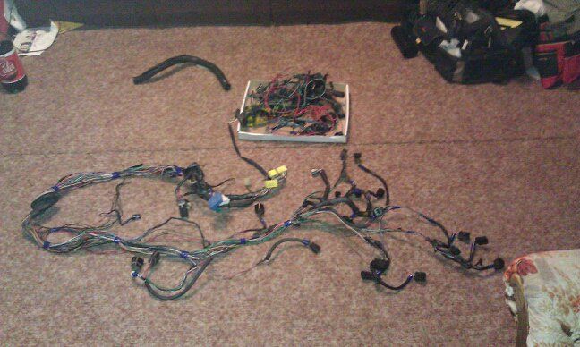

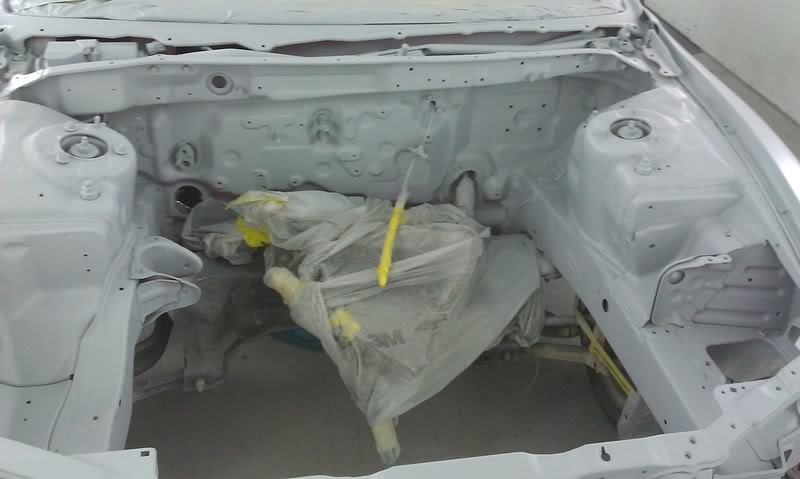

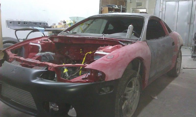

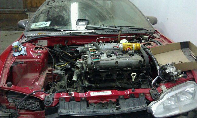

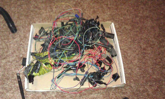

Next step was to strip down the eclipse engine bay and start work on the harnesses.
Swapped some parts over to the talon from the eclipse, and removed all the unnecessary wires from the harness. Just have to mock it up once I have the engine in to finish it up.

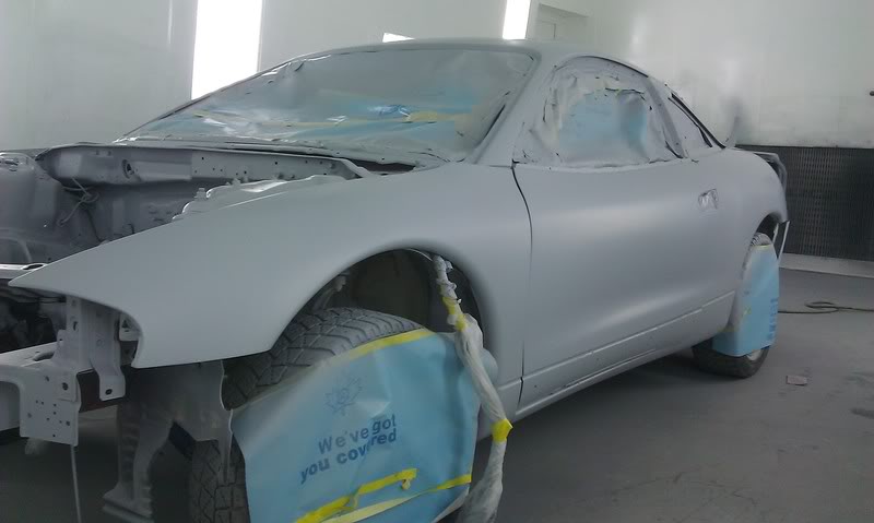

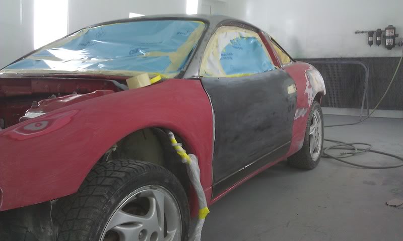

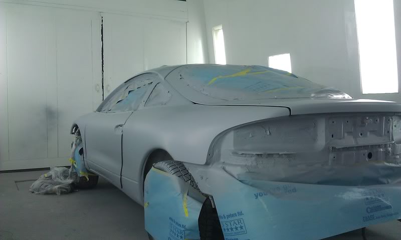

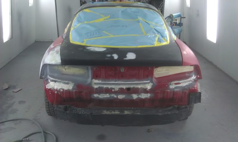

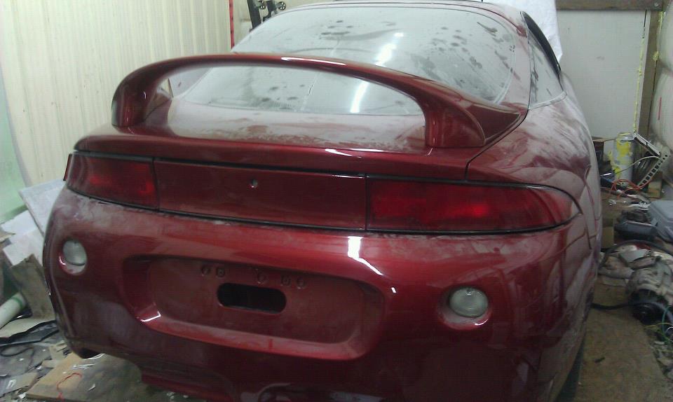

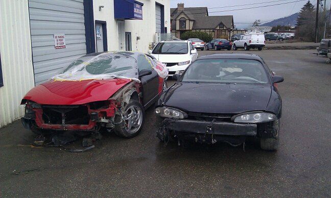

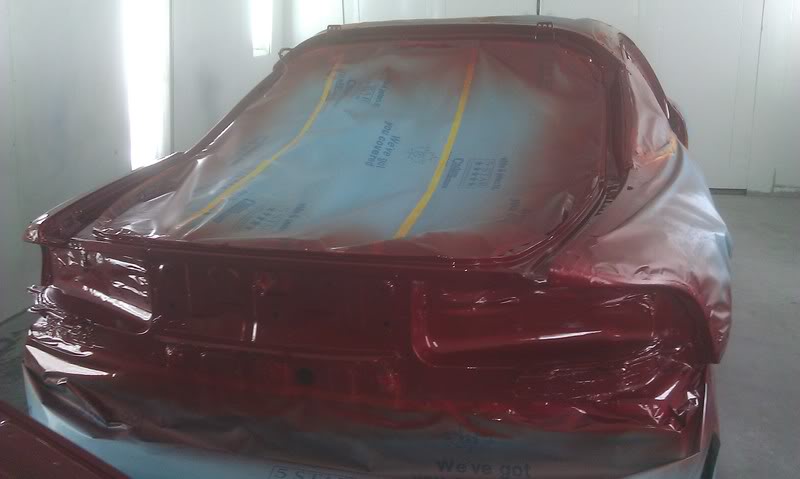

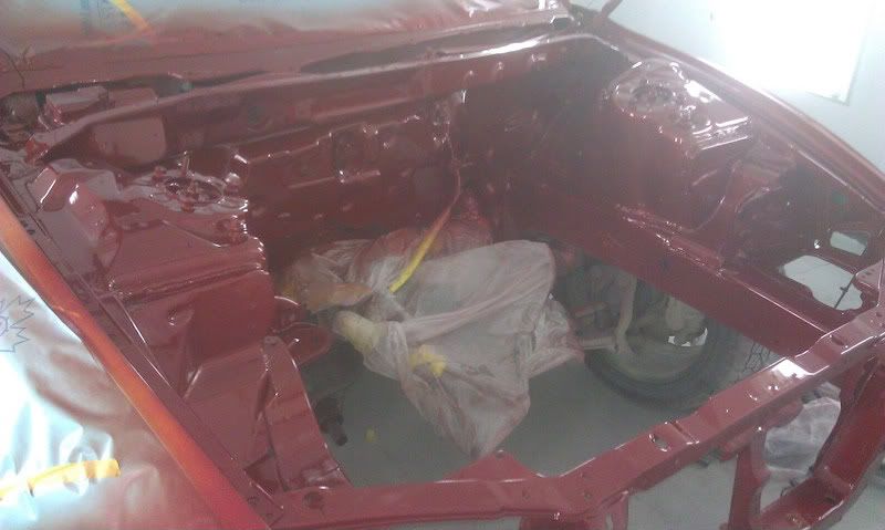

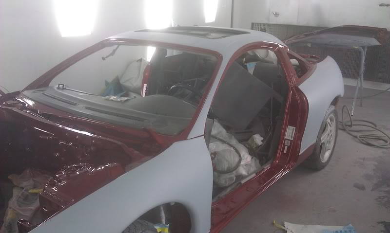

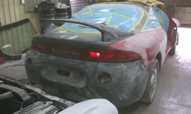

Then it was time for bodywork and paint:
Continued:

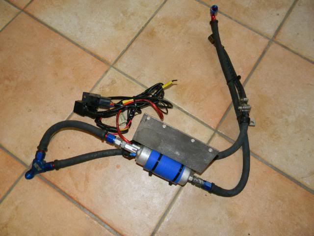

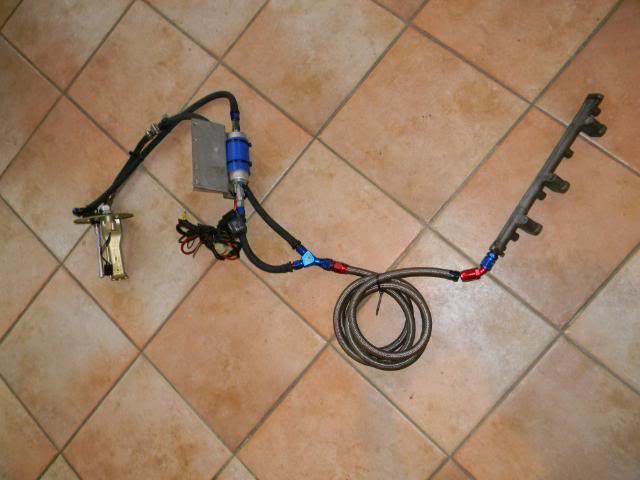

Dual Walbro 255 setup (one in-tank, one inline)

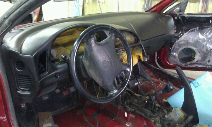

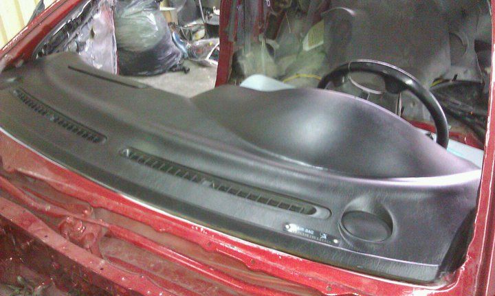

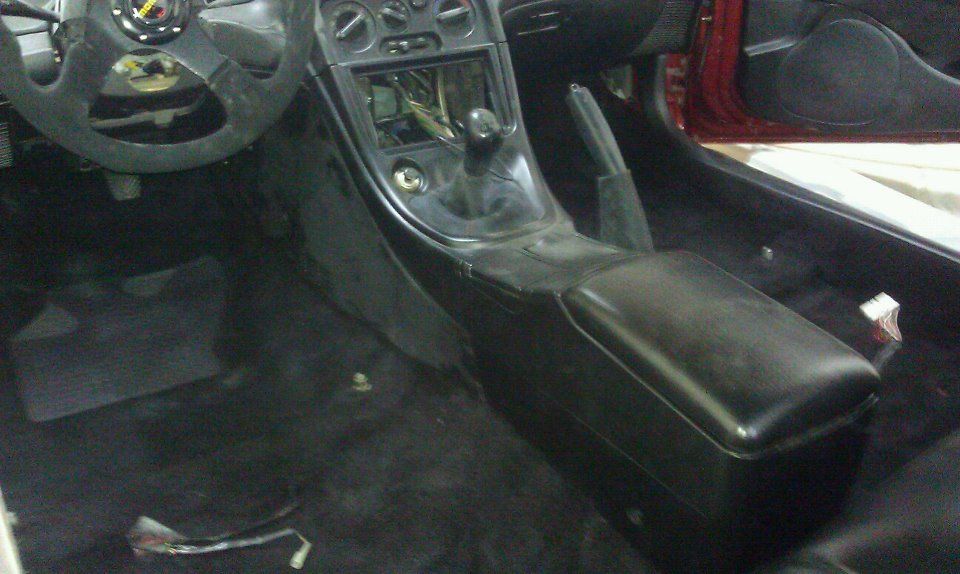

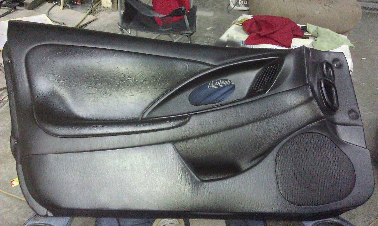

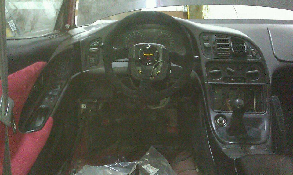

Started changing the nasty grey interior to black
A few painted shots

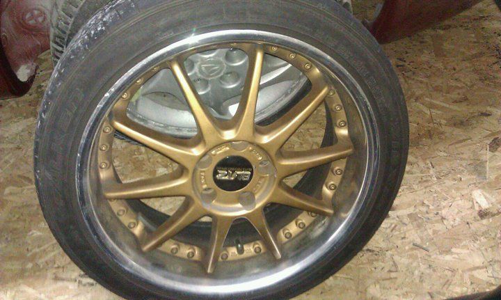

Wheels

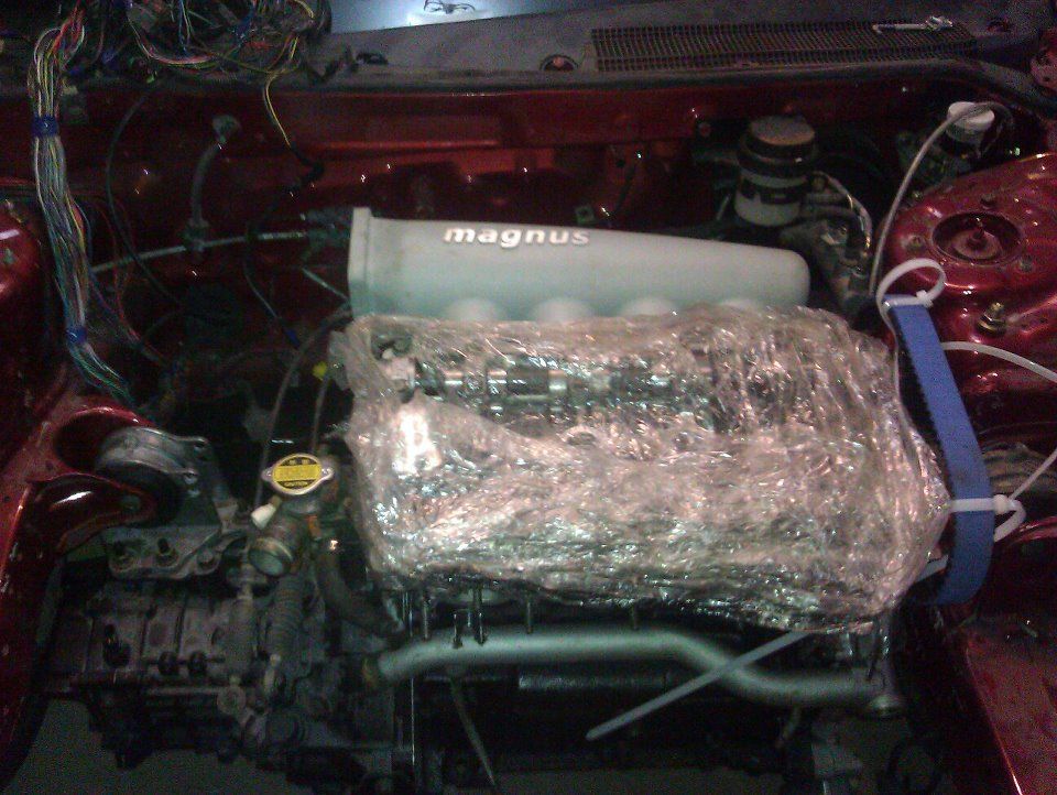

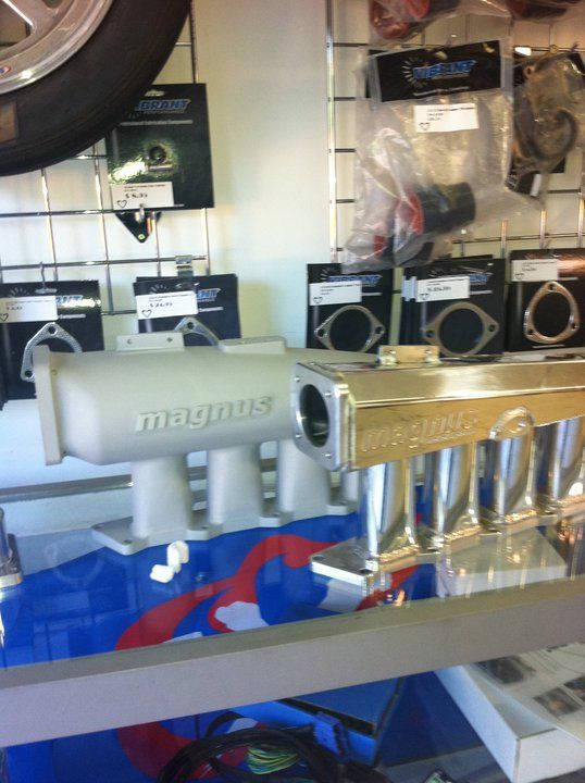

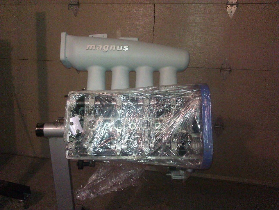

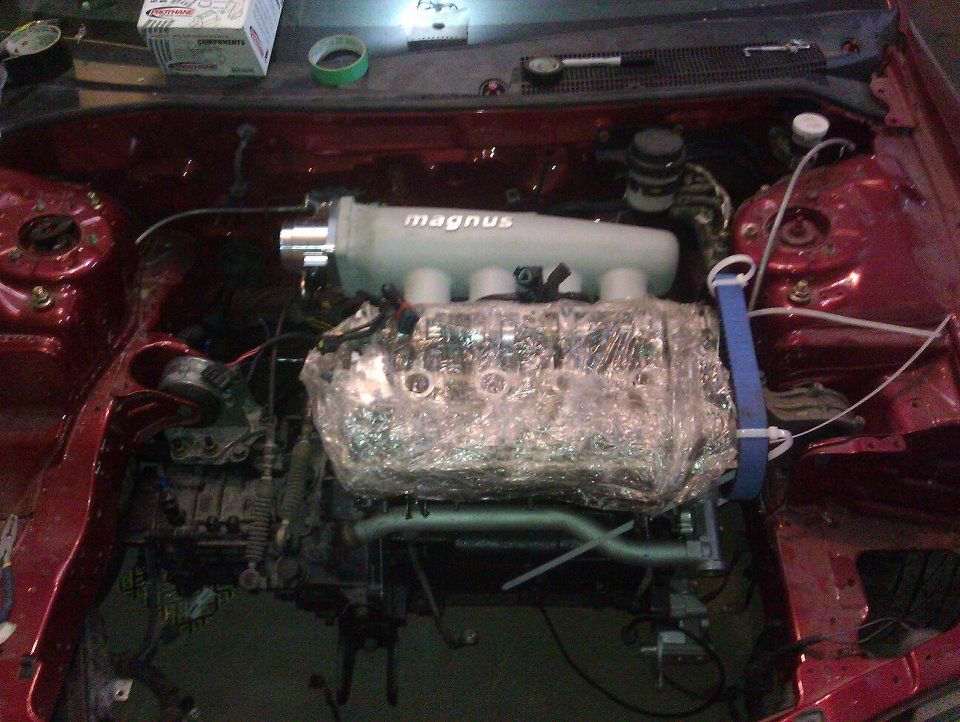

Intake Manifold (compared to a Magnus street SMIM)

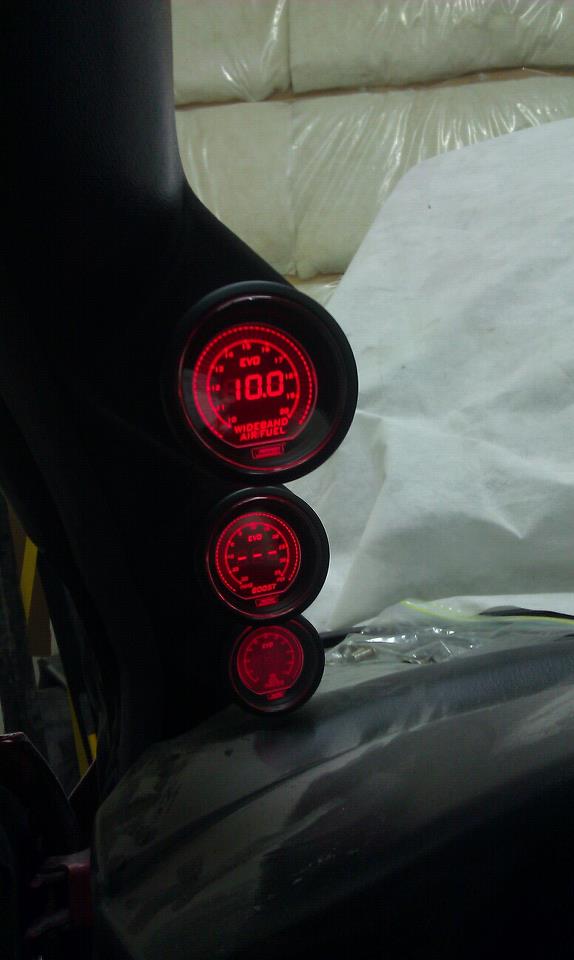

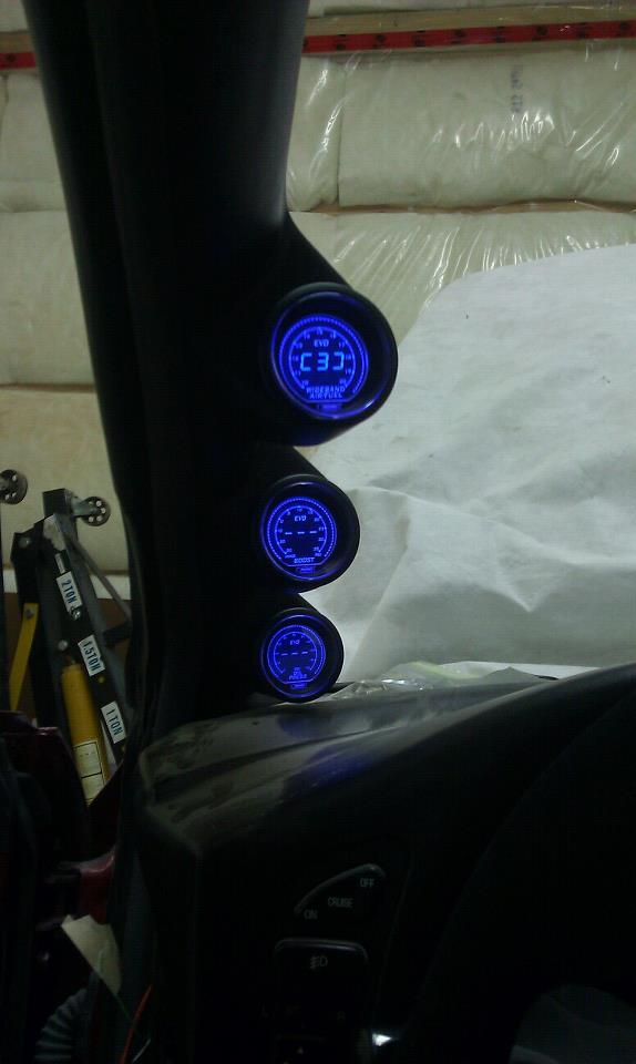

Prosport Evo gauges installed

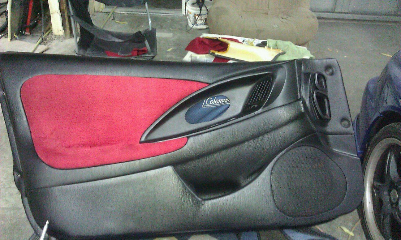

Some custom touches to the interior

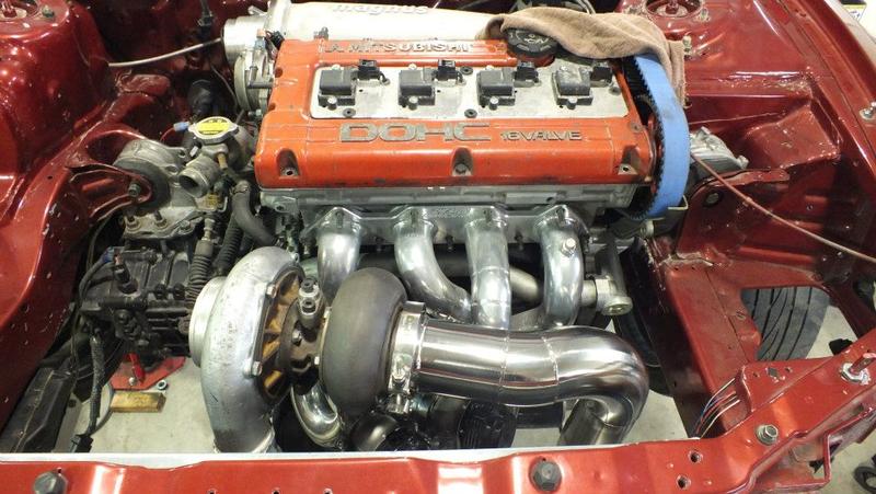

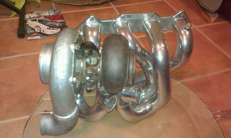

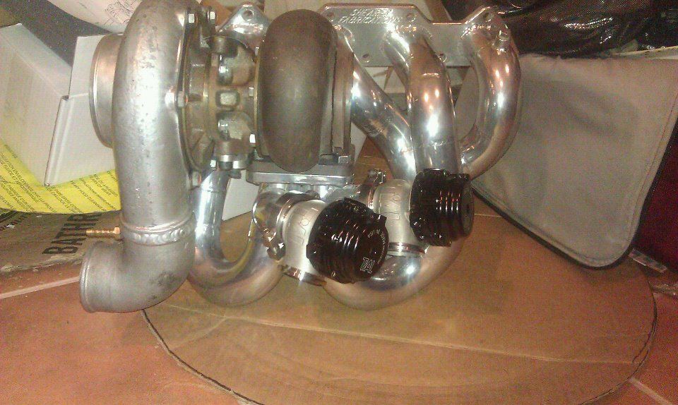

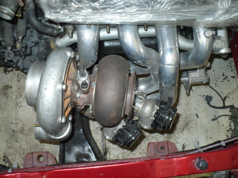

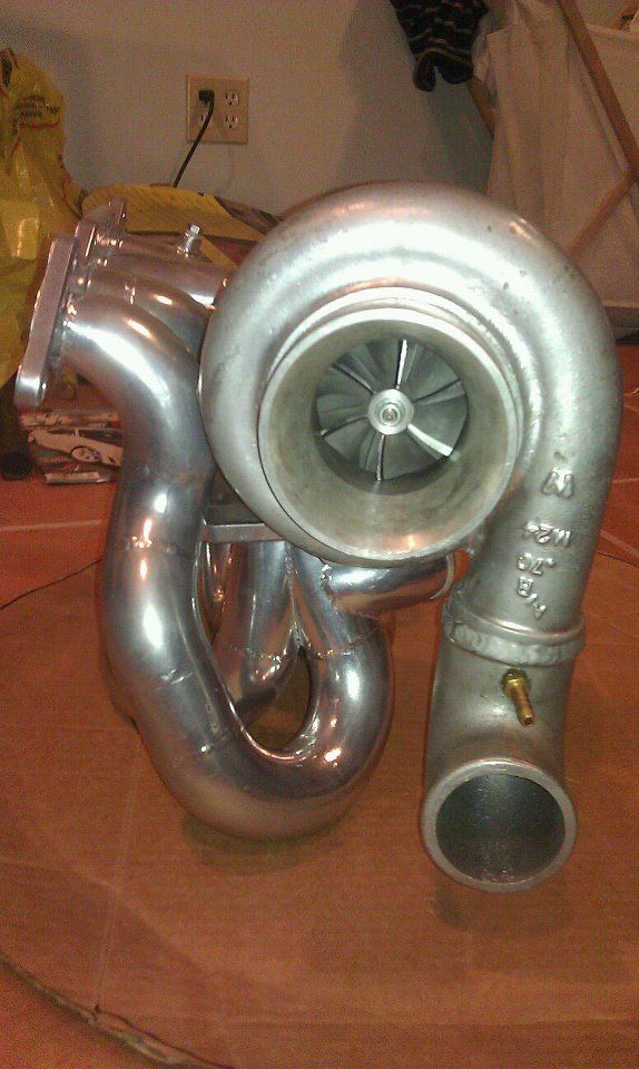

Turbo time

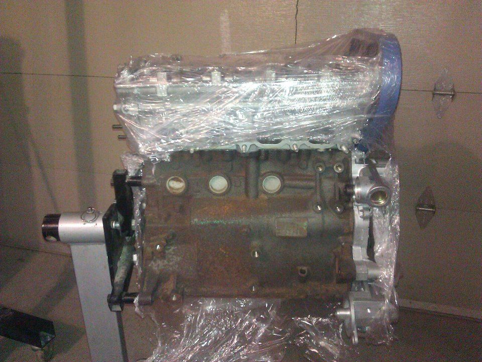

Delicious built 6-bolt:

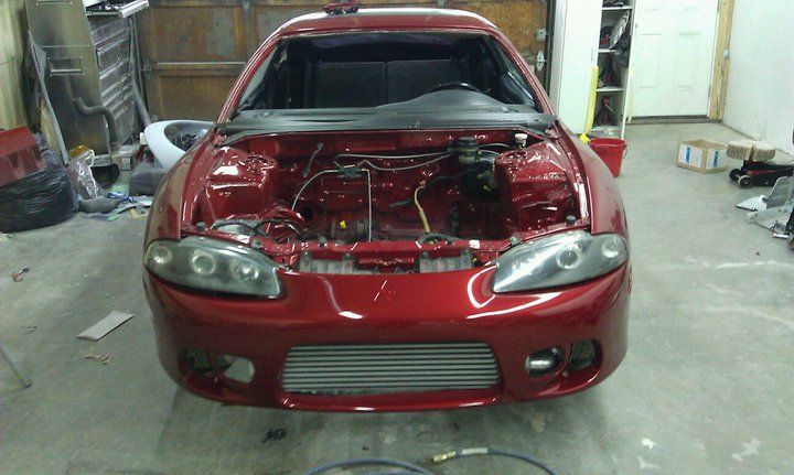

Engine bay somewhat complete (harness is almost finished, but in)

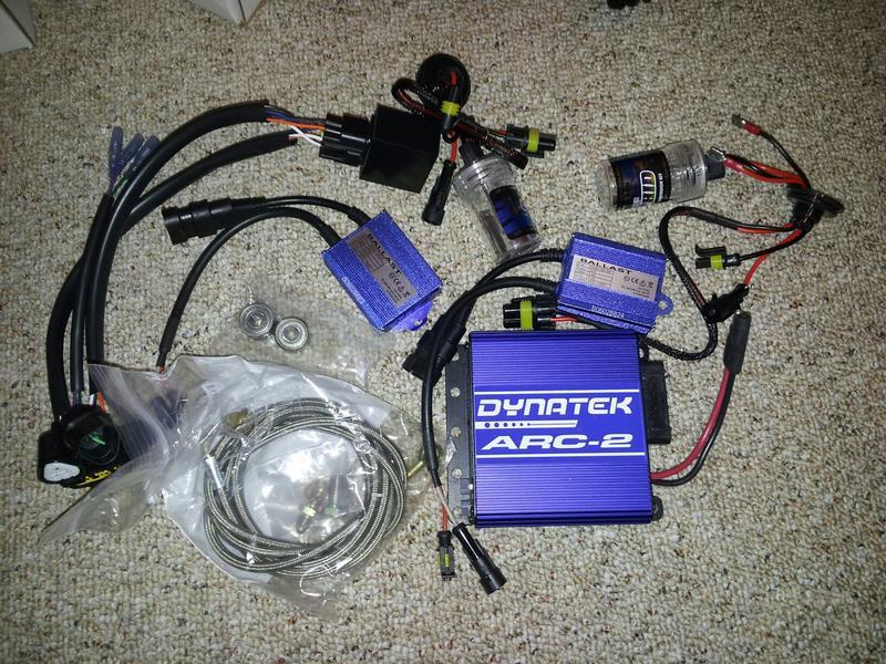

Miscellaneous final parts

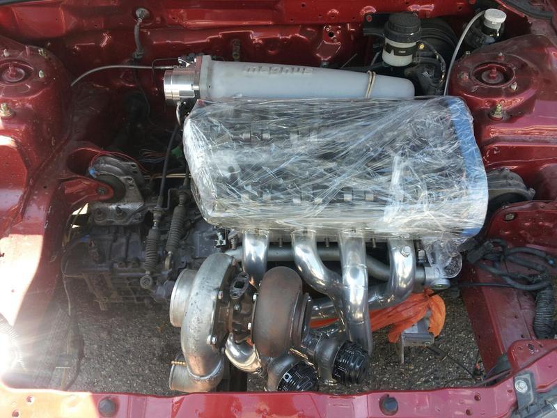

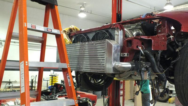

The turbo, manifold, and wastegates are too large for a stock radiator! (Yes I know the turbo is upside down, just in for mockup) Gotta mount a VW Golf rad in the rad support

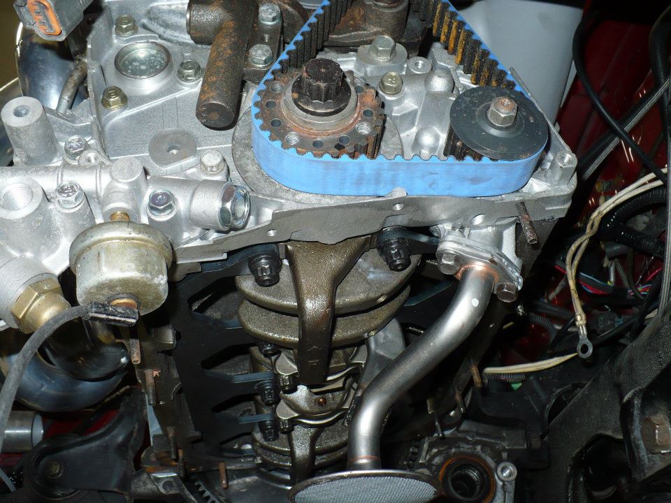

Balance shafts deleted, you can also see the main girdle and studs

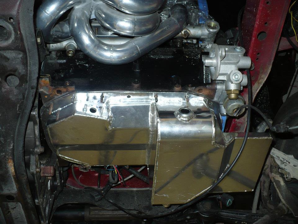

Shiny new oil pan

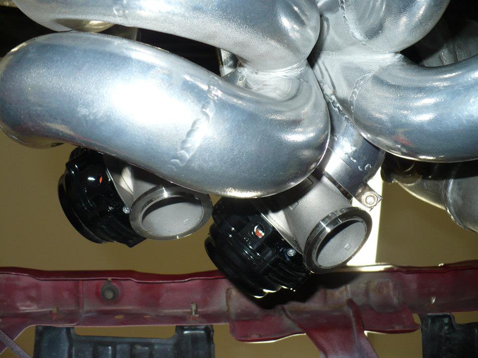

EDIT: Another good shot showing wastegate clearance

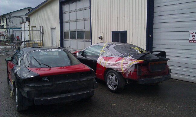

Just hanging around with my brother's Supra
Should have kept it talon :ohdamn:

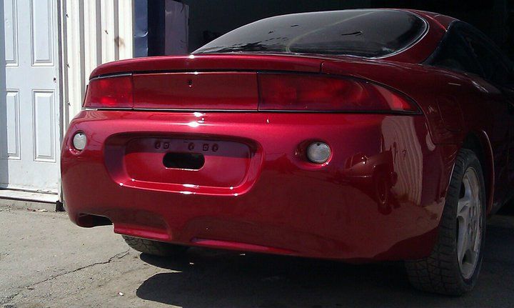

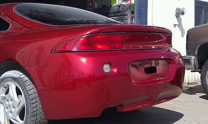

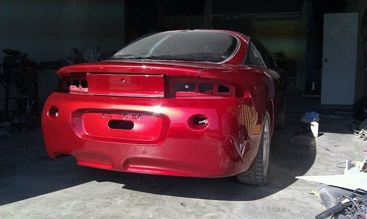

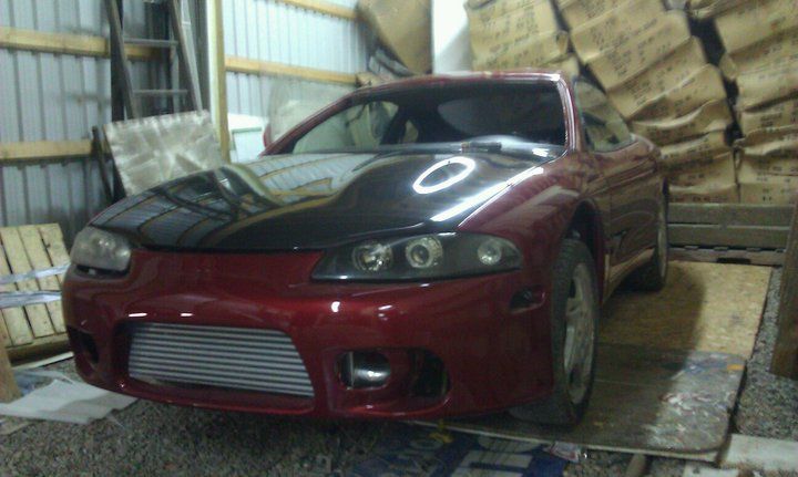

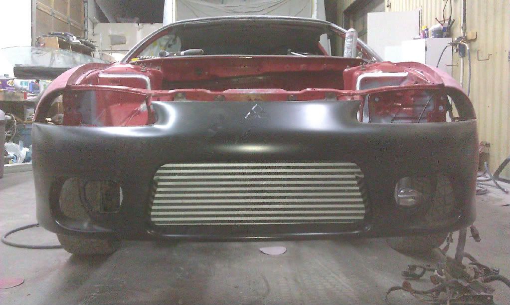

painted the car and no side skirts!
Its ok if you want to swap it to an eclipse, but do it completley... It looks like and 2gb rs with a high rise spoiler..
Nice color choice BTW.
It is done completely, I just don't have all the body parts mounted right now (side skirts, fender caps, front bumper). If you look close in the picture with the Supra you can see that it does have the 2gb sideskirts.
Thanks guys!

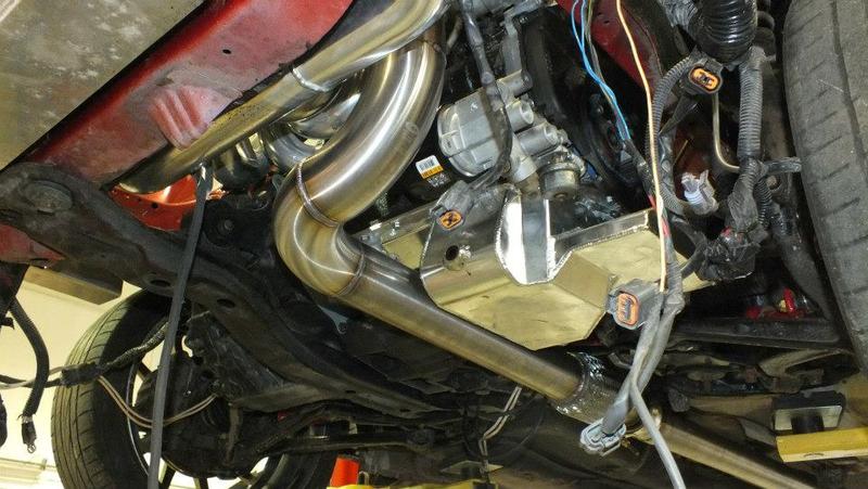

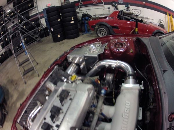

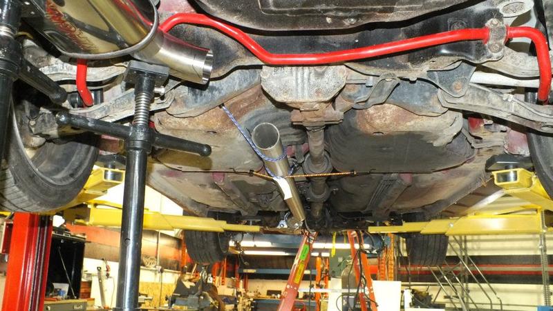

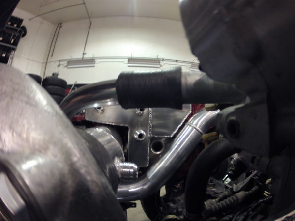

Car looks amazing man!! The exhaust work is insane as well! Whos doing all the fabbing/welding?

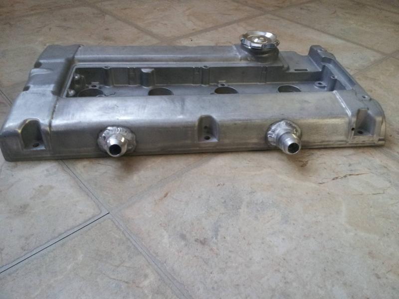

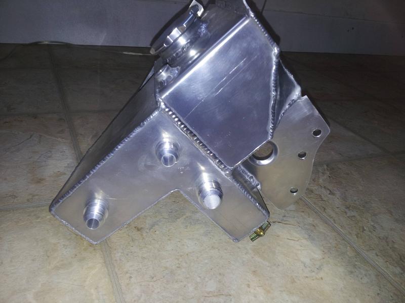

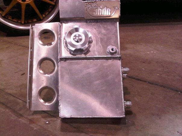

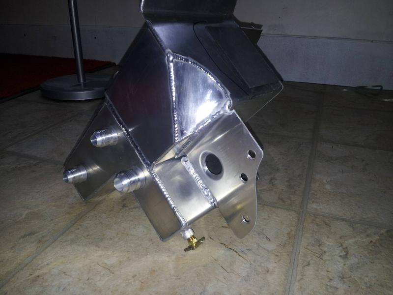

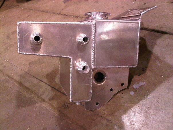

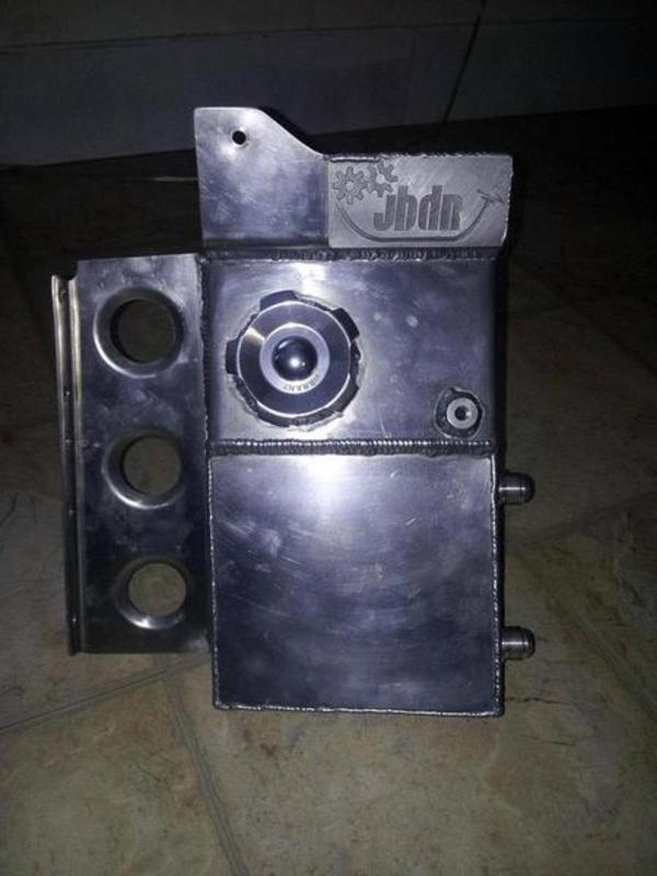

All the fab work is being done by JBDR, as he did all the fab work on my brother's MKIV Supra and it was phenomenal. I'm hoping soon to have pictures of my valve cover and catch can that he's done. I had the VC milled flat with vent line bungs and a new bunged oil cap welded on.
Wow its looking awesome, and you were right - whoever is doing the work on the exhaust and intercooler piping is doing a phenomenal job. What are you planning on using to tune?
Thanks! For now I've got a 98 flashable ecu that I'll be running CeddyMods bigmaps with speed density on. Depending on if I run into any issues with it, I might upgrade to a full standalone like AEM EMS next year.
Car is gorgeous man! I have two questions though, what kind of radiator are you using, and what kind of muffler is that?
Thanks! I'm running an upgraded radiator for a MK3 VW Golf and it fits inside of the rad support with some custom mounts. The muffler is a magnaflow oval canister with 3" in/out, don't have the exact part number on hand.

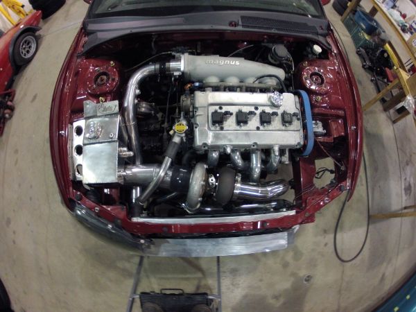

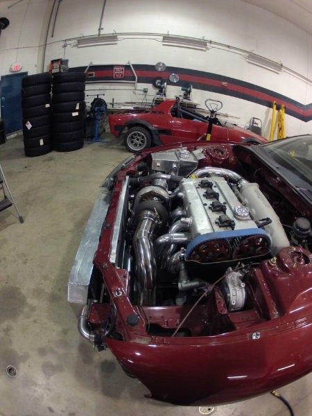

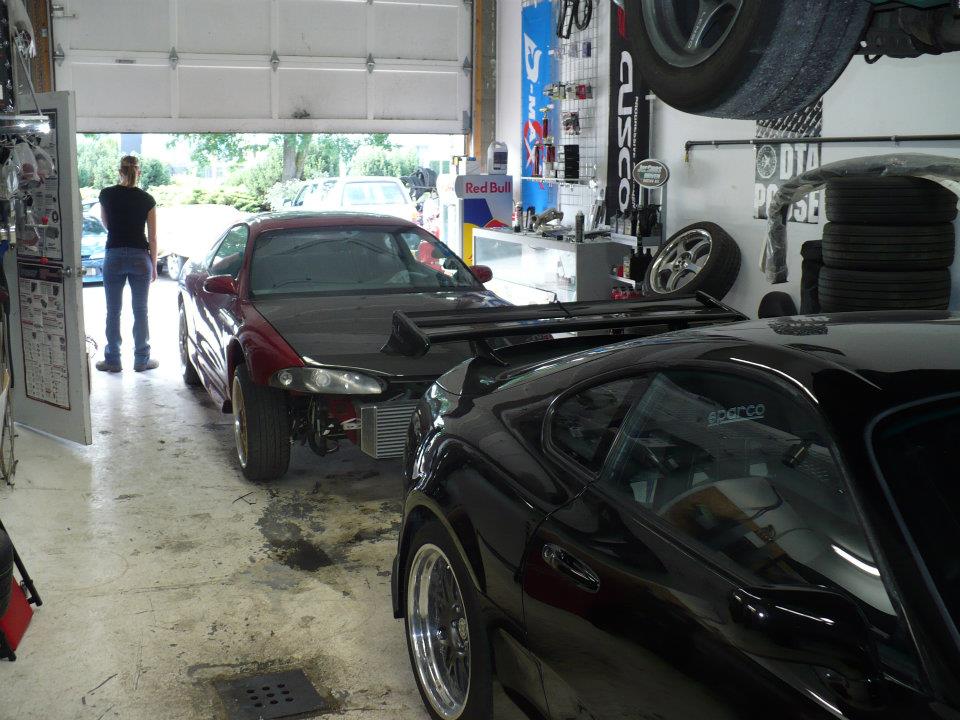

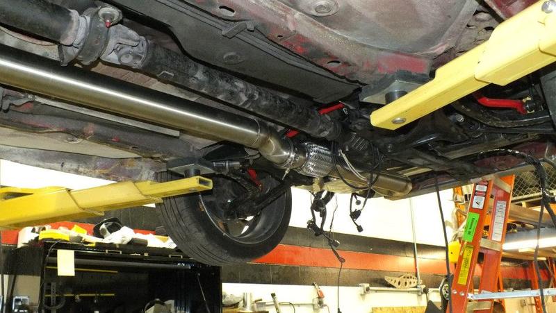

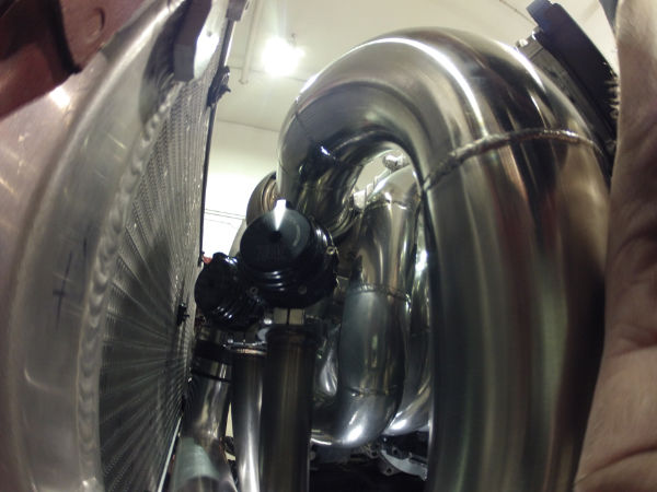

Some low-quality go pro pictures, but pictures nonetheless! Talon is done at the fab shop, just needs some small final assembly (fuel lines, turbo lines, misc wiring) then it'll be time for it's first fire up in almost 4 years!
I keep comin back to look at the car. LOVE the build and the car itself. Probably the cleanest 2g builds iv seen in a LONG time. You sir, have a sick car on ## hands. Please go with AEM or at the least dsmlink. To much quality in here not to. :hellyeah:
Some pictures to tide everyone over! The valve cover and catch can are out for powdercoating
