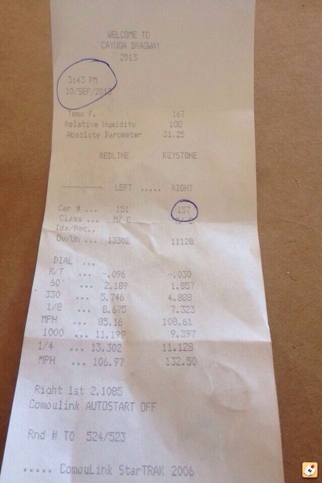

I ran 132 mph i think im somewhere around 600-650ish but no i havent been to a dyno yet. And my time at english was on pump gas and the bolt on housing. Track times speak more than dyno numbers. Talon dave hasnt been on dyno but i bet hes above 700hp
All ive ever said is my goal is a 9.9 and that isn't bench racing its a goal thats all it is.
I have much more room to grow. Heres the proof you say i lack smart ass.
Look at that shit ass of a 60ft
