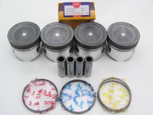

As far as availability goes, the NPR pistons are a proven performer and still readily available. Here’s one in 0.040” over for $160 from eBay.
Here’s some 0.020” overs. Same price.
I didn’t have a single issue with oil squirter interference on my 6 bolt w/ 2G pistons. Any decent machine shop should be able to bore the wrist pin hole 1mm over to fit the 2G wrist pins and honestly the bump in compression is super nice for a street car. Even on a stock 1G map.

Thinking, yes, but not without due diligence. If we're talking budget solution for a ~stock setup, what would be today's choice for piston/rod combo? Something like this? https://www.ebay.com/itm/161974975522?hash=item25b675fc22:g:SaoAAOxyni9TCZ4h
I have a motor with a set like these in it on one of my stands. Its built and ready to go into a car and they were not a junky set. This set is a standard bore and you would have to have any machine shop "hot rod" the small ends to put them on. It is something machine shops do all the time, or used to. The Hi Performance pistons and rods use full floating wrist pins with locks on both sides of the piston.

I kind of disagree. NPR pistons are $160 shipped, you’re going to need the block machined one way or another even if you get forged pistons instead so I’m not including that cost, $150 max for the rods to be machined out 1mm and the pistons put on the rods(local guy quoted me this today). You cannot put a full floating wrist pin on a stock dsm rod without machine work(at least to my knowledge. Someone will correct me if I’m wrong) so either you’ll need to machine the stock rods for a forged piston, or go with a set of aftermarket h beams.
Cost vs cost it’s $310 for brand new 2G pistons on 1G rods with machine work included and ready to drop in and go.
Forged pistons and rods are gonna be $850-$900 minimum combined for eagle/wiseco if you can find a screaming deal. Extreme psi has a package deal for $940 shipped for them but that’s the cheapest “quality” forged piston and rod combo I could find.
Way cheaper to go NPR 2G pistons on 1g rods.
Or just grab a set of brand new engine tech 1G pistons for $130 and just have a machine shop put them on.
