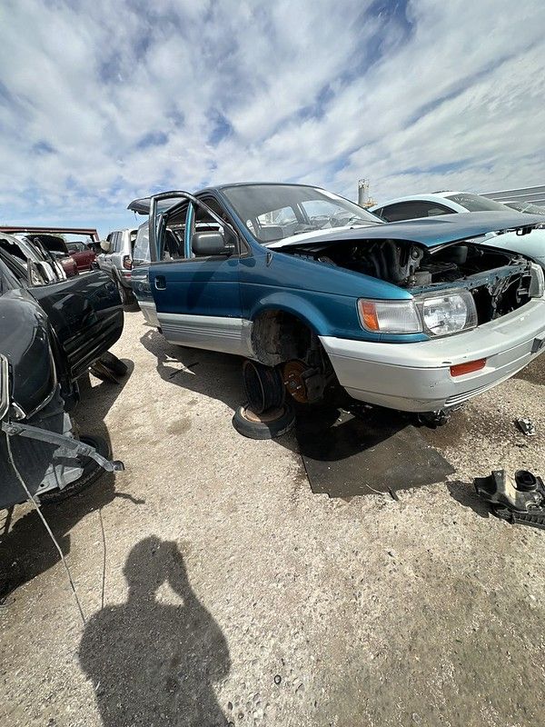

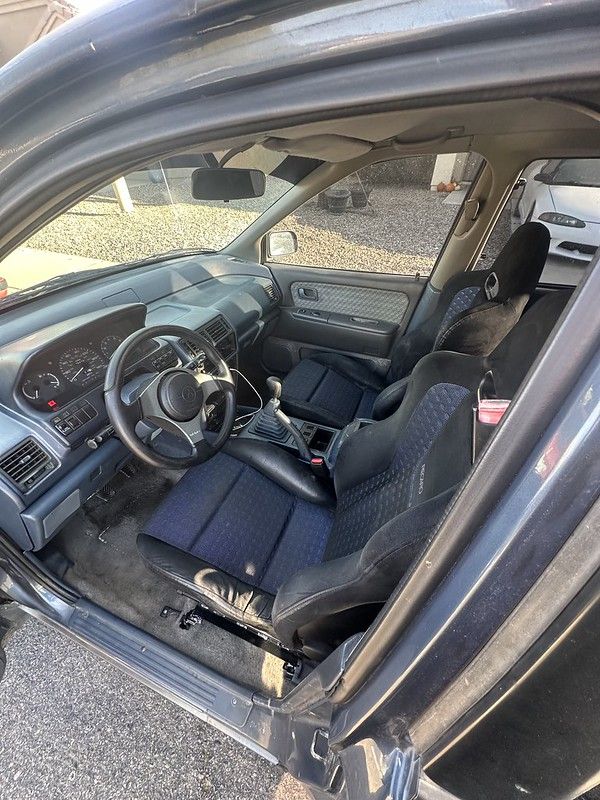

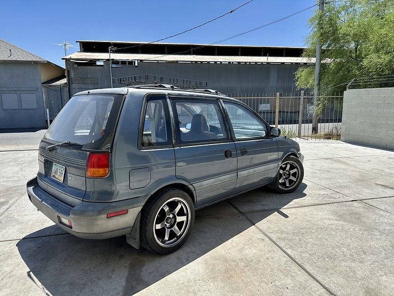

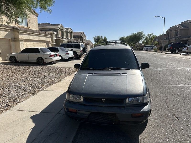

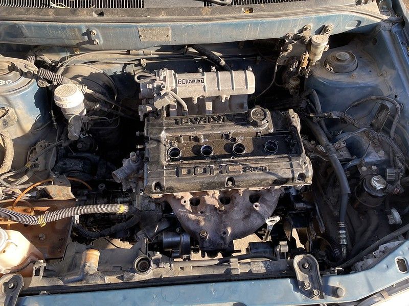

I tried to get a couple buddies to buy this car when it popped up on Facebook marketplace about 2 months ago. I started talking to the guy and decided maybe I need this. I've had 3 colts but not a van and i've always wanted one. The guy said the engine had a spun bearing and the trans was missing 5th but it was complete/stock. 2 hours before we were loading up to go look at it he told me he was pulling the ad and didn't want to sell anymore, but would add me on facebook incase he changed his mind. I had pretty well forgot about it up until Wednesday of last week when he messaged me saying he needed to sell it now. We loaded up friday and ended up negotiating him down to $600 for it. In comes a 1992 eagle summit AWD to the collection.
Untitled by Tyeler Andersen, on Flickr
We stuck a battery in it and confirmed the noise, then promptly took it out in the desert and tried to blow it up but it's a fighter and just won't die. Had it singing at 5K+ in some deep soft sand through 1st and 2nd and it just keep plowing along so we decided just to yank the engine out this week and drop the 4g in it. The plan is just to get it running with one of my spare 16gs and then mod as we need to. We have an HPDE event next month and the goal is to have it ready for that. I'll continue updating as I can!

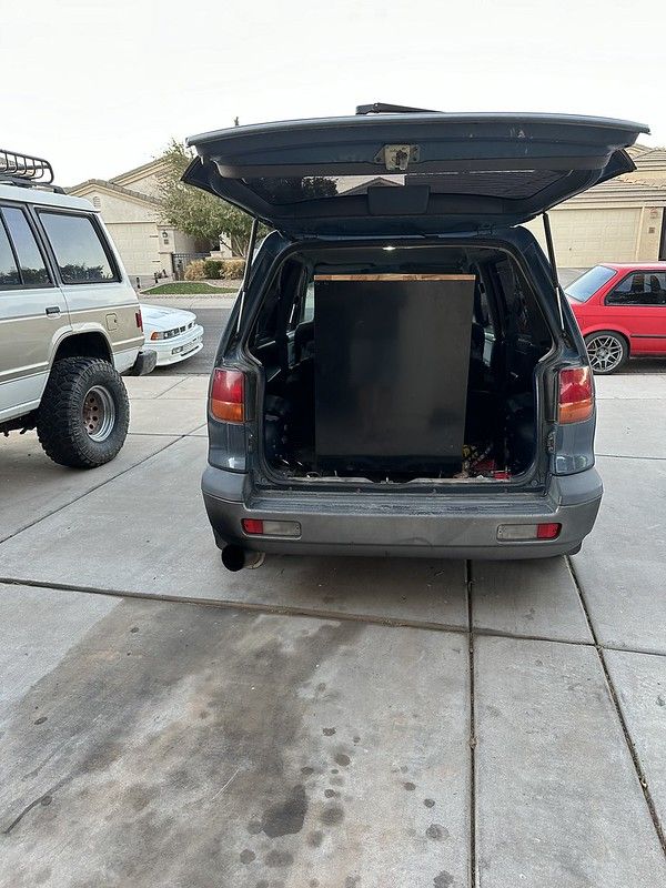

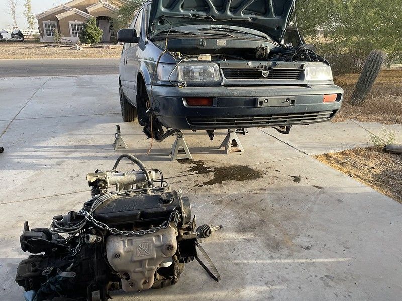

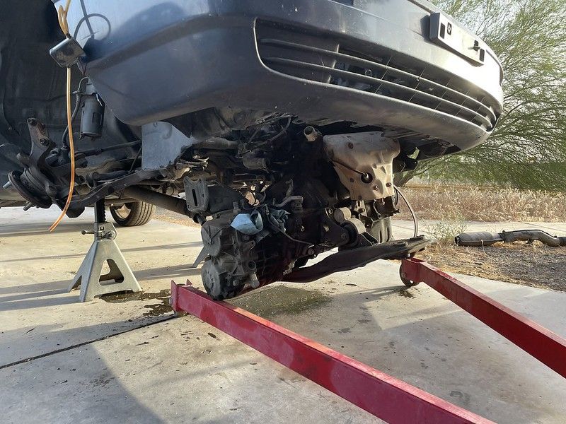

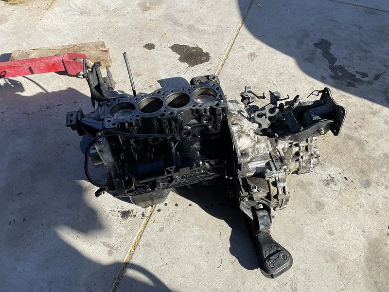

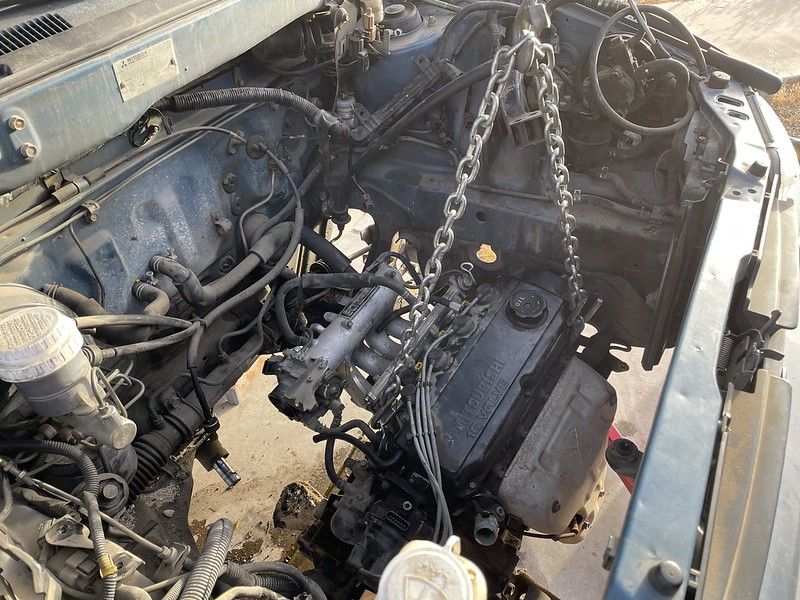

Spent some time friday after work pulling this thing apart. I don't have enough room at my house so my buddy was kind enough to keep the car there. He lives about 30 minutes away so it prevents me from spending time wrenching on this like I can with my other cars, but luckily he has no fear of ripping into projects like this and is motivated to work on it. I showed up and he had half the hard parts off and nearly ready to pull the drivetrain. We spent maybe an hour and had the 4g93 out! These use a small crossmember compared to a dsm so it was easier to just drop the whole drivetrain out the bottom. Quick work on this thing.

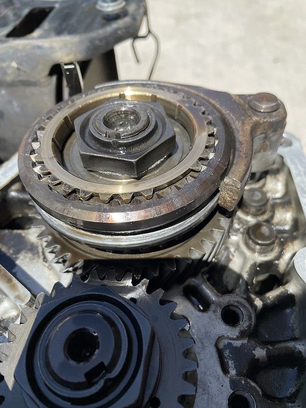

This trans was missing 5th and reverse was hard to get into and when my buddy drained it it was basically out of fluid completely. I'm actually amazed how nicely it shifted and how quiet it was considering there was no fluid in it and we beat it quite a bit. I'm going to tear into it and see if I can throw some bearings and fix 5th and we plan to run it. If not I have a few spare trans we can either pillage for parts or build another.

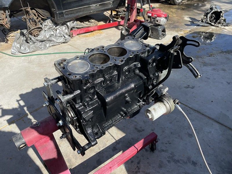

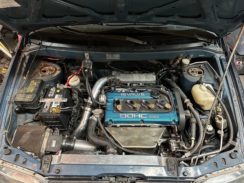

Turns out it has ross pistons, h-beams, ARP studs everywhere, BSE, and a built head with 1mm over valves! He definitely got his money worth and then some on this car as we picked it up very cheap. The plan was to throw one of my spare 16g's on the car and just crank it up and have a responsive street setup, but now we may have to throw something a little bigger on. The plan is to throw the head back on with a new headgasket and get it in the car so I can start wiring it up. I have a couple spare 3g/evo ecu's and since all of my other cars run on evo ecus it'll be easy to throw those in and go.

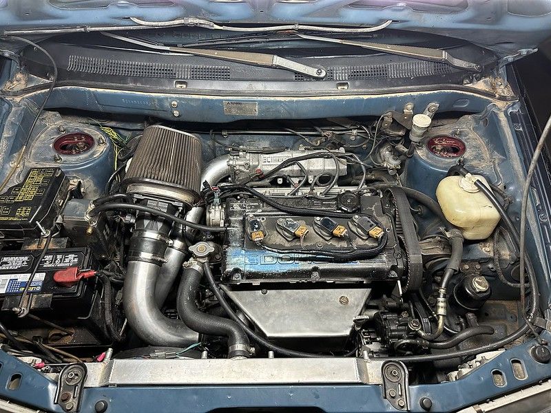

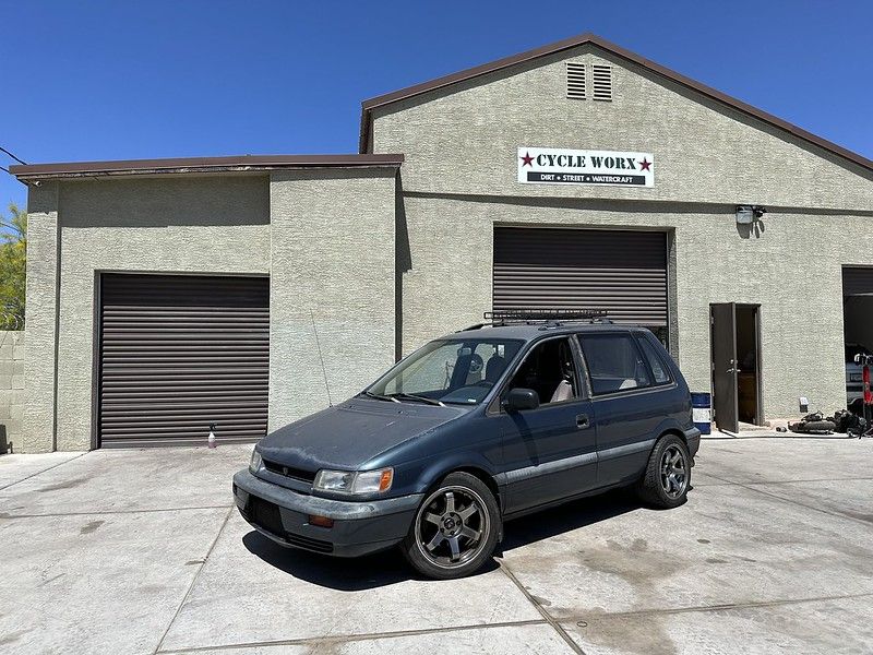

Officially 4g63T swapped! We started off the day resealing the shortblock. There was one broken off oil pan bolt that needed fixed and I was 30 minutes from my tools so we improvised with a torx bit socket. Worked perfect!
Next we needed to make it pretty so a few coats of engine enamel had the block looking fresh again.

Planning to mesh the harness this week and get some hoses/intercooler setup done, but there's not a whole lot left to get it going. We pulled an evaporator case from a 92 while at the yard since this was a non-a/c car so I need to swap all the A/C parts in but thats all minor details for now. We just want to get it running so we can use it.

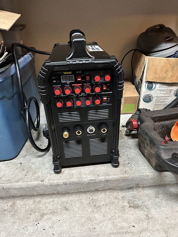

I had planned to just run a dsm side mount for the time being to make things simple but having a tig on hand the wheels started turning and decided the evo 8 intercooler I had on the shelf would make a good addition. It bolted right up to the stock hood latch mount and just needed some lower tabs made to make it actually sit level. I did end up cutting the driver side inlet off and welded a 90 that fires next to the radiator similar to a 1g VRSF or ETS kit does. The UICP had to wrap around the core support like a GVR4 ETS kit does but it still worked out great there. I'm using a VRSF throttle body elbow and 1g/2g j pipe to mate it all up, really simple 4 coupler setup.

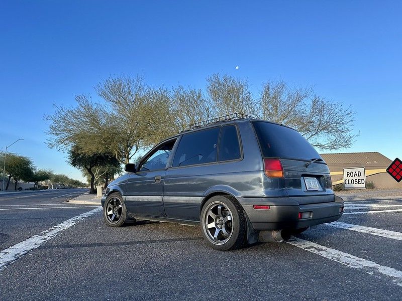

I wanted to update the wheels and tires on this thing from the get go, the motegi's aren't bad but I'm not a fan of black wheels and these are only 7.5" wide so the plan was to 5 lug swap it at some point. There was talk on the wagon group that 03-06 outlander rear hubs were a direct swap to 5 lug the rear of the van and 1g hubs up front were a direct swap as well. Luckily for me there happened to be a couple AWD outlanders at the yard, unfortunately the disc brake outlander which is really hard to find apparently was from the midwest and I gave up trying to pull the hubs after almost an hour of slide hammering with zero progress. We went back the next weekend and pulled the hubs off a drum brake car and grabbed a set of outlander front dual piston brakes.
With the 5 lug swap I needed some new wheels, the plan was to take the FN01RC's off my galant and put them on the van so I could change wheels on the galant to evo X GSR's or something like an advan RG4. I have this set of rota grids in a 17x9 +25 sitting in the garage from my black evo. We swapped to a legit set of TE37's last year as the grids were missing a giant chunk of the lip on one wheel from a fight with a concrete guard rail in the rain. I had wrote off the grids as being junk after that, but couldn't bring myself to toss out 3 good wheels. I test fit them on the van and to my surprise they fit really well with the 255/40 NT555's that were on them. I even test fit the 18x10 +30 TE's and was really surprised how well they fit and thats with a 275 tire! The turning radius is next to nothing with the TE's as they'll contact the frame rail long before full lock but the grids fit perfectly with zero rubbing at full lock. TE's up front and grids in the back

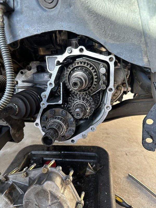

While I was at the 5 lug swap I wanted to swap out the trans and tcase for a 2g AWD setup I have. The stock van trans has held up to way more abuse that I would've imagined and more launches than I think I've done on my other cars combined.. but 5th gear has been a problem since before the swap. I previously swapped the hub, slider and shift fork for 5/R after realizing the shift fork was broken, however, I still had issues with it kicking out of 5th randomly with varying throttle changes. I had a supposedly good 2ga AWD trans so I was planning to swap that in while doing the 5 lug swap. The trans swap turned into a much bigger ordeal than I anticipated. I knew from research that the van rear diff ratio was probably going to be different than the DSM which would warrant a rear diff change. It should've been a 3.909 vs the 2g awd 3.545 and I had a dsm ring/pinion to swap in if that were the case. When it came time to swap it I found more bastard child stock parts on this thing in that it had a 2.8 rear gear which I couldn't find any information about other than they came in some galant GSX's. I didn't think this was going to be too big of an issue until I actually pulled the carrier out and realized its drastically smaller than a dsm carrier and I wasn't going to be able to just swap ring gears. On top of that the axle stubs for the vans are smaller than a dsm so swapping a dsm carrier in won't work either. I had almost given up on the trans swap at this point but luckily a local van owner had a 3.303 van diff which happens to use the same size carrier as a dsm but with van axles stubs. We picked that up, swapped everything over and got it back in the van. The rest of the trans swap went smoothly, all the stock van mounts bolt right on to the 2g trans and I used the van shift bracket and shift cables. I ended up tig welding the grids up and grinding them back into shape and was able to fix the wheels to an 8/10 condition. I was super happy that I was able to fix them!
We're now 5 lug, full 6 bolt/2g drivetrain with outlander big brakes.

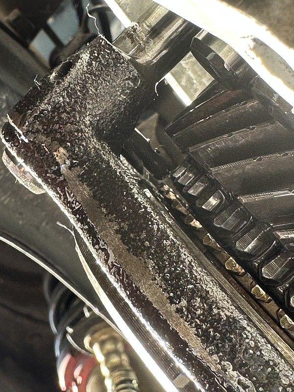

I thought everything was going to be all good from here until I went on the first test drive and realized I still have no 5th gear. It would just try and grind going into 5th, but every other gear worked flawlessly. I was hoping the hub was just dry from sitting and a long test drive might be it freed up, but no dice. I started to wonder if I had a stretched shift cable or a bent shift bracket which led to the last trans having issues and just decided to deal with it down the road, well we had a track day coming up and with an 80 mile drive down the interstate I really wanted 5th. I also needed new tires as the 2012 NT555's weren't going to cut it. What I didn't know was that the new wheels were going to present a new problem with the van. I dropped it off on a tuesday at discount tire for some fresh 245/40 advan apex's. I run these tires on my track evo 9 and my galant and have been really happy with their overall performance for both track days and daily driving. Unfortunately when the guy who was swapping tires went to back the van out he managed to jam up the 5th/R slider and now I had no 5th or reverse. We had to push it out of the stall and I drove it home. I think he tried to get it into reverse and it didn't go the 1st try and ended up mashing it back jamming the slider up. What also sucked was that the track day was that saturday. Wednesday night I decided to pull the end case off and make sure the 36mm nuts hadn't come loose on the trans since that is a common failure point to lose 5th and reverse. I got the case apart and found much worse. It's hard to see in this photo but the roll pin for the 5th shift fork had worked its way out and was contacting the gear and hub.

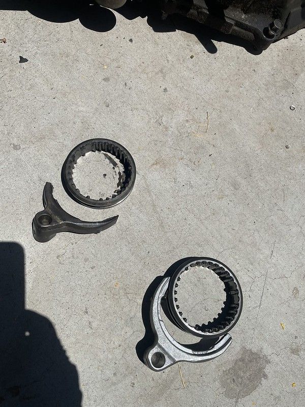

It had marred the teeth on the hub and I was doing everything possible to pull it apart and nothing short of pry bars and hammers freed it up. In the process of hammering it off I broke the silicone seal on the midcase so here I am at 6:30 at night in the driveway with the midcase and half the trans ripped apart in the car.
That turned into a fiasco after the shift rail popped off the shift selector and it seemed like everything that could go wrong went wrong, but by 9pm I had the case glued back on and was all put back together. I ended up robbing a hub and slider from a built jacks trans I had but I now have a smooth 5th and reverse!

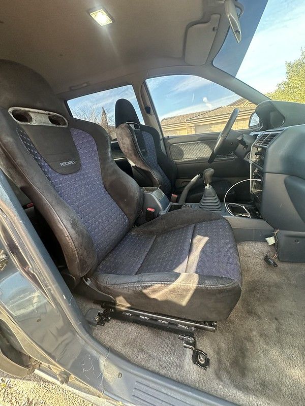

With the trans fixed I spent the next night getting rid of the school bus steering wheel these come with stock and put an evo 8 wheel in. I have these in 8 of my mitsubishis so this was a no brainer for this thing too.

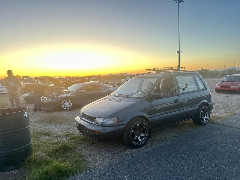

RACE DAY! I was a little nervous for the drive as this was the longest trip I have taken in the van so far and we had changed so many things in the last 2 weeks I wasn't sure how it was going to go. A buddy with an AWD swapped spyder I helped him build as well as another buddy with an absolute shit box of a 420a GS were both coming along to race, neither of which car were in anywhere near the mechanical shape as the van, so I was a little less concerned. I honestly can't believe how well this thing cruises. I led our group down and had to pull my GPS out to make sure the speedo was accurate when I realized I was cooking along at 95mph and it was just purring away. Easily one of the best, if not the best highway cruiser out of my entire fleet.
Setting up to get ready for tech. Unfortunately the GS quit charging on the way to the track and somehow still made it there on the battery alone, and the spyder puked all the power steering fluid and started getting warm (I think it lifted the head the last event) in 3 laps so both cars were done for the day before the event even really started.
My first session out was my fastest session, despite hitting traffic the entire night. My fastest flyer lap was interrupted at the start and the finish by traffic which slowed 1.5-2 seconds on my lap time and the rest of the night I couldn't put a clean lap together without traffic at some point. It felt wrong beating up on miatas on a track they normally destroy the lower power cars on, but it seemed every lap I had a miata holding me up.
All in though it was as flawless night, I finished with a measly 67.8 lap time (my prepped evo 9 does low 61's easily here) which was a solid 4 seconds slower than I was hoping for. The stock seat is absolutely atrocious to race in, a real seat alone is an easy second or more of lap time. I was constantly swung from one end of the seat to the other and wrapping the seat belt up to make it tighter did very little. The rear shocks are the original shocks as well and theyre well past their expiration date. When i could actually carry speed through the corners the rear would lift and bounce like a basketball making it hard to rotate the car. I've also been spoiled by the mechanical front and rear LSD's in the evo. I was so used to being power down at the apex and steering the car with throttle that I was pushing through corner exits with a tire lifted and free wheeling. A mechanical LSD is high on the list of priorities along with a bracket for my corbeau fixed back and some rear shocks. Even with no boost controller on this internally gated 20g I never felt I needed more power or more response. It lights off like a rocket ship which didn't help with my heavy right foot driving style. The outlander brakes were insanely impressive as well. I reused the junkyard pads that came with the calipers and the rusty rotors, with fresh fluid I never managed to fade them and everyone who rode with my was really surprised how hard they would bite. I don't think i ever used over 1/2 pedal travel and i was constantly into the seat belt lock at the end of every straight away. I'm super excited to push this thing. The reactions to it were the best part of the whole night, everyone thought it was hilarious other than one old man in a ZL1 camaro that was talking shit in the tech lane, but I never did see him on track.

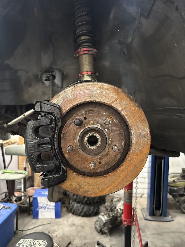

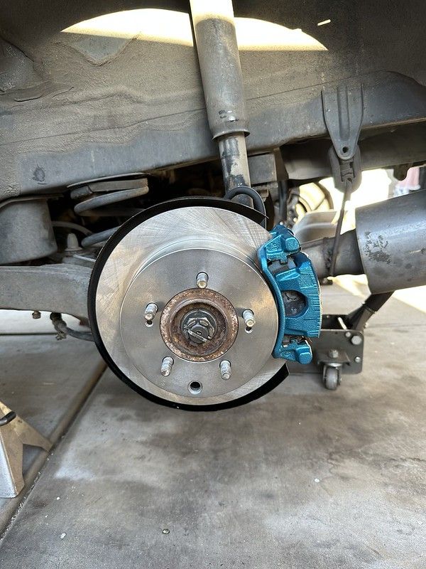

The outlander brakes I put up front have been fantastic but I really wanted discs all around. The end goal is probably a set of evo brembos all around, although performance wise I have zero reason to upgrade from how it was. That being said a set of very hard to find factory rear disc brakes with backing plates came up on the facebook group so I grabbed quickly grabbed them. These cost half of what the entire car cost me but at this point it didn't really matter as I'm not budgeting anything anyways. I shot the fronts and rears in a matching blue to the valve cover, grabbed a set of 2g awd rear rotors, and swapped the stock drums out for some "nice" looking disc brakes. I have yet to track this with the new brakes but I don't expect any drastic improvement over what it was, these are just lower maintenance and look was better.

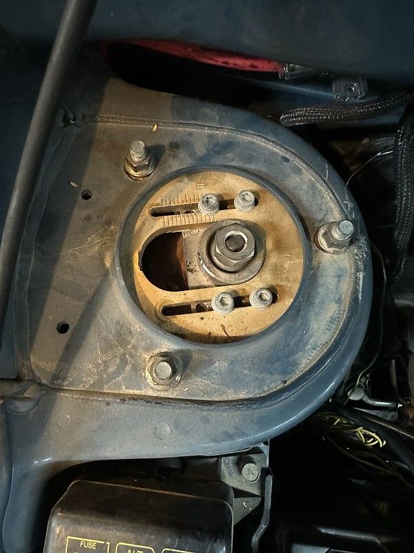

The last track day I didn't have near as much front end grip as I was hoping. It's easy to compare this car with my evo since they run "similar" setups and the front definitely felt off. I hadn't actually checked alignment short of matching my camber plates and a tape measure toe adjustment, so I figured I'd check it out since the camber seemed pretty poor. Sure enough the front with the plates maxed out barely got me -.8 degrees of camber. I run -3.2 in the evo and most of my other track cars are in that ball park. I have evo 8/9 coilovers and camber plates up front, however, the plates get spun 180 to fit the van chassis. This gives you a whole lot less negative camber adjustment since the evo plates are meant to adjust the opposite direction. I snagged a set of fortune 510's for my evo on black friday which meant the tanabe sustec pros that were on the car were gifted down to the van. While it was apart I machined the camber plates to give me as much negative camber as possible. These are also kicked slightly back so camber changes also add caster which is a win-win. I was able to pull them out to -2.7 with plenty of room to go more if I ever needed to. I also modded the rear shocks to fit as I was running stock blown van shocks previously since it's a divorced spring. I still need to swap to a heavier rear spring but the newish shocks with stiffer valving are a minor improvement on their own.
This is how much adjustment I had before, you can see in my first picture that they're not machined all the way out to the strut tower lip now. Easily -4+ degrees capable on their own now.
Here's the new ride height with the new coilovers. Plenty of ground clearance still and it handles nicely, we'll have to see how well it does on track. I had some issues with the MVD here messing up my registration so I got my 3DR EVO license plate I was planning to get :D

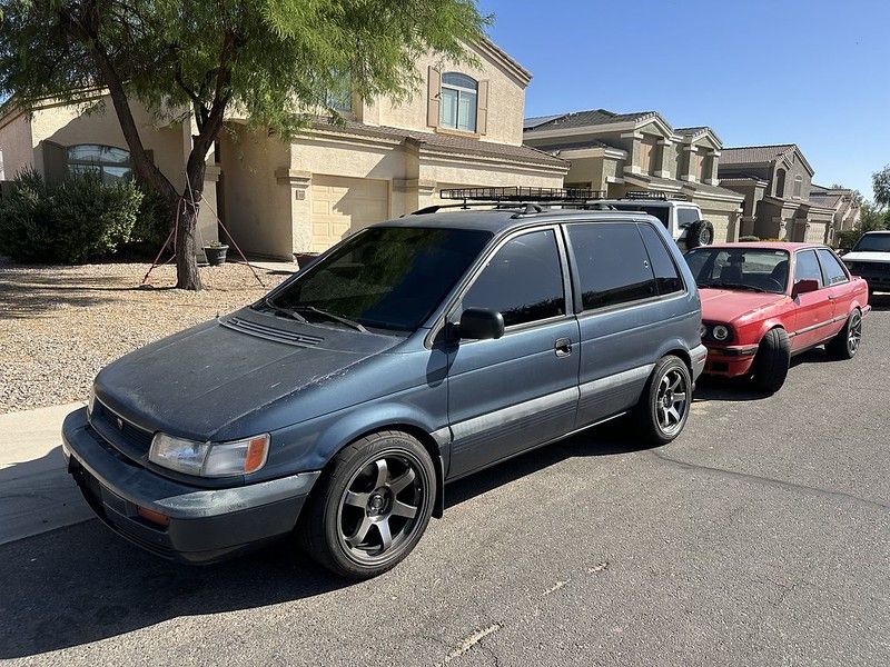

Exciting (to me at least) update on the not so sleeper van! I guess this isn't really a cheap build anymore and I've gotta actually make some things nice now. I had a huge package delivered last week that i've been waiting on customs to clear from australia.
For those that aren't familiar with these or RVR's in general, the high package of an RVR was the Hypersports gear R. Basically an RVR with an awd 4g63t, fishnet recaro interior, and an awesome factory body kit way more aggressive than anything that came on any of the other packages. These weren't very common and they obviously never made it to the states. I've been trying to purchase a kit for over a year but between shipping costs quoted in the $10,000 USD range and people just flat out (rightfully so) not wanting to ship it, i figured it was as pipe dream purchase, until now!
My full hypersport gear R kit minus the factory fender flares which are much easier to get although I'm on the fence if I want them or not anyways and the rear bumper which just has a huge jeep style spare tire swing out that I definitely didn't want. The kit consists of a front bumper, side skirts, and a giant rear wing, I also have to swap out headlights, corner lights, and the hood. I'm using HSG lights, but a late model USDM hood is the same as a hyper hood. The front bumper needs a fair amount of body work but I'll gladly get that fixed to have this kit.

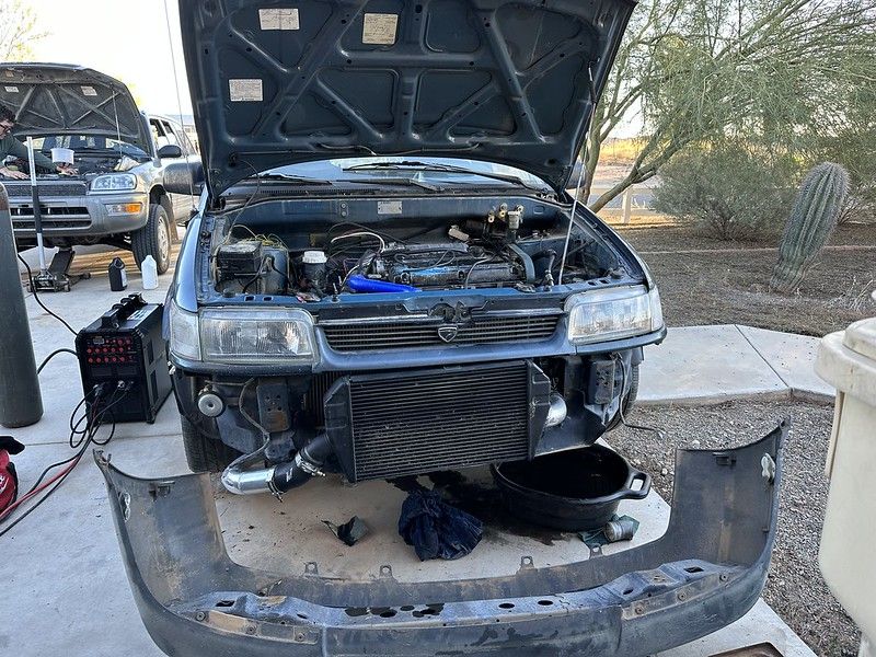

Now it's off to paint and I guess it's time to upgrade from the evo 8 intercooler to a nice shiny aluminum core that fills the bumper front up better. The rear bumper is a little lack luster now too so I'll be making a few modifications to that to help the front flow into the rear
New front end meant it was time for a light upgrade, the factory lights were like candles and the housing kind of sucked. A bulb upgrade from whatever probably 20 year old bulbs would've helped but they still weren't impressive. The HSG lights have a much better design for light output and a good cutoff so I threw in a set of H4 LED's along with converting the side markers from just white LED markers to a switch back turn signal. The corner lights are almost as bright as the headlights themselves. I do have a set of USDM expo headlights in this same design since the HSG are for a RHD the cutoffs are opposite. I like the silver housings on the HSG vs the black housing the USDM expos have so I may swap lens over to have a proper LHD reflector, but this is significantly better. I have 35% tint across the entire windshield and can actually see well at night now.
Aside from repairing/painting the kit I had to ditch the giant black hole in the front end the stock evo 9 intercooler left. The USDM bumper barely cleared this and I had to v mount the intercooler just to tuck it under the cover with the crash bar completely cut out the center. The HSG bumper has an insane amount of room, arguably more than my evo 8 and 9 bumpers do. There's 7" of front end clearance to the inside lip of the bumper to my A/C condenser and plenty of width/height. I had a 2g punishment core laying around so I installed that hoping it would fill the front end, which it does, but the sheepy 4" core I run on my evo 9 would fit better and have nicer outlet angles for the intercooler piping. For now this will work, but I'm probably going to order an evo core and install that instead. Regardless it looks way nicer with the silver intercooler taking up the whole front end. I'll be ducting whatever permanent core i install to keep it cool on track and the AC working properly.
