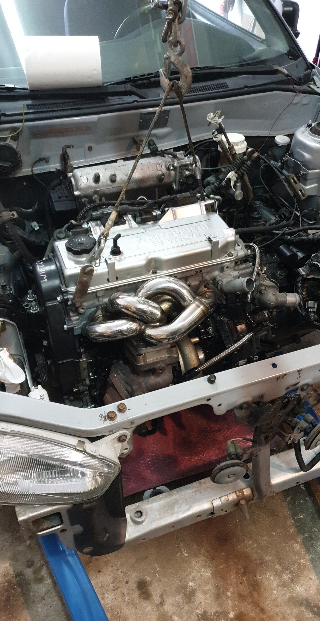

96 Mitsubishi Colt Sleeper Build
Frankenstein 4G93T FWD Sleeper
I gotta write up what I did to this car over the years some day, but that seems like a project for a different day.
