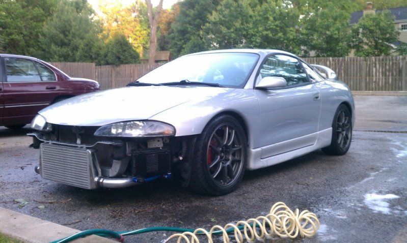

Decided to show a little build thread for my daily driver. when i bought the car everything leaked, it was smoking everywhere and needed lots of love. i always wanted one of these cars since i was little. i was in the market for an evo for about 6 months or so, i had a budget for about 17K. i could not for the life of me find a clean one. as evo theft started rising in chicago my friends talked me out of it. so i settled for the minievo.
when i first got it, purple stock wheels and a DSM front mount.

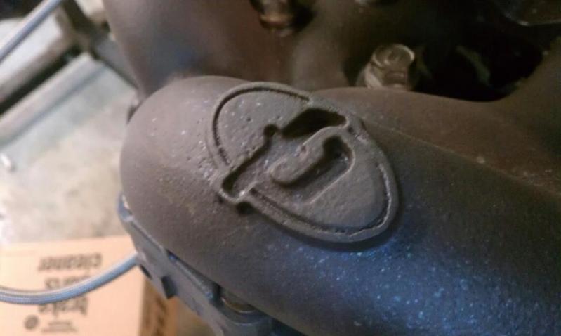

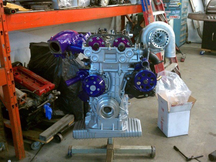

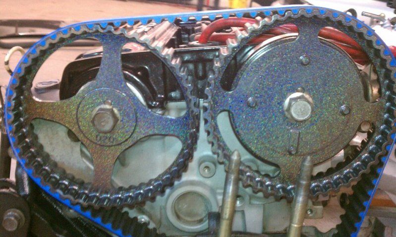

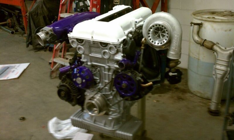

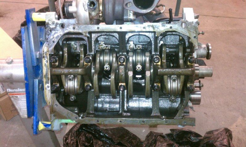

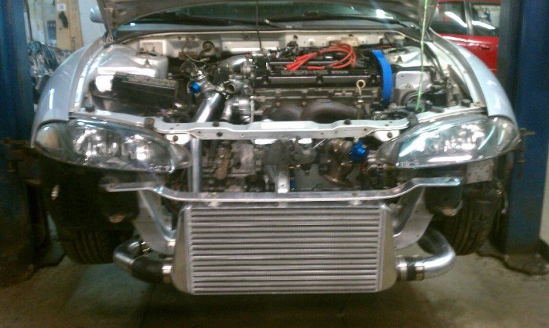

pulled the motor out. it has a fully forged bottom end, pistons, built head, valves, springs, retainers, FP manifold, Tial MVS, 16g/20g compressor wheel
super dirty

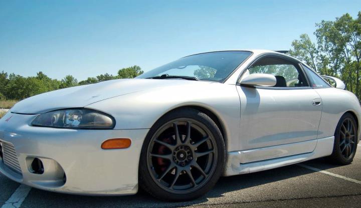

got some wheels, work emotion crkai
at my shop MSPtuned

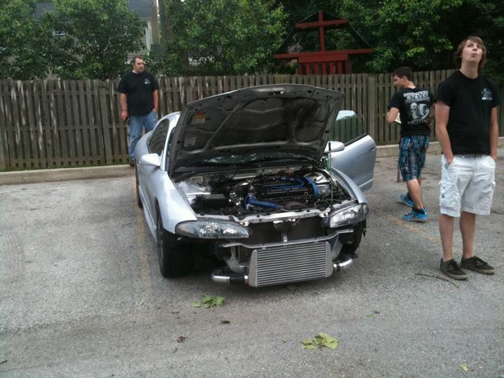

brought her home

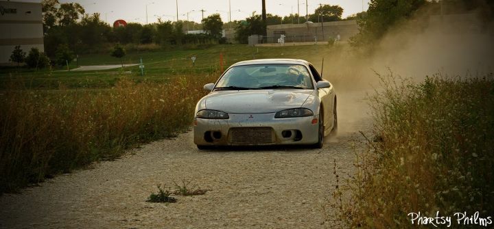

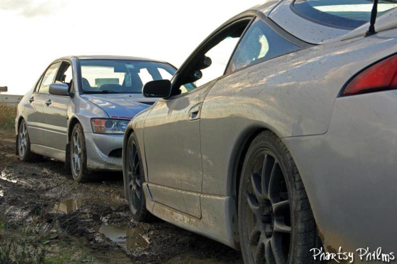

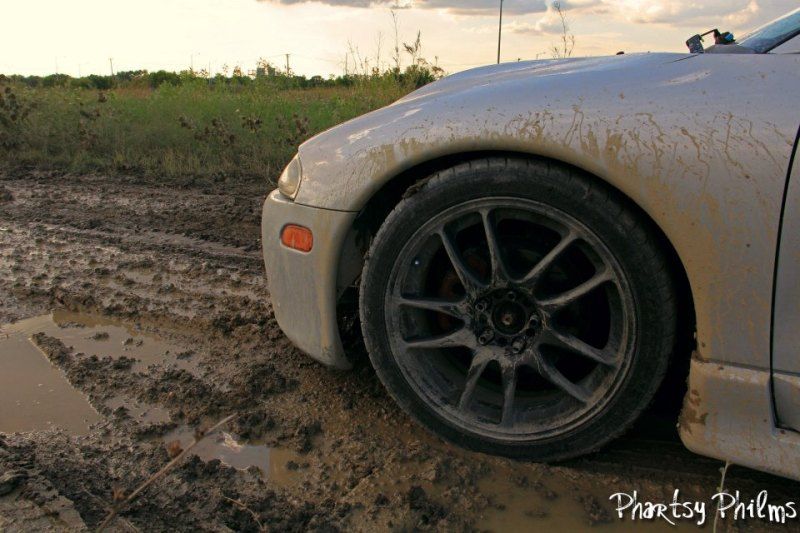

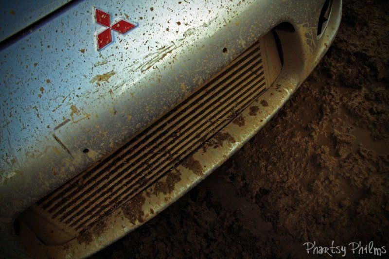

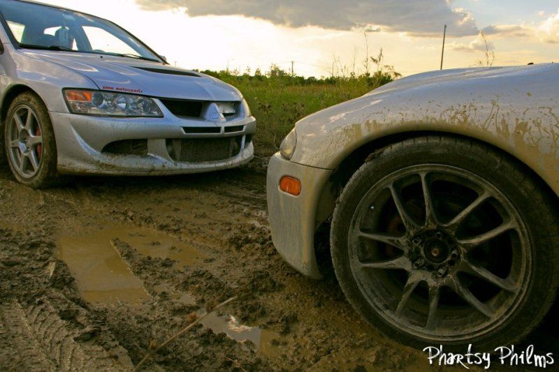

then i thought i could be a rally car
in conclusion, these are fantastic cars when done right. i spent money and did not cheap out on it one bit. i beat the shit out of it at 28psi daily. not a single issue anymore. best daily driver i have ever had. its a shame how horrible most of them are, halfassed home depo parking lot builds. worse than 240 owners.

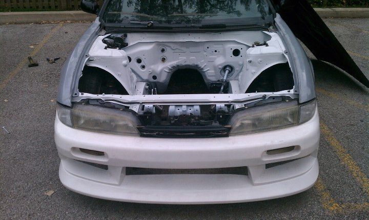

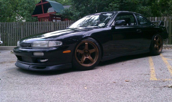

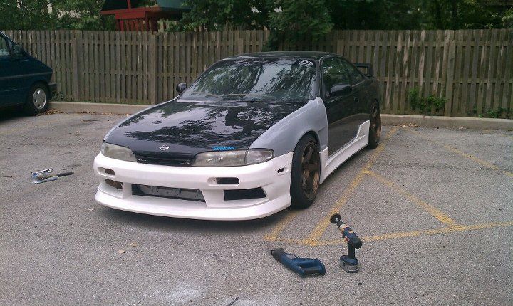

and for 240 love here is my Sr20 for my S14 that i put together :)
how it usto look
then this happened

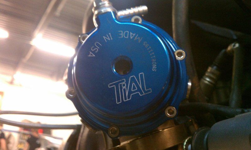

for sure! took me a good 3 or 4 hours with a pressure washer to get it cleanish again hahaha. too much fun tho. i just added a forge performance blow off valve, and put in a prosport peak warn gauge (hesitant, but so far so good). cant wait for the motor mounts and full tune!

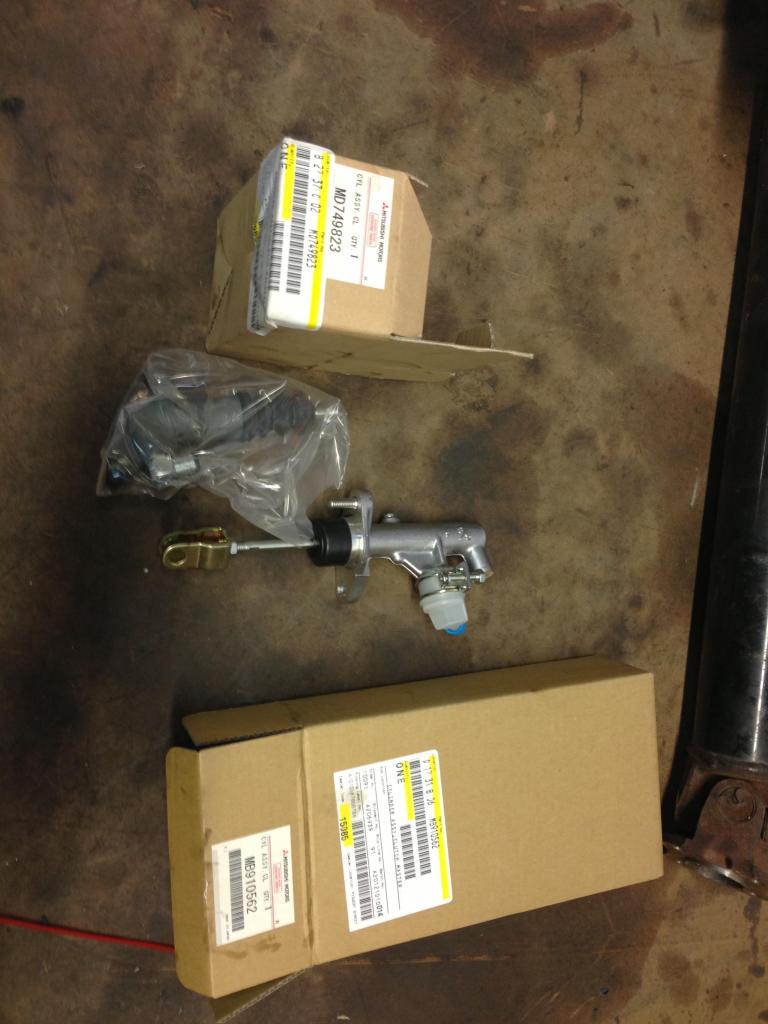

just a small update. my clutch pedal felt terrible so i bought OEM clutch master and slave cylinder. not messing around with that cheap parts store crap.

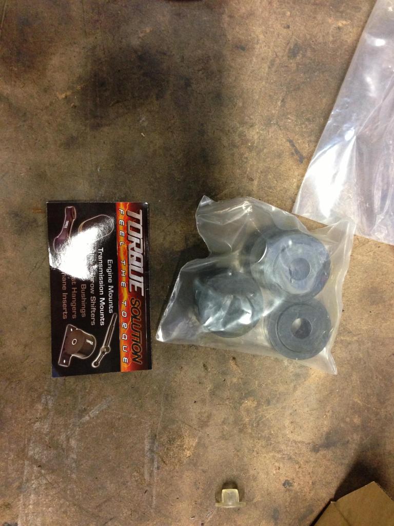

then i noticed my driveshaft mounts had A LOT of movement. so i tossed in some torque solution mounts we had at the shop.

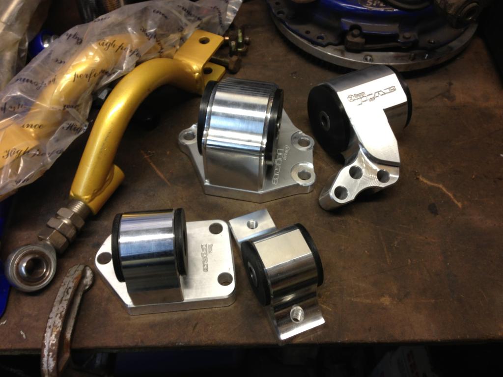

This update: Avid racing motor mounts. figured i would buy some nice ass mounts ass opposed to some cheap inserts. i love these things, vibrations really are not bad at all.

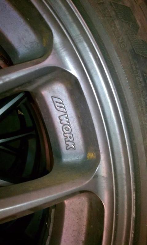

Over winter i am going to be powdercoating the Work wheels. Come spring will be bushings, coilover, swaybars. possibly paint it white. tint and shes DONE
