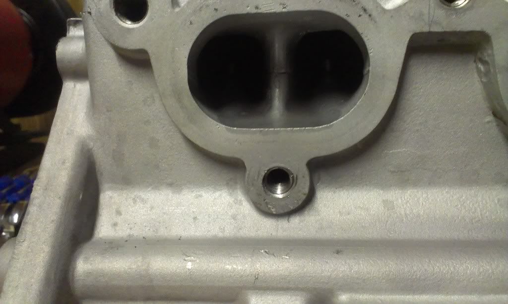

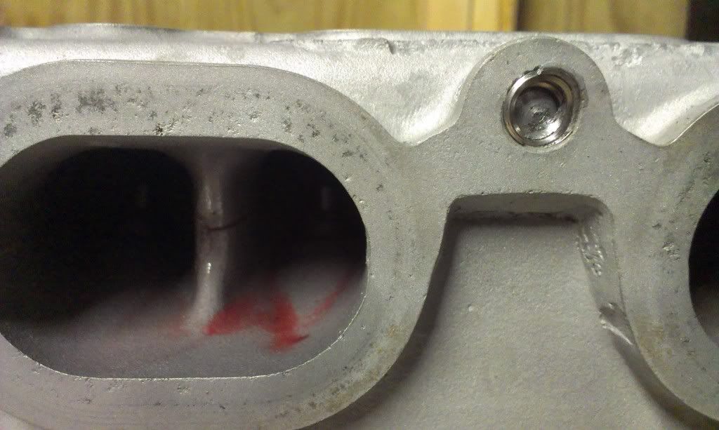

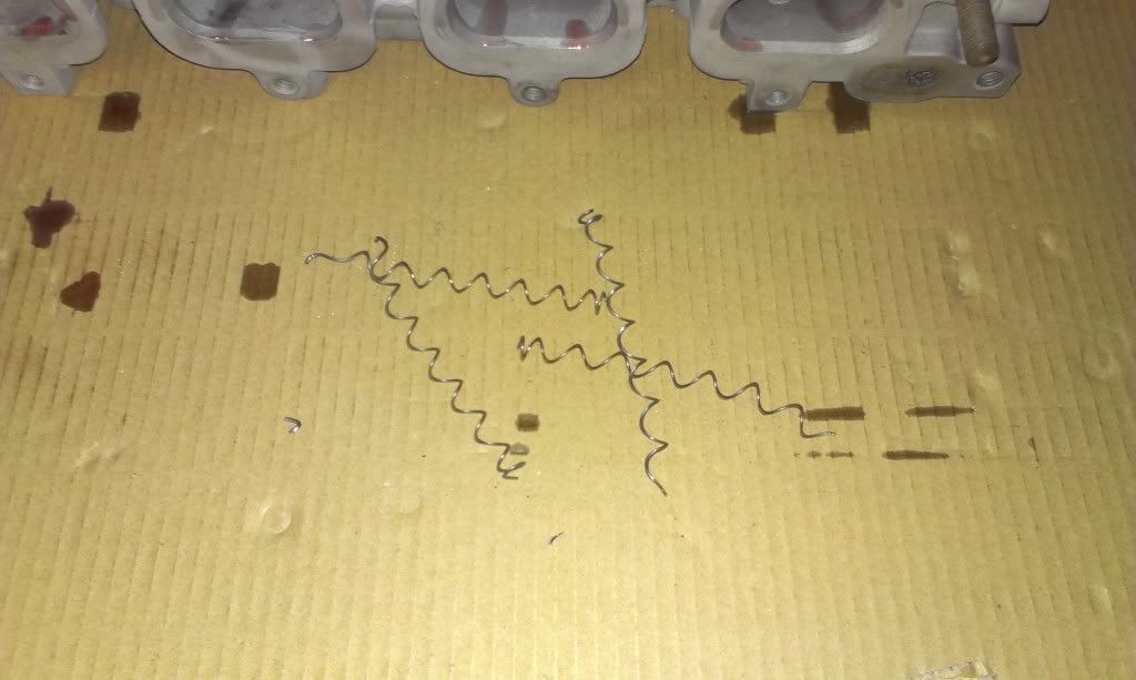

Well... Its been a bumpy road, haha. The p/o of the car had drilled (poorly), tapped (again poorly), and inserted heli-coils into every exhaust manifold stud hole.. I learned this the hard way when I was installing a new set of FP mani studs, and the new stud snapped. Took FOREVER to drill it out, and now I've got it that hole, along with all of the other holes tapped with a 10x1.25 due to the p/o being a straight up tard.
So after all that joy, I'm ready to lap the new stainless valves

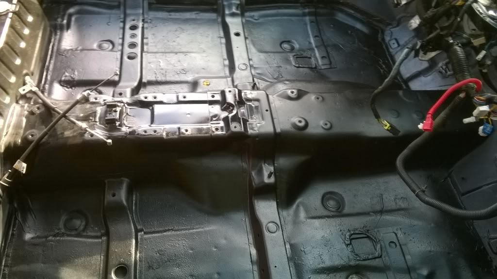

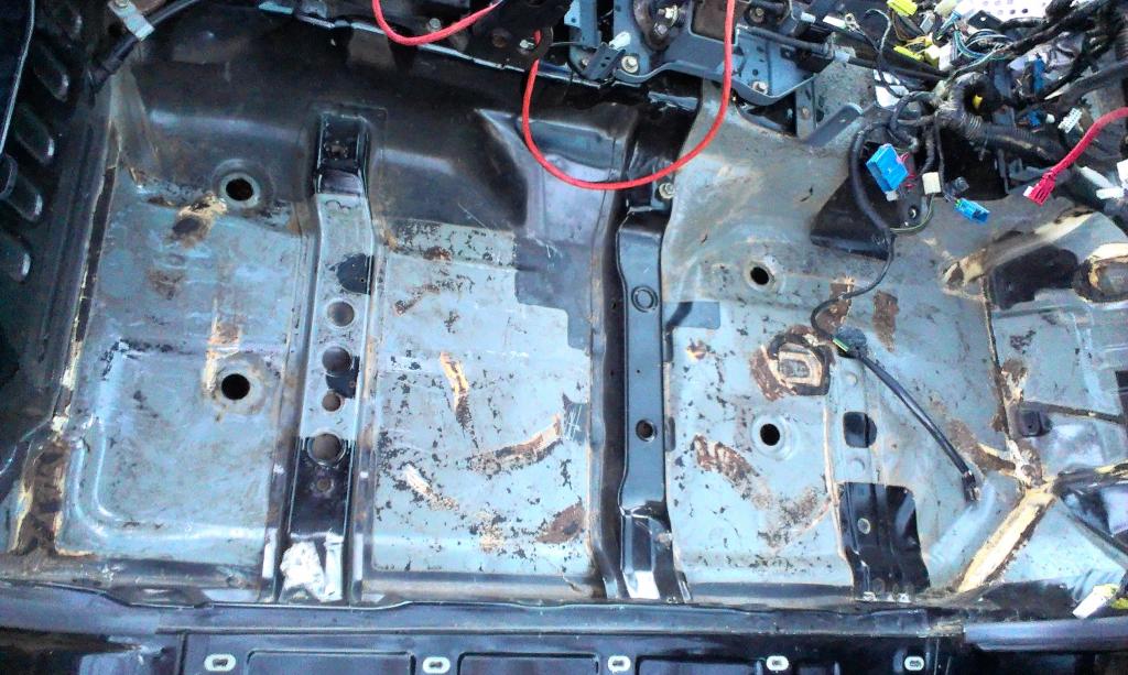

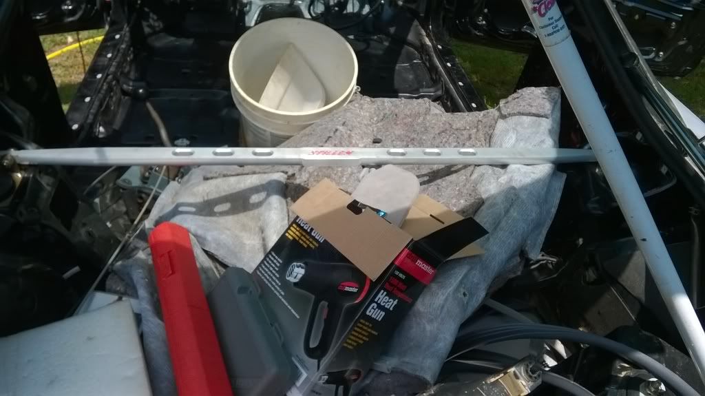

Well.... It's been a while since my last update. Not much has changed at all. I took FOREVER getting up all of the sound deadening material from the driver and passenger floor boards, but I finally finished it. After I got all of that out, I sanded, primed, then laid down two coats of Rust-Oleum truck bed liner. My idea with this is that it should provide some noise dampening effects, but it's nowhere near as heavy or as thick as the factory tar/shit that I removed.

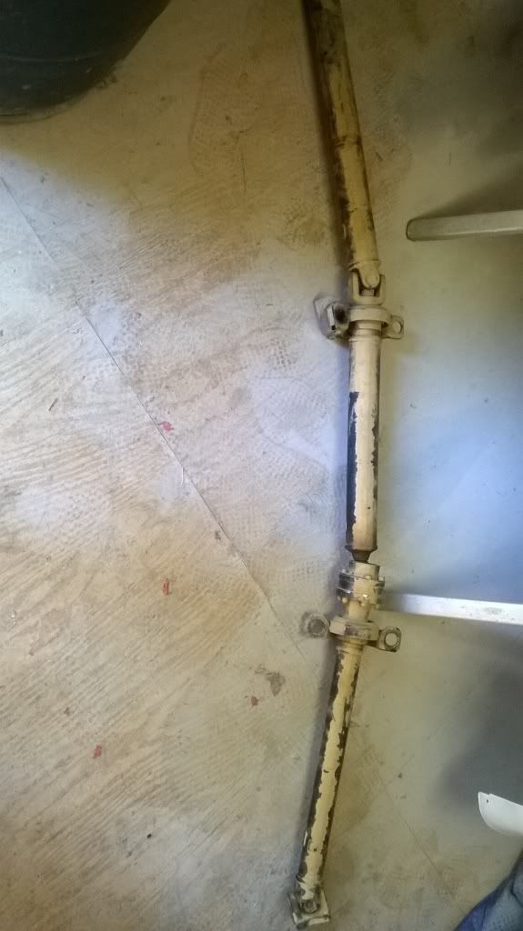

I managed to get the drive shaft unbolted and then got the rear strut tower brace bolted on today. I purchased one of the OEM Drive Shaft Yoke Repair Kits back in February, and hopefully will get that put on here soon. After I clean up the drive shaft of course, haha. After I get that back from the machine shop, I'll get that assembled then move on to the block! The current plan is to have the car moving under it's own power before the end of summer. I've decided that if I can't at least drive the car once or twice before the end of the year, I'm going to get rid of it. So I had better get my ass in gear.
