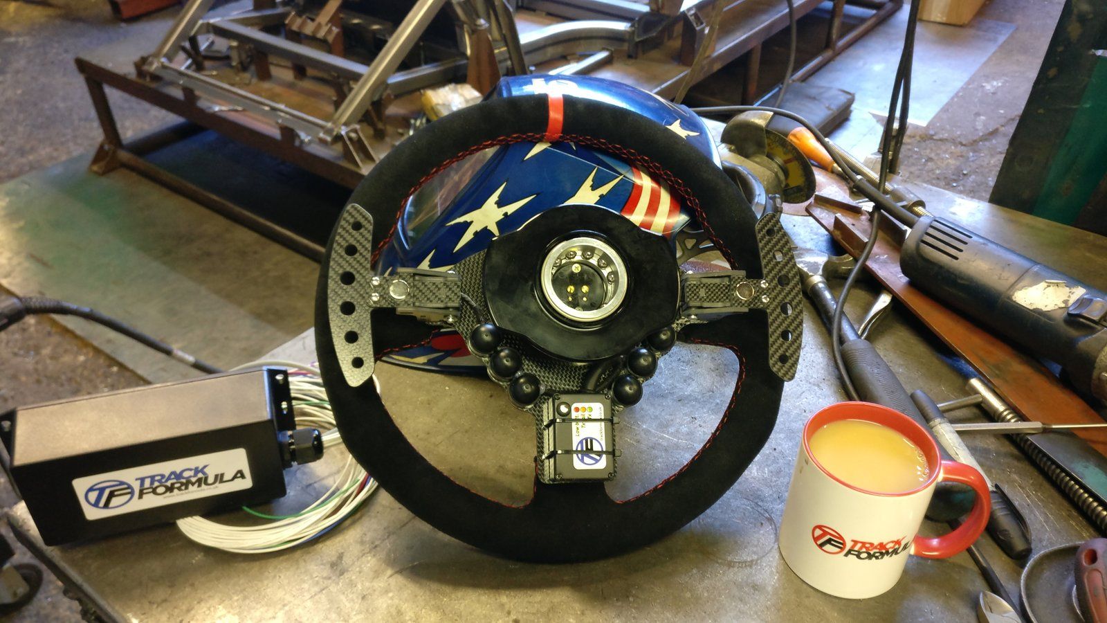

Sick.. I use the driven wheel also. And always thought I might go auto if I could get a paddle shifter. If you don't mind how much was that setup?
Also have you shared this with the "driven" company? They are always asking customer's to post up there installs. And from there site it looks like they have been focusing on the European market a lot lately. May turn into a sponsorship.

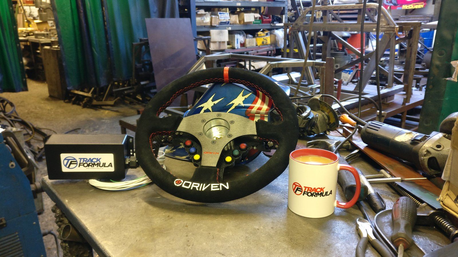

Anymore info on the wireless shifting system? What does it operate over, bluetooth?
Most of the reviews I've read on the wireless systems complained about there being too much lag for "race" use. How does this interface with the DSM TCU? Some kind of module playing middle man I assume?

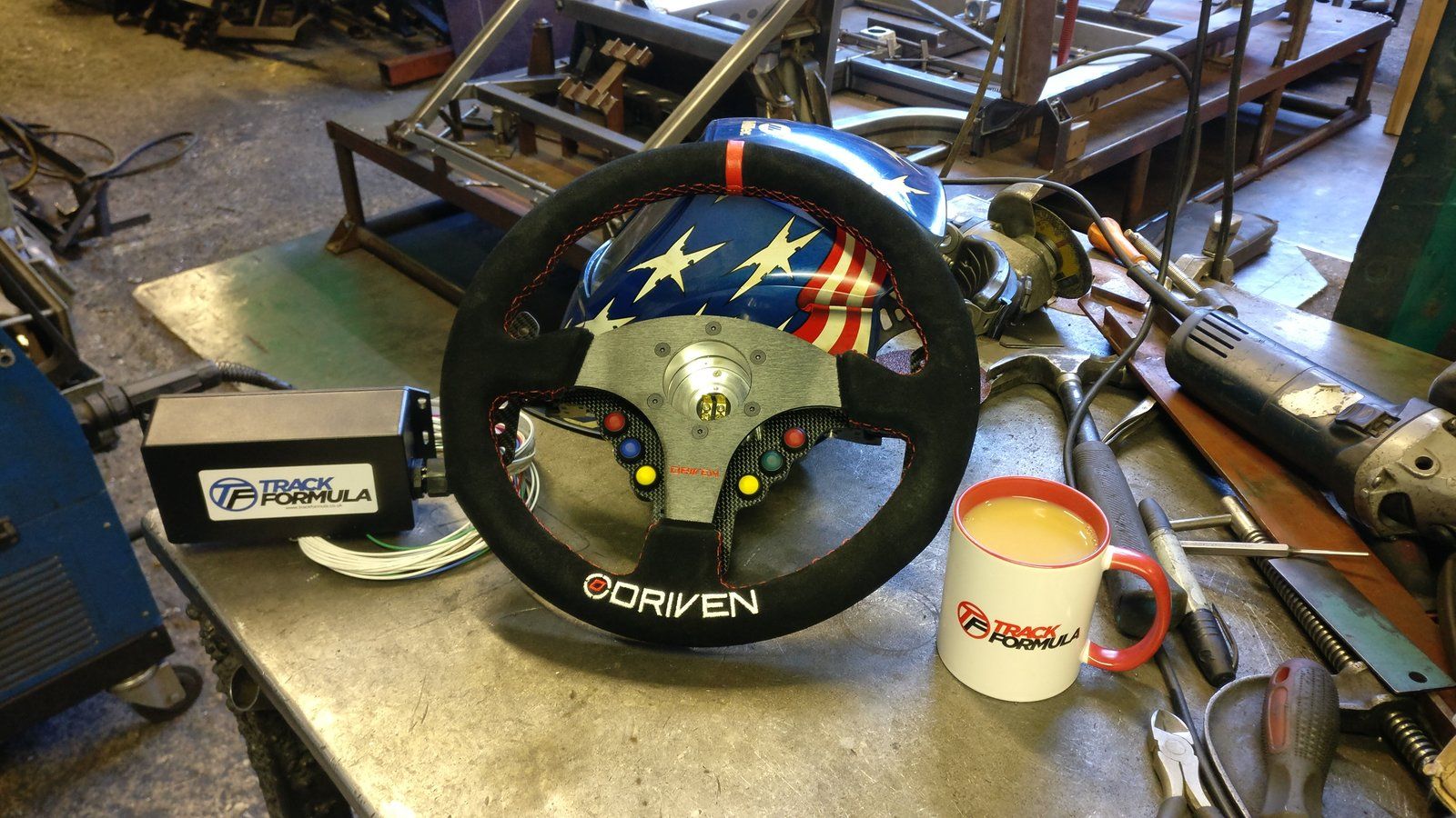

I was recommended to get the steering wheel and I wanted something different and never seen a driven wheel in the UK with my own eyes yet so figured why the hell not! It's a very nice wheel,
I've not send any pictures yet to them as I want it complete before I do, but I will be sure to message them with picture updates if they so wish to show the setup off,
That master cylinder is baller :thumb:
That master cylinder I'm assuming is the duel setup I'm assuming? That's now gone back and I'm betting billet pedals instead hehe
I have the road surge shiftbox and that will be linked into the electronics for the paddle shifter system, so road surge in with the TCU then the wires from shifter module to the shiftbox, so no different then using the road surge buttons
I'm not knowing everything about how the shifters work but it's been said to not be laggy at all, it runs on its own Frequency HZ range so it's dedicated to its own children so no interference, you may have to message David the owner https://m.facebook.com/profile.php?id=147404165676183&tsid=0.8050282072741501&source=typeahead
He can answer your questions alot better then I can at the moment.

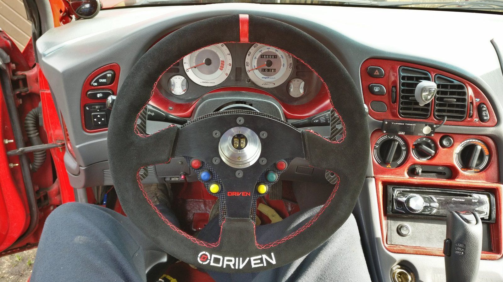

I got my steering wheel back!!! This thing is so amazing!!!
So clean!

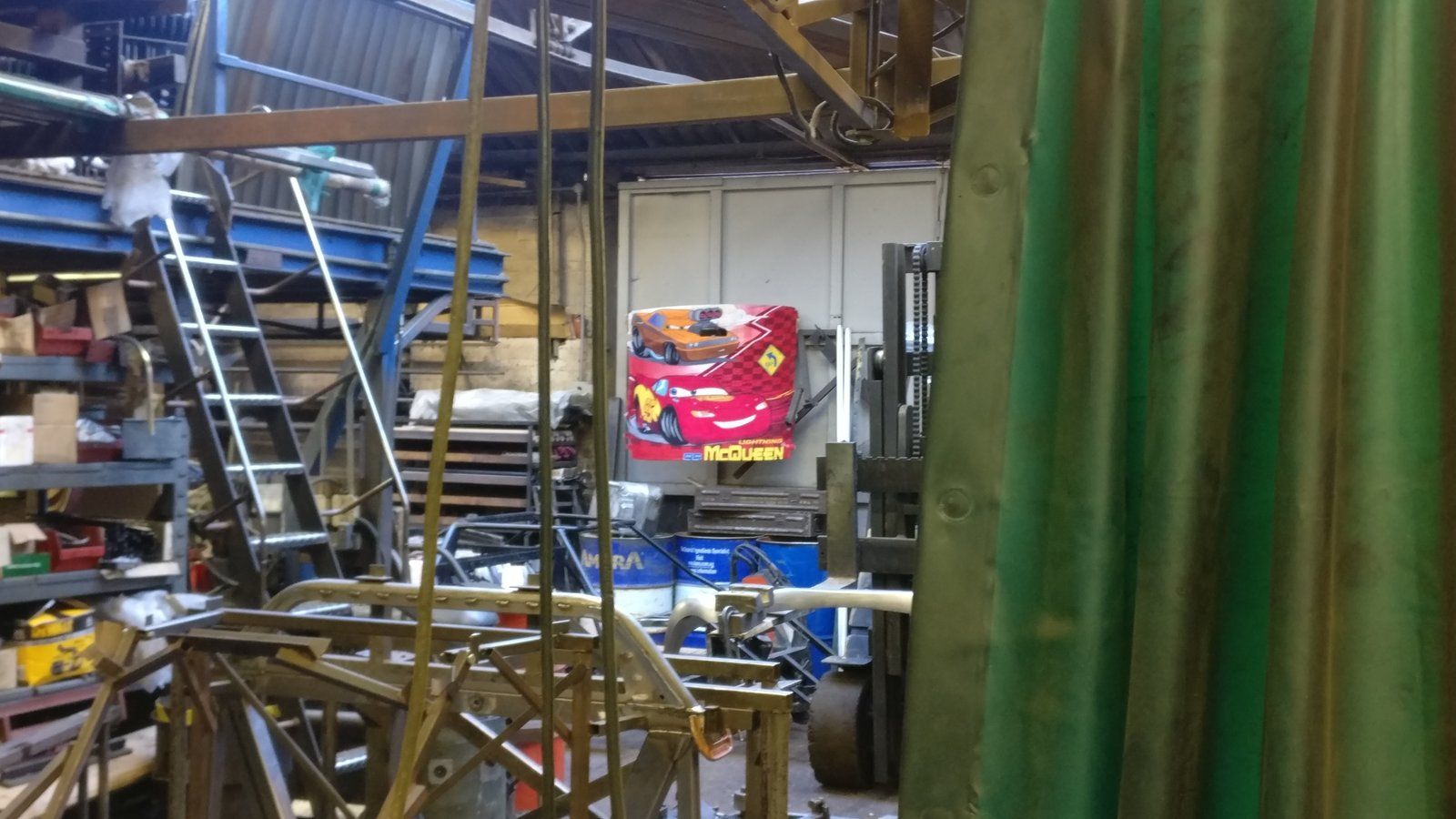

I like the bit of lightning mcqueen poster ya got there. Lol
Haha that actually came from my spare 2G chassis, it's the roof lining

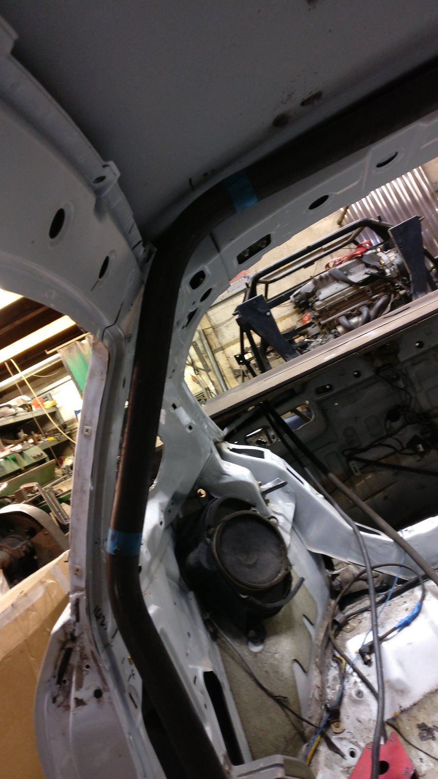

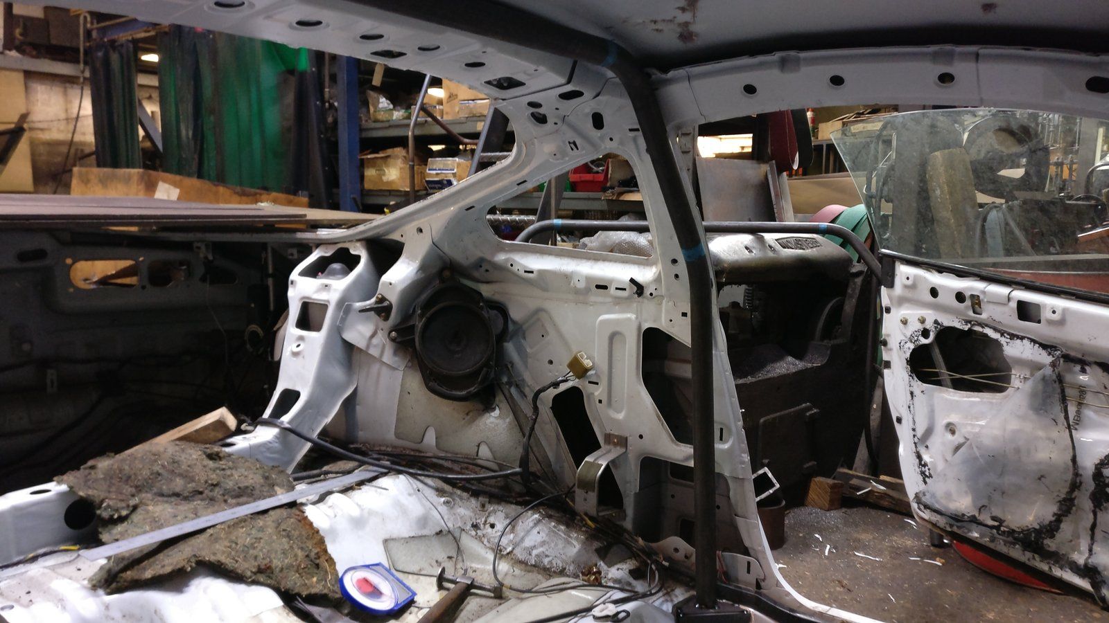

I recently mocked up my roll cage but I have to re do it since I made it to the old regs which is 38mm OD tube, FIA regulations state it has to be minimum of 45mm OD! So next weekend I'm having a shop bend it all for me since my work bender won't so 45mm tube, they are going to do the bends only and I'm welding it in and making the rest from there.

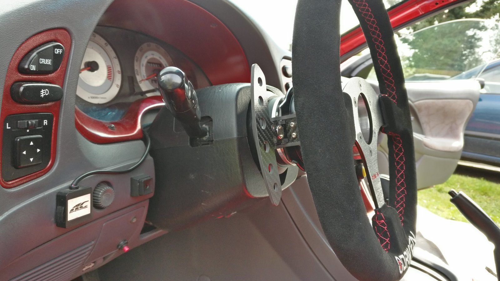

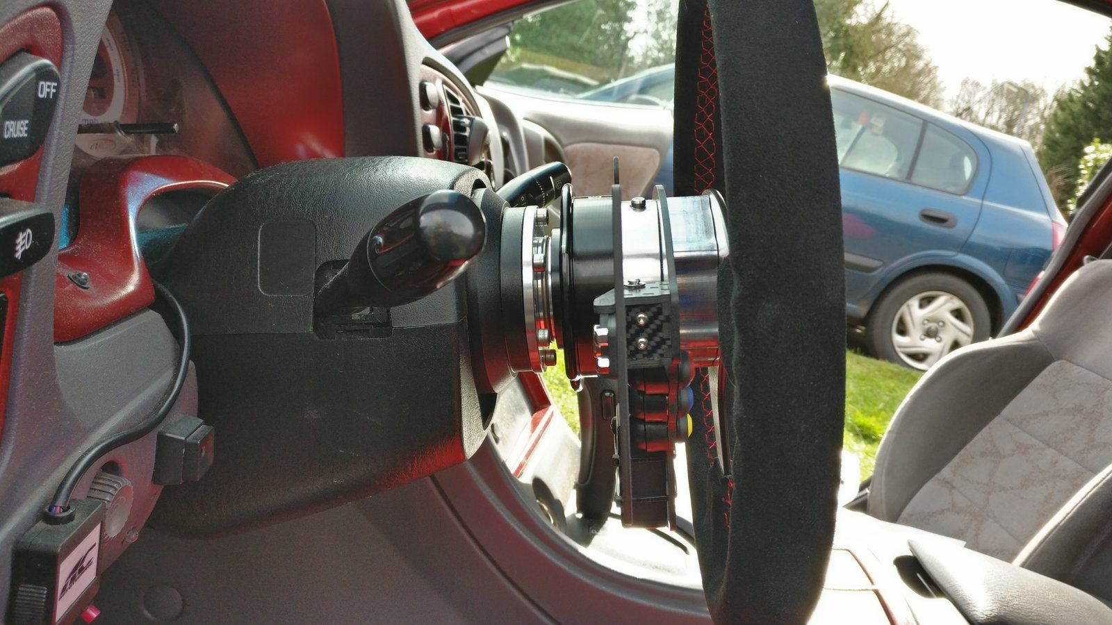

Because of that I also started to take my dash out ready for it as it will be going through the dash so I put my new steering wheel on first to see how it looks in place, it's not wired up yet but it also makes room since the wheel detaches,

I see that black crap on your door plastic vapor barrier and it makes we cringe thinking about it being all over my hands a clothes. I hate that stuff.
Haha that's just my spare chassis, I've not got around to removing it from this one yet,
My red one will have this taken off soon when I make my door covers, but I know what you means, when we did my friends race car it was nasty stuff indeed. We used panel wipe and other solvents

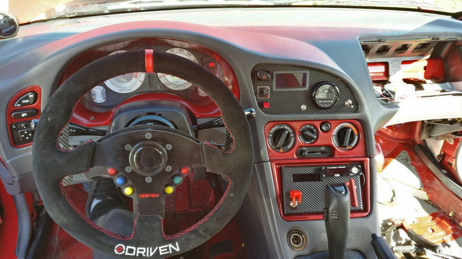

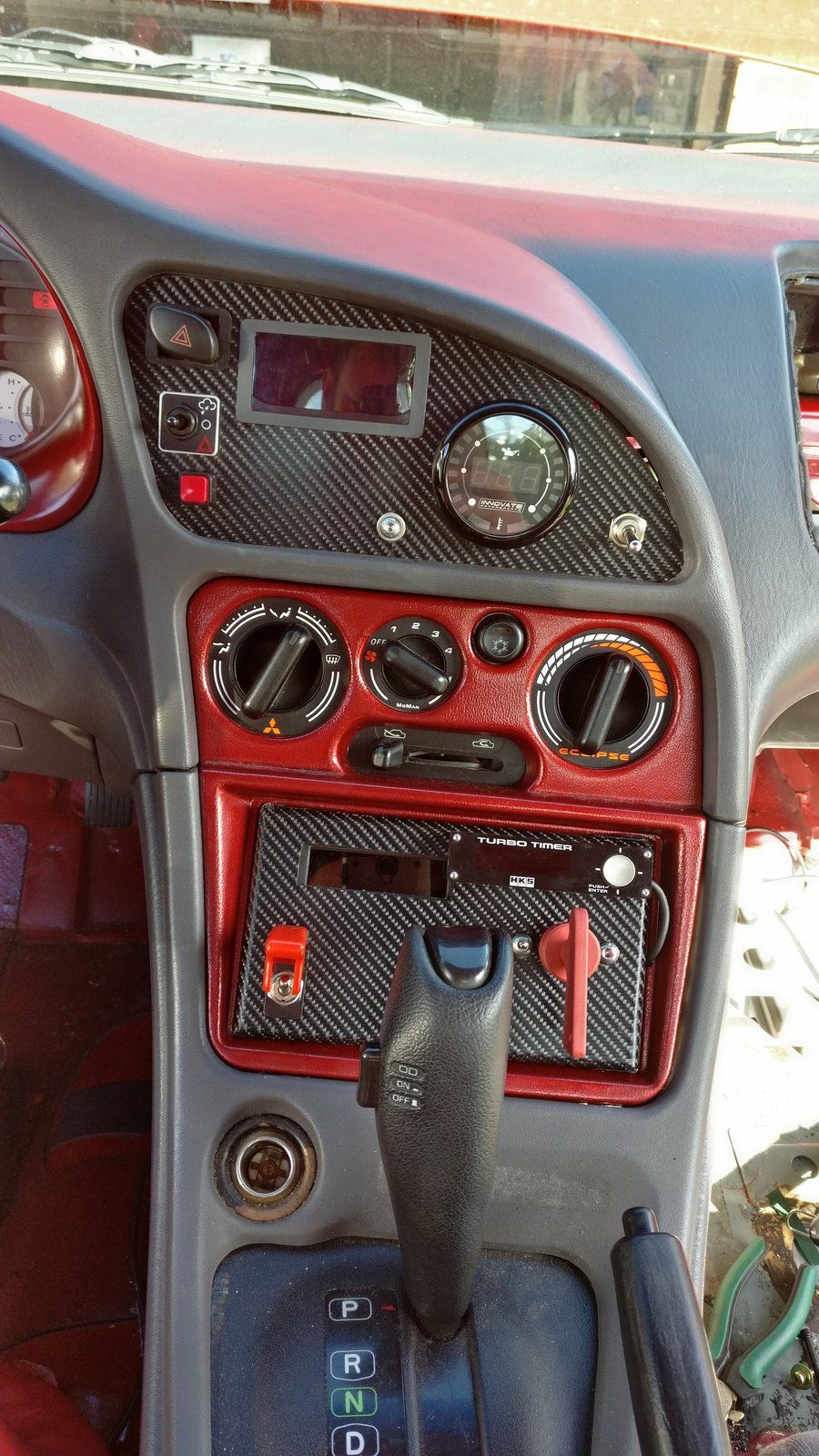

Got some items made and installed today, startd the wiring and i hate wiring so much! But im gettng on with it,
I made 3 panels but only 2 installed today, not as god as some others ive seen made on here but it does the job LOL. Lower housing is full FIA kill switch, and my trans shiftbox display, the cover is over a toggle switch for the rear rainlight to be able to allow me to use it on our rosds for plain fog use, basically to stop its soecial flashing it does for time attack.
The upper panel is the time attack light switch for wet and normal modes, transmission temp and oil temp and pressure, my hazards, horn and rear wiper are the others also on this panel.
Wow. Looks fantastic.
Thanks, its only basic but took me a while to cut all the holes and file the corners on the squares. It does what i need it to so im happy and no more hug gaps from a missing radio

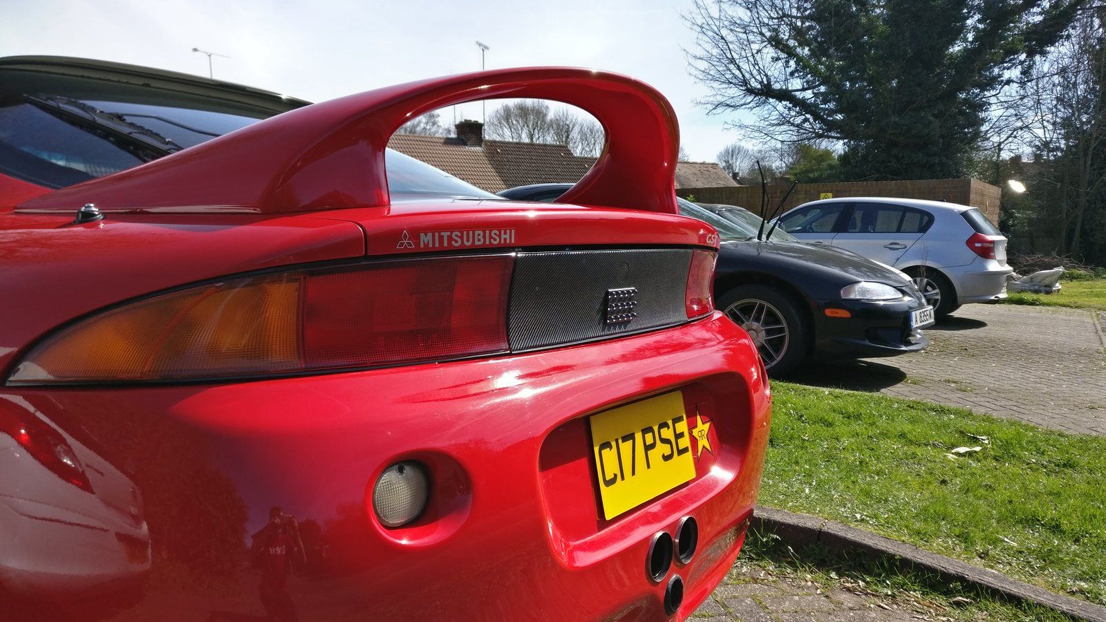

I put the rear time attack light on and it looks pretty good, my friend popped over to wash cars today, he has a canadian spec talon, he is at uni here for motorsport engineering just down the road from me,
