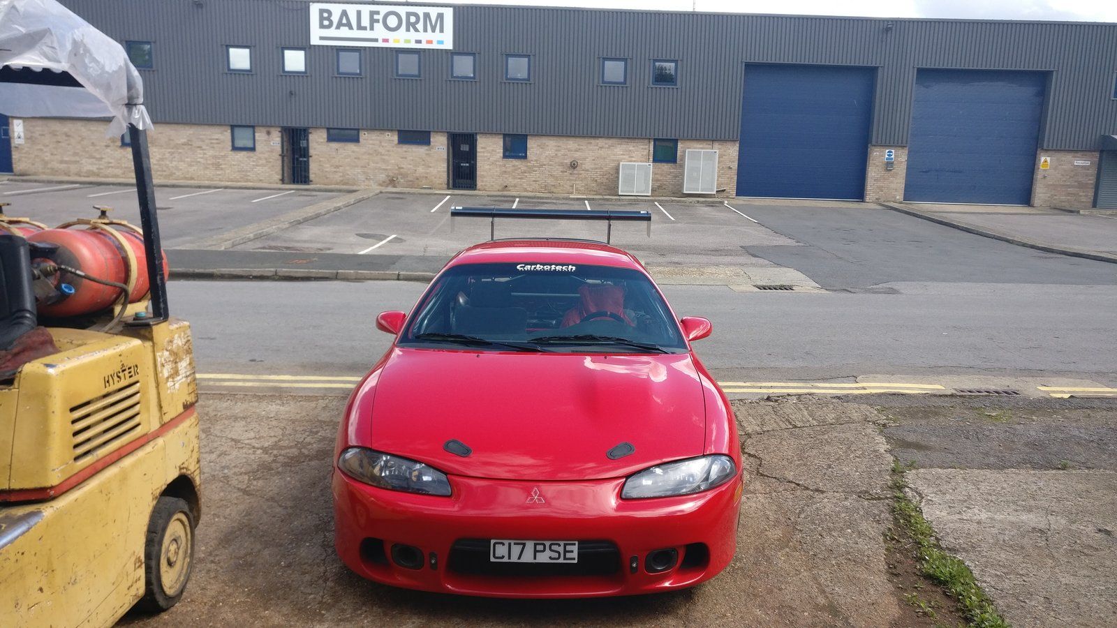

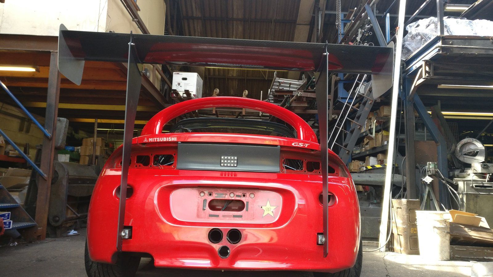

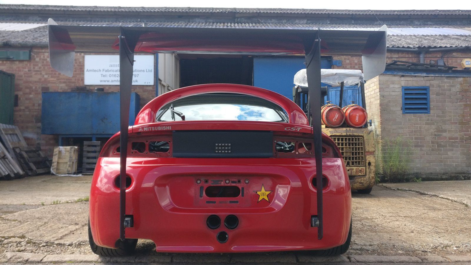

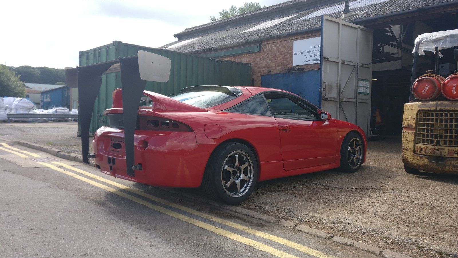

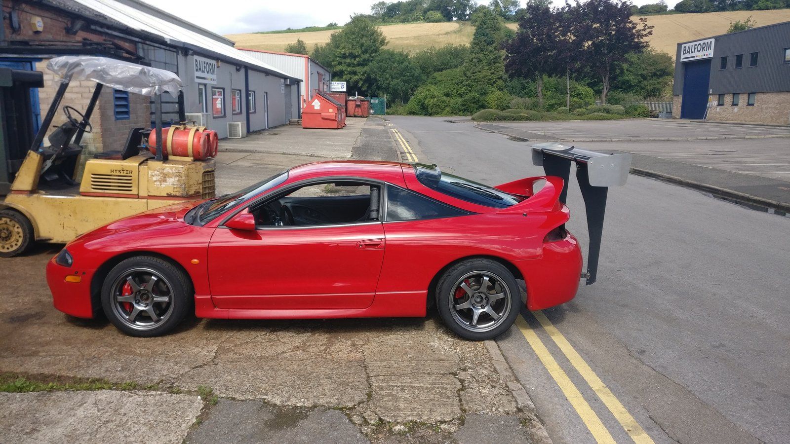

Well here it is folks! The aerofoil mounts and brackets are complete!

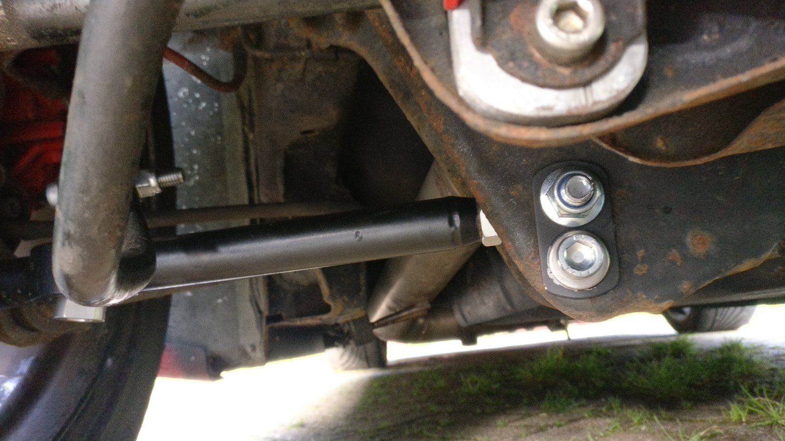

I still need to finish off the supports to stop it flexing side to side and am looking in to some stainless wire setup that some other time attach guys have told me about so that will help keep it strong,
While it looks beefy and it kinda is by design i can always trim it up near the top area but i just wanted it as strong as possible so it may be well over engineered. So as ugly as the mounts seem its there to do a job, as i progress i can play around and get some pointers on holes and making it look a tad neater and better flowing down the line
The lower mounts bolt in to the chassis rails with 4 m12 bolts so thats plenty for its job in hand! Overall i am very happy with how its turned out and will look forward to testing it out in the next month or 2.

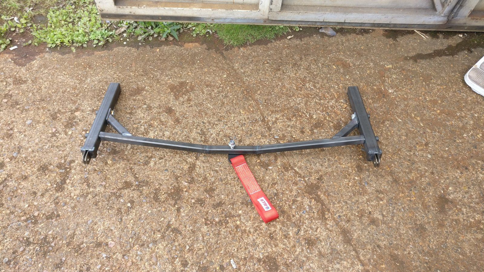

I also made my a rear tow hook as i require one front and rear for passing tech inspection, simple thick box section and support to stop it twisting when/if used, sits below my exhaust exit and can suport that and my diffuser when i design it
What are the small things next to your fog lights?
At the front? They are my side lights, we require side lights in the UK and i wanted these then in the headlight housing
The small black things next to where the stock fog lights go in this picture.
Yeah they are my white side lights, similer to side markers and i still have them in amber but our laws say you must have white or similer color front side lights! Why i dont know since they are not on all the time like DRL's

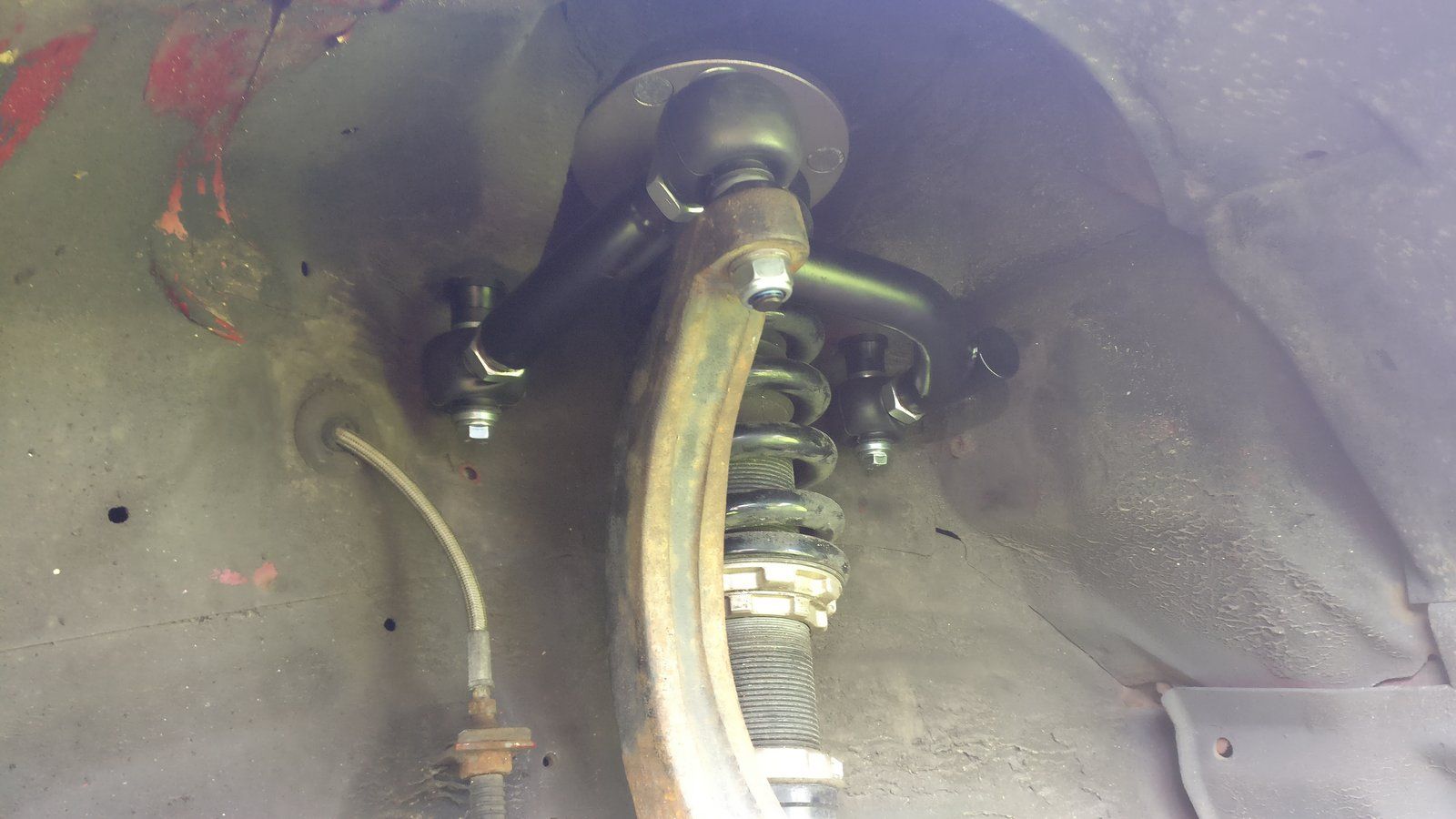

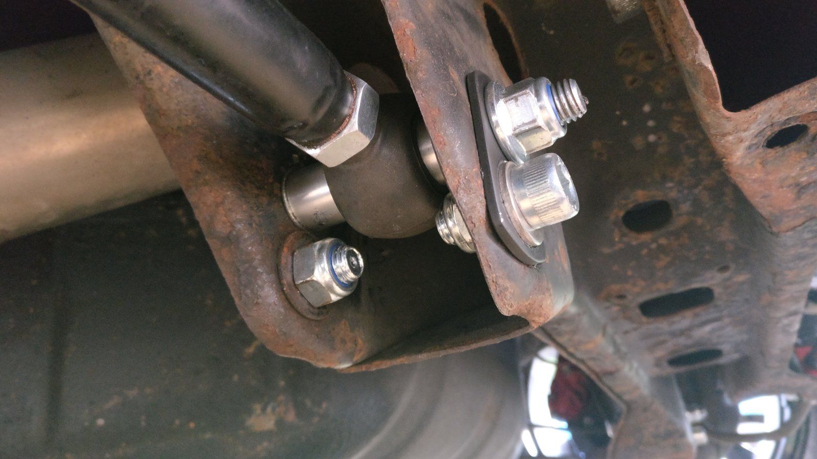

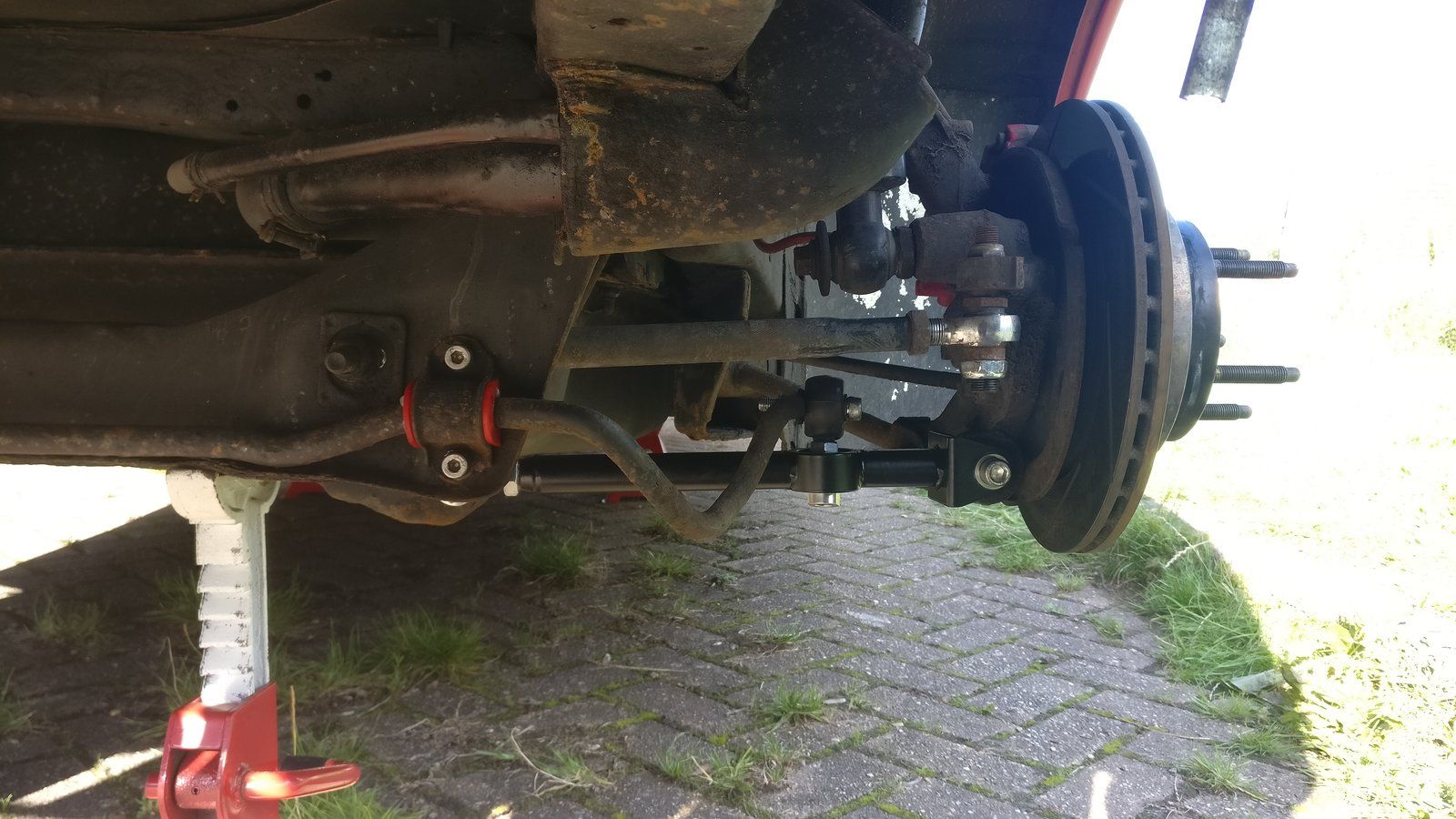

What i have added today are front uppers and rear lowers!
Rear lower were ment to have RC adjustment aswel but found out there is a washer spot welded in the inside of the subframe so i have out that on hold till i find a way to do it, i am thinking of thin washers inbetween the rodend standoffs and the 3mm plates outside will also strengthen the frame so it might still be possible, it may help with the uppers tame full advantage a bit more!
The front uppers i have set to as close as i can today and will finish tomorrow and final adjustment and alighnment and bumpsteer re adjust and see how the test drive goes,
I set it up for 2* rear camber and 2.5* front with front caster being 6.6* now. RC and anti dive are all set to oem for now to keep it more simple!

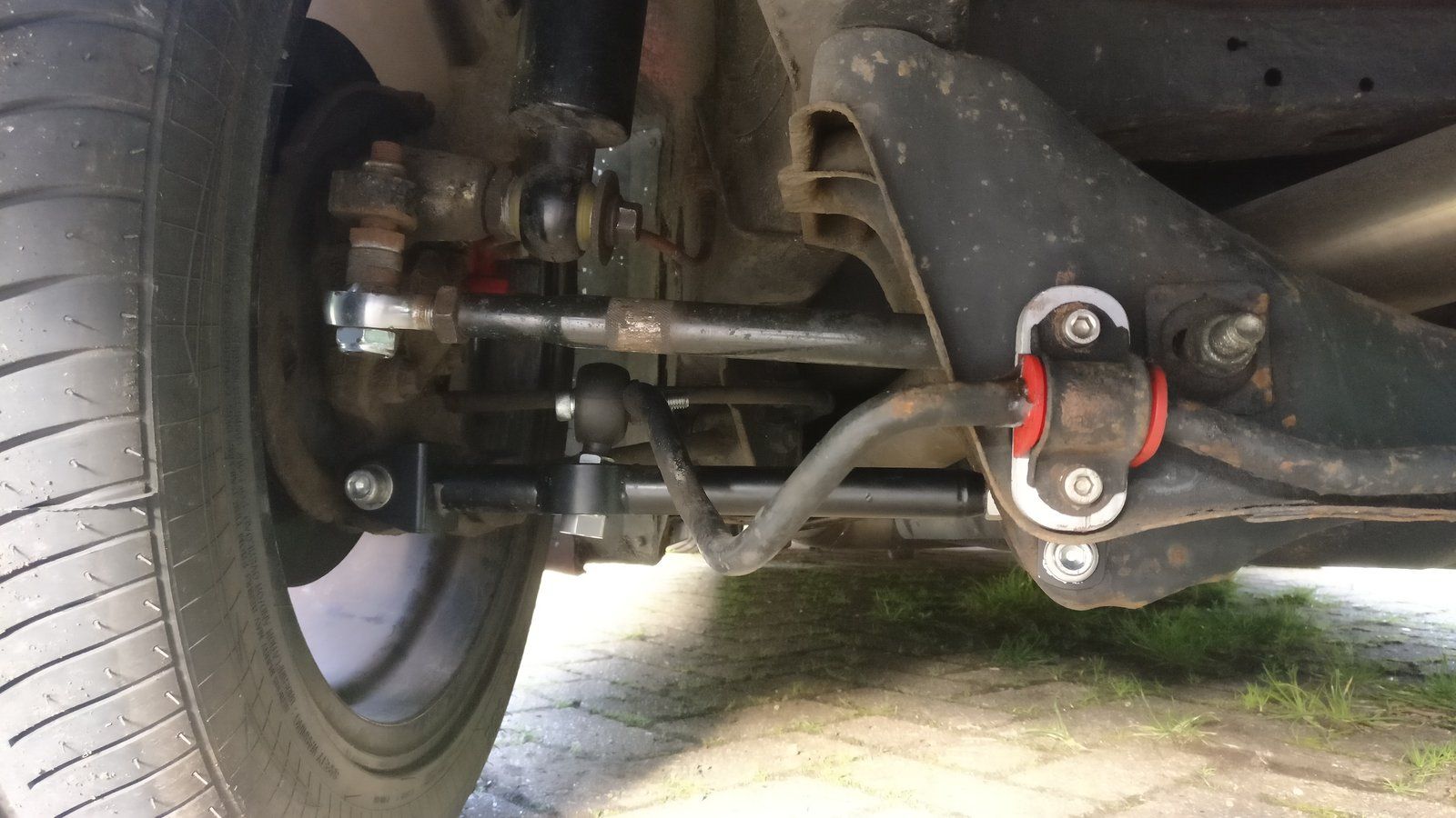

On another note i considered using my front BS kit to give me toe in/out under braking and cornering but j decided to just keep it as simple for now! By my figures are below,
Thin spacer below the rod end gave me.
Compression 5 thou / 0.12 mm / 0*1' of toe in
Decompression 23 thou / 0.58 mm / 0*4' of toe in.
Thick spacer beloe the rod end gave me.
Compression 48 thou / 1.21 mm / 0*10' of toe out
Decompression 22 thou / 0.55 mm / 0*4' of toe in.
So if i used the thick spacer it would be good for cornering and braking but i dont k ow its effect in straight line driving over bumps! So for that reason i kept it simple and kept the thin washer below and opted for the toe in under braking and cornering since toe in makes the front end turn a bit faster since the loaded tire in a corner is ready pointing into the corner and not having to go past zero to point but its often known toe out is faster cornering but its not, so because of this knowledge i have come to find out toe in for me it is!

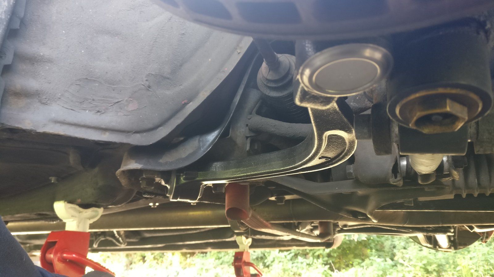

Another day and other modification!
This time i modified my rear subframe, the reason is to allow mh rear lower arms to be moved up 1" on the inner mounting side, currently i was pointing down towards the center of the car, this made my rear RC way below ground, now i have adjusted it up im at a slight angle towards the outside of the car now,
This has made the car alot different! Its so sharp now kinda like before but this seems different! Its so responsive, the rear if very quick to react and i seem to have made the rear as fast as the front which is good, before it was slower and lagging but im happy its reacting fast.
I am currently holding the bracket in with lower bolts aswel as i have not yet welded the bracket but its not going anywhere as it locates it perfectly,

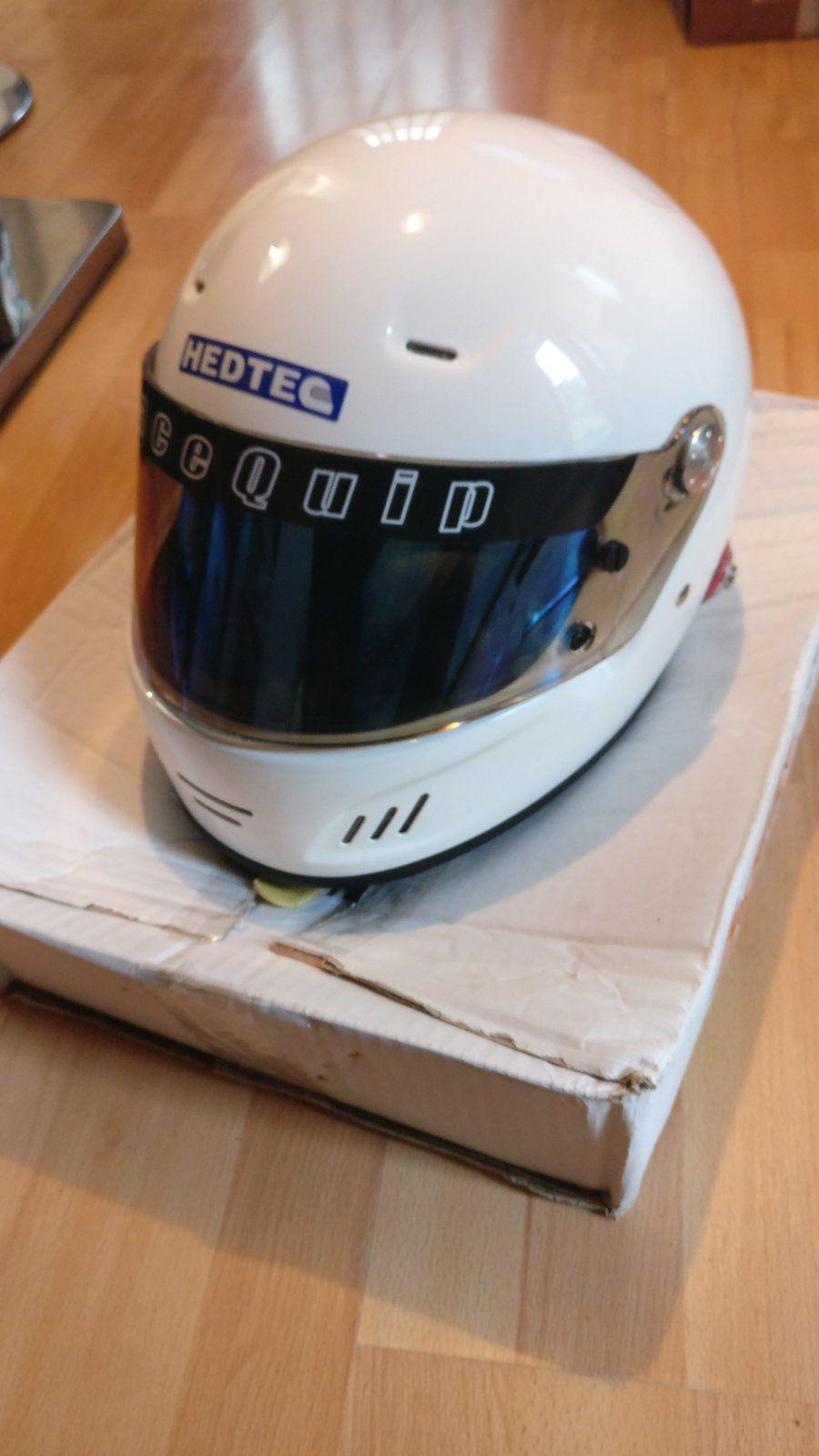

My new light blue Iridium visor came in which looks awesome! I may get the dark blue Iridium if i feel the need for a darker shade!

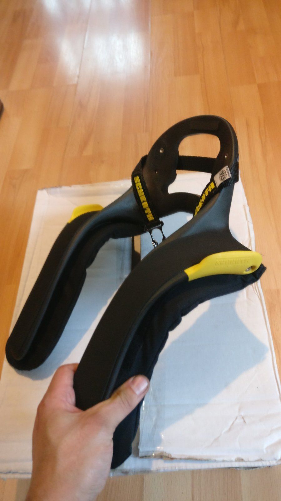

Also my new Hans by Schroth arrived too! Since we have to use these now in all forms of motorsport here. Without it you cannot take part!
Next is my race suit to be ordered and the rest of the kit Gloves, Shoes, undersuit! Then thats the safety side of things done and ready which i will order that all this month no doubt as it take a few weeks for my modification to be done anyway.
