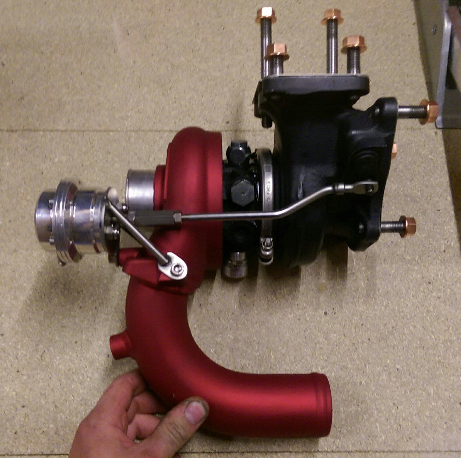

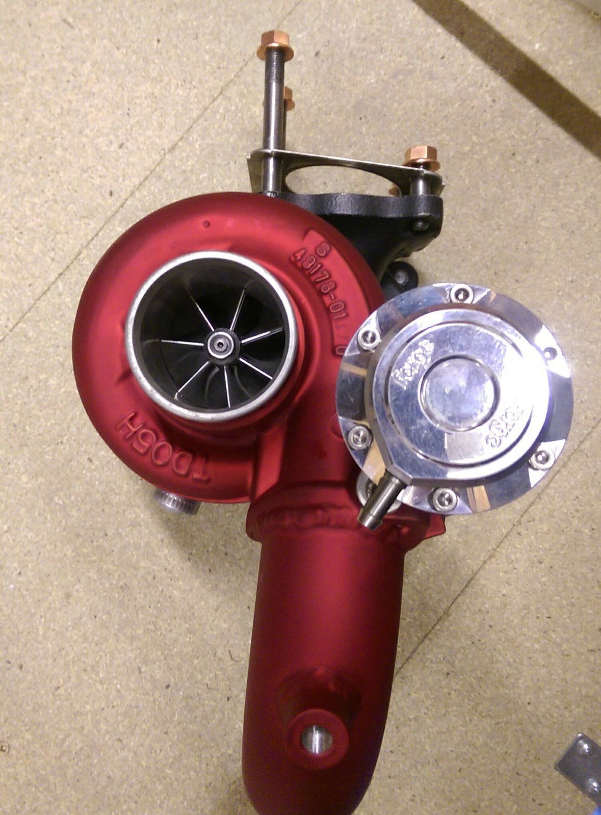

I also managed to put my turbo back together tonight. Just need to buy a new retaining clip for the wastegate arm but other then that its done and another thing off my list to finish!
Just incase anyone wants info from it, its has
9 blade turbine wheel
Kts billet 7x7 high blade extended tip compressor wheel
Upgraded bearings and thrust washer
clocked down
And finally it has a forge actuator with 20psi spring
If it helps either of you, -3 front (to make my Hoosier A6 tires happy) and -1.5 rear feels like the best balance so far over the years.
Thanks, John.
I'm not exactly sure on how much camber to run up front. My roll resistance is pretty good, although I want more. If I can get between -2.5 and -3, I'll be happy.
Turbo is looking gorgeous, Bobby. Same turbo/wheel I want to use for road racing with the stock block/trans.
They said the 7x7 is a great wheel with the added benifits of better torque lower down and it does not effect top end power! So i said i would try it out
What did you coat the hotside of your turbo with? It looks like you media blasted on page 2.
I did blast it, i used a ceramic base primer and a ceramic black overcoat then baked it on. Its ment to withstand alot of abuse and very high temps

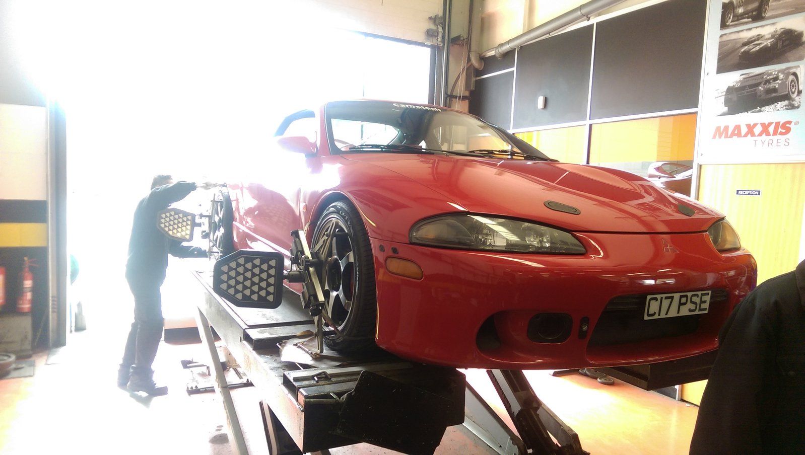

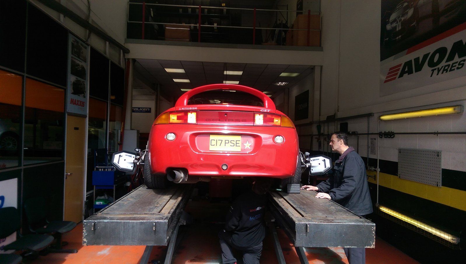

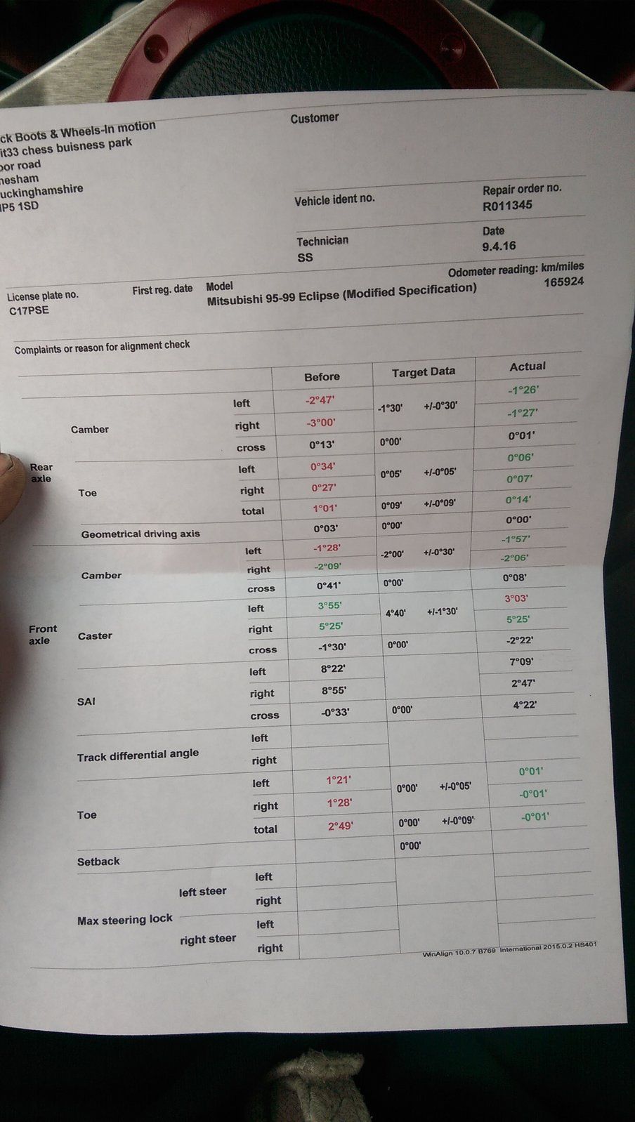

Got tracking all done today! Much much nicer now, it was a pain to drive their but i took it slow and on the way back i had some fun to see how the new setup works and the arms and coilovers feel.
I ended up getting 2* up front and 1.5* rear. I could have got 2.5* up front but i got so much else to do i did not want it to be over and plus i wanted to see how this felt first.
From the install of the arms and tracking they showed up as pretty close to being bang on 2* up front. Much more would have created more caster issues and it kinda already did. The oem compression arms bushing is the same and ive not had a chance to flip it around to counteract the caster, its om though as it still feels good.
Hey Bobby, Why is your Front, Left vs. Right caster so different?
Because the compression arm inner bush! Its still oem setup and i never got around to flipping it so thats why its low caster up front drivers side. I will flip the bush to make it better caster from L/R
Thanks, after some research now I understand the problem was/is and how to fix it!

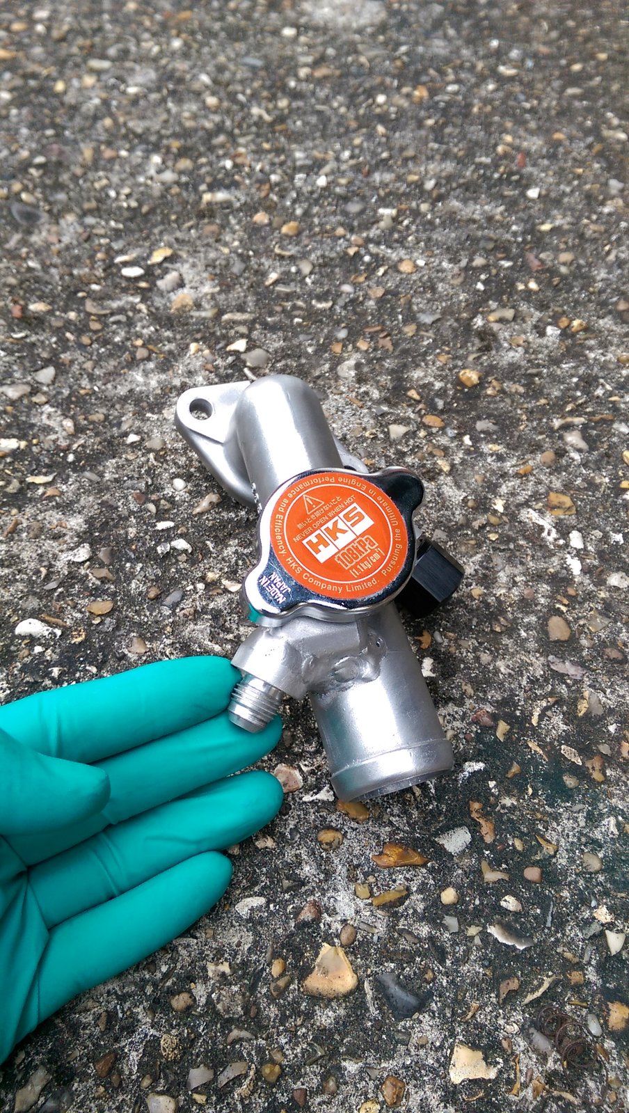

The upper thermostat housing has now had AN fittings welded on for my overflow, 6AN for the over flow and i welded a 8AN on the otherside just incase i need a swirl pot installed but i dont know much on them and placement so it was easier to weld it on anyway,

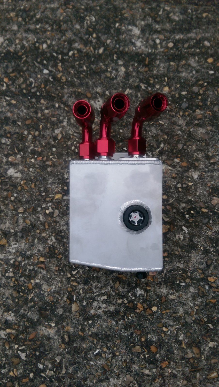

My VS3 catch can is here and ive got all my fittings and hose in now,

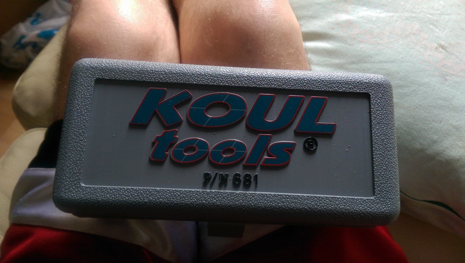

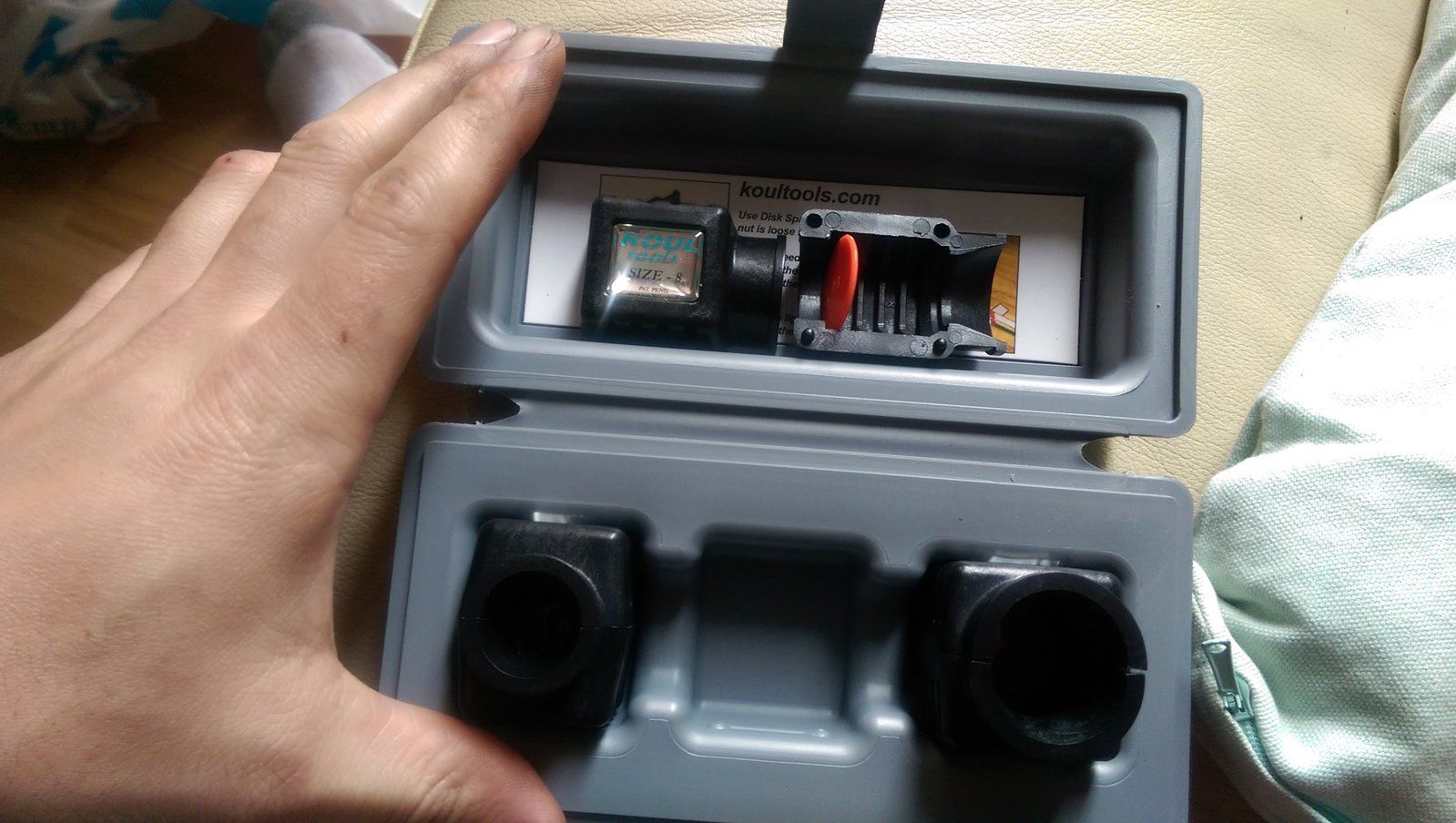

Also got a koul tool kit for fitting AN fittings and making it a breeze,

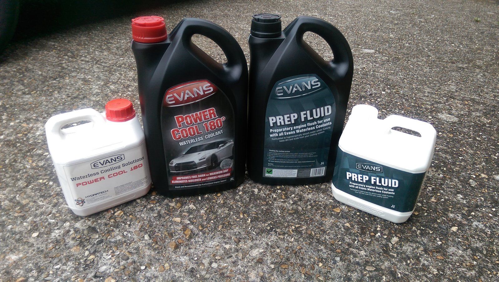

Also thought i would share a pic of my coolant i will be running. Its waterless and has better cooling effency then water plus as this is no water its no pressure from vapor so less pressures on pumps, gaskets and rad pipes, its nice stuff plus its lifetime and can be reused for years.so in the long run it can save you money.

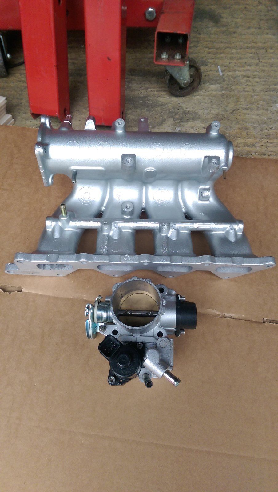

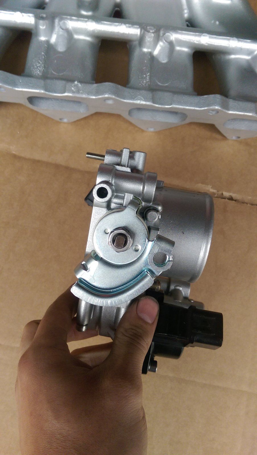

The throttle body and Intake manifold have both been fully rebuilt with new zinc plated parts and caps and sprayed and its an EVO 2 IM and TB so bigger and better.

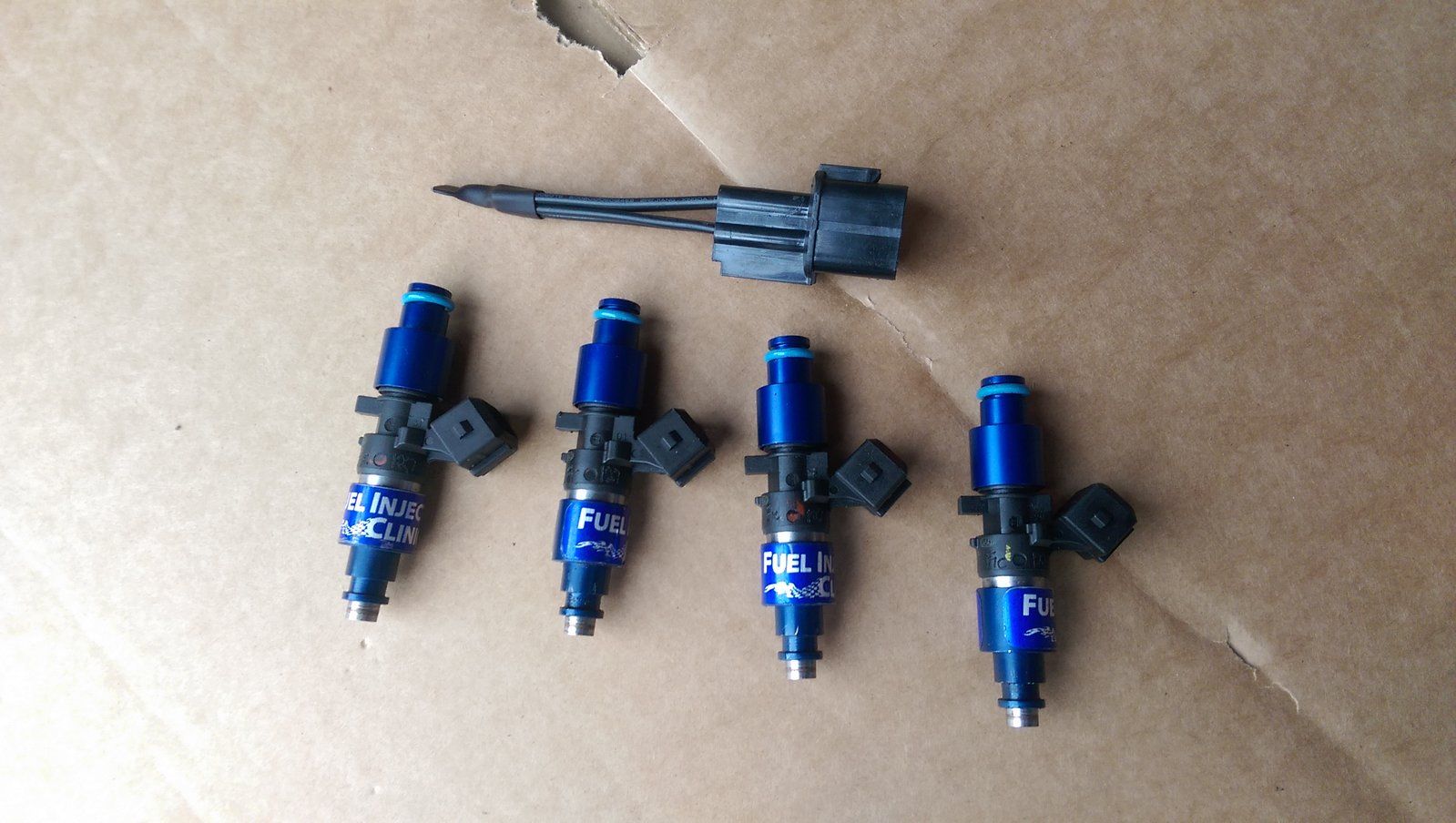

Fic 1100 high Z injectors with plug. These allow me to grow to the 550HP i want in the future so i planned ahead and the 1100's have bee given a great review for great idle and fueling needs.

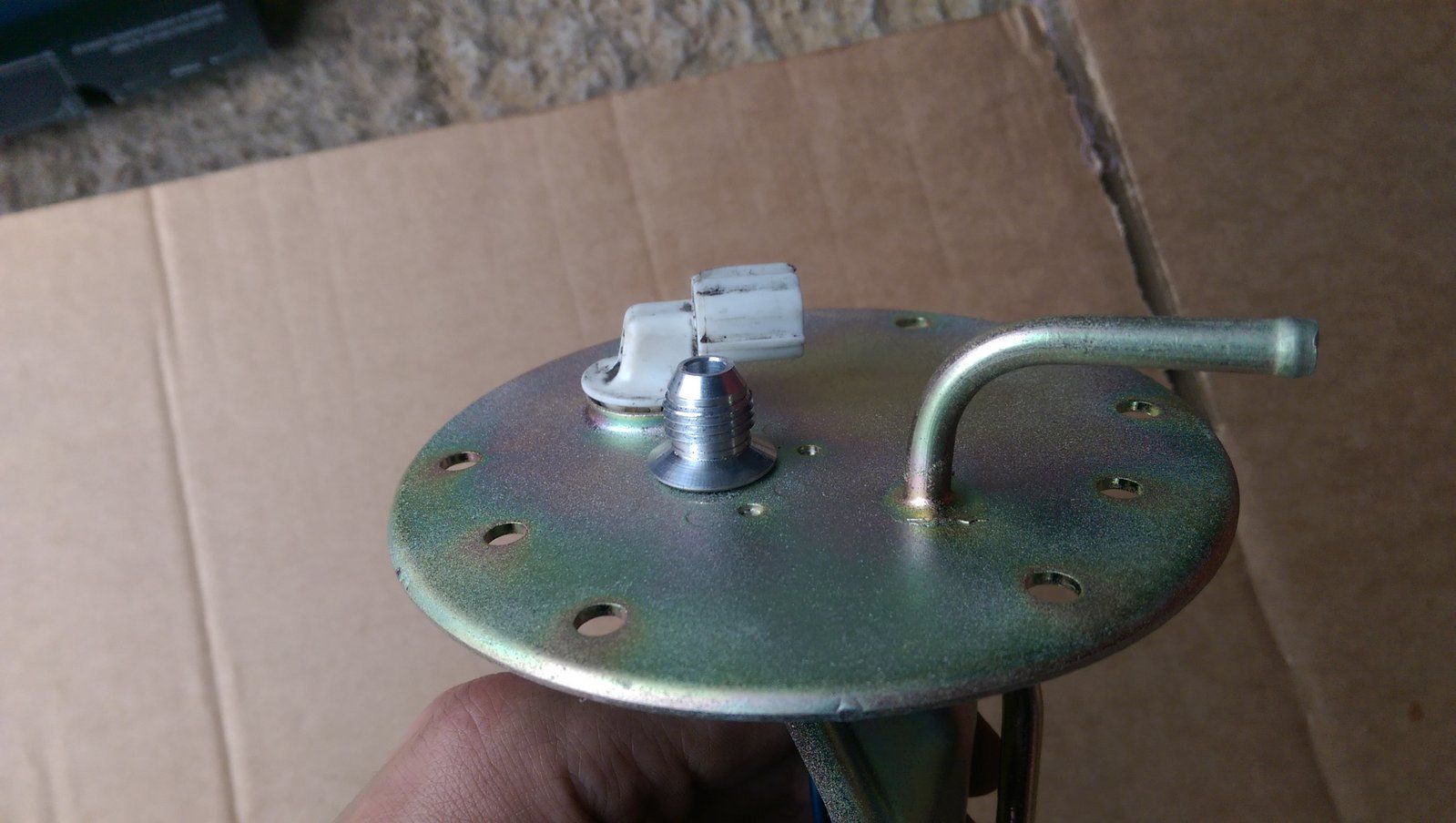

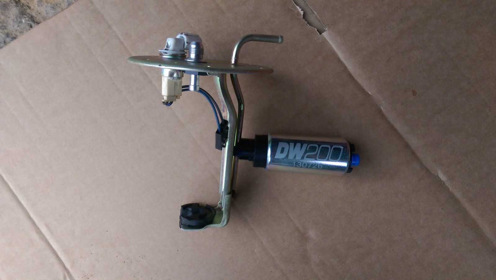

Stock fuel pump hanger re zinc coated and drilled and bokted up a 6AN feed connector, pump is a Deatchwerks DW200 225 pump, this setup will all change when i build the new fuel tank and then i shall run the DW inline DW350iL as its all I will ever need for fuel feed.

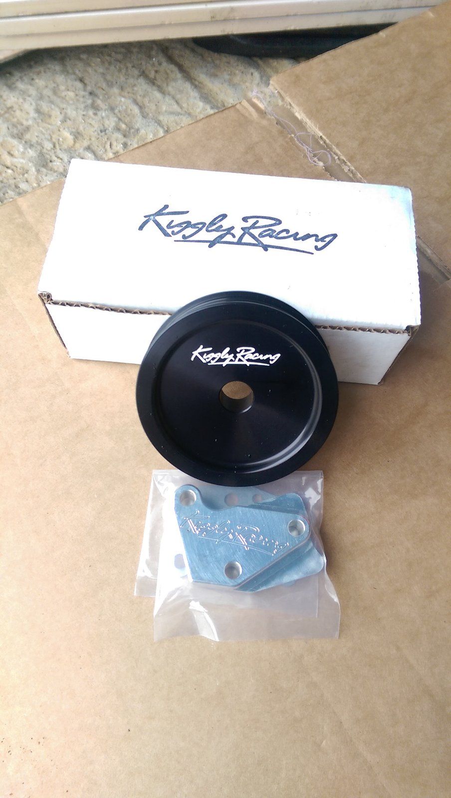

Couple of items from Kiggly, the hla regulator and the Alt pully

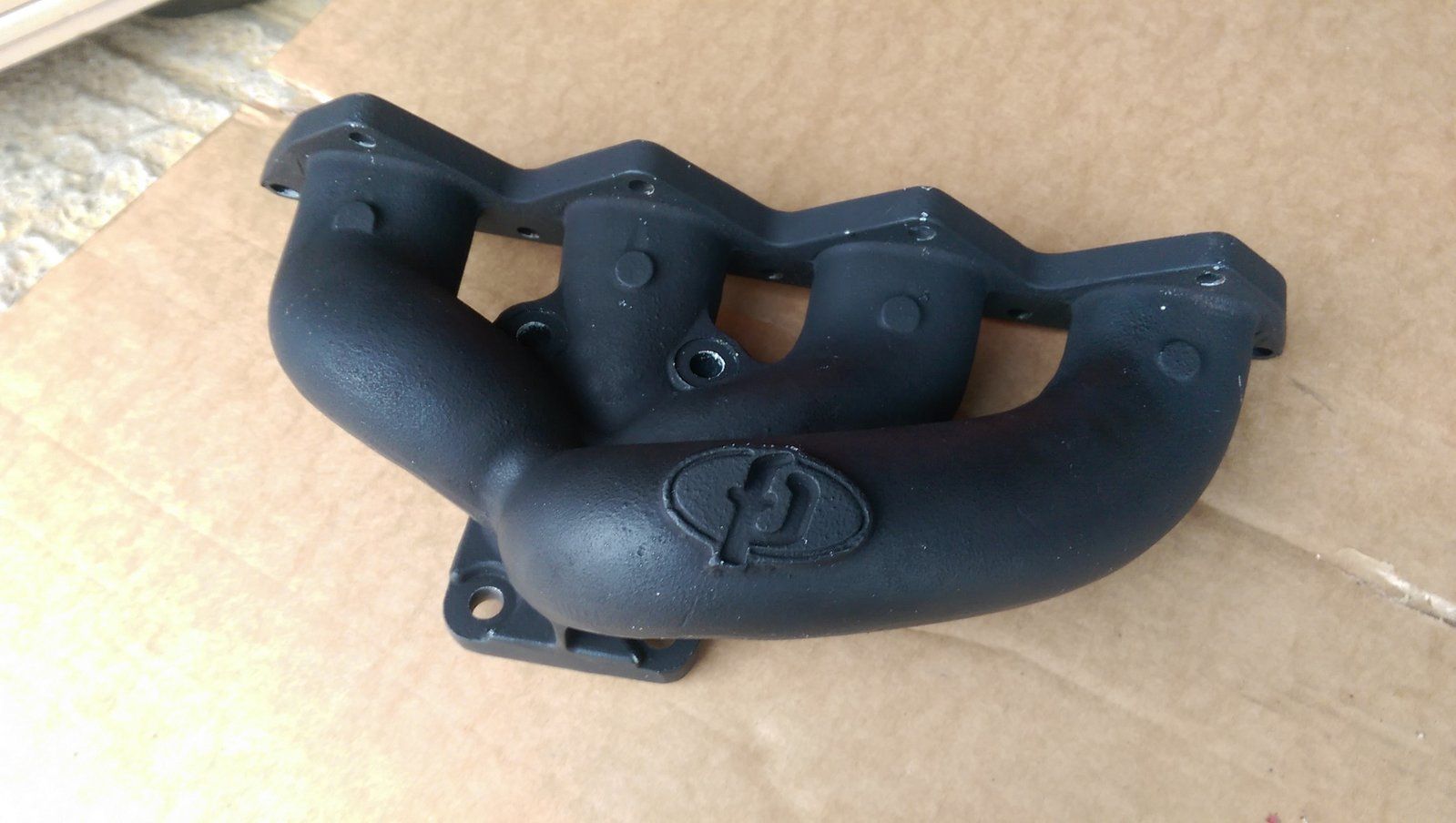

The ceramic painted and self ported FP manifold, and heatshield.

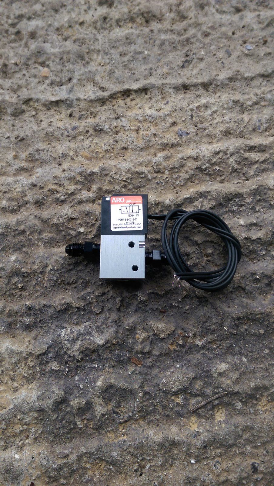

Then the Ecmlink boost controler

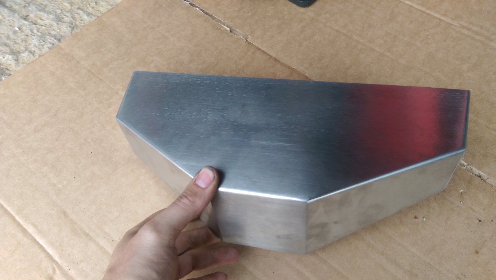

Im currently mocking up my oil pan to fully baffle it so thats being worked on slowly over some nights at work or break times, all takes time
