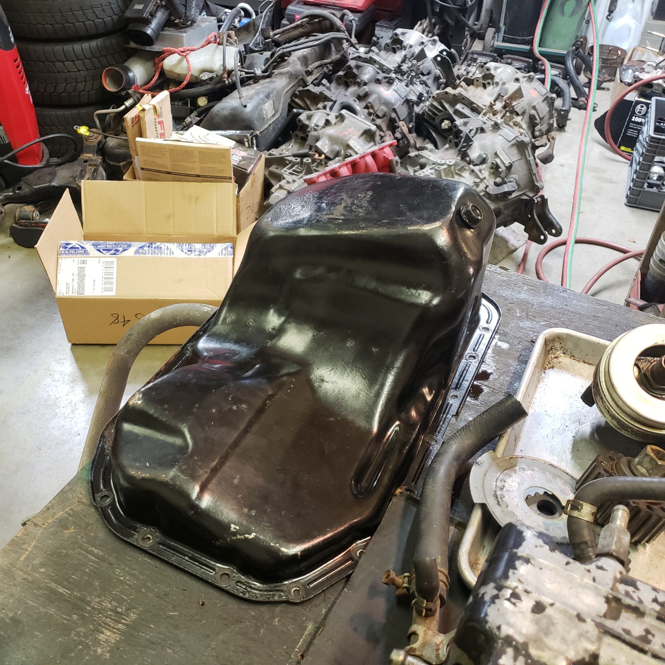

I was able to press the main point of impact out on the shop press, then attacked it on an anvil with the air hammer to finish it up. pretty happy with how it turned out.

Now that I have a process for a smashed in pan, I dont expect to have this issue again any time soon.

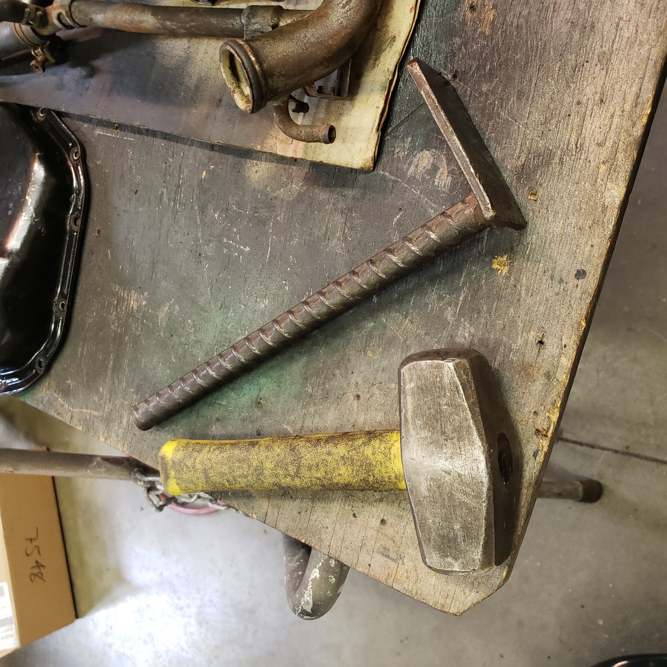

I took it on step further after my last post and made a dolly/ striking tool which alowwed me to really get in there and nice it up:

I have the press too and prolly would have grabbed a random 2x4 and pressed on it myself to see what happened, so you don't need to spend any money, just fix the last persons fk ups, it looks pretty good to me.
Budgets need to be conserved if possible!

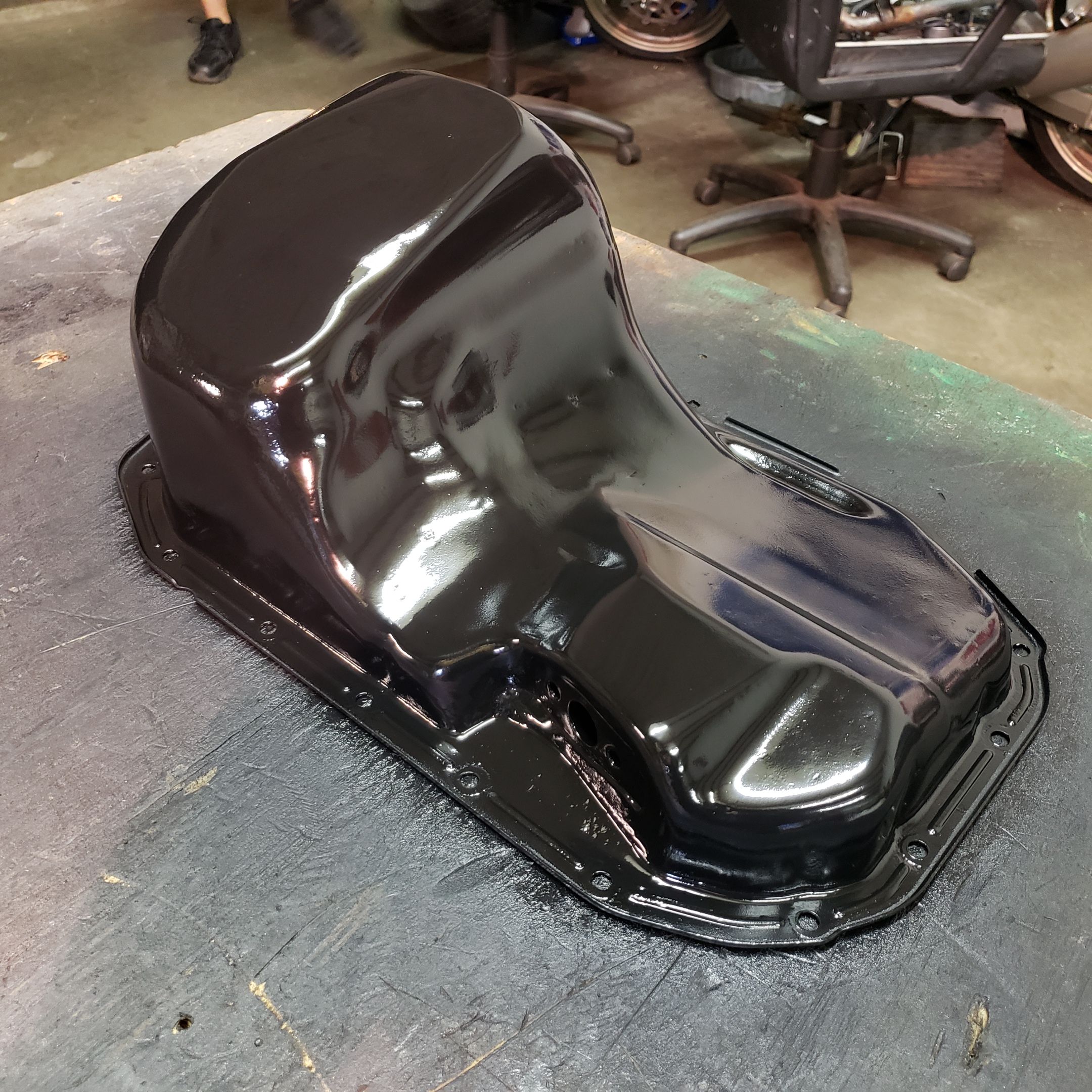

This is the final product. SEM E coat is a great all around final coat for stuff like this. Its not fussy and always holds up over time.
20200727_212153-jpg.607095
WOW, If I hadn't seen it before I would have thought that is a dam good pan!
You did a super job of "body work" on it!!!!! :thumb:
