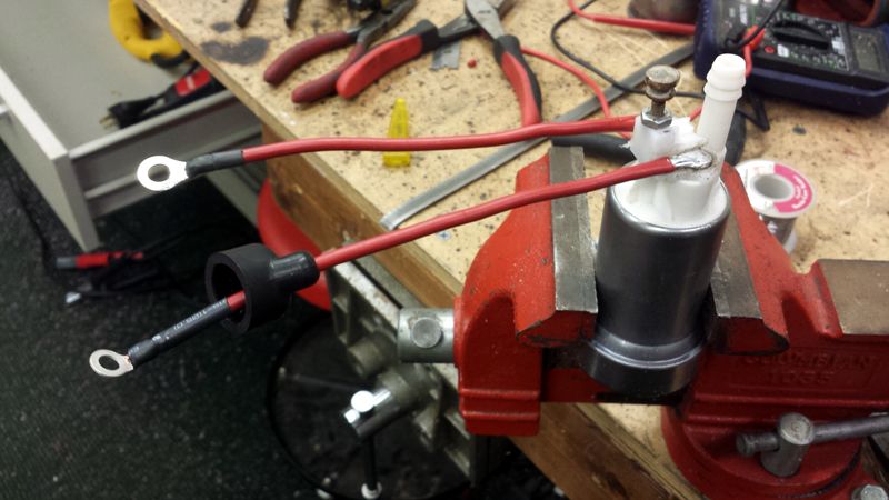

@Stapl3 This picture has been on my mind since it got posted. I mean no offense, but I am curious what happens if that solder job fatigues from vibration over time? Since there is no plastic physically holding the wire in place, it will happen eventually right? That's how solder joints work, no?
So when it separates with current flowing through it, will it have enough energy to arc as the wire falls away from the terminal? It will be in a liquid filled gasoline/ethanol tank, which is not easy to ignite without the right circumstances, but I just do not know enough about electronics submersed in flammable liquids to say this was a good idea... Is there more to your setup I am not understanding?
Does anybody else have any thoughts on this? I know we have some EE guys on here right?
Ahh, okay. I didn't realize you stuck them back down with JB weld. That's certainly better than nothing. Even if the solder joint cracked the wire wouldn't separate from the pump terminal? if so you I would imagine you are safe...
The JB weld was just to cover up the solder. There was a good size of contact area for the wires to be soldered to. They're solid. And when it's mounted in the hanger, if you pay attention to how the wires are ran, there's no strain on the connection and there's virtually no movement.
I did this because the first 450 I fried the wires on trying to go from 18v to 22v. I certainly wouldn't want to experiment with frying wires in a tank of fuel, but if it was ever going to become a bomb that would have been the time. All that happened was the pump stopped working.
