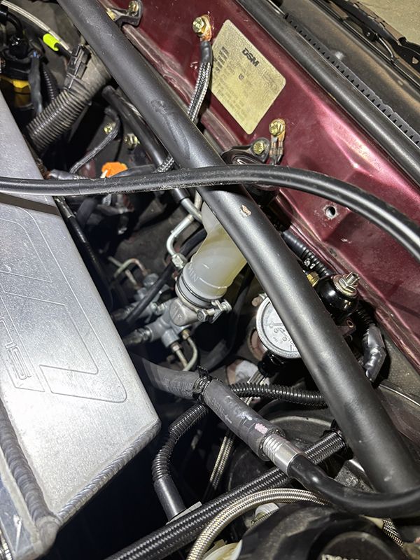

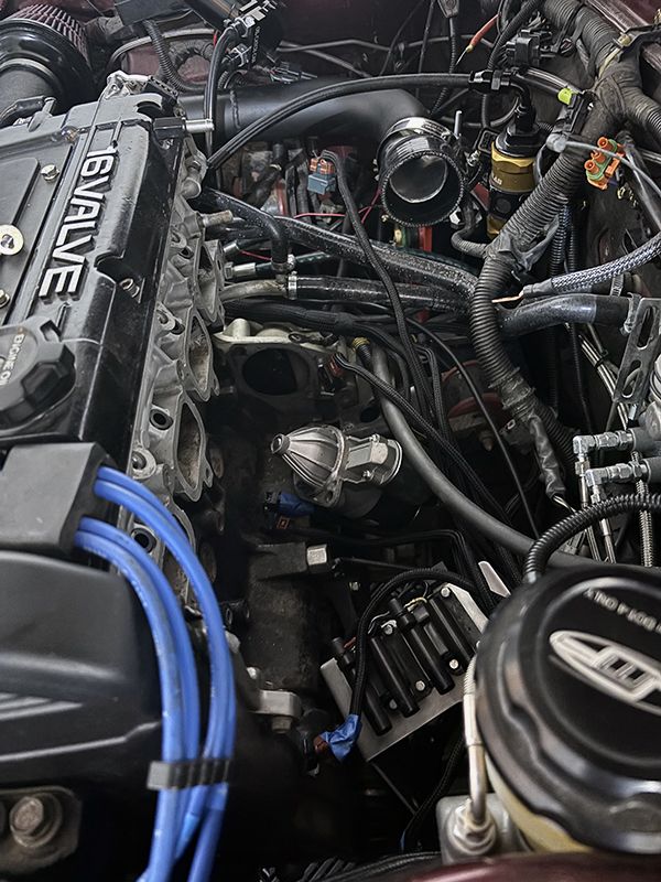

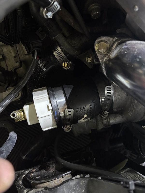

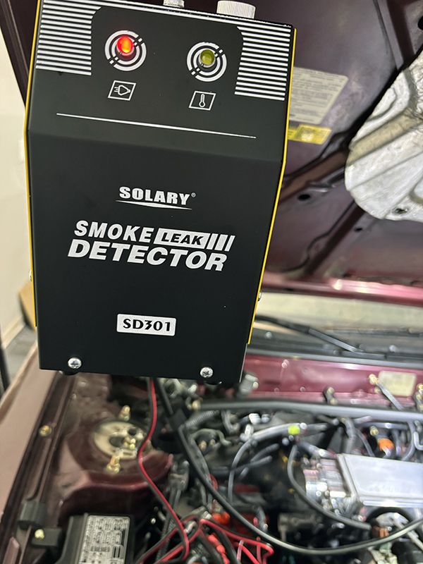

I had mentioned last weekend I did a smoke test and boost leak test. Here's my boost leak tester and my smoke machine and where I inserted it to check for leaks. I used the brake booster hose. Only smoke leaks were at the TB.

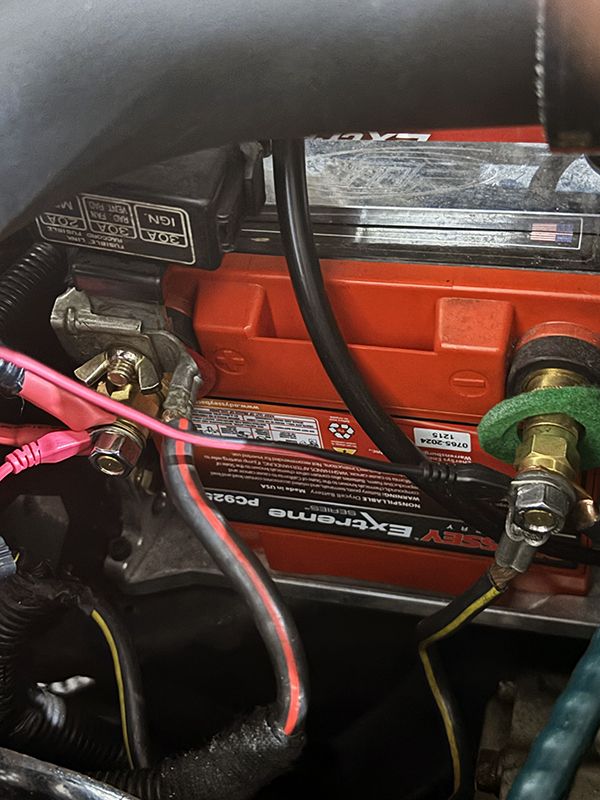

I also needed some more real estate at my battery terminals. I noticed that the Odyssey batteries have a threaded post so I did some digging and found the appropriate hardware to allow me to utilize that. I now have the main harness on one post and my fuel pump and amp on the other. Makes it easier and cleaner down there. ALso used it for the grounds.

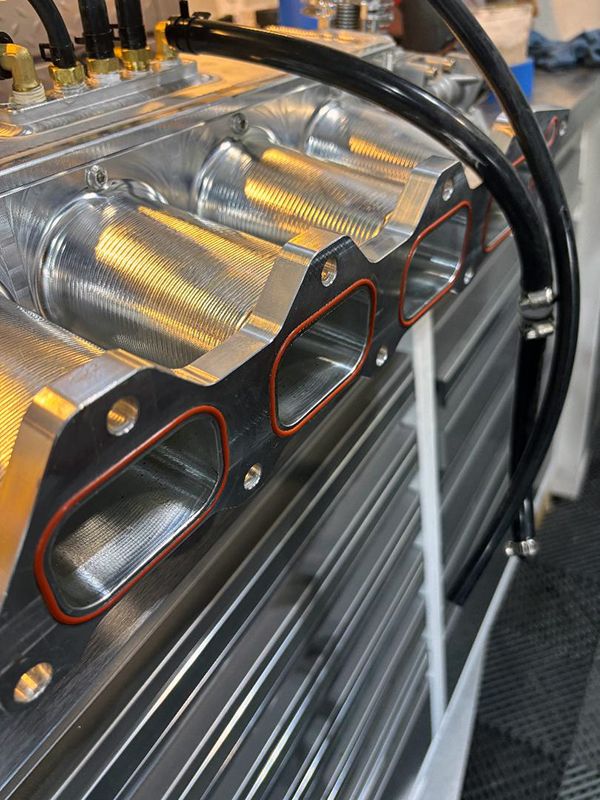

Next up was removing the intake manifold to check for massive leaks. It's not a super hard job, I just had to remember the order to remove things in order to get to all the IM bolts.
nothing really stood out for me that would be causing a leak....BUT, when I removed the IM, one of the o-rings did fall off rather easily. Upon reinstall I noticed it didn't stay in the groove easily and firmly like all the other ones. So it POSSIBLE maybe this o-ring was not seated all the way or perhaps became twisted when I originally installed it. There were no crushed spots on it and it was still in really good shape. I used some RTV to make sure it was seated properly and let it dry before re-install.

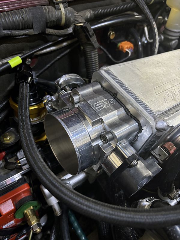

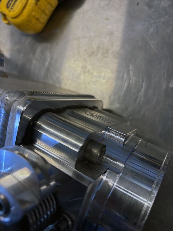

I also took this time to remove the TB and RTV the damn thing upon reinstall as the paper gasket it comes with looks pretty worthless. Also reset the throttle plate screw while I had easy access to see the plate. Did about a half-turn once I saw it just start opening.
Got it all reinstalled again, checked to make sure al the o-rings were good and buttoned her back up. Let her sit for 24hrs to allow the RTV to cure. I then re-set my throttle cable and TPS at .63v. I then started her up and she settled right down to a healthy 1400 rpms while warming up. After warm though I got idle surge from about 1000-1500rpms. Not great, but it's an improvement...something changed so I'll take it.

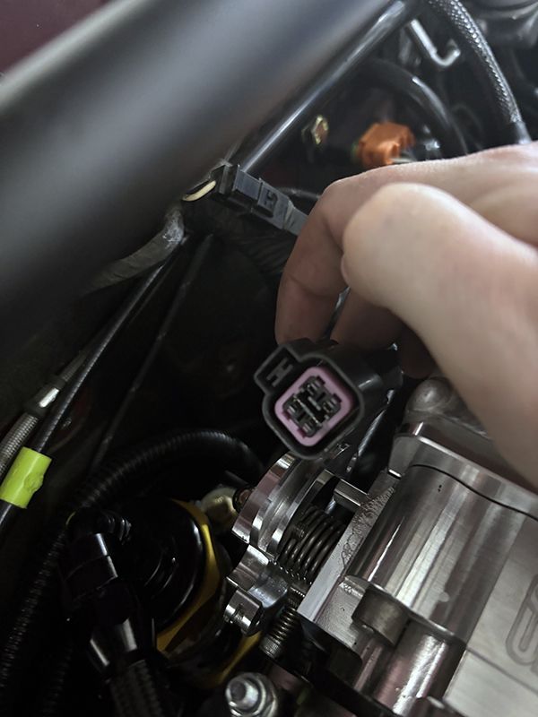

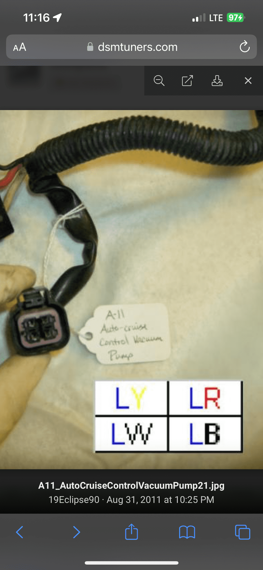

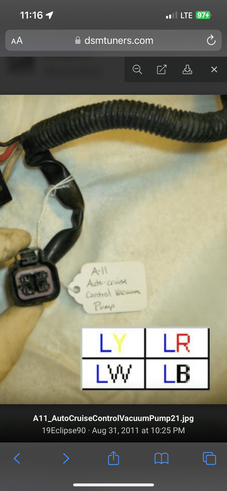

Also, I'm having a massive brain fart...where does this connector go? I'm thinking it was something for the cruise control, but I can't remember and I saw it dangling there today so.......anybody? And no, it's not the ISC connector or the grounding pin connector.

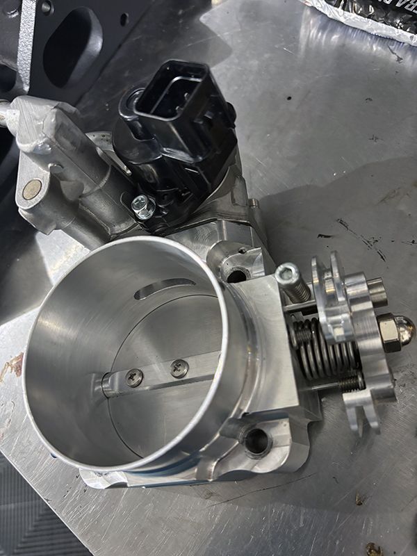

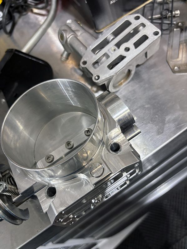

Lots of stuff happening these last few weeks, but not a ton of progress. First thing's first, is I received my TB back from Nick a couple weeks ago. Super fast turnaround time. Got it all put back together, FIAV blocked off, ISC reconnected and reinstalled back on the IM.

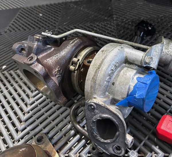

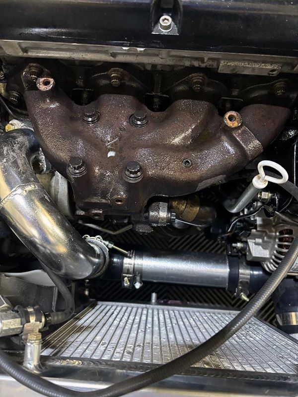

I also received some goodies from Forced Performance this week, but first I had to get the "old" stuff off.

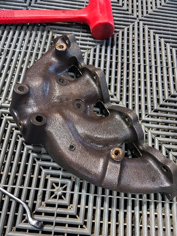

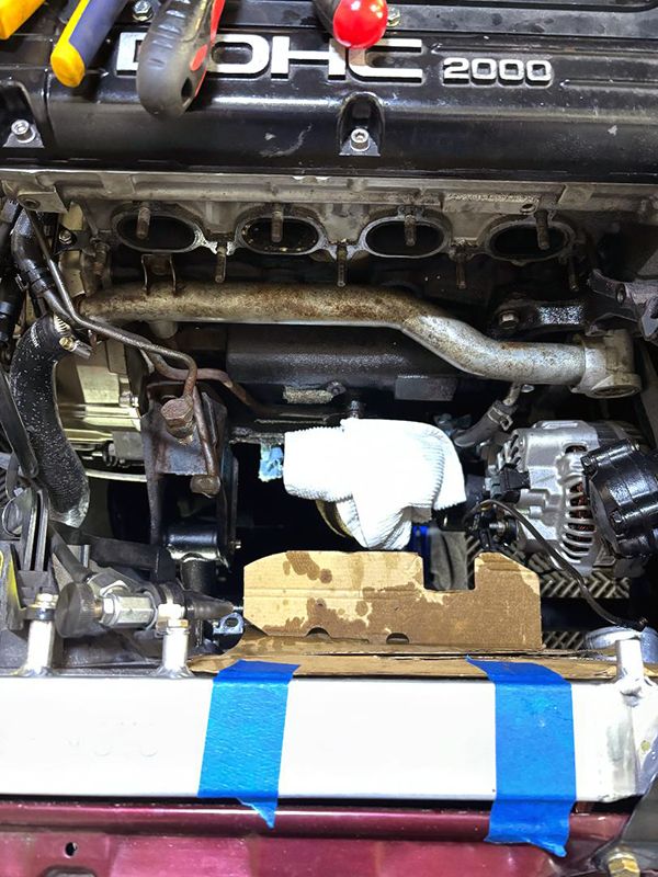

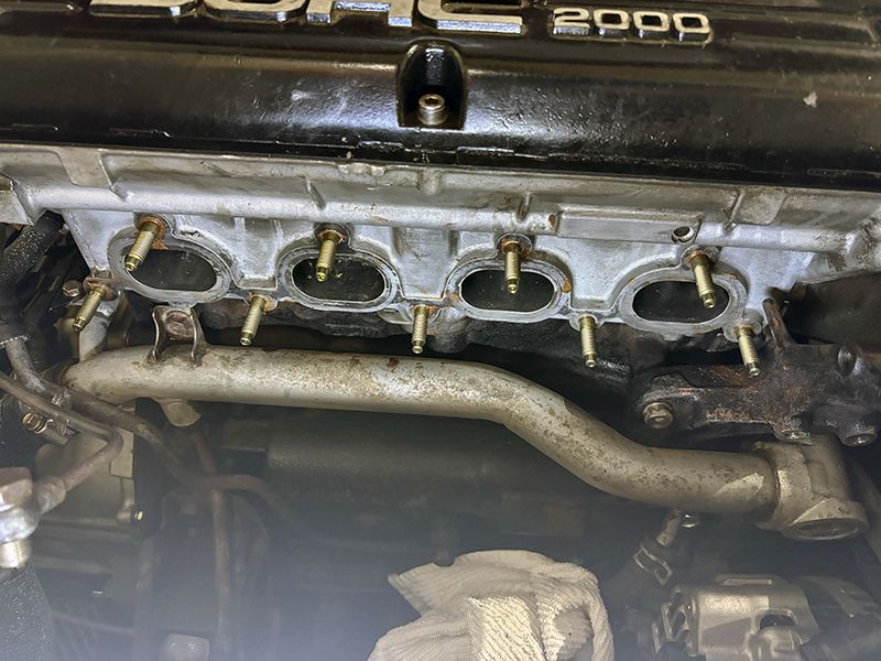

Removing the ported Evo exhaust manifold I installed about 20yrs ago.

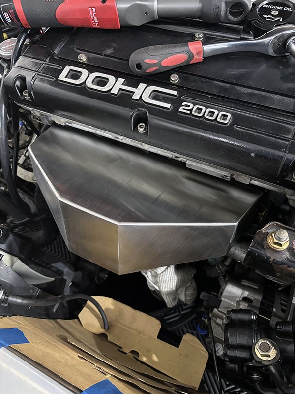

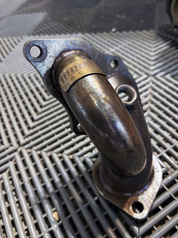

Next up was removing the Evo16G and O2 housing. Now I have all kinds of room for the new stuff.

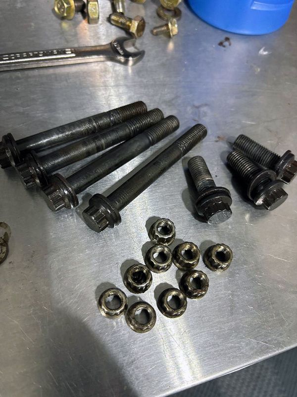

The 20yr old ARP hardware I installed all this stuff with using copper anti-seize came off super smoothly. I'll be reusing some of it.

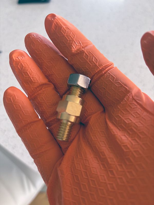

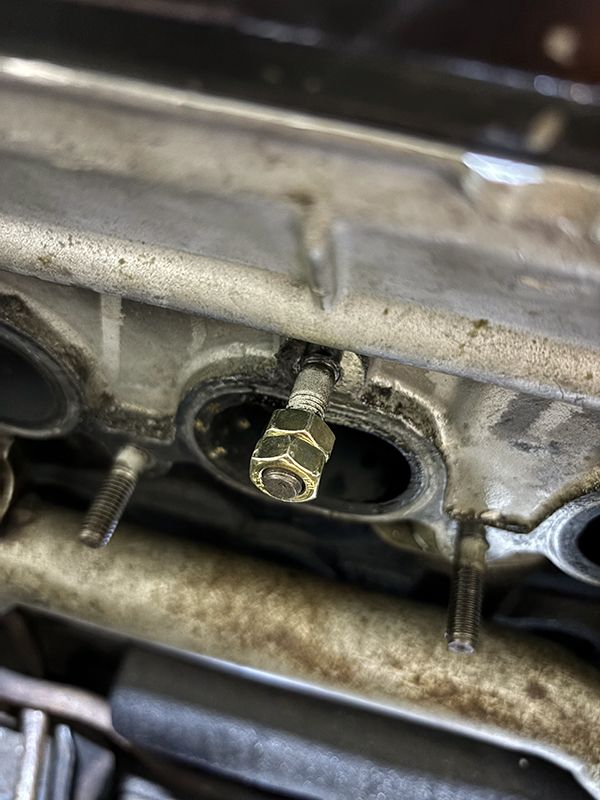

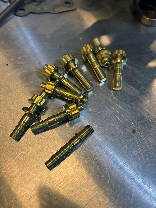

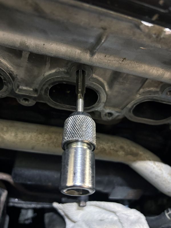

I'm replacing the old stainless studs with new titanium studs that are allen-keyed for easier install/removal. Got some cool gold ones, even though I won't see them. For the old one, I did the 'ol double-nut method of removal and of course, cleaned the threads.

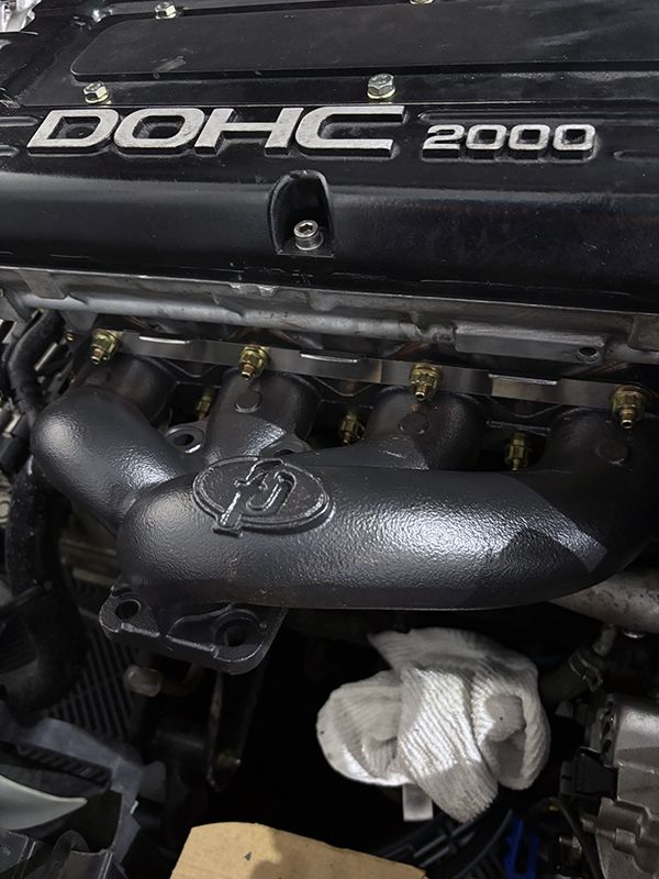

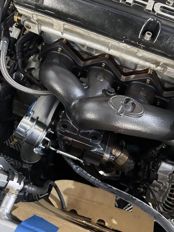

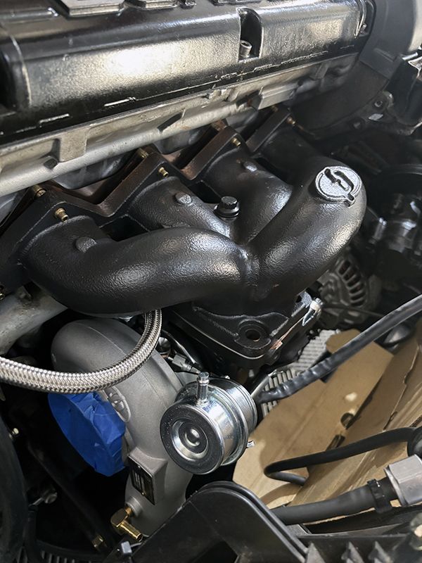

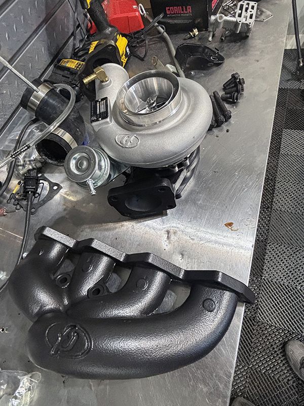

I received my new FP Green UHF with coated turbine housing and FP exhaust manifold, also coated. I had to order two new ARP fasteners that are 30mm for the front of the manifold. I'm re-using two of the turbo to manifold bolts in this case. I also ordered a new heatshield specifically for the FP manifold. Might not need it with the coating, but I want to keep the temps where they belong. Plus , I can always remove it easily later since it's only one bolt holding it on.

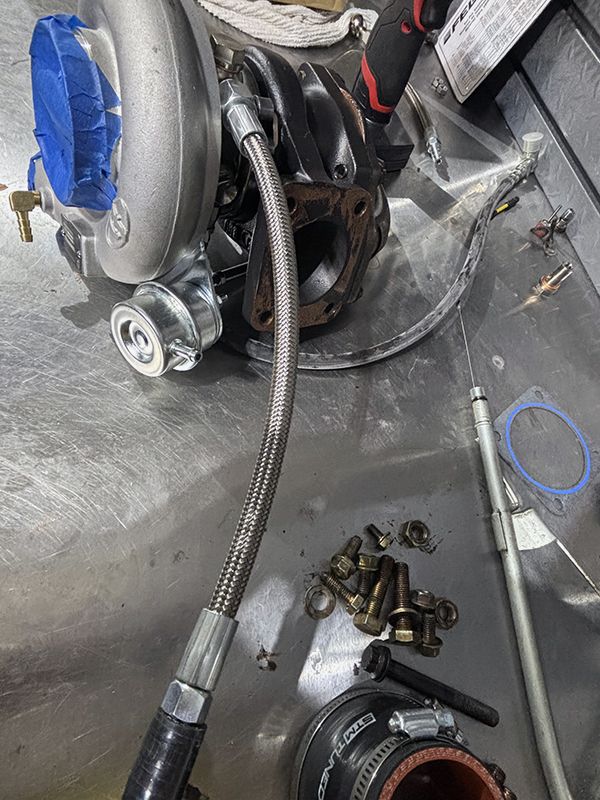

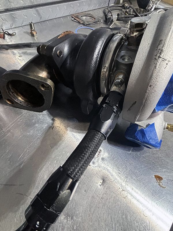

I am going back and forth on this, but for now I have new braided water lines hooked up to the new turbo. I may ditch the water lines altogether and am leaning more toward that way now, so I'm sure this will change. I also installed my oil drain line to the Green as well as FP's oil feed line. This turbo will be fed from the oil filter housing.
I had a few "while I'm in there" moments and have a few more things coming in the coming few weeks so I wasn't able to get everything bolted back in., but I did a quick test-fit to see how/what I need to do to make it all fit great. All new metal gaskets between all these pieces as well.
Feeding from the filter housing? Why’s that?
That's what FP recommends for this turbo.
"This turbo requires that oil be fed off the filter housing which can be accomplished by purchasing our 1G Oil Supply Line. For all of our journal bearing turbos we recommend a high quality oil, see below for our oiling information sheet."
