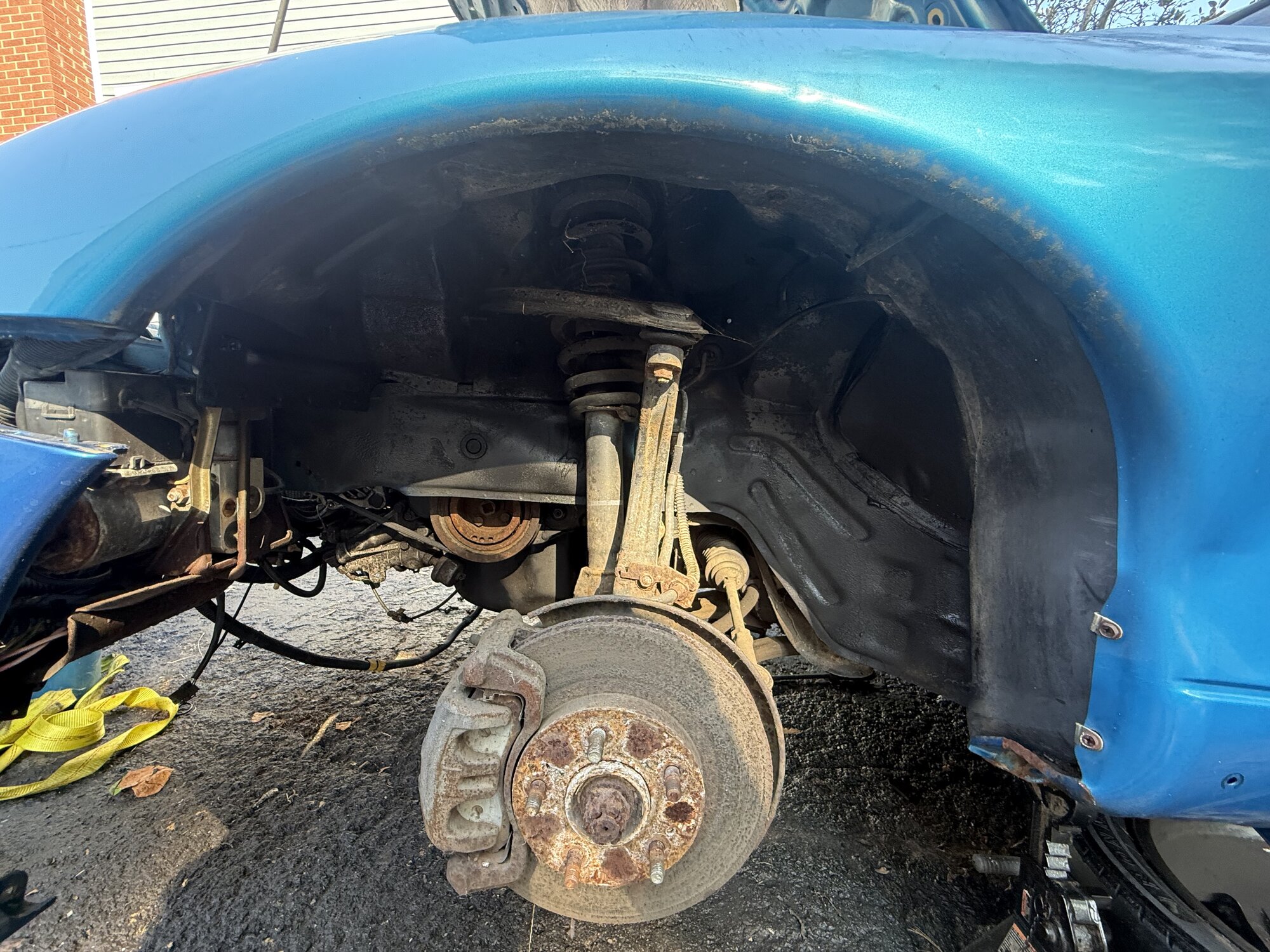

Suspension

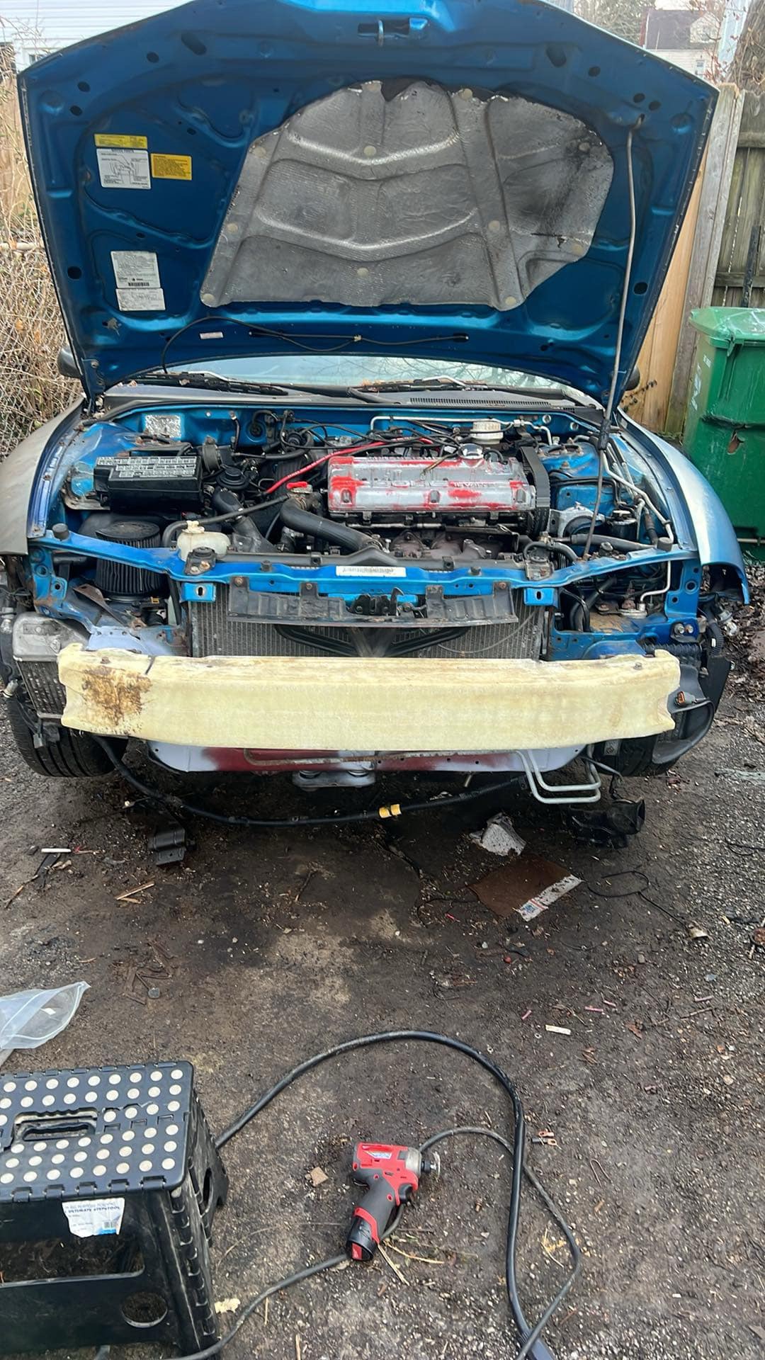

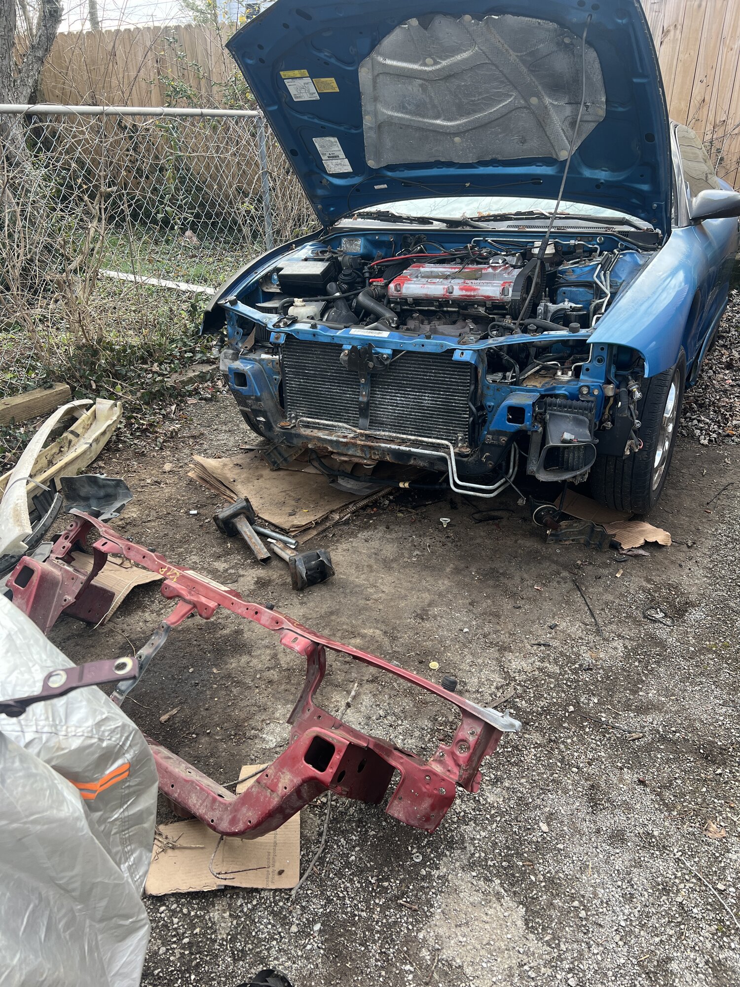

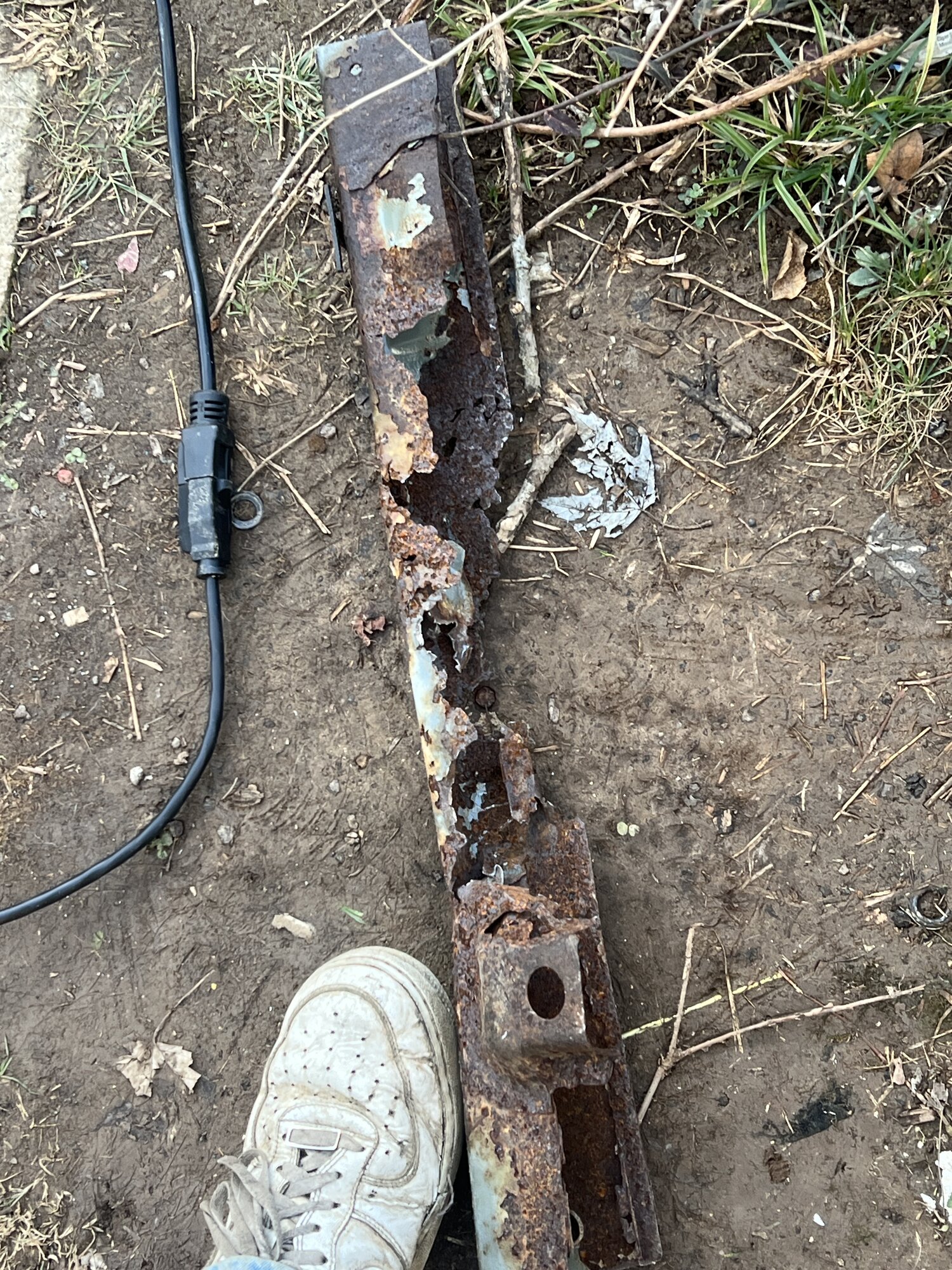

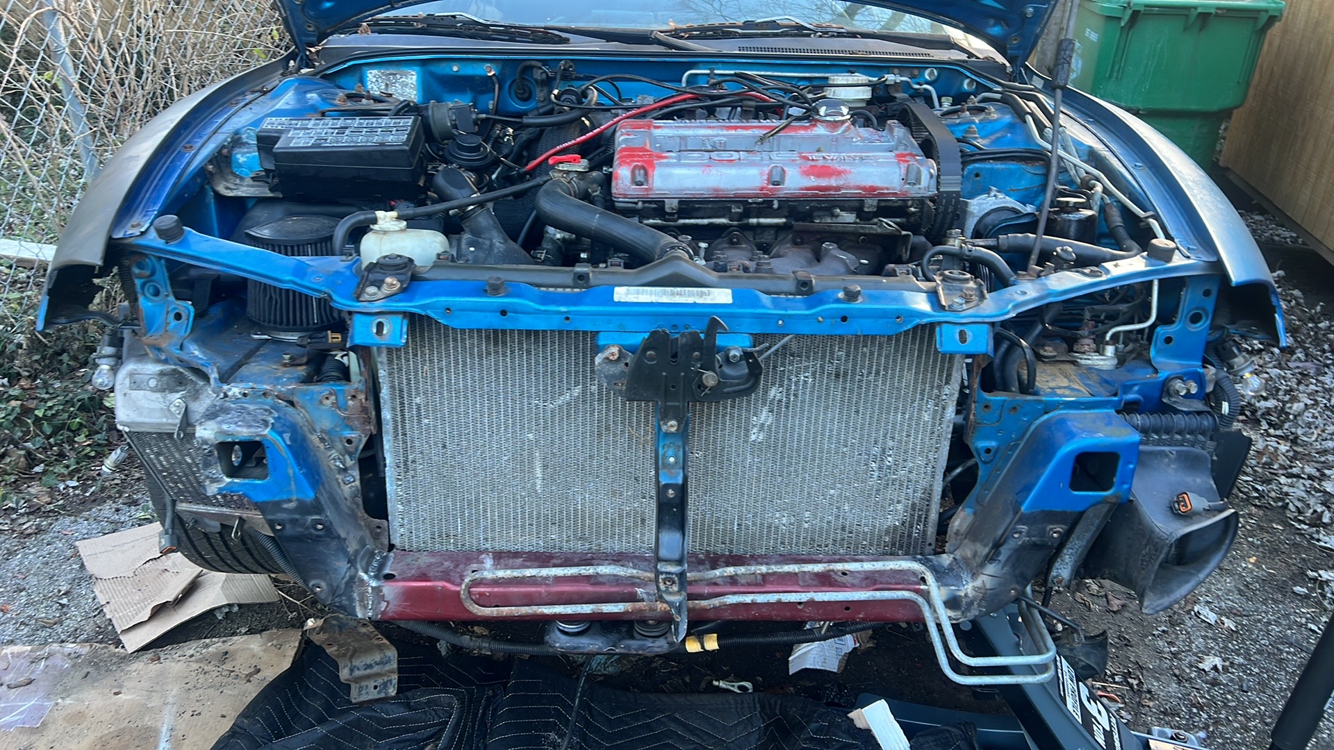

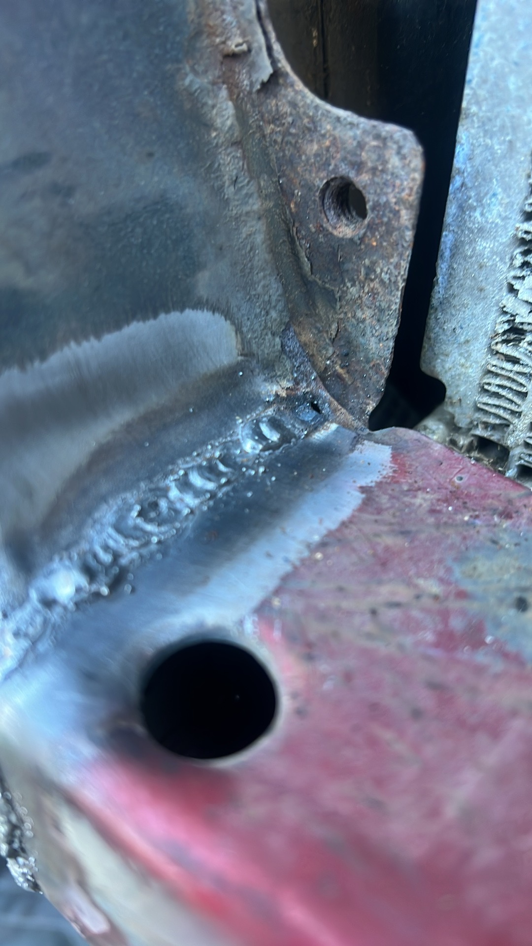

Today we solved #1, the radiator support.

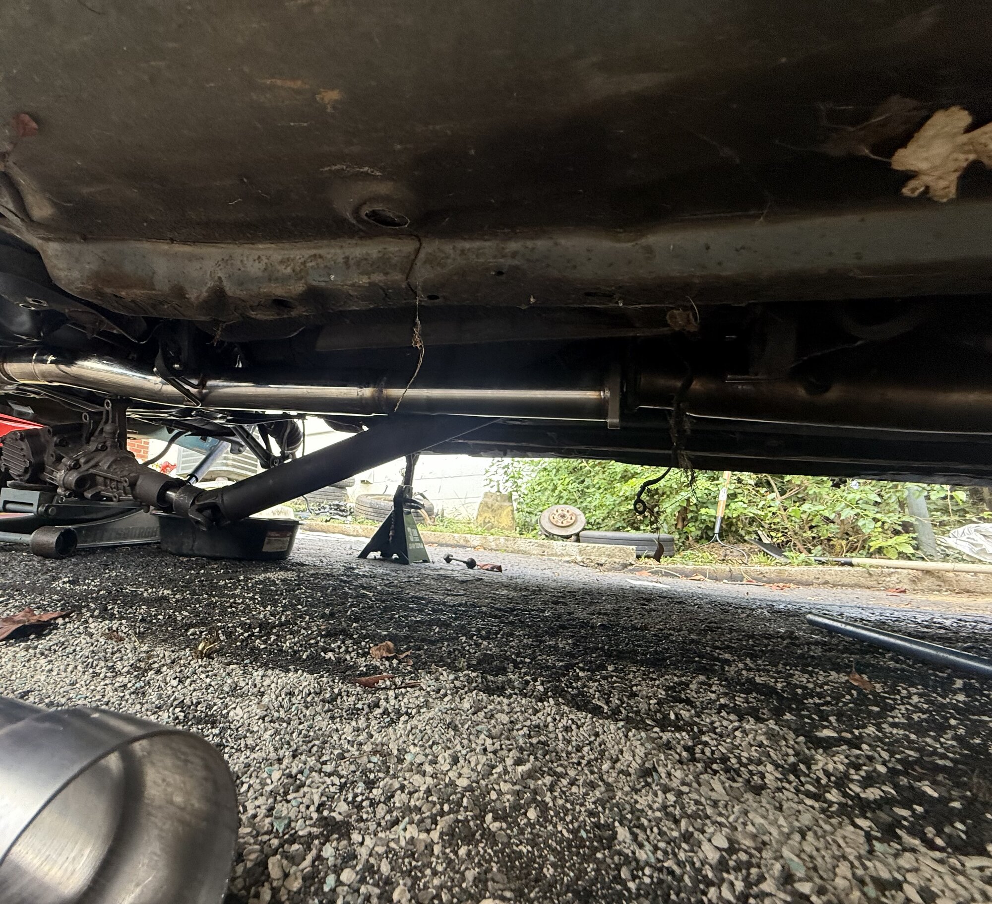

Car was missing about 2ft of exhaust, so I got to welding. Added 2ft of 304 to the downpipe and a new flange.

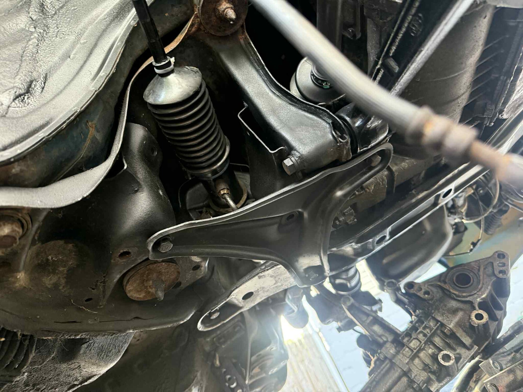

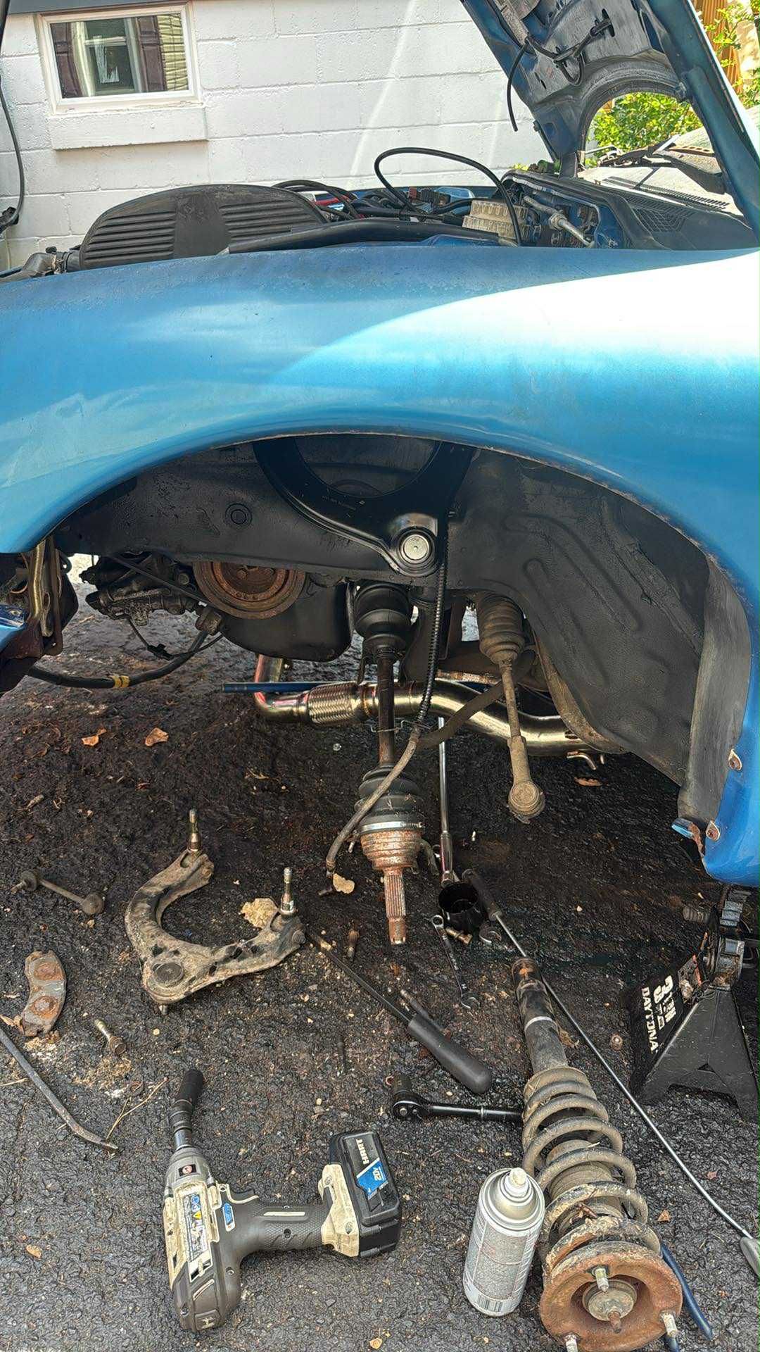

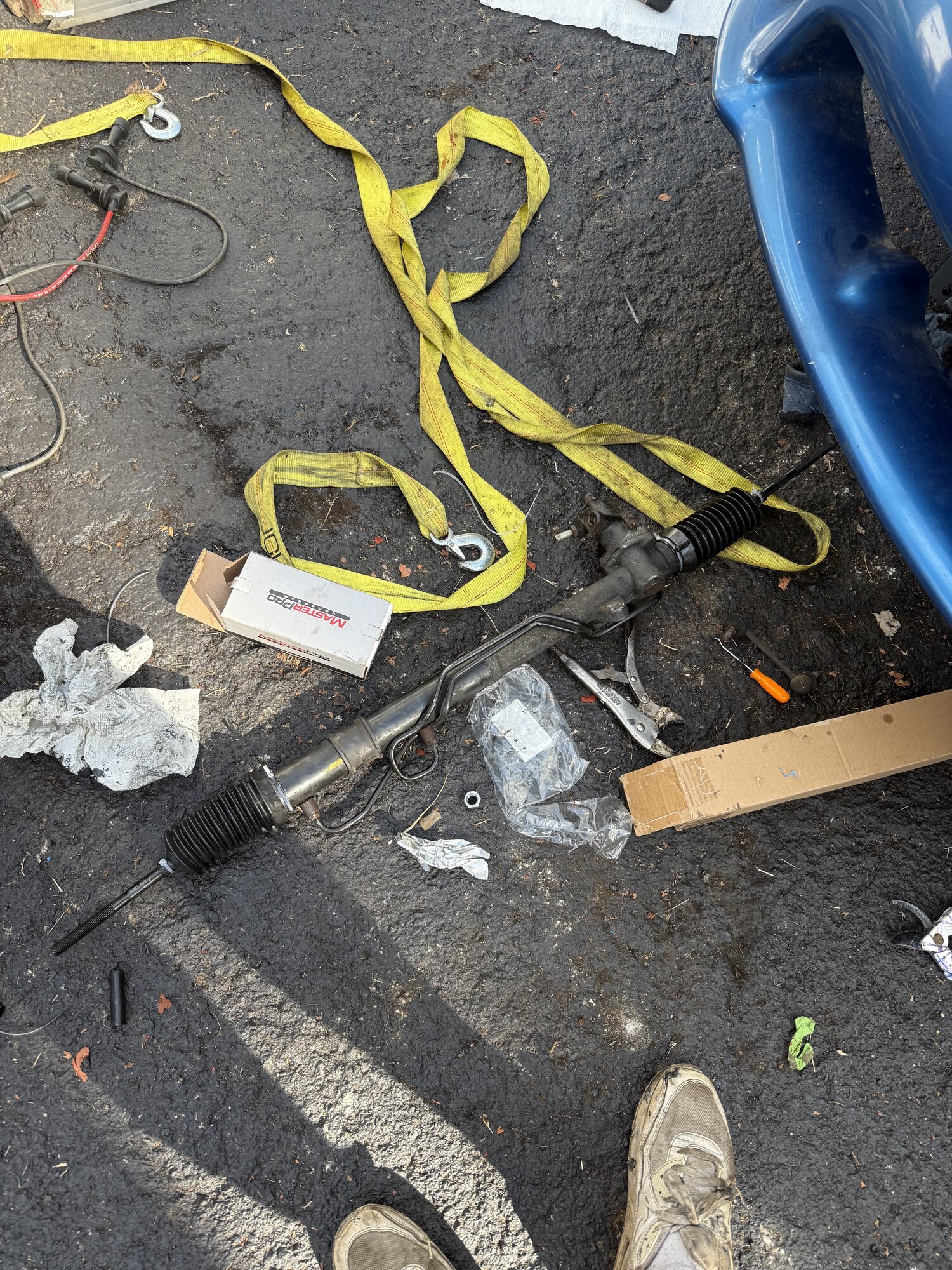

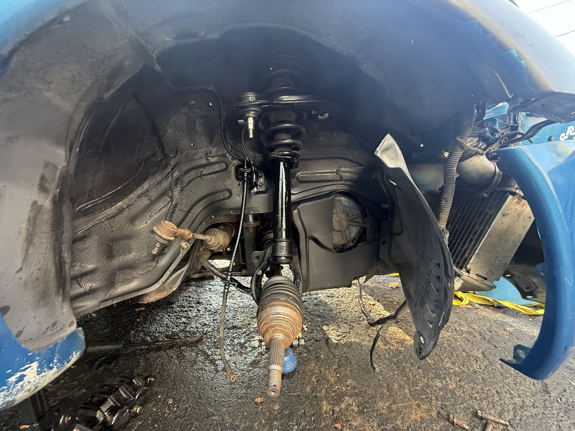

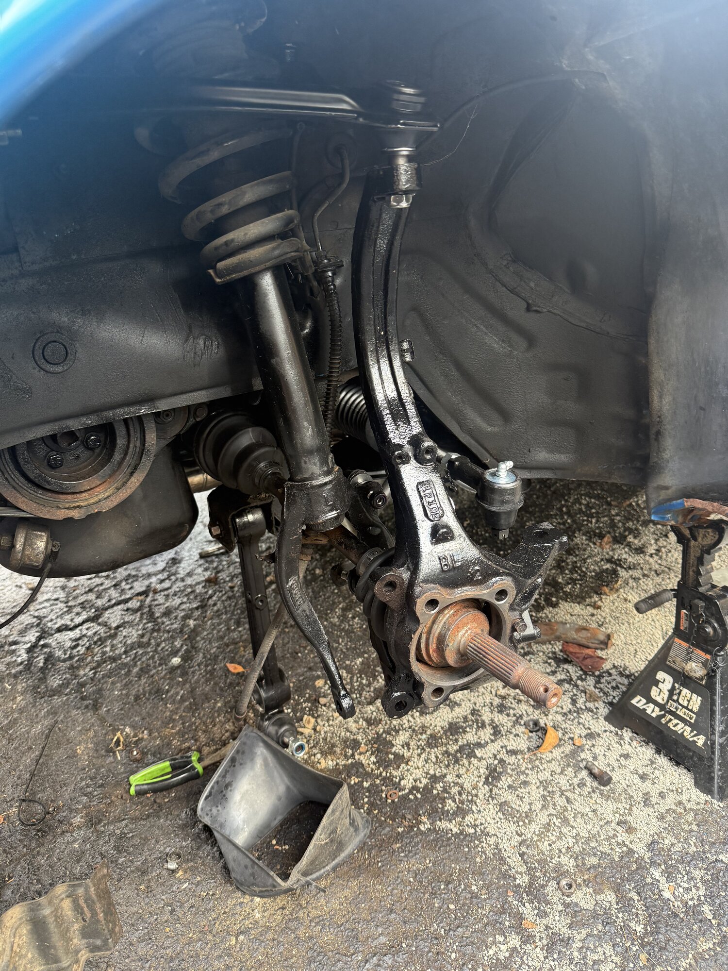

Power steering rack had a cut in a line, so got a replacement rack from PerformancePartout, and got some new boots/rods.
As a random tidbit, Mastercraft K6928 is a nice boot for the rack. Hair shorter than OEM, but seems decent for a local pickup.

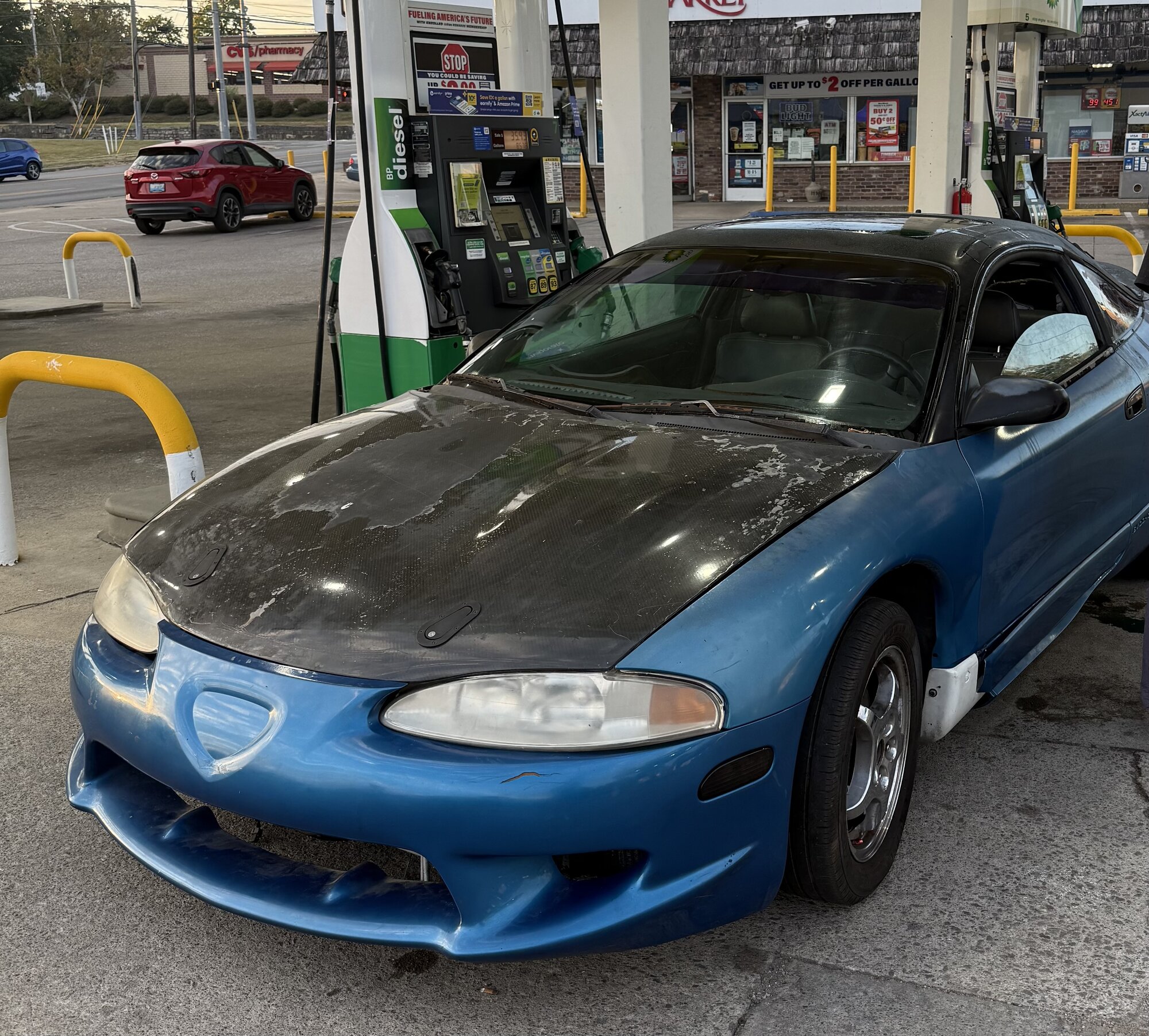

Nice car! I have always liked Kona Blue, and the 2Gb front bumper really adds to the look. Also I have had the thermal on my last Takin and have it on my current Talon. It’s the best sounding exhaust system in my opinion. Keep up the good work!
Thanks man! It’s unfortunate it’s so crusty, but it’s an AWD drivetrain and that’s hard to turn down at the cost we got it at.
