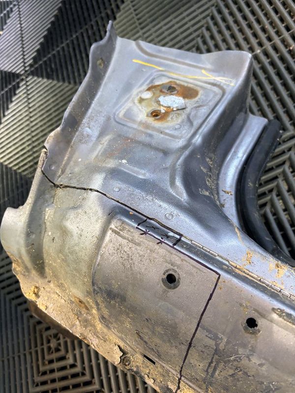

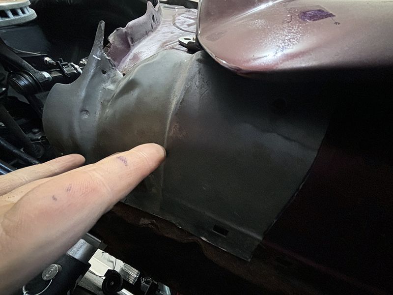

This week I needed to tackle the huge rust hole underneath the driver's side fender. You remember this hole?
I cut the new piece out of the donor part I was sent awhile back.
Lots of trimming and hammering and I got it damn close.

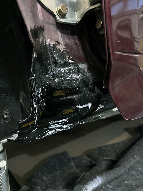

Before I tacked it in, I wanted to take care of the interior of the tunnel as best I could. I used Fluid film and sprayed as far down the tunnel as I could, then used POR15 as far in as I could reach. I mainly wanted to get the inside of the closest trim clip as it was getting pretty rusty.

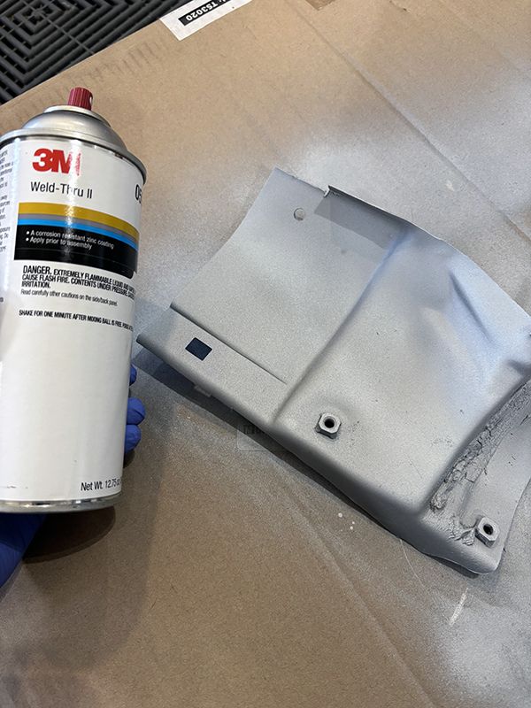

I then needed to prep the patch panel. I wanted to make sure the inside doesn't rust out again, so I used Weld Thru II on both sides to help with corrosion.
I have the panel tack welded in place and will stitch weld it in place next weekend. I ran out of time today.
I wouldn’t have used the fluid film I’ve seen bad things in testing after that was used. I suggest the Eastwood internal frame rail coating, it changes the rust molecularly. Either way great job and keep it up love the build progress!
Interesting. I'll check it out. I used FF because I've been using it on the bottom of my pickup for the last two years or so and it still looks flawless and I'm in the rust belt. I like Eastwood stuff so I'll check it out, thanks!
honestly I can’t remember if it was a fluid film review that scared me so much now or something else. I reckon it’s a little subjective. I believe you have to keep reapplying that stuff though. And make sure not to get it on any rubber or wiring components.
Yes, FF you have to reapply as it will just wear away eventually. Using inside the tunnel in this case I think it'll last pretty close to forever. I'm going to get the Eastwood stuff and use it inside the frame though and see how it holds up.
i use fluid film on my battery terminals, all along the wheel well arches, etc. with water splashing on it all winter i had to reapply it once? fluid film is great i use it on all the joints throttle body springs, driver seat bolts etc in the daily runner. its great stuff once you get over the smell of it. 10/10 would recommend

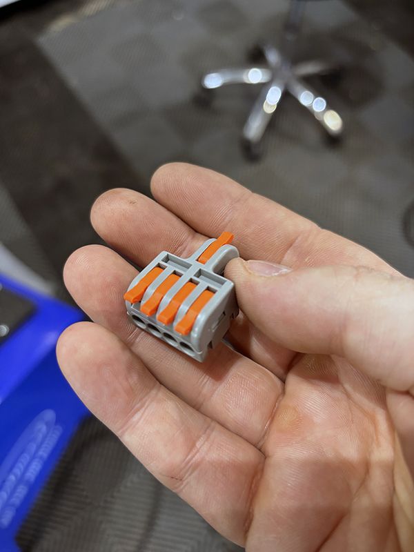

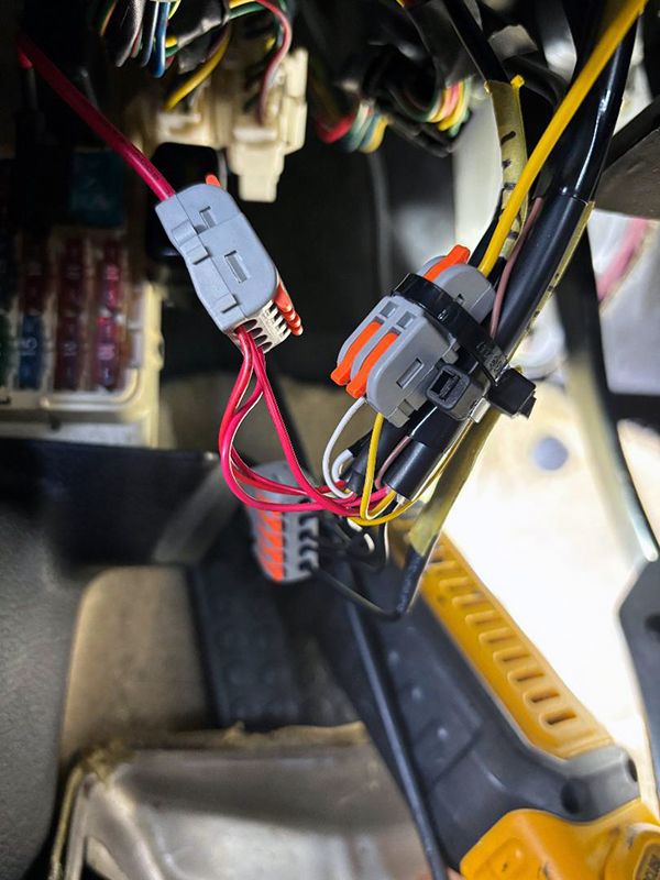

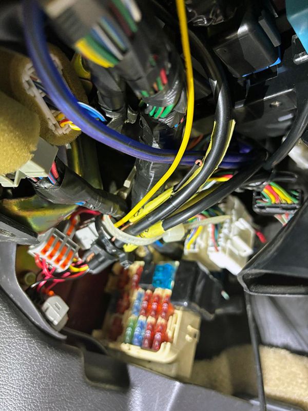

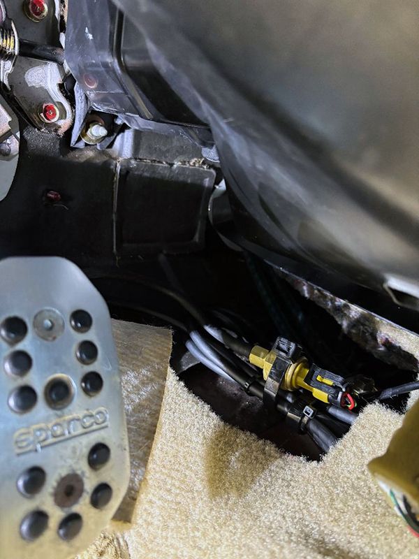

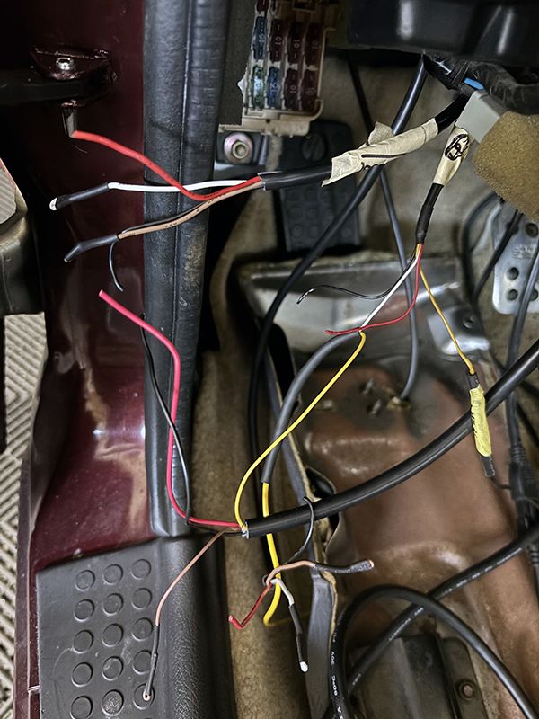

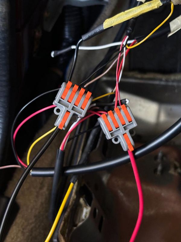

I wanted to get the gauges all done this weekend, BUT I basically re-did everything I did last week too. I just wasn't a fan of the bullet connectors and how they looked...it was quite a mess under there, so I found some wire connectors. Basically WAGO's. Figured I'd give them a shot. They are small and they hold the wires nice and tight.
View attachment 724470View attachment 724460View attachment 724461
I have a 4-in-1 and a 5-in-1 I used. four powers and five grounds. Worked great and takes up way less space and the best part is they are re-useable and easy to swap out. With lots of routing an re-routing of wires under the dash, I managed to get everything nice and tidy and in it's place using the add-a-fuse in the "cigar" fuse spot. It's a 12v switched fuse as I was able to successfully calibrate my wideband O2 sensor.
View attachment 724462View attachment 724466

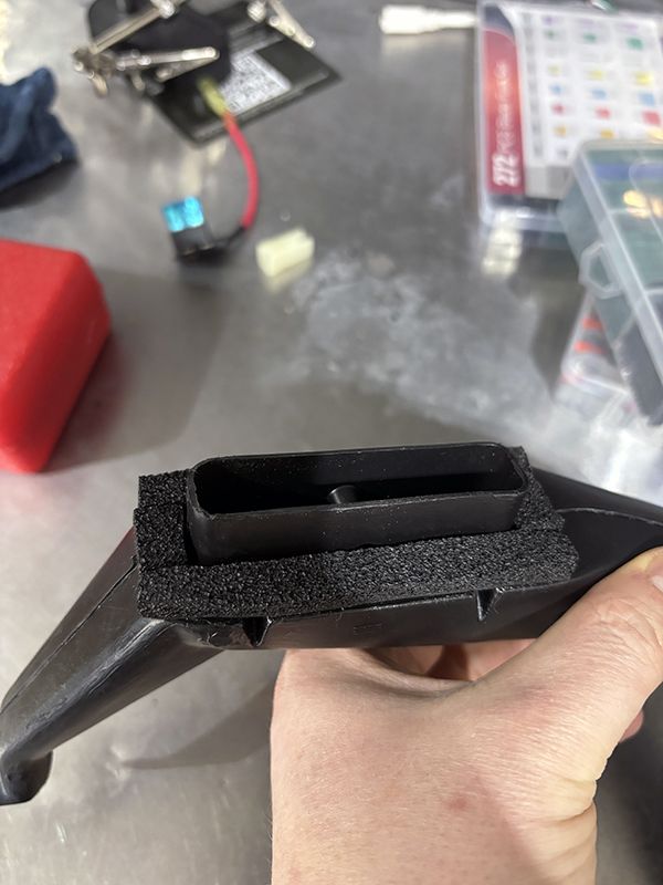

While I was under the dash, the foam around my vent opening disintegrated so I replaced it

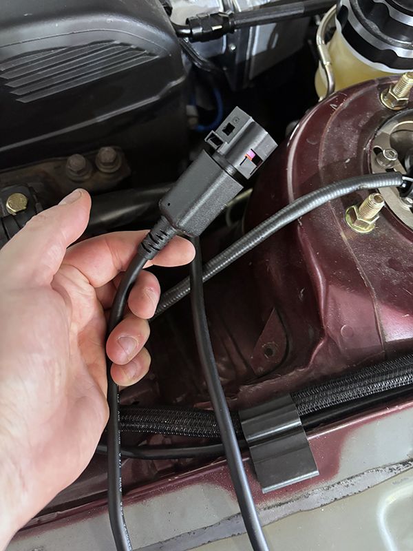

I also got the boost gauge connector and wideband controller all buttoned up under the radio where the shifter cables are behind the ECU. On the engine side I tee'd off of the FPR line to intake manifold.

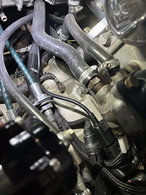

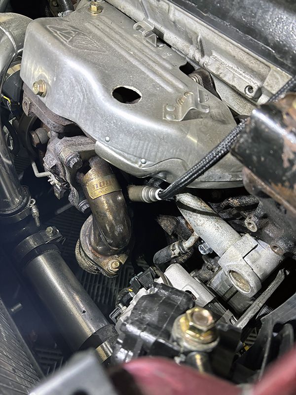

Next was getting the new wideband O2 sensor installed in the stock location (I'll simulate narrowband using ECMlink). In order to reach it I removed the power steering pump and bracket as well as dipstick tube. A pain in the ass, but makes it much easier. Surprisingly the O2 sensor came out nice and easy.
I routed the new controller wiring through the engine bay along the same route as the stock one. It was a tight fit, but it fit in the stock holder as well. I used the stock clips on the exhaust manifold as well.

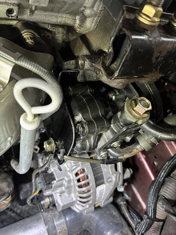

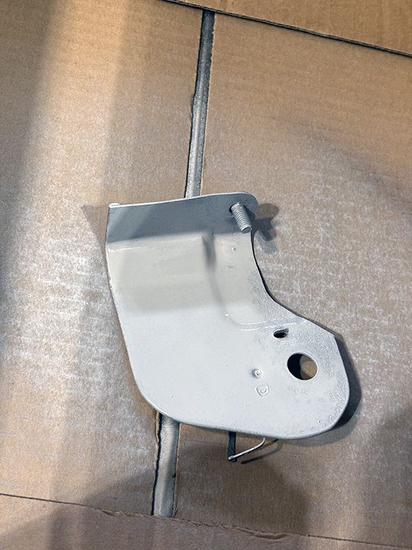

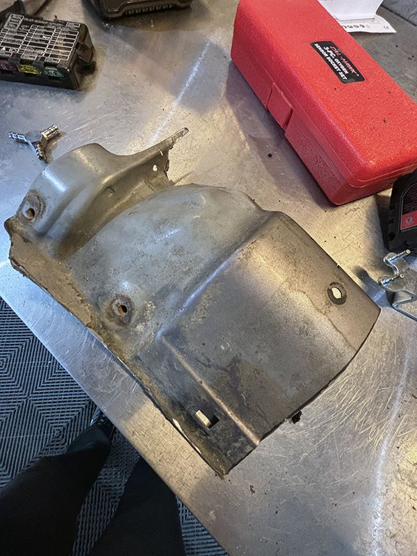

While I had the PS pump out, I noticed the PS heat shield was looking a little rough, so I sandblasted it, primed and re-painted it. Looks pretty good now.
View attachment 724463View attachment 724458
Everything all bolted back up. Eventually, I'll get a stainless PS heat shield.
Be careful with those wago type connectors. I had my aem gauges wired up in a similar fashion with those type of connectors and kept popping fuses. I couldn’t figure out for the life of me what was going on. Even went as far to rewire the entire panel with new aem gauge harnesses. Only to find out that connector was grounding out on the inside. Ditched that mess and went back to terminal buss bar.

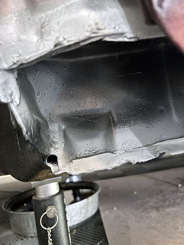

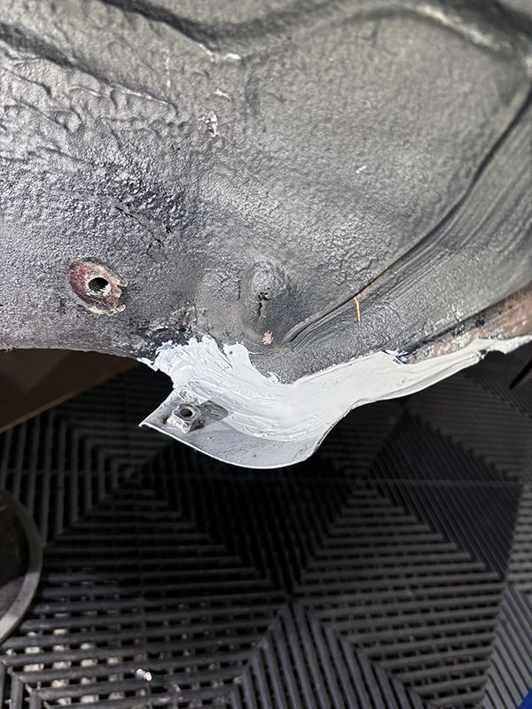

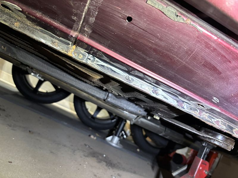

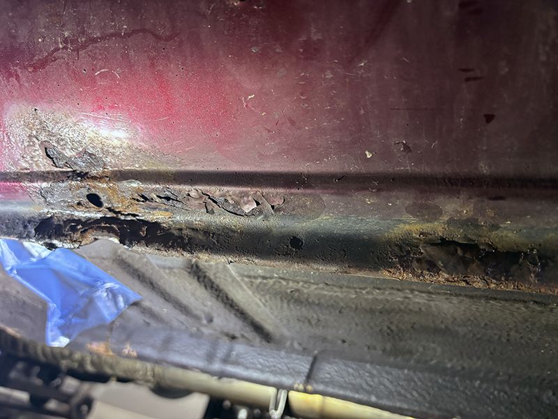

Finally got the new patch panel all situated but had a bit of a detour while I was doing it.
I got the new patch all welded in. Had to stitch weld it since the metal is so thin here (about 18 gauge). I'm no welder, but I got it done and it's solid. Here it is all welded and grinded smooth.

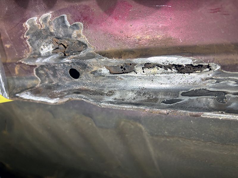

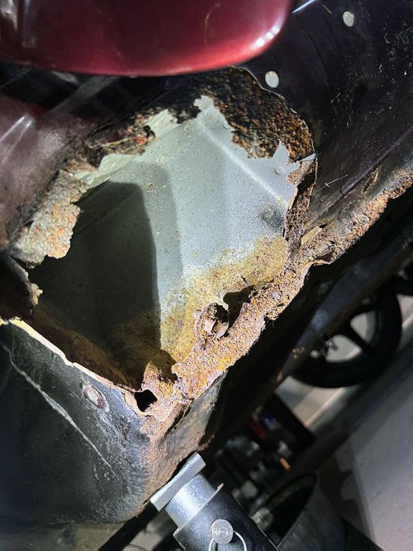

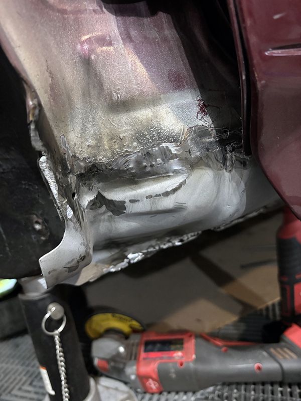

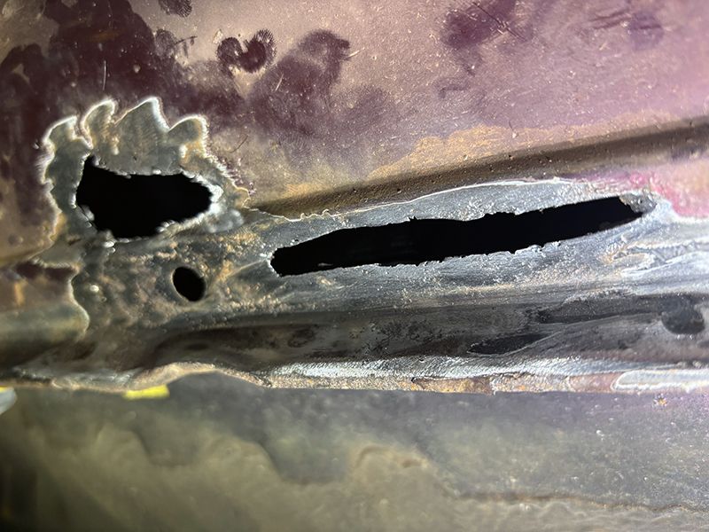

While I was getting it all cleaned up and smooth, I decided to go further back just a little as I noticed some rust, so I wanted to clean that up while I had the grinder out.

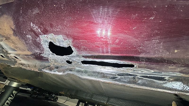

This area was hiding so much more. Here it is again after grinding away the surface rust.
A little exploring and cleaning the rust away from these new holes it uncovered and some smoothing of edges.

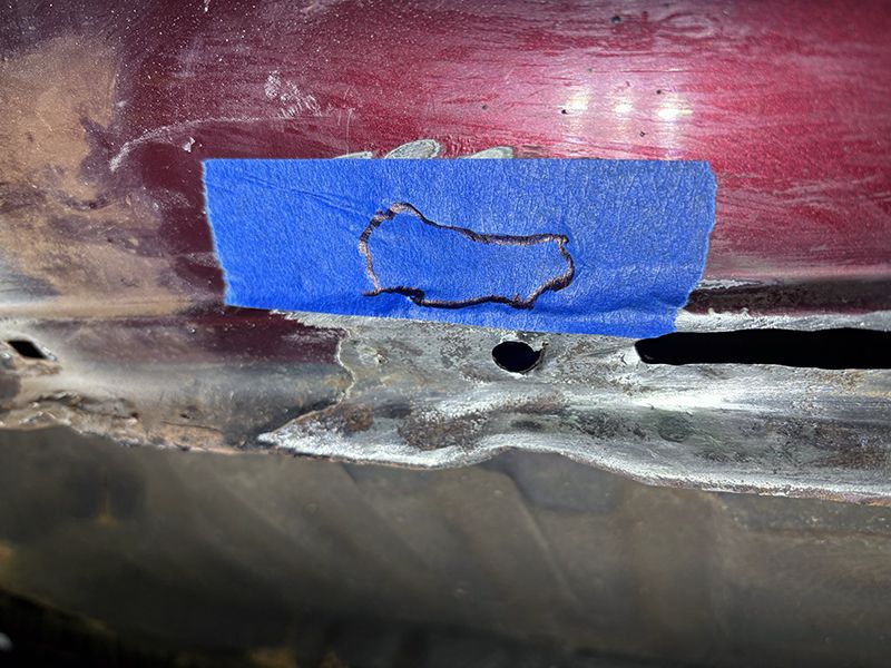

I decided the best course if action was to make a few patches with some sheet metal I have lying around for this very reason. First I made a template, cut the patch and screwed a bolt through the center so I had something to hold onto.

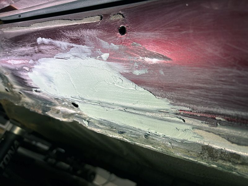

Then it was time for some fiberglass bondo like I did a few pages back.

Decided to clean up the rest of the pinch welds on that side as well as they were looking pretty gross after 32yrs.
Next up was applying POR15 to the new panel and the pinch welds. Any bare metal got por15...and since this was a previously rusted out area, I wanted to protect it as best I could. I will be reapplying Fluid Film on the inside as well to cover the Weld-thru that's already on it.

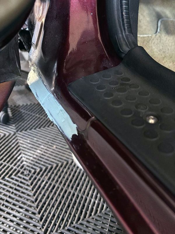

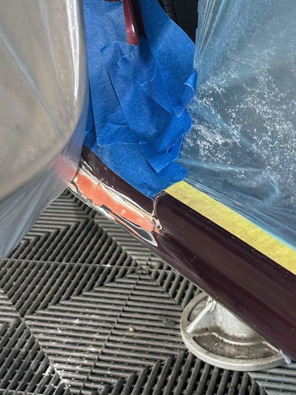

Finished up the patch and lower door sill area this weekend. While I was prepping the new patch panel for paint. I noticed a bubbling of some rust on the door sill. I sanded and smoothed it to also prepare for paint.
I did a lot of sanding this weekend. I used filler to fill the low spots from the welding process and make it smooth and to recontour with the body lines.
I also POR15'd the pinch welds after grinding the rust off last weekend.

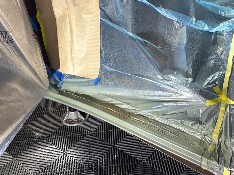

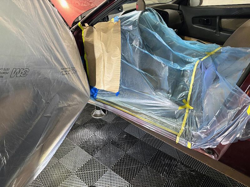

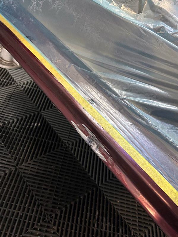

first thing I needed to do was protect the area from paint.,
then primer. I used about 3-4 coats until it was where I wanted it to be. then 3 coats of base, followed by 2-3 coats of clear.

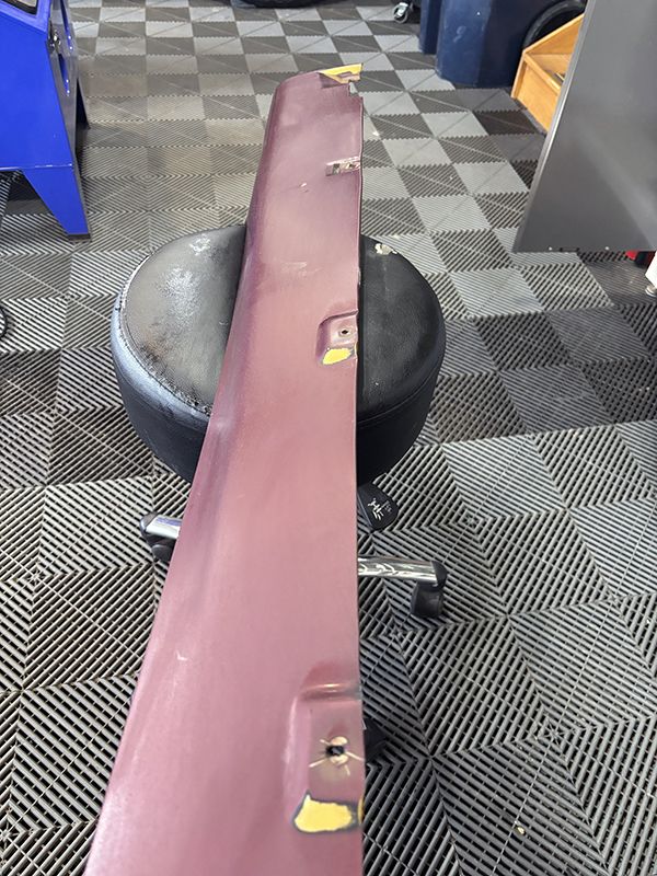

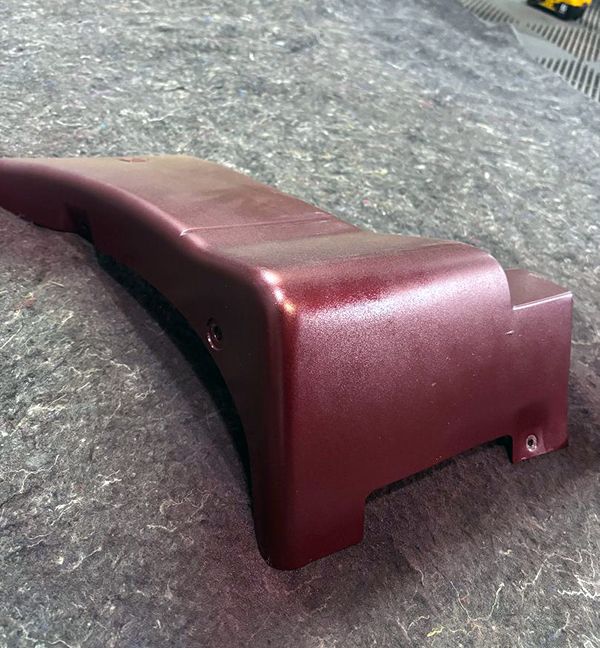

I also decided to pain the bottom of this fender trim piece as it was showing the yellow of the original plastic from many years of road wear. This was when the basecoat was still drying. Looks much better now.
Next weekend I'll cleanup the trim pieces, re-install the tape and get it installed again.

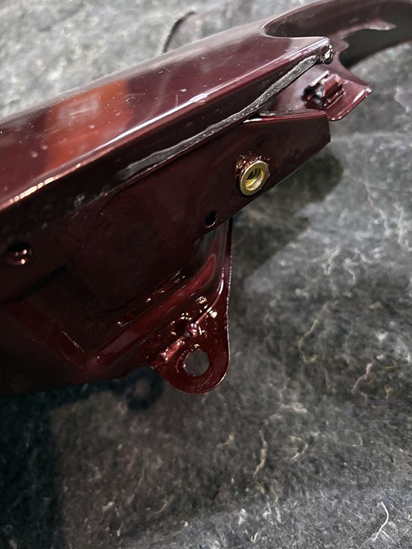

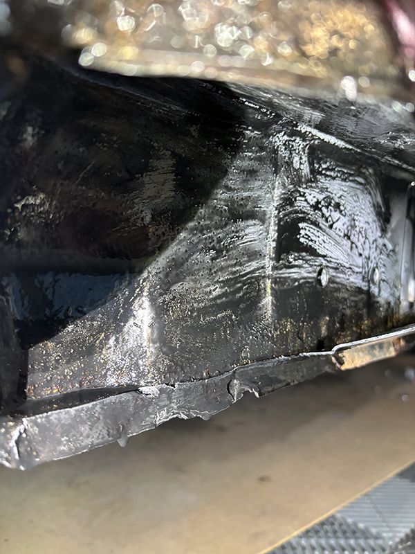

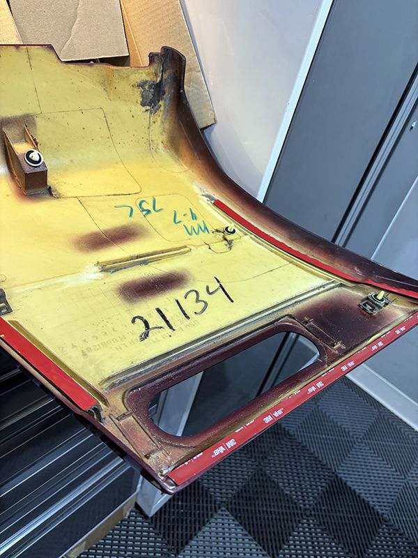

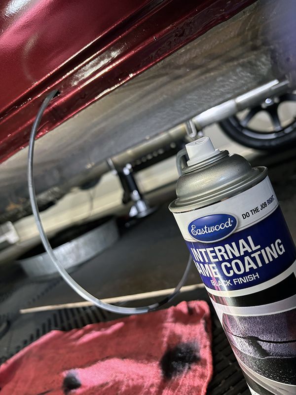

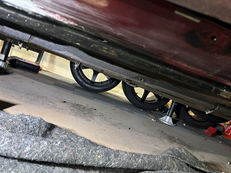

Before I got the sideskirt back on I wanted to make sure the inside was protected so it doesn't rust out again. someone had mentioned Eastwood's internal frame coating before so I tried it out. It's very similar to POR15, but in spray form. I used the included attachment which allows for all around spray in tight spots. I went along the entire interior of this area for good measure. Then did the interior of the frame on this side where I could.

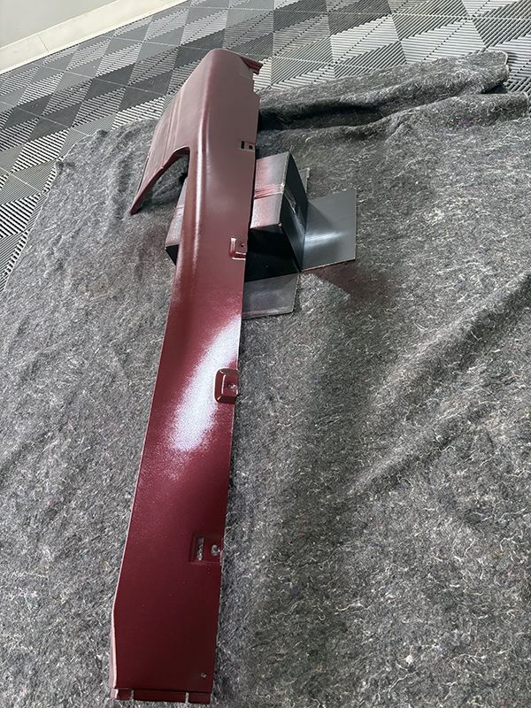

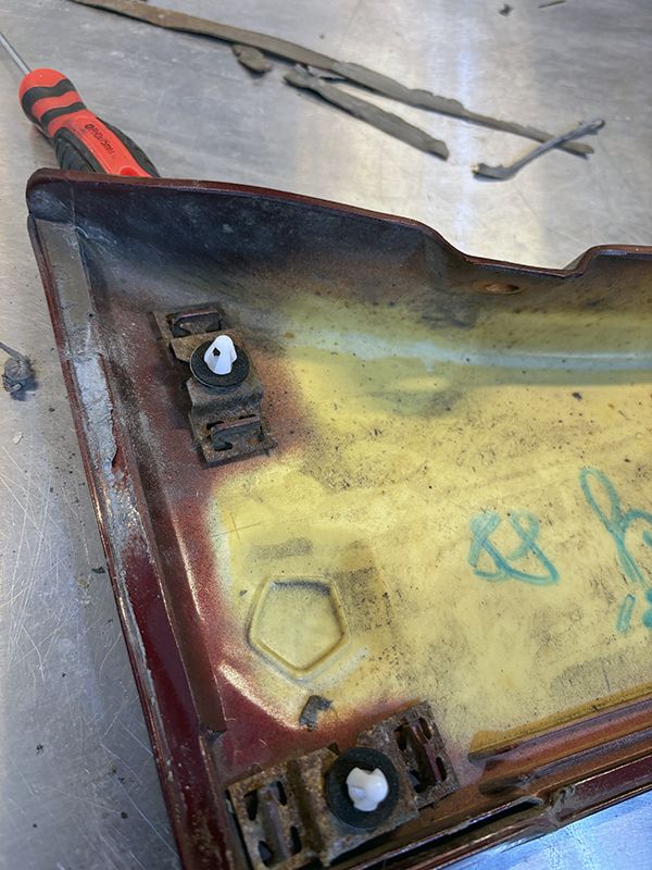

Next up was preparing all the parts for re-install. But first, I noticed the bottom of the side skirt was looking pretty faded and in some spots the yellow of the raw plastic was showing through. I needed to fix that.

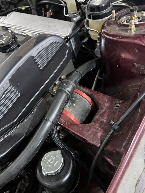

While that was drying, I decided to reroute the opil pressure line I installed a few posts up. I ended up not loving the routing I took along the wiper hose. Plus, it was making the hood not close as smoothly as it could. I decided to run it alongside the power steering line.

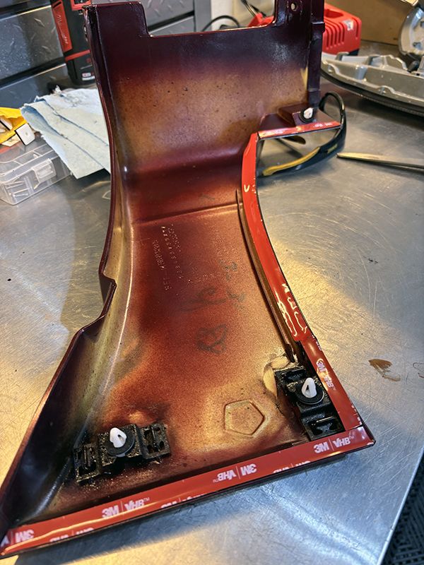

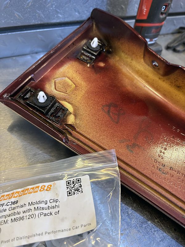

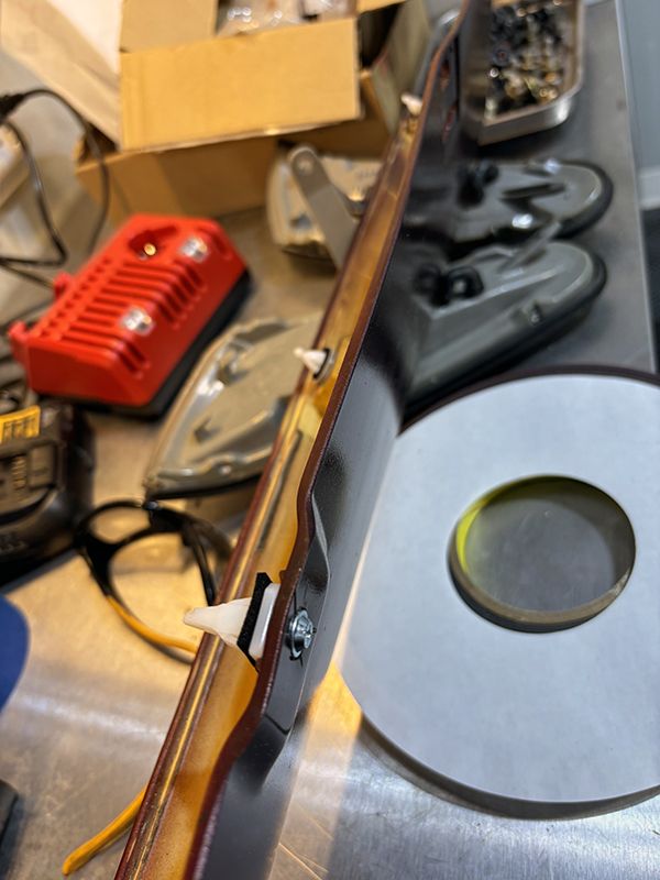

I had a lot of old tape to remove. I also cleaned up the inside of the trim pieces.

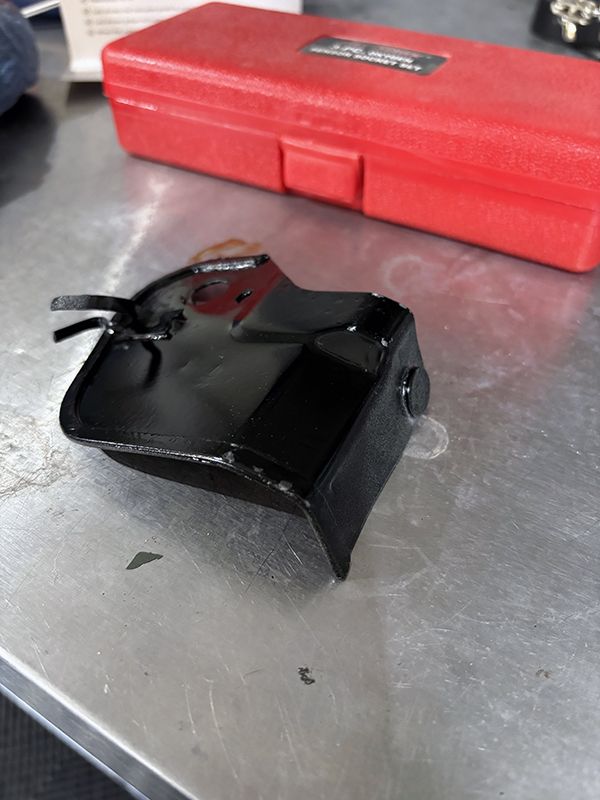

I used Eastwood's Rust Encapsulator on these metal brackets that hold the clip in place. If these rust out, I 'm screwed. then I installed all new clips/screws on all.
The installed new 3M moulding tape.

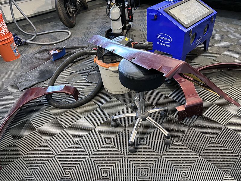

Body parts everywhere.

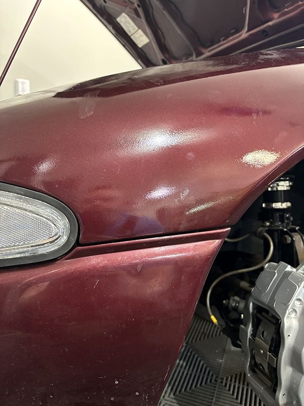

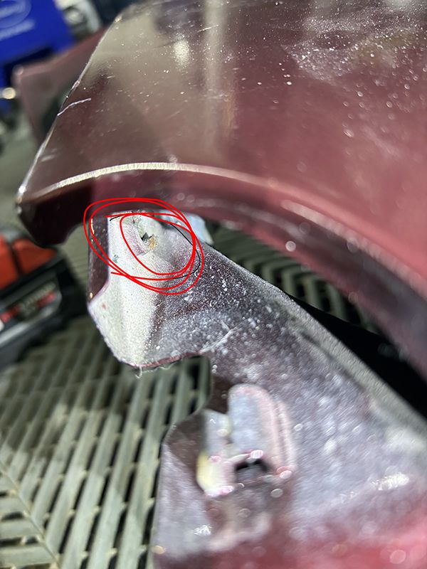

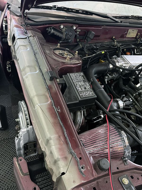

Not much of an update. Worked on getting the fender and plastics all setup perfectly. With 32 yr old plastic that has been warped over time, it wasn't fun. Having new clips in all the proper places made it difficult to line everything up the way it should be.

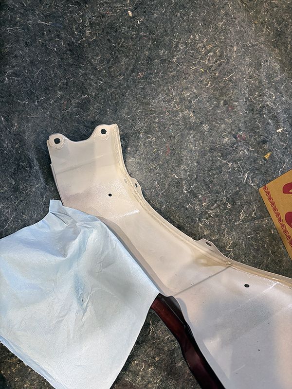

Primed and cleared the backside of the other fender since i had it off to replace the moulding tape.

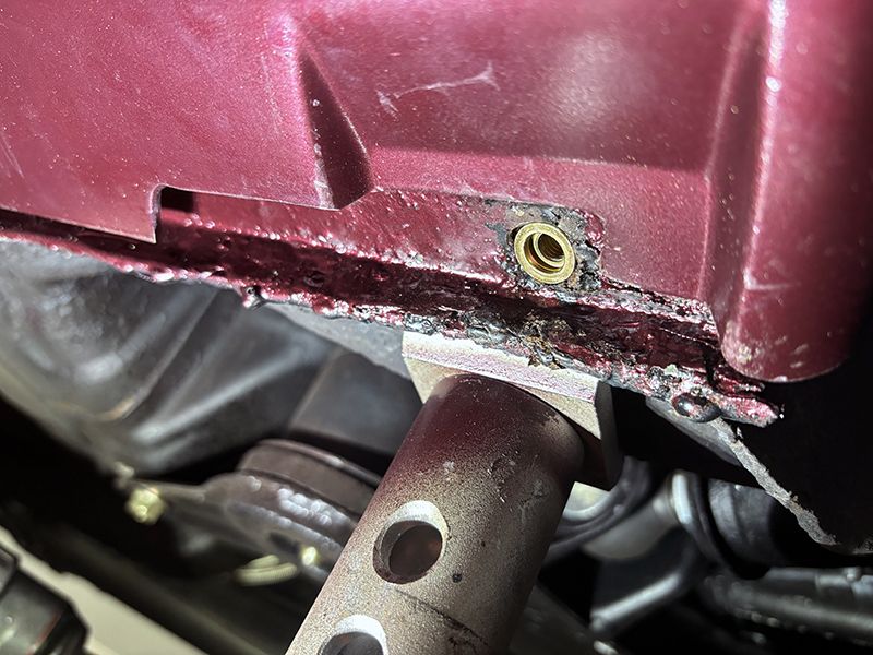

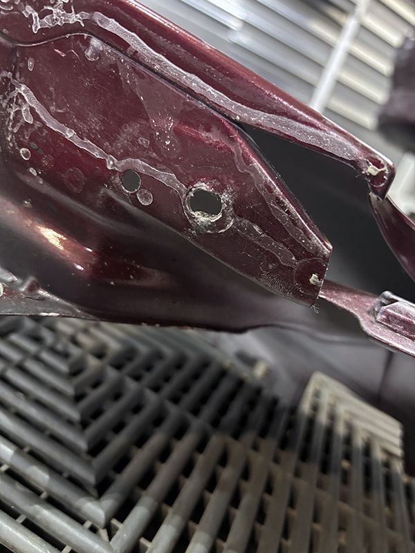

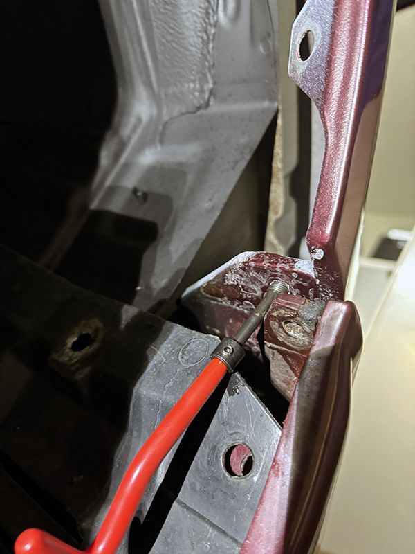

The driver's side fender proved more difficult to install for some reason. This bolt hole on the new piece I replaced was all messed up so I heli-coiled it.
Cleaned up the threads too on all the other holes. Lots of crud.
I don't think I've ever seen the bumper cover and fender line up this well before.

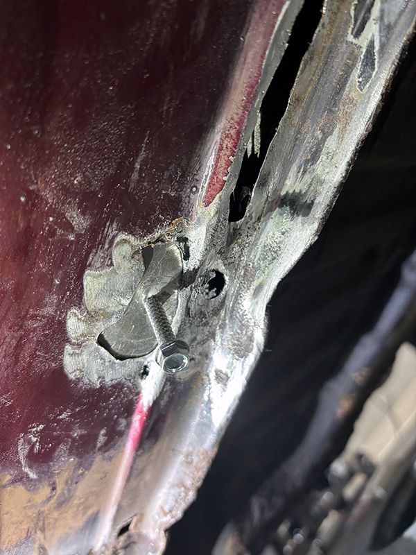

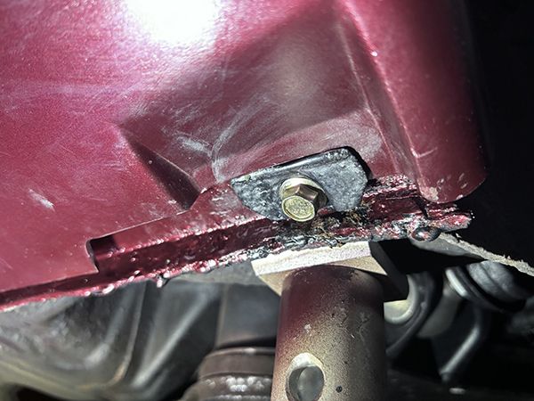

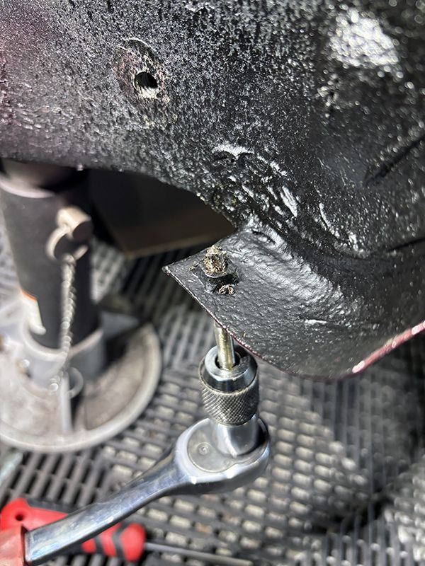

This week started off just trying to get the fenders and body work put back on, but turned into repairing bolt holes left and right. Had to helicoil some fender holes and rivnut some others. for some reason, they were all messed up. On the passenger side, one bolt was barely hanging on.
Yu can see here that some of the holes were all widened and worn out. the reinforced stock threads were broken essentially on the back side. this really messed with the fitment, so needed to be corrected. the ones where the threads were screwed up I just used helicoil. the ones where the holes were all messed up, I drilled out and used rivnuts.

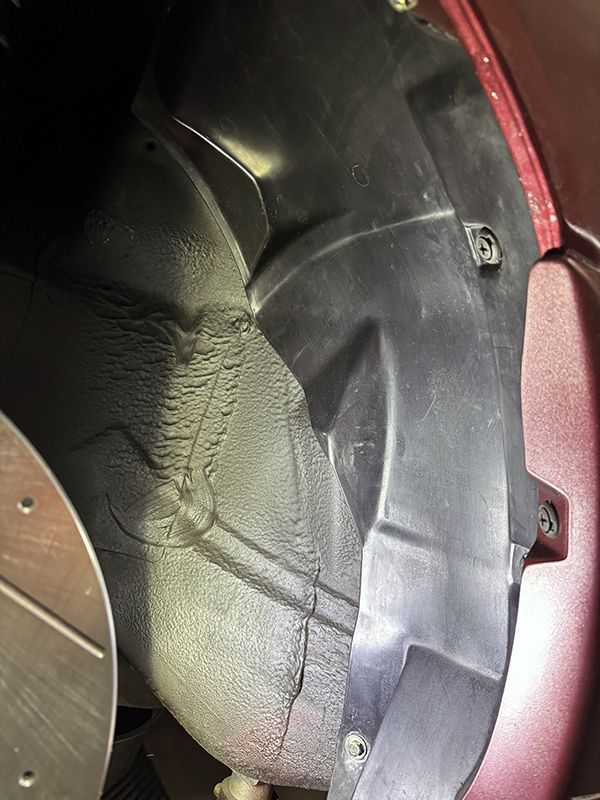

After that, I got the fender liners reinstalled. For some reason, I just hate doing this. It's simple, but damn it's annoying to do.

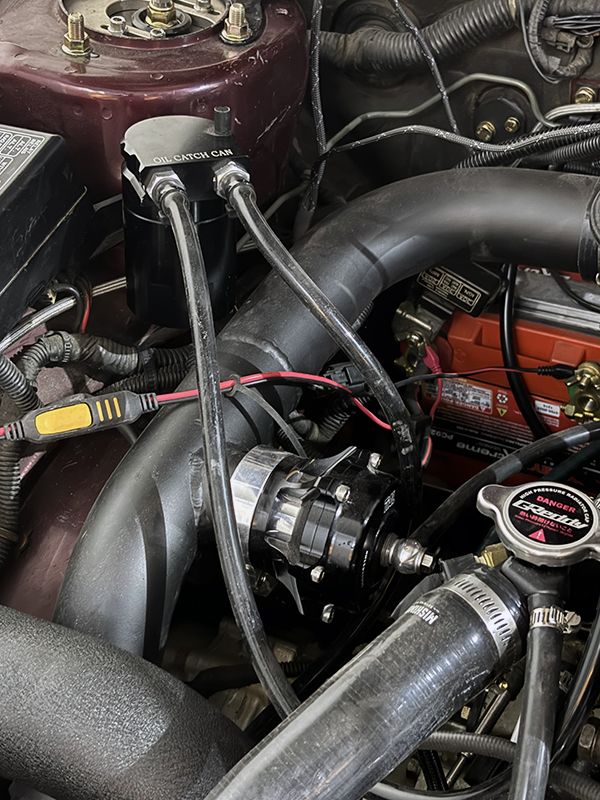

I remembered I needed to reinstall my oil catch can and strut tower brace too.

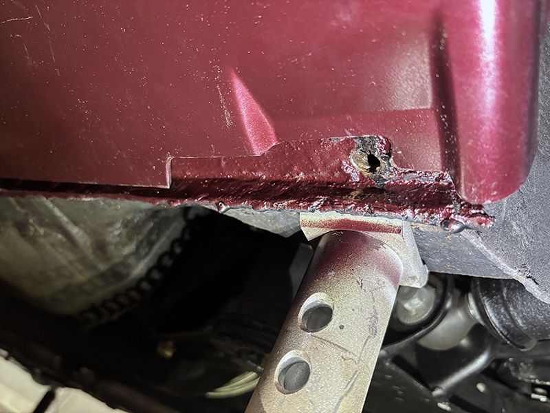

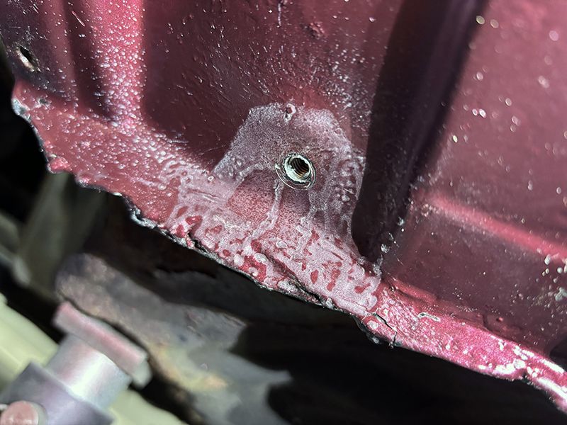

Next up, I realized I had a bolt that broke off when I was removing the side skirt. didn't even look like a viable bolt hole location anymore so I drilled it out and installed a rivnut to make it like new again. This little metal piece is pretty worthless. I'm not sure what Mitsu was thinking here. It BARELY even does anything. If they would have made it a bit bigger that would have made it worth it, but whatever. It's reinstalled anyway. As u can see in the pic, the one corner is "holding down" the plastic part of the side skirt...and it doesn't even do a good job of doing it.

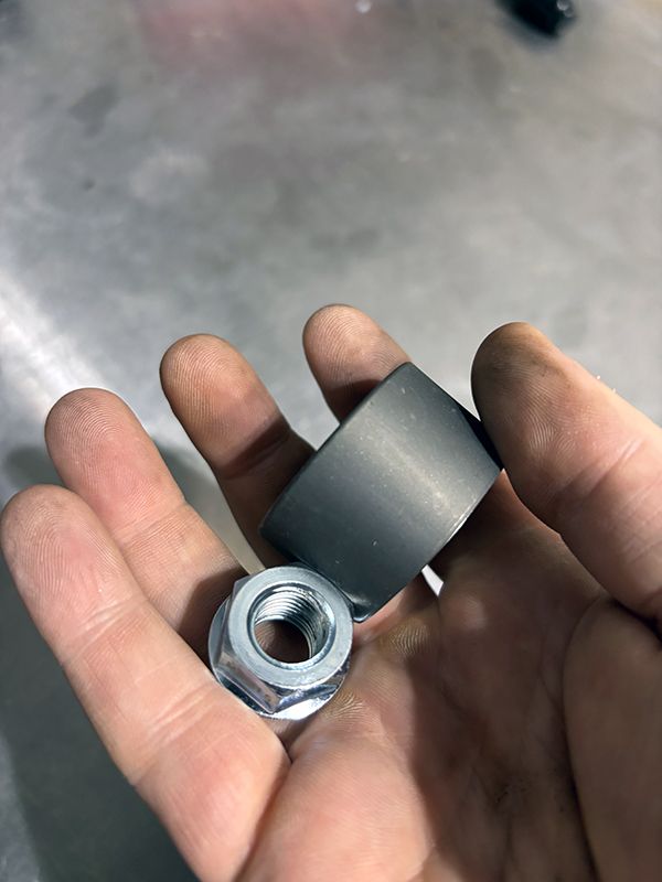

While I was wrapping all these loose ends up, I realized I only get about 4 threads on my front lug nuts, so just to be safe, I ordered some extended wheel studs and new lug nuts for the front. I'll get those installed next weekend.

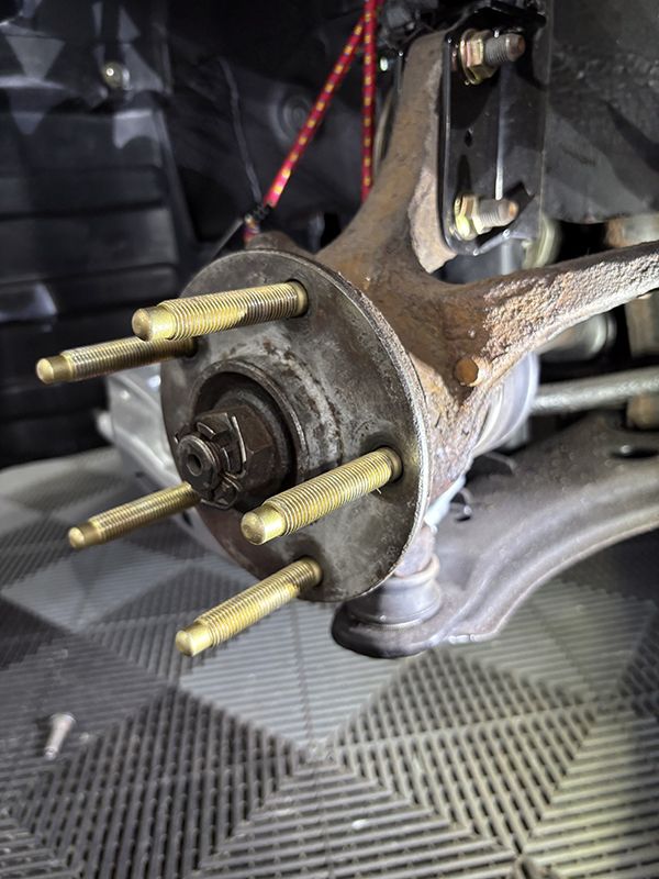

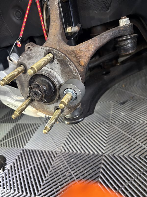

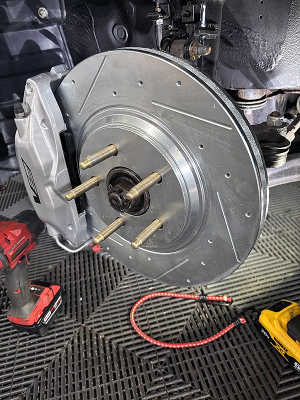

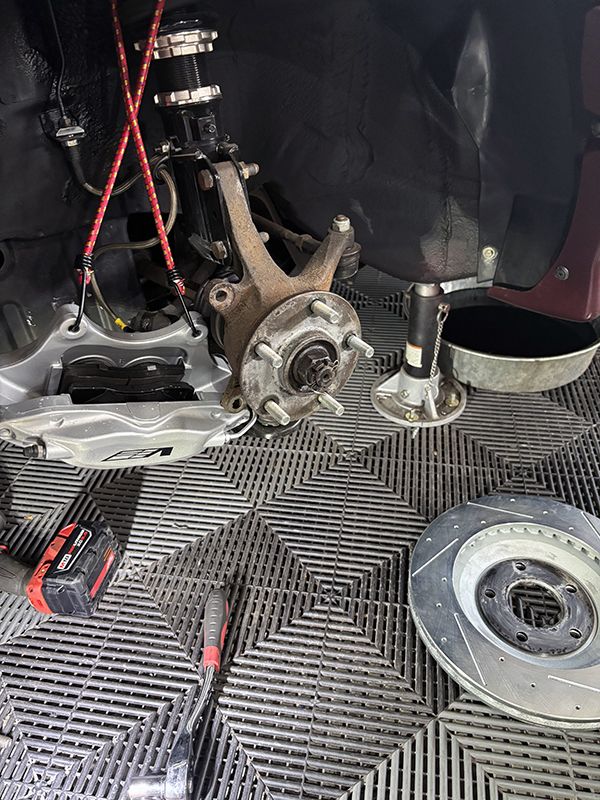

This week I had a goal of starting the car and getting the wheels on. Last time I mentioned I only had about 4 thread engagement on my front wheels. As a result, I ordered lengthened ARP wheel studs and new lug nuts. I ordered a couple pair of lug nuts and neither of them worked. One didn't fit in the stud hole and the other wasn't long enough (closed end). I have a couple more styles on order. I'm not a fan of open-ended but I ordered some as well as some more closed-ended. We will see what works and what I like.
First thing was to remove the brakes (again) to remove the stock studs and install the new ones.

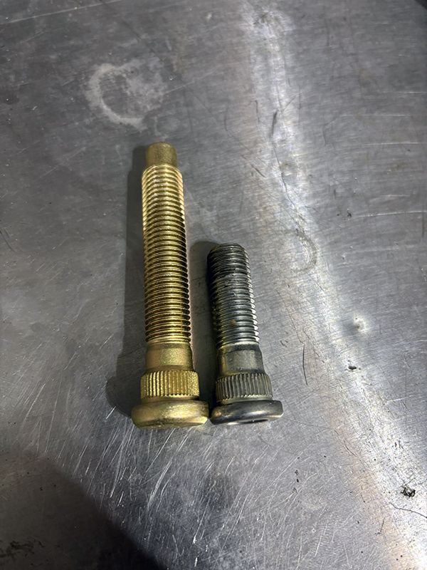

Here's a stud comparison. Our studs are M12x1.5 btw. The ARP studs I have are part # 100-7717
I also ordered a stud install tool to try out so I don't have to use the washer method. For only about $15, this thing is well worth it. Made stud install super easy.

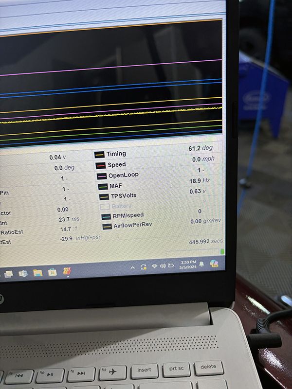

After that I made moves to try an engine start. I made sure my throttle cable was nice and tight (not too tight) and decided to adjust the TPS as well. To do that I use DSMLink and log TPSVolts. You want .63V. My method is to push the accelerator pedal all the way in, release it all the way. Adjust TPS, then do TPSAdjust in Link. Rinse and repeat. I didnt need any adjustment with TPSadjust as I had it right on. .63v with throttle plate closed and 5.00v with WOT. Perfect.

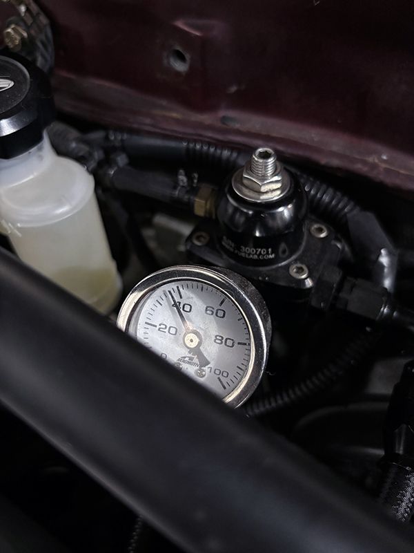

Next I wanted to check base FP. Also did that in Link. Base presure for a 1G is 37psi, so I started there.
When I started it, idle shot way up to 3k and stayed there. With some tweaking in Link I got it down to a steady 1700rpm. I'll need to tweak some things and do a boost leak test next weekend to see what I can find.
