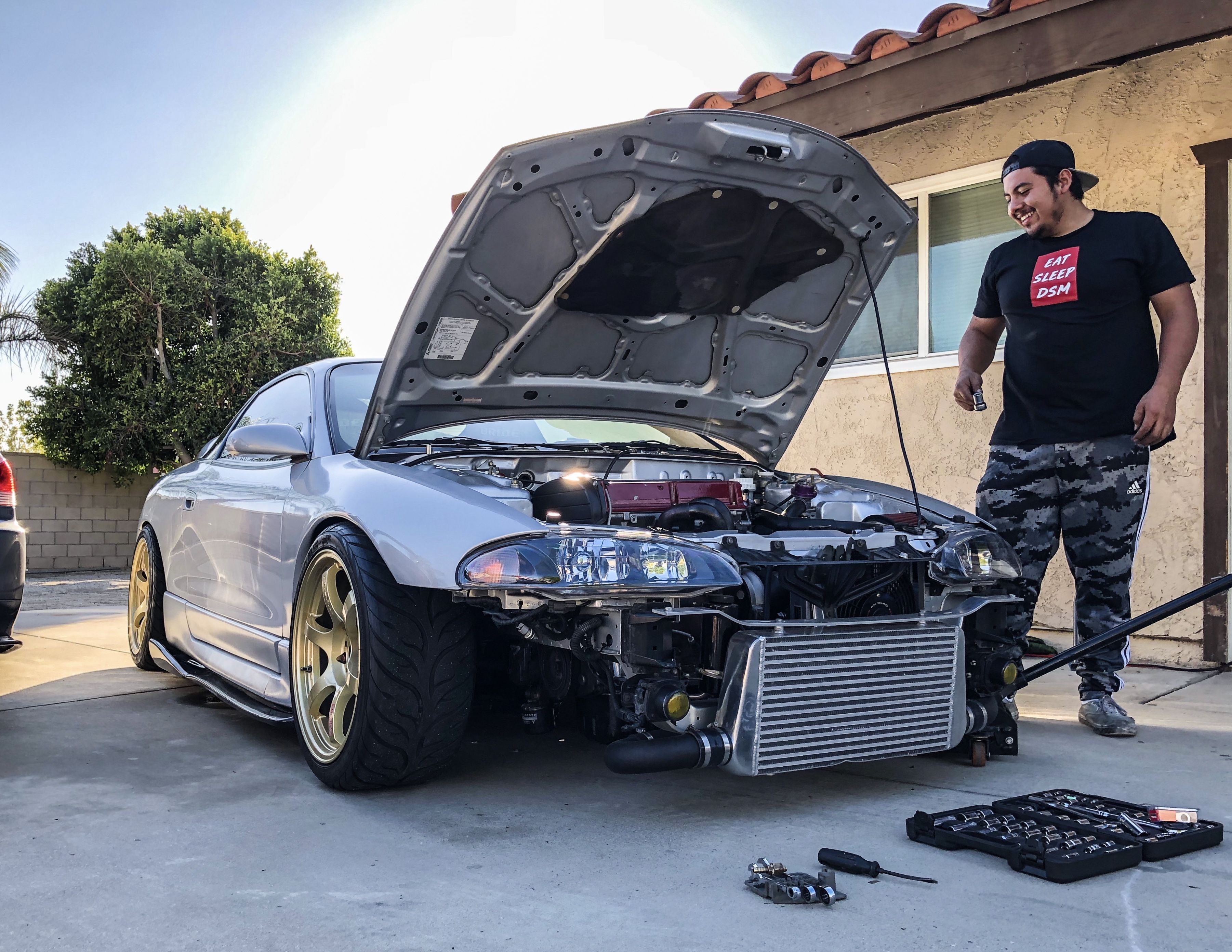

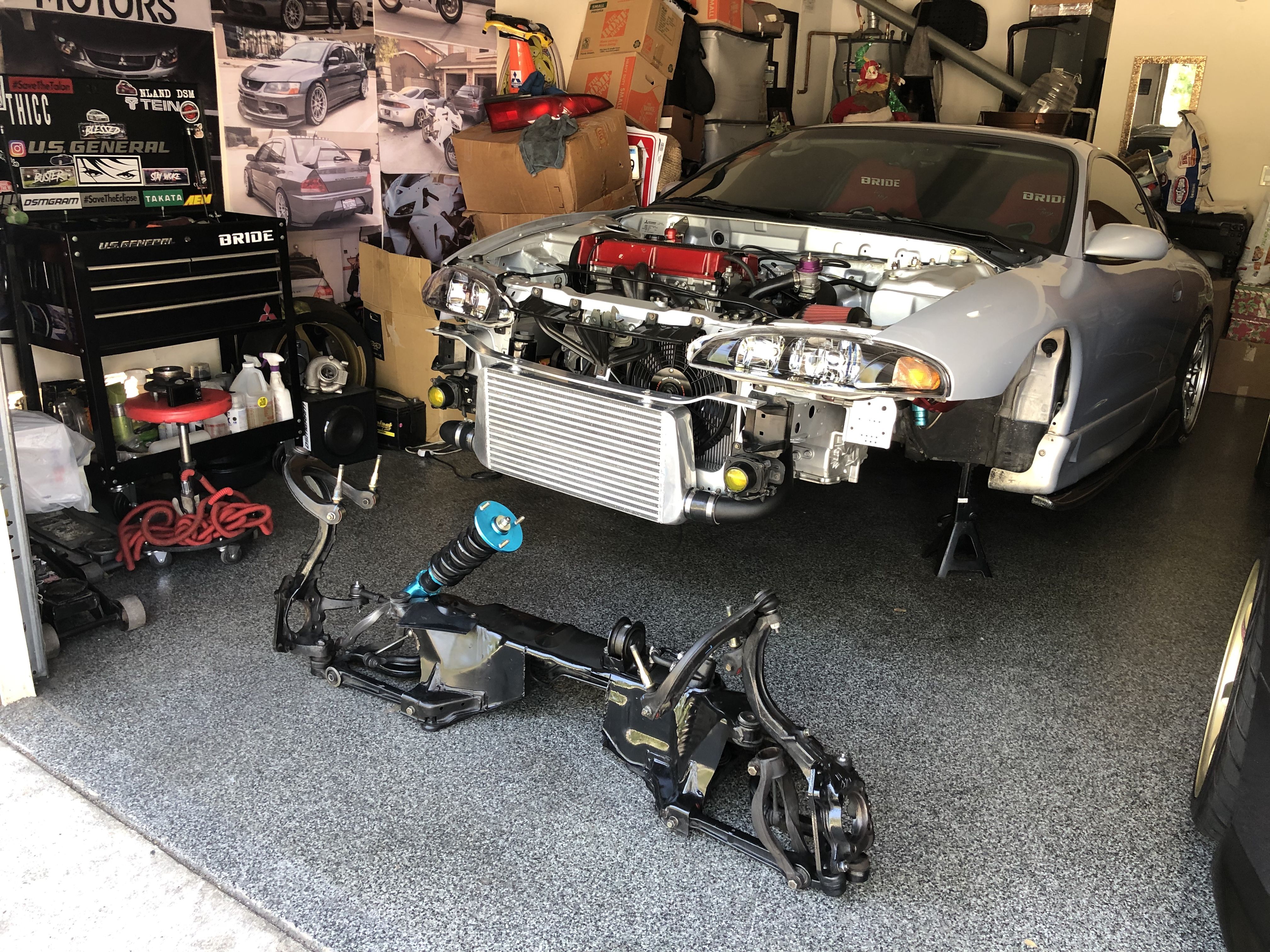

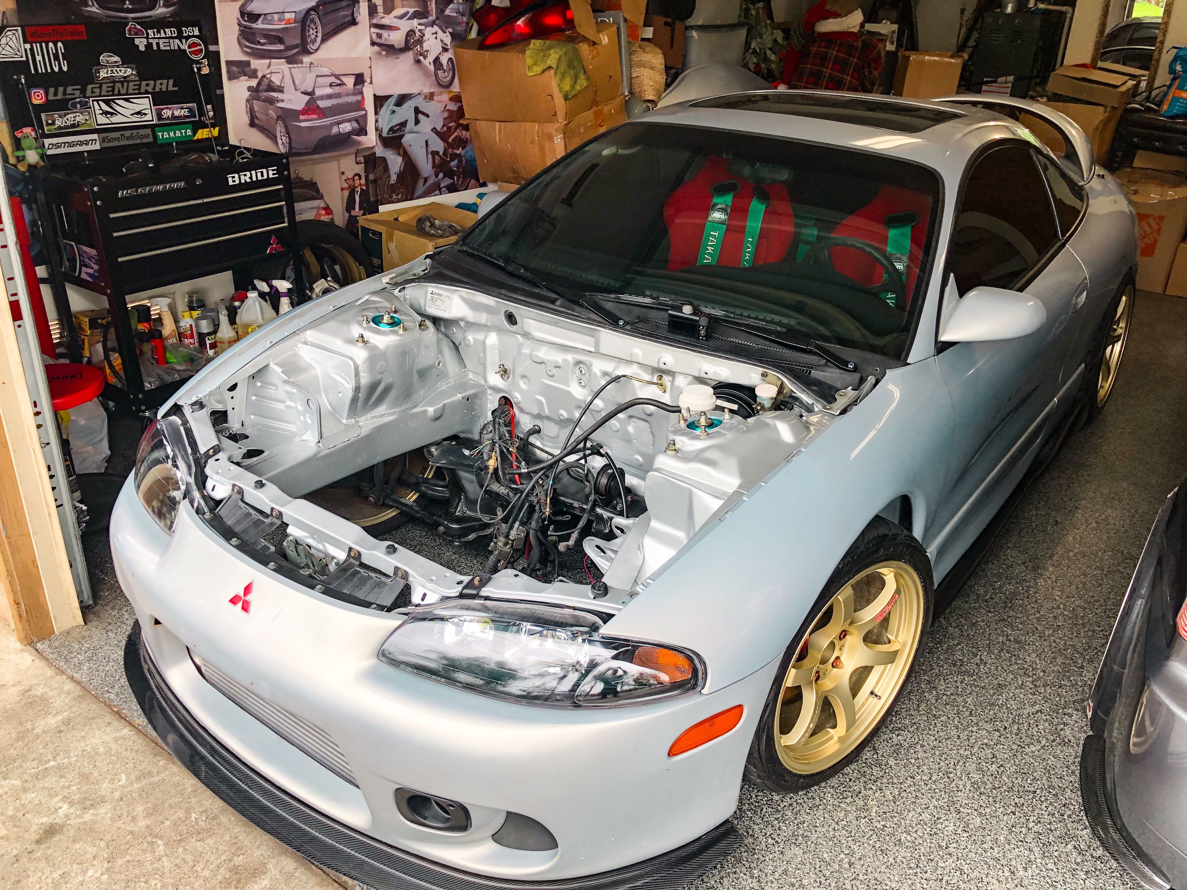

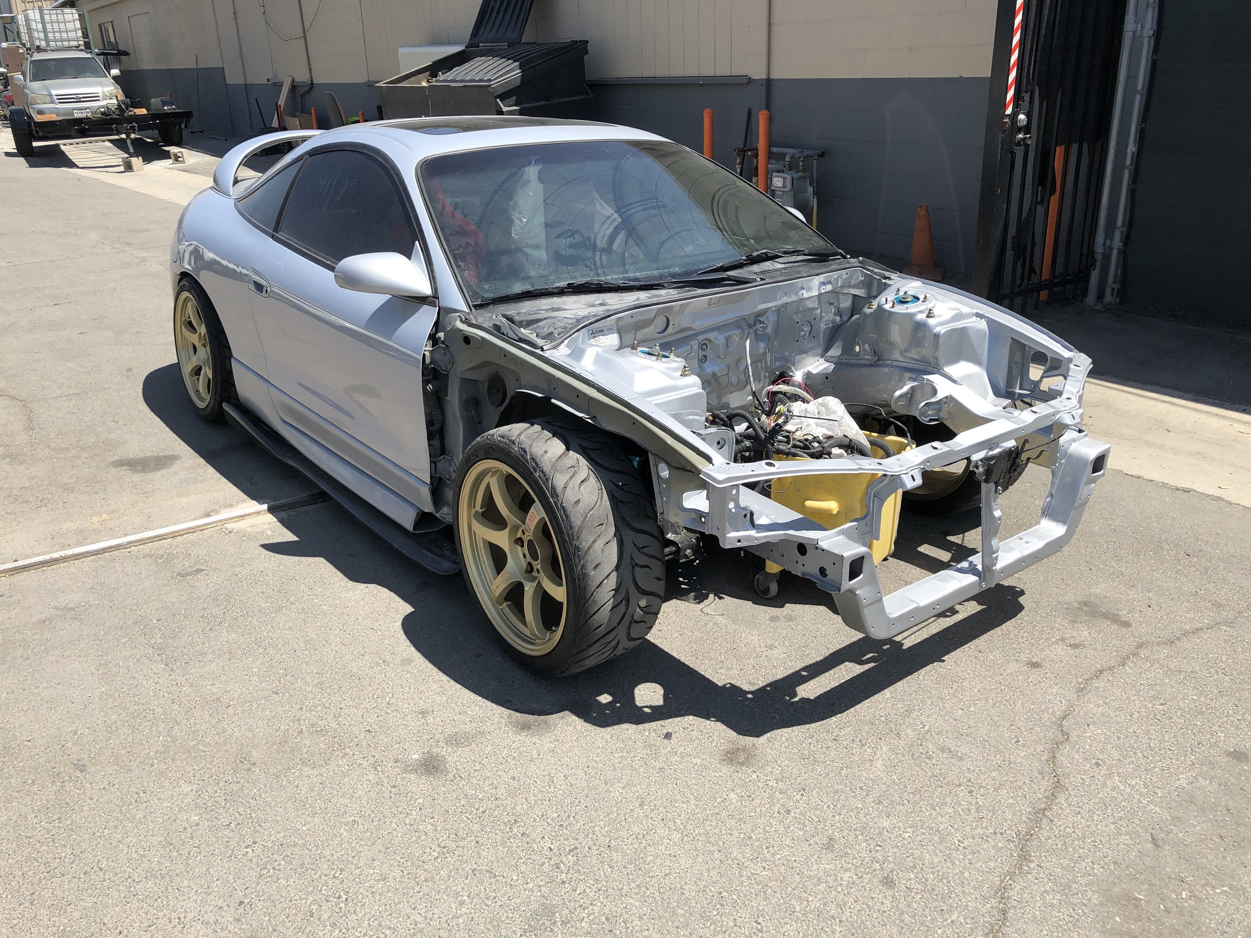

We have since then
- SHAVED & PAINTED ENGINE BAY
- INSTALLED MOTOR & EVO TRANS W/ TRANSFER CASE
- CUT SUBFRAME TO FIT TRANSFER CASE
- INSTALLED COMPETITION STAGE 3 CLUTCH & FLYWHEEL
- REINFORCED FRONT SUBFRAME
- INSTALLED SUBFRAME
- INSTALLED 3G ECLIPSE SHIFTER BASE AND LINKAGES
- SWAPPED WHEELS WITH EVO TEMPORARILY (ENKEI NT03)
I also just bought some evo 6 axles as the evo 8 ones do not fit the dsm wheel bearing with a 25 spline count vs the 32 on the 8/9
We had to run a 3g eclipse shifter base and linkages as the stock ones do not suffice with the new evo trans.
I also got a custom made harness made for the car to wire tuck real soon!

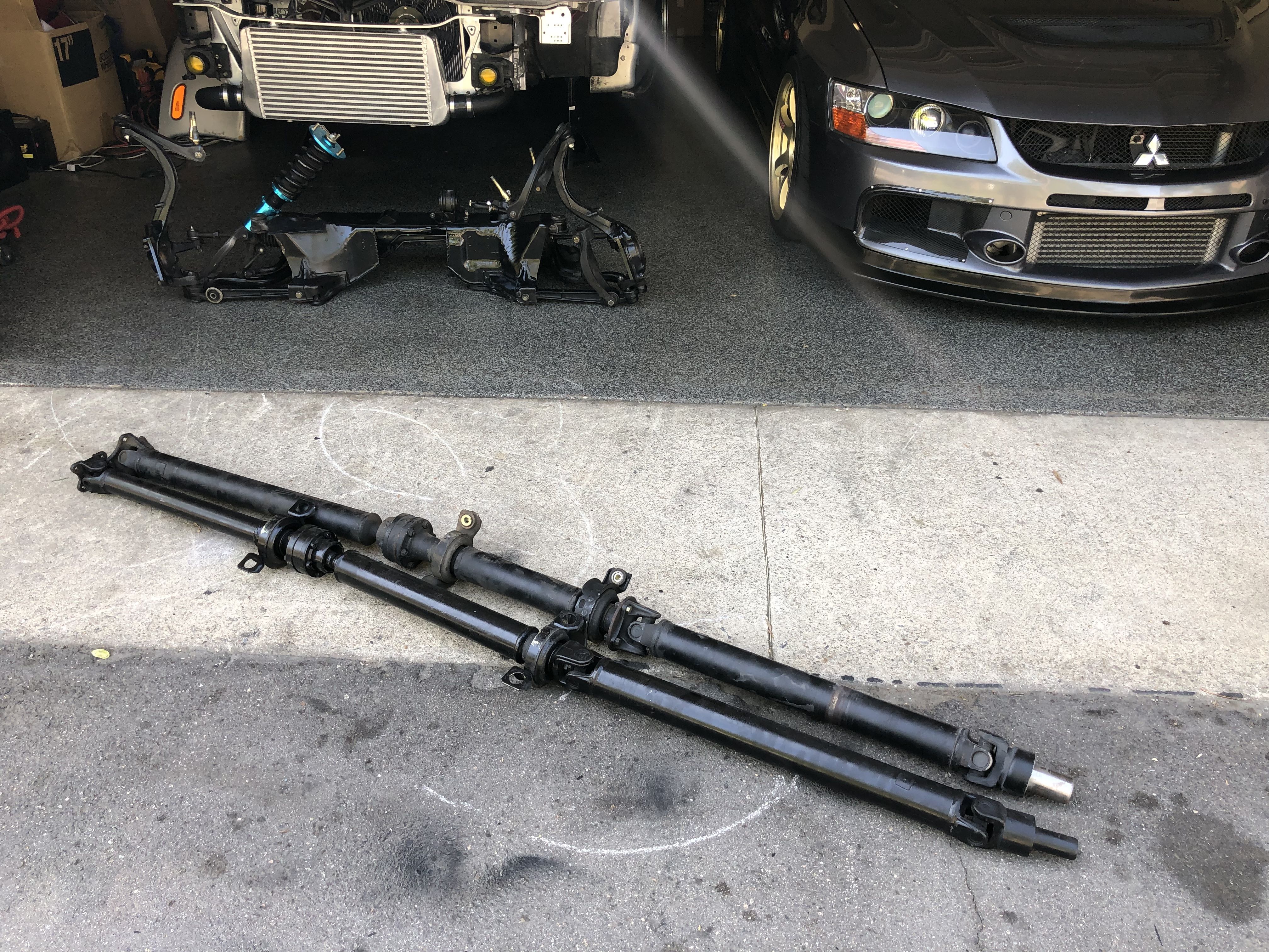

We test fit both a gsx drive shaft and evo 8 drive shaft and both didn’t fit. They are too long and we will be cutting the gsx one at a drive shaft shop with the appropriate attachment up front to fit the evo transfer case.

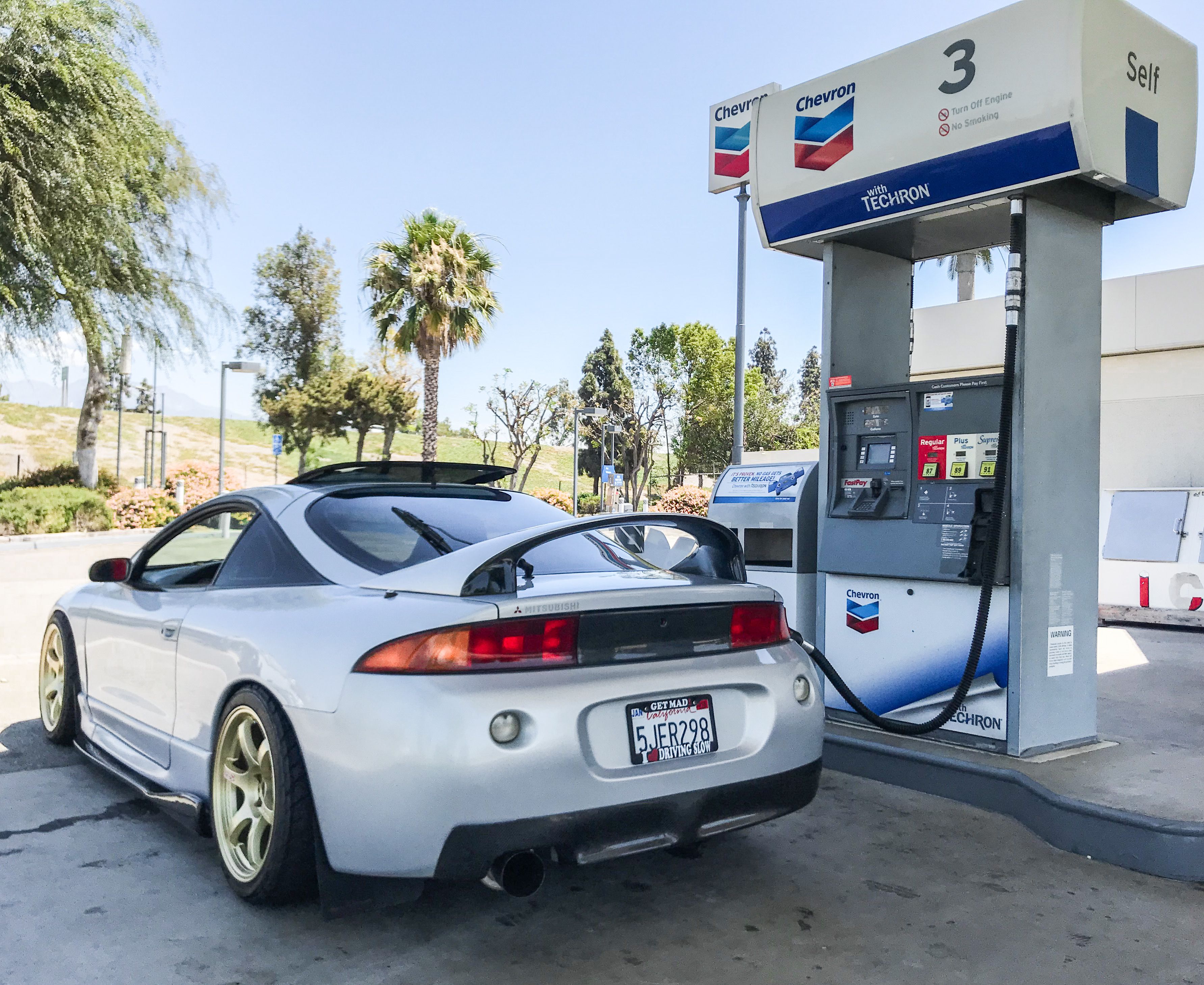

And just like that she’s back in business! We managed to have it back and running on the streets as the worlds first AWD evo swapped dsm! We used nothing but evo & gsx parts for the swap (no legnum/galant parts)
I apologize in advance as the build thread is not detailed on how to do it. I’ve been uploading everything on YouTube for documentation and for the visual learners. I’ll include the latest video down below where it runs on its own for the first time!
I’ll be making a full In depth video on how to do the swap with a full check list for all the future evo swapped dsms!
if you would like to see more of the car I’m always posting it on Instagram and YouTube @Miguel_Dsm
I want to give a huge thanks to anyone that gave some helpful advice and helped with the build!

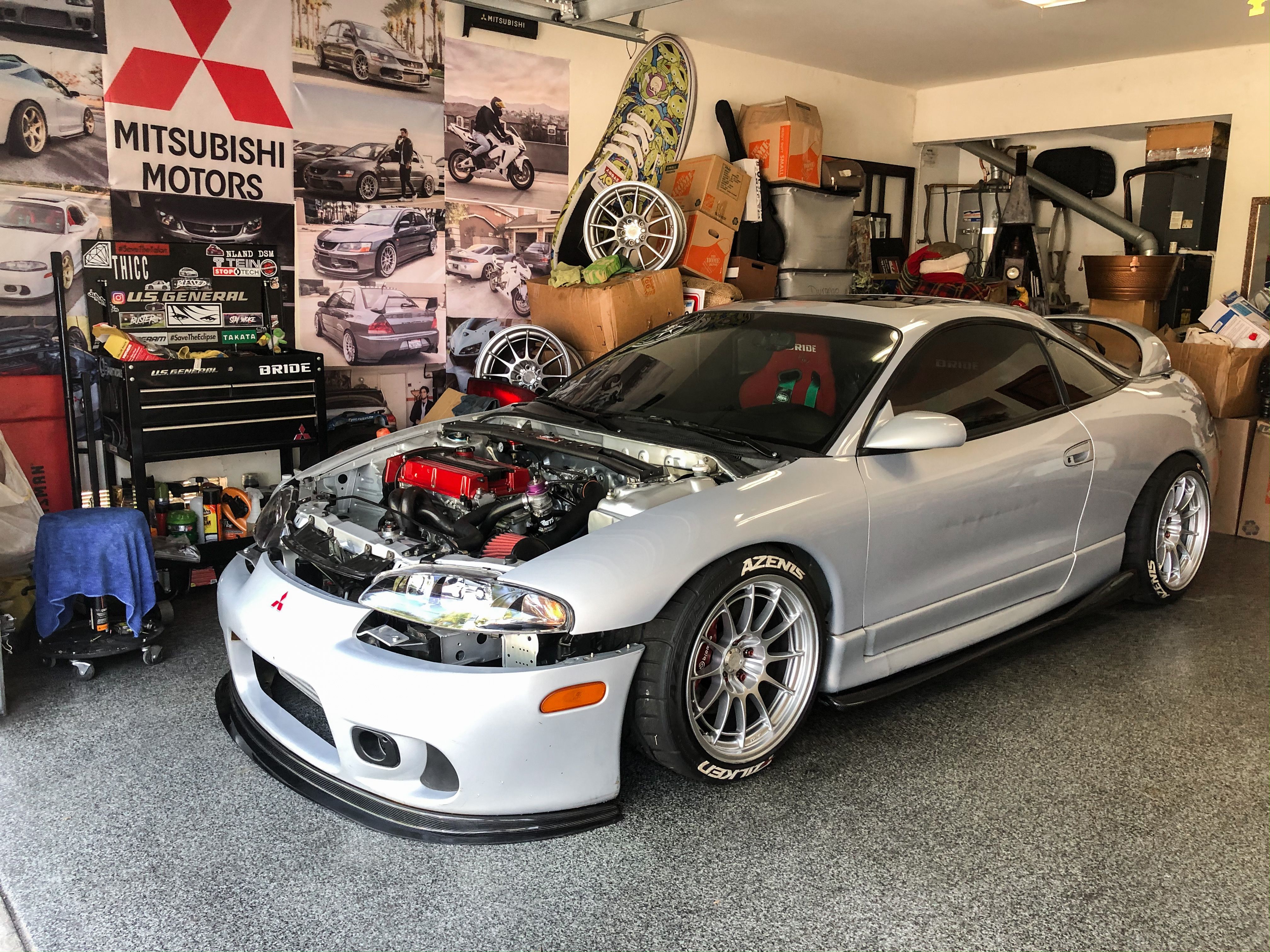

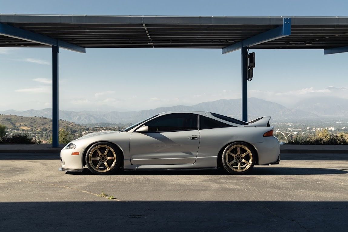

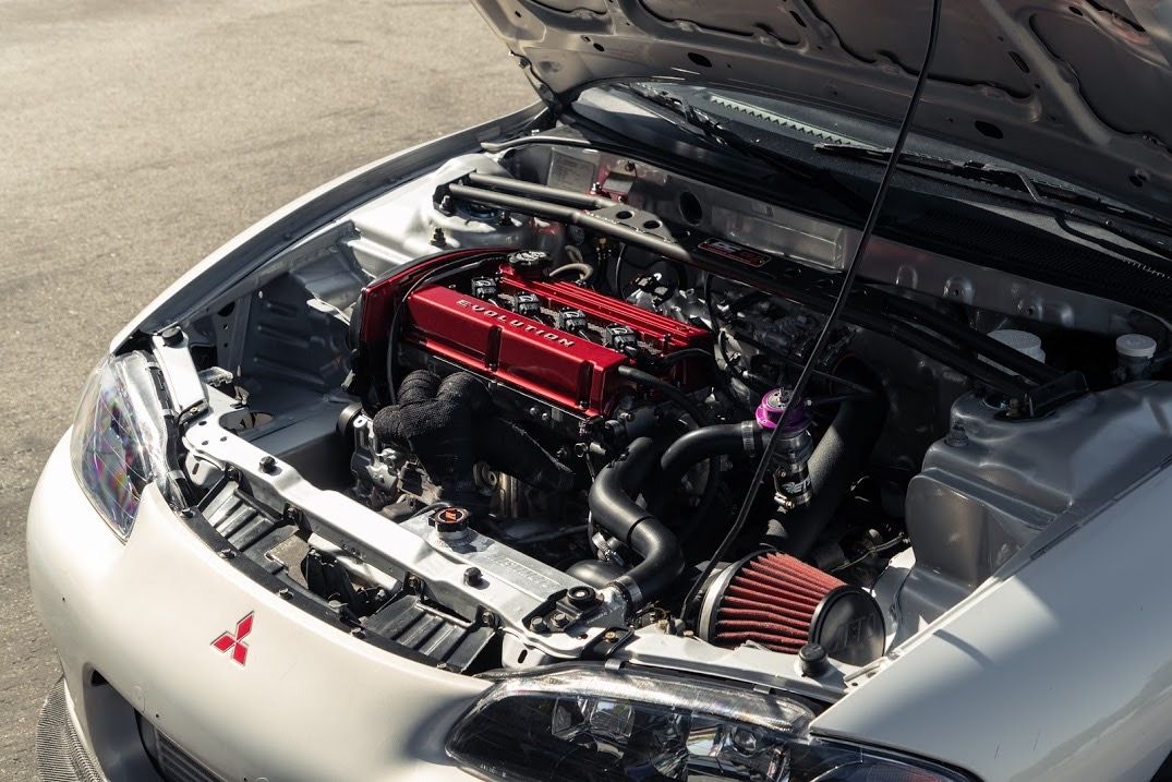

Hey guys!
A lot has happened with the DSM since it’s been running! It was featured on Super Street Magazine on June 2020! Unfortunately it blew a head gasket due to failing fans and over heating..
http://www.superstreetonline.com/features/dsm-mitsubishi-eclipse-evo-awd-swap
It has been back up and running since then & getting close to it’s E85 tune day on an AEM stand alone ecu, in hopes to break the 400WHP mark on the stock Evo 9 turbo.
It’s been such a fun build thus far!
I’ll link the super street feature video below for you guys to check out

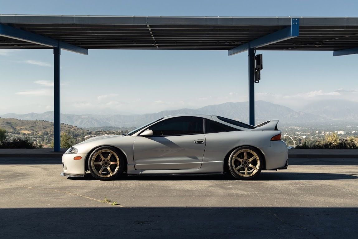

View attachment 607418 View attachment 607419 View attachment 607421 View attachment 607422 View attachment 607423 View attachment 607426 View attachment 607427 View attachment 607428 Hey guys!
