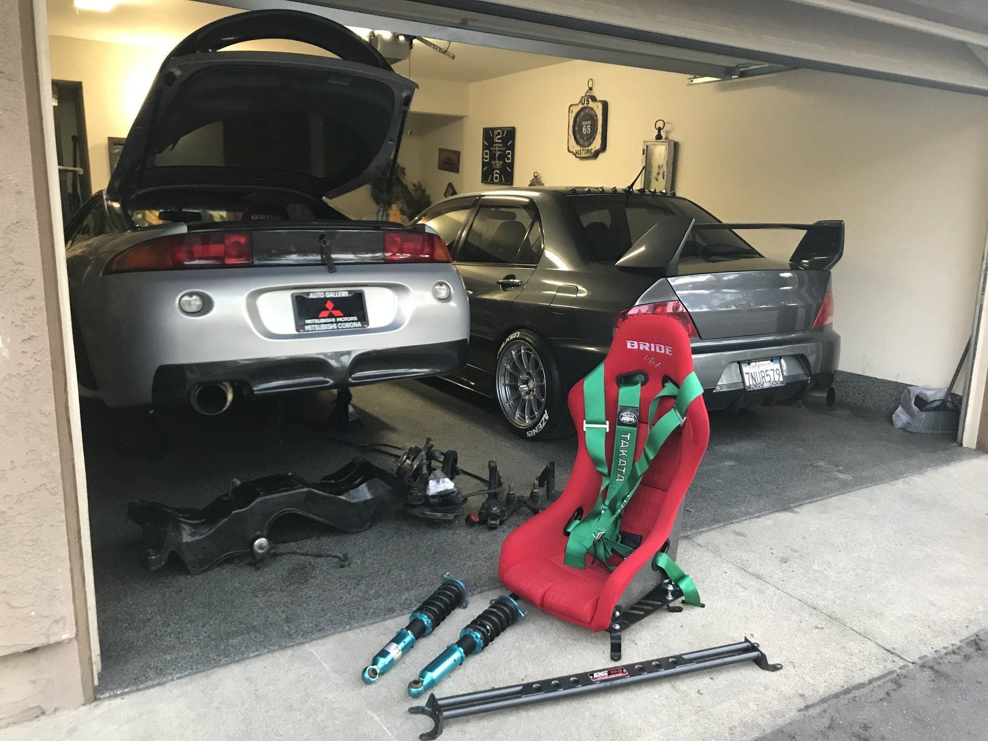

It’s been almost two years since I last posted on this build thread! The car has been great since it was evo swapped and has given me minimal issues! The 2g has gotten many new parts since then, including a Carbonetics V2 carbon hood and authentic Bride Low Max bucket seats
Over time, it’s been clear the 3g trans can’t handle the power and my Clutchmasters clutch is starting to slip at WOT.
I think it’s time to AWD swap this eclipse and bring this build thread back to life.
I went out yesterday and picked up a 95 gsx gas tank, subframe, rear knuckles, axles and differential.
Next step is figuring out if the Evo transfer case will line up to the Gsx differential in the back.
I’ll keep this thread updated as I gather more parts and take the car back apart.

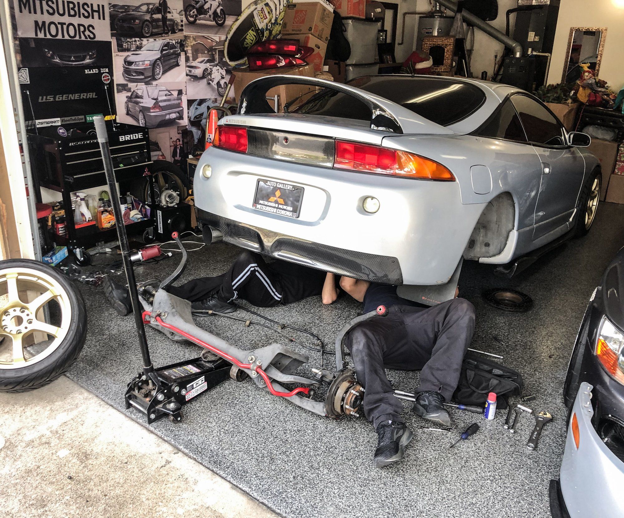

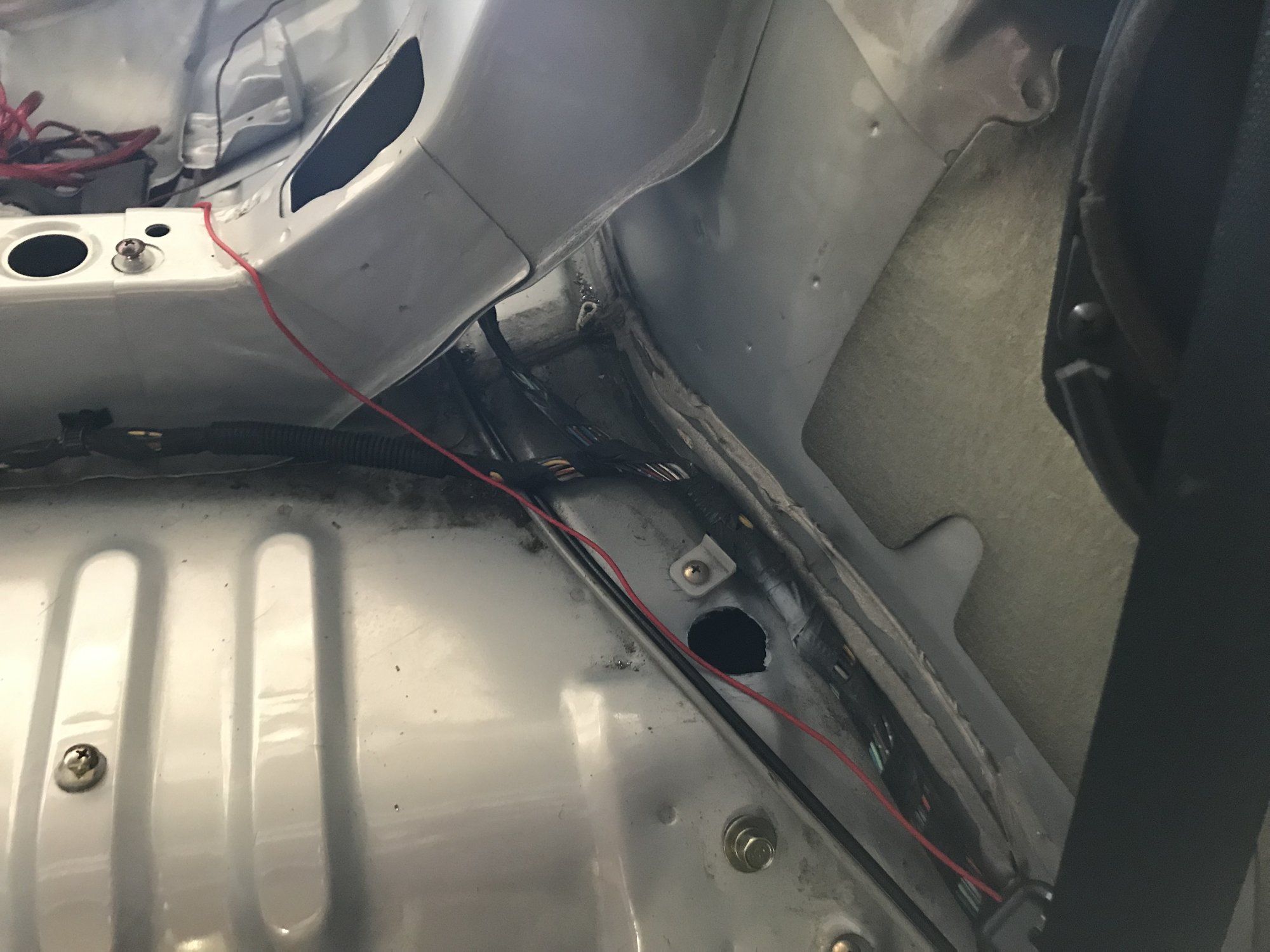

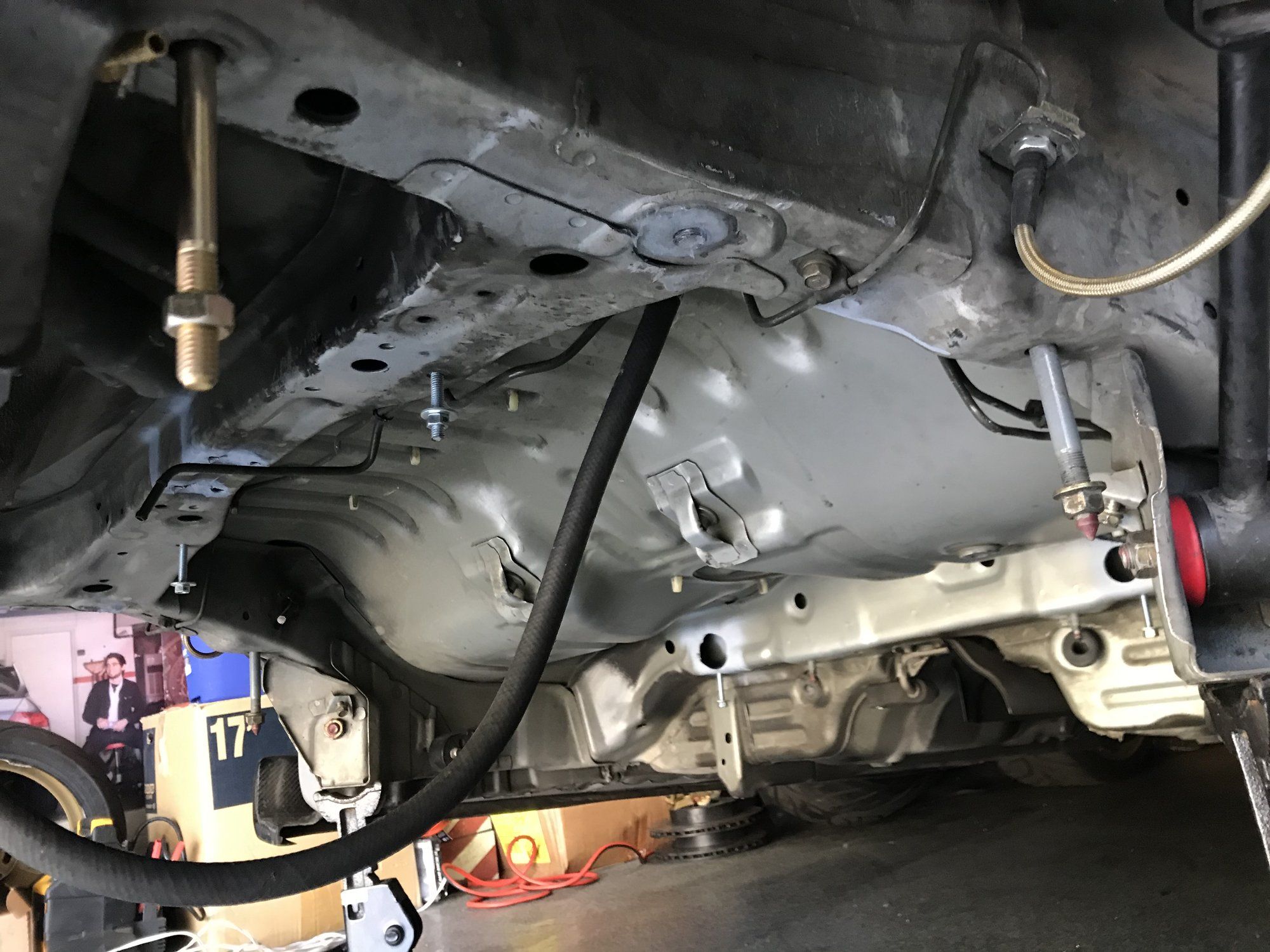

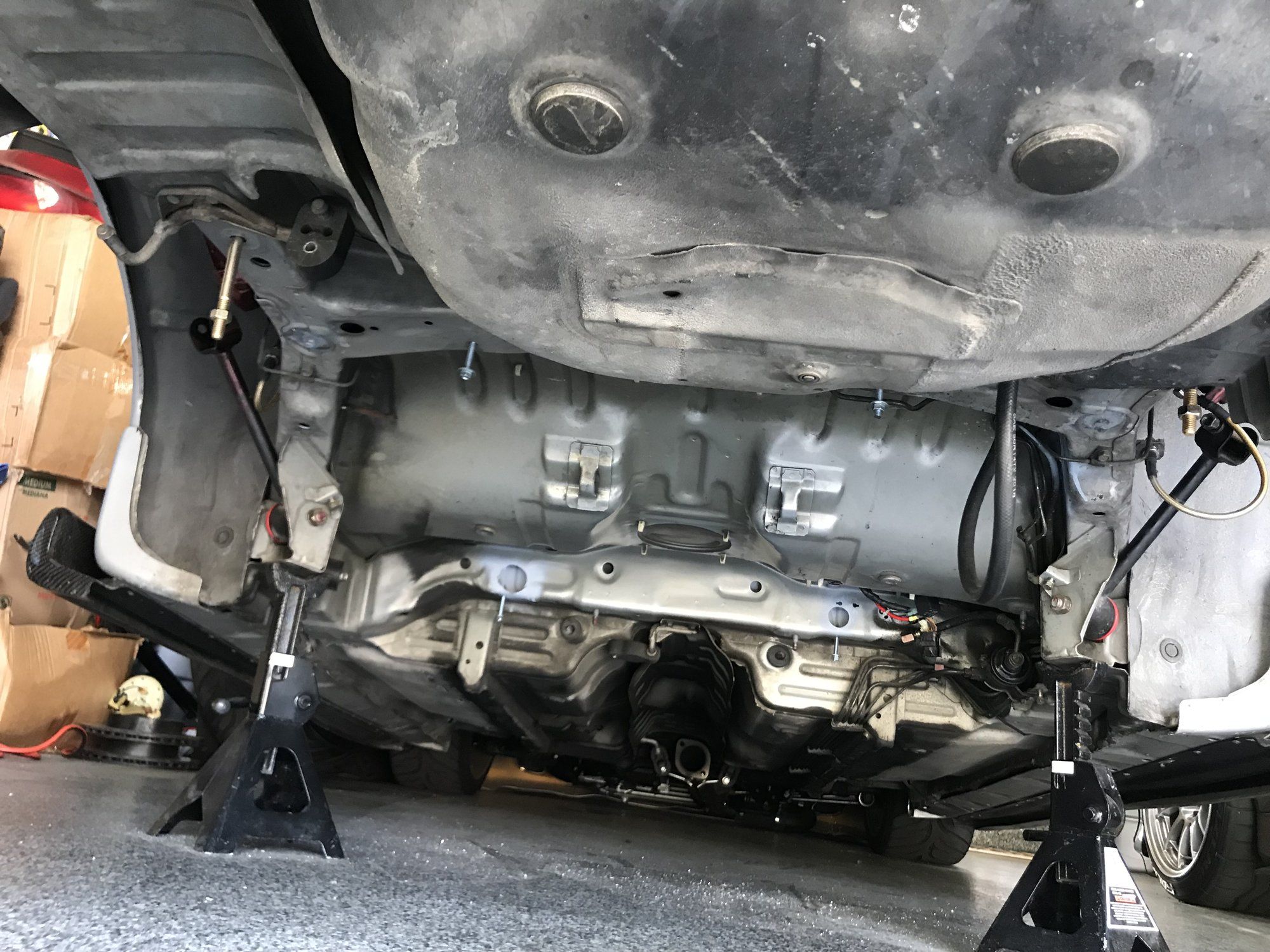

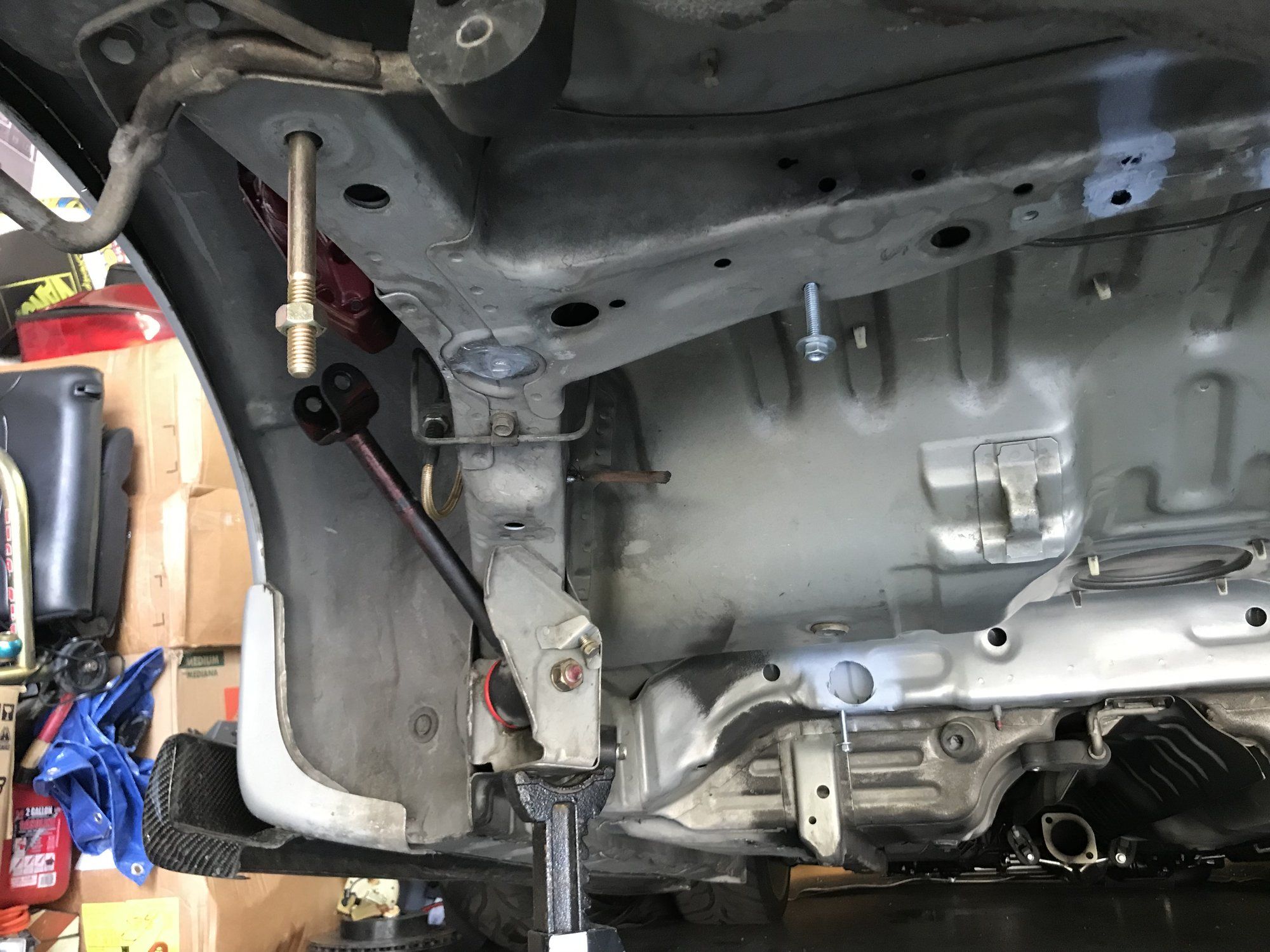

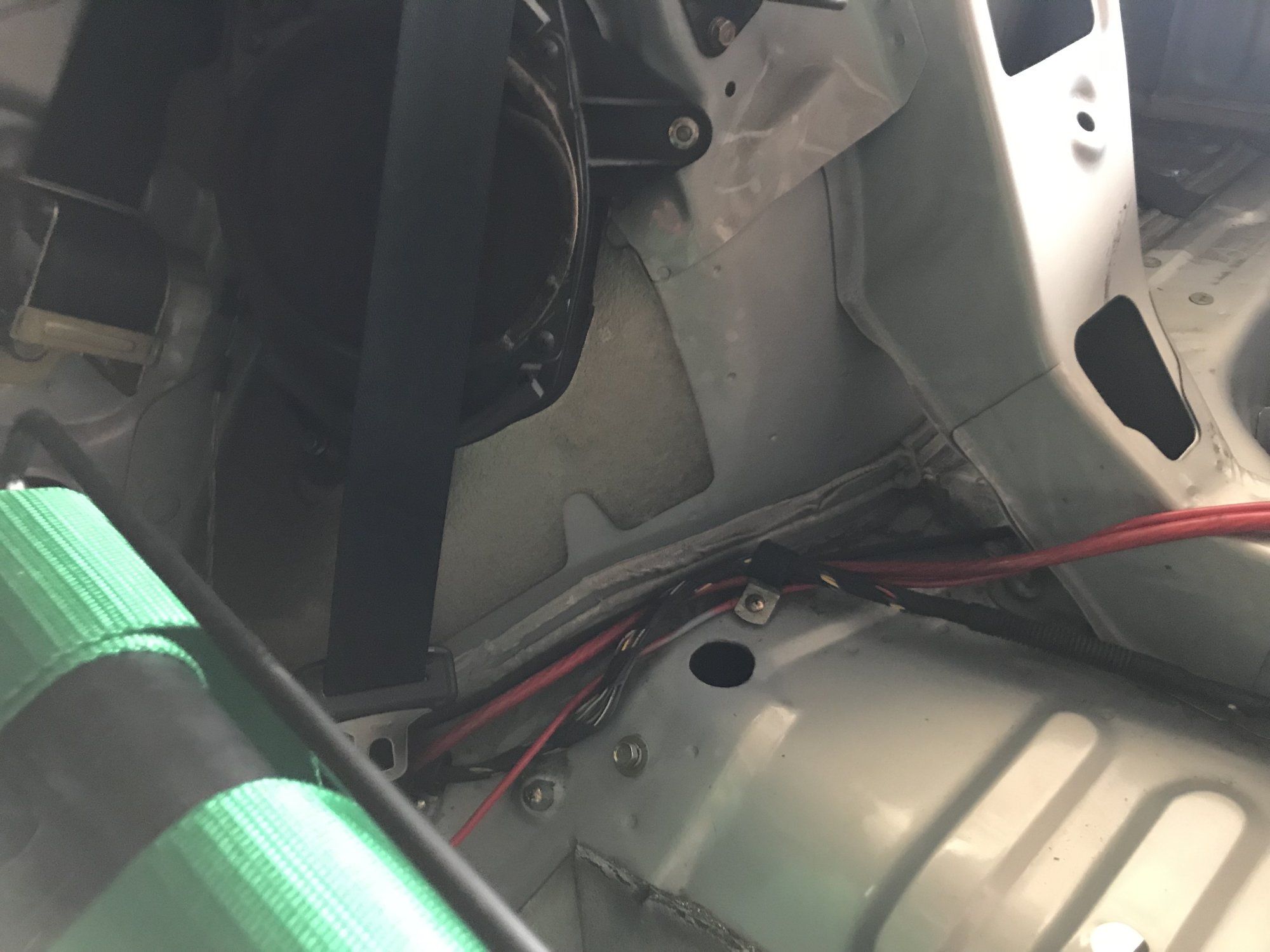

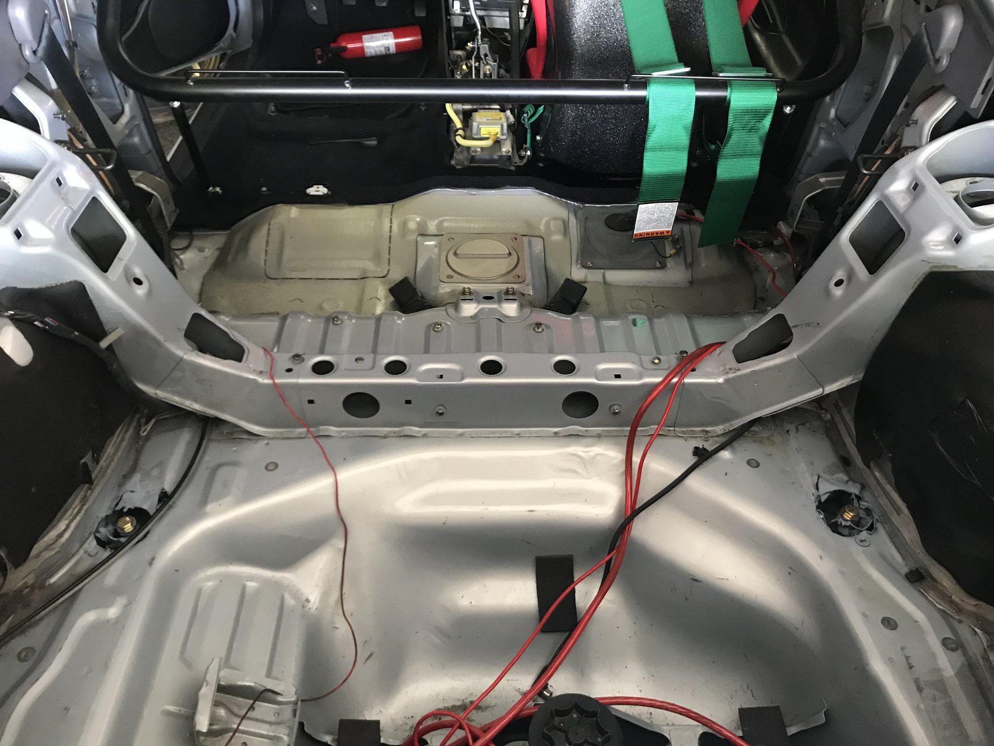

Got the car on jack stands and fully removed the fwd gas tank and subframe. Cleaned up the awd components and started cutting into the chasis for the awd subframe and gas tank holes.
For the people wanting to do this in the future, your rear end work will be the same as the Gst to Gsx conversion! There’s countless threads on how to do that so it should be easy. Only difference is you will need the AUTO GSX rear differential (JFH) with the 3.307 gear ratio to match the evo transfer case up front. I’ll post this link here for a quick reference.
http://www.vfaq.com/mods/2G_FWD_to_AWD_Conversion.htm
For the visual learners, im also documenting the whole swap on Youtube (Channel: Miguel Dsm). Ill post the link of the latest video below! Cheers! :dsm:

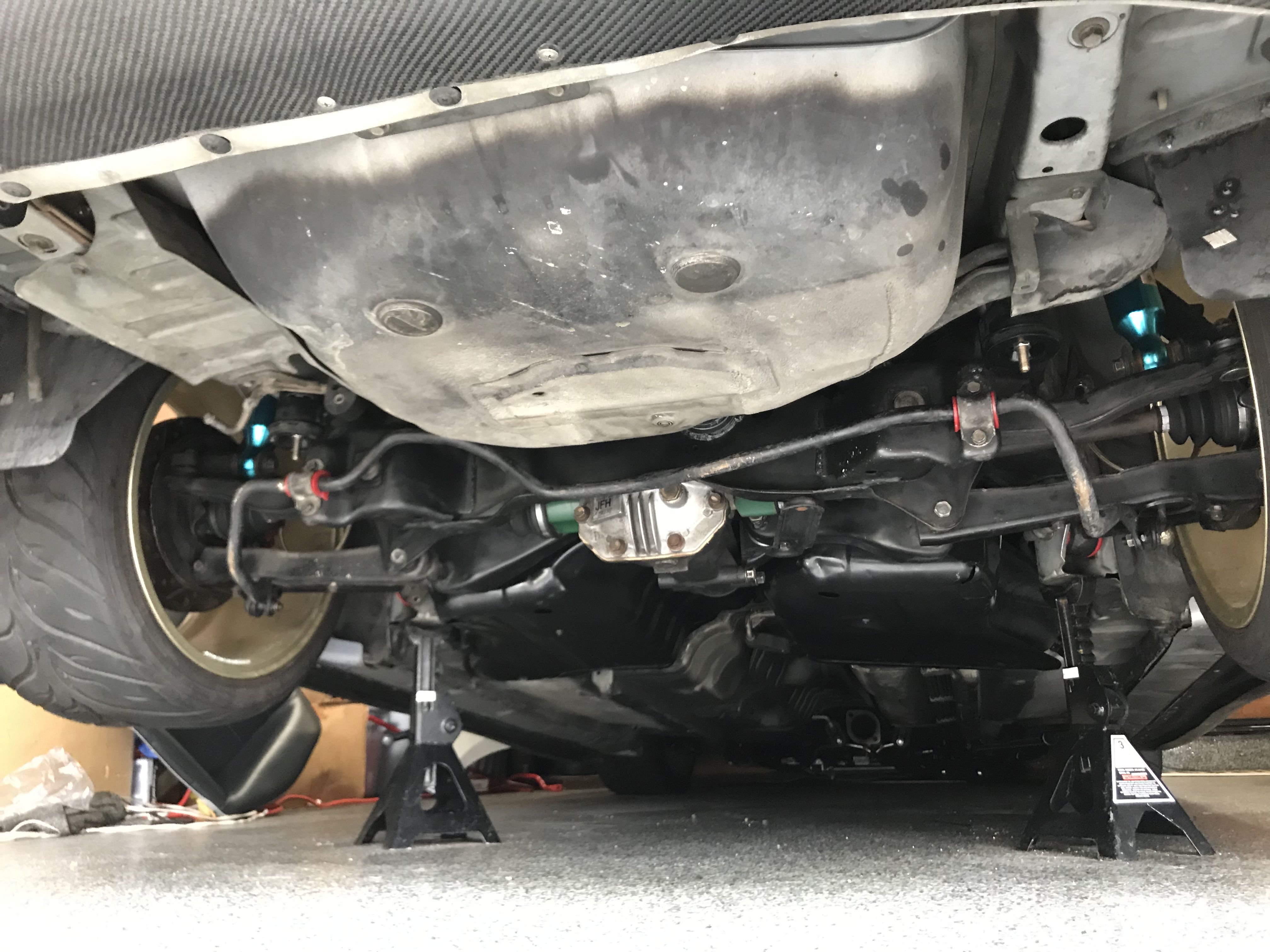

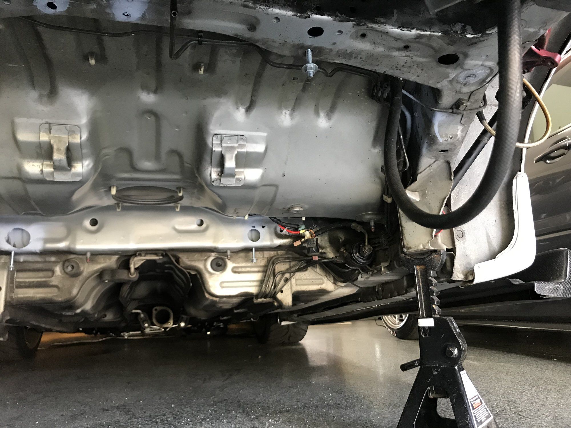

Quick update! The Dsm officially has a full GSX rear end! Only needs the drive shaft and drive shaft hangers installed.

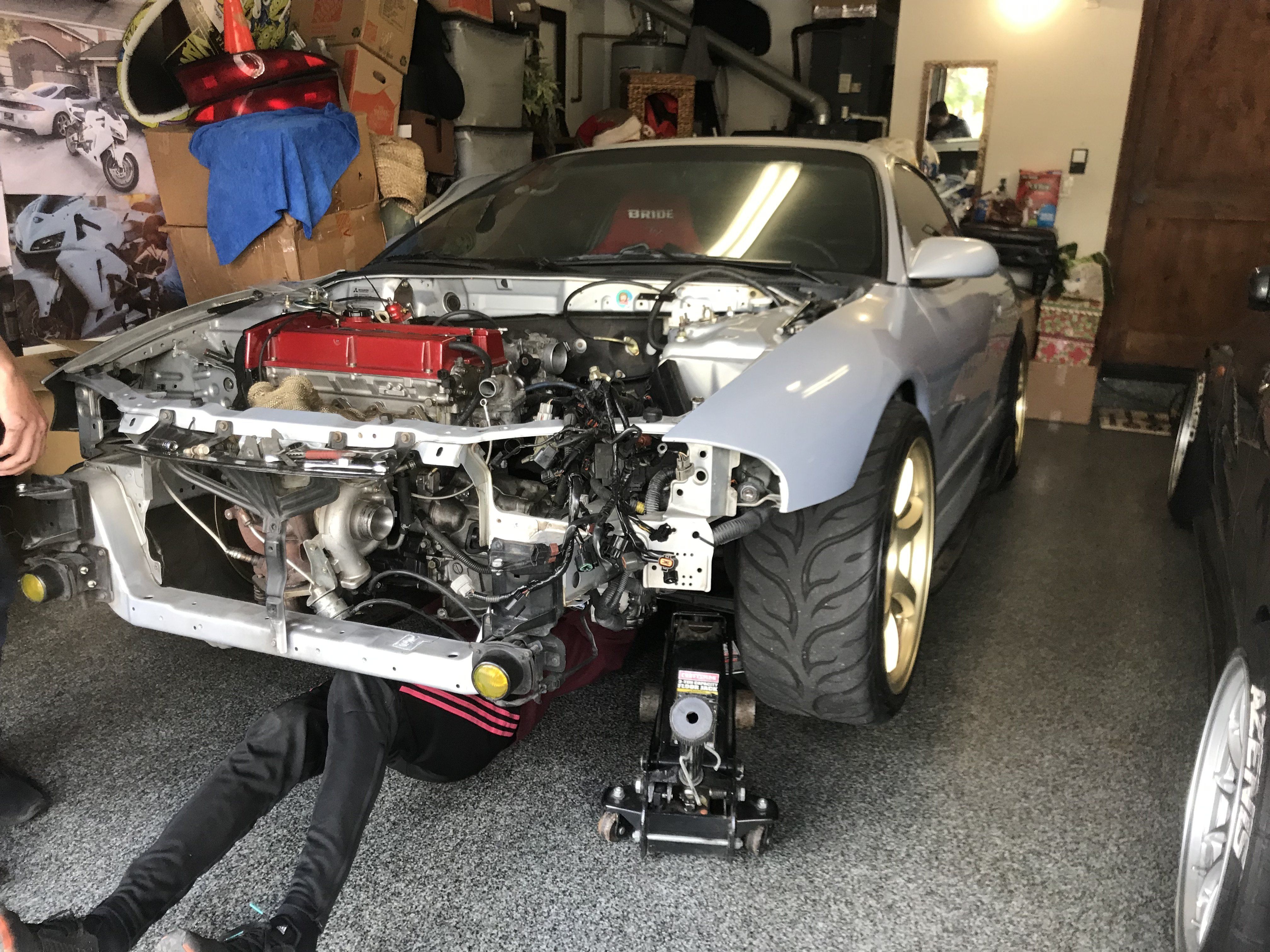

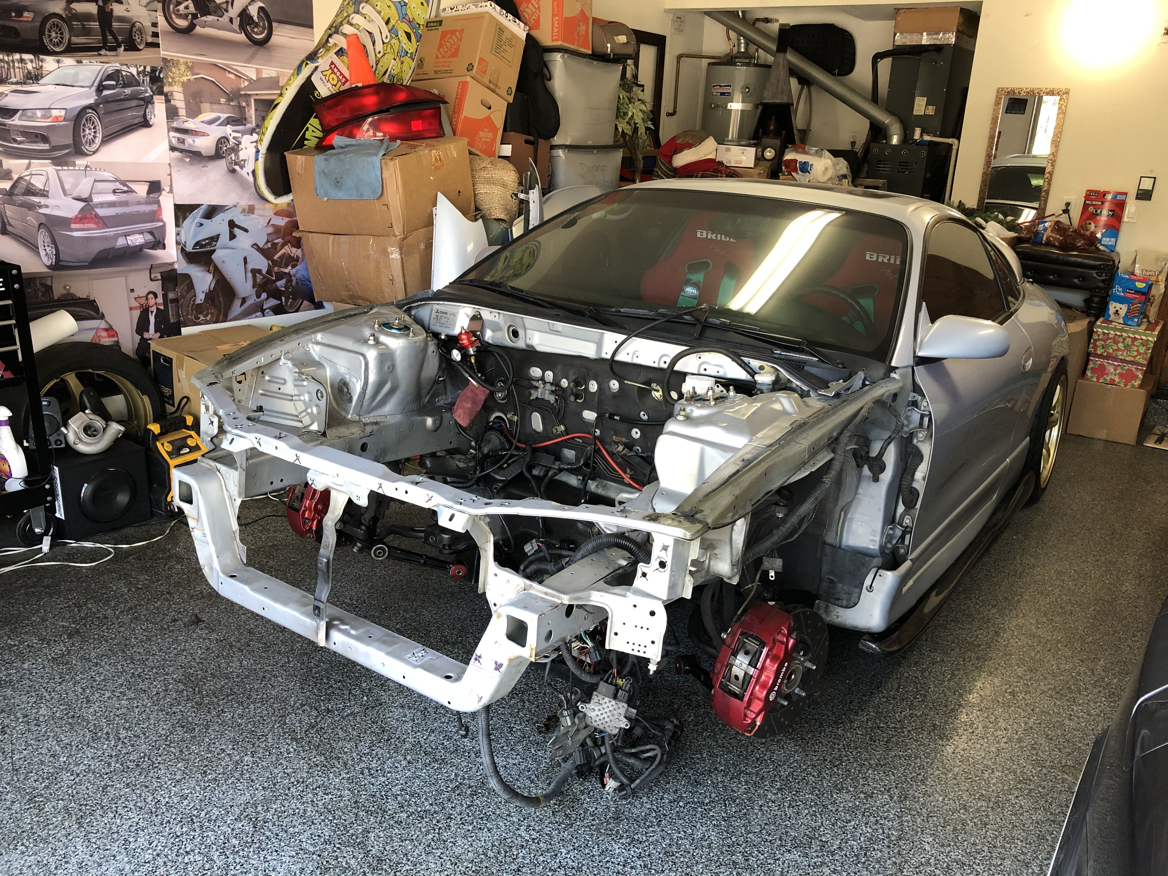

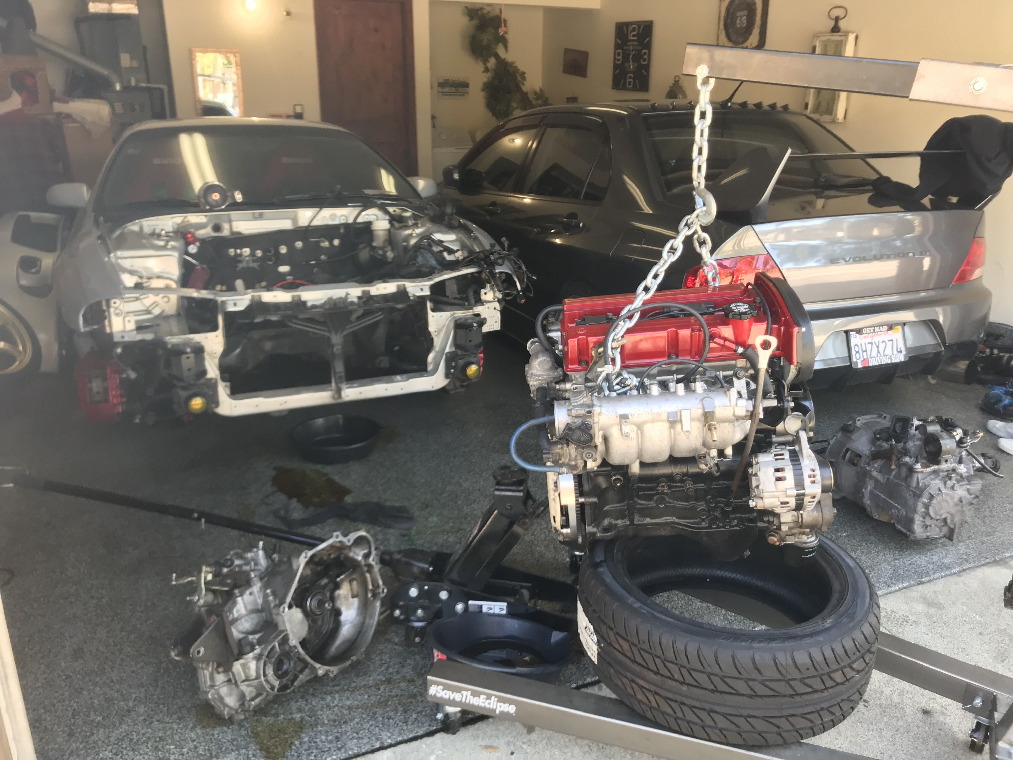

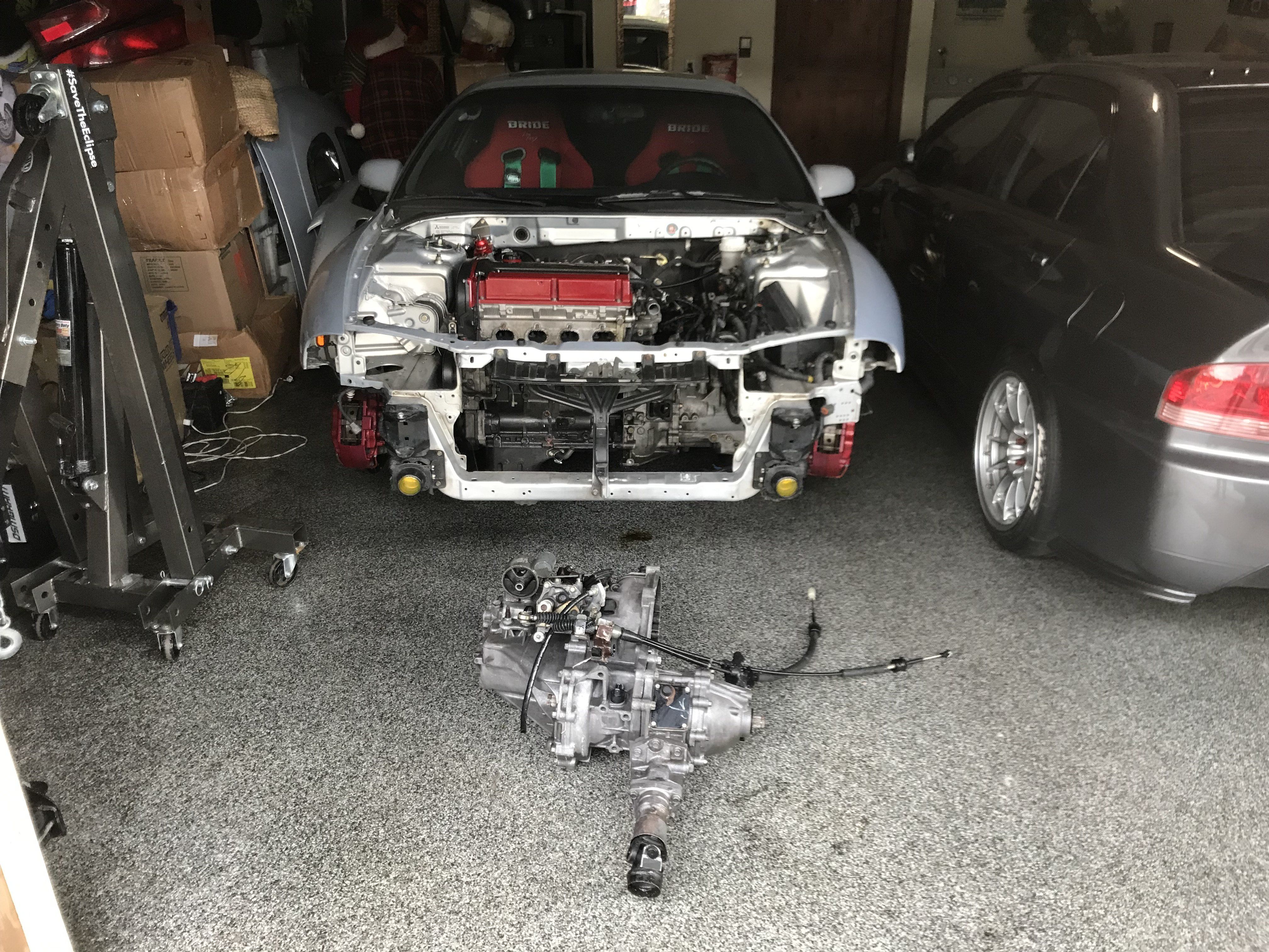

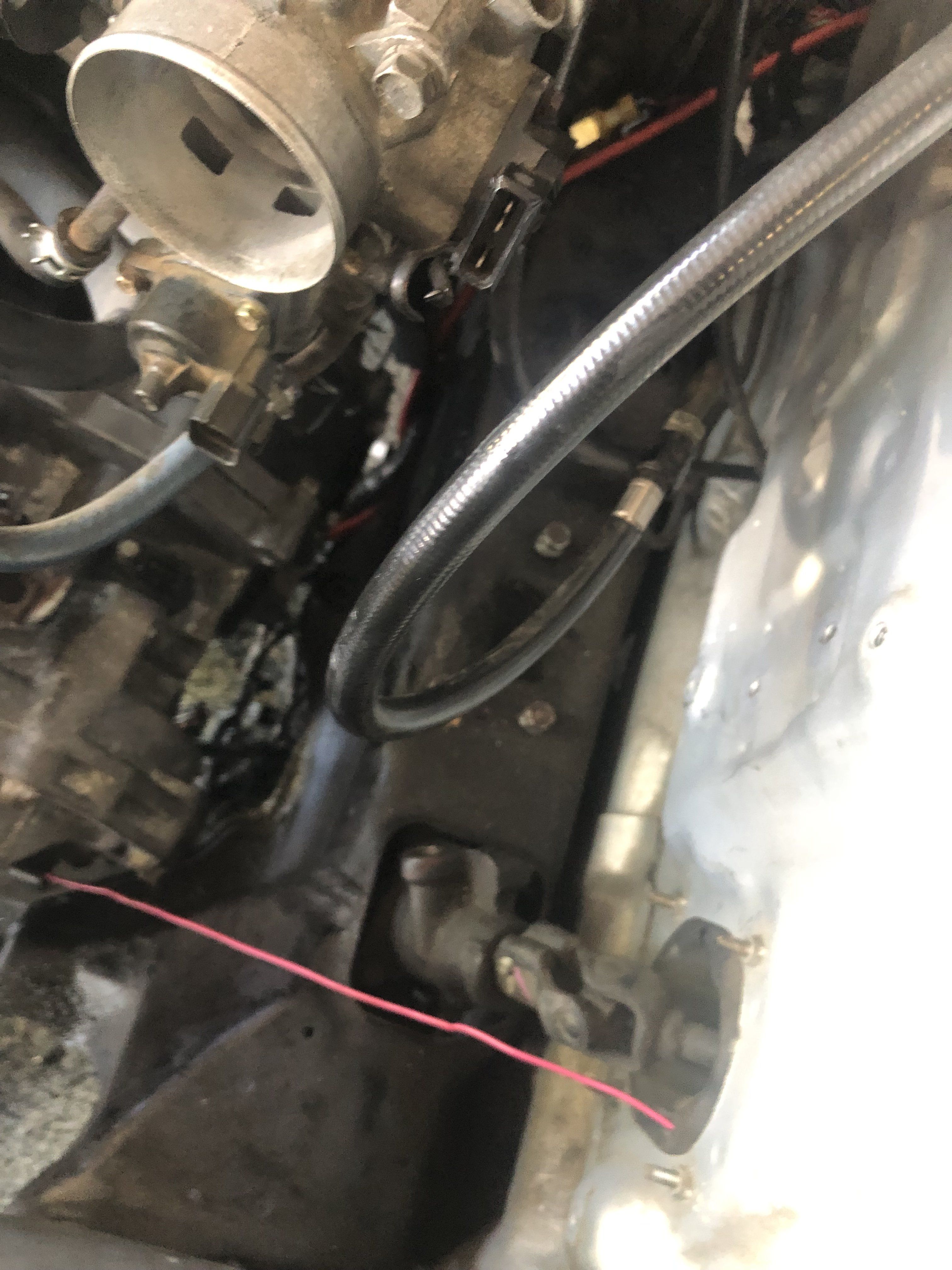

We moved towards the front of the car to remove all bolt ons and get the motor out.
We then removed the fwd 3g trans to install the new Evo 4 trans and transfer case to test fit into the chasis.
We then removed all accessories to prep the engine bay shave & paint!
We currently ran into fitment issues. The Evo 4 transfer case is hitting the front subframe. We plan on cutting and making space. Previously relocated transmission mount looks like it will still fit the evo trans without modifications.

Any reason your rear lower arms are in upside down??
