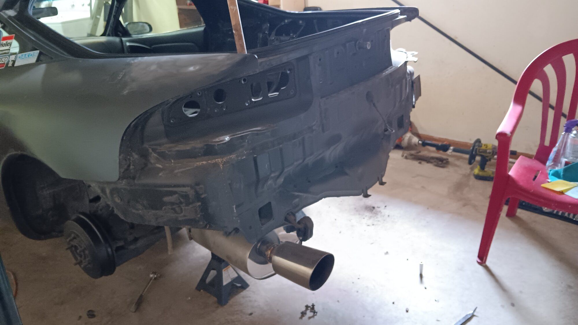

Good idea not welding the hatch i had to buy a junkyard hatch from not knowing better a few years ago, warping the hatch stupid bad. I should have used those patches rather than fiberglass and resin. Looks like way less of a mess. What are you planning to do with the spoiler?? I love that low rise look.
The spoiler has already been sold and the third brake light. I had considered installing a high rise but the car looks very sleek with no spoiler, especially once the holes are gone.
Getting to the nitty gritty of the body work. So far most of the original seam sealer seems to be holding up but there are some small spots that need attention before thick coats of sealer and primer. I haven't started sanding much besides the quarter holes. Disassembly comes first.
Also, does anybody have a GS or GST parts car? I'm looking for rear spindles. I'll be adding a rear sway bar during reassembly. I plan to post a WTB ad soon but am in no rush. A quality finish will take weeks or months at the rate I'm able to work on it.
