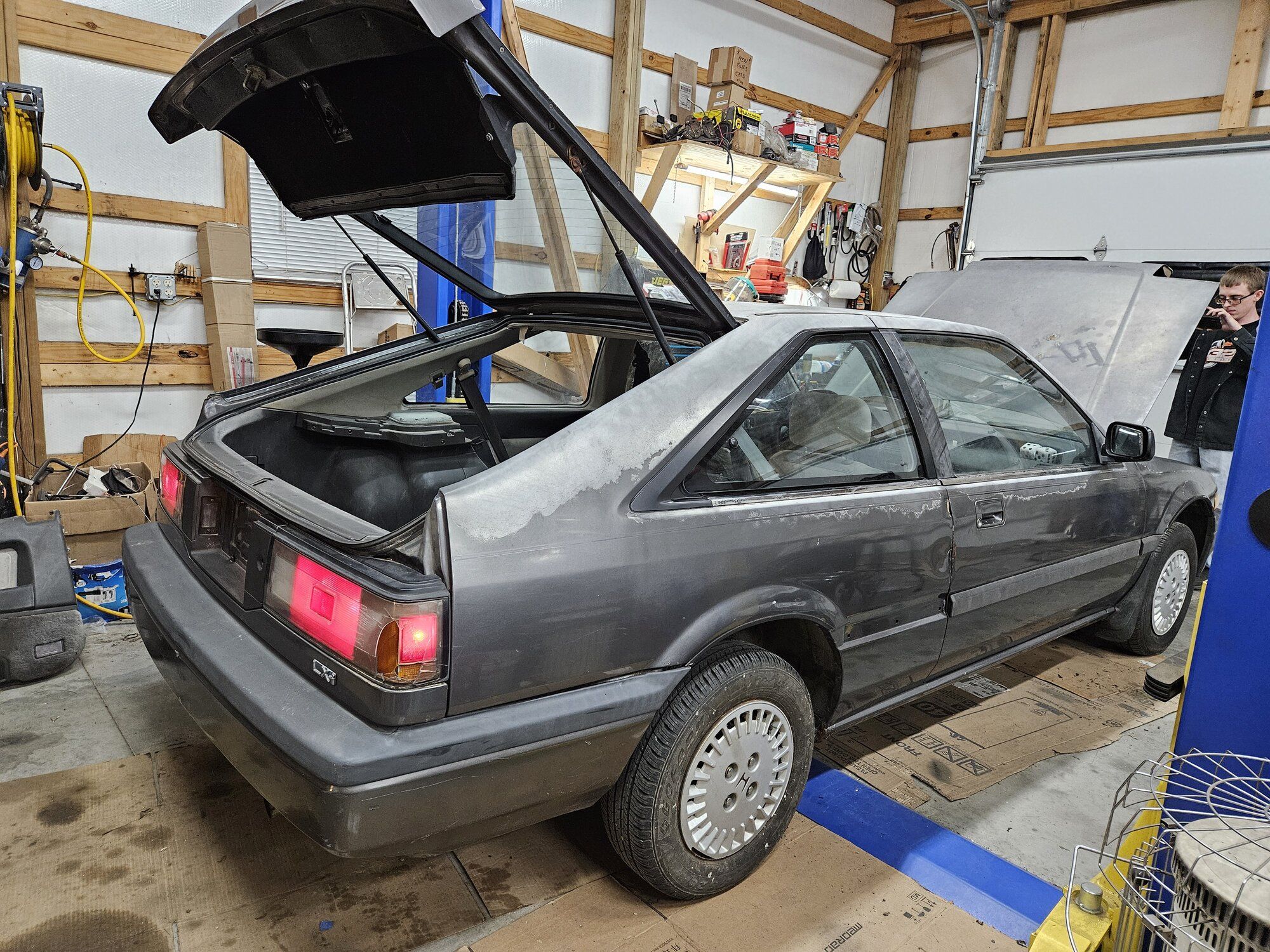

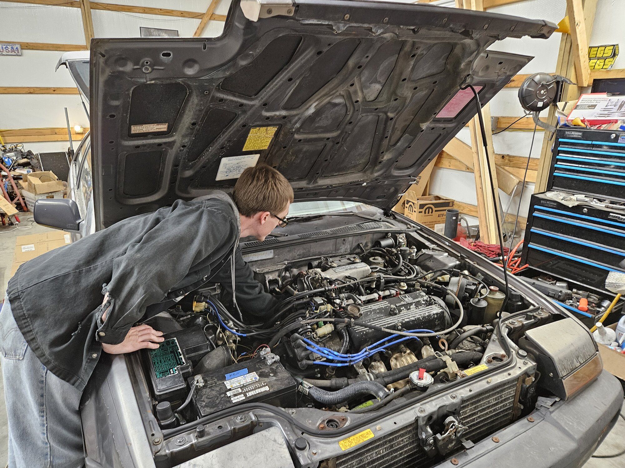

My son picked up this old Honda for $500. It hadn't ran in 12 years. We started it and it smoked so bad, I couldn't see the car. He freshened up the car with a tune-up, hoses, brakes, tires and now the car doesn't puff any smoke and you can't even hear it running. I think it will be a good DD for him and good mileage he hopes.

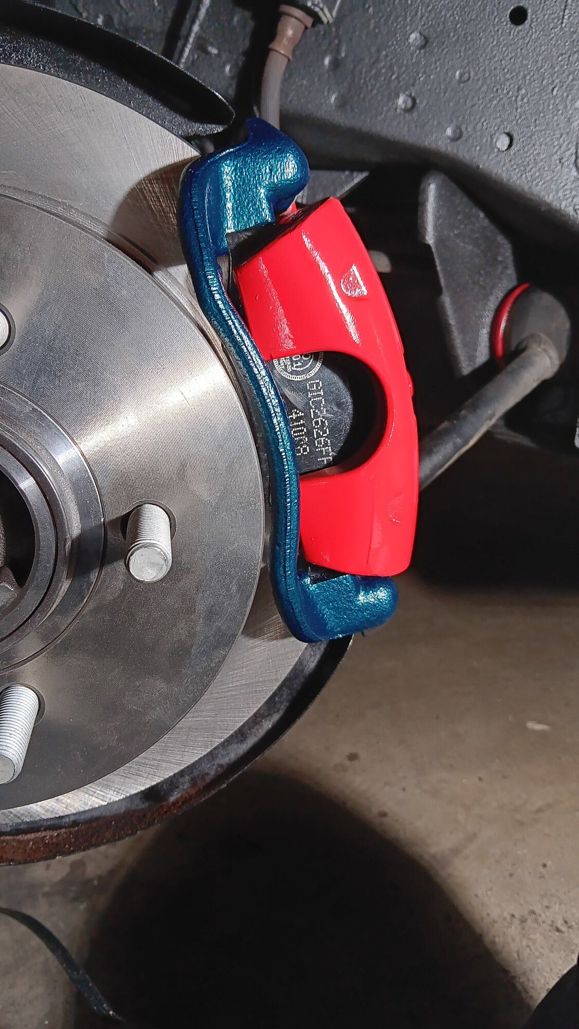

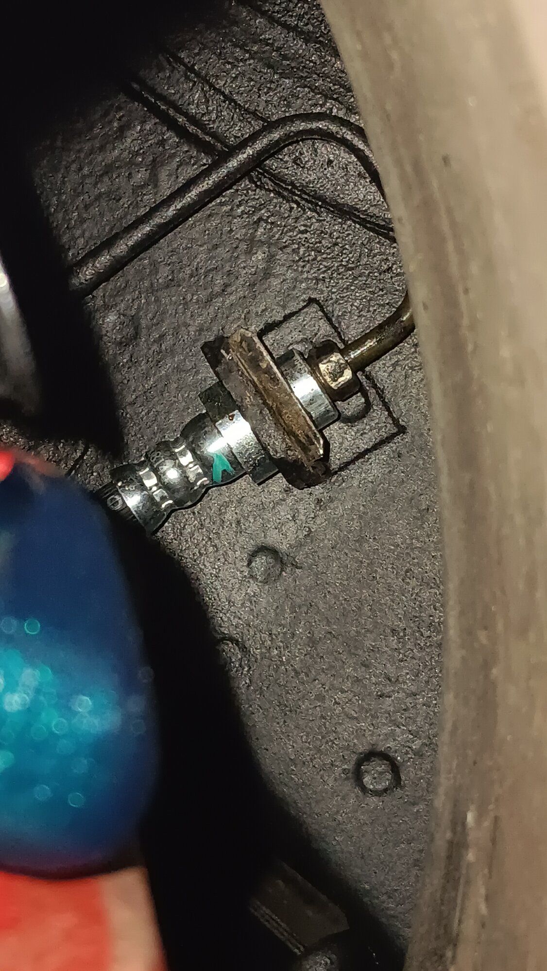

Installed some new rear brake hoses. No way I was sending it with those junkyard hoses. I made quick work of bleeding the brakes with a vacuum bleeder, checked to make sure everything I installed was tight, and immediately put the car out on the road. I couldn't wait anymore. The last time I drove it the weather was snowy, so it was definitely time to go blow the dust off. That 15 minute experience was definitely the highlight of my day. I'd say the poly bushings definitely made a difference, and so did the disc brake conversion. Steering response is instant, and I don't have to lock up the fronts to get a decent stopping distance. Things will get even better once I bolt up the rear sway bar and go for larger front brakes. I'm happy with the improvements for now though. Often times I forget how peppy the damn thing really is. It pulls hard for what it is. I let it rip past redline a couple of times, just to make sure I properly wake it up after a season of rest. I swear the damn thing would self destruct before it stops making power. I always shift when I'm scared, not when power drops off. I honestly don't know when that would occur, if at all. Anyway- until next time.
PS: I didn't install braided SS rear lines because you can't buy them separately, and I already have the fronts installed which were bought separately. At some point I'll get a kit and either use the spare fronts on my other 2g project or just give them away to another member.

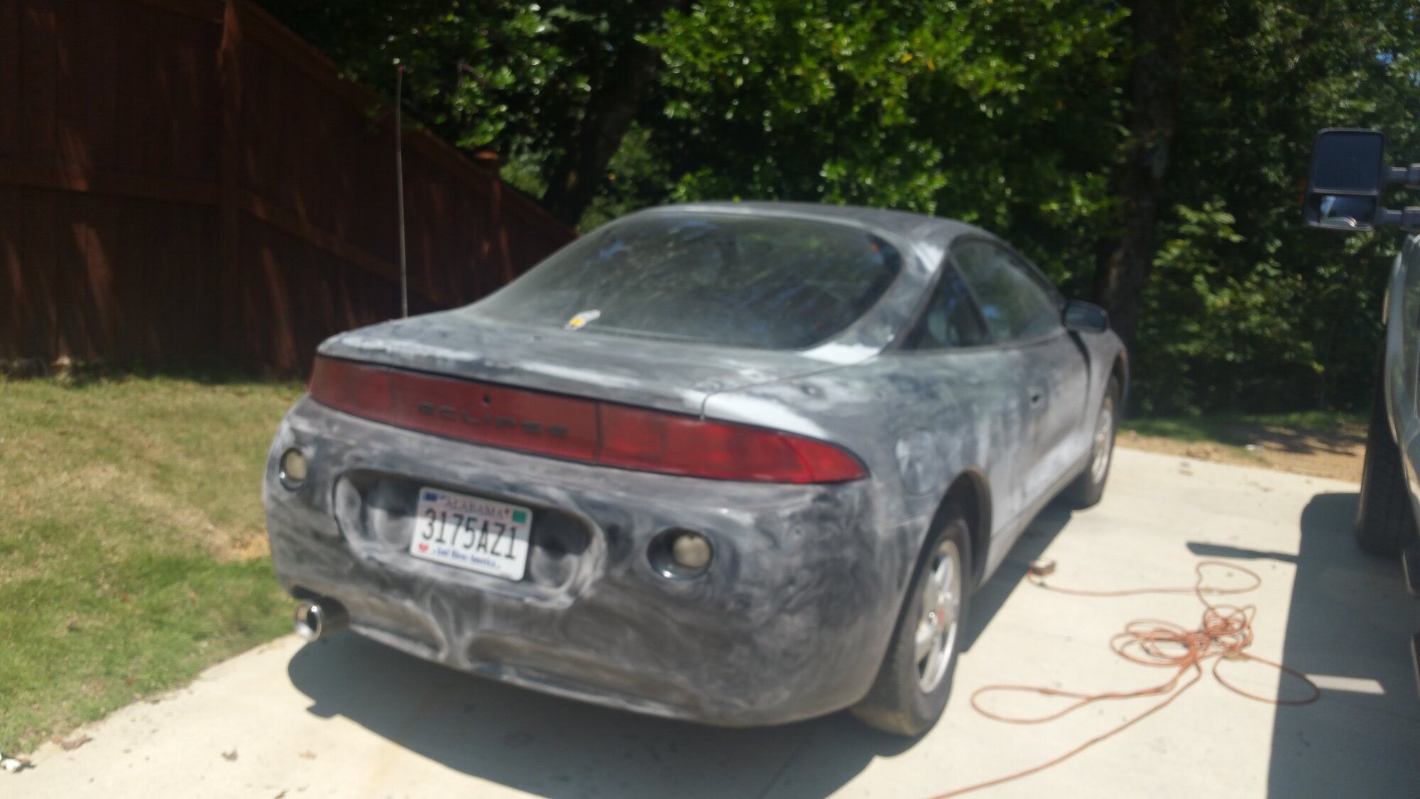

6 years ago, I started the body work on this car. It only took a couple of days to finish and spray paint, then I had considered it finished. Here we are today, and I'm still doing body work. It could almost seem like progress has been minimal, but you have to understand the mutliple stages of this body work, and my changes of plans over the years. First time around, the goals were just a clean OEM look for daily driving. Second time around, some revisions were made and much more meticulous repairs performed. This time around is not OEM at all, and simply aimed at maximum aerodynamics and weight reductions. It went from one side of the spectrum to the polar opposite. Maybe one day I'll make final decisions and have it all finished up, or maybe it's one of those never ending projects that everyone else would have given up on already. I'm more excited than anyone else to see this car sprayed emerald pearl with smooth & tucked bodywork, but the day furthers constantly and my interest has swayed towards other projects in recent years. The largest project being my mental and physical health, which become more important every year.
I still have a long list of parts to purchase, and one hell of a "to-do" list written out for the car. I just check things off one at a time, with no real pace - I'm not trying to meet a deadline after all. Sometimes I add things to the list quicker than I can mark them off. ONE DAY the car will be finished, but not in a near future it seems.

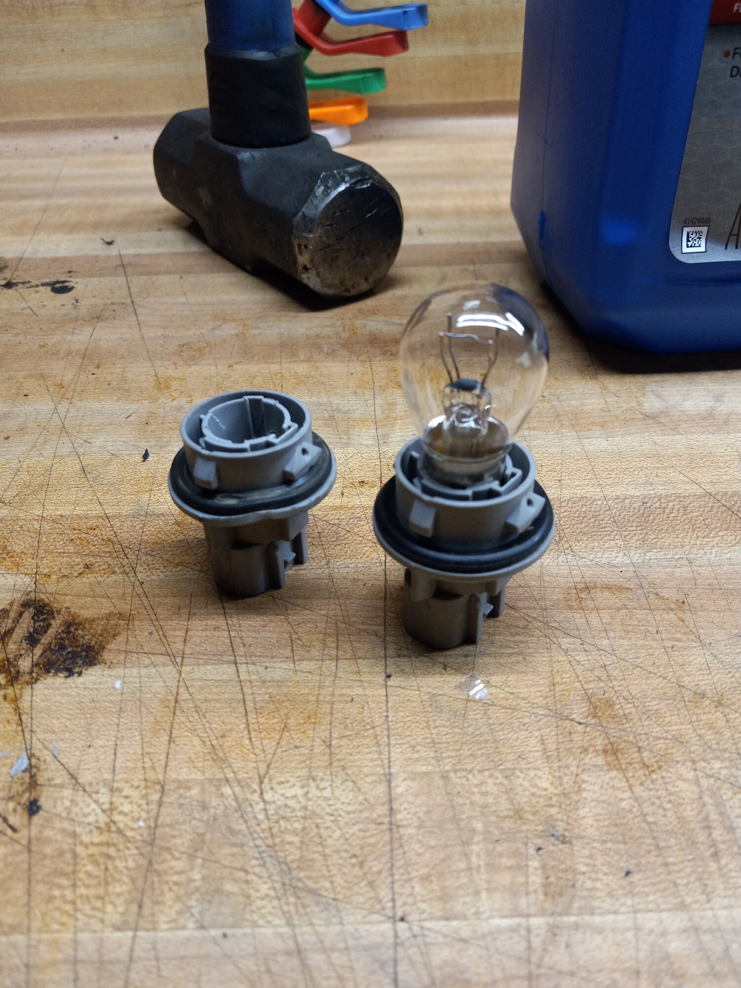

Noticed some fast blinking so I pulled the right side bulb... No, I pulled the socket. Somehow the bulb stayed in my housing. I can't imagine how or why it's broken besides pre-existing damage before my installation a couple years ago, and I didn't notice since it were a complete assembly. Damn thing finally rattled loose and fell in. One of my spares fit in the housing, so I'll leave it for now. Tearing the assembly open is far down the priority list. It gave me 2 good drives before something else fell apart.

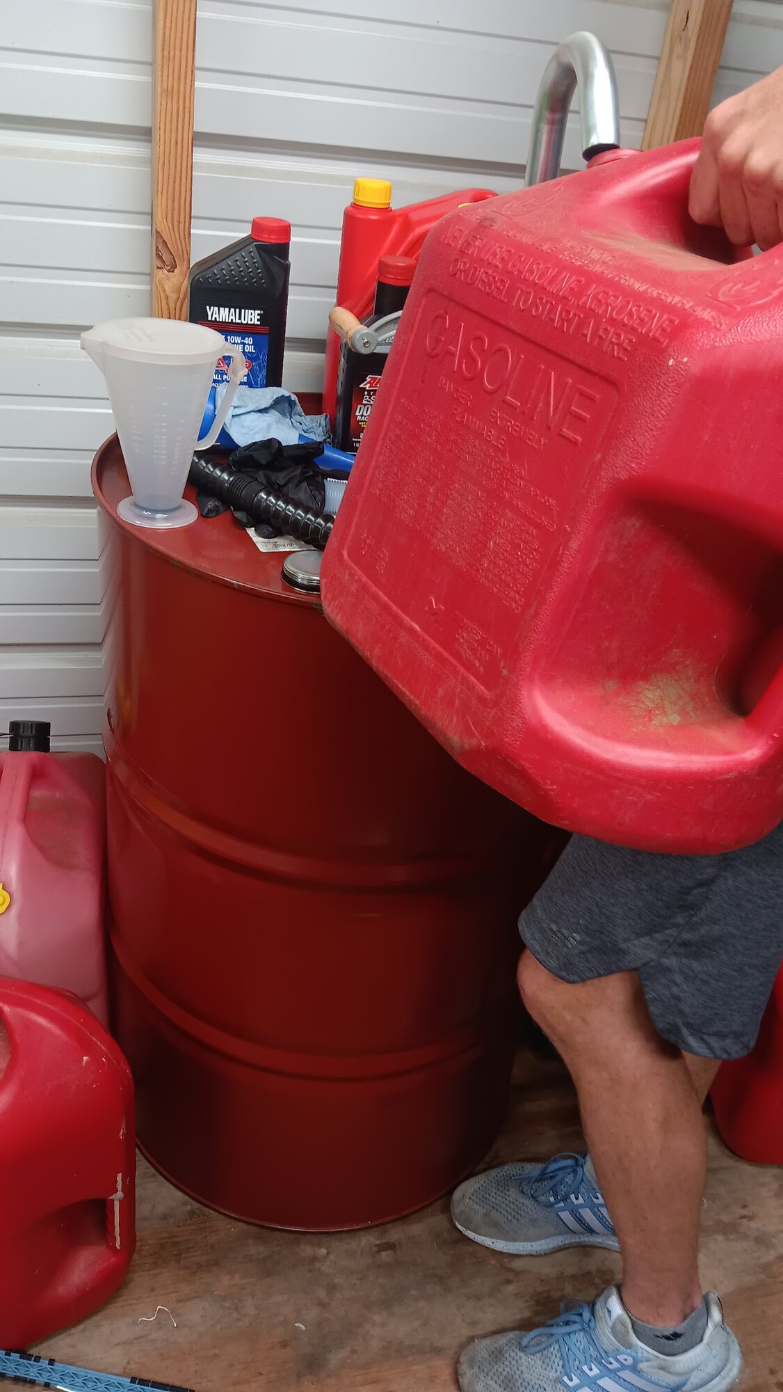

I recently helped a neighbor unload a 55 gallon drum using an engine hoist. It is filled with avgas (leaded and approximately 100 octane fuel). Filled at the airport. Well, we decided since my car was practically empty to pour a few gallons in the tank and write a new street tune with it. I was able to throw in an extra 4 degrees of peak timing without knock. It was running great. Once the tune was mostly sorted out we were messing around on the highway and my brake booster started leaking vacuum. I went to press the brakes after a hard pull and the pedal felt pretty stiff and wasn't having the pressure I normally do. Once we stopped the engine was idling high and slightly lean at around 16:1. Pumping the brake pedal would build some slight pressure but raise the idle more. The 27 year old OE brake booster diaphragm gave up on me tonight. I guess I'll put in an order for that soon.
I'll definitely be swapping back to my previous 93 octane unleaded tune once this fuel is mostly burned out. The avgas is twice as expensive and only available at certain places not so close to home. It was an enjoyable experience though until the brakes went funny.
