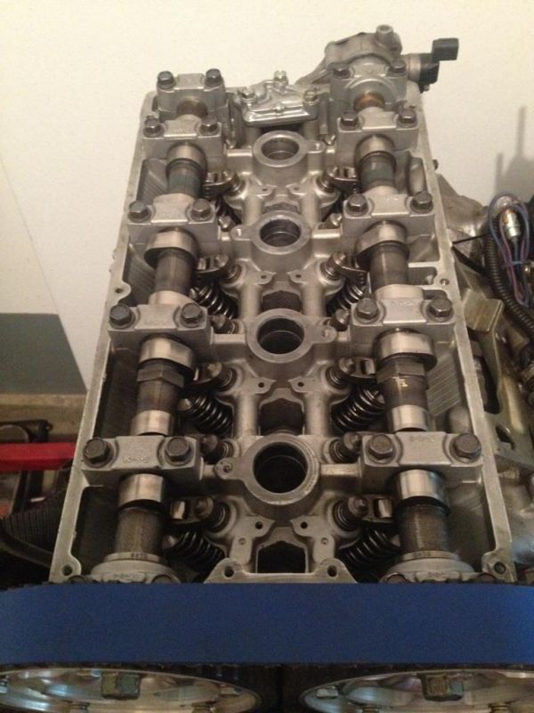

I have done a ton to the car since last time I was on here. I spent 13 hrs one weekend tearing the head apart on the car so I could change valve seals one at a time, what a PIA but it doesnt smoke hardly at all now. Only time is smokes is on a cold startup when its idling.

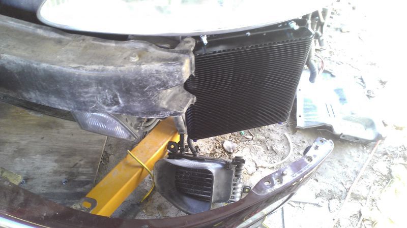

after I fixed that problem, I installed dsmlink, some FIC 1120's and a trans cooler fan to keep my trans temps under check when im at the drag strip. I then started tuning the car myself with no prior experience with dsmlink.

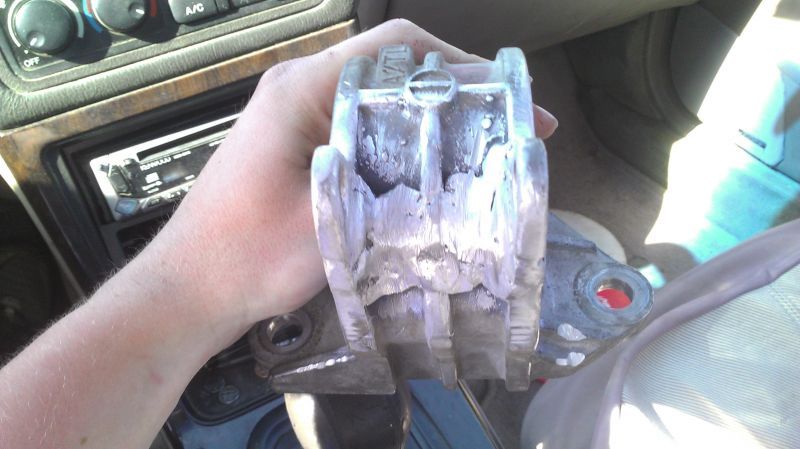

Well have bad news. About a month ago my auto tranny started leaking fluid BAD from the output shaft seal on the tranny side. Worst part is that everything is working GREAT and running the best it ever has (thanks again My1GDSM!!) And now the motor, trans and tcase are all being pulled and replaced so I can reliably run a stupid amount of boost to the car without worry about breaking something. Switching to Speed Density, buying a fourced four shift box plus, doing an alternator relocation and putting in an electric 3" cut-out.... just can't decide weather to put the cutout right after my 3" vband flange and run fender exit exhaust and muffler out the back. OR put the cutout where I had to cut my D.P to remove the tcase (about 1 foot after the flex section) and have a muffler out the back?
im sending the tcase off to Devo 2ning for a full 300m upgrade and getting a 950hp DSS driveshaft from them as well.
The auto is going to be sent to Mark at metro trans for him to work his magic on.... cant decide weather to do a 4 spider upgrade or have him weld the center diff (going to pretty much be a daily driven car but want it to hold the most power it can)

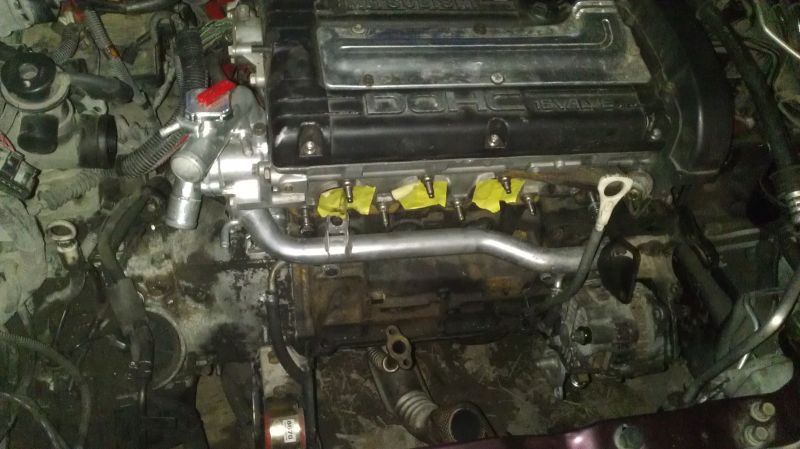

Well I have a couple updates and hopefully can load a couple pictures because I have like 50 pictures that I havent been able to upload yet... seems it will let me upload one of my motor ready to drop in, so I will show that off until I can figure out how to get the rest of my pics to upload.

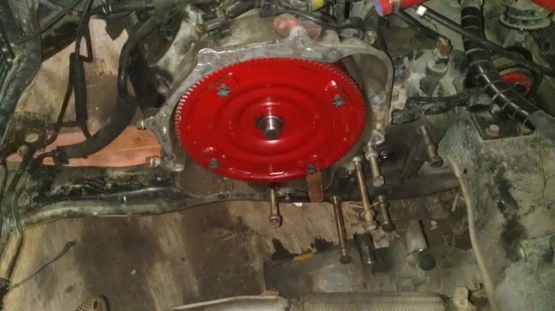

The last thing I have to do before the car is up and running again is get the trans out of the engine bay and sent off to metro trans for a full performance rebuild with welded center dif LOL

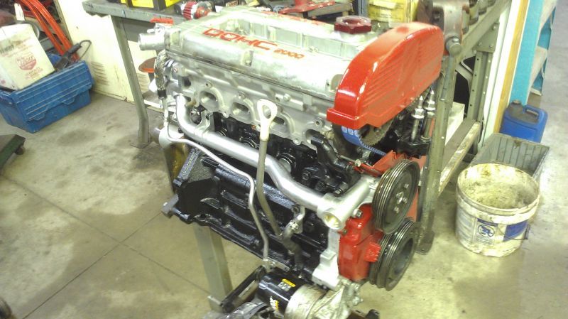

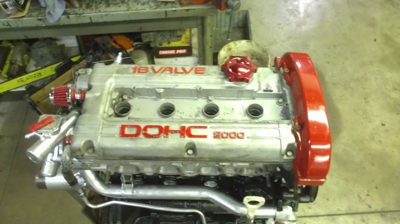

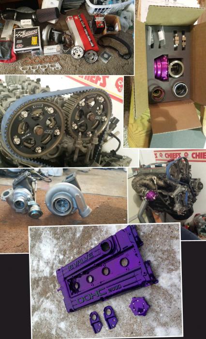

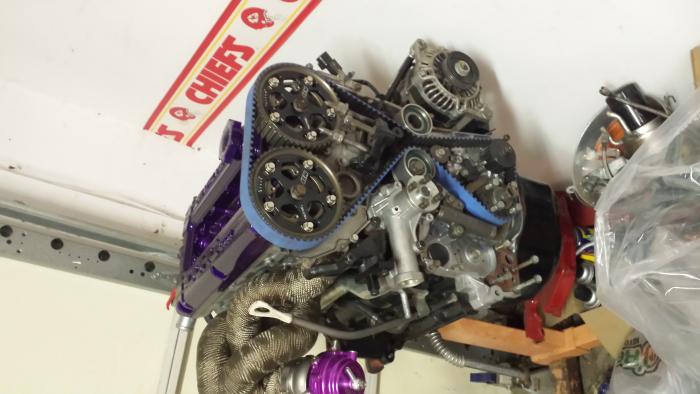

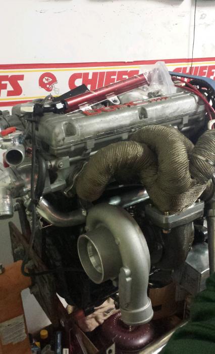

Got all of my new parts in and my engine ready to start one I drop her in! I got my VC powder coated illusion purple, put BC's new 284 cams in, 3g lifters, kiggly HLA, and some AEM tru-time cam gears. As well drilled/tapped an extra 1/8" bspt port on my evo 3 OFH, fluidampr, AEM water/meth kit, S.D. setup, fourced four shift box, and turbo setup all ready to go on the car :thumb... got my egr port drilled, tapped and blocked off for my heat barrier I.M. gasket.
I also have gotten another sponsor, Automod Central, that helped me out with pricing on my AEM cam gears and AEM water/meth setup.

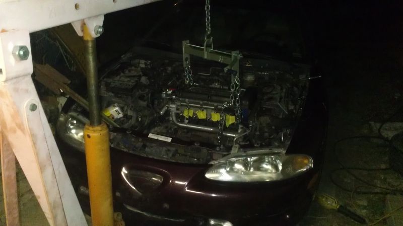

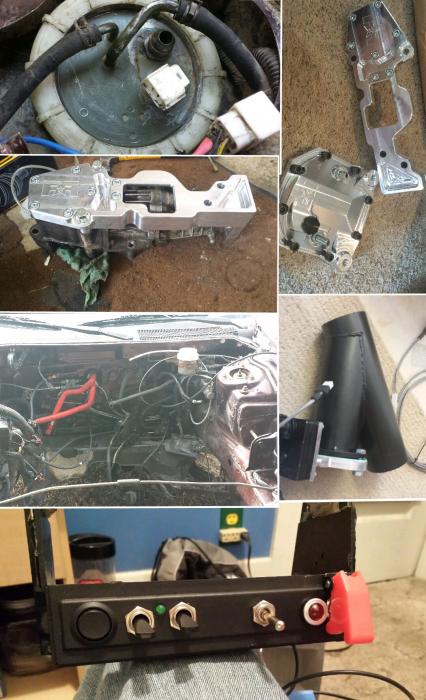

Sorry for the long update but i have alot to tell about, as I found out how I can upload pictures on my new phone to the site to show my progress :thumb:.... I managed to delete my ABS brake lines, ABS ecu and the big bulky ass ABS module under the p/s reservoir thanks to STM's ABS delete kit. I also bought a ZEX 50-200hp direct port nitrous setup off another member on here. Got my F.F. auto tcase brace mounted up after removing the dust shield off the rear of the tcase tail housing. Also got my FIC 2150's, resistor pack delete plug and plug n' play harnesses (BIG THANKS TO FUEL INJECTOR CLINIC FOR MY LATEST SPONSORSHIP (well kind of LOL) MY ACHIEVEMENTS WOULDN'T BE POSSIBLE WITHOUT YOUR HELP!), 3" electronic cutout, fluidampr harmonic balancer, modified -8an awd sending unit with wally 450 e85 pump already mounted on it for a steal (picked it up for $210 to my door LOL). And finally just yesterday I pulled my 7" touchscreen out of my car and removed the radio bezel to install my various switches for my goodies. In order from left to right they go: cutout switch, orange lighted switch for rear light for talon emblem (plan on lighting up the rear talon emblem with LED'S and putting it on this toggle so I can remain unidentifiable when I want), green water/meth low level Indicator light, green lighted water/meth power switch, shift box on/off toggle and lastly nitrous arming switch with red indicator light that will light up when spraying the N20.
Big thanks to 1990TSIAWDTALON (my dad) for help on the wiring for the toggles. I am definitely not an electrical guru like he is, but also helps he has an electronic engineering degree :p.
Also talked to mark at metro trans friday and my trans should be mailed back in the next couple days and hopefully here before my 21st birthday come April 5th. The car is starting to come together REALLY fast after having basically no progress on it for about 3 months. Cant wait to get this thing together and crank the boost up on my new engine/turbo/trans setup!! :rocks:
One of the few things I have left to do now is compare the 2gb cam sensor positioning @ TDC on my running motor that came out of the car with my new motor going in @ TDC to make sure my cam sensor isnt 180* off come time for first start up.

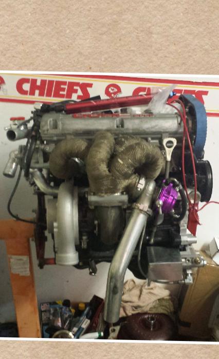

Got a few updates for the car. Should be getting my trans back from metro in the next couple days then I can start the install process with that and then get all my new electronic's wired up. I still have to wire up my AEM water/meth controller, shift box plus, gear display, NOS switch, push button & solenoids, trans temp gauge wiring and Alt wires for my Alt relocation.

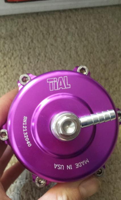

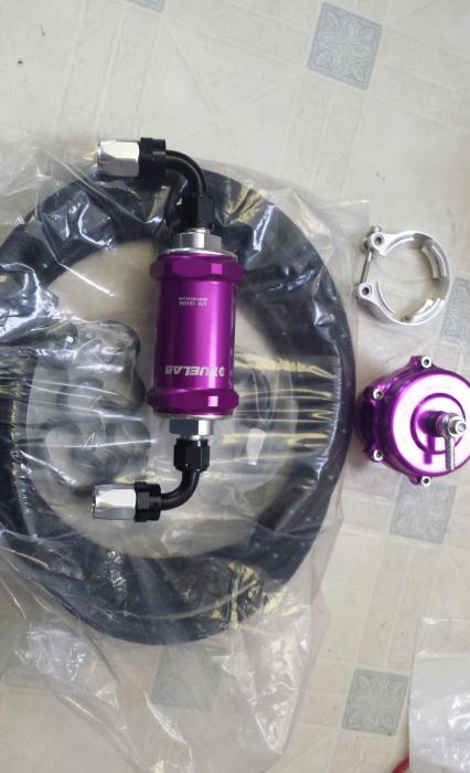

I have gotten a few parts in over the last couple weeks as well. Got my fuel lab -8an tank to rail kit for my modified sending, got my Tial Q BOV, fresh chrome powder coated hood latch support and also got my VRSF FMIC in and mounted on the car (so I put the old P.R. fmic onto my spyder gst and took a picture LOL, so I can finally get that one up and running also).
I also took my motor apart before I install it and re-timed it again. As it was a little tight for my liking. Even though all the marks were perfect and I could slide the grenade pin in and out still after a couple months and a few rotations, I loosened up the tension a little bit to where the hydraulic tensioner grenade pin hole was about half visible and half blocked by the upper part of the tensioner body.... only reason I did this was because I recently did a timing job on my dad's '90 AWD, i had ALL new components and I got EVERYTHING perfect, triple checked it all and could still slide the grenade pin in and out of the tensioner after sitting 15 minutes and turning the motor over like 20 times...... well upon start up of his car the timing belt started smoking and was getting extremely hot, took everything apart and it was all still perfectly timed. So I loosened the timing belt a little bit 3 different times until it got loose enough that it didn't smoke anymore when running.
I would hate for this to happened on my brand new motor on first startup and have to shut it off during the critical first 20 minutes of break in time. So hopefully i took enough precaution before it goes into the car.
