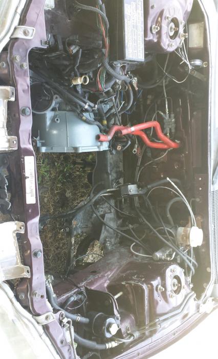

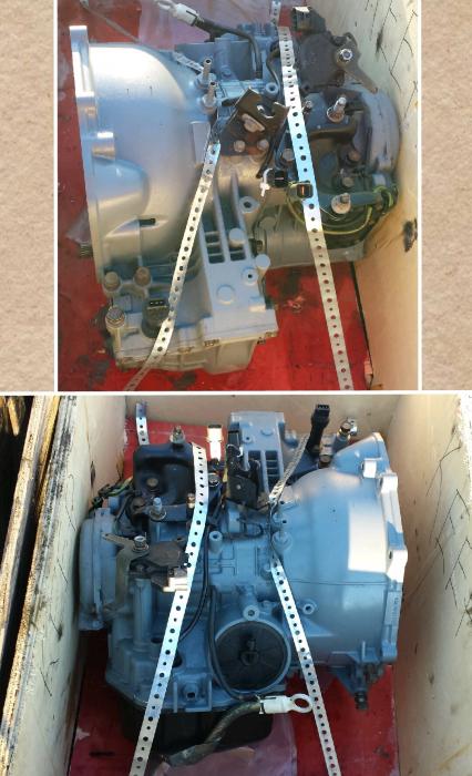

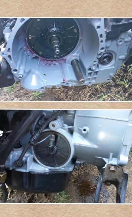

Alright guys, got a few updates. Got my trans back from metro this last Tuesday. Then couldnt sleep on Wednesday morning so I went outside and dropped the trans in by myself before I went to work at noon :thumb:
I also finished extending my ALT relocation wiring, trans temp sender wiring and got my toggles mounted in the dash under my touchscreen with a little bit of modification with my dremel tool :sneaky: :cool:. And finally last night I got around to routing and installing my -8an tank to rail kit from my modified sending unit up to the engine bay.
Now I just have to pull the motor off the stand, install my pilot bushing, my trans to block alignment dowels and bolt up my kiggly 7 bolt flexplate. Aftet that the motor is ready to drop in the car and then I get to start having combsdsm fabricate my side exit exhaust with a cutout going to muffled exhaust.

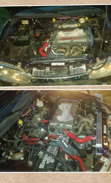

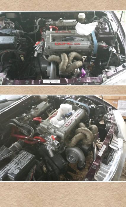

Well I got the motor off the stand and into the car today with the help of a friend. I think im getting pretty good at this pulling and replacing these motors, it took me only an hour to get it all bolted up to where I just have to plug things in basically. :hellyeah: :cool: :thumb: LOL
Now I just need to get my exhaust fabricated up to make everything fit and have the cutout with my side exit exhaust.
I also have to drill out both innermost fender, bumper bolts because the dumb P/O snapped them off when he went to take the stock motor right before I bought it. I have to do this to make my overkill fabrication bumper quick release kit (very nice piece, by the way), mount up properly as it uses the factory bumper mounting locations on the sides. After I have the bumper to where I can mount it, I can then cut the hole for the side exit exhaust so that way its an exact fit and doesnt look sloppy :cool:
Other than that there is just a couple small things and it should be ready for my1gdsm to tune the car and attempt first startup of it :hellyeah:

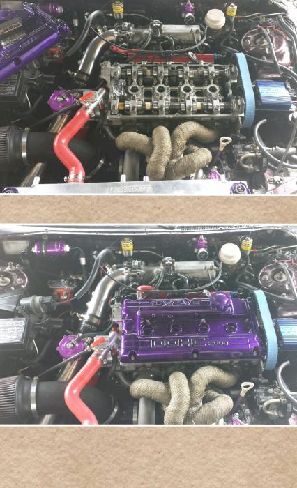

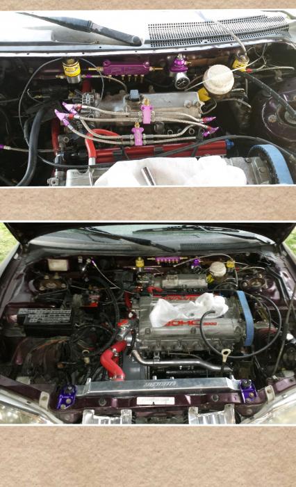

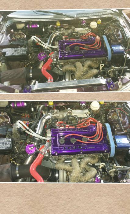

Got some more updates. Got almost all of my wiring done. Just need to wire up my nitrous and oil pressure gauge and that stuff is done.. finally got my throttle body elbow back after 2 weeks, it now has my AIT, water/meth and nitrous bungs welded into in. I also got my fuel line cut to size, nitrous solenoids mounted, Dynatec arc -2 box mounted and wired up, cut a hole for my coolant overflow where the stock airbox used to be (and the splash guard still bolts up :cool:). And finslly got my catch can mounted, nitrous bottle mounted and lines ran to the bay and got my water/meth tank and pump mounted in the trunk.
Oh and got that sexy illusion purple valve cover with wet black letters on since all the work is done in the engine bay minus fabbing the exhaust.

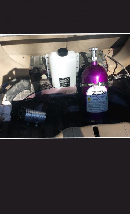

Thanks victor! The nos looks pretty sick mounted in the spair tire well :cool:... if your going to the shootout I will be there this year for sure, dont know of my dad can make it but I will definitely be there so you should stop and chat for a bit. :thumb:

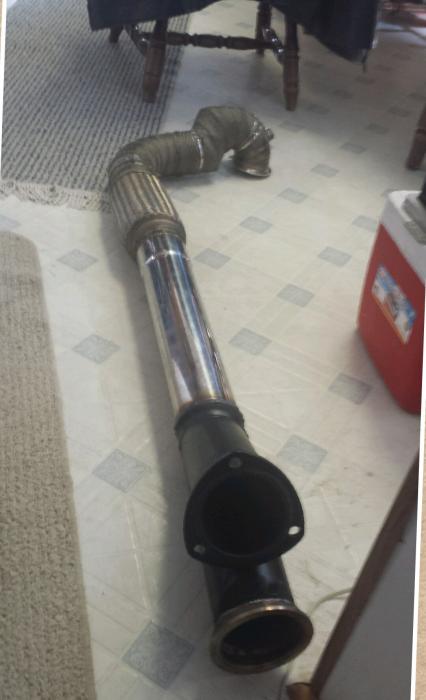

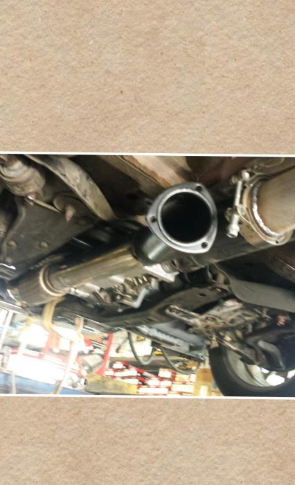

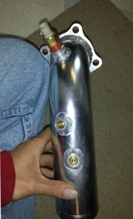

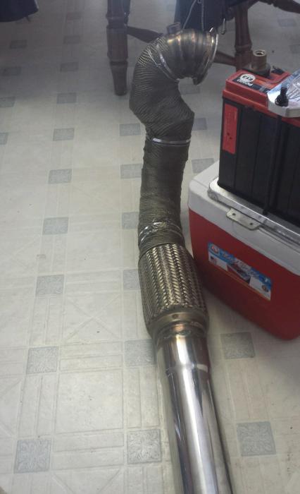

Well I have a couple updates... one is good one is bad :(. So I will start out with the good news. Towed my car 1.5 miles down the road to the local exhaust shop and had my exhaust fabricated up to go around my hotside I/C piping and also around the OFH shield I made (to keep heat off the oil filter and keep from boiling the oil since the oil filter is only like 3" from the downpipe).

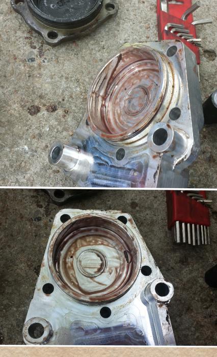

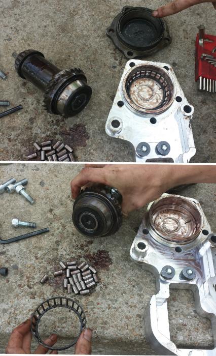

After re-seating the axle I went through inspection tests again to make sure everything in the trans was fine. Everything in the trans checked our fine so far (thank god) BUT I could hear a NASTY metal grinding sound when my brother spun the rear tires forward, which moved the driveshaft and tcase output shaft and when he turned the tires backwards the driveshaft doesnt spin at all :cry: :banghead:... the sound was definitely coming from the tcase.... so I ripped the tcase back off and tore it apart for inspection, only to find some carnage that I created (and not by towing the car).
The metal grinding sound I was hearing was from my dumbass forgetting to put the bearing race out of the oem tcase bearing cover into the new F.F. tcase brace.... so I found a destroyed bearing and that the bearing had eaten into my FF cover, but fortunatly I think the cover can be re-used..... as for the tcase, it seems to be alright (gear wise from looking inside it) but I feel weary about using it, so I am either going to have to find and buy a used 97-99 auto tcase or borrow some money and send it off to boosting performance or Devo-2ning for the 300m upgrade along with my FF tcase brace.
I will upload pics of the custom vband eliminator downpipe and carnage of the tcase tomorrow when I get some spair time..... FML!! Its always gotta be something! I was sooo ready to start the car before the weekend and drive it around for the first time since October. So I guess street car takeover in Kansas City is going to be a no-go for me this year. I was really looking forward to dynoing the car and racing some badass street cars but that will come in time now.

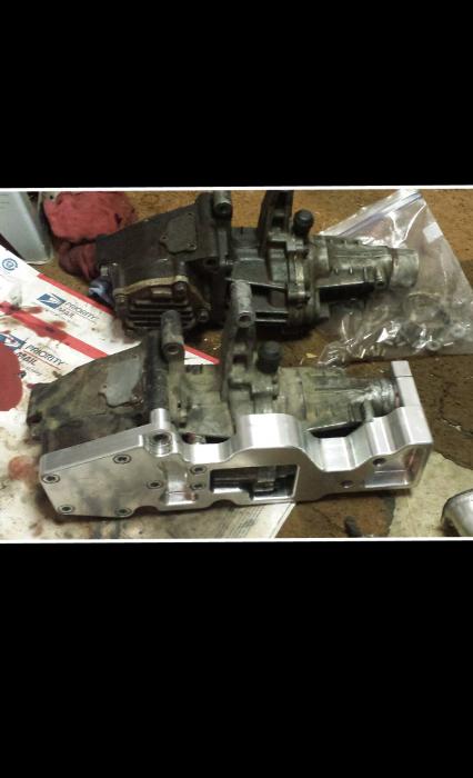

Well I found a used 97 auto tcase yesterday for $180 so I decided I couldnt pass that good of a deal up and went and bought it :thumb:
This time i got the bearing race out of the new tcase's old oem cover thanks to the help of my dad, cleaned up the burrs on the inside of the F.F cover from my f*** up, placed the pre-load shim in the F.F. cover and finally tapped the bearing race into place and installed the F.F. tcase brace onto the new tcase I got.
I will be installing everything back onto the car when I wake up and check everything out again. If all checks out good I will plug all my electrical connections back in, torque down my tcase and prepare for first startup this weekend :pray: :hellyeah:
Here is a pic of my new tcase with the FF tcase brace installed. :rocks:
