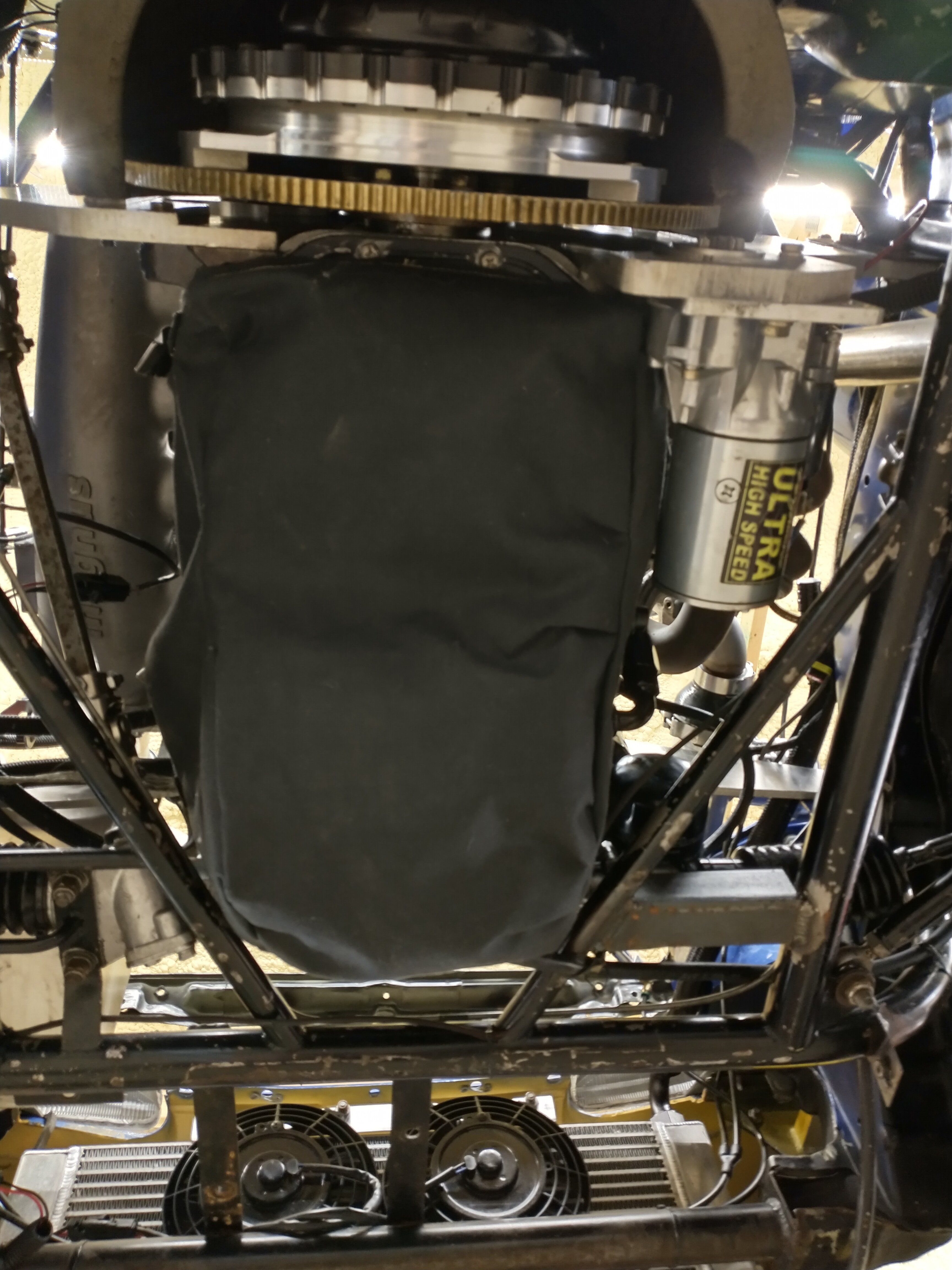

It's a fairly generic bolt together 8 inch I've been running since 2017 or so. After annihilating all the pump fins again I sent it to Pete at Circle D to beef it up a bit. I've still got two other stators to try (tighter), but now at least it should be able to take the power without shitting the bed. I also need to try some better trans fluids as well since I'm near the limit of an 8 inch unit. I'd also like to try the mechanical diode again (sprag) for quarter mile racing. And I need to double the flow of my converter dump. Converter testing never ends.
