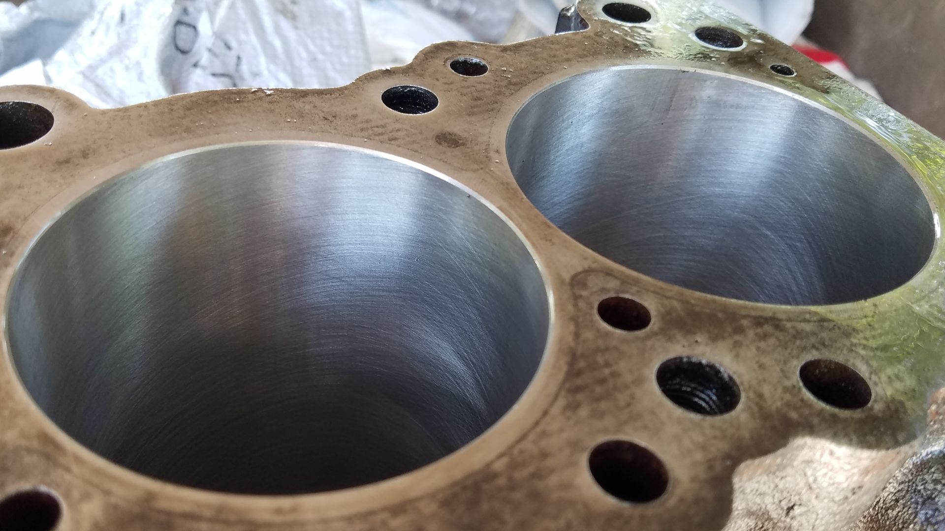

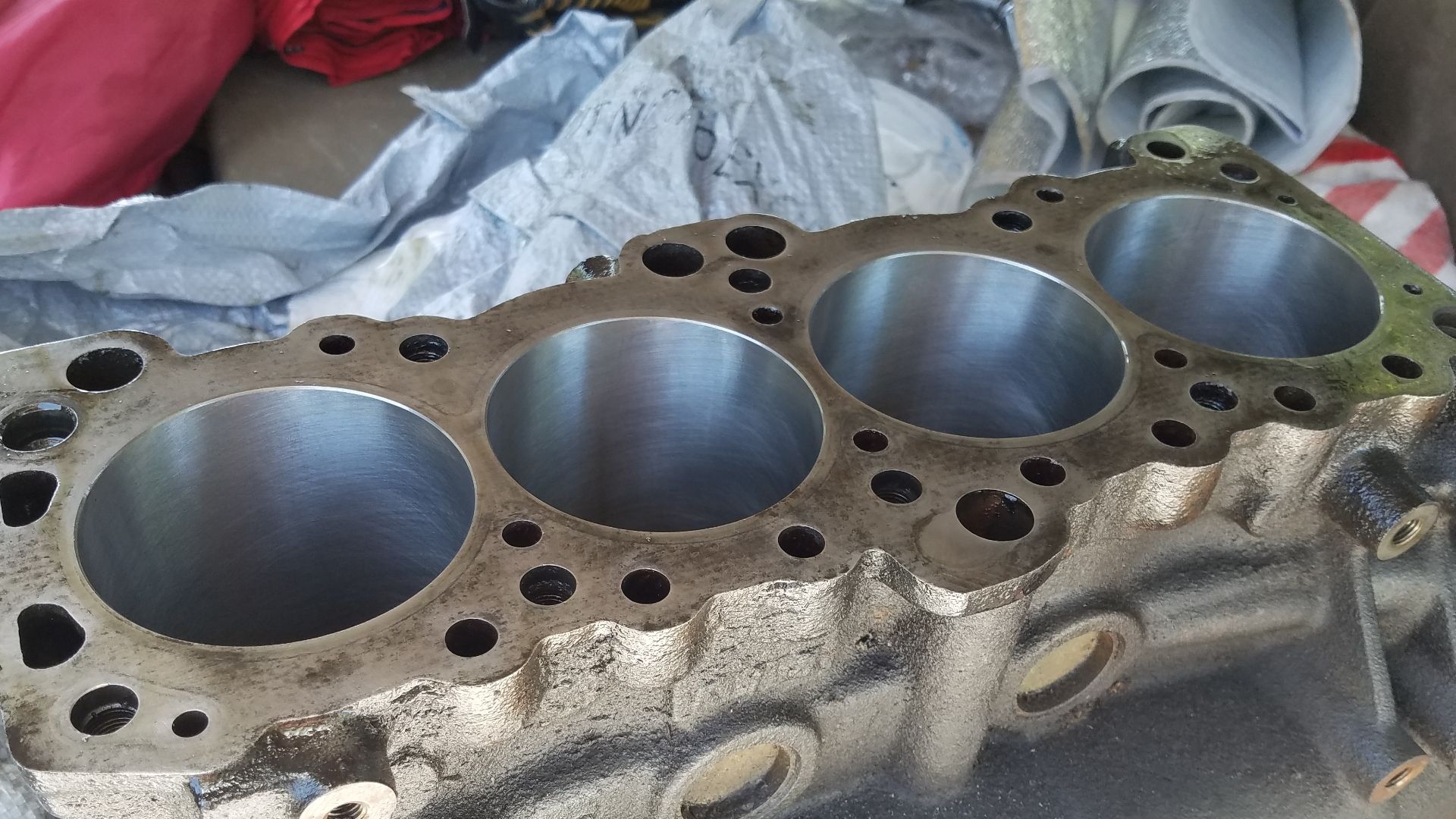

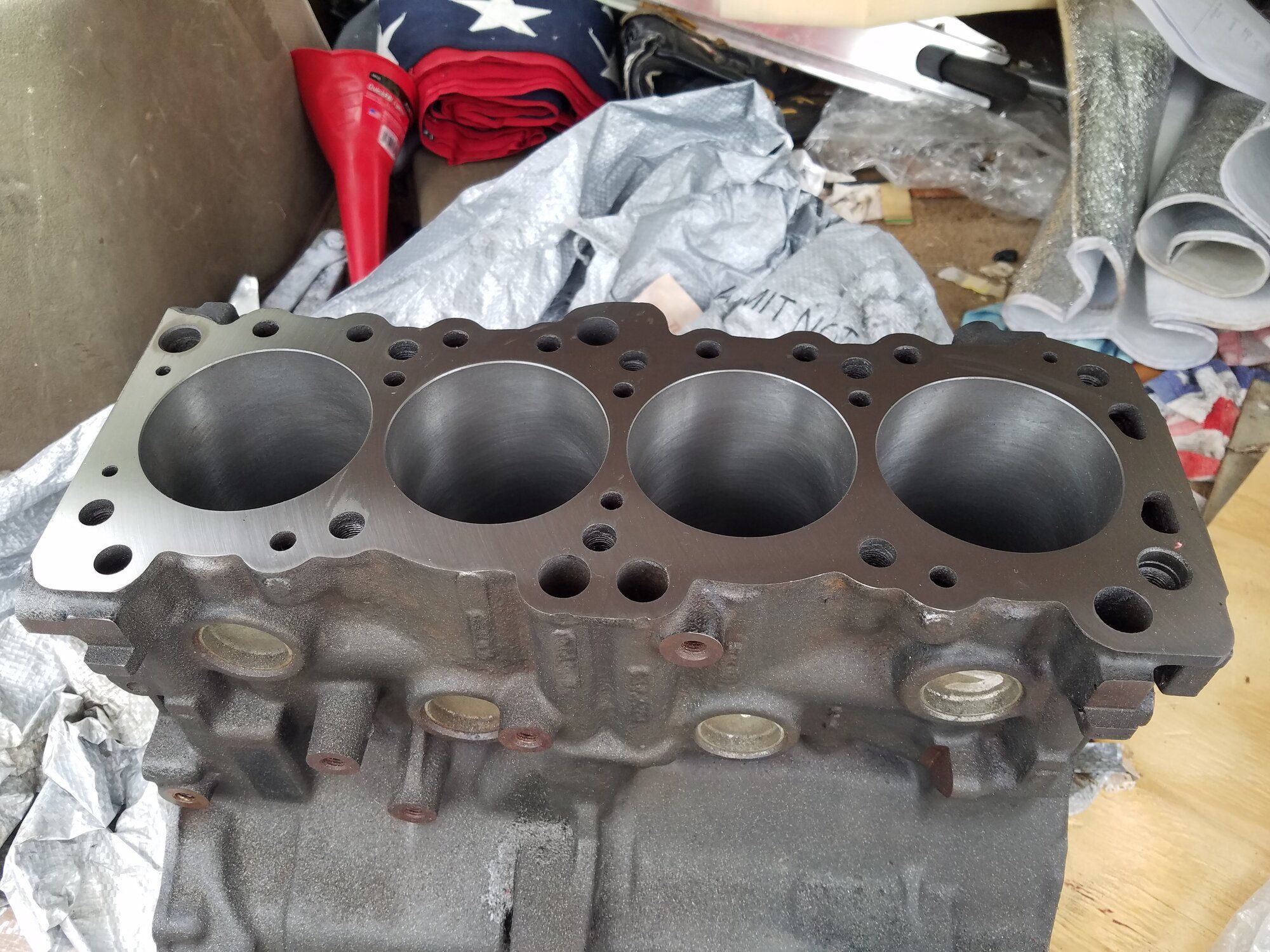

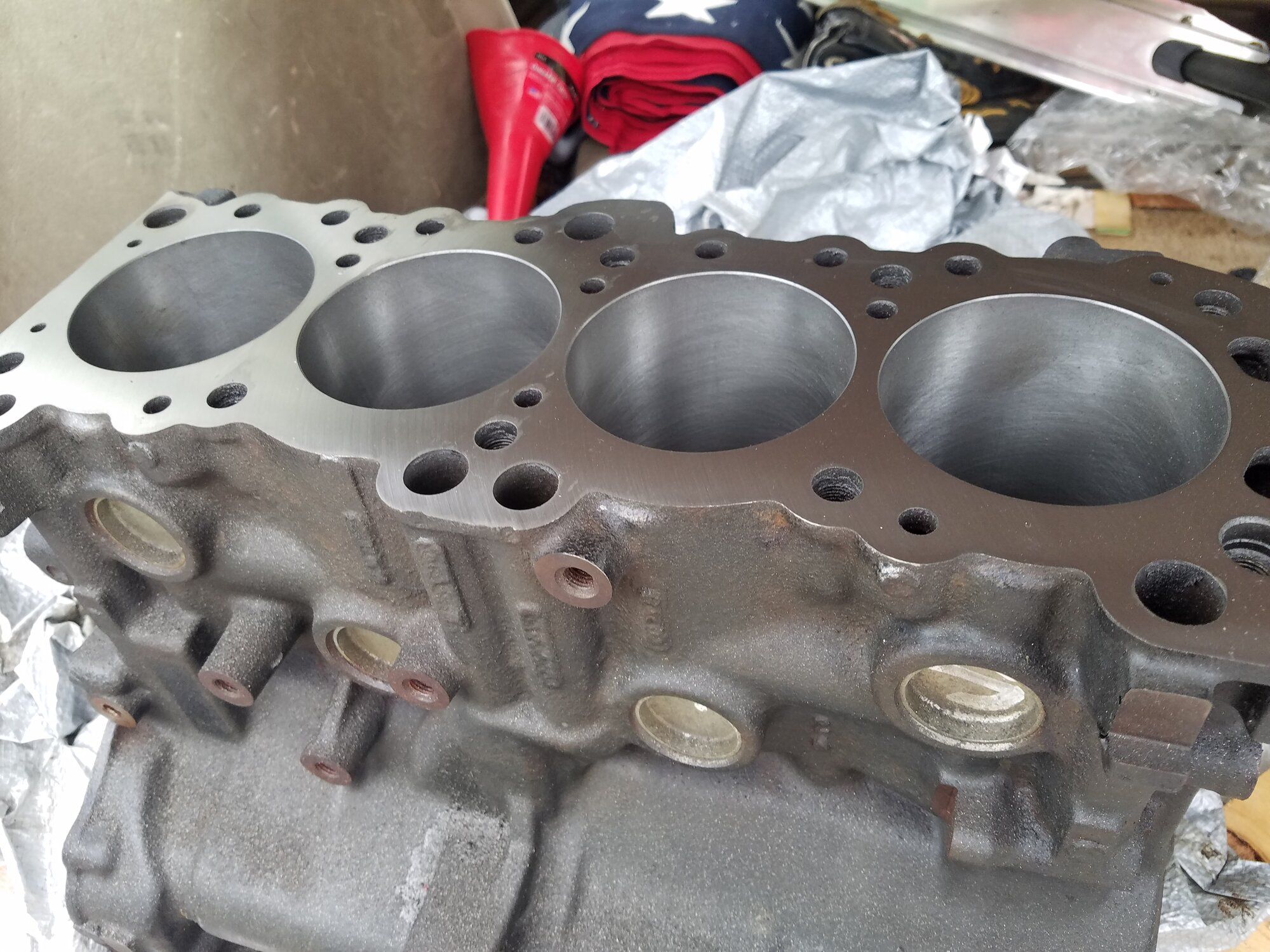

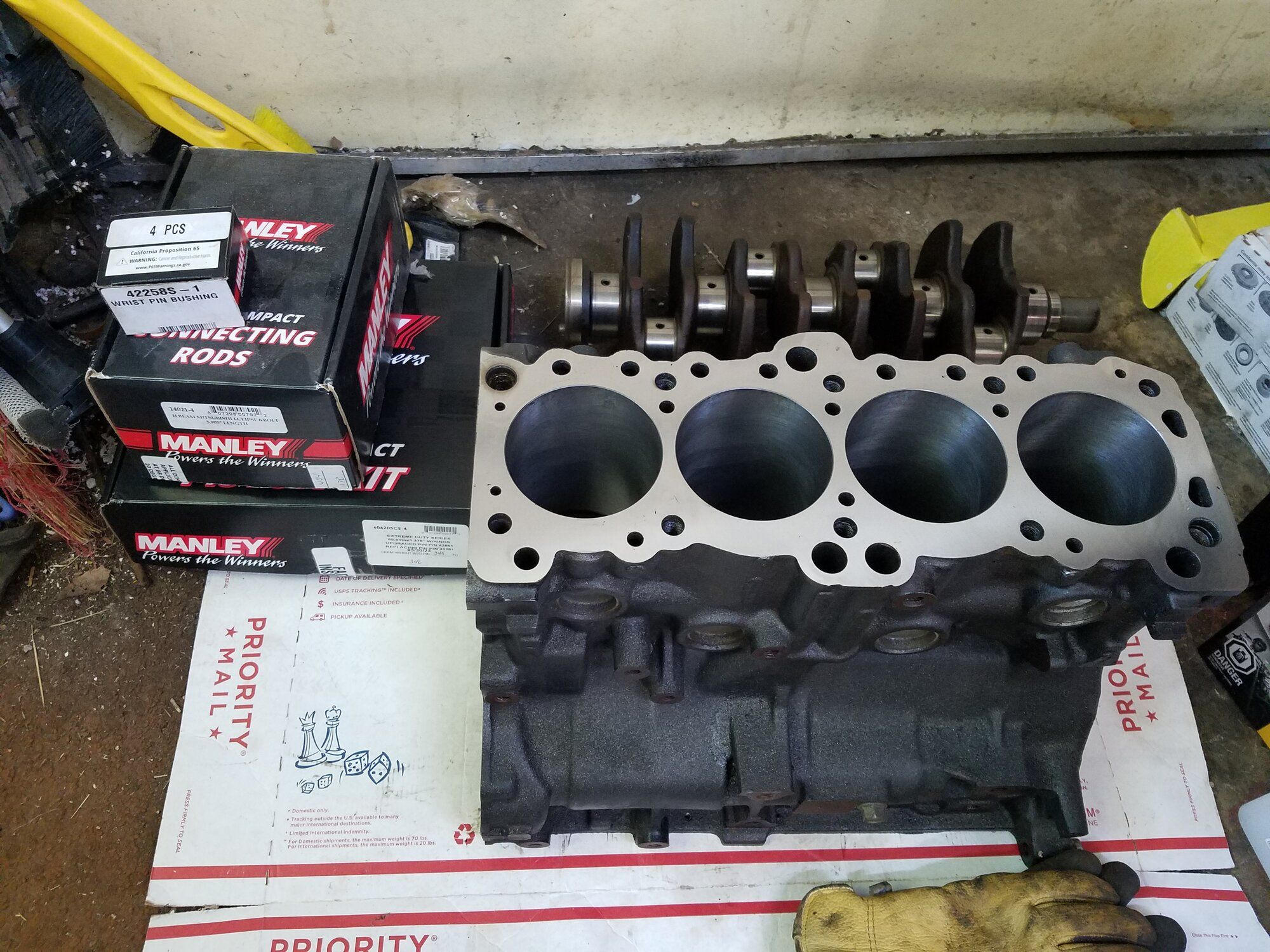

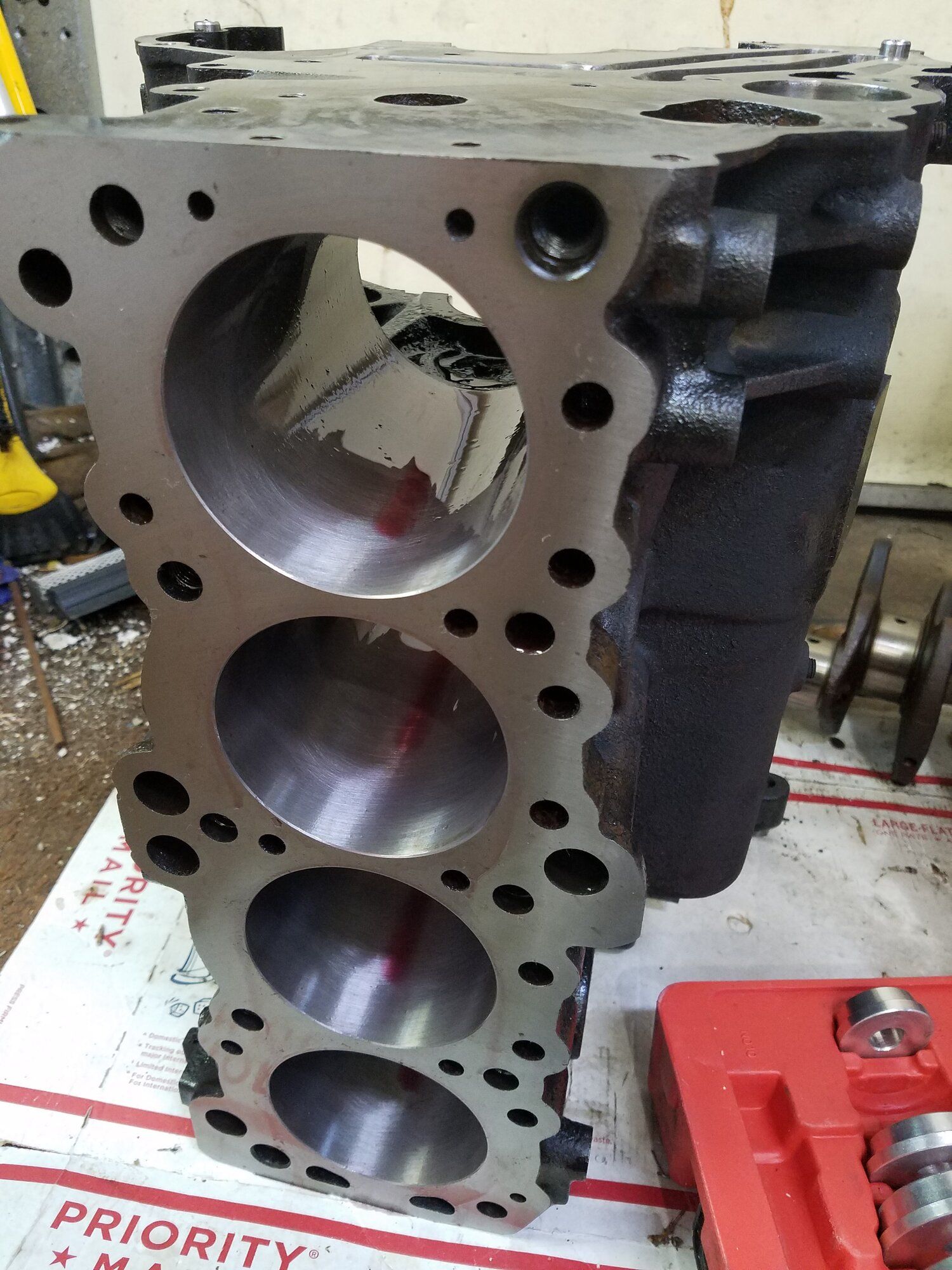

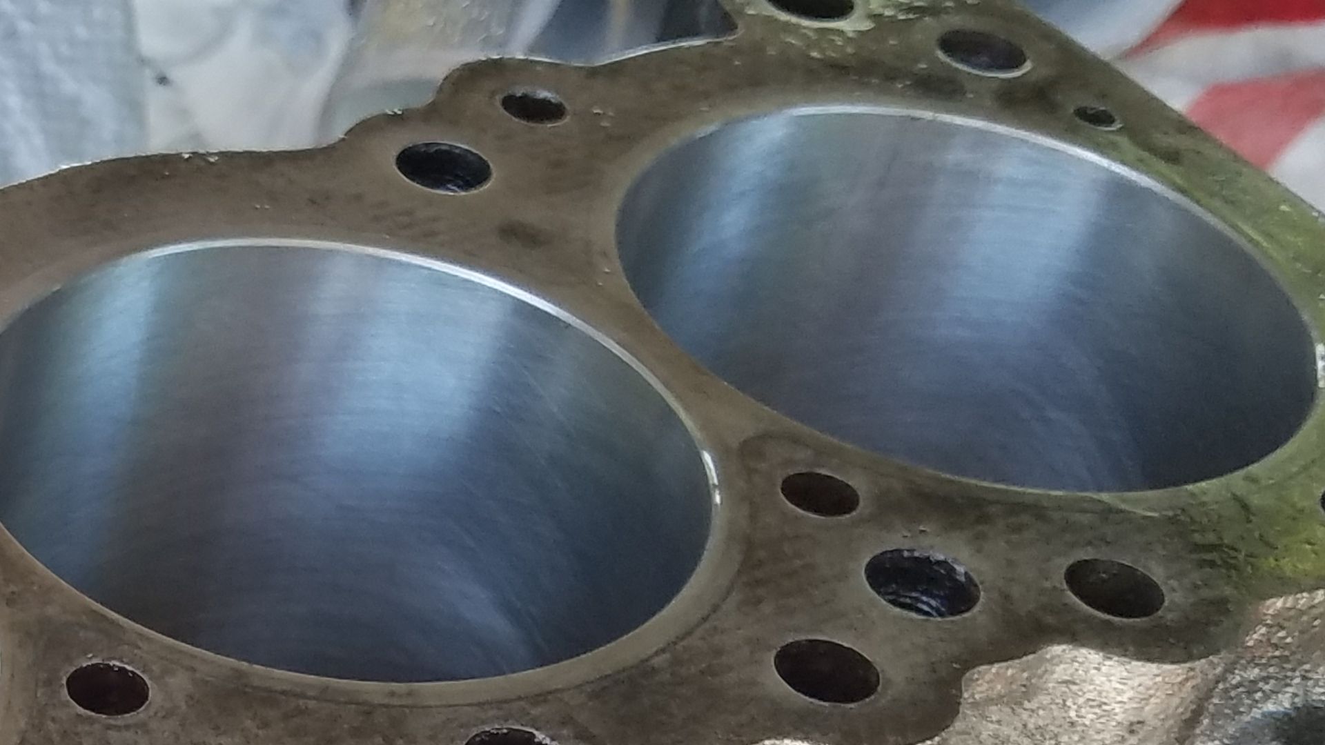

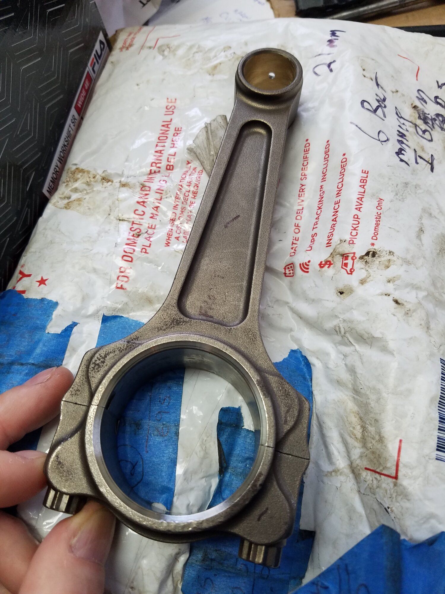

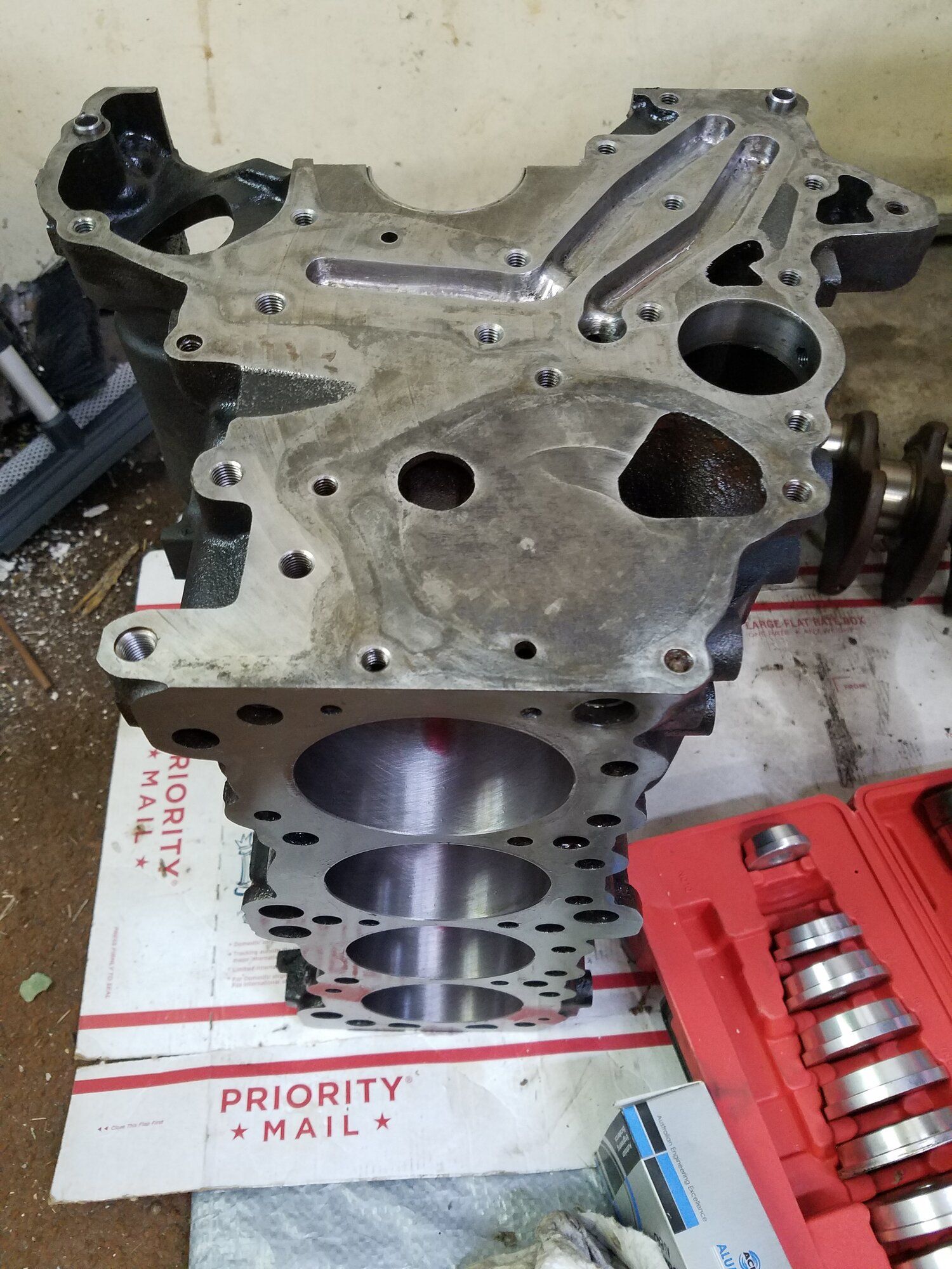

Well I got my block and rods back from the shop today so here are some FRESH pictures. I haven't cleaned the block yet or punched out the balance shaft bearings for a BSE but that will come.

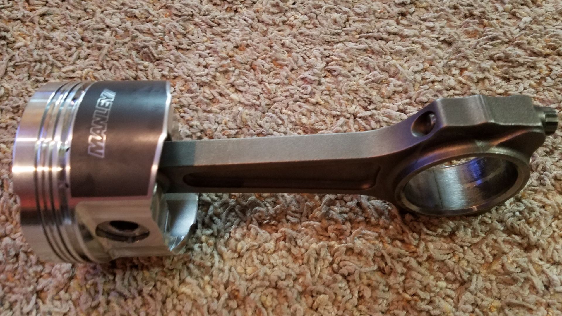

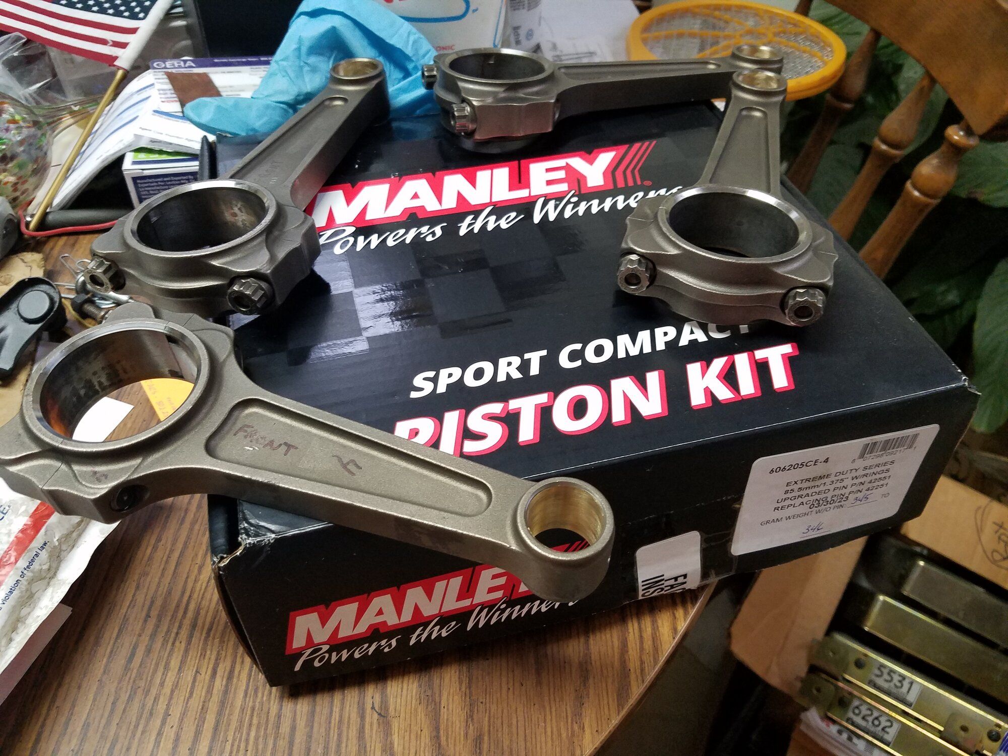

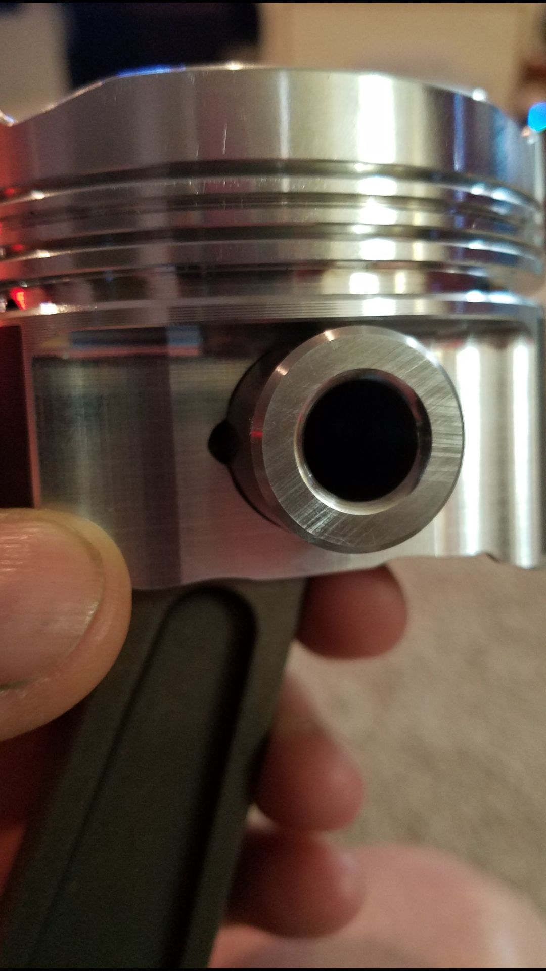

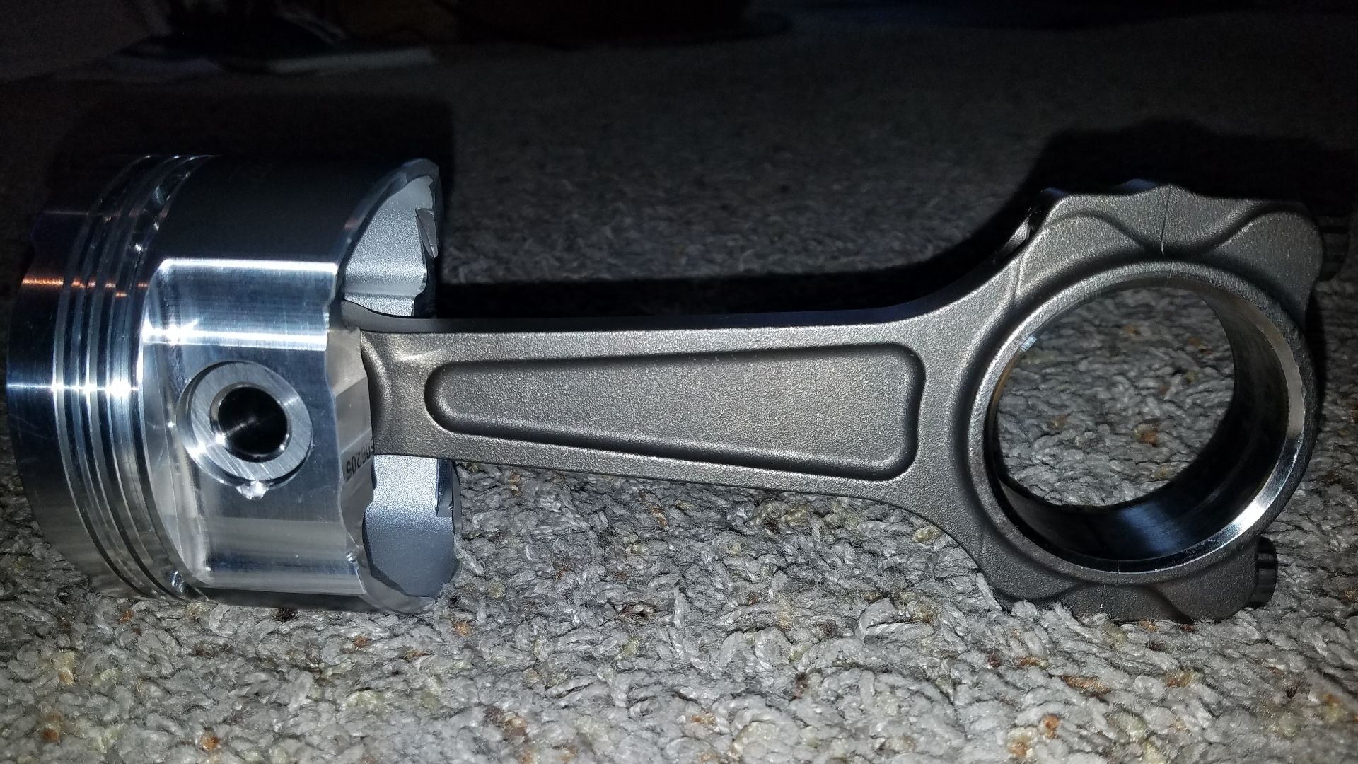

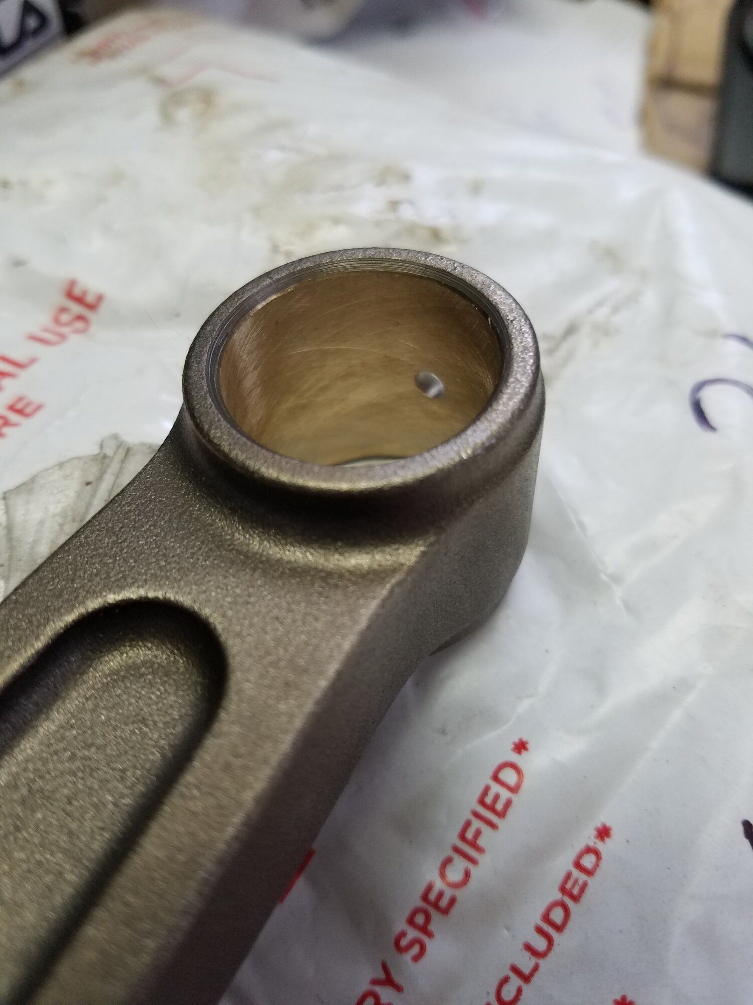

These rods WERE 21mm now reemed to 22mm and feel fantastic! No wobble to the pin, which is why I hadn't used them yet.
My machinist said it took 20 minutes a piece to do the rod ends with precision and I checked all 4. Man they are slick!!!
Thanks and a shout out to Privitt Machine Shop in South Coffeyville OK!!!
Total cost, under $300!!!! :thumb:
I asked for .004" PTW clearance and he agreed that with what I am doing, it need room for expansion. Good man!

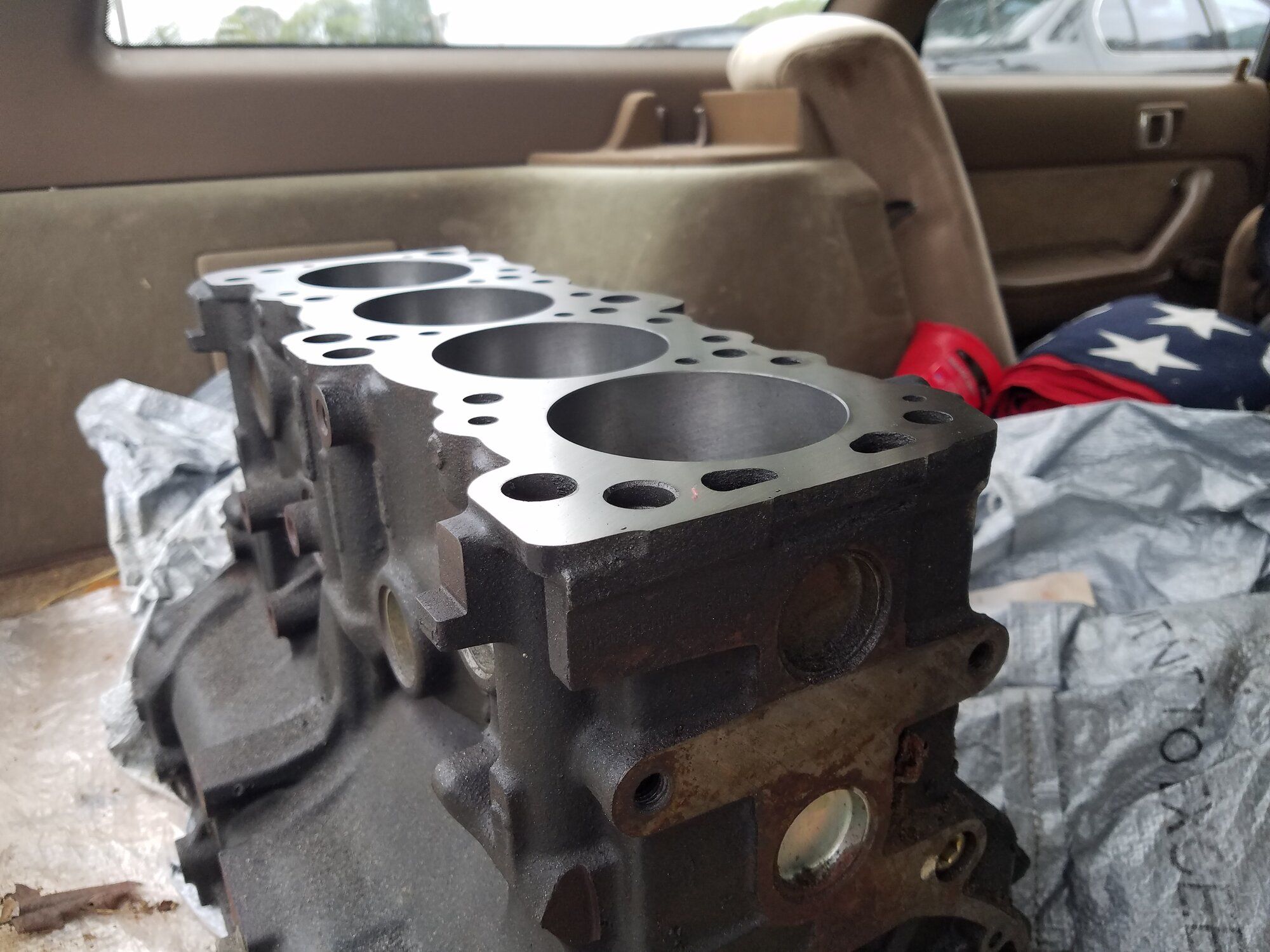

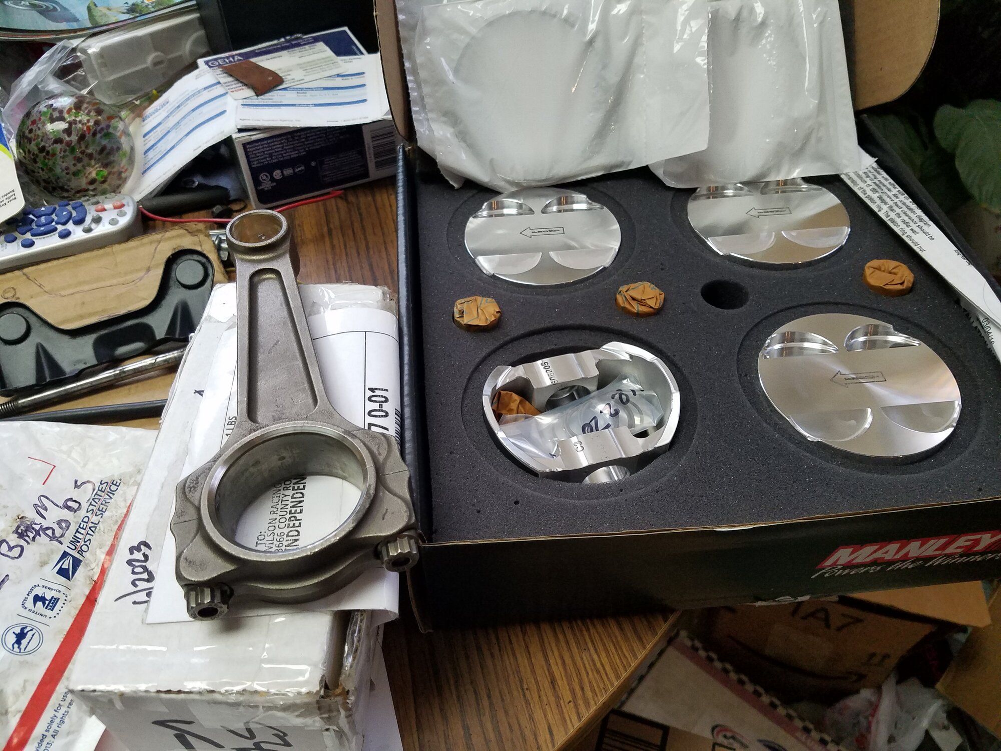

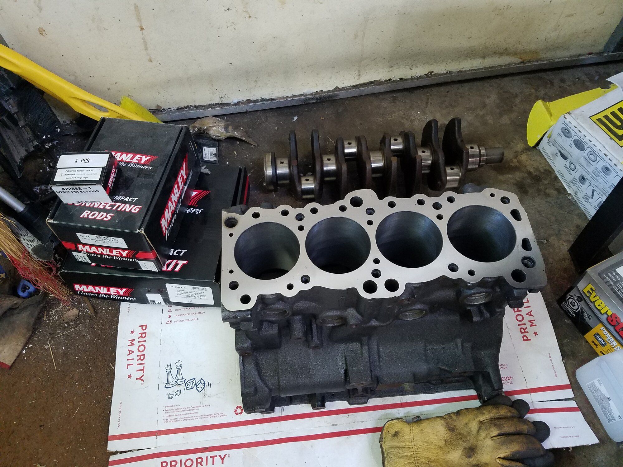

I got my block back from the 2nd machinist. My boring man would have sent it to this shop anyway. Nice fresh cutters on the machine for a great decking. Parts ready but I am in some of my other projects currently.

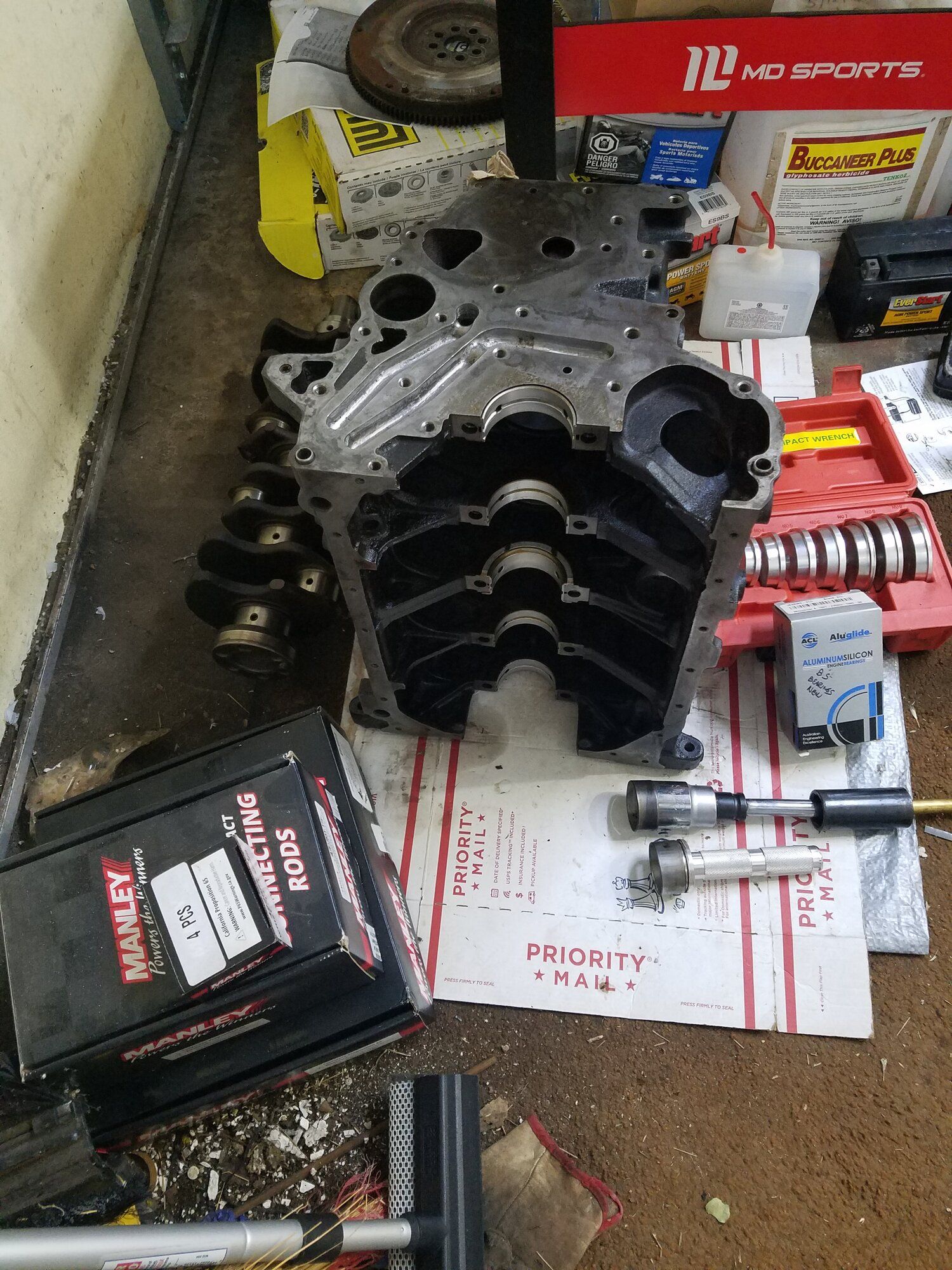

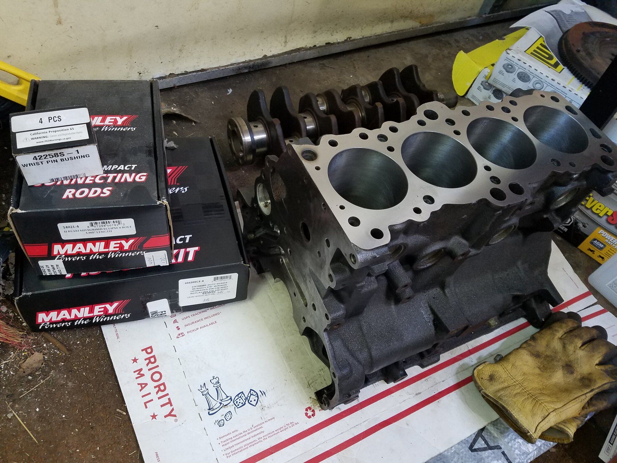

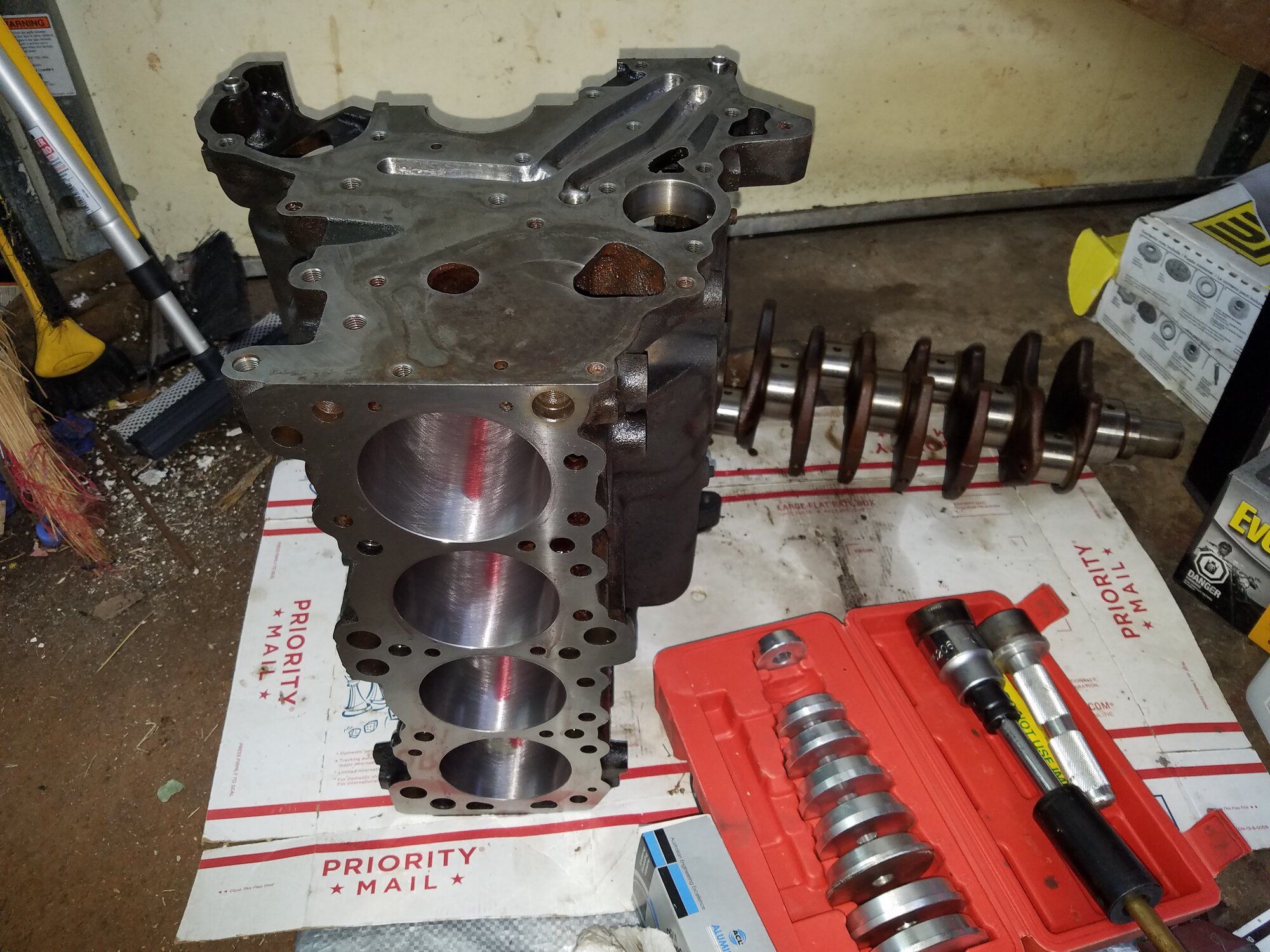

Well with 100* heat, I moved all of the block parts to the cooled garage for checking clearances and possibly assembly.

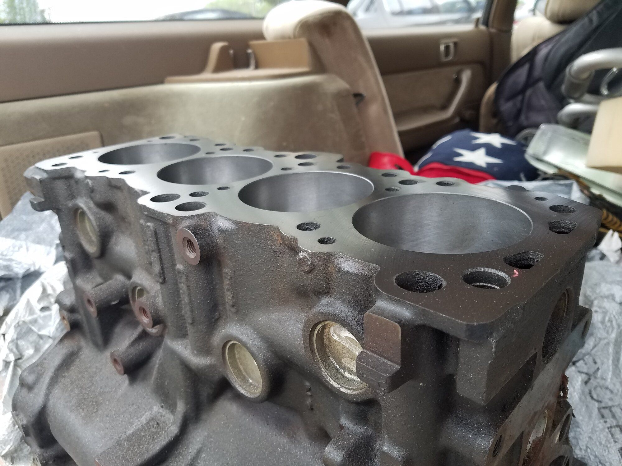

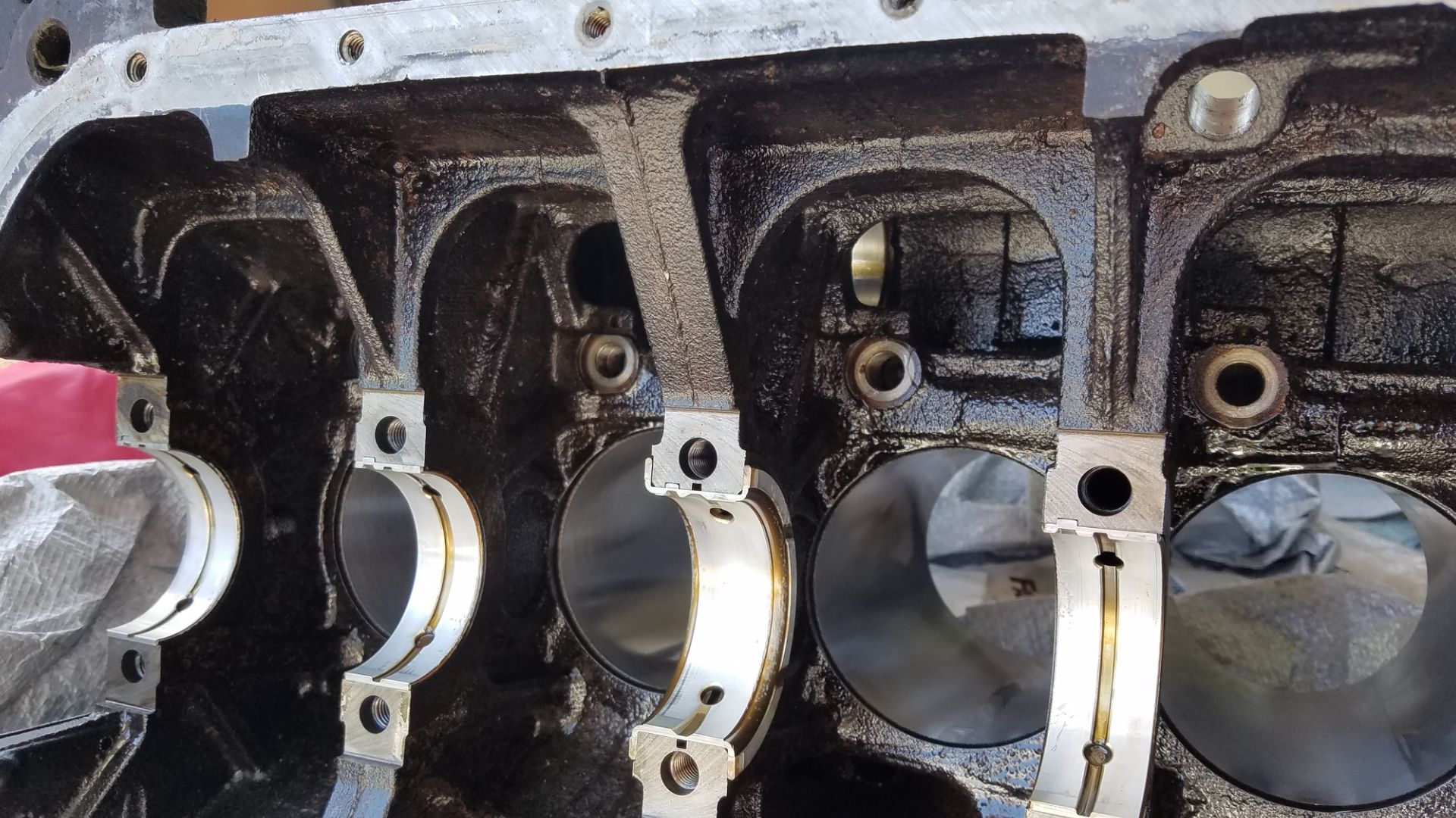

Block got punched. 020" and the stock crank "looks" good but #1 main needs a massage. I'll check it all out and hope I don't need a crank. Fingers ceossed!
I went out and grabbed the bearing race tool also so I can knock out the BS bearings and take her for a good cleaning! :)
Marty

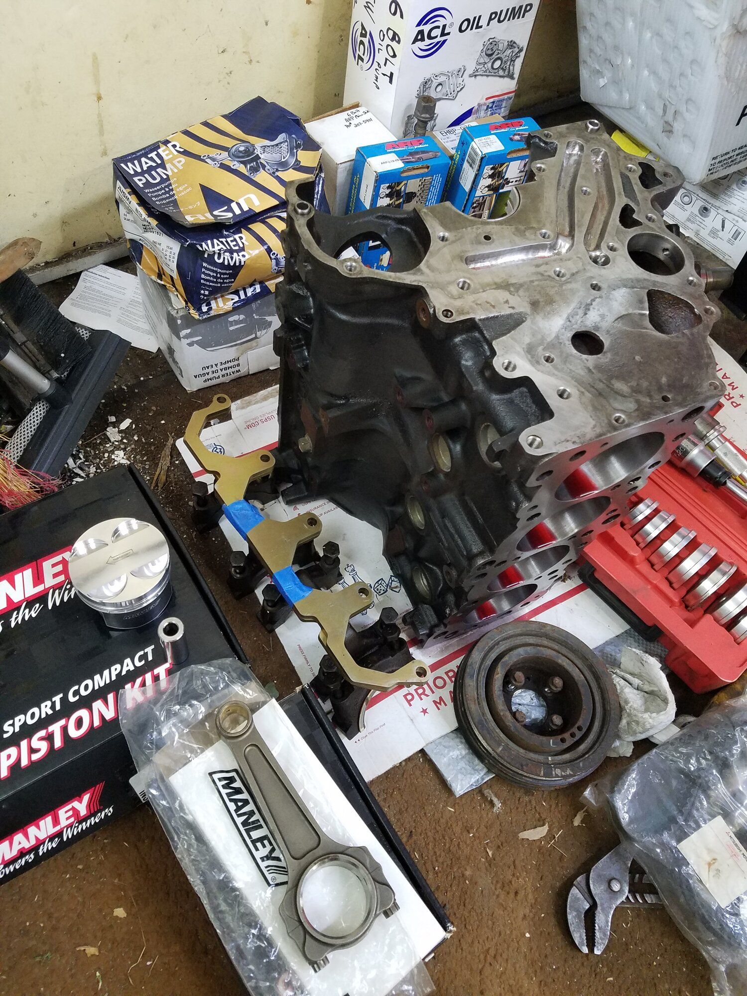

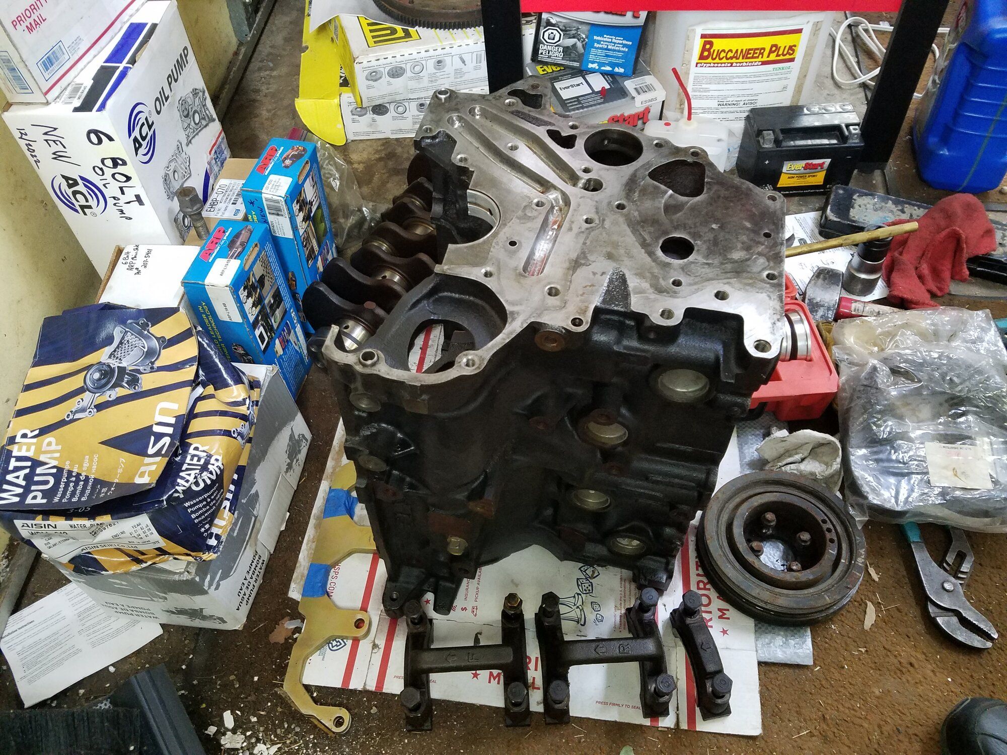

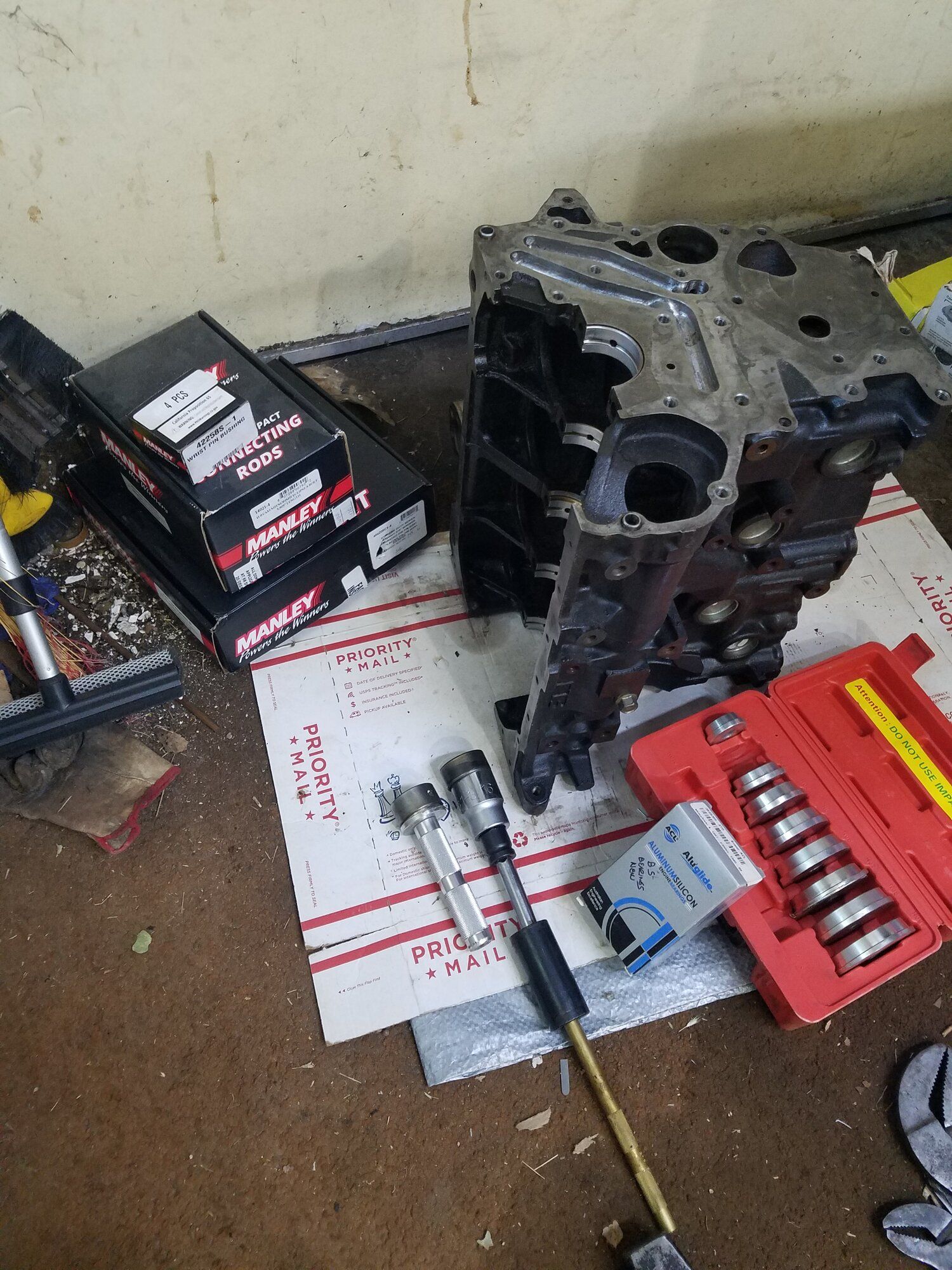

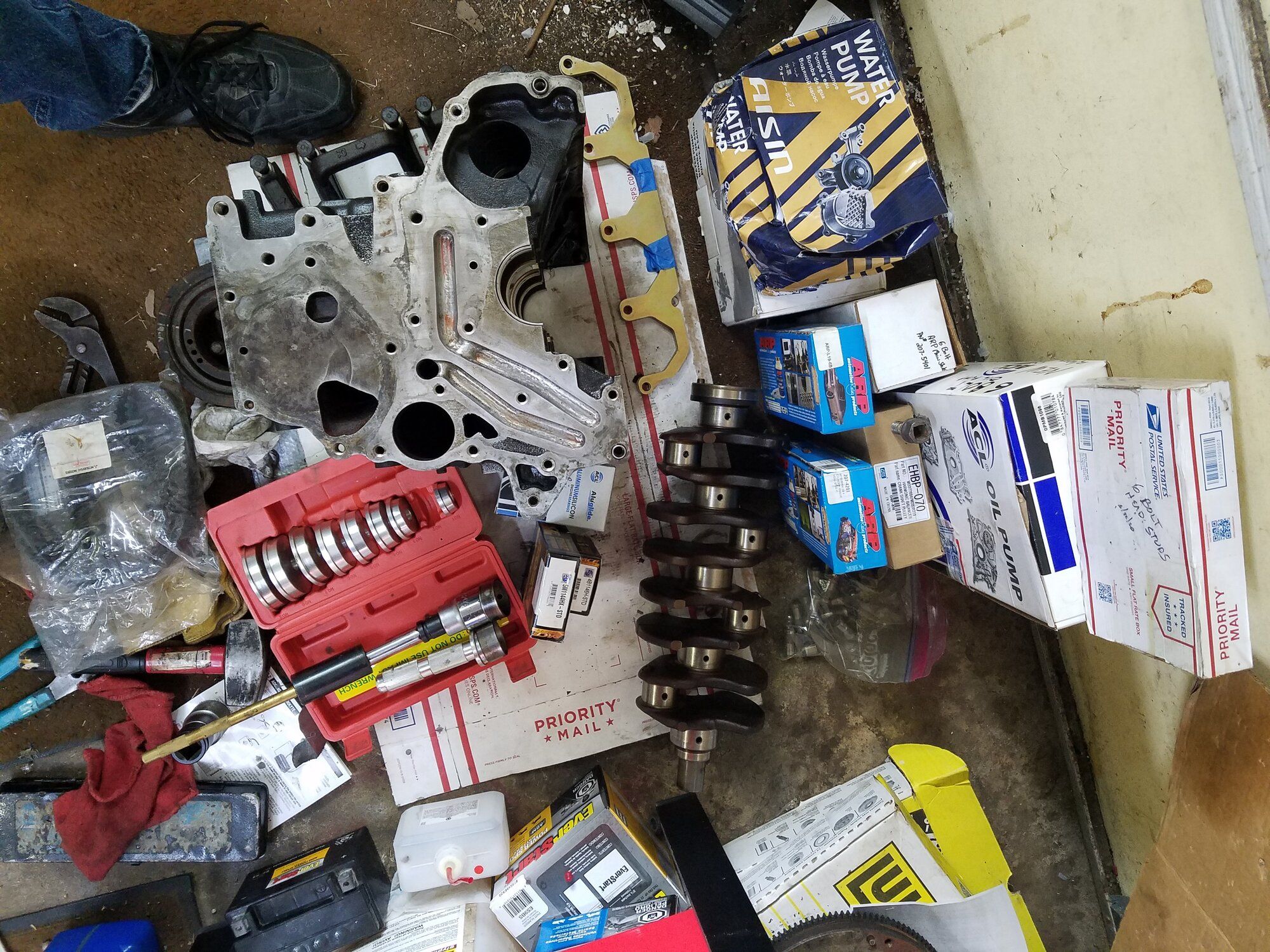

A small update on the Red 90 Talon new short block (hell maybe longblock).
I got the BS bearings knocked out and need to get the freeze plugs out for a good wash down and cleaning then I'll wipe it all down with ATF to keep it from getting surface rust until I can wash the cylinders out and ready them for the new pistons. The old main bearings look great so maybe the crank is in similar condition, I haven't miked it yet but will soon.
Progress, slowly but still progress with all the other things we have going on. :thumb:

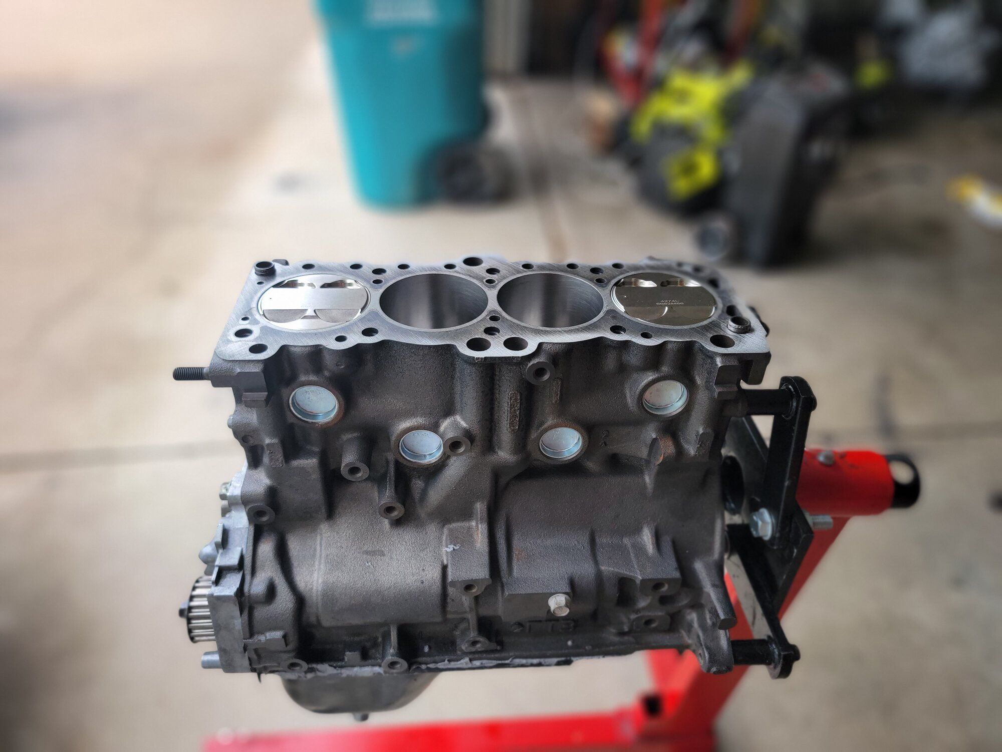

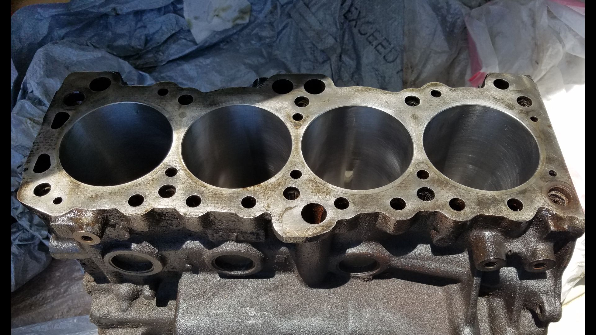

Well to show I didn't get totally burned out on the platform, I took her new heart to the carwash for a good bath and then a wipe down with ATF to ward of flash rusting. It all looks really good so far. I am thinking of maybe building another race head also so I don't have to tear one motor apart for another.
Anyway, a couple pics. It's in the garage with A/C so I can work on it anytime, no old man excuses, LOL.
