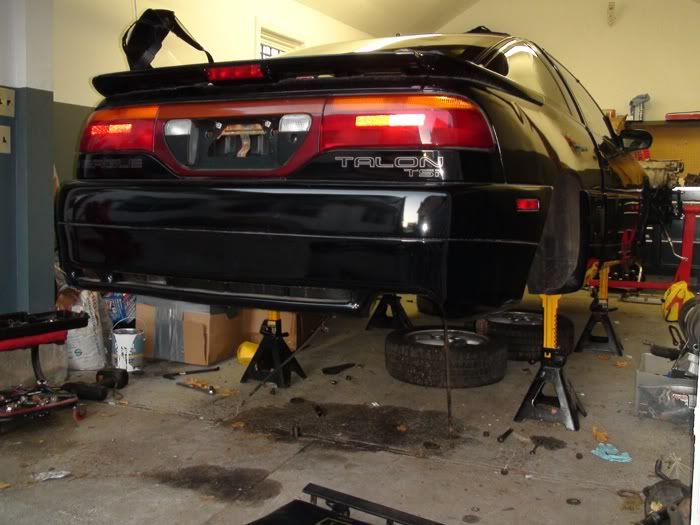

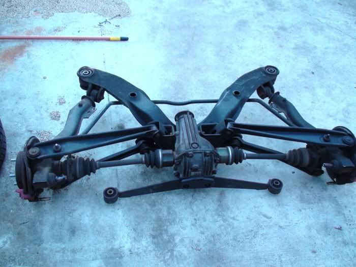

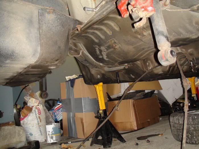

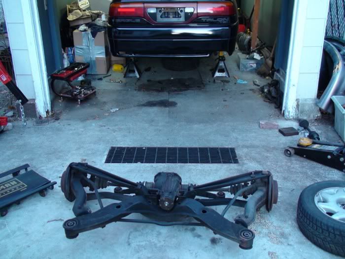

Ok guys, I decided to hold off on the cage for now. JMF is still in the process of moving so the cage will have to wait. Winter is here, so I decided to pull the car in the garage to continue the build. In staying with the build path, I am going to focus on the suspension. The goal is to install poly bushing all around, get the rear diff serviced, install shocks and springs (still need to pick them up), and clean and paint parts. First I started with the rear subframe. Four bolts and a jack to lower it down and it was out. Next up is the front subframe.
