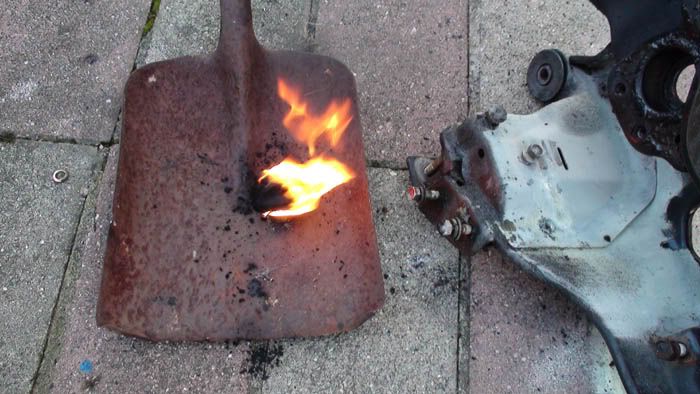

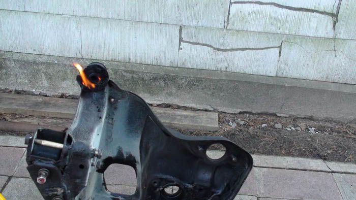

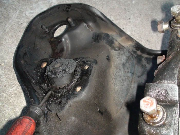

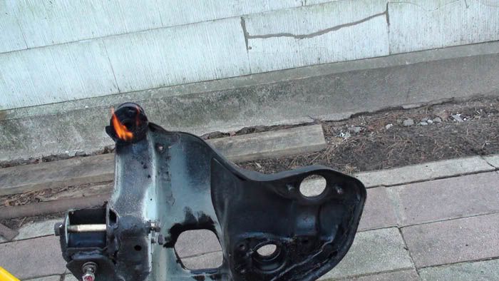

Just a quick update; I have not had much time to work on the car due to the weather and my job. I was able to get all the subframe bushings out. I used a propane torch to set the bushings on fire. The heat will soften them up. It takes a while, but eventually they catch on fire. I then used a screw driver to pry them out. It takes a little bit of work. After you get the first one out, the rest come easy. I just have to clean up the subframe, install the new bushings, and paint.

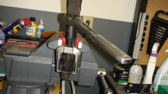

I was able to get the front control arm bushings out today. These bushings are actually easy to remove. There was no need for the torch. I simply clamped the control arm in the vice and used a separater to push the bushing out. These bushings are not bonded to the arm, so they came out easy.

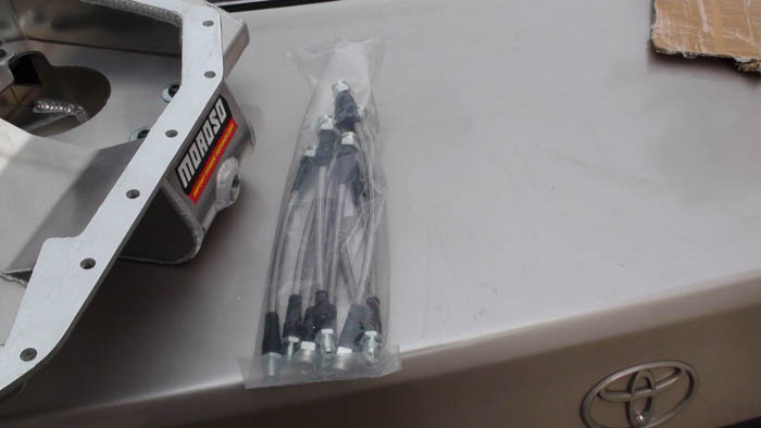

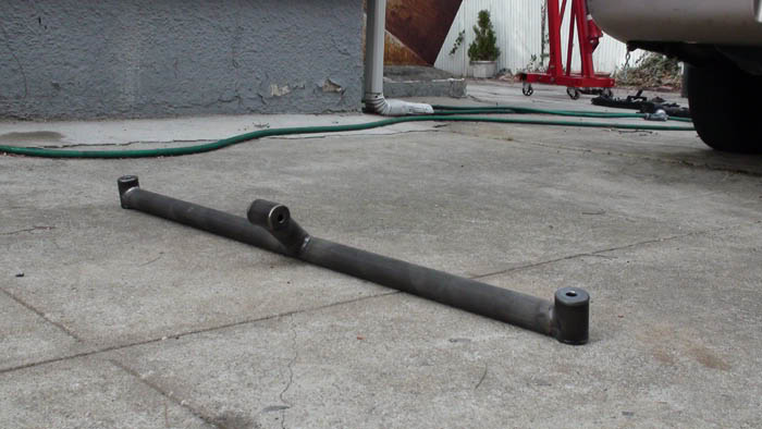

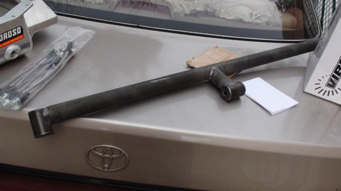

The project continues. I have been busy lately with work, so I have not made too much progress. Funds were low recently, but I was able to buy some more parts, nothing major. I picked up a tubular crossmember and some brake lines. I also picked up a used Moroso oil pan, but this is for my other car. (I would like to do some roadracing this year with my DD.) I hope to finish the suspension shortly and send the car to JMF to get the cage put in.

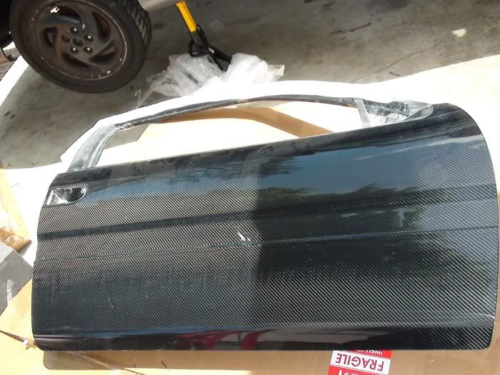

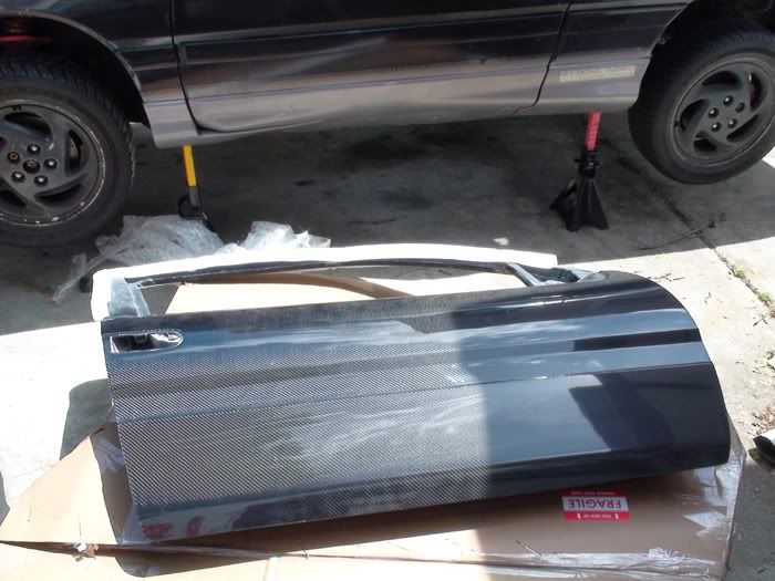

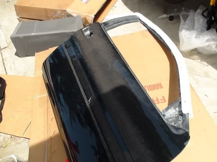

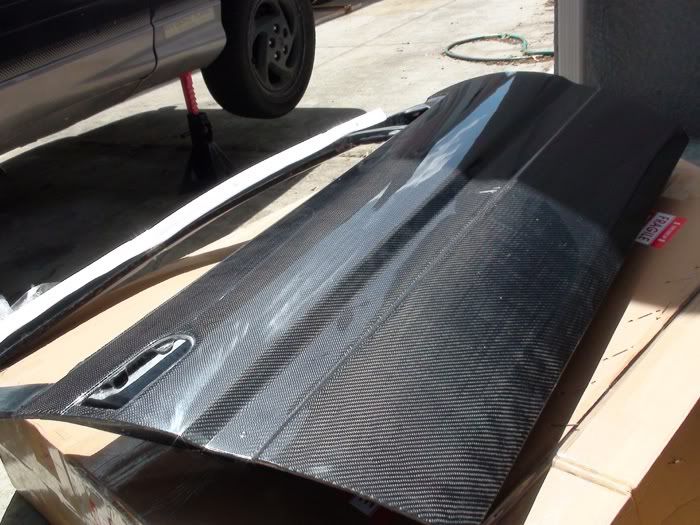

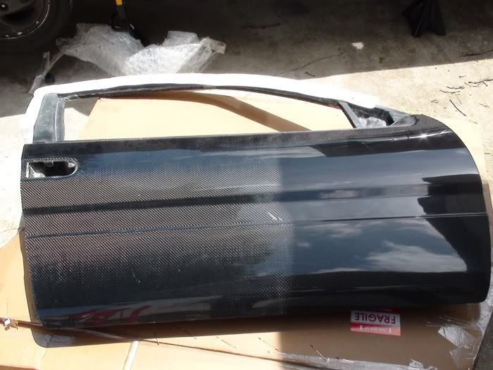

Ok guys, just a quick parts update. Been out of town working lately so I have not made much progress. I did however pick up some CF doors that I got from Gt fabrications. This should help reduce some weight. I got a great deal so I had to get them. Check out the pics. They look really good and have all the correct bolt locations. I'll keep you posted on fitment.
I was thinking about going with CF parts but after seeing how easy some of that stuff cracks I didn't want to have to worry about that while driving on the street. Looks great though and should set off the outside of your car real nice.
