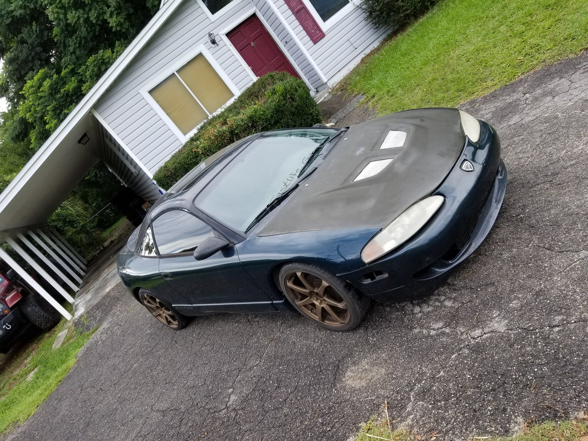

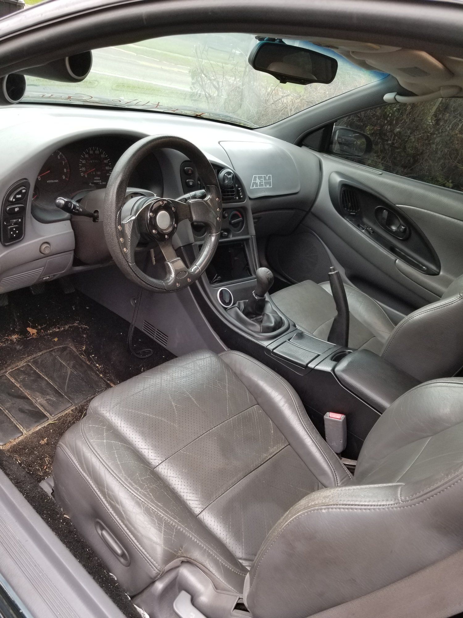

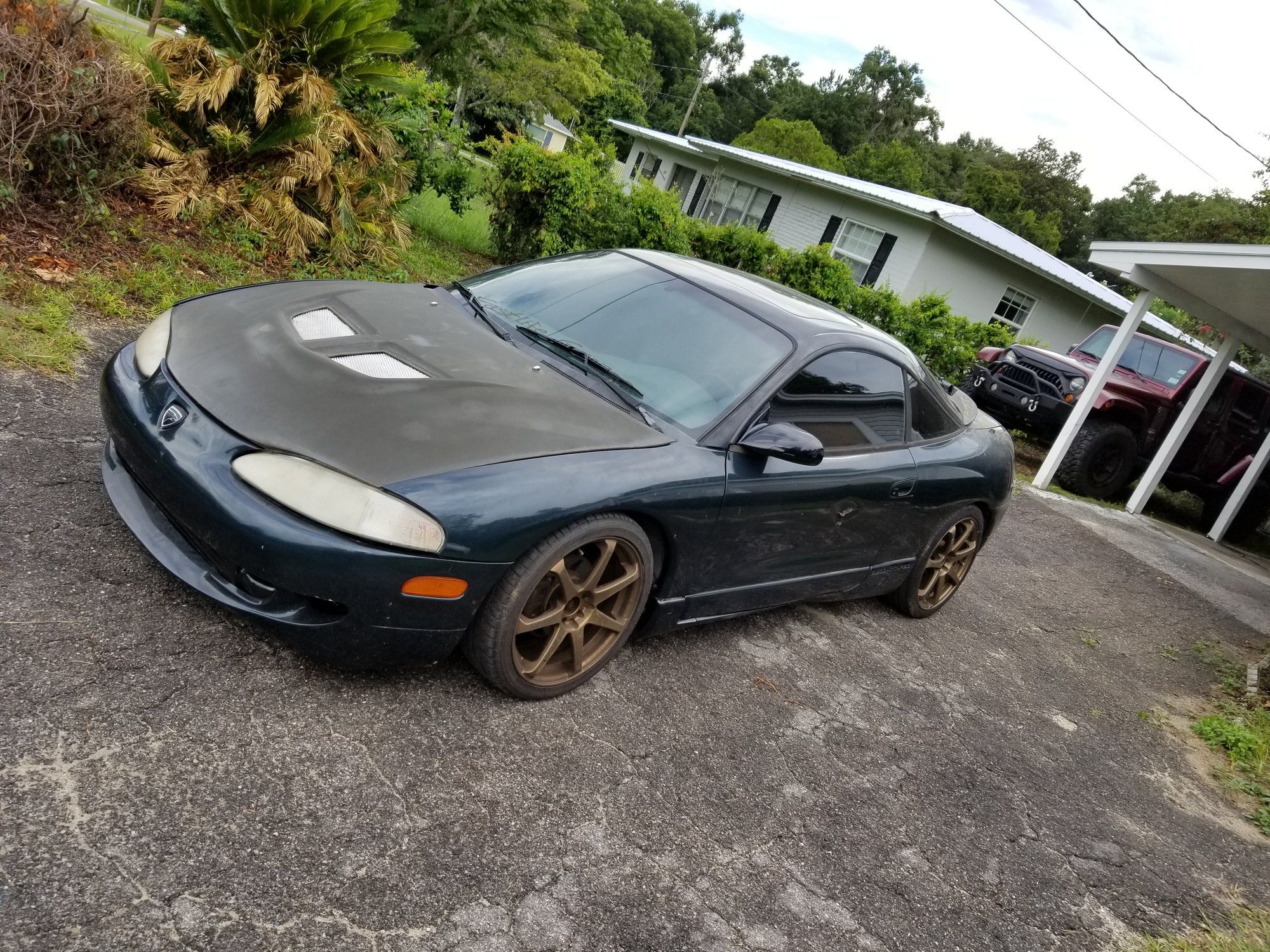

My First Project Car -- '95 Eagle Talon TSI AWD
Got this Talon TSI AWD in May of 2018 in rough shape. Plan to bring it back to running order and learn a bit in the process.

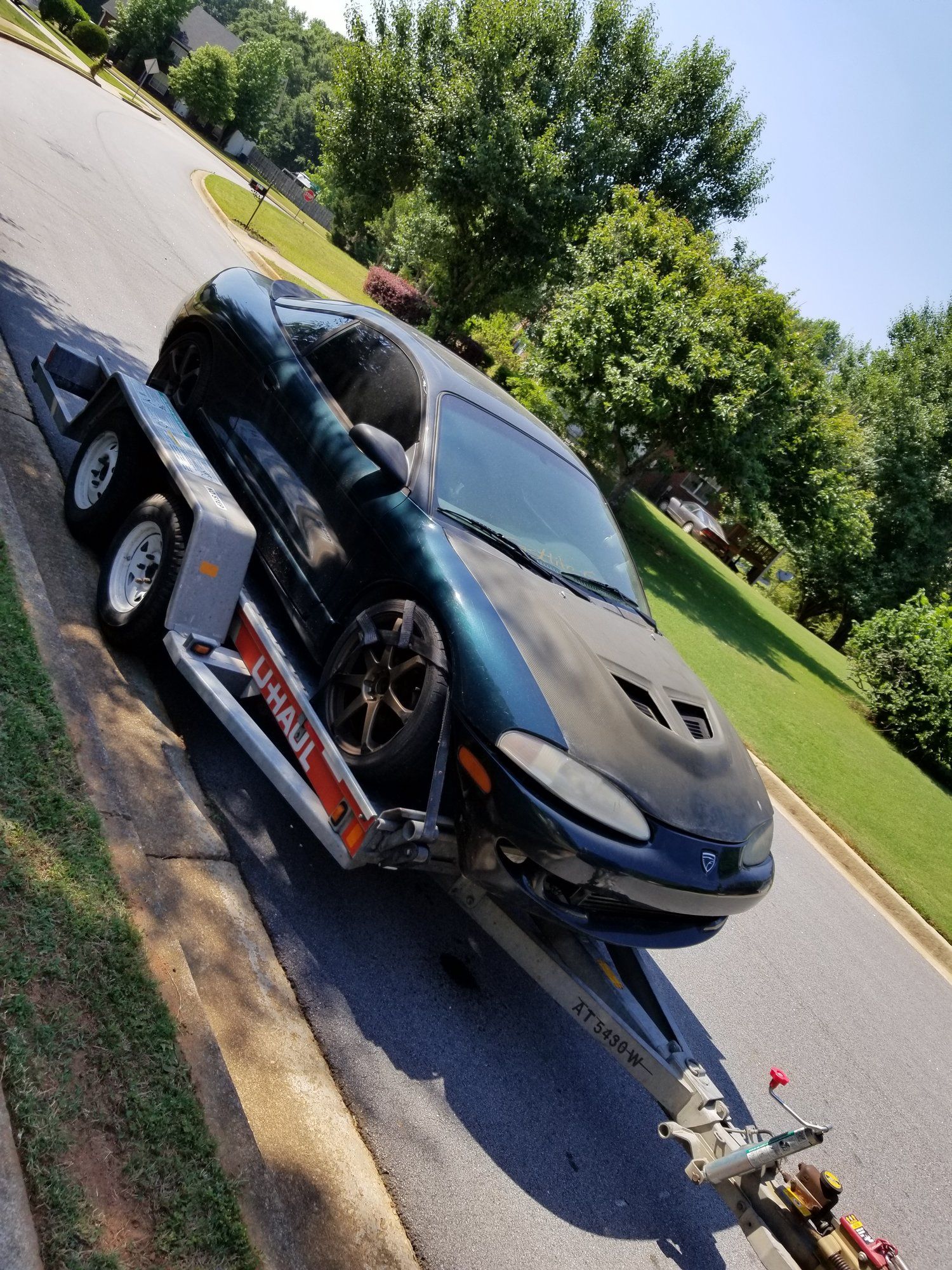

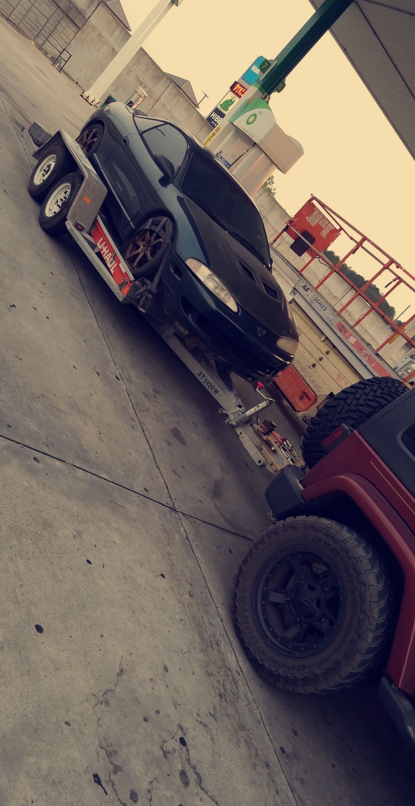

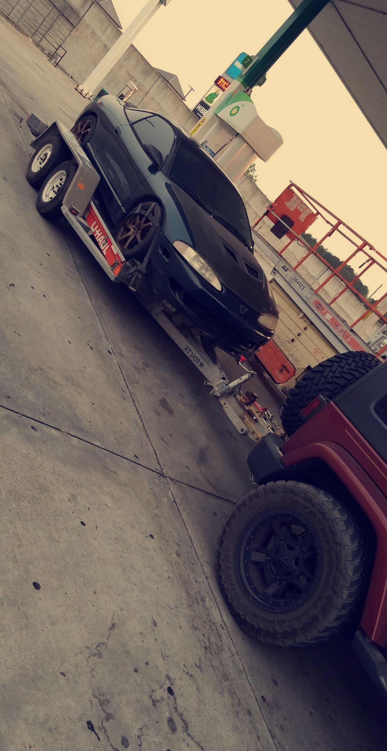

After a few months of searching, I found a guy with a '95 Talon TSI AWD up in GA. Took a cruise up there and ended up bringing it home. It was in rough shape, not running. Previous owner told me all it had made 438 WHP, but had since sat for a while and all it needed to get going was an ECU and a MAF. Well, I talked him into selling me a black box ECU while I was there.
