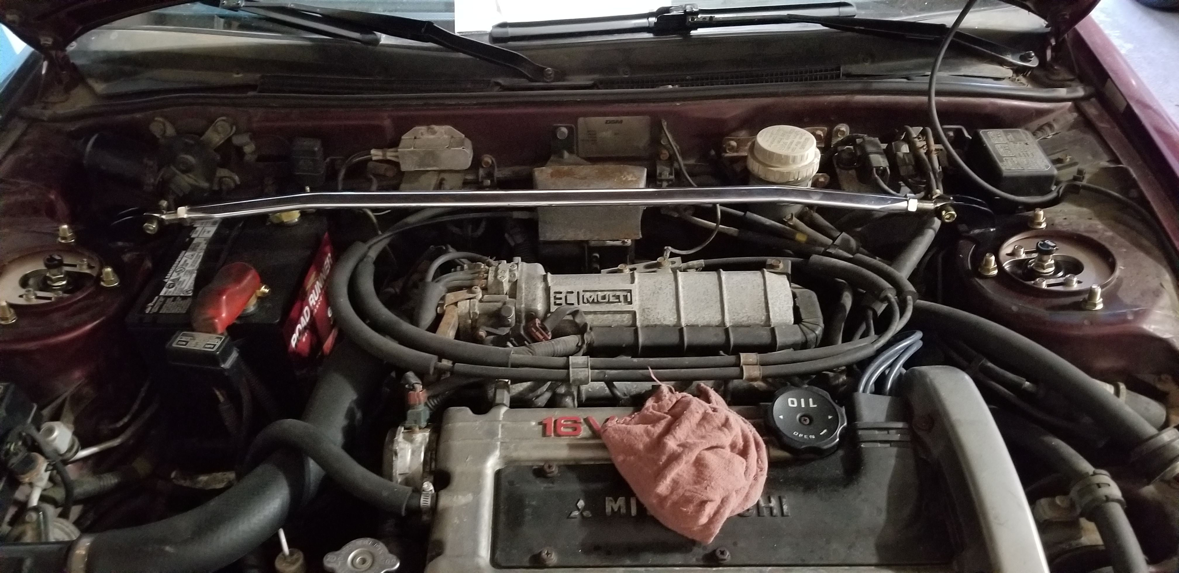

Bought bone stock with 98k and minimal rust in MN
im getting ready to upgrade my fuel system but am looking for some input/pointers when building a fuel system.
Supporting mods
Punishment Racing? Full Exhaust
FP Manifold
FP Green
VRSF FMIC
2G MAF with 1G adaptor
Extreme PSI intake
Kelford 272 Cams
AEM TruGears
ECMLink V3
Stock Block
My plan is to run E85 (current fuel system is completely stock) and hoping to be in the 400-450hp range.
I was considering the FIC-1650cc High Z injectors with the resistor pack plug delete. i don't want to buy too big of an injector, but I also don't want to buy something to only have to buy bigger injectors again. also still trying to figure out how much of a difference and what to choose between the High-Z and Low-Z injectors and what would be best for this build.
to go along with that I figure I should replace the fuel rail and notice that those have a -6AN or a -8AN fitting. with a new fuel pressure regulator too. is there much of a difference between those two choices? will the -6AN restrict too much fuel flow? I also would like to fun all new fuel line and fittings front to back, what's the best way to go about that? buying in bulk with the fittings I need?
then that brings me to the next piece I need... the fuel pump.
ive been told that the Walbro 255 with a rewire should be perfect for what I need, then I cam across the 450. Is the 255 good enough for what I want to do with E85? or should I consider the 450?
now for the E85 part, whats the opinion on inline Ethanol Content Analyzer with a gauge readout? worth it? or are there better options to keep an eye on e85 mixes? I do plan on driving this from late spring to early fall in Minnesota but don't want to ruin anything with having poor ethanol content and not knowing it.
im still trying to pull my own while building this car but any input is appreciated.

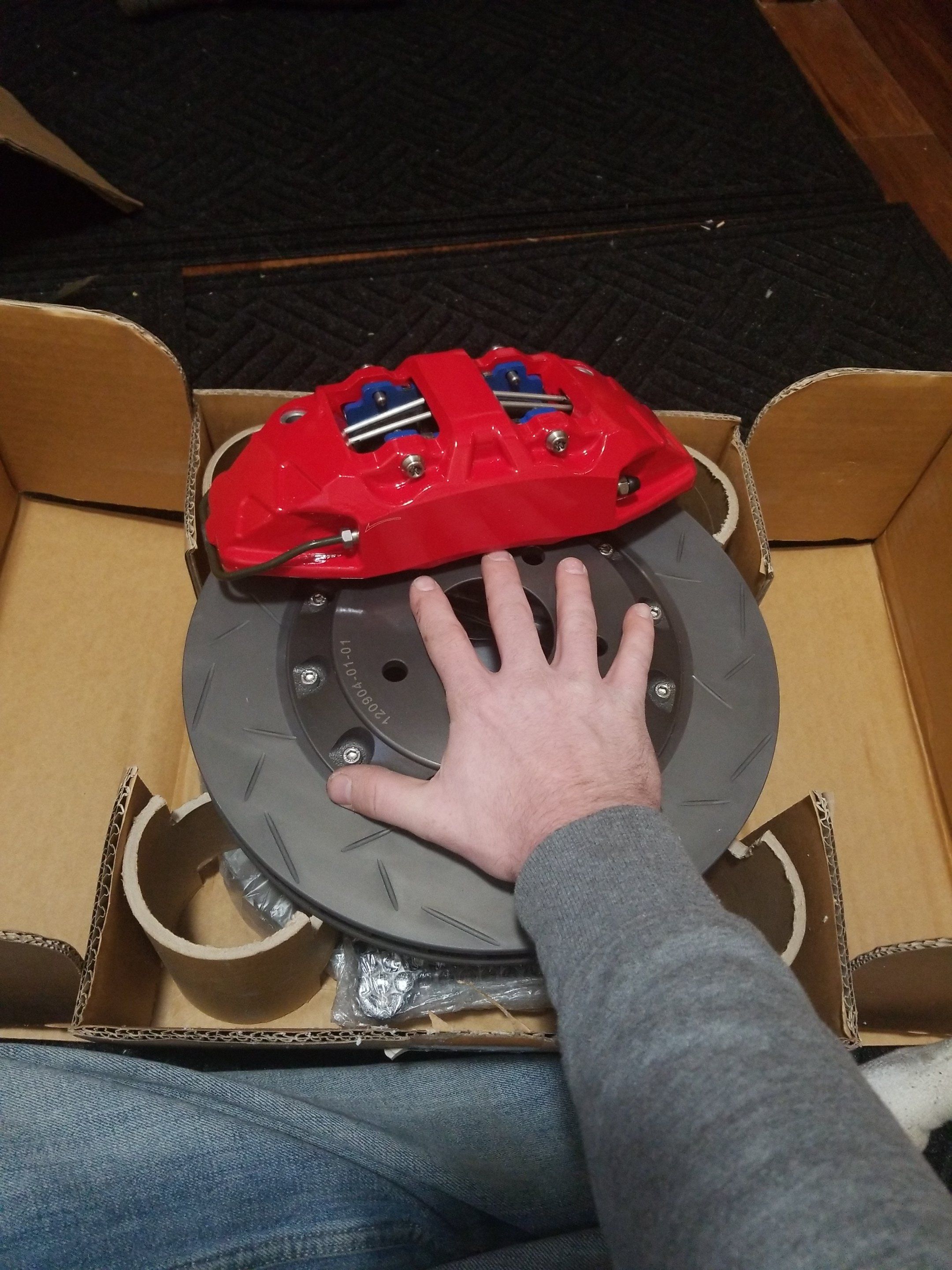

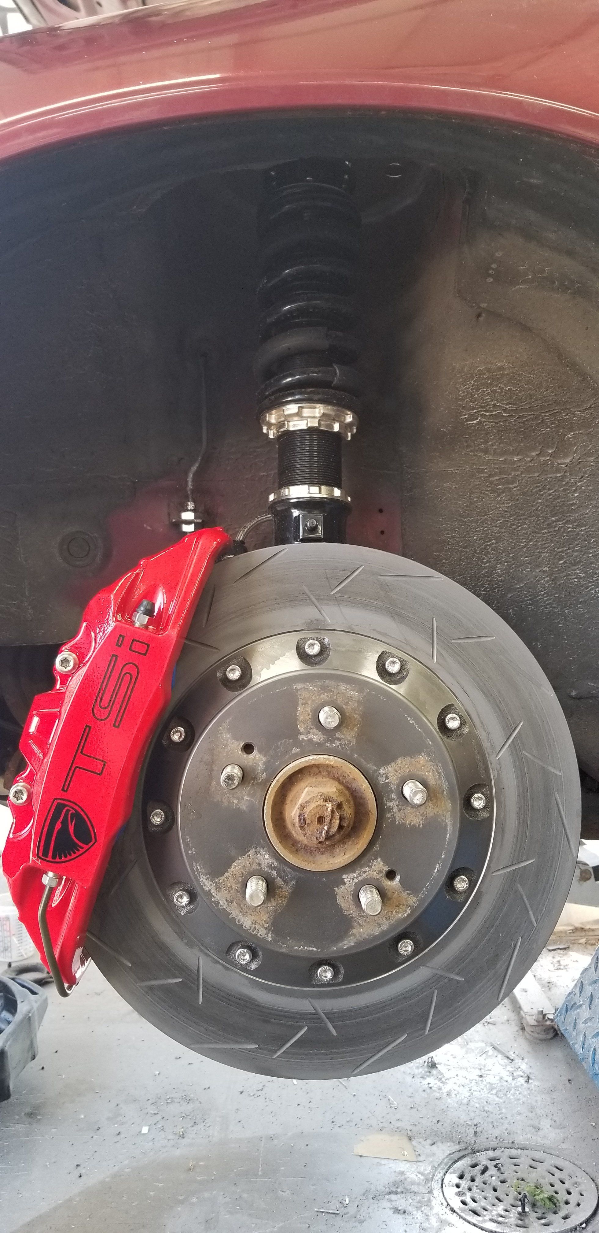

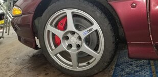

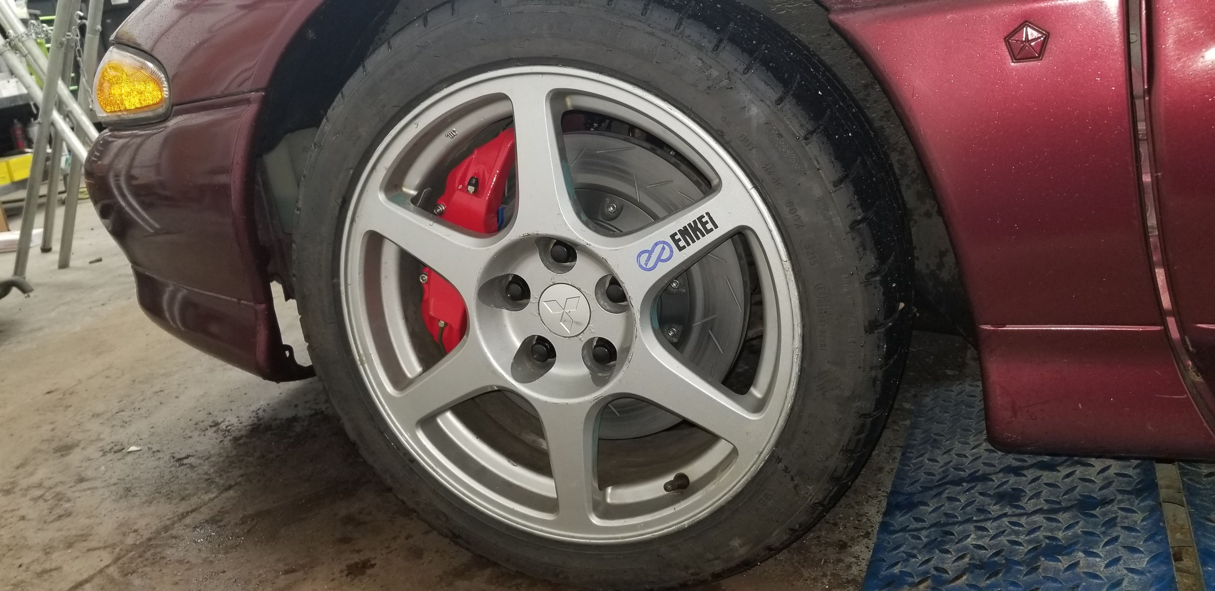

got my big brake kit installed with out too much of a mess made! (working in a body shop really helps me with space and having all of my tools right there for me to use instead of having to bring them home, and a really nice air compressor) I also have new rear calipers, rotors and pads for the rears (since they are seized)

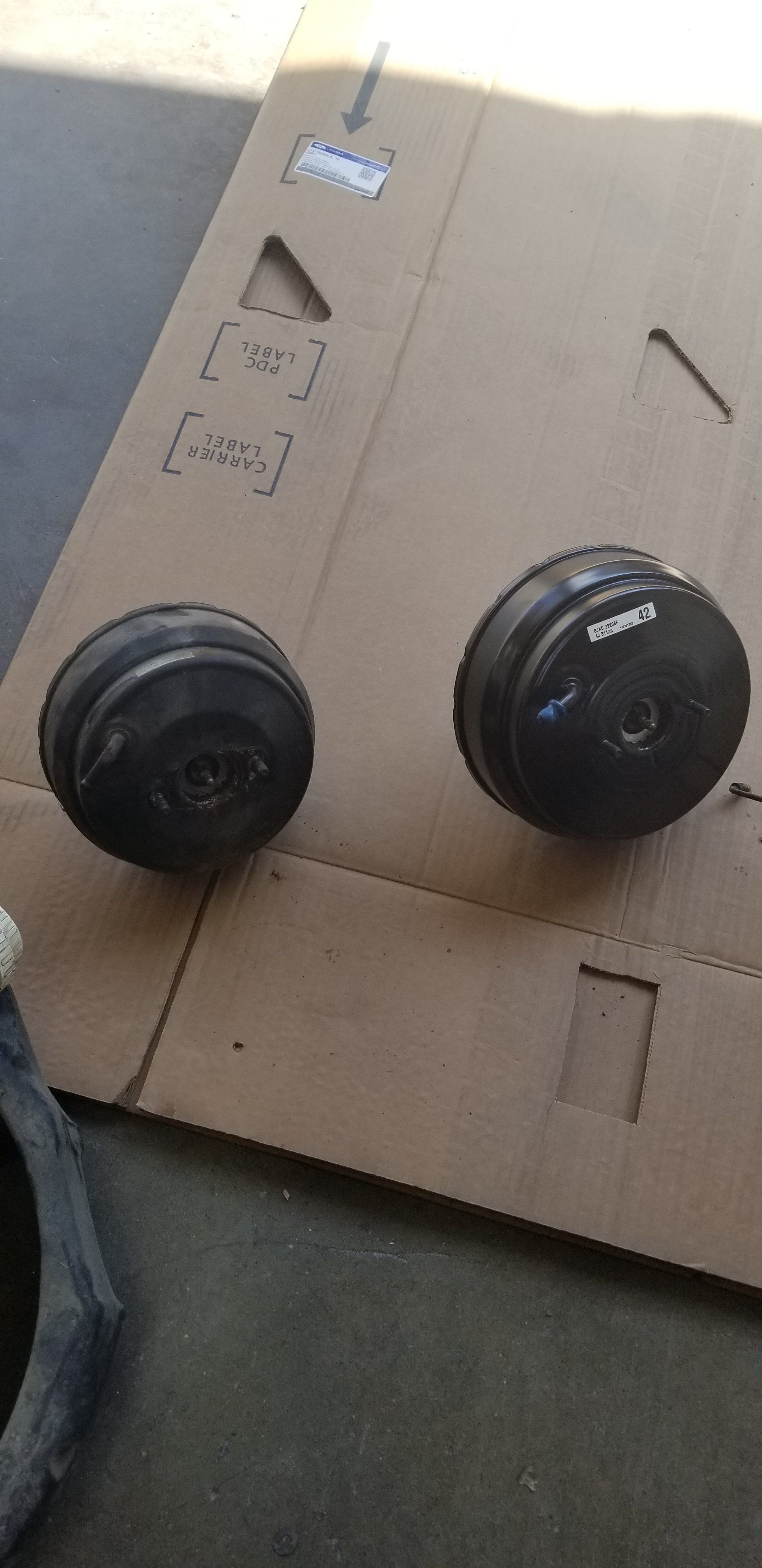

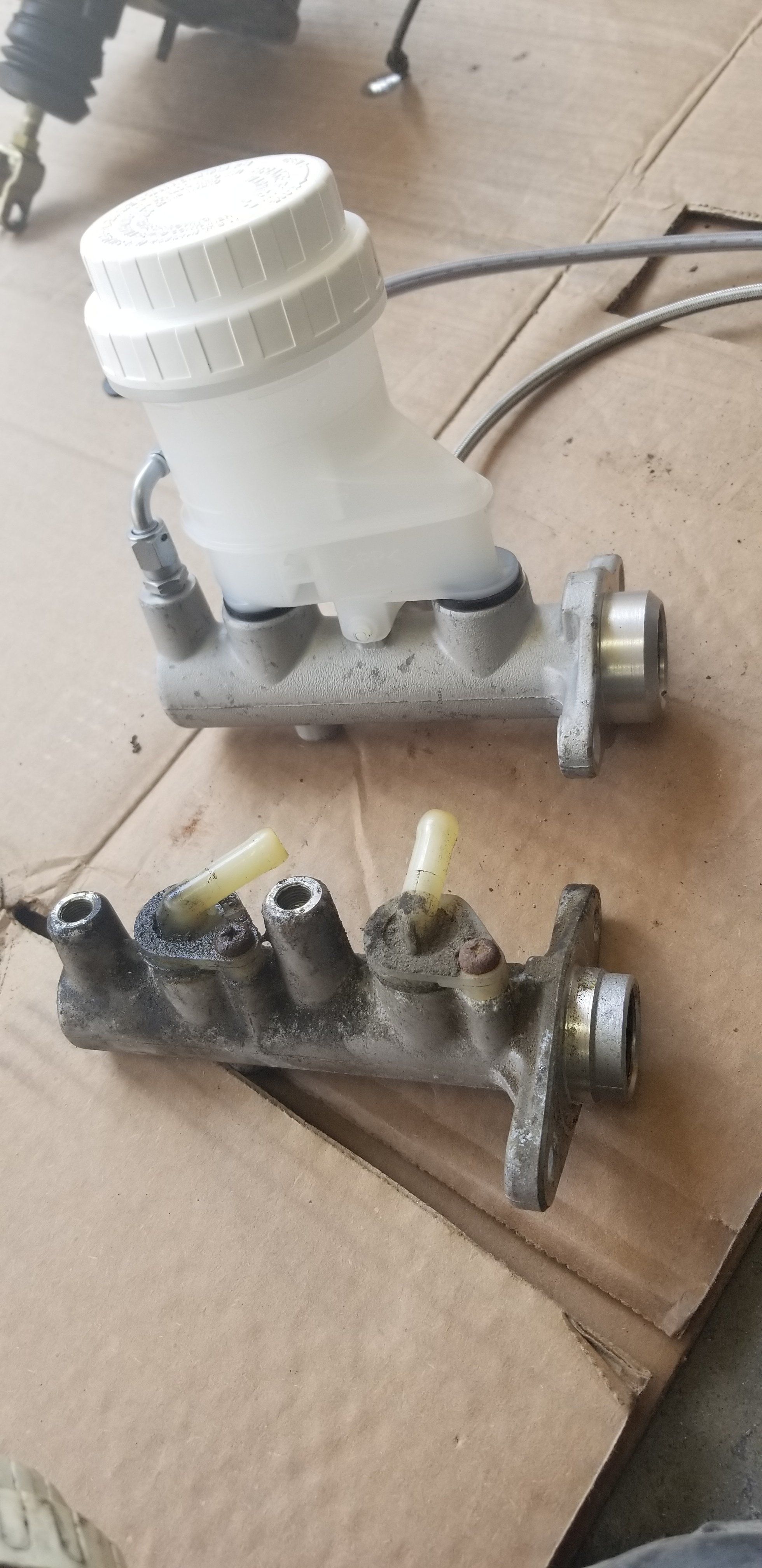

after putting the wheels back on I drove it around the parking lot to see how much of a difference they made! whelp.... its got a super squishy pedal. (yes I bled them super well too :/ ) so now im trying to find an alternative to the brake booster and master cylinder. ive heard hat you can use a 3G eclipse booster and master to help with this. (being that I went to a single piston to a 4 piston brake setup technically adding 6 more pistons to push! makes sense now. any insight on that would be helpful!
You can do the 3g master/booster, I run it on my 92 with outlander brakes, works great.
You do have to alter the brake lines some as they have different mating surfaces and port locations, so reflaring and bending needs to be done.
It's a tight fit on a 1g, but bolts right up. There is a difference in the abs and non-abs versions of the booster, pertaining to how it interacts with the pedal pushrod.

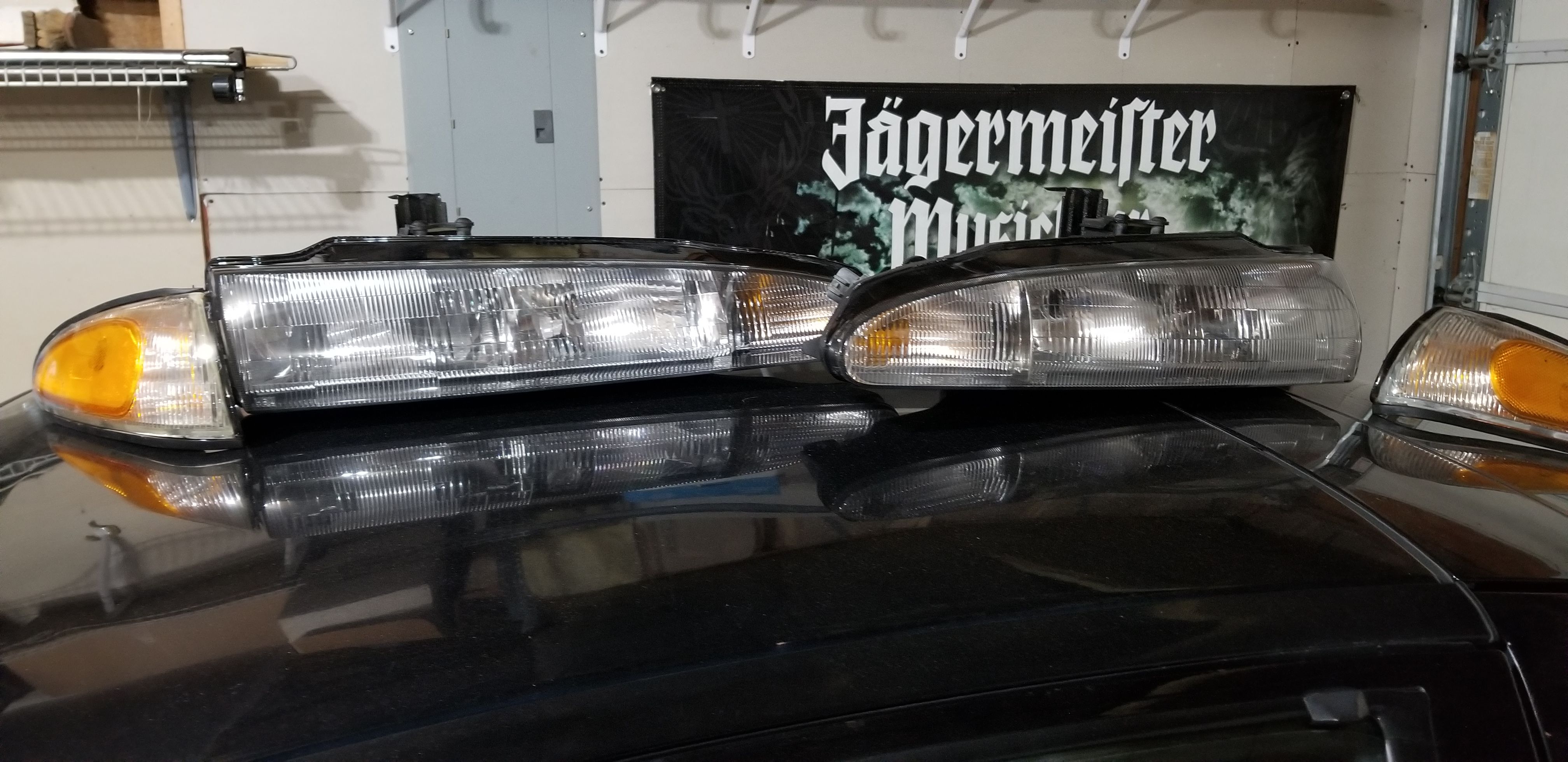

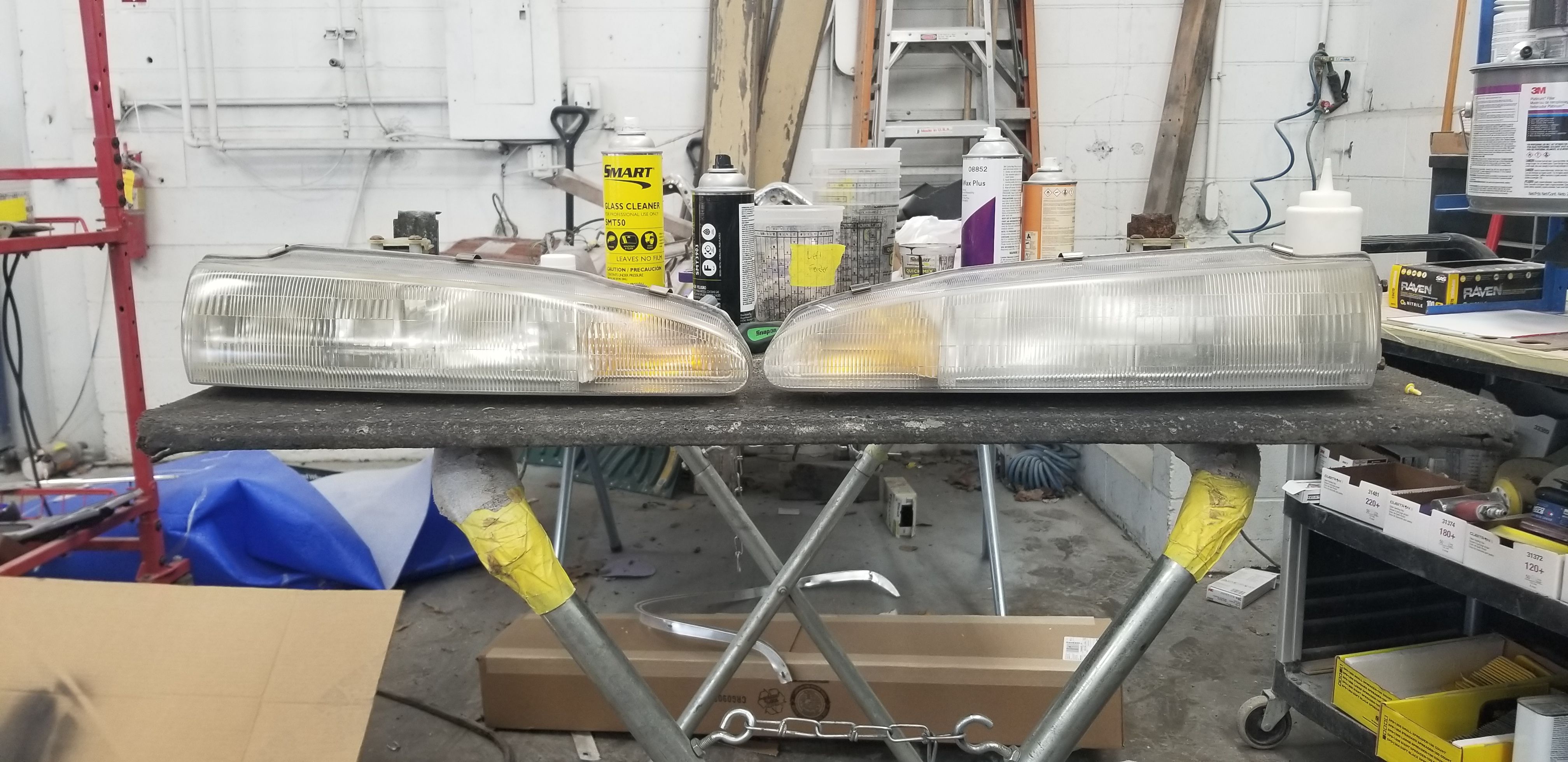

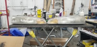

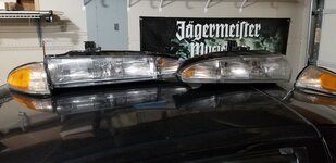

I recently took my nasty crusty headlights out and refinished them, they look AMAZING (check out my photos)
some of the perks of working in a body shop!
sanded the lenses flat with 800 grit sand paper on a D.A palm sander
while I was there I masked off the lenses and sprayed the rest of the housing black to get rid of the faded grayish tan
cleaned them with glass cleaner then gave them to my painter to spray them with clear coat, the UV coating in the clear will keep them looking FRESH for a long time
I also plan to put some 3M stone guard/clear bra/clear shield to help prevent more stones/sand form blasting my refreshed headlights!

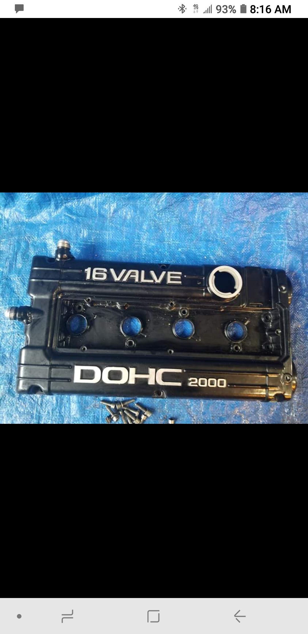

Valve cover with -10am fittings welded on and gaskets

I did end up don't the 3g brake Booster and Master upgrade and it is AMAZING. I love the stiff feel of the pedal and the stopping power I have now!
I was a super easy instillation process from start to finish! I would very much recommend that to anybody with big brakes!
