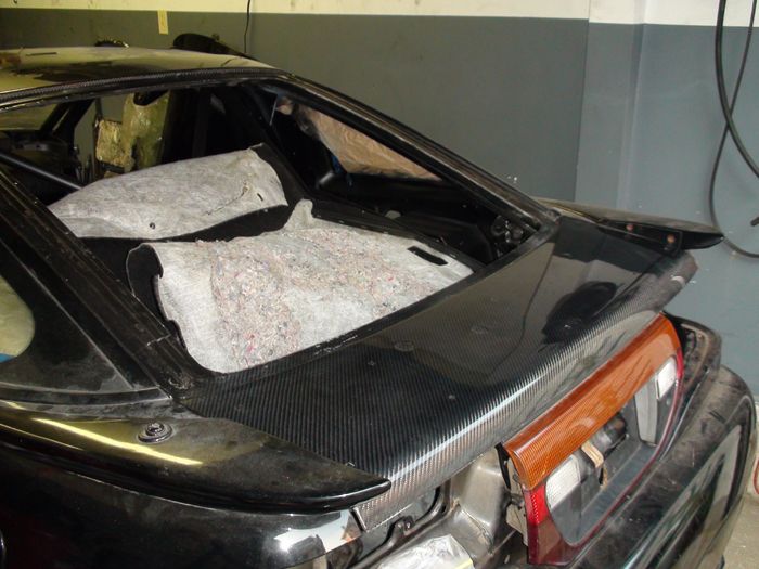

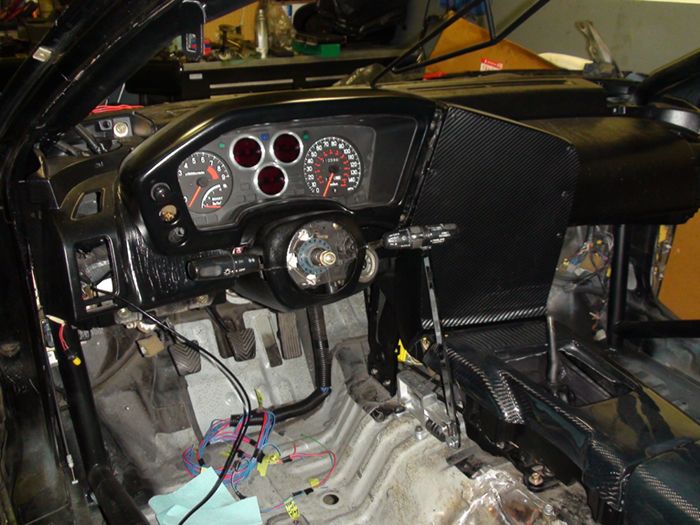

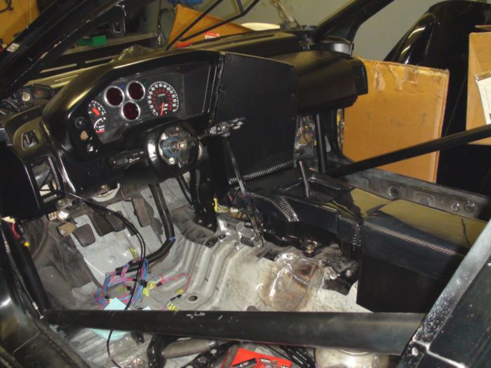

Hey guys, just a quick update. I will upload more pics this week. I painted the dash, install the staging brake, and mocked up the carbon fiber parts. I also tried my hand at fabrication. I used some aluminum sheet and carbon fiber wrap to cover the center portion of the dash.

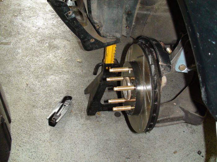

Hey guys, just wanted to get your opinion on lug nuts. What do you use at the track. Also do I have to use arp wheel studs or can the factory studs take the abuse.
If you plan on using slicks, extended wheel studs may be required.
the thread engagement on all wheel studs to the lug nut, or lug bolts to wheel hubs, must be equivalent to or greater than the diameter of the stud/bolt. length of the stud/bolt does NOT determine permissibility.
Depends on the track you're at with how strict they'll be. Some tracks have been reported to demand open ended lug nuts.

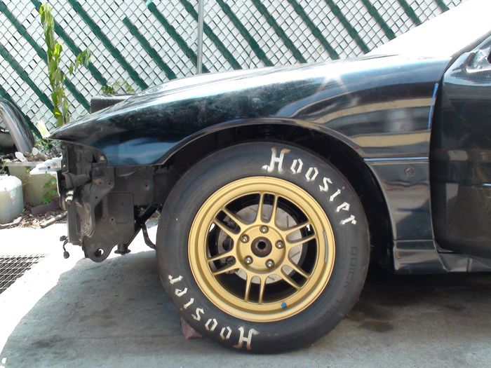

I am running Hoosiers qtp

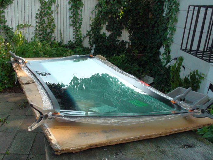

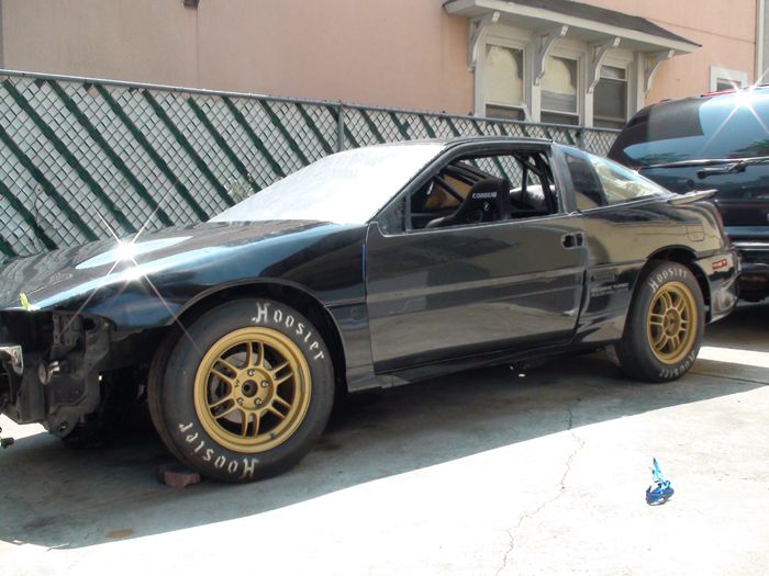

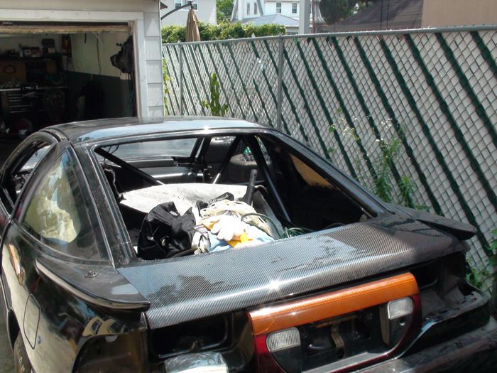

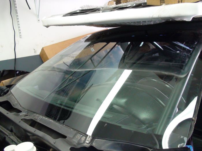

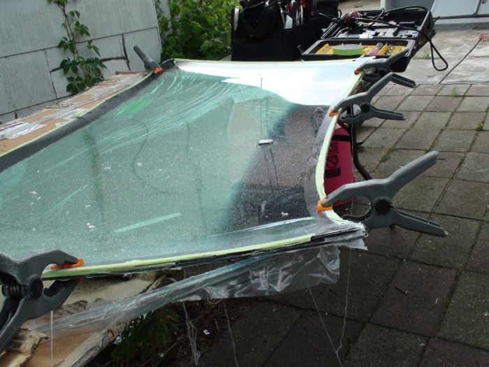

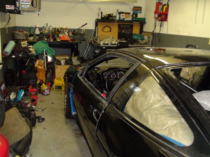

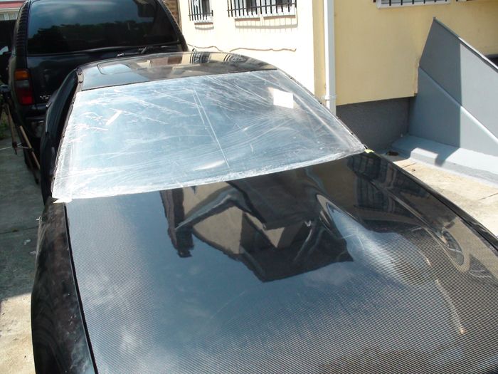

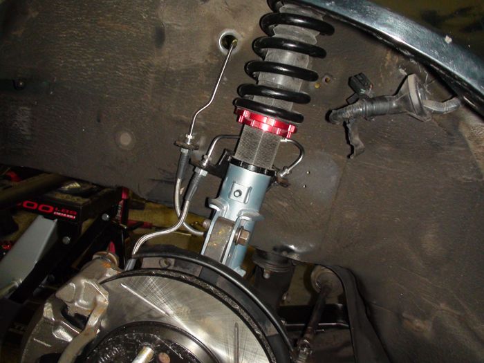

Hey Guys, Just a quick update. I finally got the suspension installed. I put the car on the ground to see the stance, looks pretty good. Also mocked up the carbon fiber doors, hatch, and hood. Everything looks and fits pretty good. The hatch is slightly higher at the roof line, but it still looks good to me. Installed brakes and ARP extended stud. I tried to use the factor wheel studs but the were too short for the rims. I used a factory window that I was installing on the DD to trim my lexan windshield. Everthing came out well. This project is taking really long to complete. next up, build the engine. I need the engine in the car to measure for the drive shaft. updates coming soon.
Looks really good!
