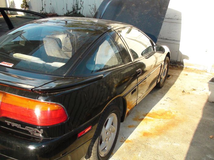

Ok guys, this is a project I know you are going to love. Most guys who put up build project threads on this site are experienced DSM builders. Their project threads just details what they are doing to the car daily. There is barely any interaction. This build will be different because I don't have any experience building DSM drag cars. This will be my first build. I figured since I have access to some of the most talented DSM builders who can build cars in their sleep, why not ask for help. So I hope you guys don't mind helping me with my build. Ok, let me give you more information about the project and myself.

Year: 1992
Make: Eagle
Model: Talon
Drivetrain: AWD
Induction: Turbo
Mileage: 98,000 miles
Color: Black
Differential: 4 bolt rear
Engine: 2.0 liter (I think it is a 6 bolt. I will have to check; I hope it is)
Transmission: 5 speed

Then it should be all done. Not so hard right (LOL). I know I am underestimating this project, but it's worth trying. At the beginning of each section I will list the work and parts needed. I will look for you guys to give me some feedback and suggestions. I think this will be fun. Below are some pics of the car.
