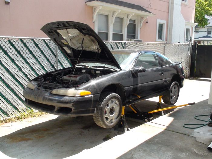

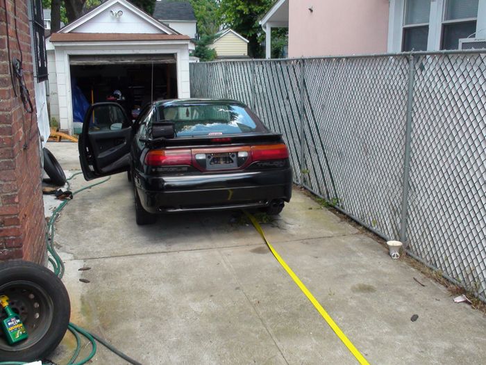

Project Superman: '90 Talon - building my first drag race car
Good luck with the build my friend. Sad to see though that a car with a/c and clean interior will be stripped, but if it's what you really want to do then by all means i wish you the best of luck.
Just be patient, search around a lot for good deals, and most of all i wish you lots of patience.
What are your hp goals with the car ? What are some mods you will be doing first to it ?
Thanks. Yeah, this car is super clean, and the AC is Ice cold. The things people are willing to do to go racing. My goals are high. I want to make 800hp; but everybody says that, so that means nothing. I just want to make as much power as I can. We'll see what happens. After stripping the car, I will send the car out to have the cage (10pt) installed. I also have to install a race seat. (They can't build the cage without the race seats installed.) I don't want to get ahead of myself. After fighting with that dash, I am having second thoughts about this build. Just joking! I have a long way to go. I am going to try my best and see how things end up. The one thing I do know is that I want to do a lot of the work myself. If it blows up at least I know I did it. I am really having a lot of fun. With all the advice I have been getting, I do have to rethink some things (more on that later). I hope to finish stripping the car and getting the motor out this weekend. I will keep you guys posted.

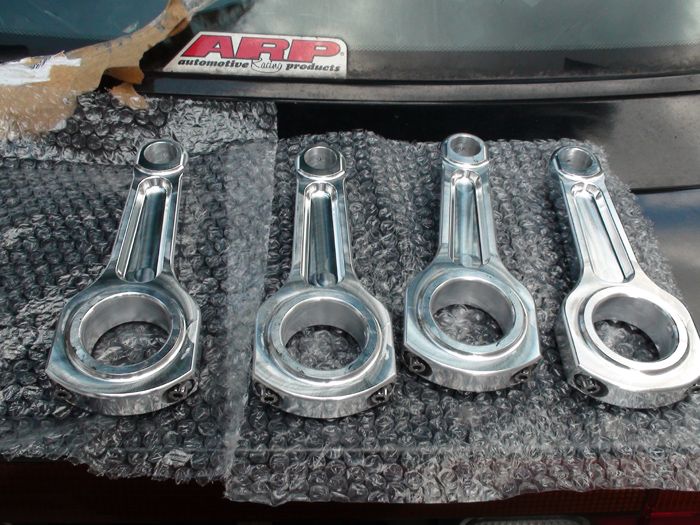

I am going with the R&R Aluminum Rods. These rods are simply amazing. I just got them yesterday. I got these through a group buy. These should hold 22mm wrist pins (I have to measure them to make sure).

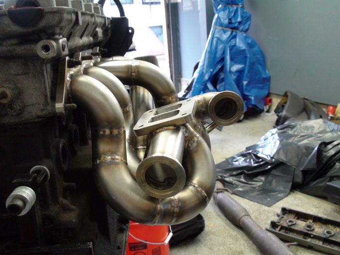

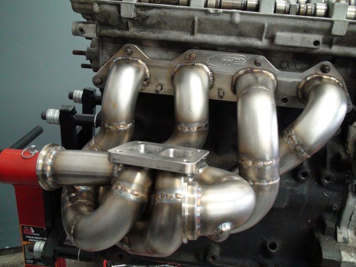

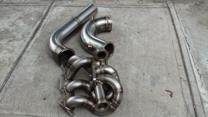

Exhaust manifold:

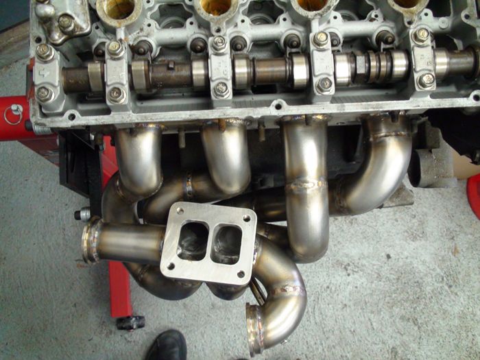

JMF T4 top mount. I got this manifold while it was on sale (it is more beautiful in person). Welds look good too (not that I could tell the difference, but they look good.) Jim at JMF is the man. While making the manifold, Jim gave me a good price on the down pipes, so I bought them. My only mistake was when he asked me what turbo I was running I told him GT42 (I was sure this was going to be my turbo). Then when you guys mentioned the BW Turbos I started to second guess my decision. All is not lost, Jim said he can modify it if need be.

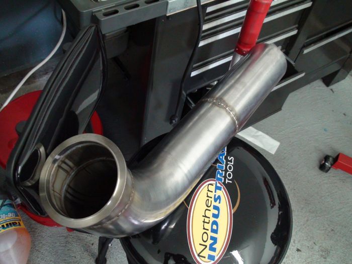

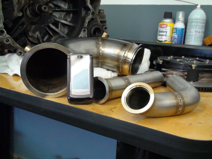

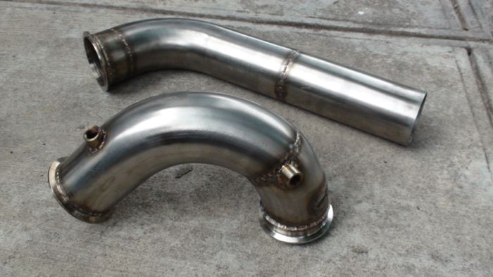

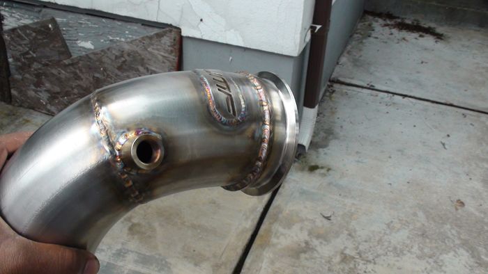

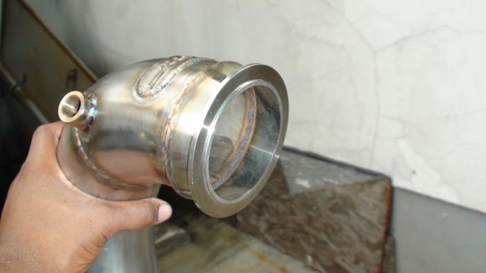

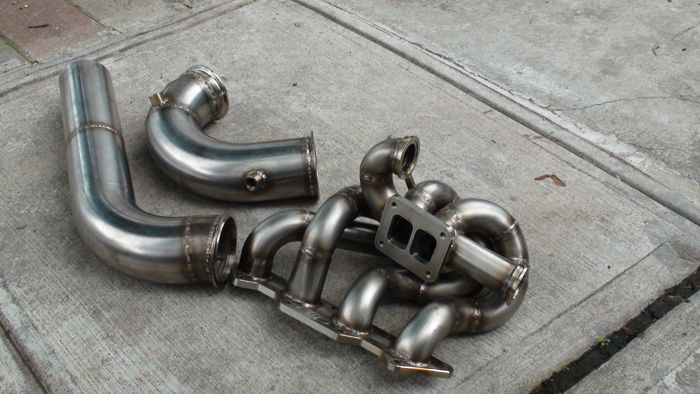

These are 4inch down pipes
Also got the Waste gate dump tubes.

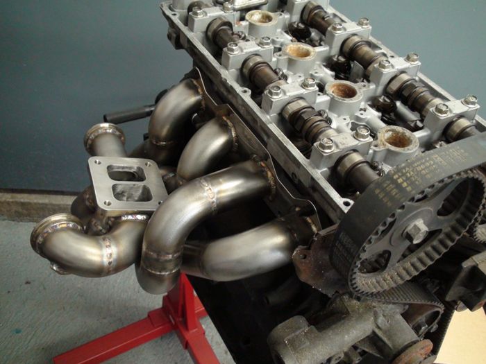

I mocked it up on an old engine I had on the stand. (Looks good)

Damn! Looks AWESOME! Good purchases! I really like that 4" downpipe as well! I am assuming that you will be running a remote mounted alternator on the back of the block to make that downpipe fit. If so, look at Jay Racing for the alternator relocation kit. As well, you might want to look at running a Scirocco-style radiator with single or twin puller fans to clear the turbo manfold assembly. As well, you will likely need to run a different main water line. You can run a 16-AN or 20-AN fitting from the water pump to the radiator, and a matching-sized upper radiator line from the thermostat assembly to the radiator.

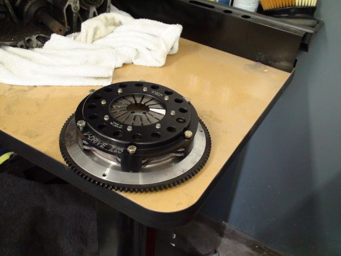

Great purchase on the clutch -- you will like it! I would also recommend running a Fluidampr crank pulley to help reduce the drivetrain harmonics that you will see when using a multi-disk clutch, as it will take its toll on your transmission and your main bearings. The harmonics are greatly reduced when running the Fluidampr and you will have substantially less chatter from 5000rpm-2000rpm on decelleration.
Also, if you are using 22mm wrist pins, be sure to use upgraded thick-wall tool steel pins, as the standard 0.110"-thick ones will be the weak point in the rotating assembly otherwise. As well, I would recommend using wire locks instead of spiraloks for ease of installation.
Great start!
Yeah I have to say I didn't think you had your stuff together this good but you are really on the right track with this thing so far. Not going with a top mount is one of my only regrets with my turbo setup but my IC setup works with a bottom mount and I went with a very good unit so it doesn't looks as sexy as that but it gets the job done.
Also twick is right about the fluidampr is a big help with a twin disk. It's on my list of things to pick up after I heard about premature trans and bearing failure from twin disk and stock balancers.
Tim this is the first I'm hearing about the rings though. Is this not standard on 1400's ?

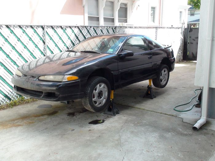

Did some more work today (not much). I was hoping to get the engine out today, but that didn't happen (I was working slow today). I had a strange problem with the car today. I tried to move the car back so I can make space for the engine crane, however; it would not move. It has been parked so long the brake pads rusted to the rotors. This thing was really stuck. I had to use my truck to get it to move. I hooked a tow strap to the front of the car (there are no hooks in the back), ran the tow line under the car and to my truck (this is my tow horse). The big 5.3 liter V8 made quick work of talon. Once I got her to move, I jacked her up and put her on jack stands. Now I can get underneath the car to remove the exhaust, axles, etc. Oh by the way I disconnected the AC line (what a surprise). I forgot that it is a high pressure system. I learned very quickly. I also drained the oil and the coolant. I also sprayed all the bolts with liquid wrench to prepare for the tear down.
