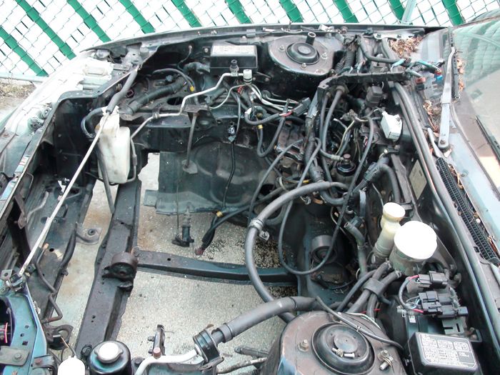

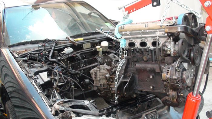

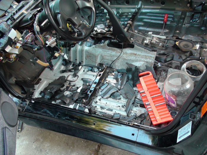

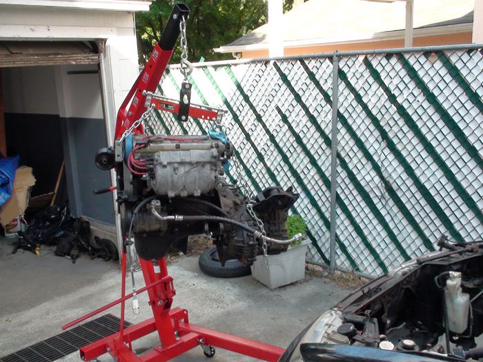

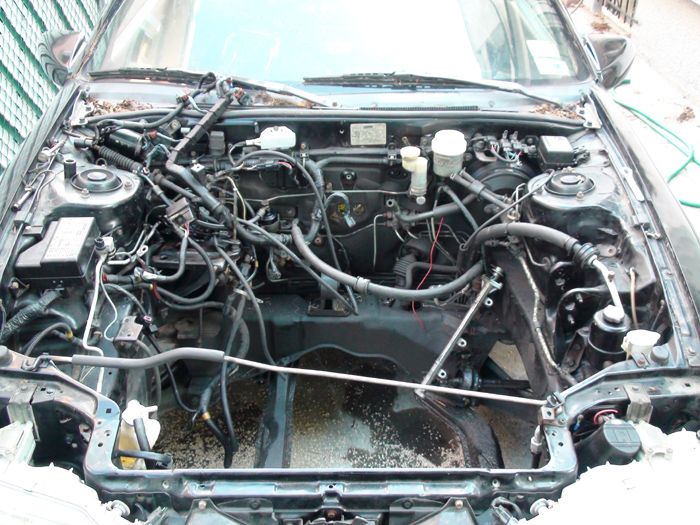

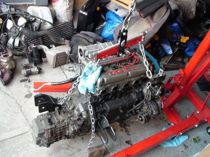

I made some progress this weekend. After removing the driveshaft, axles, and heat shield; I took the car off the jack stands to remove the engine. Taking out the engine took longer than I anticipated; however, after about two hours, I was able to pull it out. Now all I have to do is finish removing the sound deadening material from the interior, remove the windshield, and install the race seat. I still have some wiring to get rid of.

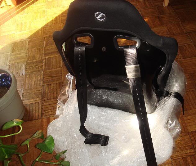

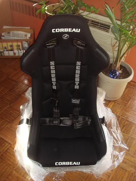

Made of fiberglass and feels very nice to sit in. Seat is inexpensive and the company makes a bracket as well as sliders for our DSM.
Wow i really like that seat. I expected it to weight more than 16lbs too. Where did you find the dsm sliders for it? It looks like i might have to opt for the $29 extra fee of the wider version, i'm a 38" waist but sometimes the muffin top feels tighter than other days. For occasional street use and "room to grow" i should opt for the big boy seat. It only comes in black but that's what i want any way. This seat and getting rid off the pwr seat belts would save big weight.
I couldnt shut the door with the big boy corbeau in my Talon. I did still have door panels and a center console though too.
I need to get some pics of it in my talon asap for I can show you. I do have the wide version since I'm 6ft tall and and weight 216. Im not wide but I felt that seat was a perfect fit for me and I have a 38 waist size.

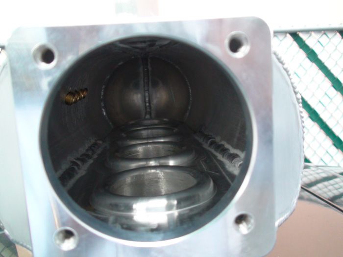

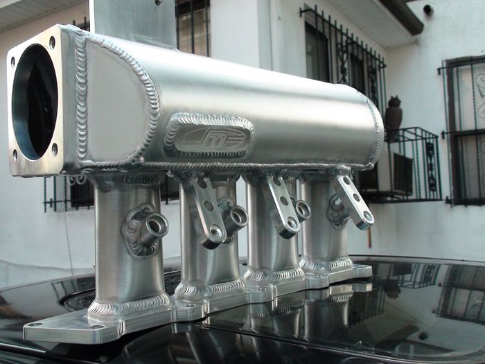

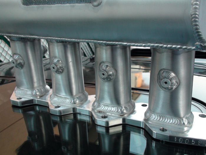

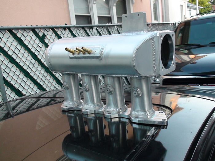

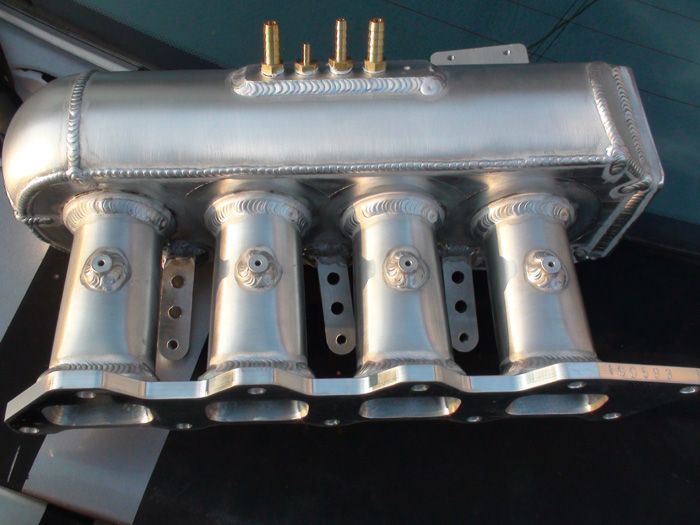

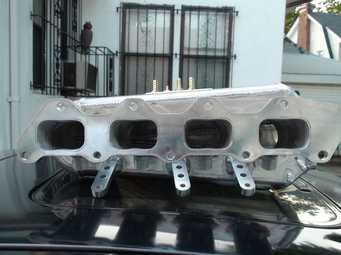

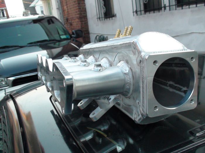

Ok guys, look what came in the mail. My new JMF Drag intake manifold. This thing is super clean. The welds and design are top notch. These guys do great work. I got this manifold on a group buy. It is setup for Dual fuel rails and has nitrous bungs on the bottom. It is flanged for a Q45 throttle body. The pictures don't do this thing justice. It is huge. I didn't get it polished because I was trying to save some money. I am going to polish it myself. Check out the pics.
You plan on running 8 injectors? What kinda fuel do you plan on running that you need that kinda flow? 8 1650cc FIC blue max injectors flow enough for just about anything, and those aren't even the biggest they make.
I was wondering the samething, I just run 4 bluemax 1750s
