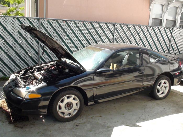

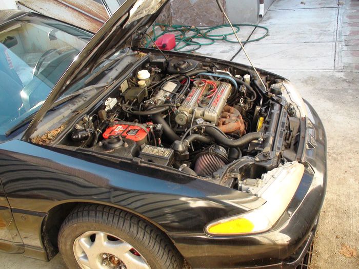

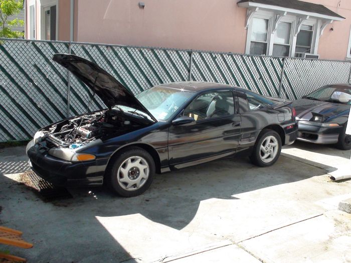

Ok, I finally figured out the pics situation. The tear down begins next. Let me start off by saying that this car is very clean. No rust, few dents, good paint, no mods (just a boost gauge), it even has AC. My street car doesn't even have AC. This should be a good platform.
First off nice car, and as said above it looks like you have a good stating point. No ABS will save you some work as well and it doesn't look like anyone has been hacking it up before you, i looked at a lot of cars that were before i found mine that was relatively clean and un hacked. Although my car is still going to be occasionally street driven i feel like I can relate some ways to you build. I do my work in my friend's garage where i now keep my MAC tool box and what not. If i had my own garage i would do a full tear down and then clean and repaint stuff and reassemble with the needed stuff.

I think your car is very clean and with a wash and wax i think it would be a very presentable race car in the end with out pricey paint and body work. Always have a back up plan. I got let go from my job of 7 years and was out of work for 2months and now i'm working 6 days a week but it's considered "part time". Good luck and get dirty.

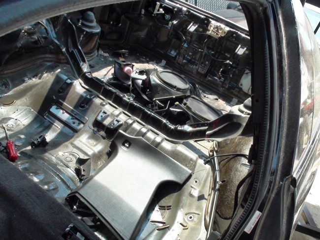

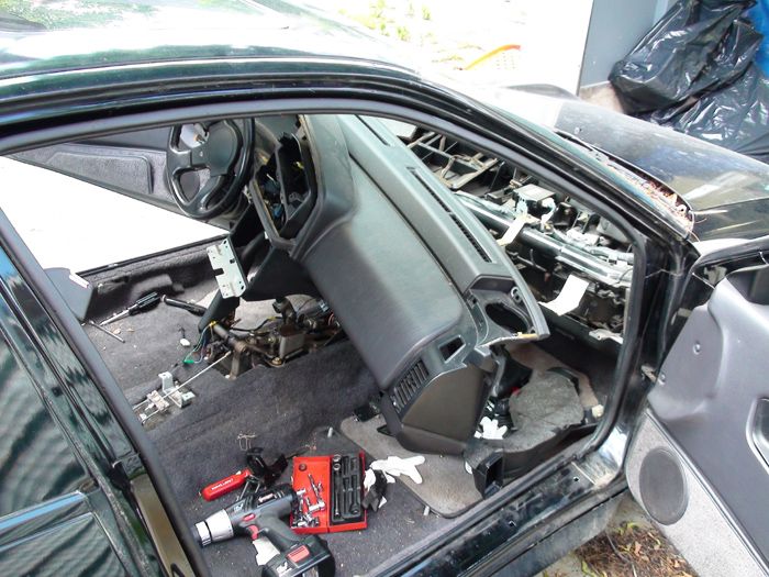

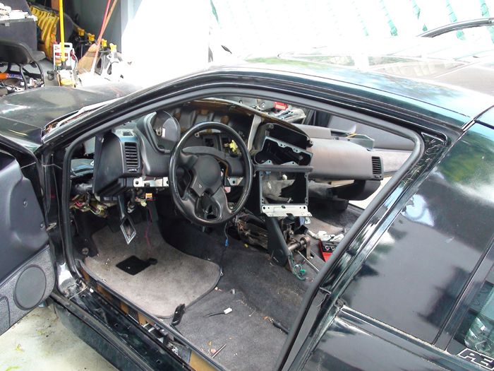

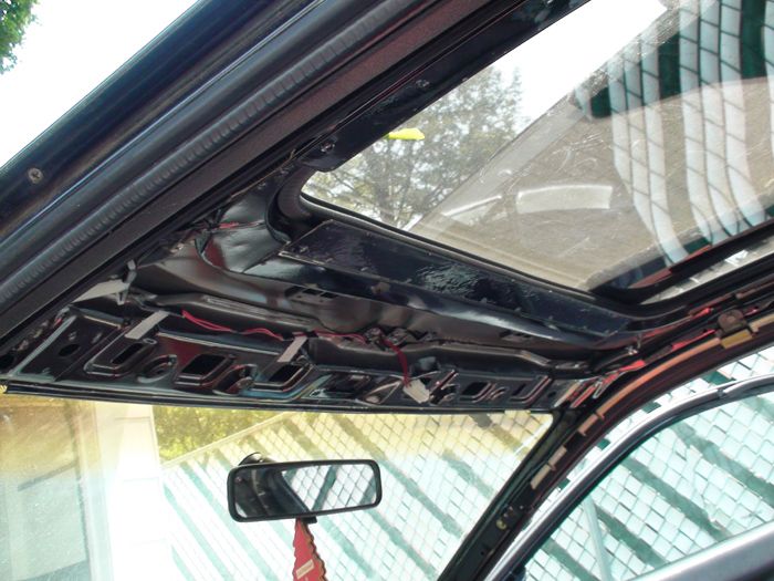

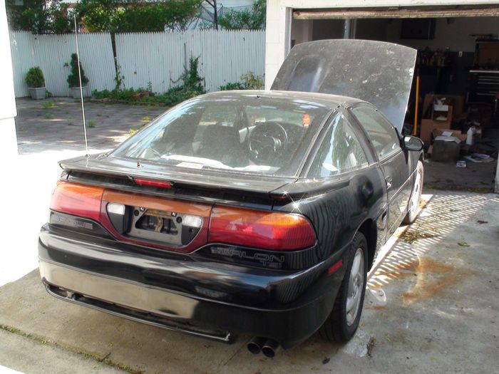

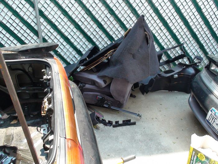

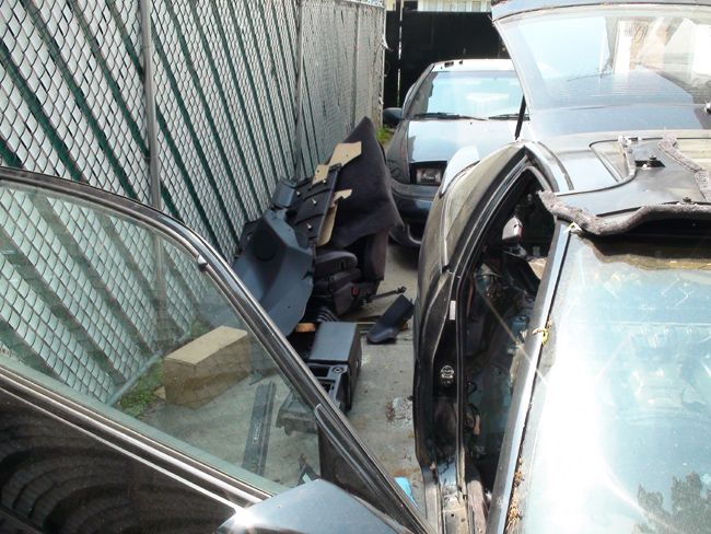

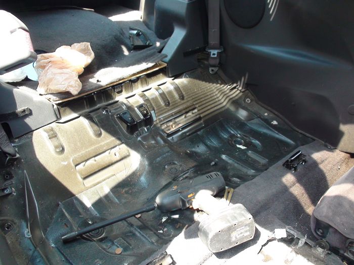

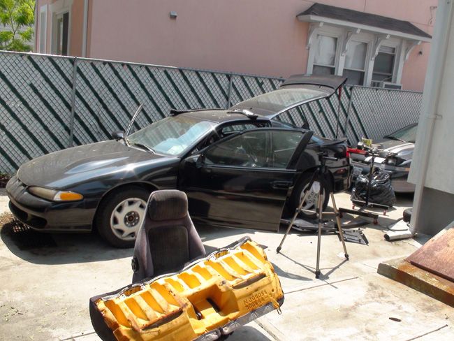

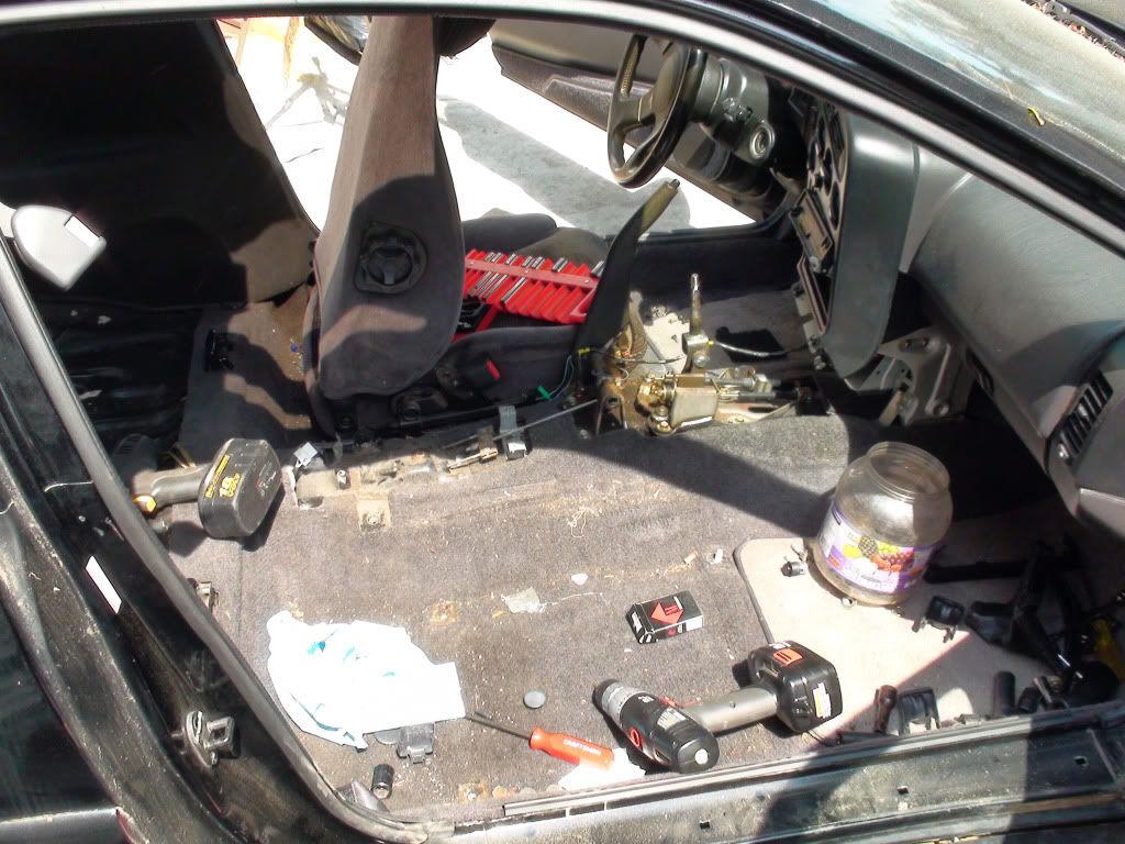

ok, the tear down begins!
Seats are out.

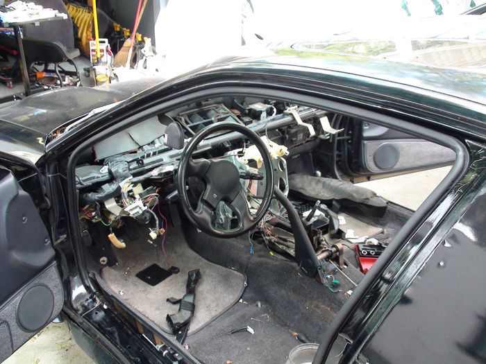

Interior coming out.
Trying to get the dash out.
This thing is hard to get out.

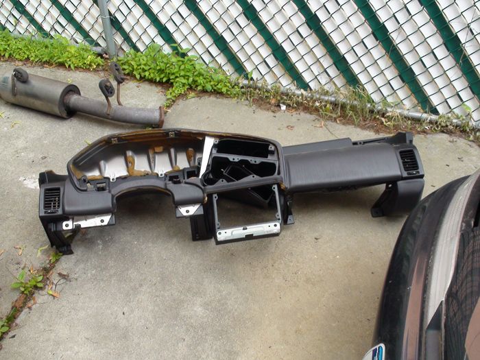

Finally got it out.

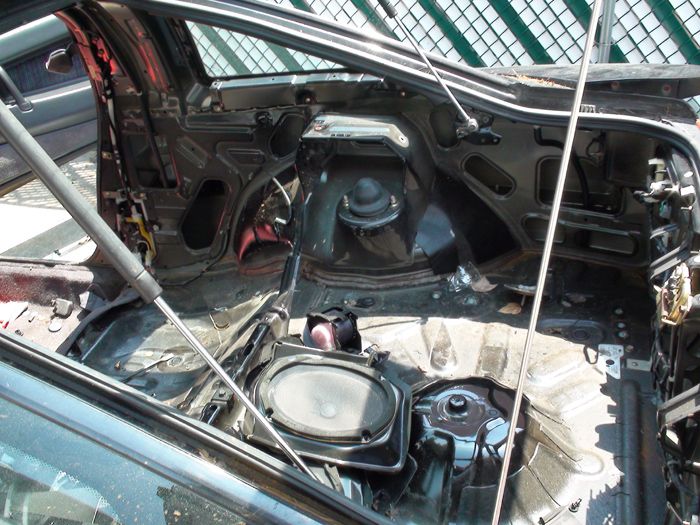

I am not done, but I hope to make some progress this weekend.

What are your hp goals with the car ? What are some mods you will be doing first to it ?
Your right I will need a set of boots if your BS gets any higher in these threads. I guess those cars in my profile just assembled themselves. Forget the fact that I have built both 4g63's and a 420a you with your YEARS of experience are the greater man and builder. Despite the fact that no one has ever seen proof of such said things just pictures of unfinished cars. You would be best to just stop talking because no one here believes any of the crap your flinging around. Hey we're all reasonable men show us proof and I will gladly shut up. You ran 12's then 10's then built a 9 sec car according to you so you should have atleast ONE time slip right??? Post a 10 sec time slip that's yours or point me to a thread where you posted a picture of one and I will gladly go. Last time I checked whenever someone on this site runs no matter how slow the post it in their profile as to how fast they went.....funny you haven't wonder why?????
