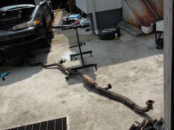

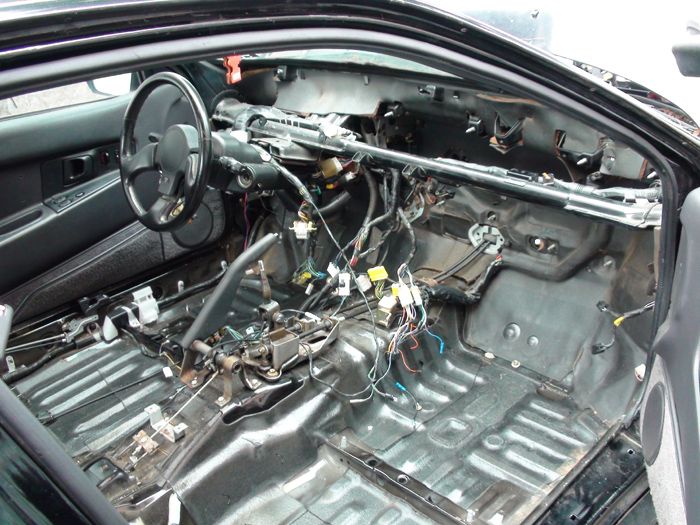

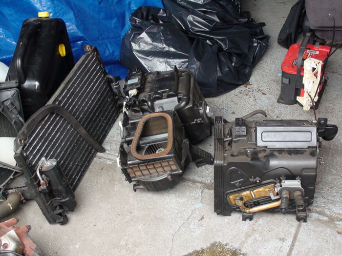

Ok guys the tear down continues. Today I was able to finish up most of the interior. I got the AC unit, heater core and carpet out. I am going to follow Gooberlog's advice and scrap off the sound deadening stuff and take those wood pieces off the carpet. I also removed the exhaust (those hangers were tough), transfer case, radiator, condenser and some misc parts. Next week I am going to take some very detailed interior shots so you guys can tell me what wiring I can get rid of. Next week I should be able to get the engine out and finish the tear down.
Pictures wont help with wiring.. You have to do a search, find the diagram and trace every single wire that goes to a circuit or item you don't use.
That your you can just buy a racing harness.

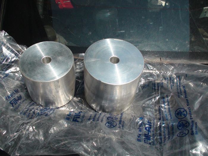

I also picked up these cool solid aluminum mounts from the classifieds. I only have the timing belt and tranny side mounts so far. I am looking to get the side ones shortly.

looking good, getting it down to a shell almost already. How heavy is the heater core and the blower motor boxes in the above picture next to the a/c condensor. Not including the condenssor though, i already have that removed. Wandering if it would be worth it...at some point. Thanks,
Travis
They are not extremely heavy. It is mostly plastic.
