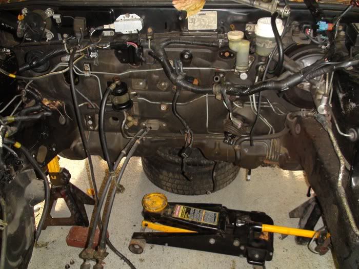

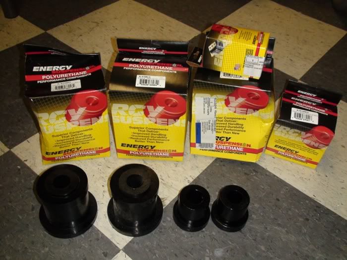

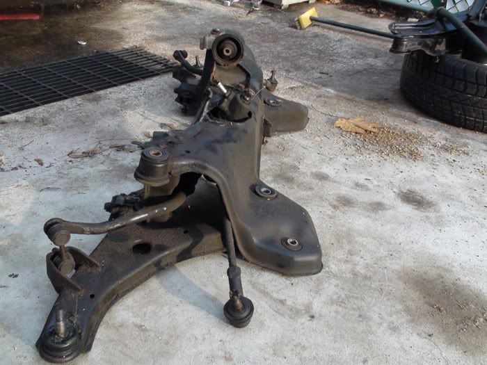

Ok guys, got the front subframe off. I have been very fortunate with this car. All the bolts came out with no problem. Got my poly bushings. I think I got everything covered. I read up on how to install them. I am going to start this weekend. This is going to be hard. That's what I get for wanting to do it myself. I'll keep you guys posted on the progress.
Looks awesome man:thumb: Set aside alot of time for the subframe bushings, they are fun to say the least ROFL

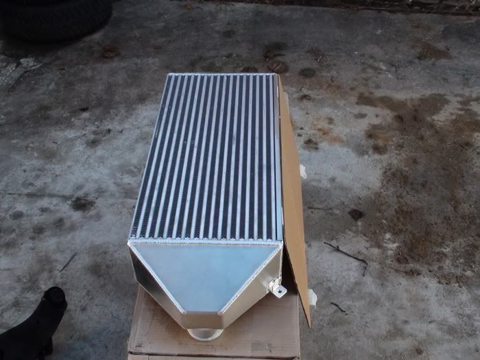

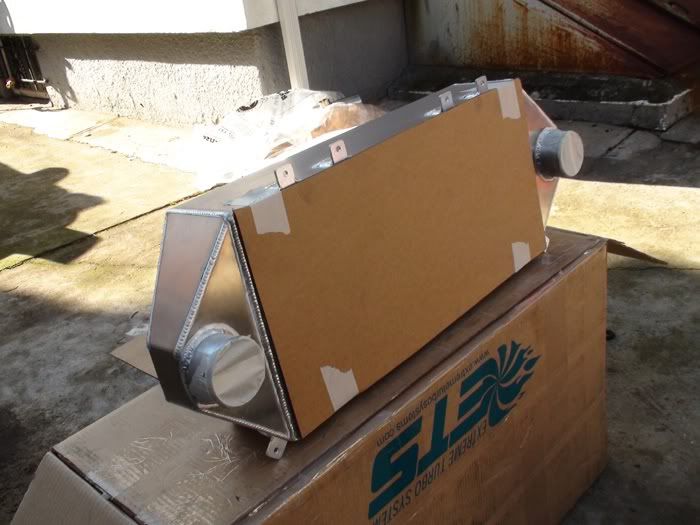

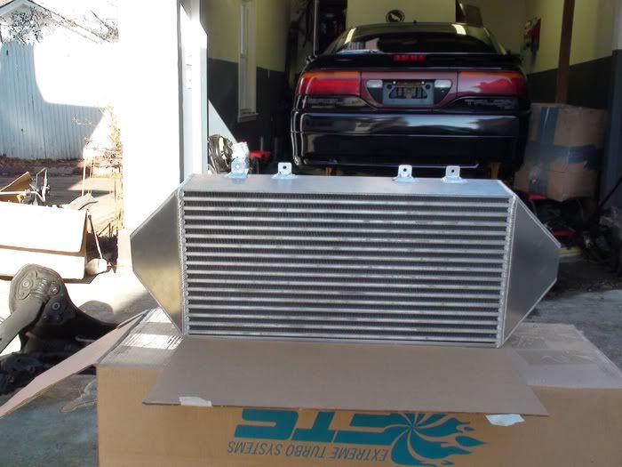

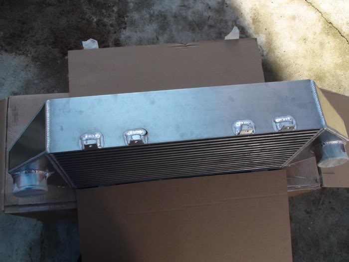

Just a quick parts update, I took advantage of the ETS sale going on and picked up my intercooler. It is their ultra race core. It is actually bigger than the ultra race core. The price was so good I went as big as I could afford. The core measures in at 27 inches wide, 12 inches tall and 5inches thick. The inlet and outlet are both 3 inches with of course a 3 inch upper intercooler pipe with a Tial flange. No lower IC pipes yet. ETS advised me to order the lower pipe after I get the turbo setup in. I also had an IAT bung added to the elbow (pic not included) for the AEM. Still working on those bushings.
Nice pick up. That thing should cool anything you throw at it. They're right the lower pipe depends on the turbo the placement and the outlet design and is def better to wait till everything is in the car. Keep it up man

Why did you choose energy suspension? I have been wanting to do this but i couldnt decide on prothane or energy. Prothane is a lot more for there master kit. Did you get energys master kit?
Yeah, I got the Energy master kit, which I didn't really need because I am not running sway bars (I'll just use them on my street car). Price was good on the Energy kit. I think that's why I picked them.
