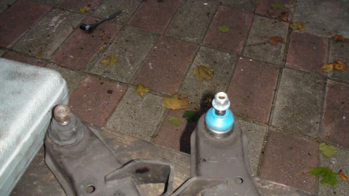

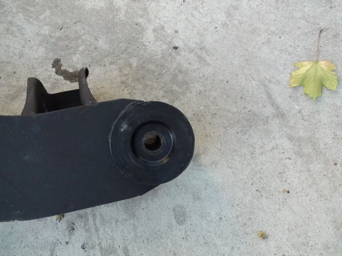

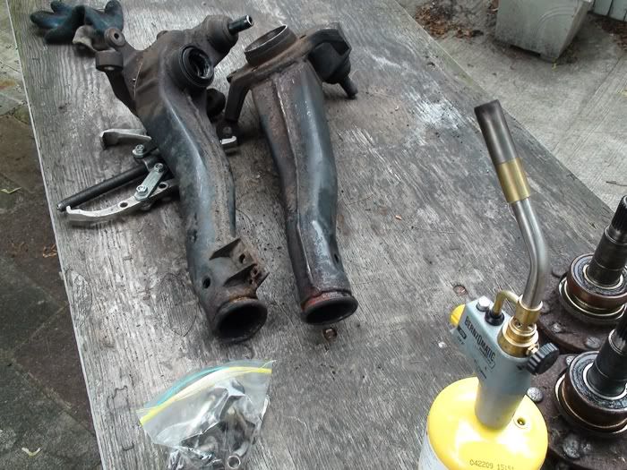

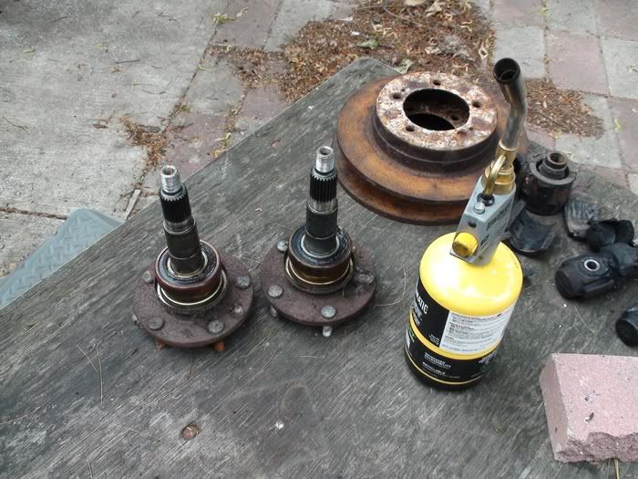

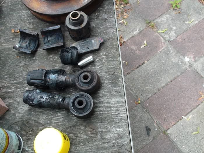

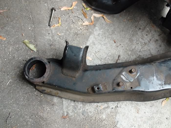

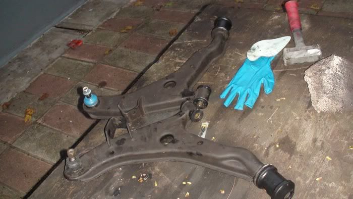

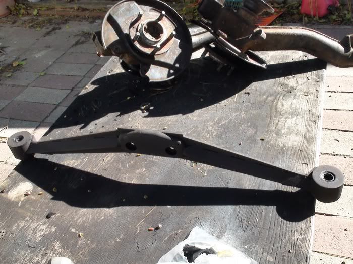

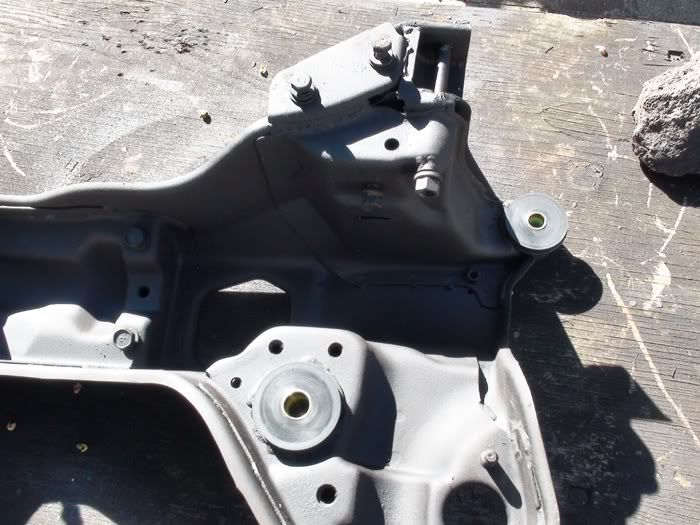

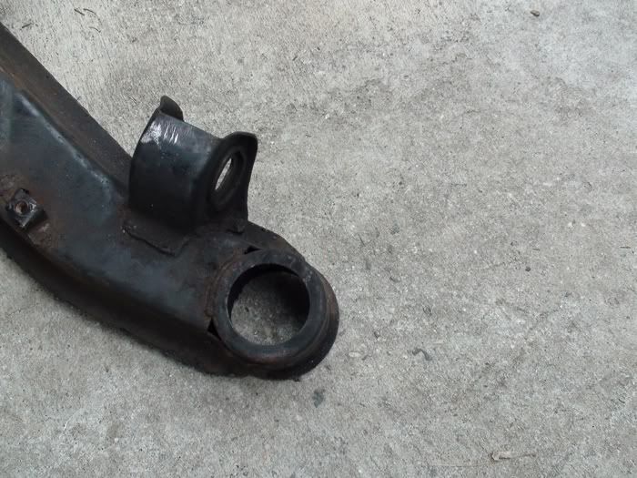

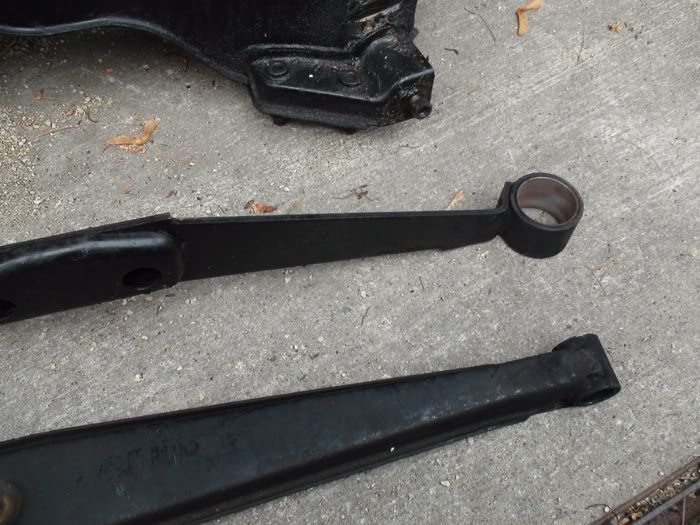

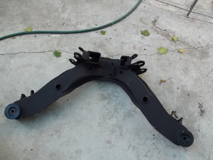

Ok guys, I was finally able to remove all the bushings. The trailing arm bushings are the most difficult to remove in my opinion. You have to remove the bolt that is located towards the bushing. You then have to burn the bushing out. Try to aim the fire into the arm itself. The bushing is actually a steel rod that is surrounding by rubber. You have to burn the rubber off and then pull the rod out. This part takes a lot of heat. Once everything was removed I packed up the parts and took them to JM Fab to have the toe eliminator install and box the control arms and rear diff brace.

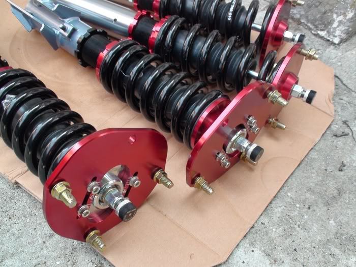

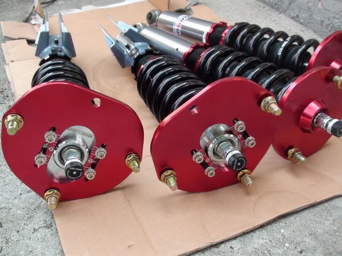

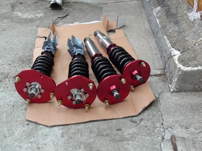

I also picked up some used Megan coilovers I found on sale in the classifieds for cheap. I know I am going to have to upgrade the rear springs. What spring rate do you guys recommend for the rears?

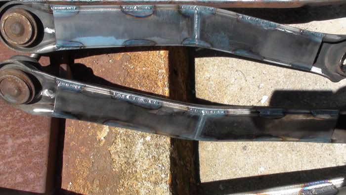

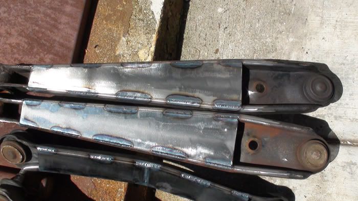

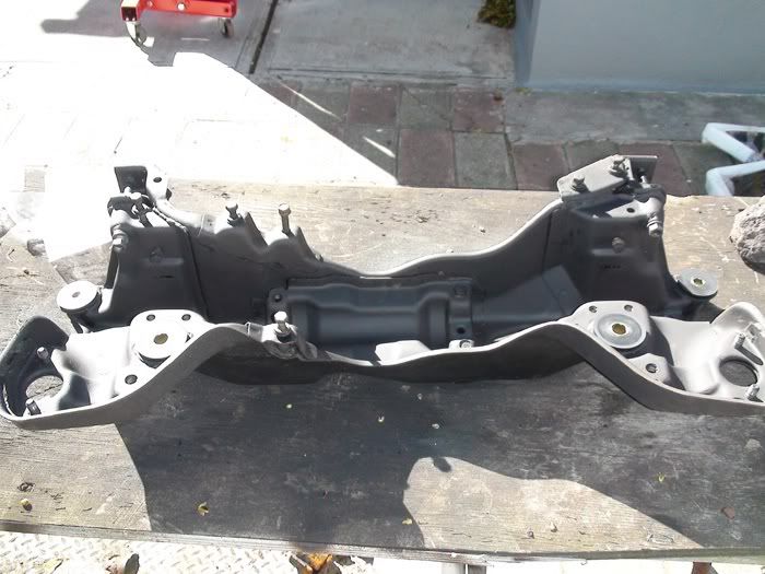

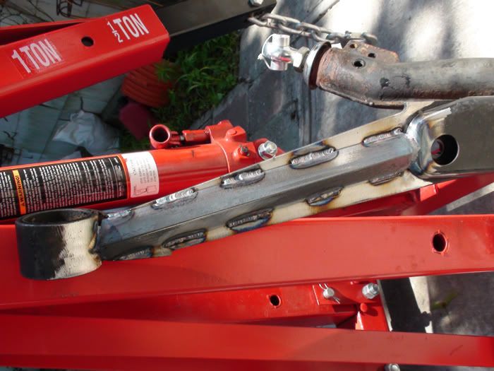

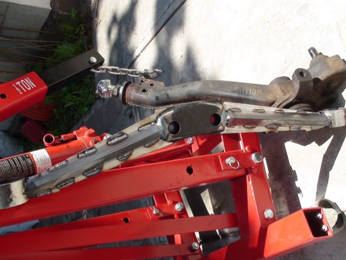

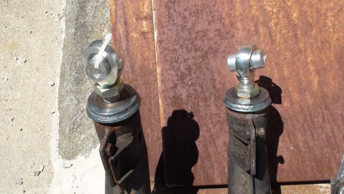

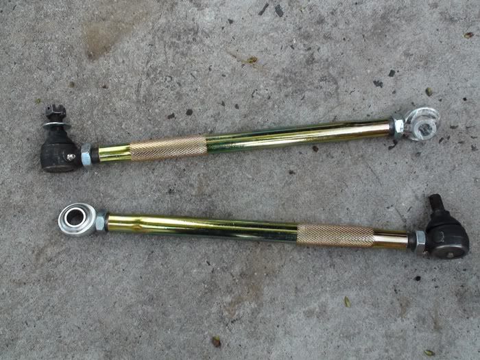

Ok guys, I got the suspension parts back from JMF and I must say I am very impressed with their work. I asked Jim to reinforce the control arms and rear diff brace. They don't normally do things like this, but they did a great job. Everything came out great. They also installed the toe kit for me. These guys do great work. JMF will be doing all the welding for this project. The suspension part of this build is almost done. Now all I have to do is clean everything up, install the poly bushings, paint and re-install everything. Should be fun.

I didn't want to miss my appointment so I took some days off work and got the car back together. I installed all the Poly bushings (except for the rear lower control arms), added new ball joints, and painted everything up as best as I could just to get the car back together.

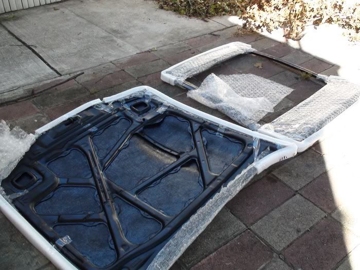

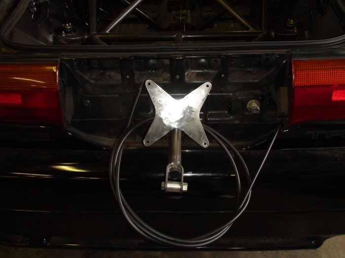

Also picked up carbon fiber hood and hatch for more weight savings.
I got everything together, loaded the car on the trailer and headed out to Nate's shop (more pics to come).

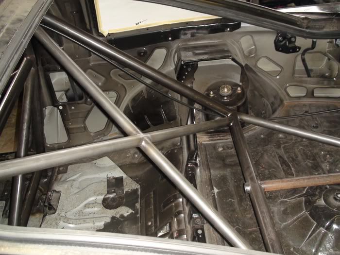

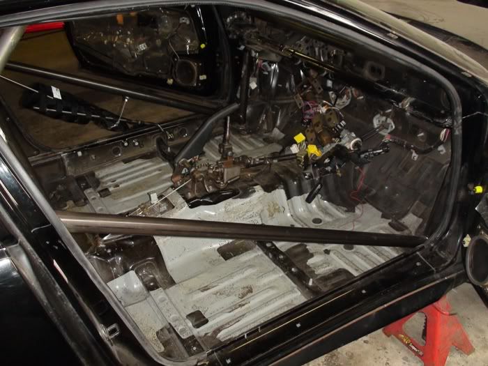

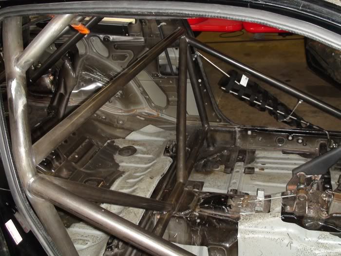

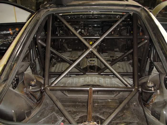

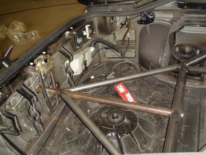

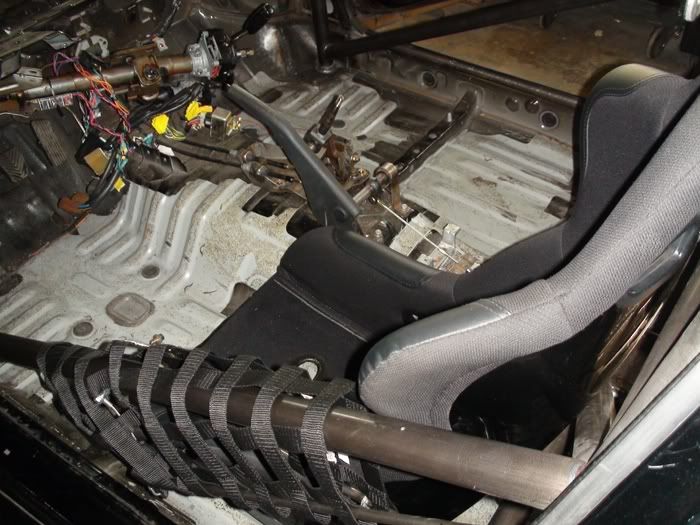

Today, I took a trip out to Nate Dog Creations to look at the cage. This guy can really build a cage. His work far exceeded my expectations. All the welds look good. He installed the windshield brace (for the lexan glass), windows nets, parachute mount, cable and handle. The cage looks great. Also sat in the car to see how much room I had. The seating position was a little too high so he is going to adjust the seat to fit me better. Things are really coming together with this project. I spoke to him about possibly removing the factory rear setup and going with a solid rear diff. He said he would look into it and let me know. I will keep you guys posted.
