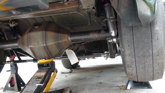

Was wondering what the measurement in on your solid axle rear from axle to axle? That is a GREAT looking car.

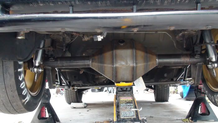

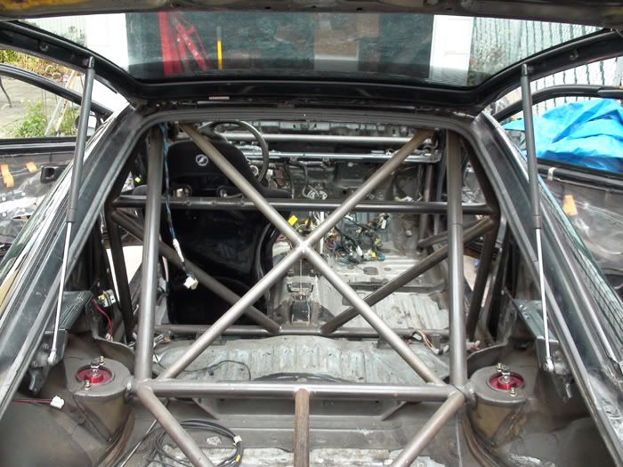

Finally got the car home. This thing looks even better in person. The fab work on this car looks great. I took some better pics today. Pardon the surface rust. I have to get everything painted soon.

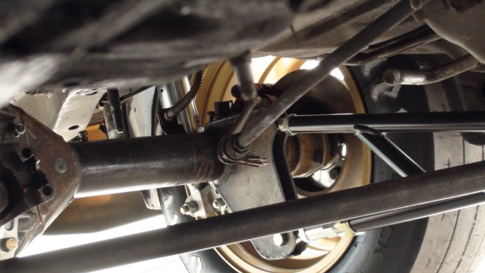

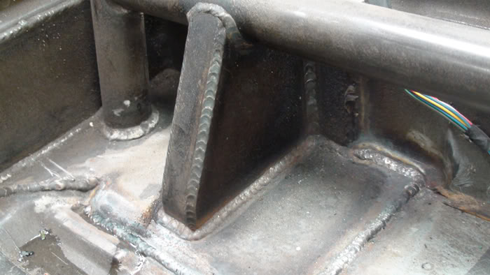

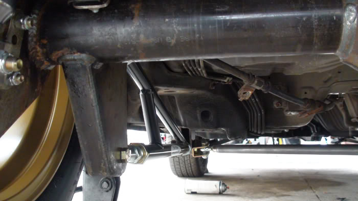

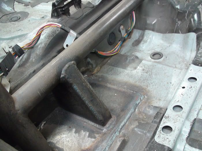

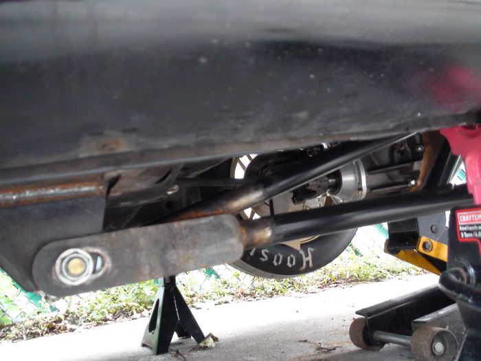

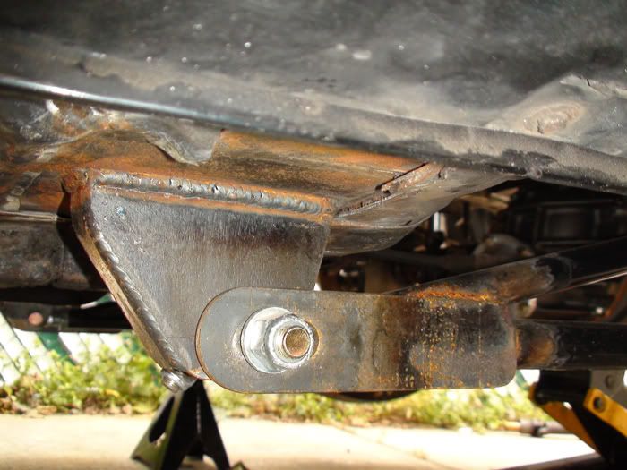

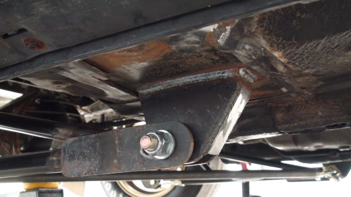

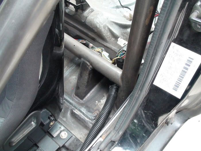

The Ladder bars are attached to the roll cage through the floor so he didn't have to install an additional cross member (clever). The area where the Ladder bar support comes through the floor is reinforced with heavy steel plates. Nate tells me that this area will see a lot of stress during the launch so it had to be super Strong

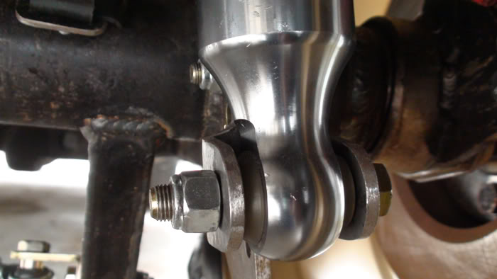

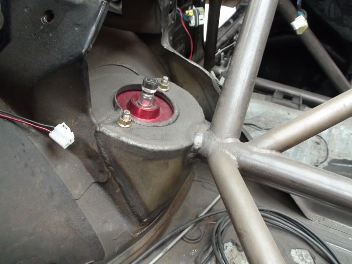

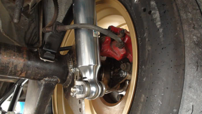

Custom Shock mounts

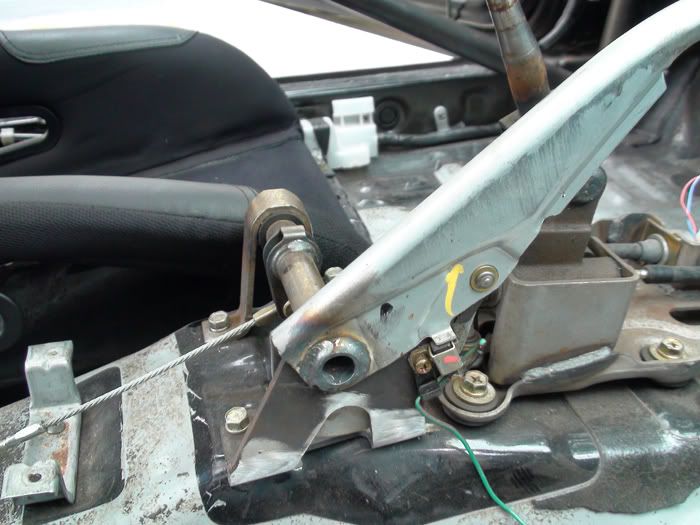

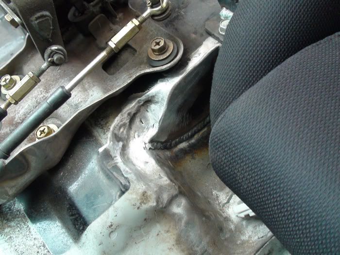

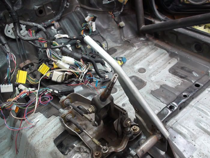

E-brake had to be moved to the other side so that the seat would fit. The seat had to be mounted lower so I could have enough room. The floor had to be modified to make it fit. Clearance between the shifter and the e-brake is fine.

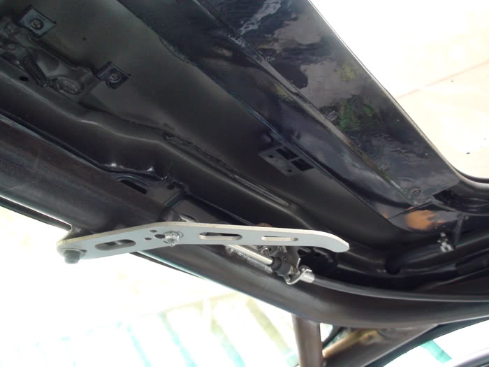

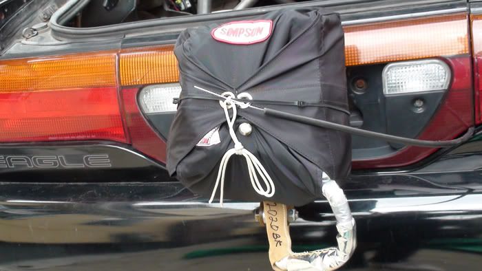

chute handle

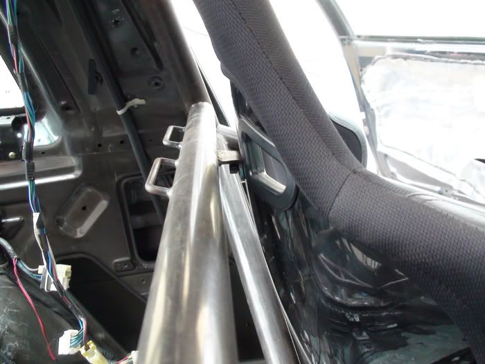

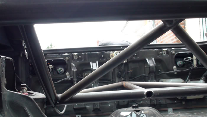

Seat belts tabs
This is the FIRST 1g cage I have EVER seen that made me jealous of them in comparison to mine. You sir have an amazing suspension setup that even the fastest of the fast guys wold be jelous of. No one out side of shep is rollin like this in the unibody.

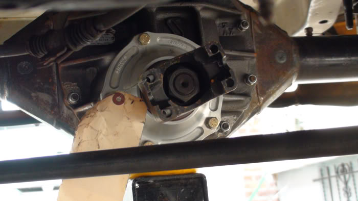

A four link would be better for the street (much more adjustability). You must get an LSD center section to run a live axle on the street; it is very difficult to push this car with a spool around turns. While the setup looks simple, there is a lot that goes in to making the ladders work on the DSM. You have to understand things like: Center of Gravity, Instant Center, and Percentage of Rise (I only understand a little because Nate explained it to me). Regarding the drive Shaft, I am having a custom shaft made by The Drive Shaft Shop.
Any idea of the weight difference between a stock 8.8 rear and the aluminum housing? (assuming a stock junk yard exlporer rear is the same length. )
I don't know the weight difference. The reason I didn't get the 8.8 is because the fab work cost the same. So I decided to just get the 9 inch.
