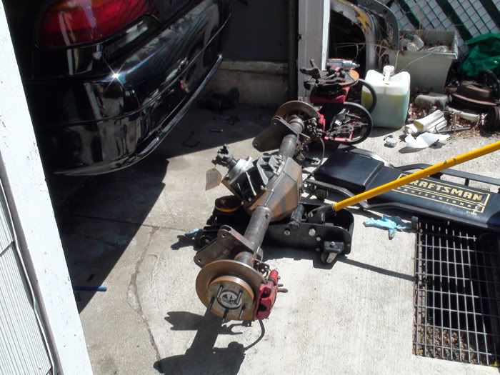

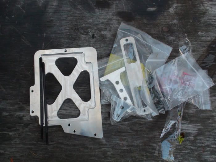

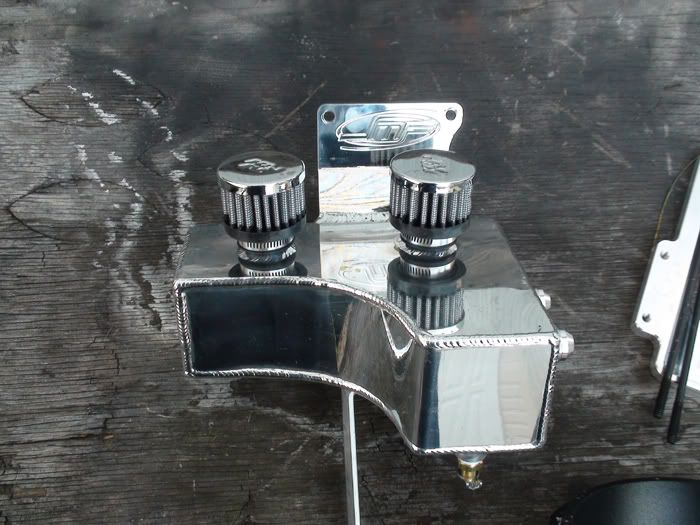

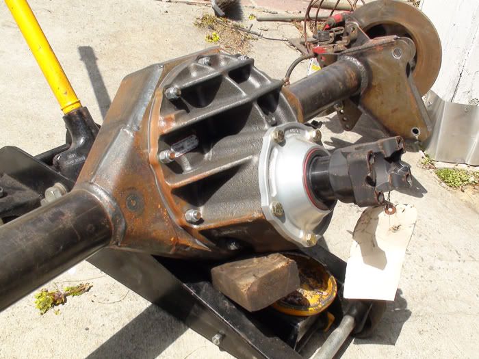

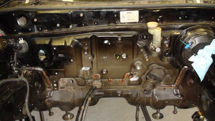

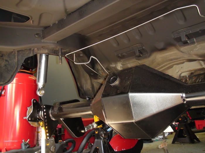

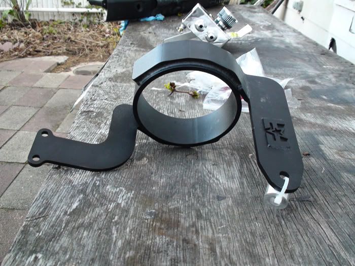

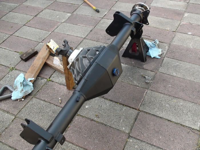

Got some work done this weekend. I decided to remove the rear to finally address the service rust. I cleaned up the rust and then painted everything. It came out ok. I also started on the front, cleaning up the engine bay, and cleaning up the harness. At this point I won't be removing anything from the harness. I don't know enough about how a DSM is wired to go messing with the harness, and I really don't want any issues at start up. I also bought some parts. I got a drive shaft loop, JMF catch can and battery tray. Here are some pics.
Painted
This thing is built like a tank
Ahhhh like the new paint. Don't forget to post pictures once you get all that installed again!

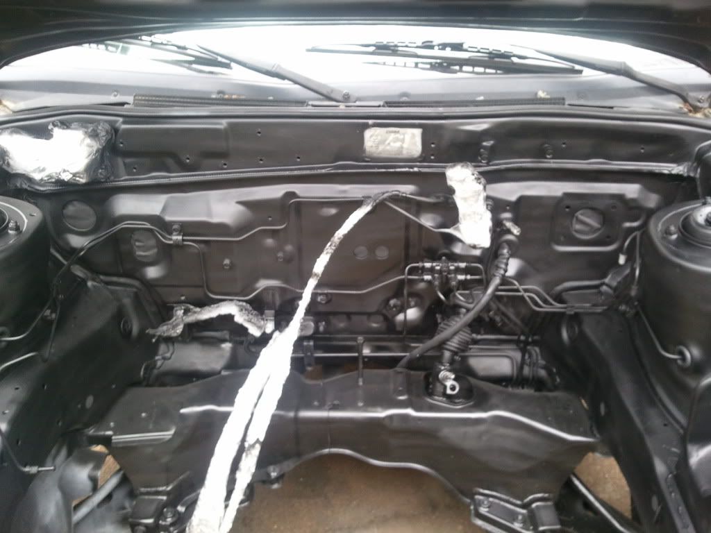

Should have some more pics up this weekend. I originally wanted to get the engine bay painted; but, I can't afford that right now. I plan on using some Eastwood paint coupled with some good surface prep to get the job done. I will also attempt to mount the Fuse box in the dash to clean up the look of the engine bay.
Me and a buddy ended up just buying some high-heat paint from Wal-Mart along with some clear. Spent maybe $50 bucks total (including cleaning products before painting) and it didn't turn out too bad. It's a cheap alternative and will do what it's supposed too. I always paint my engine bay's with the same setup and never had a problem with pealing, cracking, bubbles, etc. Just something to take into consideration if you want a freshly painted engine bay! :thumb:
Here's a pic before clear. The wiper motor has been removed along with everything else though; plans were a tad different when I painted and was gonna leave it all.

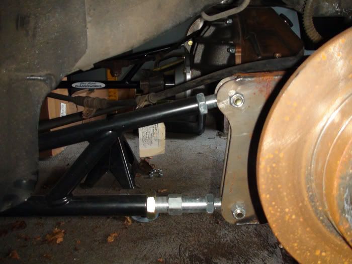

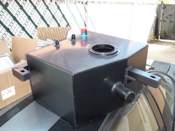

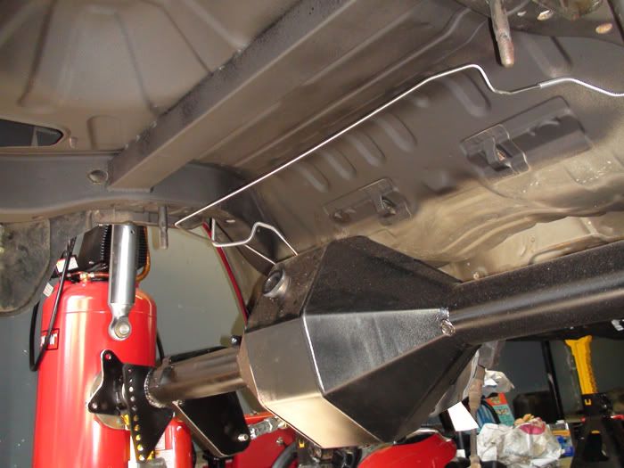

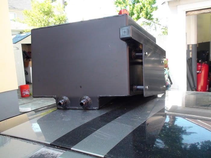

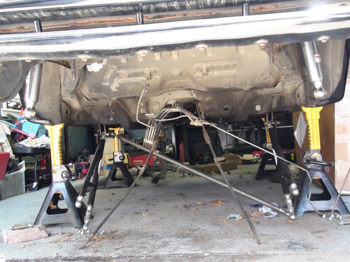

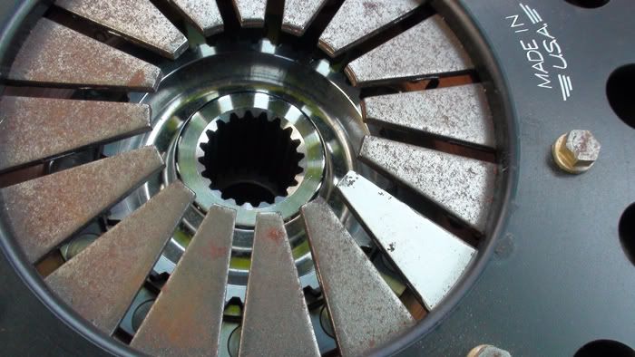

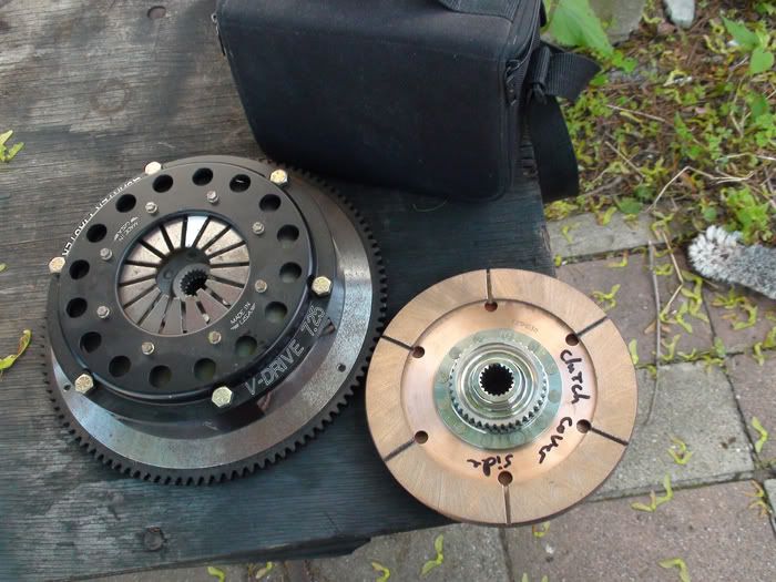

Got my fuel cell from JM FAB. Also picked up the HD clutch upgrade from TMZ performance for my twin disk (Thanks Tim). Installed the rear and some new brake lines. I didn't attach the shocks because I think I am going to need some stiffer springs. What would you guys recommend for spring rates? More updates coming soon.

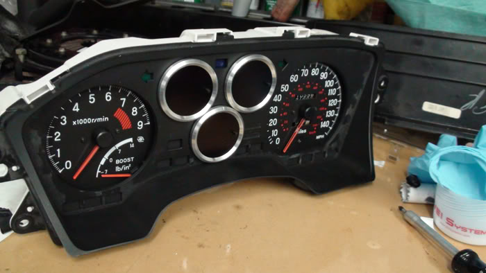

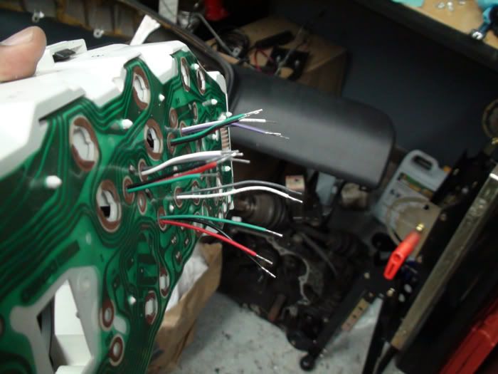

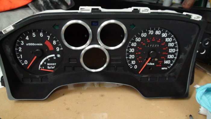

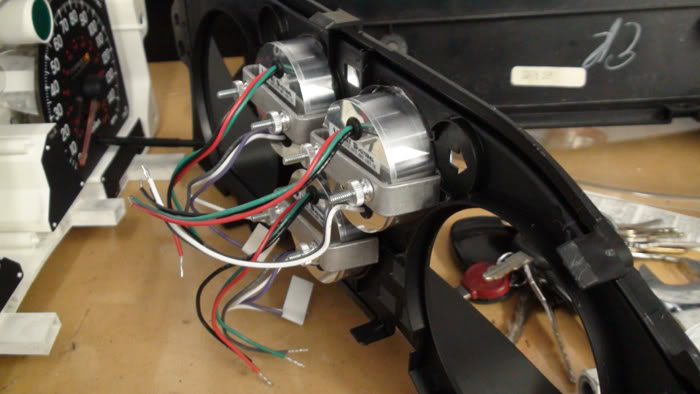

Ok guys just a quick update. I saw a thread on the forum where a guy put aftermarket gauges in the stock cluster. I thought it was a cool idea so I tried it myself. I used VEI dual gauges. These were perfect for the job because they are not deep gauges, so they fit inside the stock cluster without having to cut up the back of the cluster. You do have to grind down some of the plastic tabs inside the cluster, but all in all, it was not bad for my first time. It came out ok. I have these gauges on my street car and they work well. Dual gauges also minimize space. This put all my critical functions right in front of me. The gauges show: fuel pressure, oil pressure, water temp, oil temp, boost, and WB O2.
