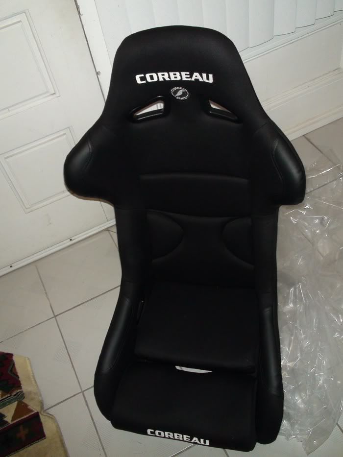

OK guys, just a quick update. I finally got my seat back. I ended up going with the smaller FX Pro. The seat fits great. I was swimming in the FX1 wide; the pro is just right. It is snug, but that is what I want. It may be too tight for a street car; but I think it should be good for racing. I will put it in the car this weekend. I am about ready to get the cage in. I just have to remove the windshield and make an appointment with JMF FAB. I am also thinking about going lexan glass all around. What do you guys think?

I was wondering. I could not understand how the FX1 wide fit in your car. The pro is perfect. It should fit fine. Also the seat brackets that I got did not fit the FX1 wide. They fit the pro perfectly.
Yeah I mean I had the clubman but the specs on the site showed them being about the same wdith and I was like getting this is here is like a monkey ####ing a football. The new shell has a better designed cage and the pro is what is going in seeing how I still have my brackets.

I believe this one will fit. The FX1 Wide hit the door panel in my car. However if you do not have a small waist you will not fit the pro. Don't go by you pants size. I thought I was a 40'', however, I am a actually 38-39''. The FX pro fits up to a 36 waist so it is a little snug; but I feel it is perfect for racing. It really holds you in the seat.

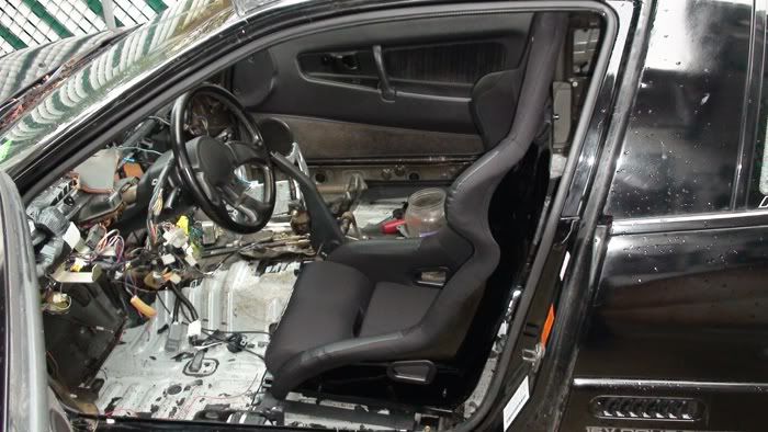

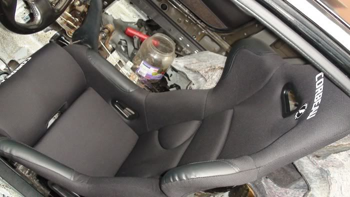

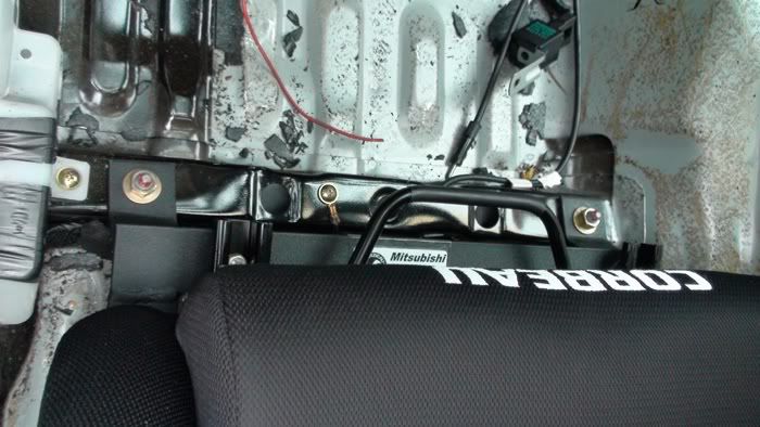

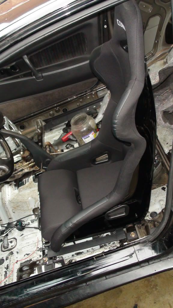

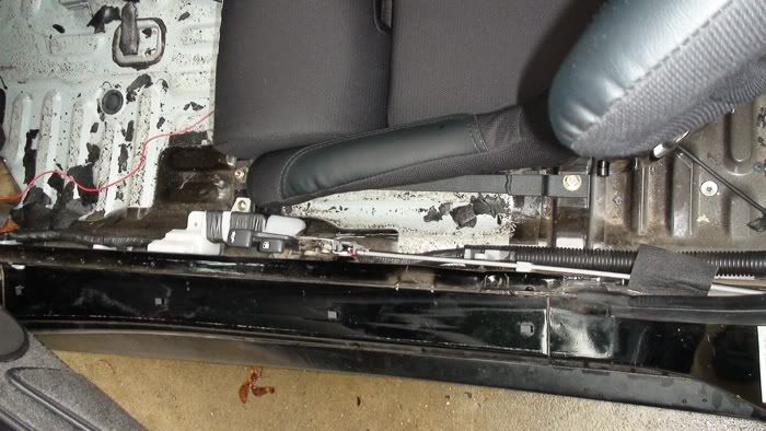

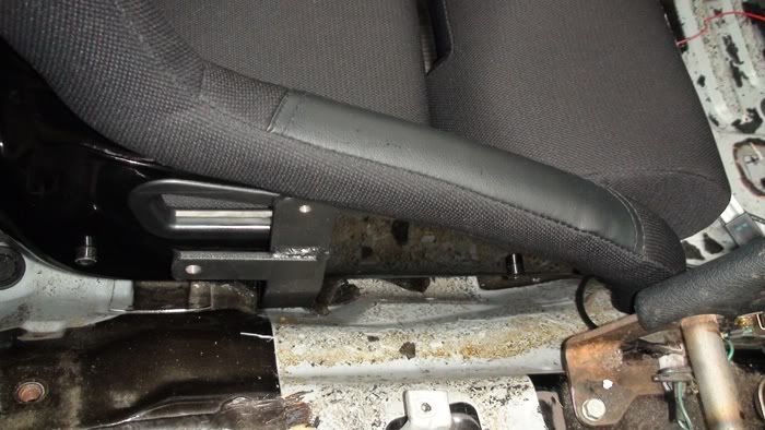

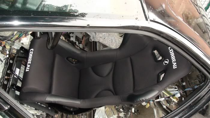

Ok, I put the seat in the car today and it fits great. Everything was perfect, until I sat in it. The seating position is too high. I was almost hitting my head on the roof. Things would be tight with a helmet. Not a big deal. When I take the car to JMF, I will ask Jim to cut off the mounts (this is where all the extra height is coming from) and weld a new mount. This should be a simple fix. Other than that the seat is great. It clears everything. It is close to the E-brake, but it doesn't touch. Check out the pics.

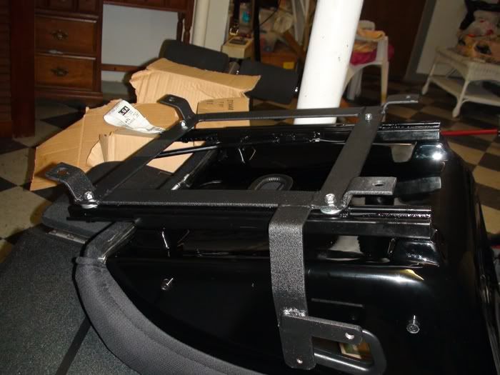

This is the mounting bracket. Notice the height on the lower mount.
