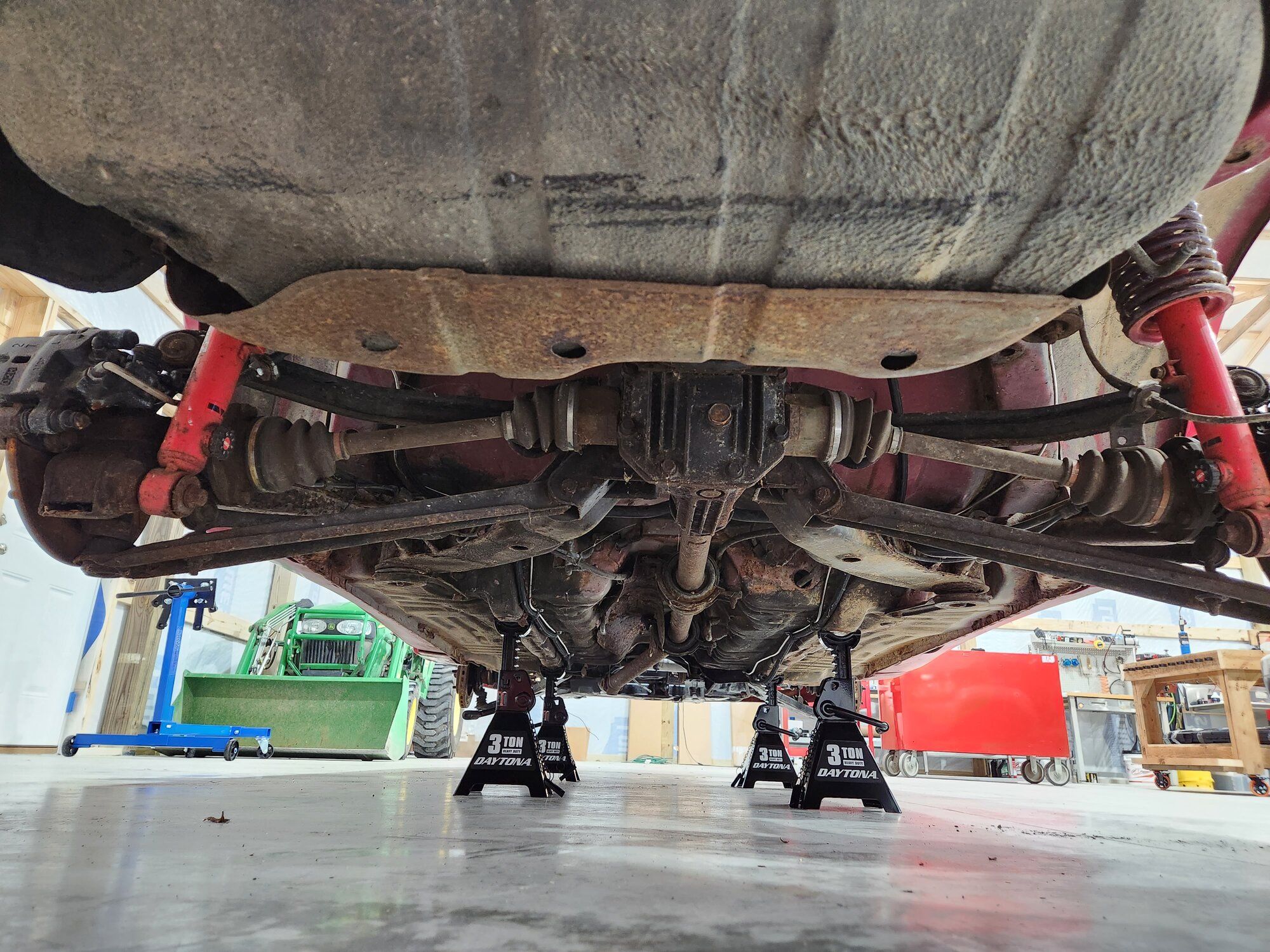

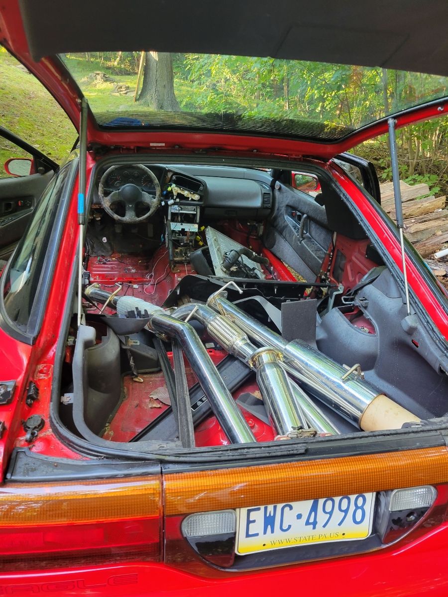

The 3" exhaust pipe cut at right around 2" did the trick to replace the rotted original subframe bushing housing.
Slowly, but surely it's progress!
Stripped the cross member, sprayed with rust reformer, several coats all in the nooks and crannies, and ended with a couple coats of flat black for now.
Finally got the rest of the bushings out, stripped the control arms, cleaned, and hit them with several coats of rust reformer as well before sending it with some flat black.

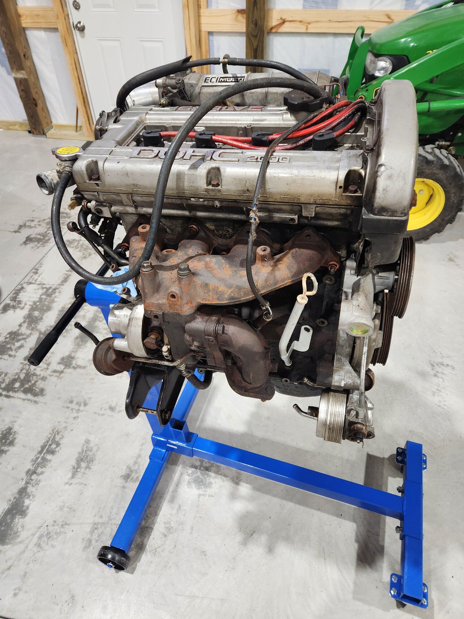

Rocking the OG 6 bolt, which I haven't torn down yet. Hoping it won't need extensive work. Going for 2g pistons with the 1G rods for a nice bump in compression. 2 G head with evo3 intake and comp/FP 101200 cams. Justin just built the Evo3/big 16g so I'm super pumped about that. Got the 90 OFH in and will build lines for the external oil cooler as well.

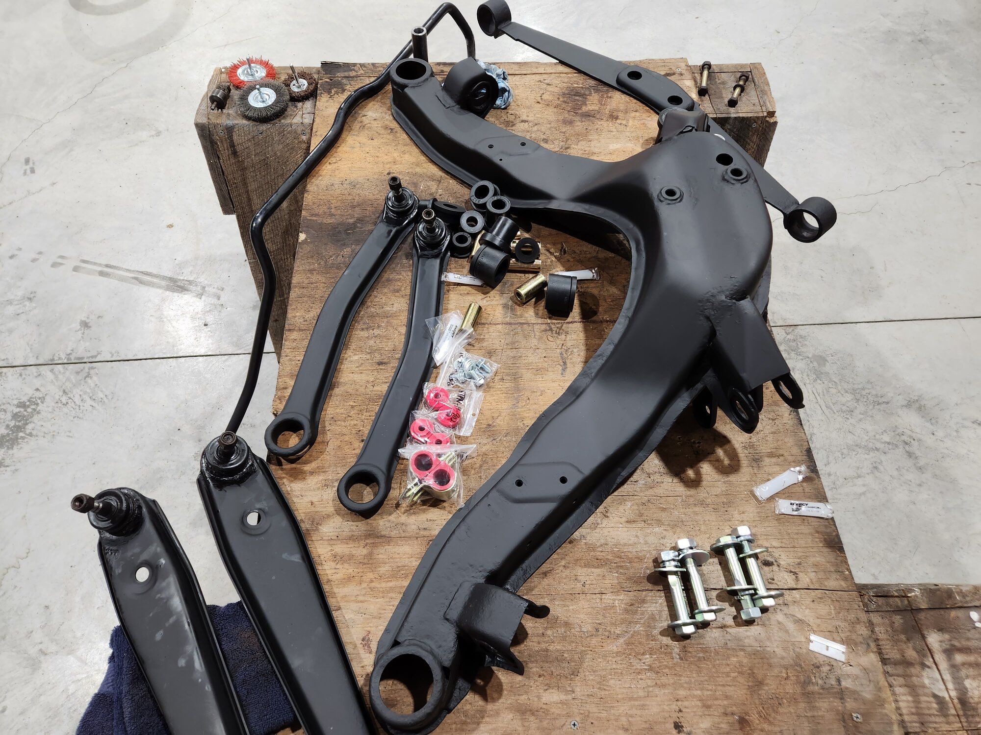

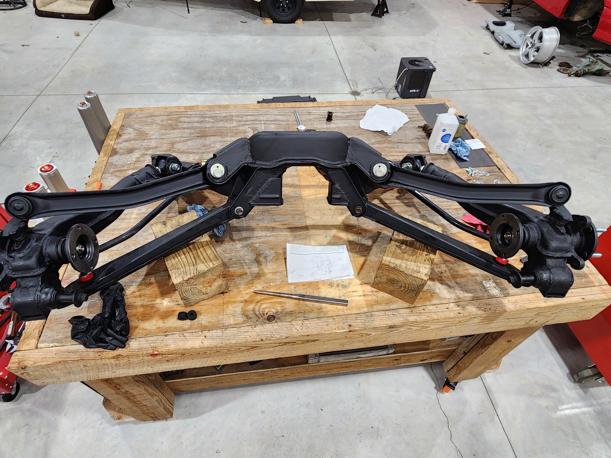

The final frontier of the rear K member, the trailing arms! Although they're a bit c-rusty, they came apart easy and, cleaned up *ok*
Busted out the squirt gun (MIG) and got the Volk toe Elim kit assortment welded up. Also, the seams where they were ground down, probably for tire clearance, I welded those up as you could see light through em...yikes! All 100% now. A couple more coats of paint, new OE dust shields, SKF bearings, seals, and the subframe should be ready to go back together!!

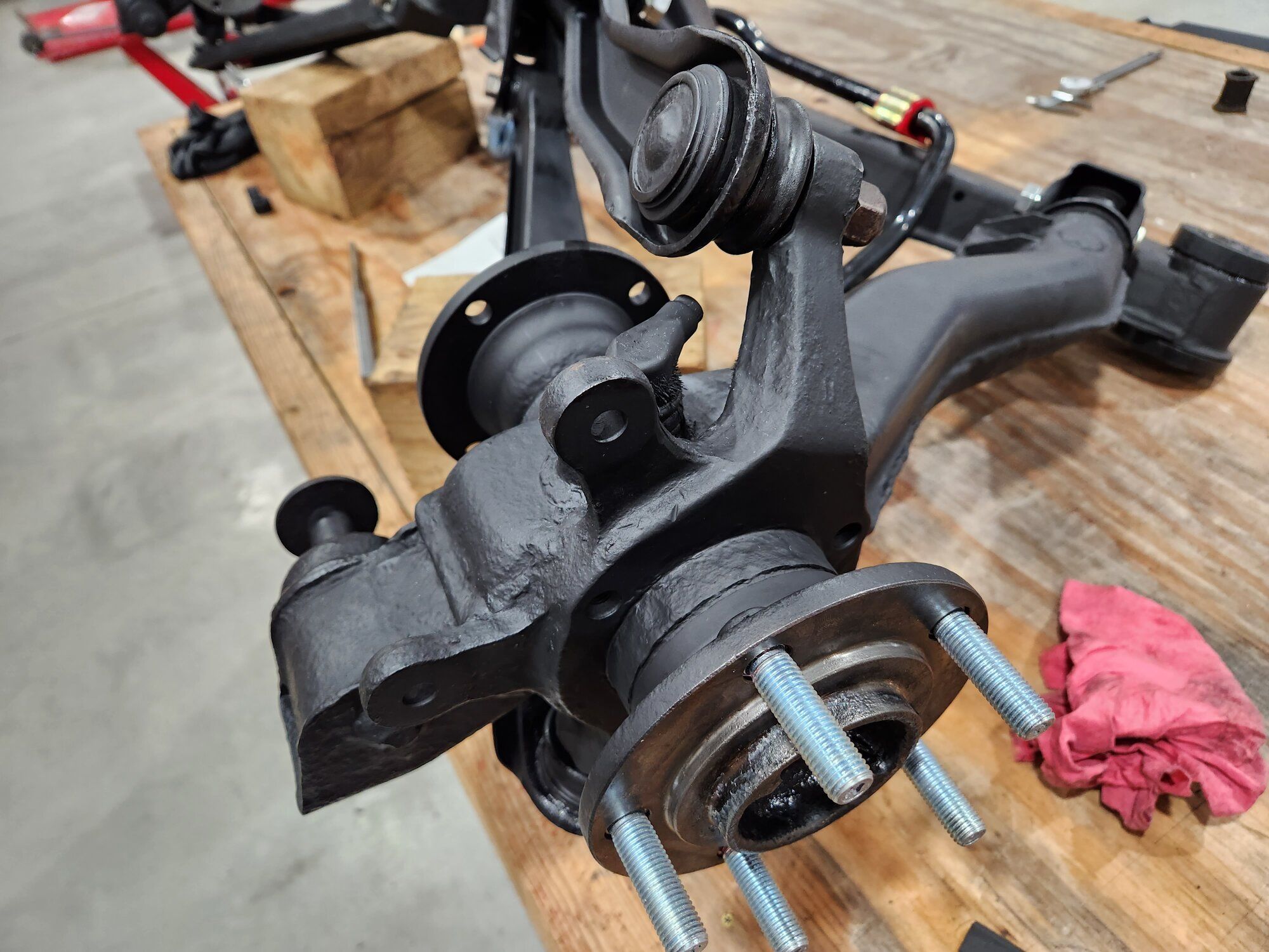

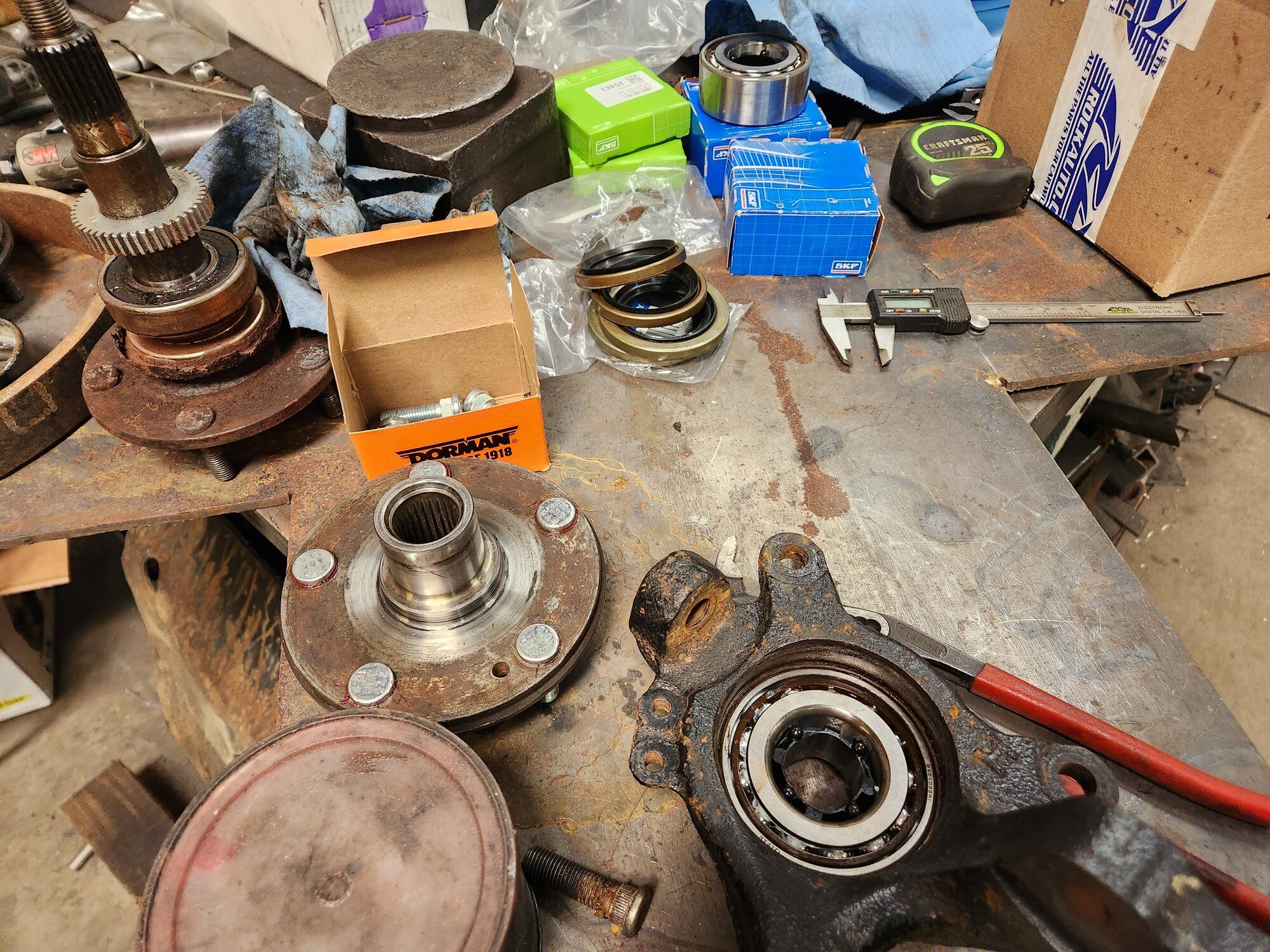

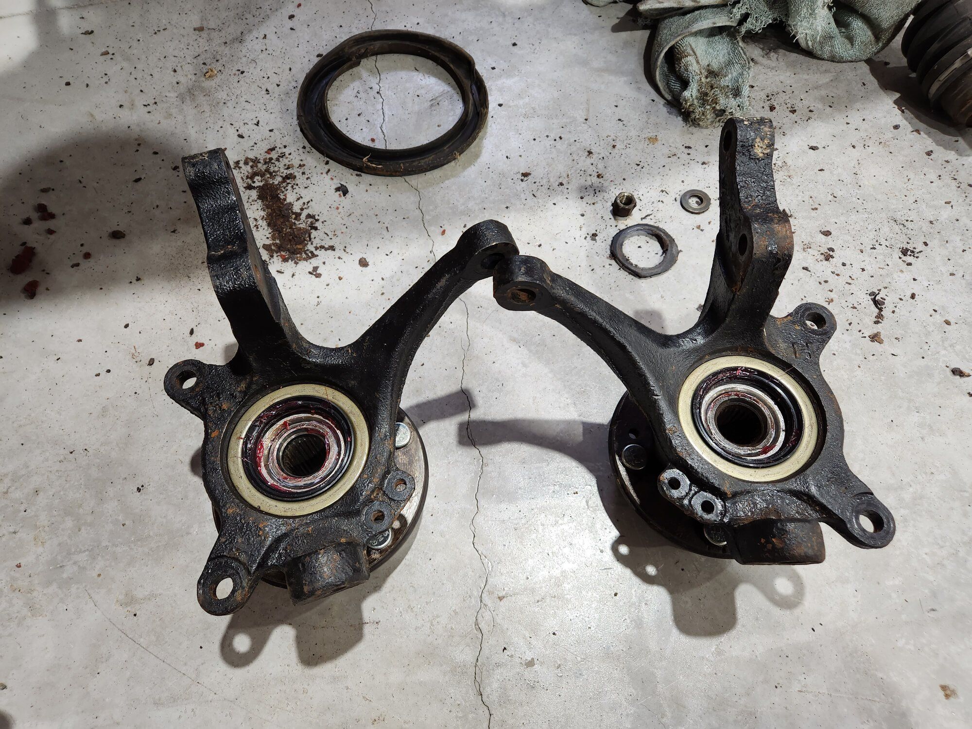

With the help of my buddy Travis from Wilson offroad performance, we pressed off and on all new SKF and Koyo bearings front and rear, new lip seals and dust covers.

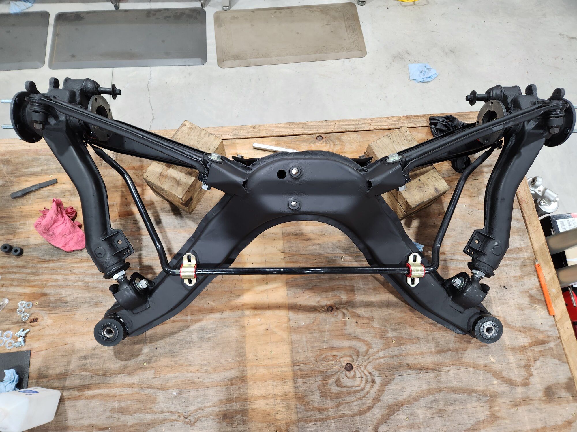

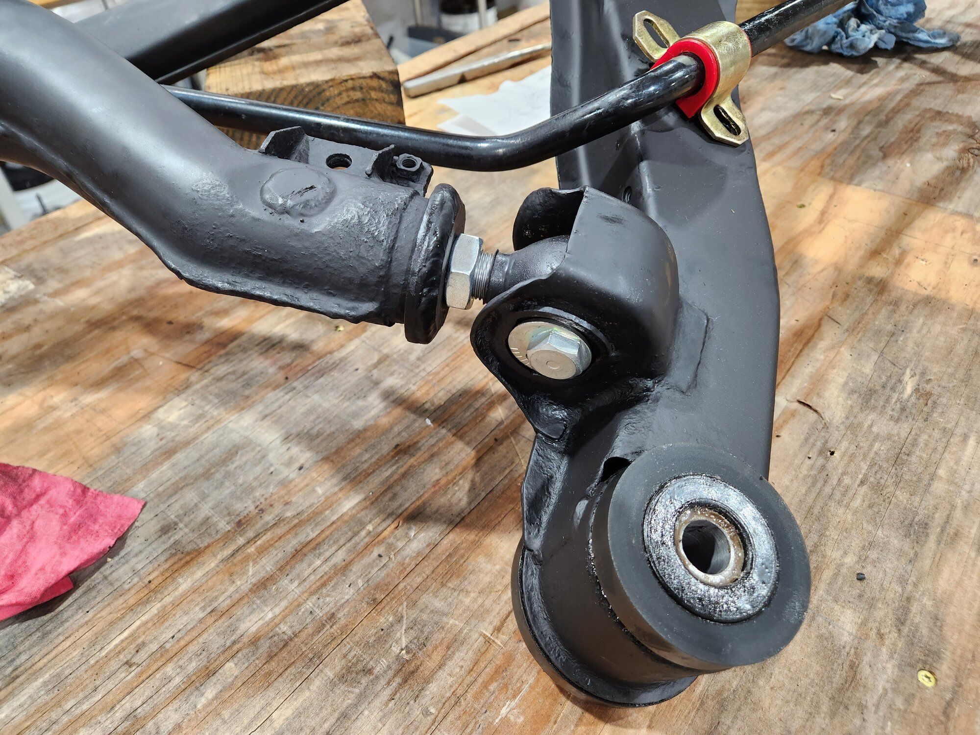

Finally installed the poly bushings and loosely assembled the subframe. Found out I ordered the wrong sway bar bushings, doh.

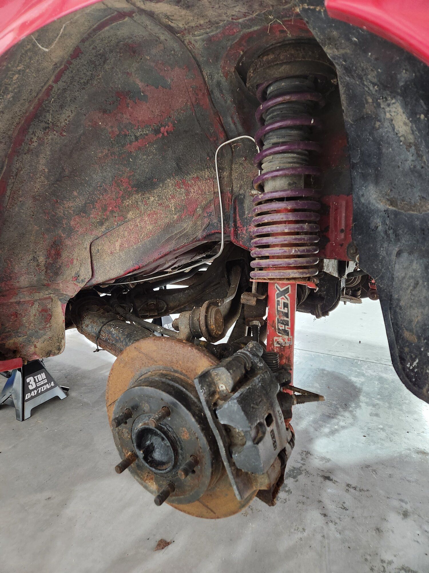

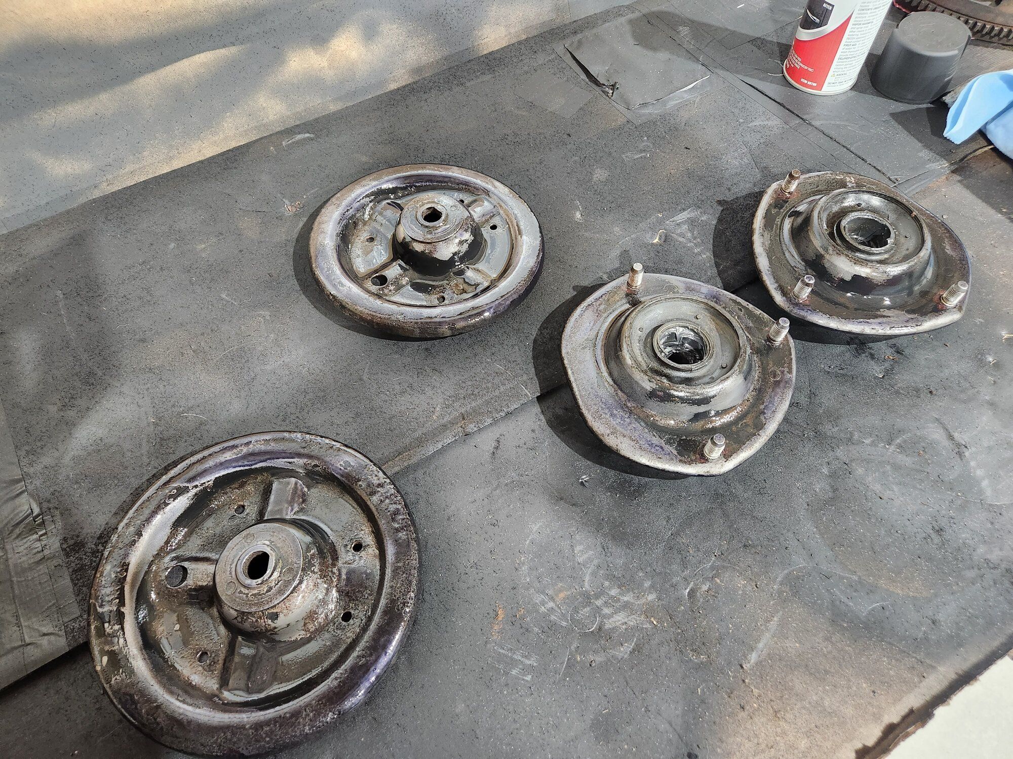

Cleaned up the crusty suspension components, hit em with the rust convertor, then some paint. Plans are to just get it back on the road, iron out all the little details that a 30 year DSM generally has. Then, upgrade down the road to Ohlins coilivers, fatty sway bar, and roll bar.
Freshie Tein S springs (-1.2 to1.5 drop), bump stops, and AGX to round out the suspenders.
Here's to some boosted pulls right around the bend!

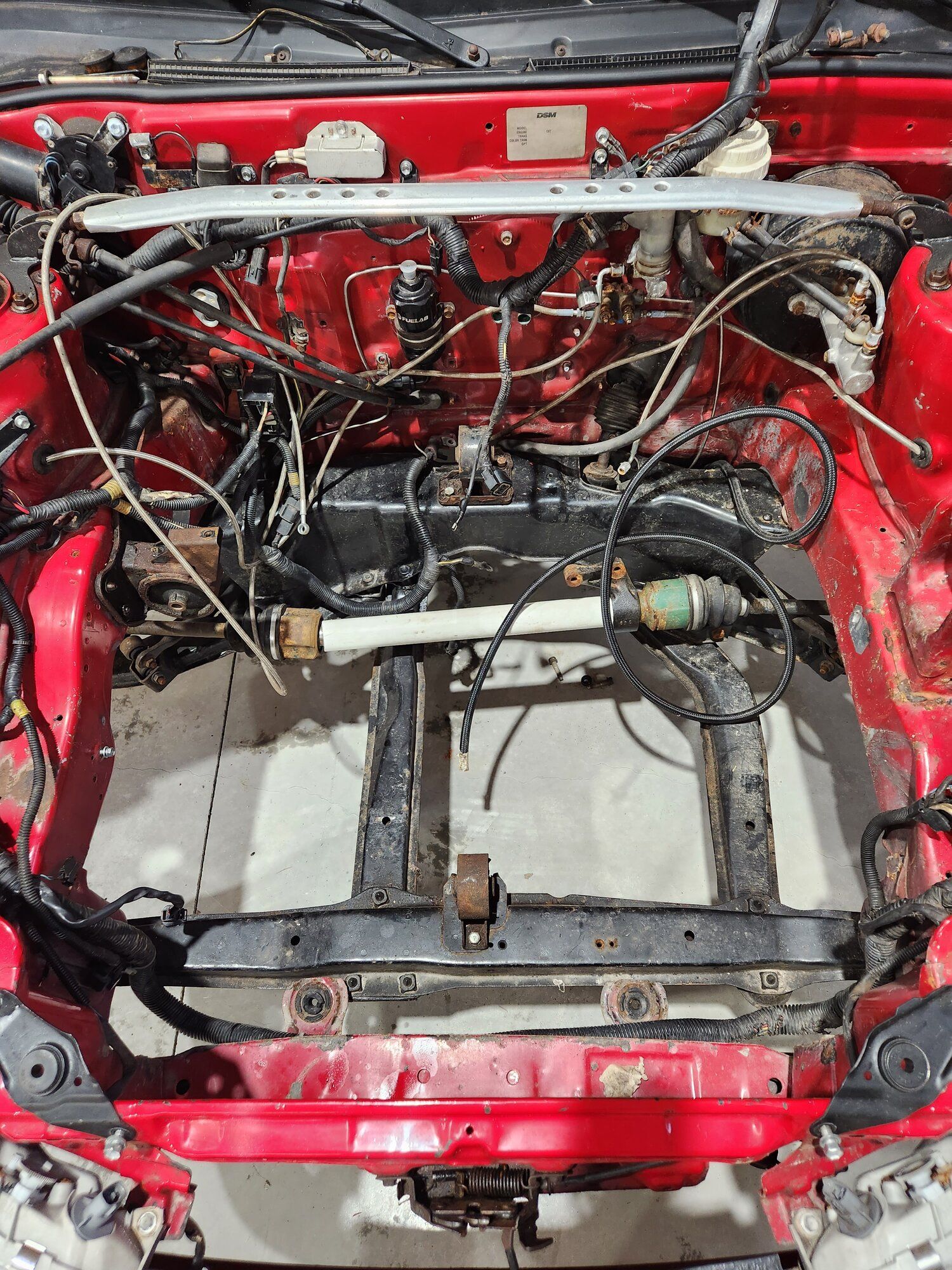

There's no way I could pass up the opportunity while I'm here to strip the engine bay, scrub/clean it, then what's the hell, may as well prep and paint it, too! I'm not pulling the fash to get the harness completely removed so I did the best I could to keep it clean. Hell, it needs work anyway. Haha.
Time for everyone's favorite task next, clutch pedal assembly removal....yay.
