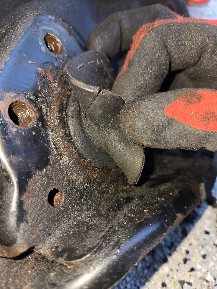

So I have a bit of a dilemma. I have the front subframe removed from the car right now. I also have an Energy Suspension Front Subframe Poly Bushing Kit
Should I replace the bushings with the poly ones? I do want to try and preserve the drivability of the car, I don't want it to become super harsh. So I'm debating between leaving the OEM rubber bushings in vs installing the poly bushings. Will it make a big difference on the subframe?
The bushings on the subframe are the OEM rubber ones and they look "fine" to my eye? They aren't torn or cracked. But I really don't know how old they are or how much play is supposed to be normal for them.
Here's a pic as an example they all look mostly like this
Its subjective but I did poly subframe back in the 90s. I didnt think it was harsh.
I had the fortunate experiemce of DSMs from relatively new (30k). Bushings made the car what it should have been from new. Great tires and suspension took the car beyond my capability on the street. Just simple quality parts made for a great street car. I never wanted a race car. I still dont.

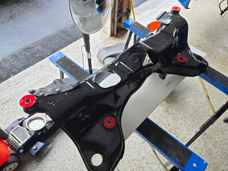

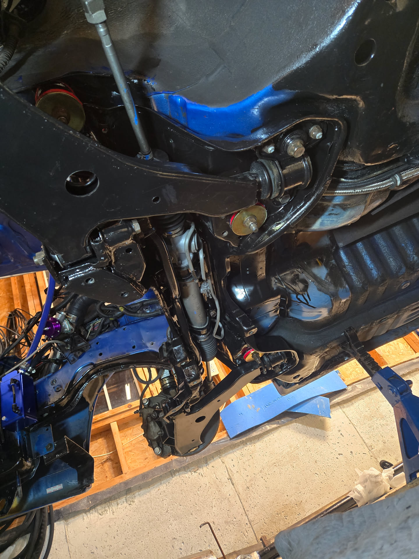

Okay, subframe is sorted! And I've got all the front end stuff back together. Looking shiny under there now :D

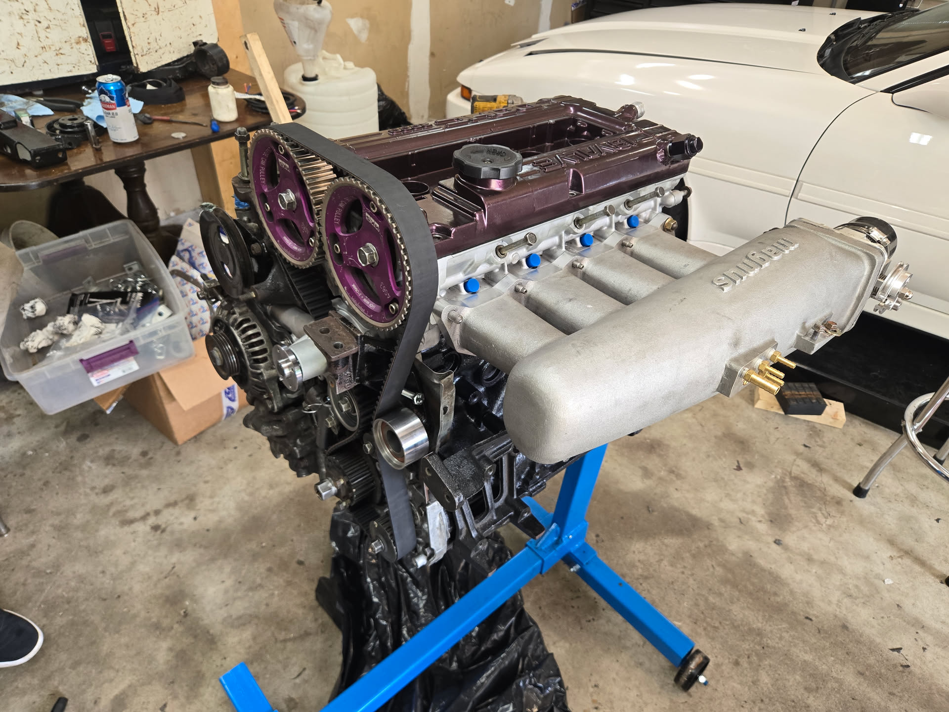

So, my attention is turned back to the engine now. We got the timing done, it took a lot of trepidation and cross referencing half a dozen different service manuals and guides to figure out the right way to tension it and time it. But I think we've nailed it, so new tensioner, new water pump and an OEM timing belt and balance belt. All that is sorted out now. :thumb:

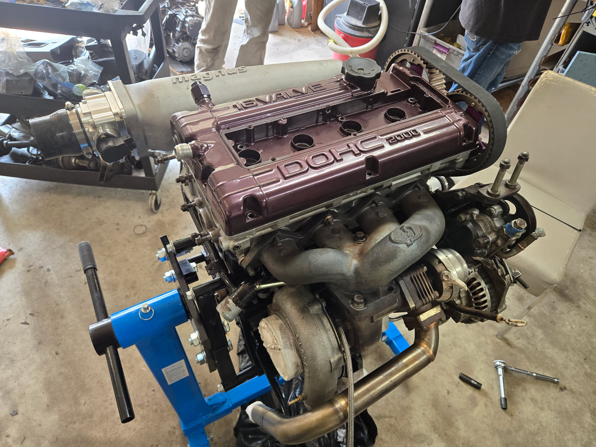

Now I need to get all the plumbing on this thing figured out. We test fitted the exhaust manifold, intake manifold, turbo, downpipe etc. to just see how everything is going to fit up. It's looking pretty good so far!

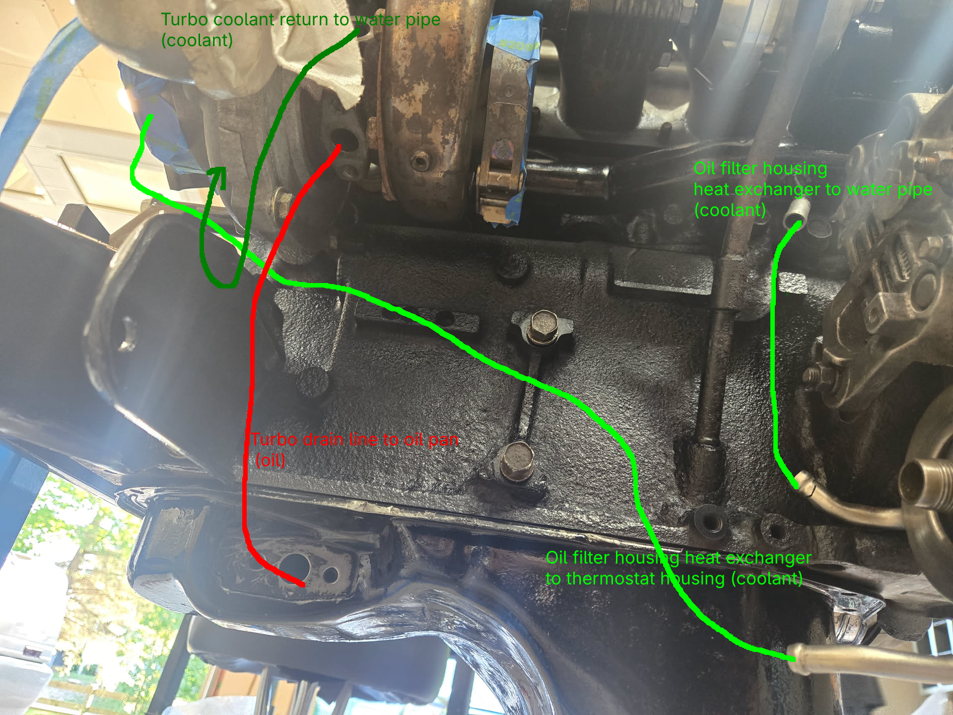

So now I'm trying to figure out this bit - I need the oil filter housing's coolant lines and the turbo's coolant and oil lines hooked up. But a lot of this is gonna be awfully close to the turbo / exhaust manifold / downpipe, so I'm trying to think about temperature and make sure I don't have an issue there. I cannot afford to have a hose melt on me, if I blow up my engine or my turbo it'll be game over.
My understanding so far from all the research I've done is that the coolant lines in green need to be... SAE 20R3 rated heater hose, because that's rated to handle coolant? Meanwhile, the turbo drain line is differnt it's handling hot oil not coolant so.... you DON"T want heater hose there. I have AN fittings for the turbo and oil pan that I got from RTMRacing last year before they closed so I was thinking maybe I'd do a short run of 10AN PTFE fuel line for this
The heater hose is rated for 257F but I have no idea how much heat the turbo is going to produce, will that be enough? Evil Energy has silicone 3/8 heater hose that they claim is 20R3 rated and allegedly good up to 356F so I'm considering going with that..

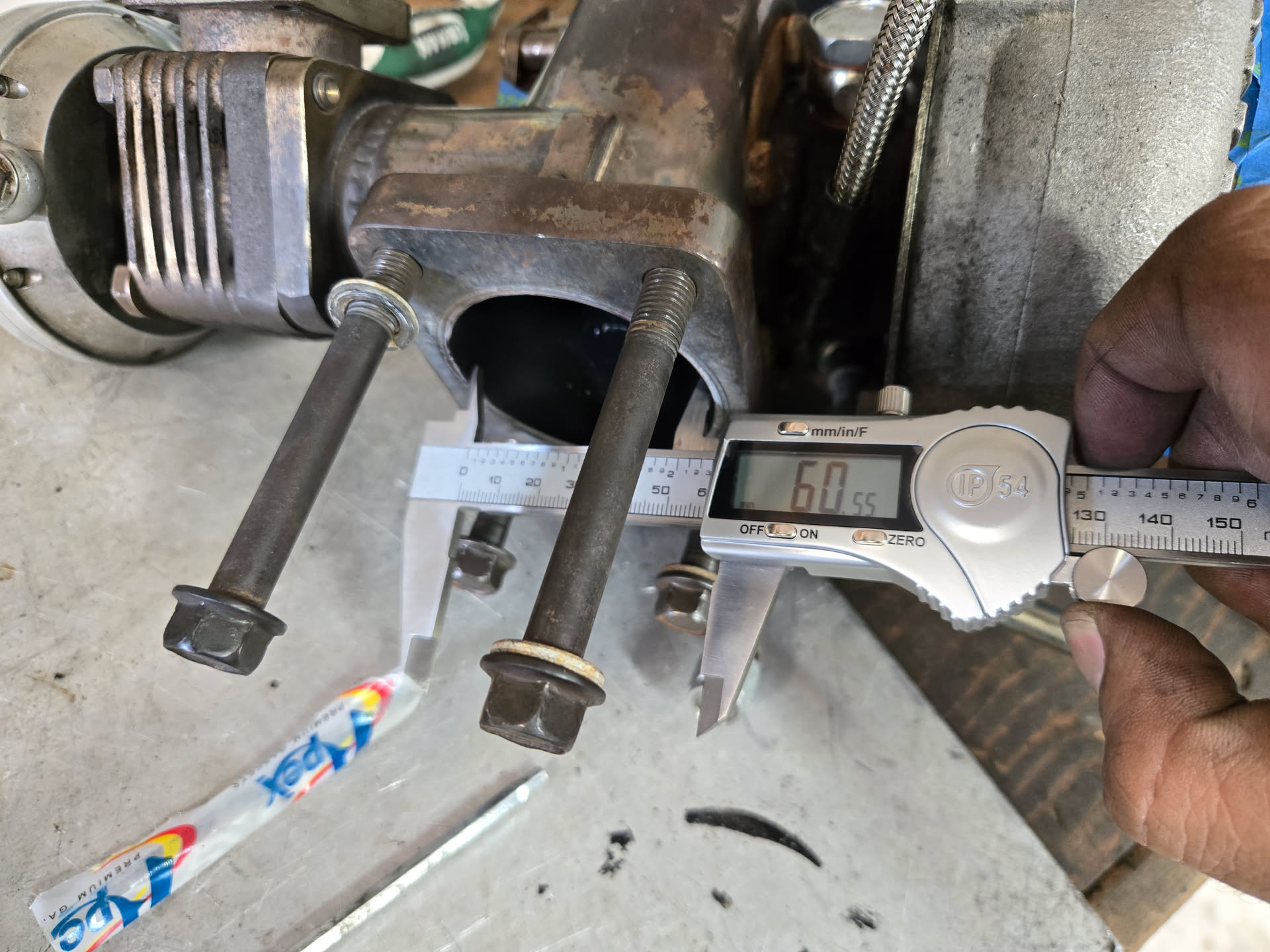

Well I found out today that my FP3052 turbo's 60mm inlet that attaches to the exhaust manifold does *not* mean I need a 6cm gasket. Apparently 6cm gaskets are for the stock turbo, which has a 55mm diameter hole. What I actually need is Forced Performance's 7cm gasket. Which has a 60mm hole. Go figure :confused:

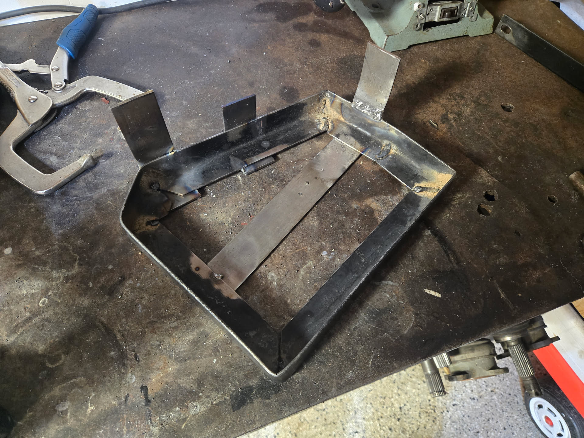

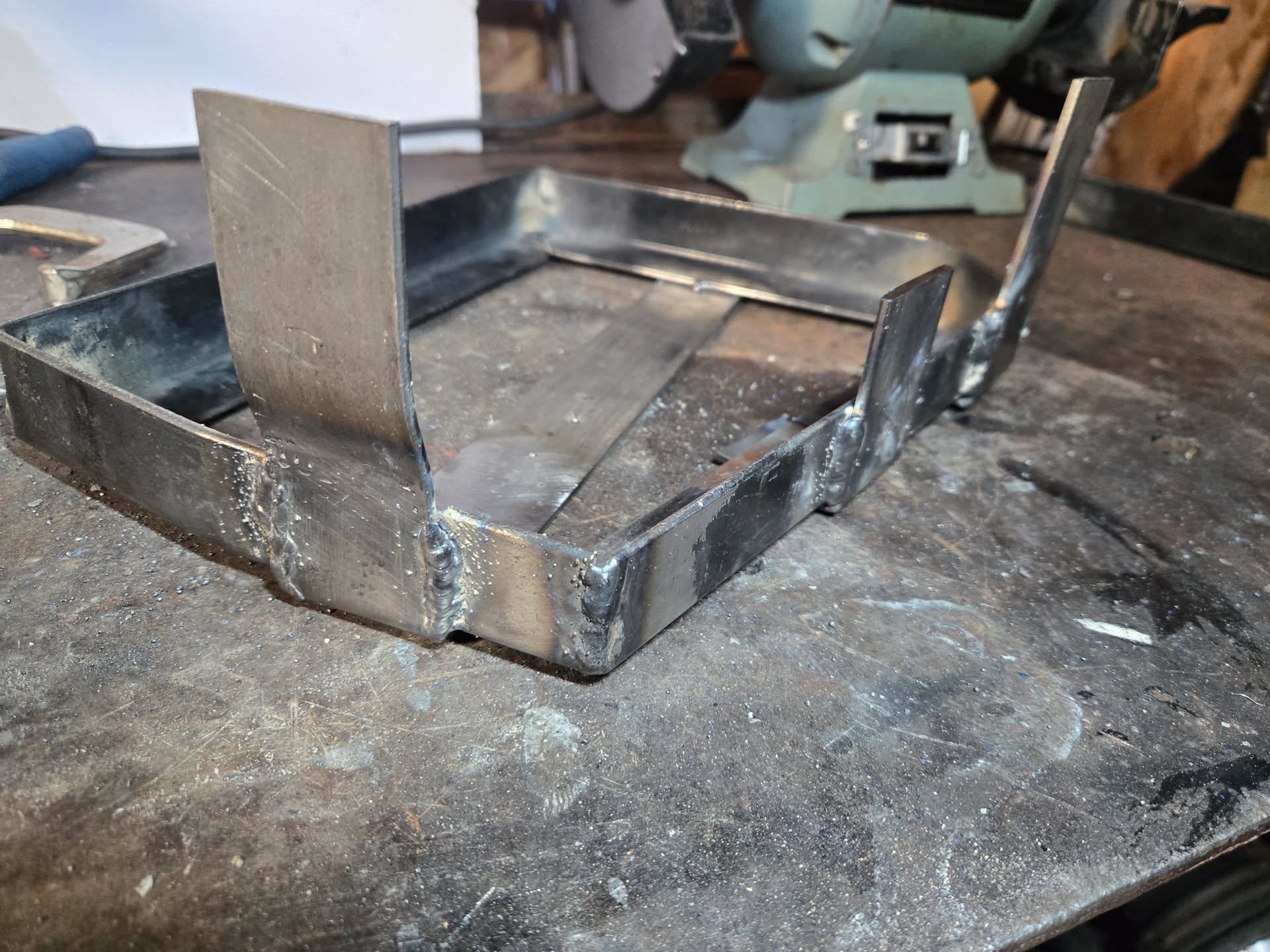

In other news, I've been working on the battery tray. The stock location for the battery interferes with the intercooler piping to the intake, and the previous owner had just set the battery on the subframe and strapped it down, which would maybe work okay but I didn't want to risk that and I just spent a lot of time repainting it... so I took a piece of an old bed frame and I'm trying my hand and welding and bending it into a custom bracket that can bolt to the firewall + side of the engine bay to hold the battery.
I think it came out okay!

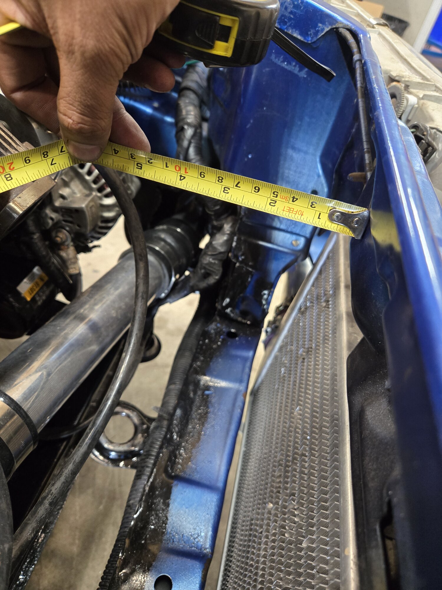

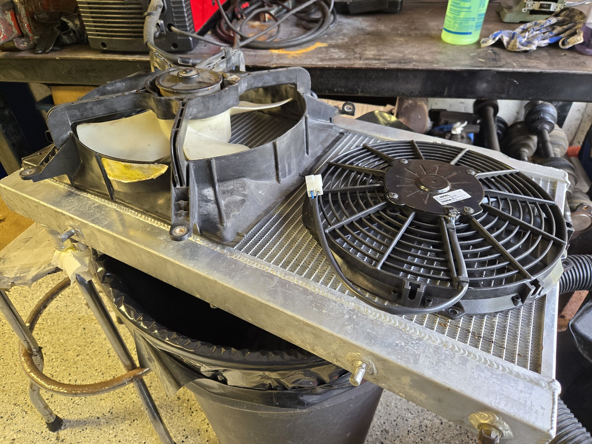

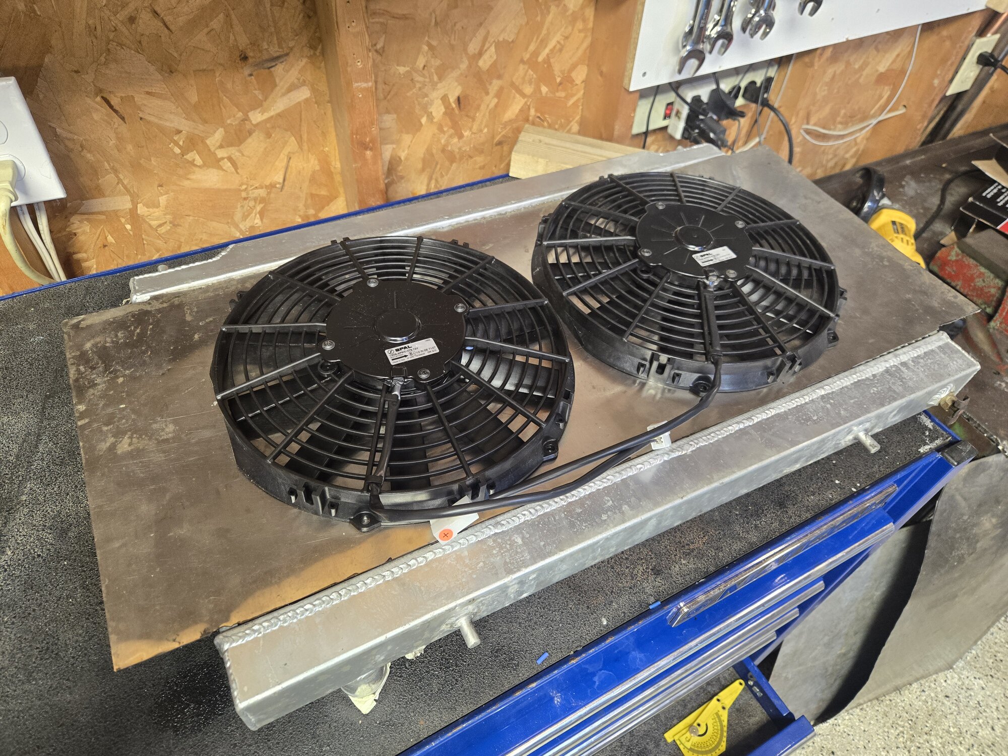

Sooo, while I try and figure out the rough running issue with the engine I thought I'd turn my attention to the other issue - my stock rad fan doesn't fit.
But, I think there is enough room in here for activities

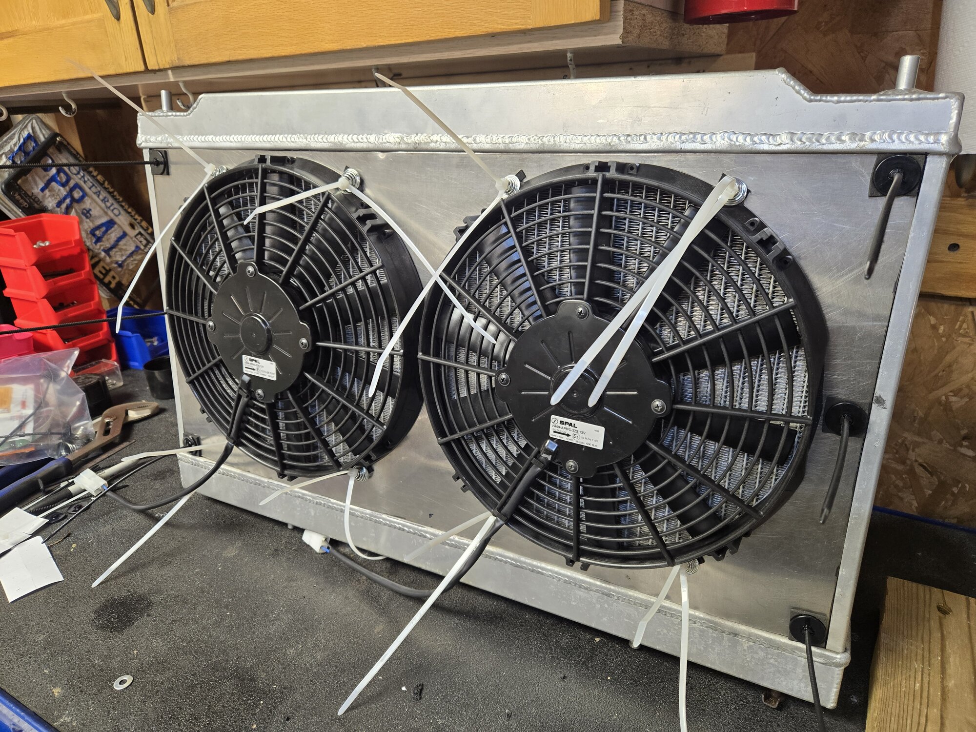

I decided to go with 2x 11" SPAL pusher fans and they will mount in front of the rad, behind the intercooler.
What a size difference!
Making the shroud, I just attached it with zip ties to press it tight to the rad with some foam. Hopefully nothing melts..

@pauleyman - I finally managed to take it out for a few test drives. I'm super glad you supported the poly bushings, I don't think they're adding any harshness at all steering just feels nice and tight and it is much more predictable than my previous talon. The ride feels great!

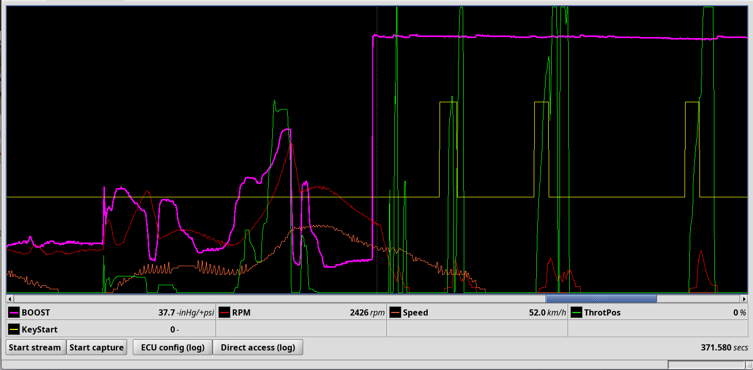

Alright so maybe I spoke too soon. The car keeps randomly dying on me mid-drive.
Once it dies, it won't run right - hard to get it started, and when it does it barely holds 300RPM while huge amounts of smoke comes out the back, like it's flooding itself with fuel. Leave it for a bit, wiggle wires, mess around with stuff and suddenly like flipping a switch it'll just work again.
Now when it does run right... it idles really rich, like the AFR is 10-11ish. The idle feels really like 'lopey' and is sort of shaking / shuddering at anything below like 1400RPM. At 2000RPM it seems to smooth out. But I can't really get it to stay idling well enough at 750RPM to do the base ignition timing. It wasn't like that in the doner car... so idk maybe I haven't timed it right? We were super careful about getting the mechanical timing right though so I don't know where we could have gone wrong there.
My boost is going to 37 PSI when the car dies. And then it just stays like that while I'm cranking the engine!

Oh cool! Okay here is the log. Yea it was really nice having all my friends over for the first fire up. :) I'll upload more videos of stuff soon!
The Htr code does go away on the wideband after like 20 seconds or so and it shows my AFRs. It is just going to the gauge though it doesn't feed into ECMLink, haven't figured that out yet.
Wow, at 411.925 secs the MAP raw voltage (RawOmni4Bar) all of a sudden jumps to 4.33 volts which is ridiculous. Then 2 seconds later it is back to normal. Everywhere else it looks ok.
I don't know, it could be the fault of the MAP, or it could be an intermittent connection on one of the wires to it.
Our ecu inputs, or at least some of them, have an odd feature that when there is nothing connected to them, they will log 4.7 volts or thereabouts. Your 4.33 volts could be from that but it is a few tenths of a volt lower than the usual for that.
So I'd say it looks like either an intermittent connection, or else the MAP itself is intermittent.

It goes into closed loop at 87 degrees coolant, just like it should, but then it has trouble staying in closed loop because it is running too rich. The Combined Fuel Trims are usually -22% when your throttle is 0% and they are usually more like -10% when you have some throttle on it and are moving. So I think the main too rich thing is the Global deadtime. You could reduce that a bunch, you could try 200 there instead of 450.
