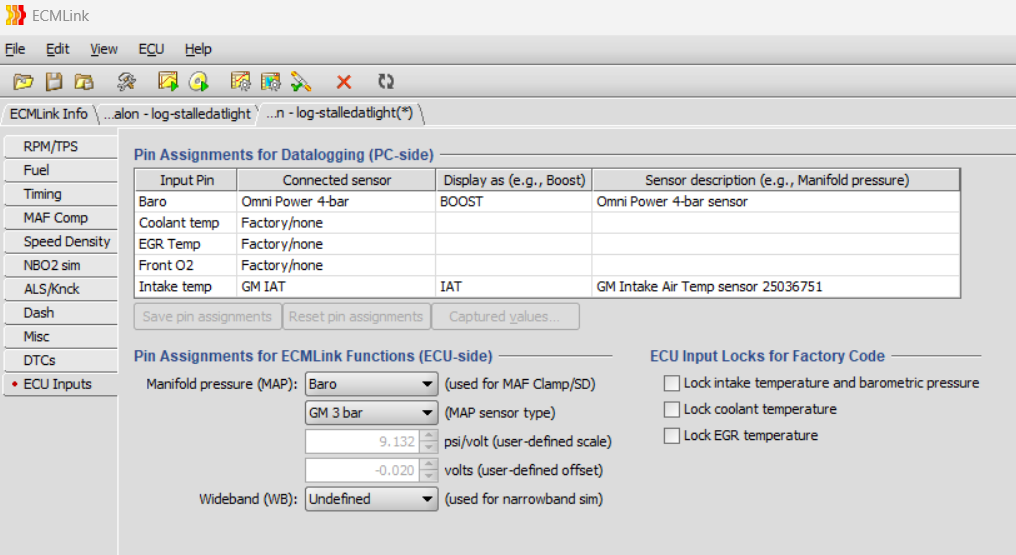

I have both so I can play with it, gonna swap it out if I can figure out how to make it talk to ecmlink.
If the electrical plug is the same, all you need to do is change the "MAP sensor type" on the ECU Inputs page to "GM 3bar" like this:
