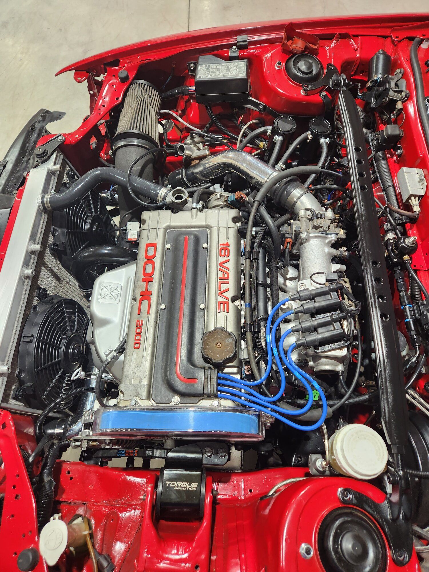

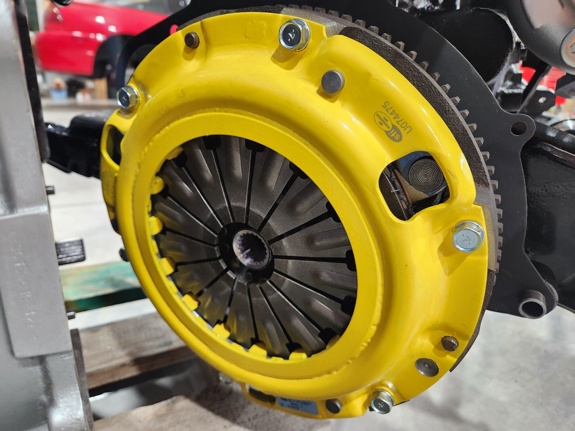

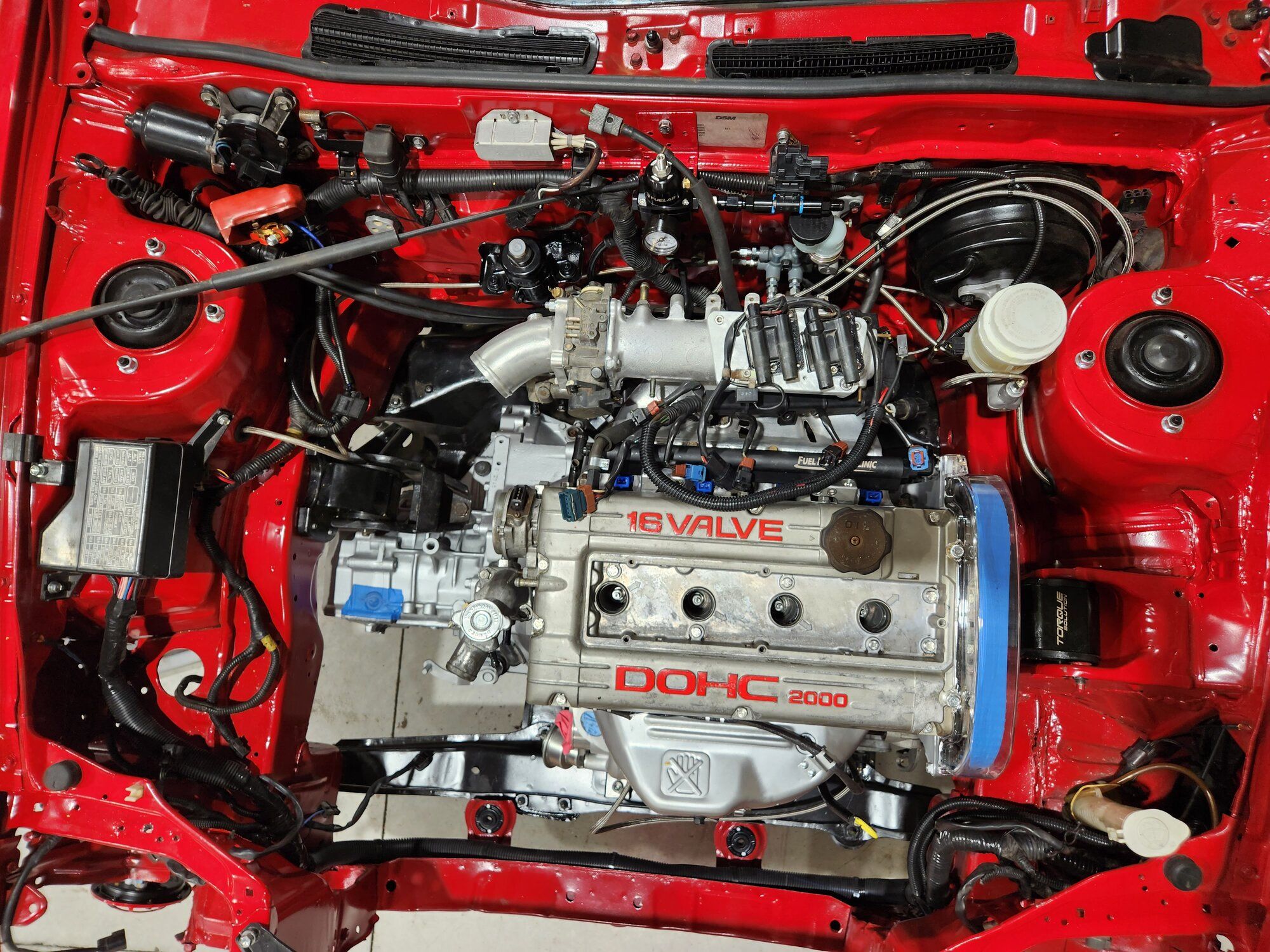

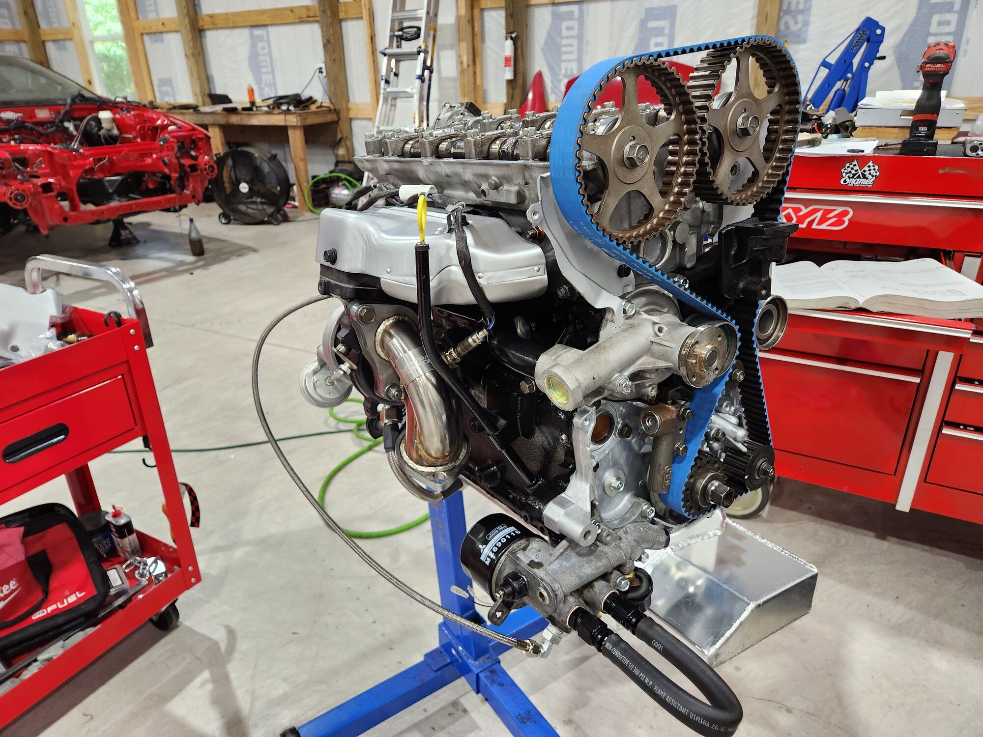

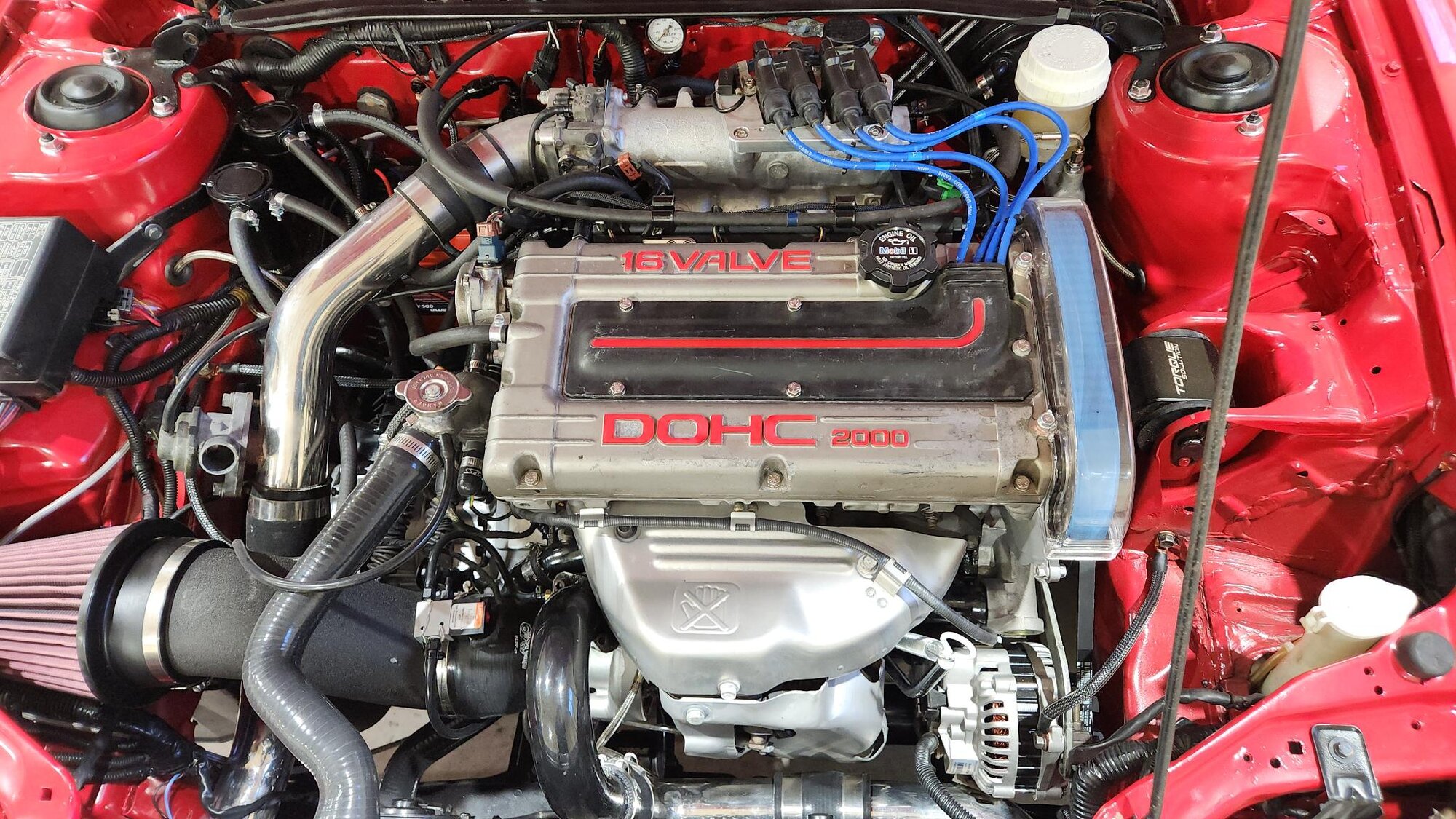

Hey, all! Hope everyone is doing well out there!

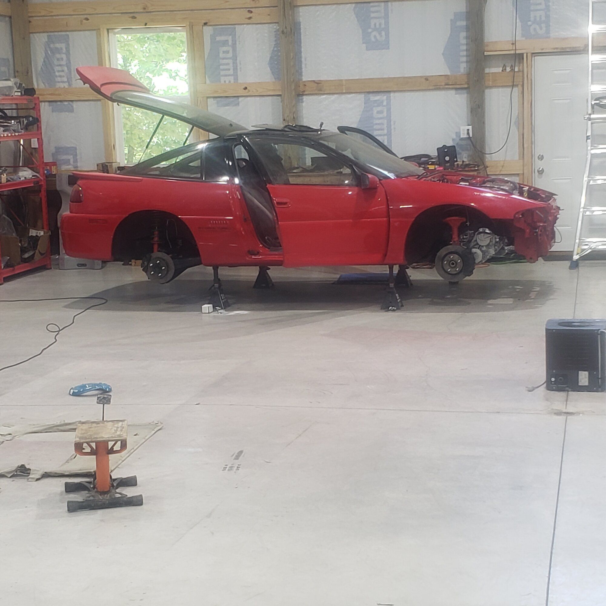

I've been grinding between work jobs and the extreme heat to push to get this thing ready for the shootout.

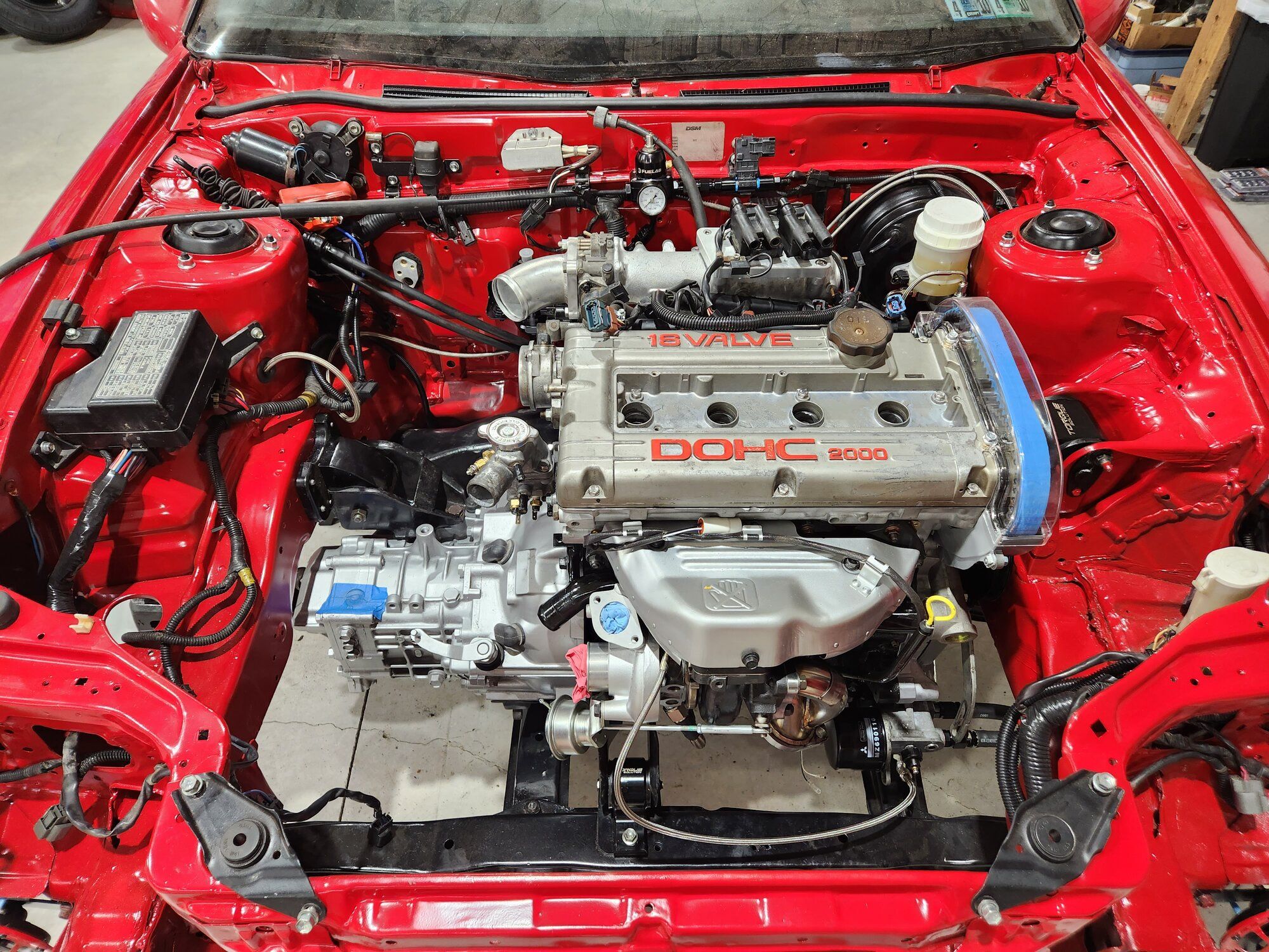

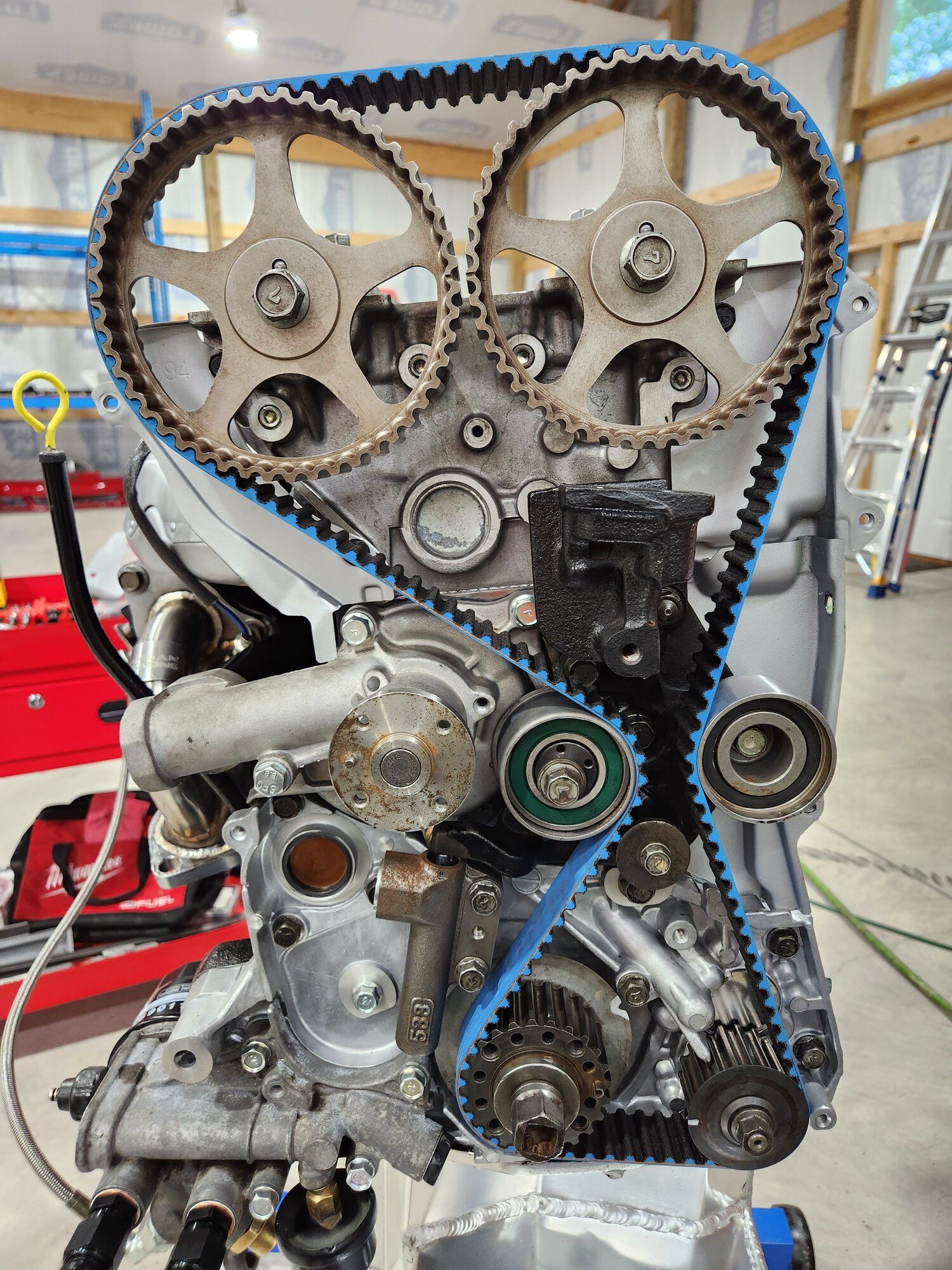

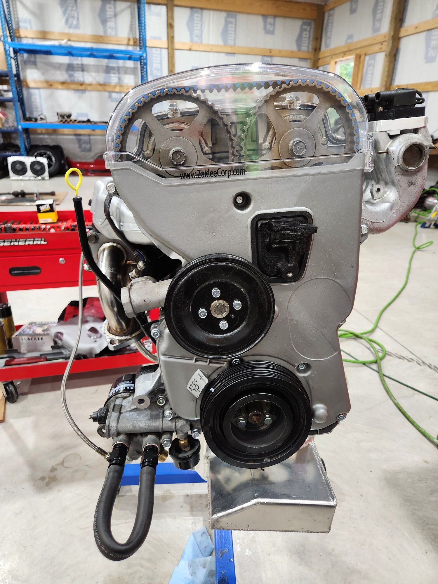

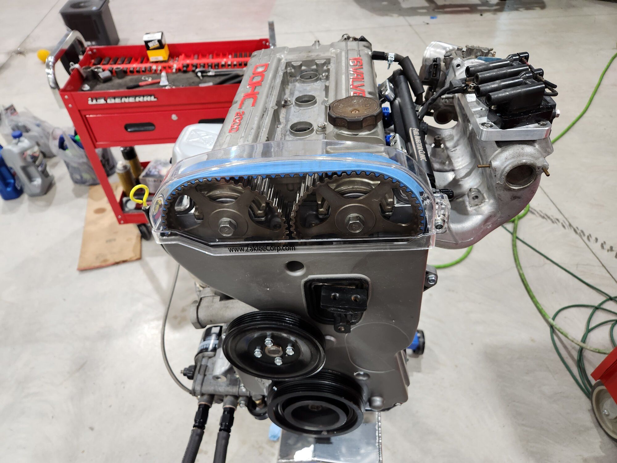

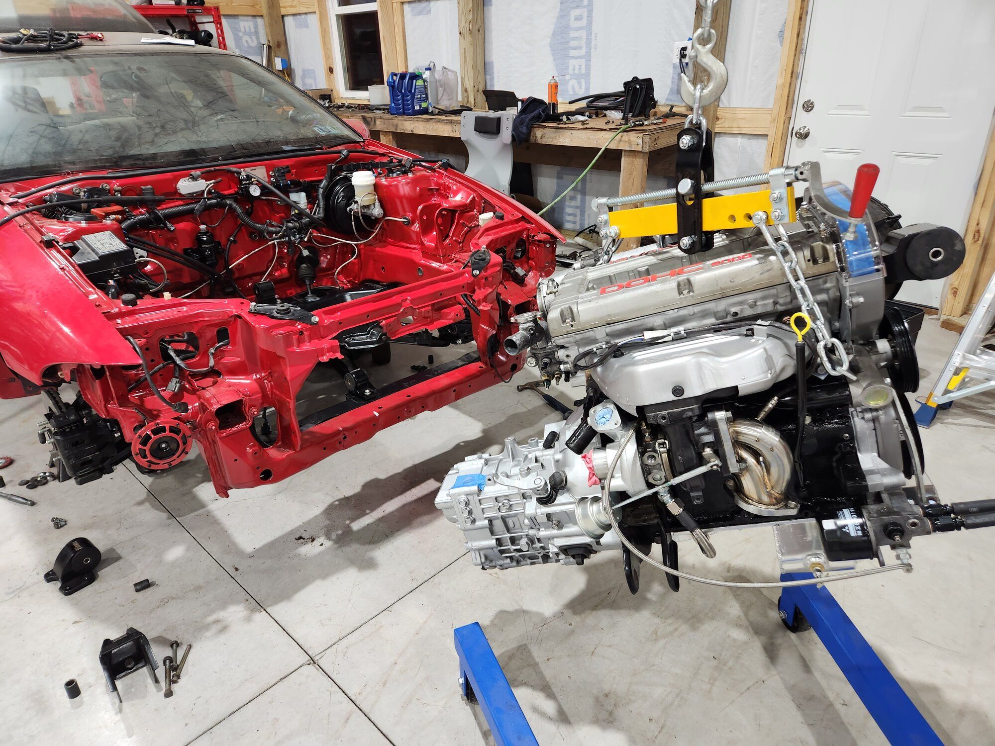

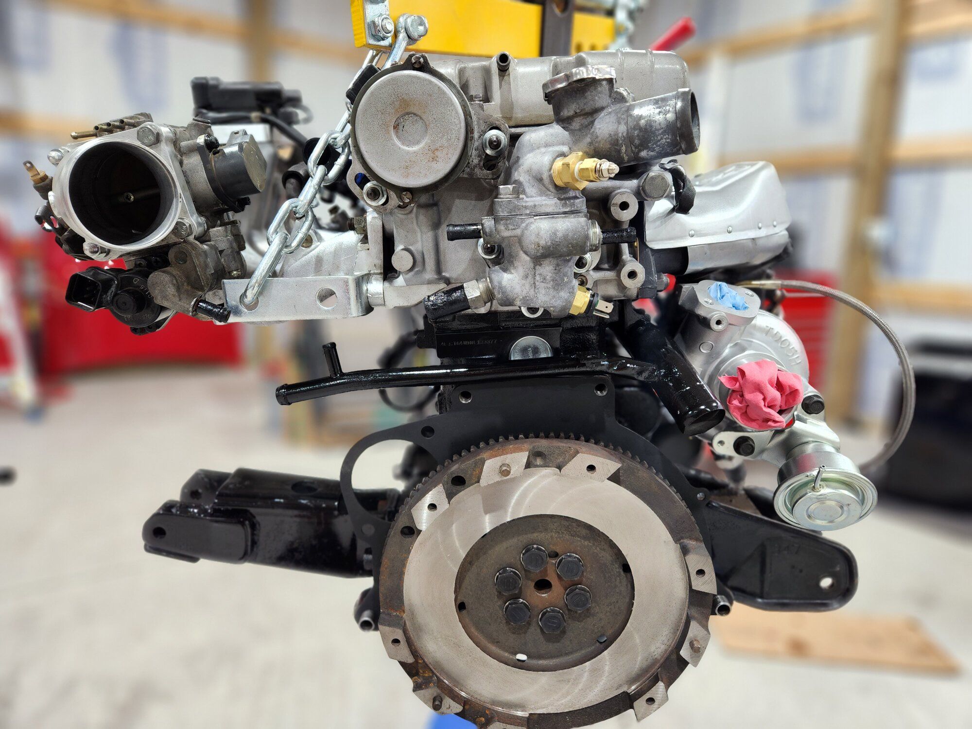

Motor and trans mated, back in the car! I've been working on a bunch of supporting projects and small details while waiting for parts.

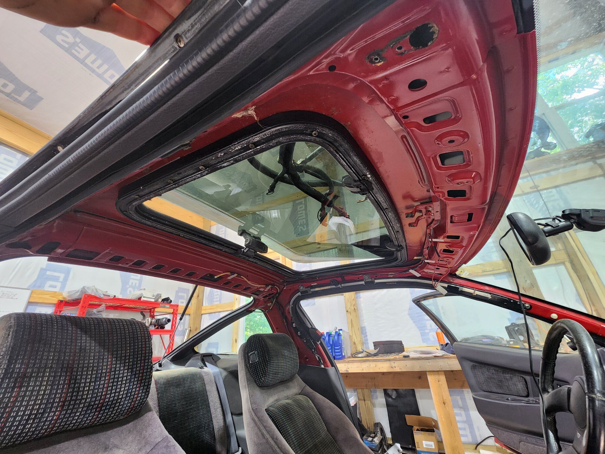

Yanked the stinky old headliner to repair a small section of dome light wire that a mouse chewed on. Lol

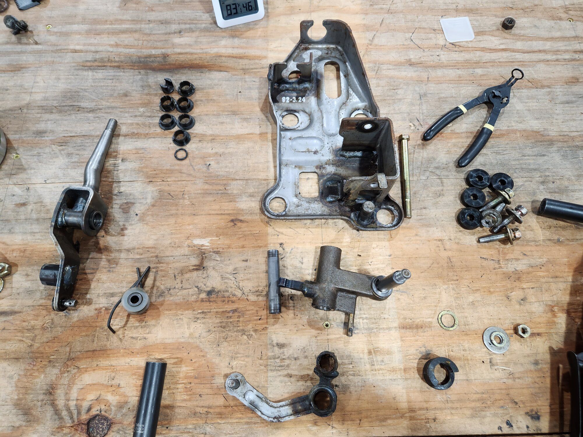

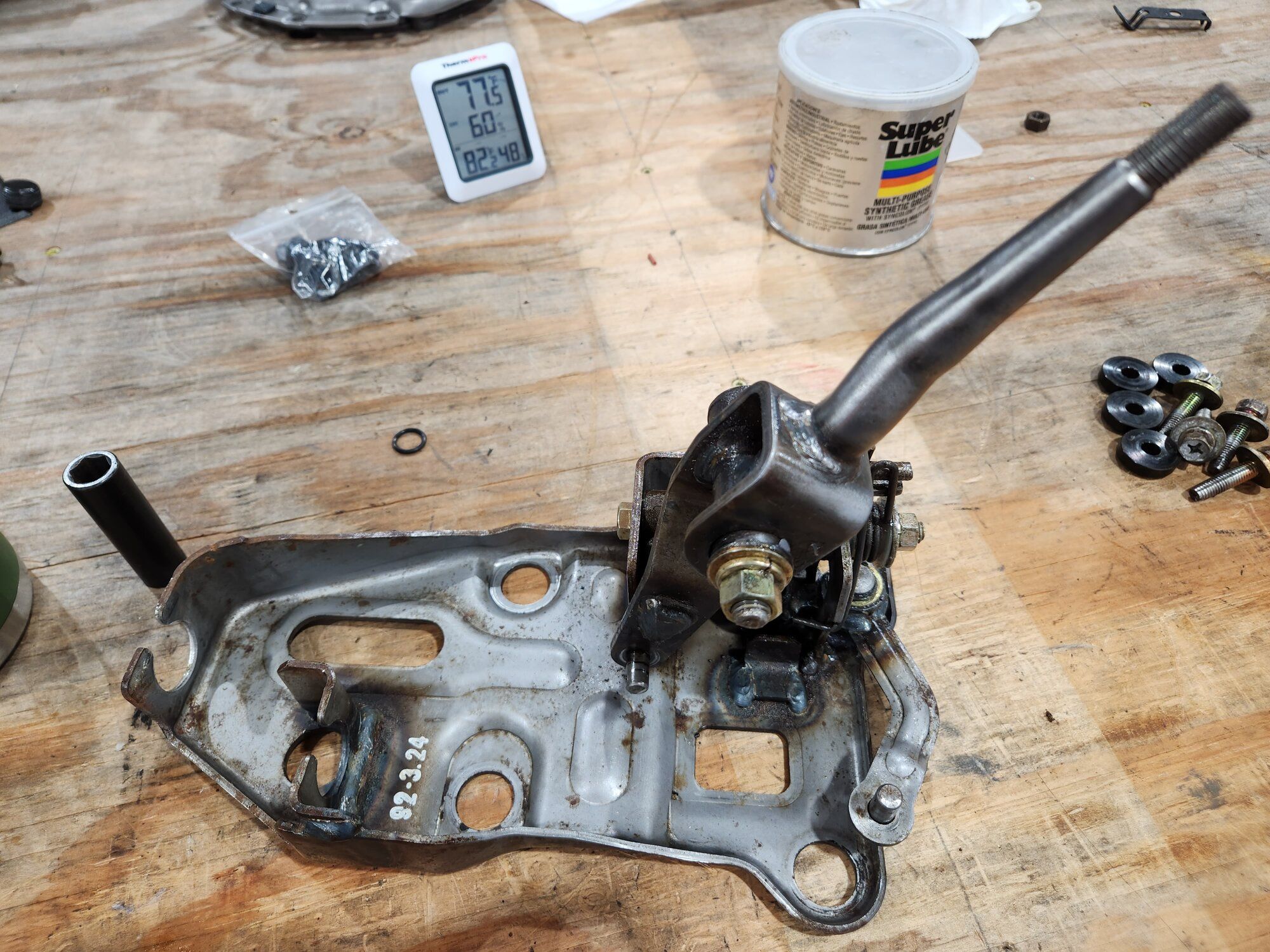

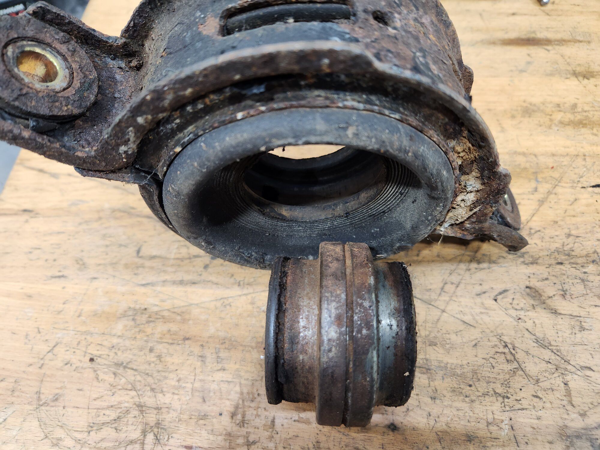

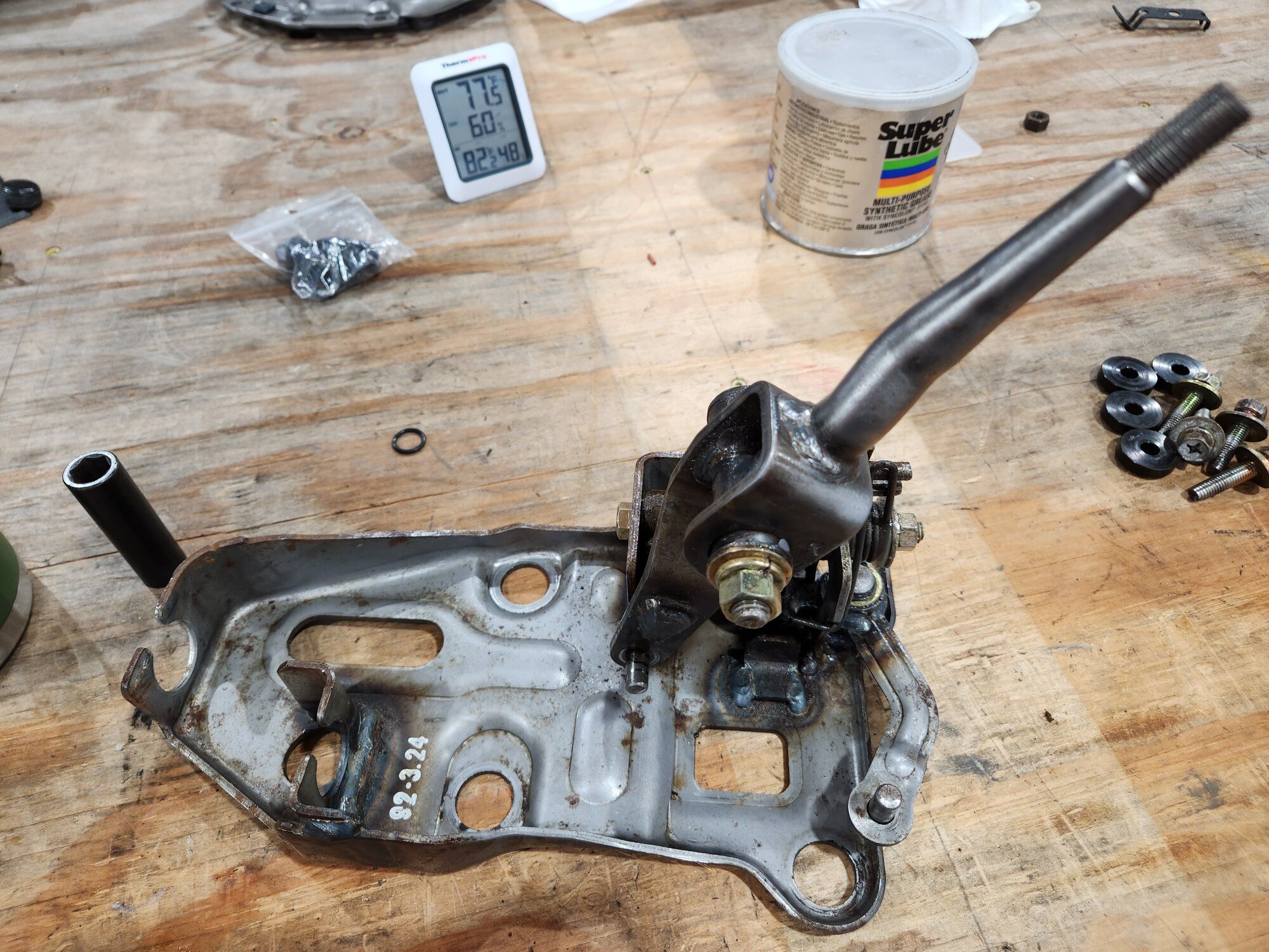

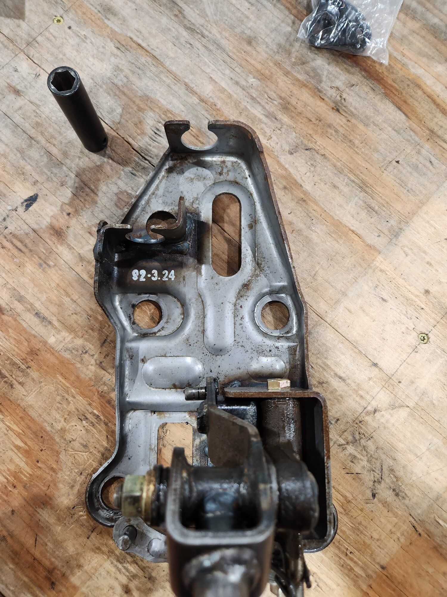

Rebuilt the shifter with fresh OE bushings and what a nice difference!

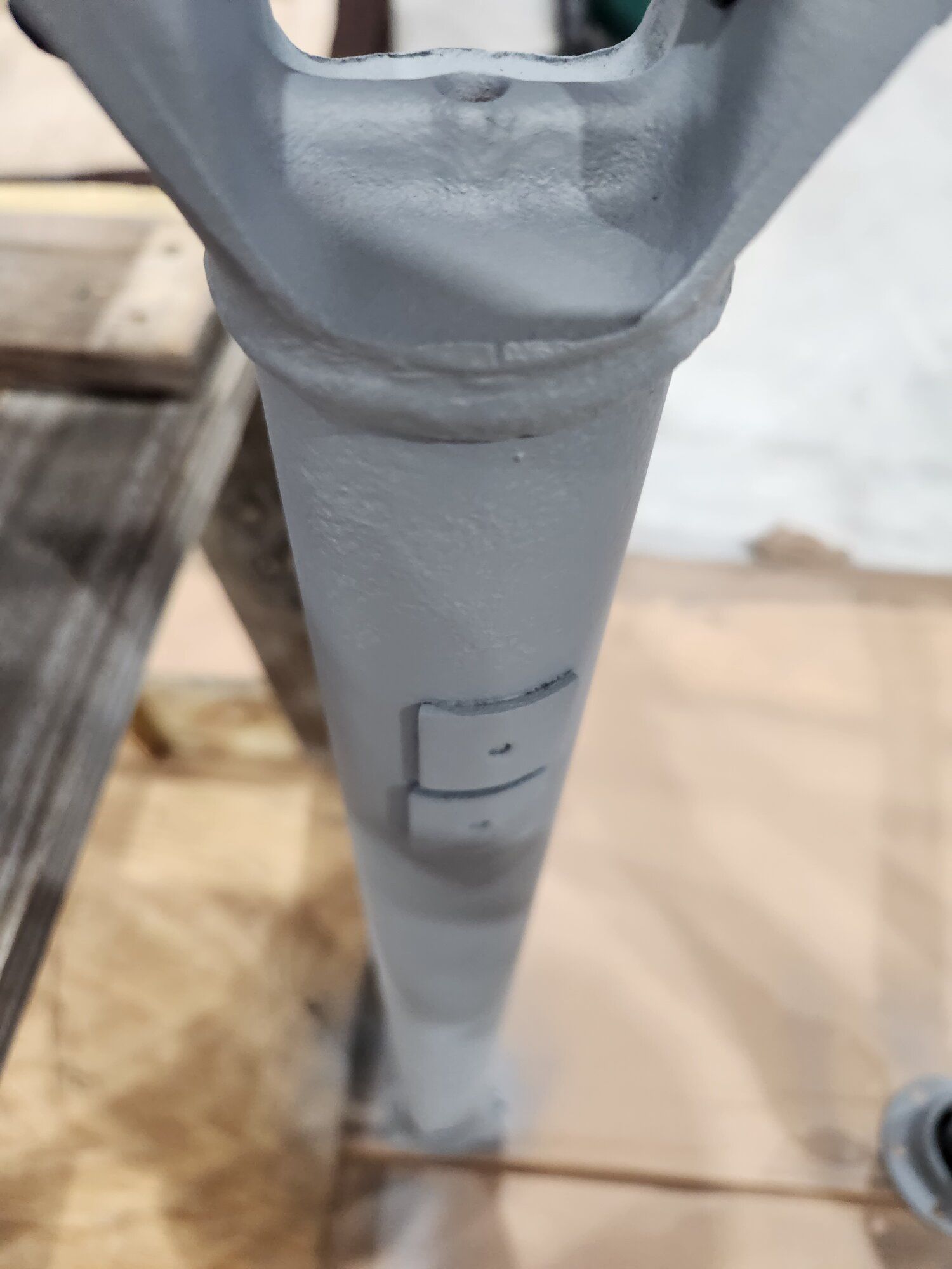

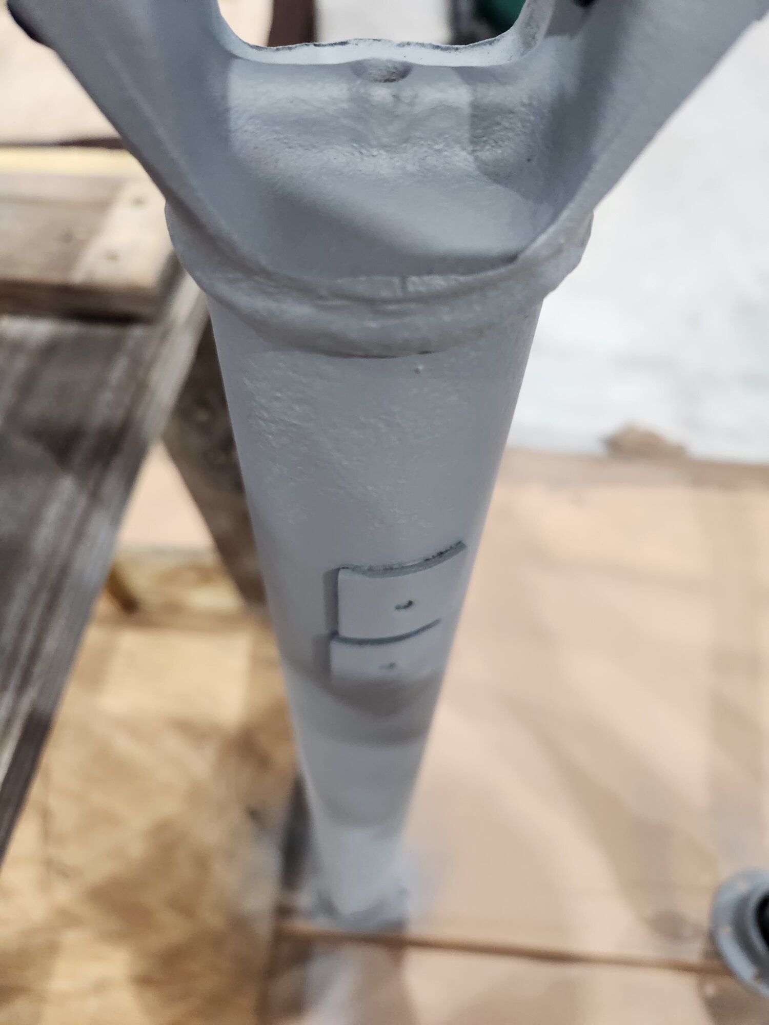

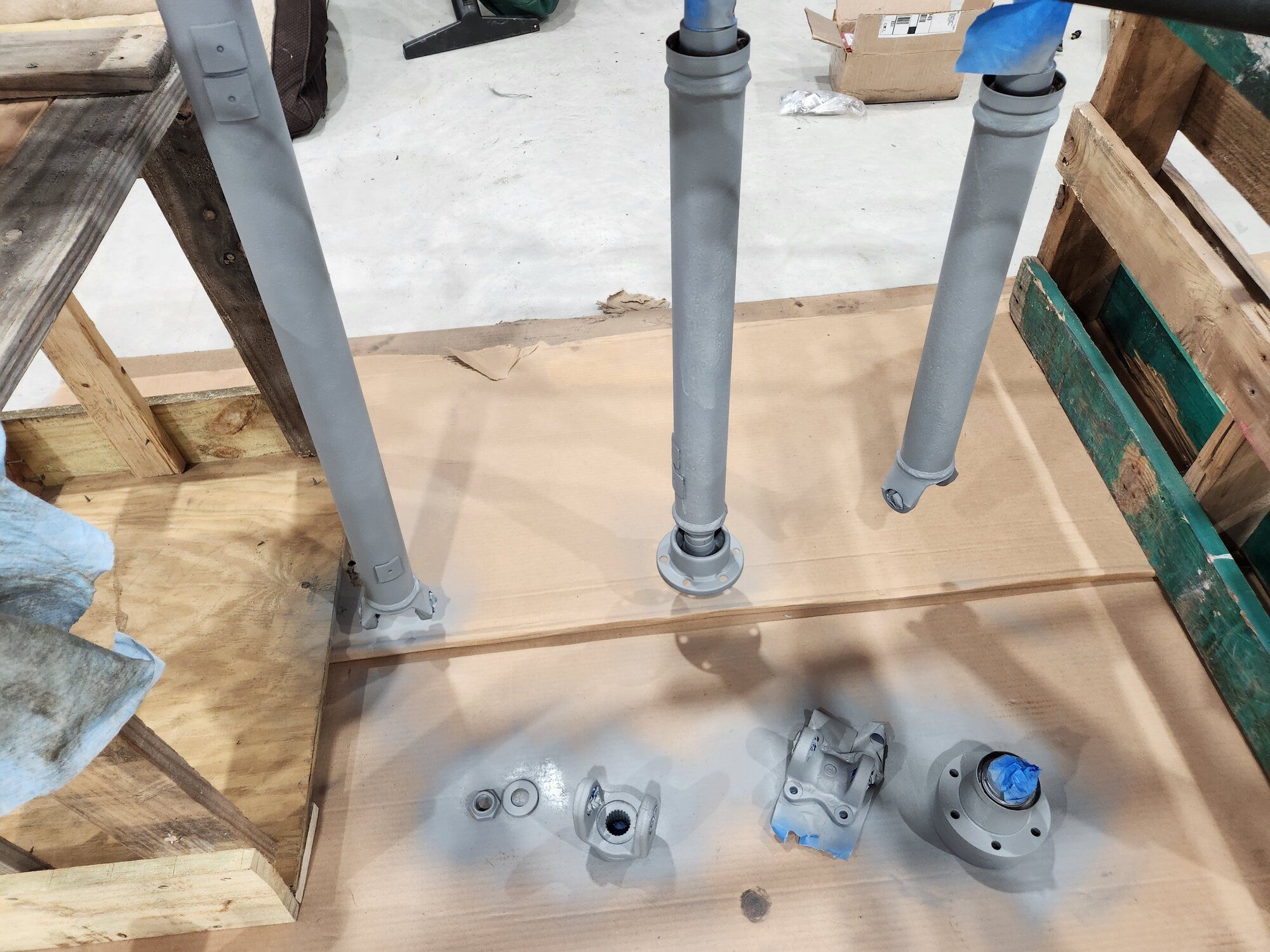

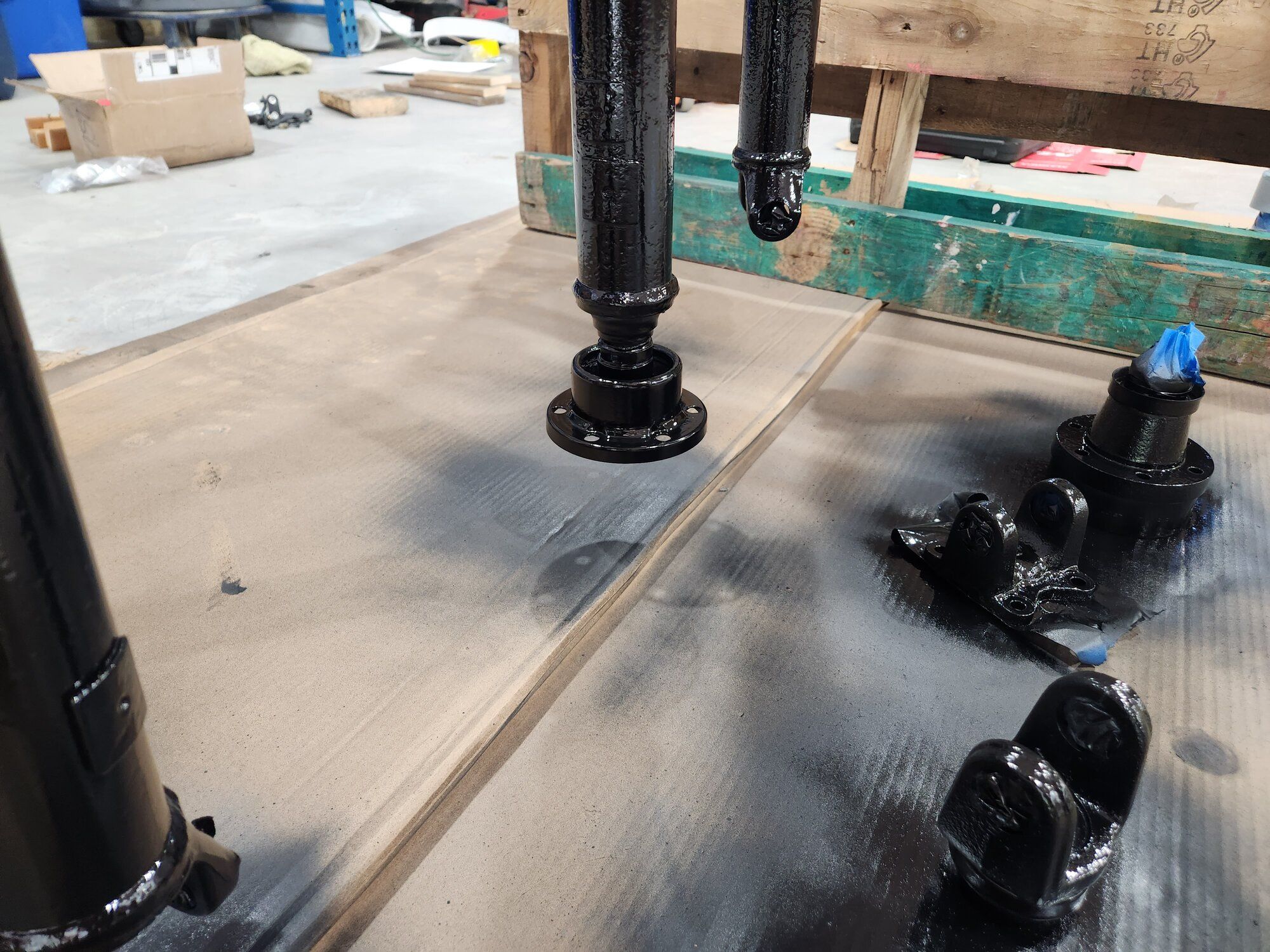

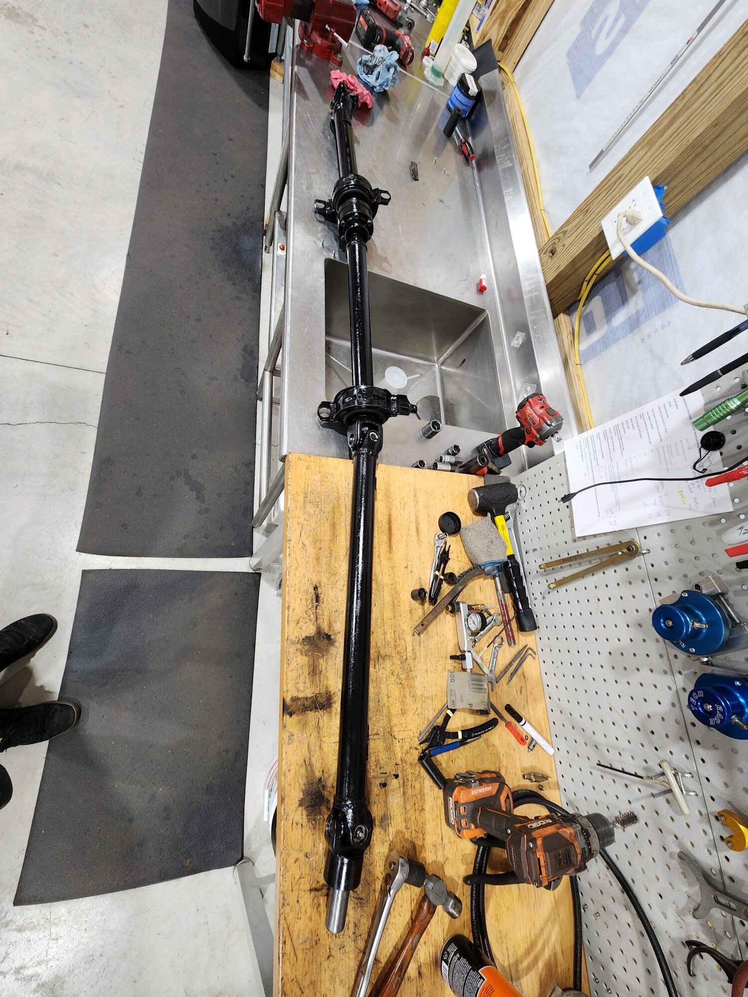

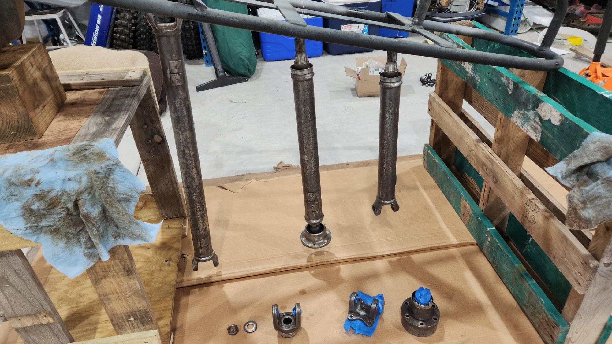

Since I'm waiting to eventually upgrade to the aluminum DSS unit I didn't go all out and have this powdercoated, it still turned out better than the submarine shaft that it once was 🤣

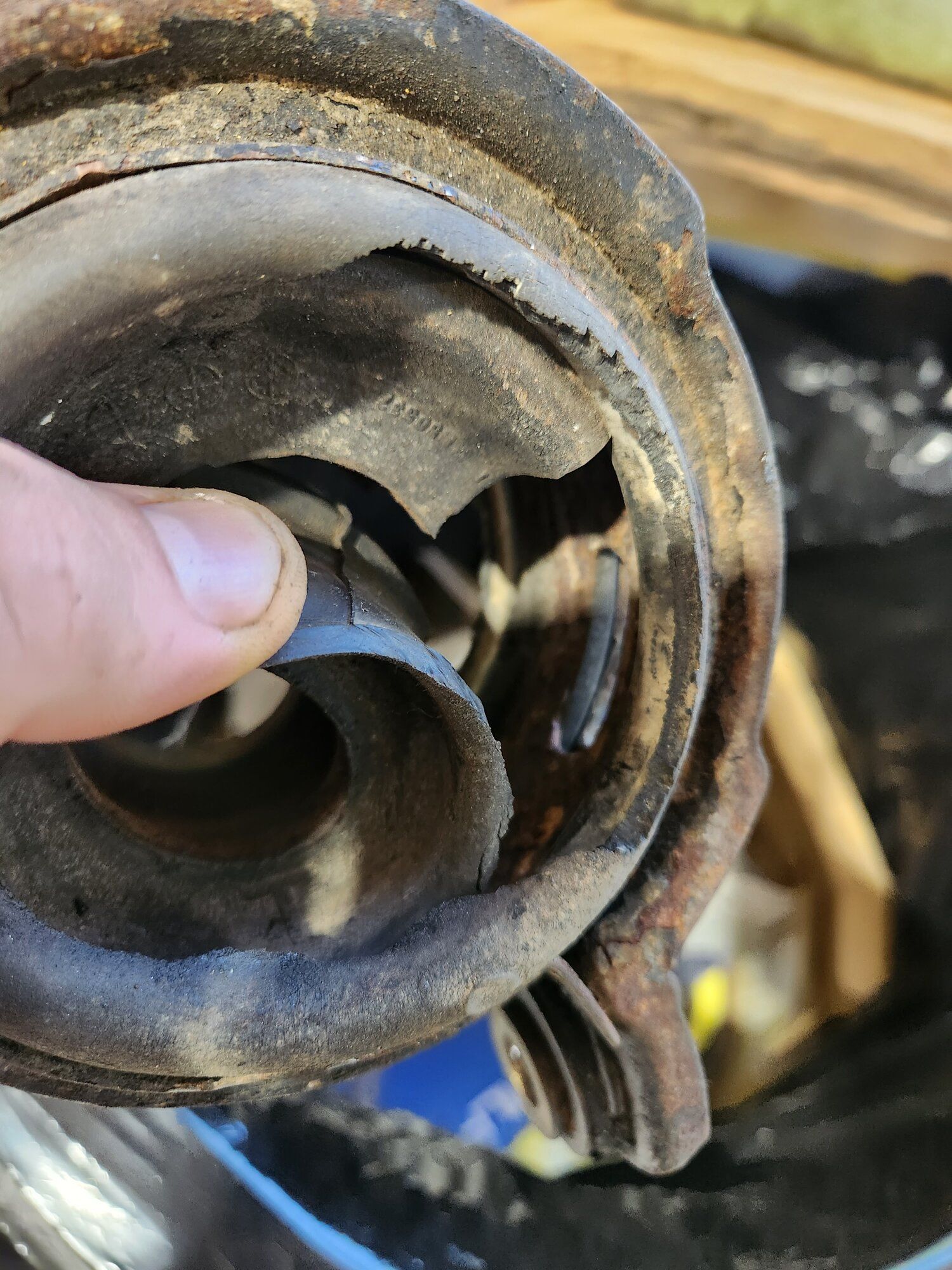

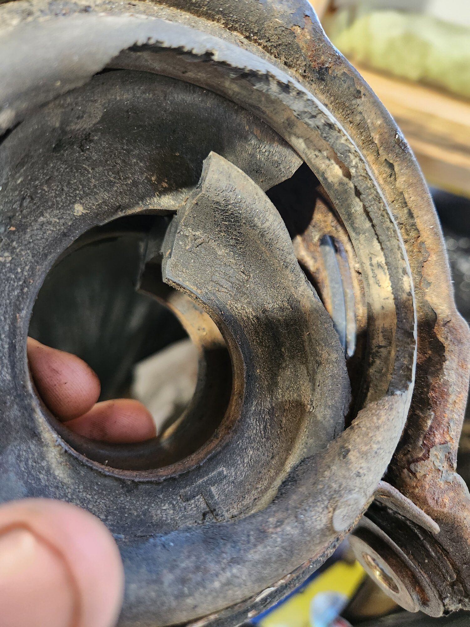

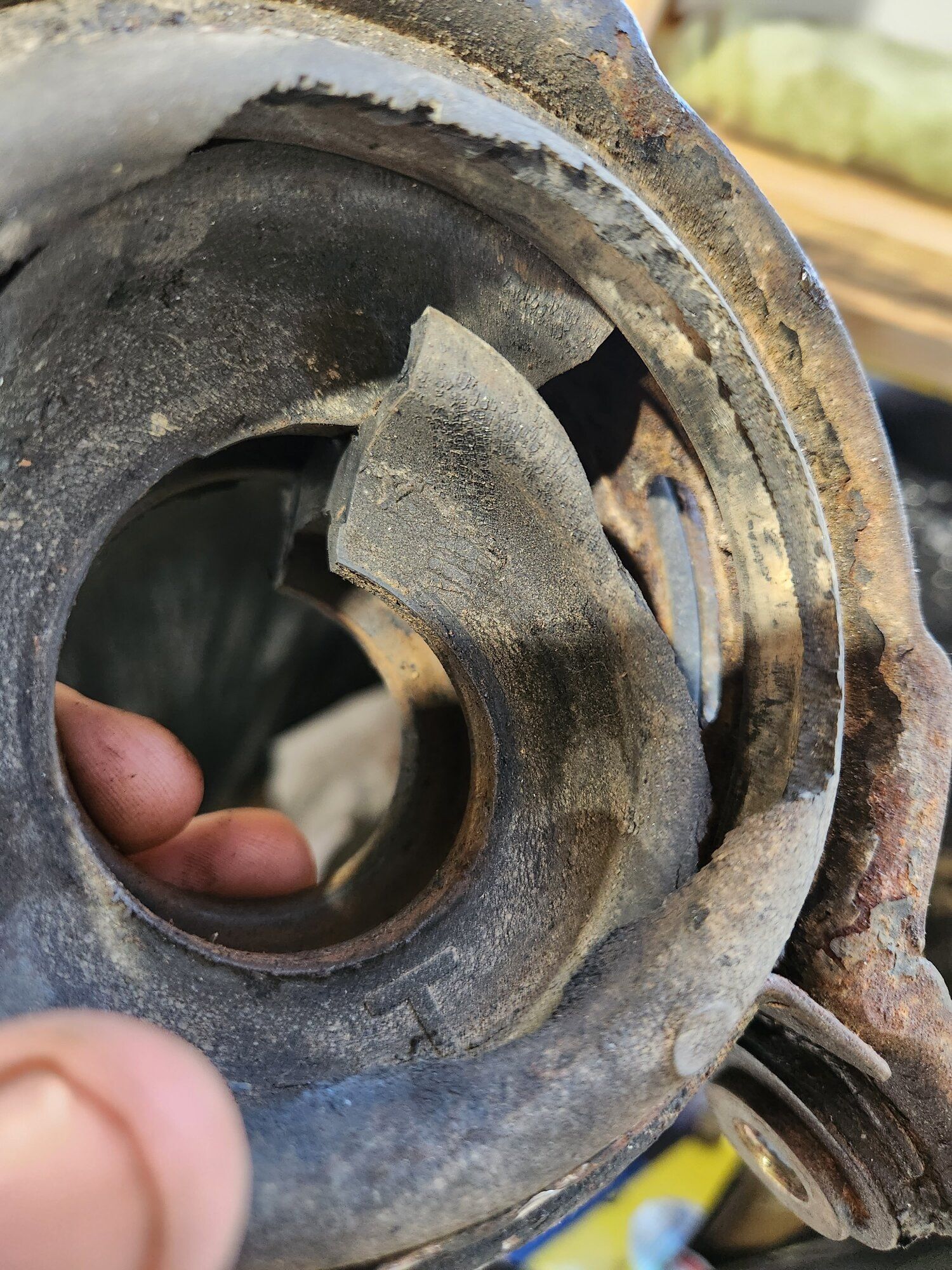

Fresh HD U-joints from Japan GMB brand ($10/piece from rock auto) new OE carrier bearings with the air space filled about 70% with eurethane to allow for for some movement. Yes, I know, It may be awful and should have used silicone, we'll see. It has every single polyurethane mount available so she's going to be buzzy no matter what. Lol

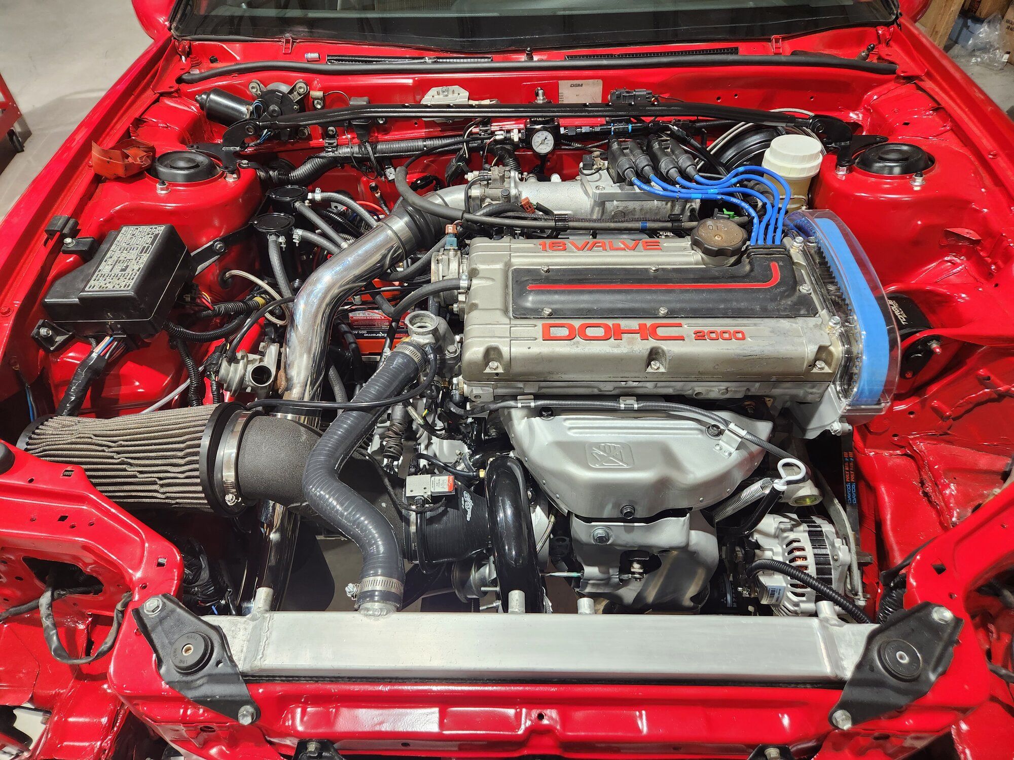

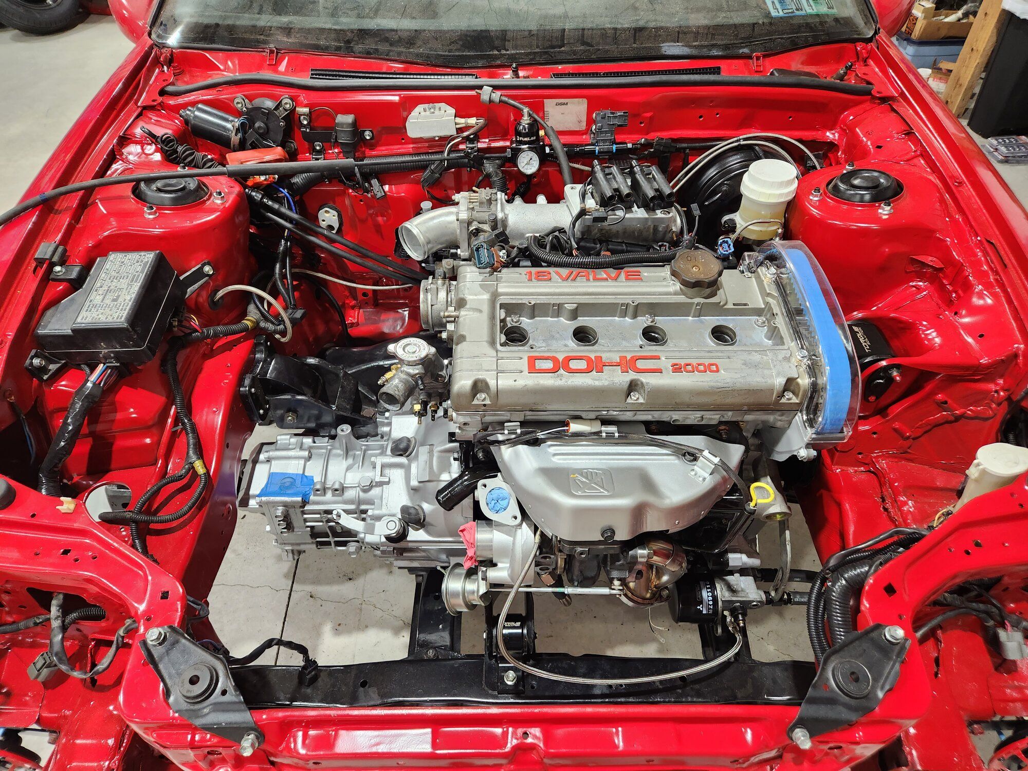

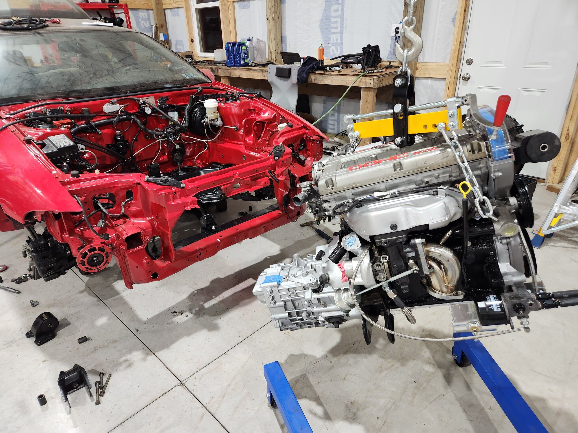

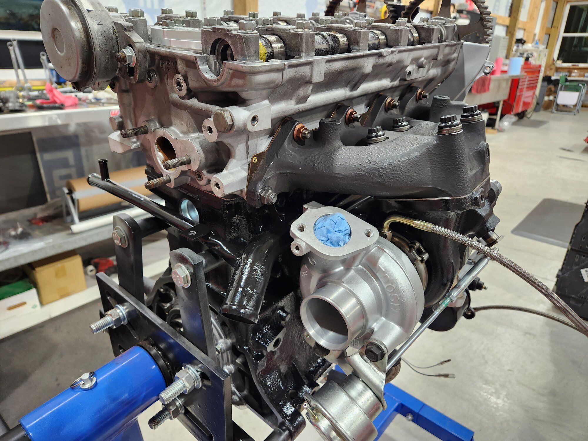

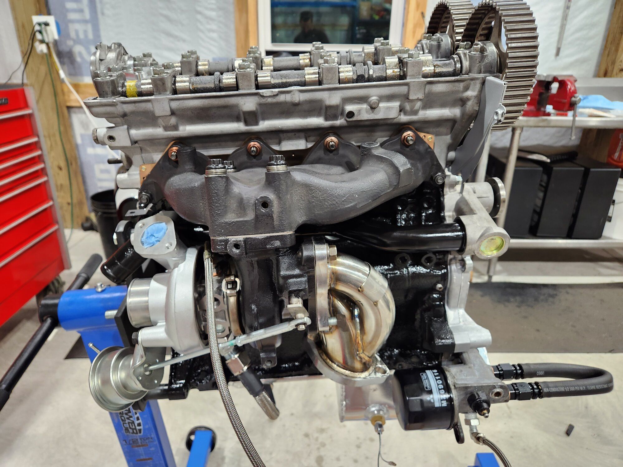

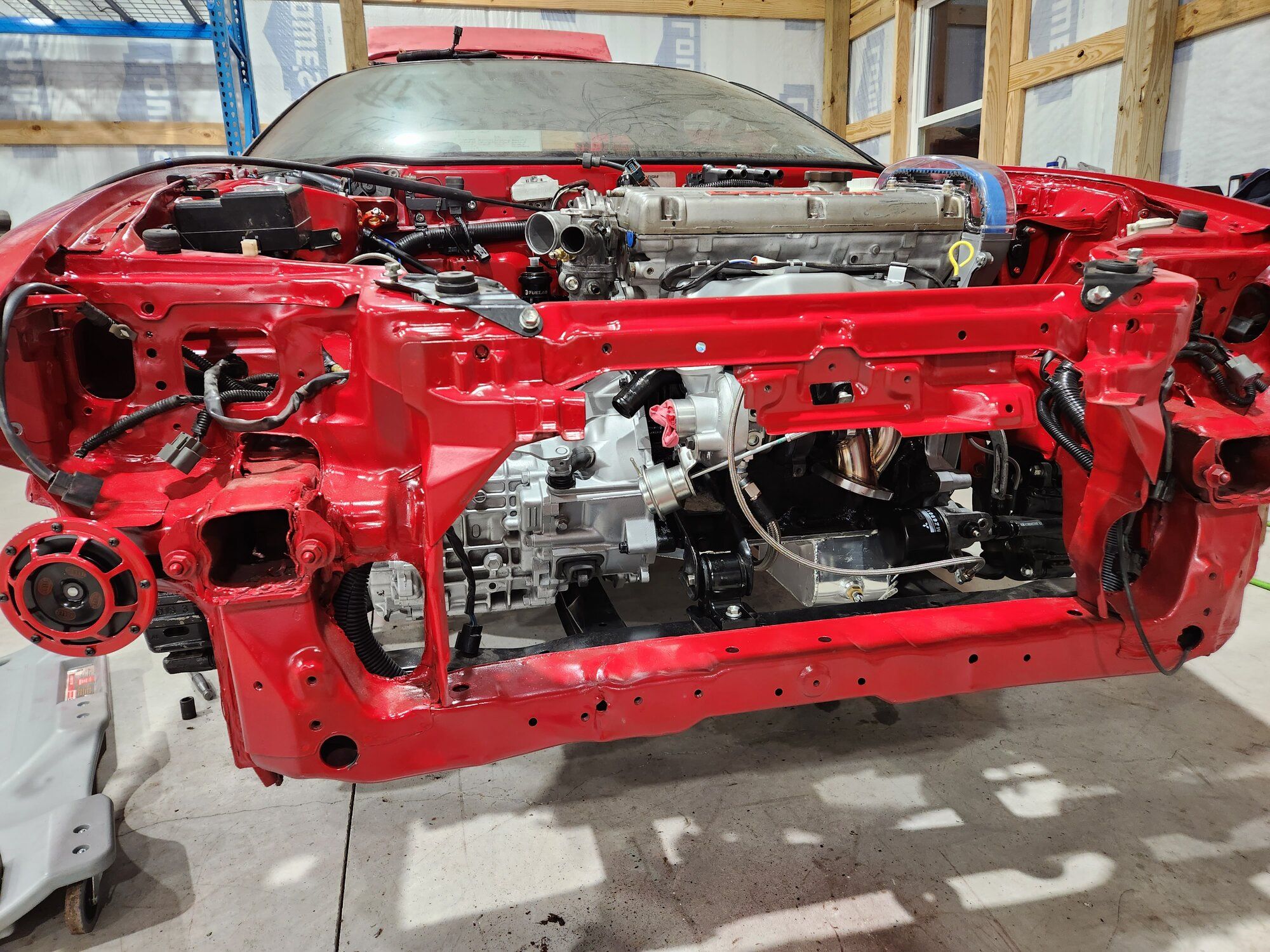

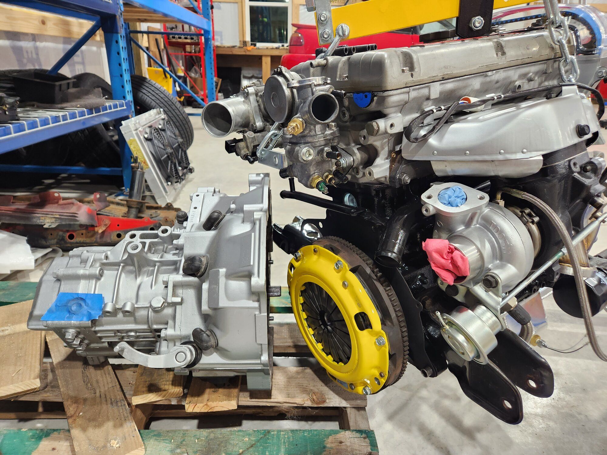

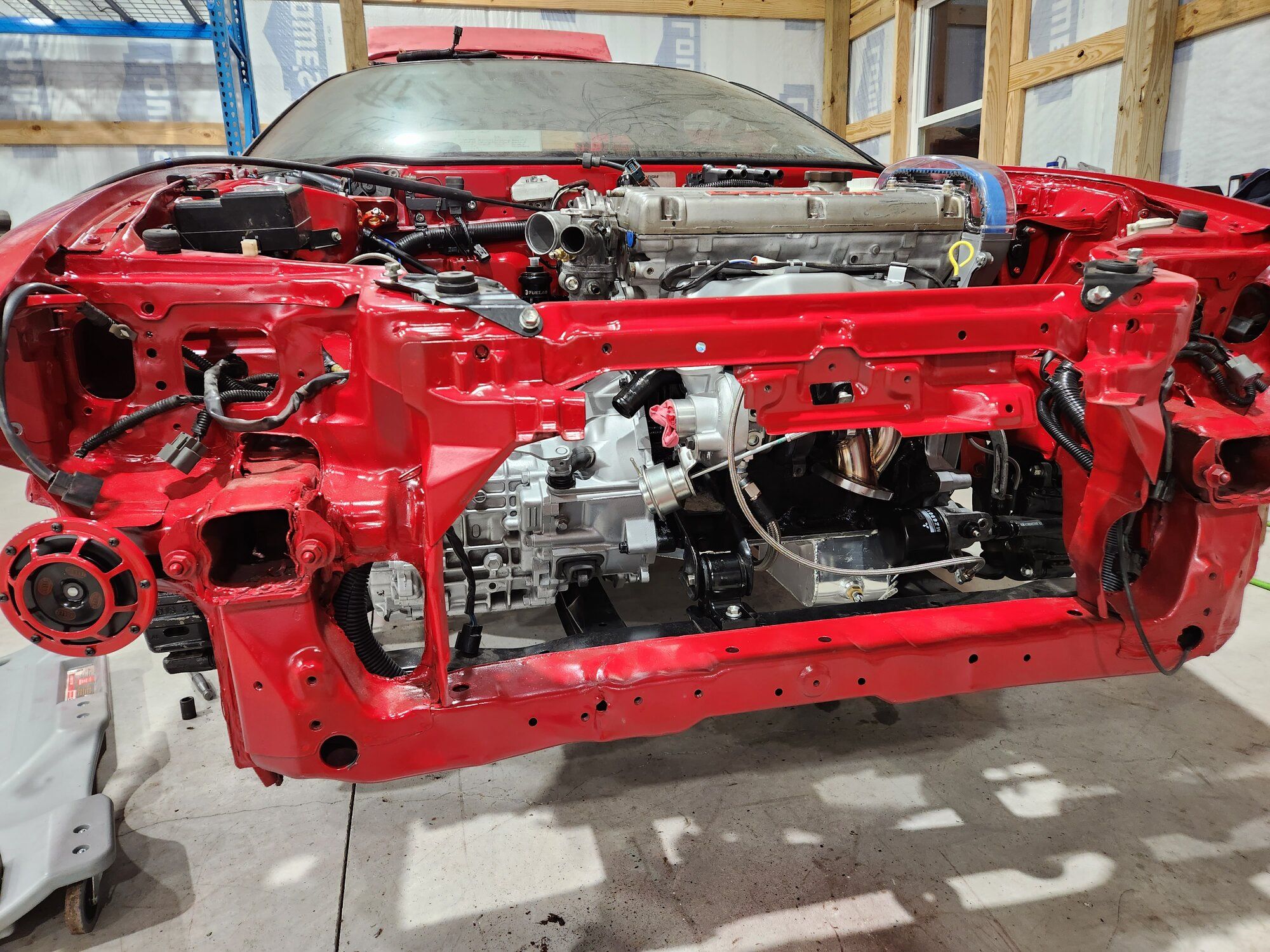

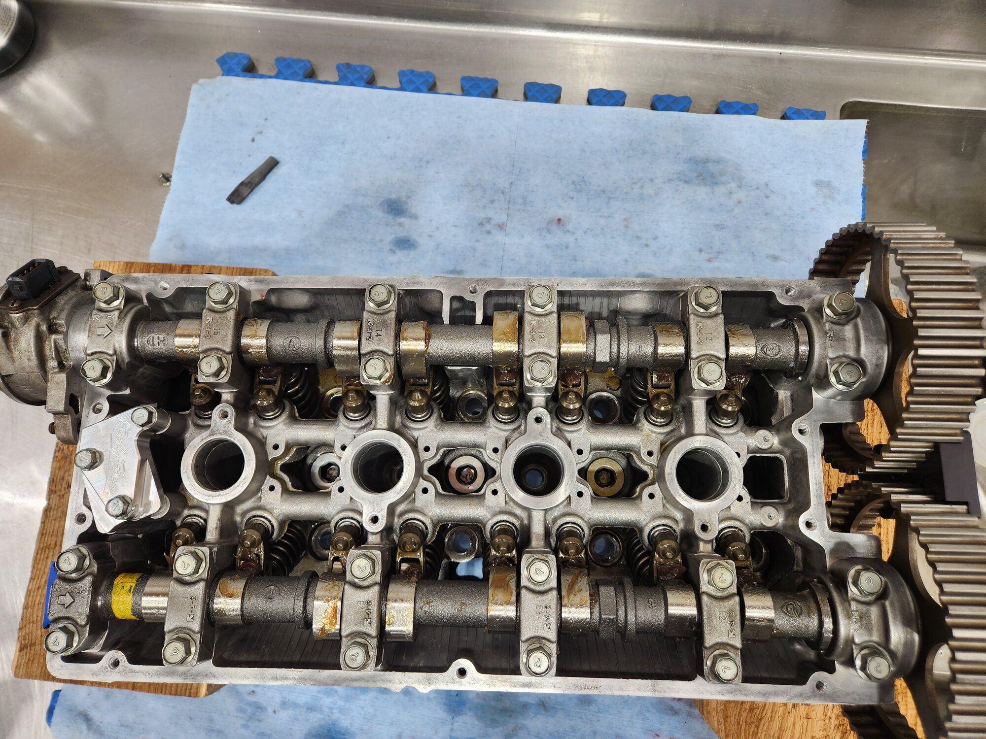

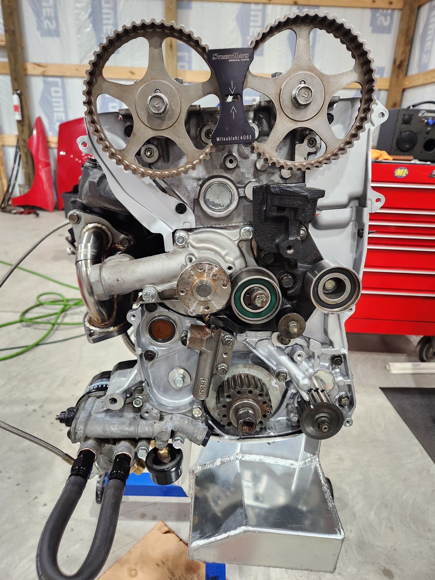

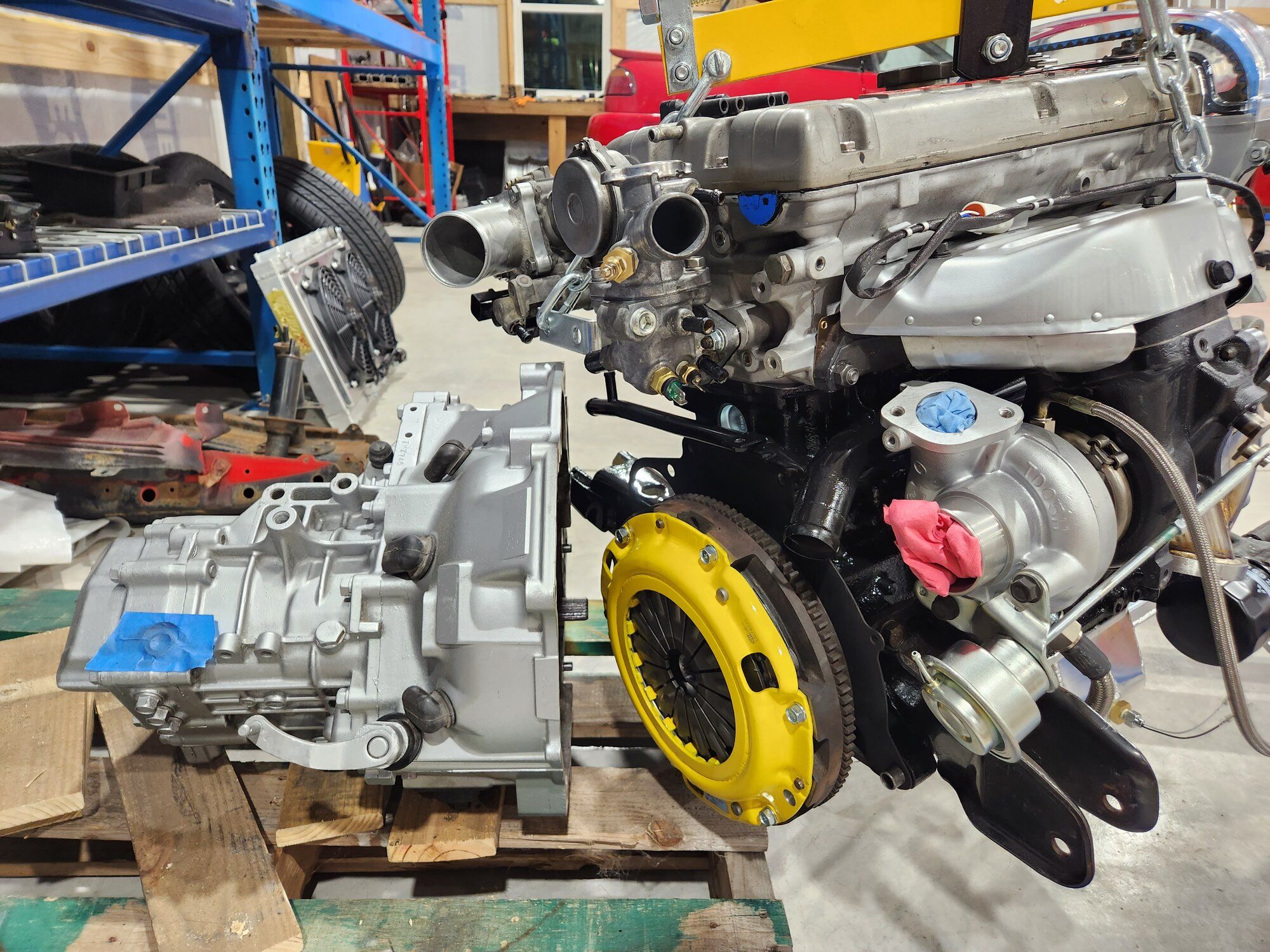

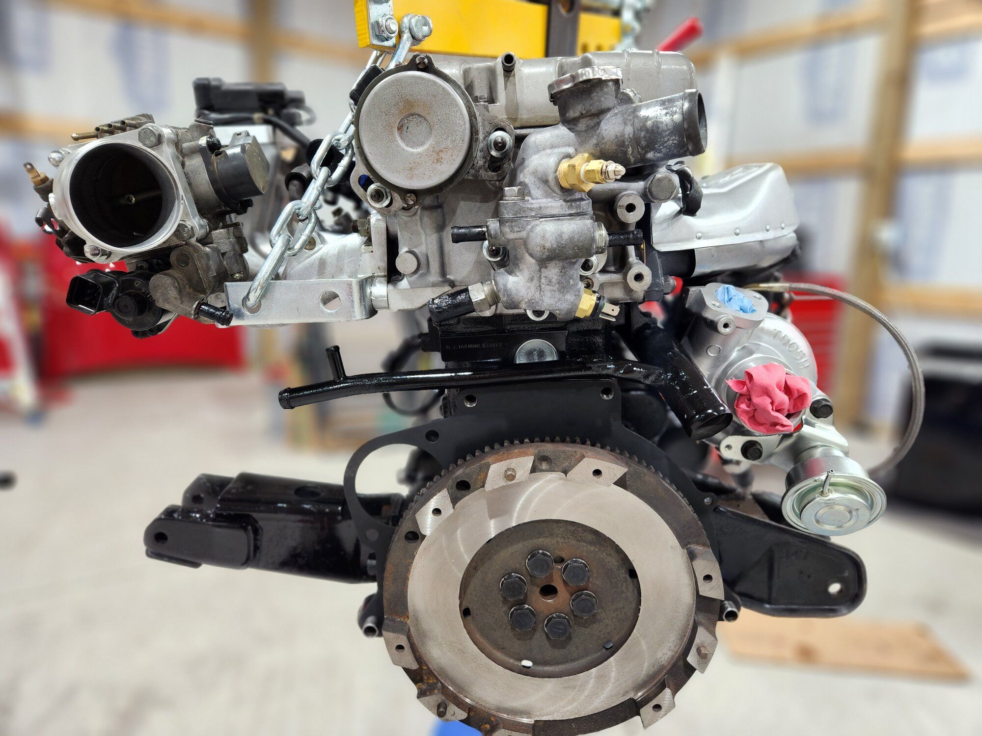

Sucks to see RTM getting out of the game...I've been ordering parts off the other site supporting vendors.
View attachment 706004View attachment 706005View attachment 706006View attachment 706007View attachment 706008View attachment 706009View attachment 706010View attachment 706011

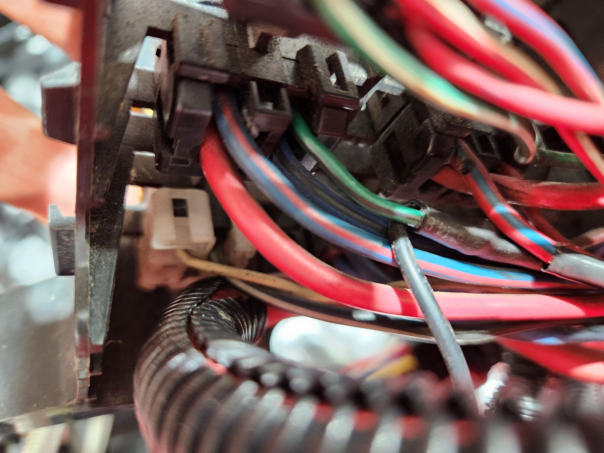

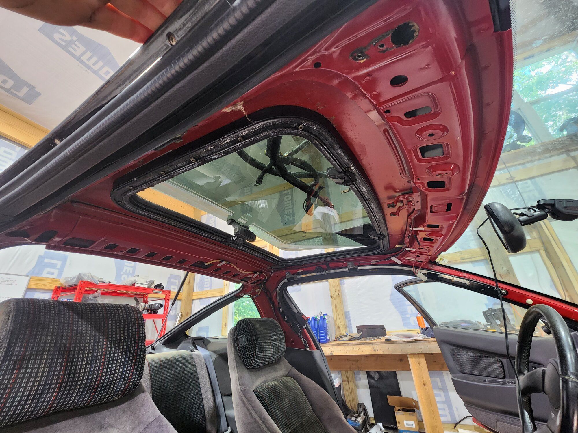

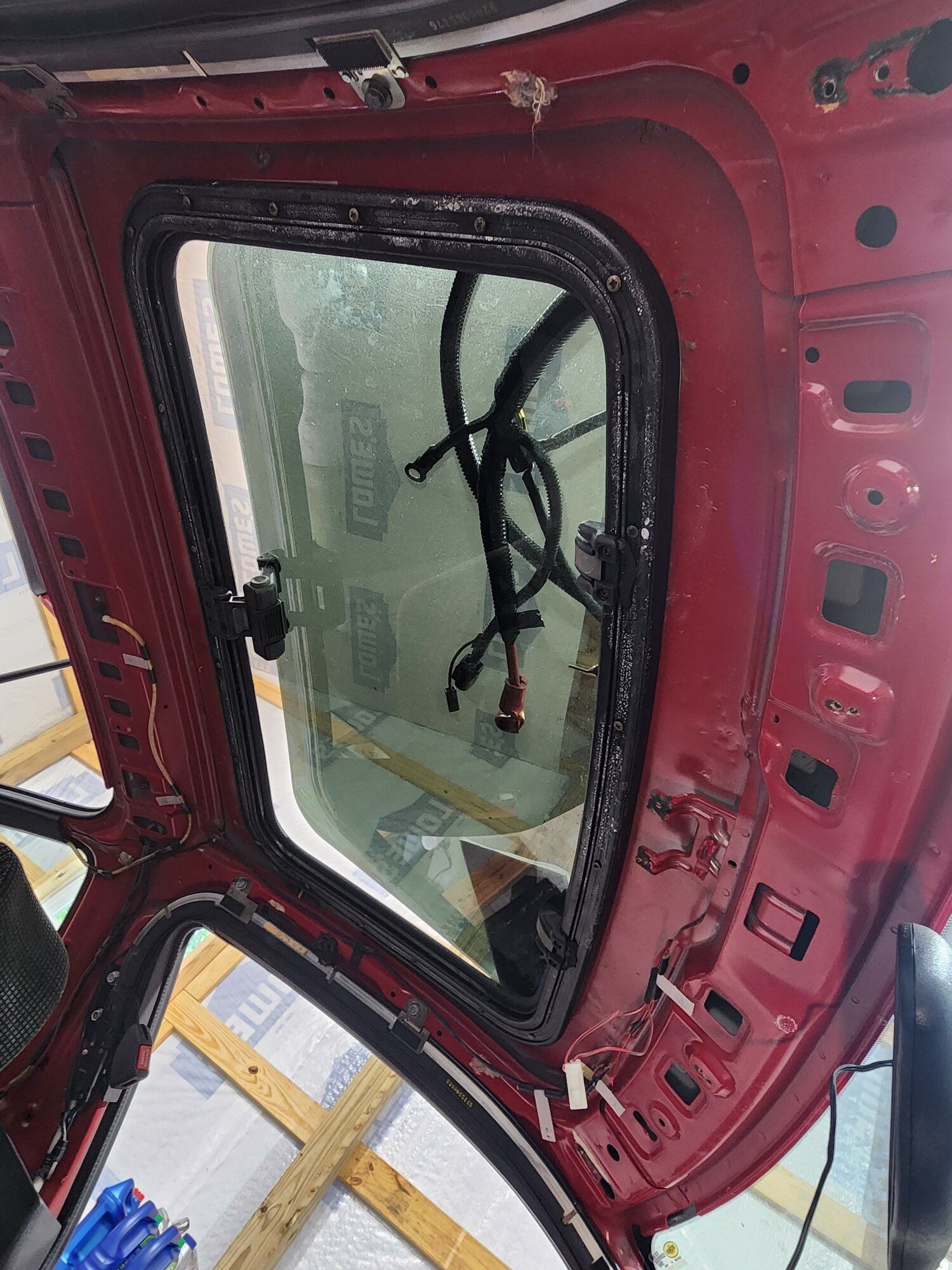

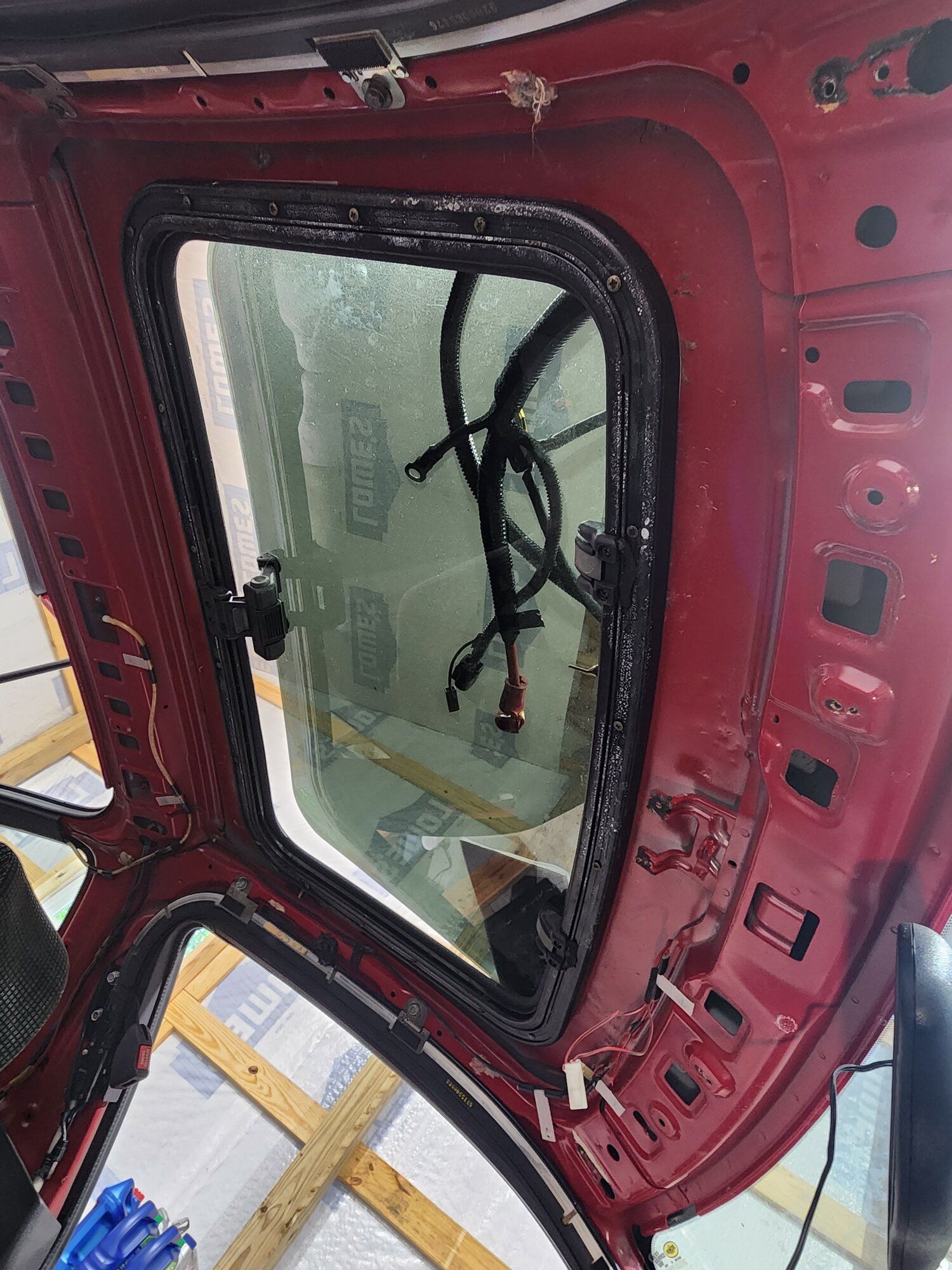

View attachment 706012View attachment 706013

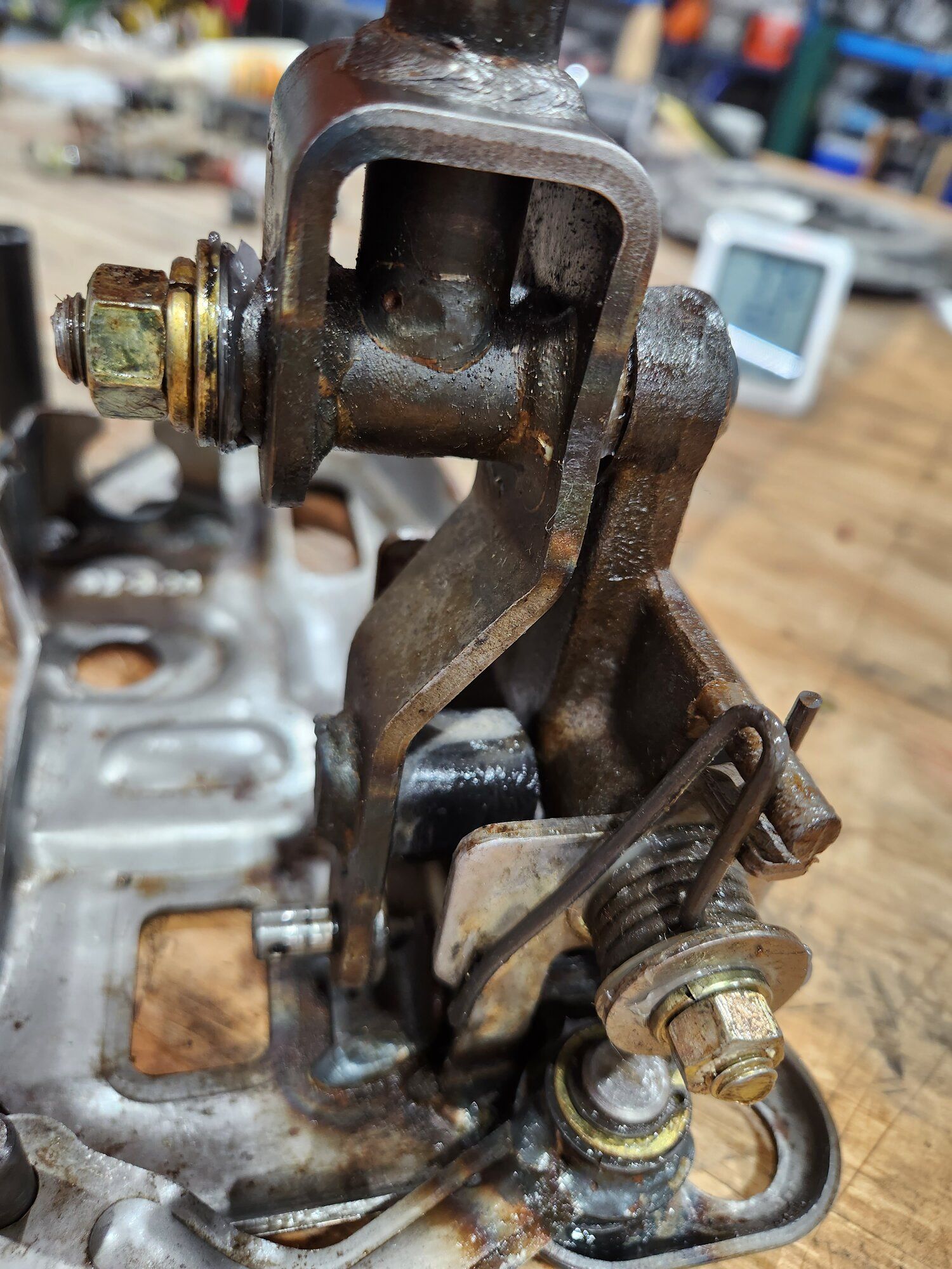

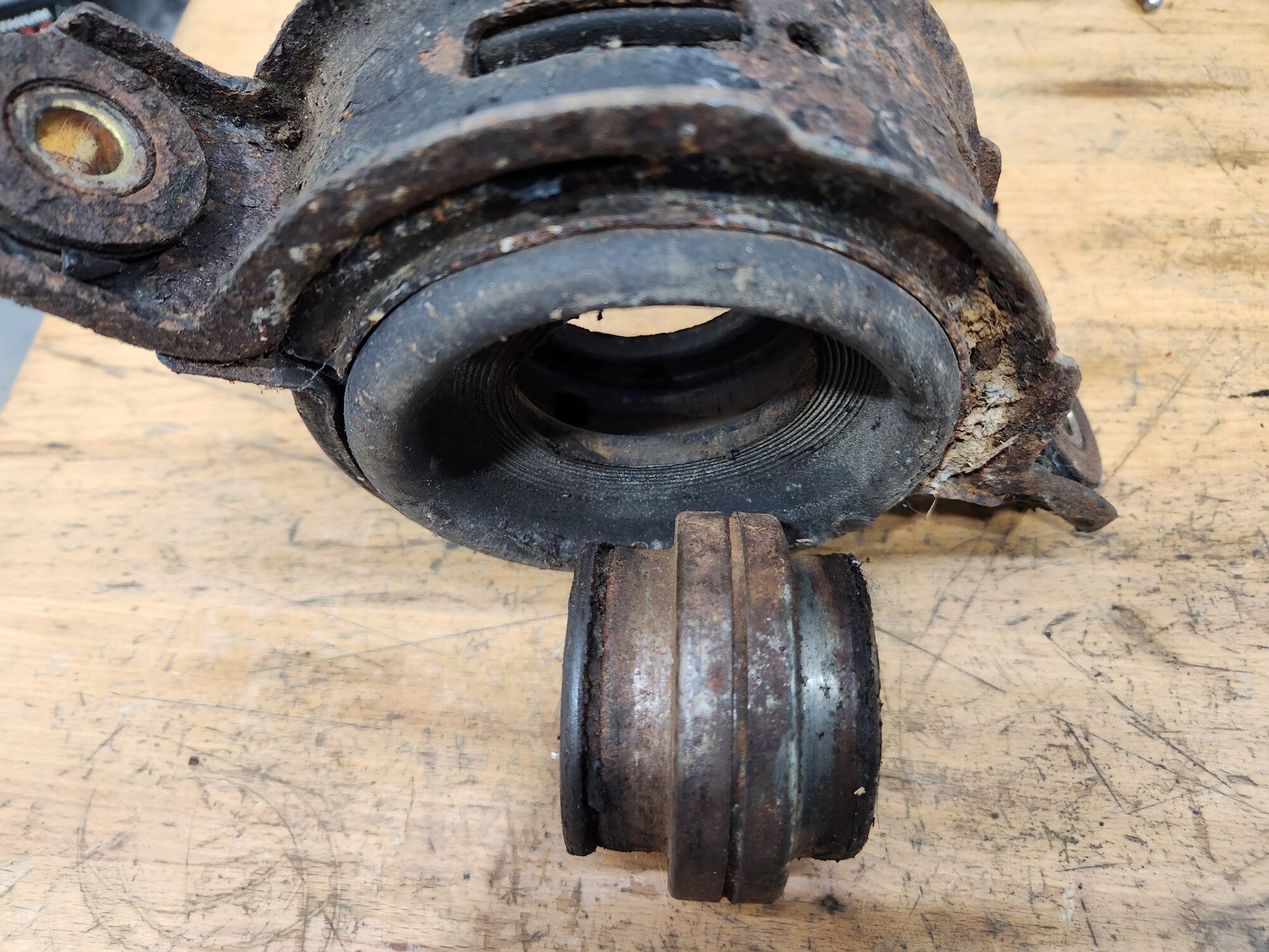

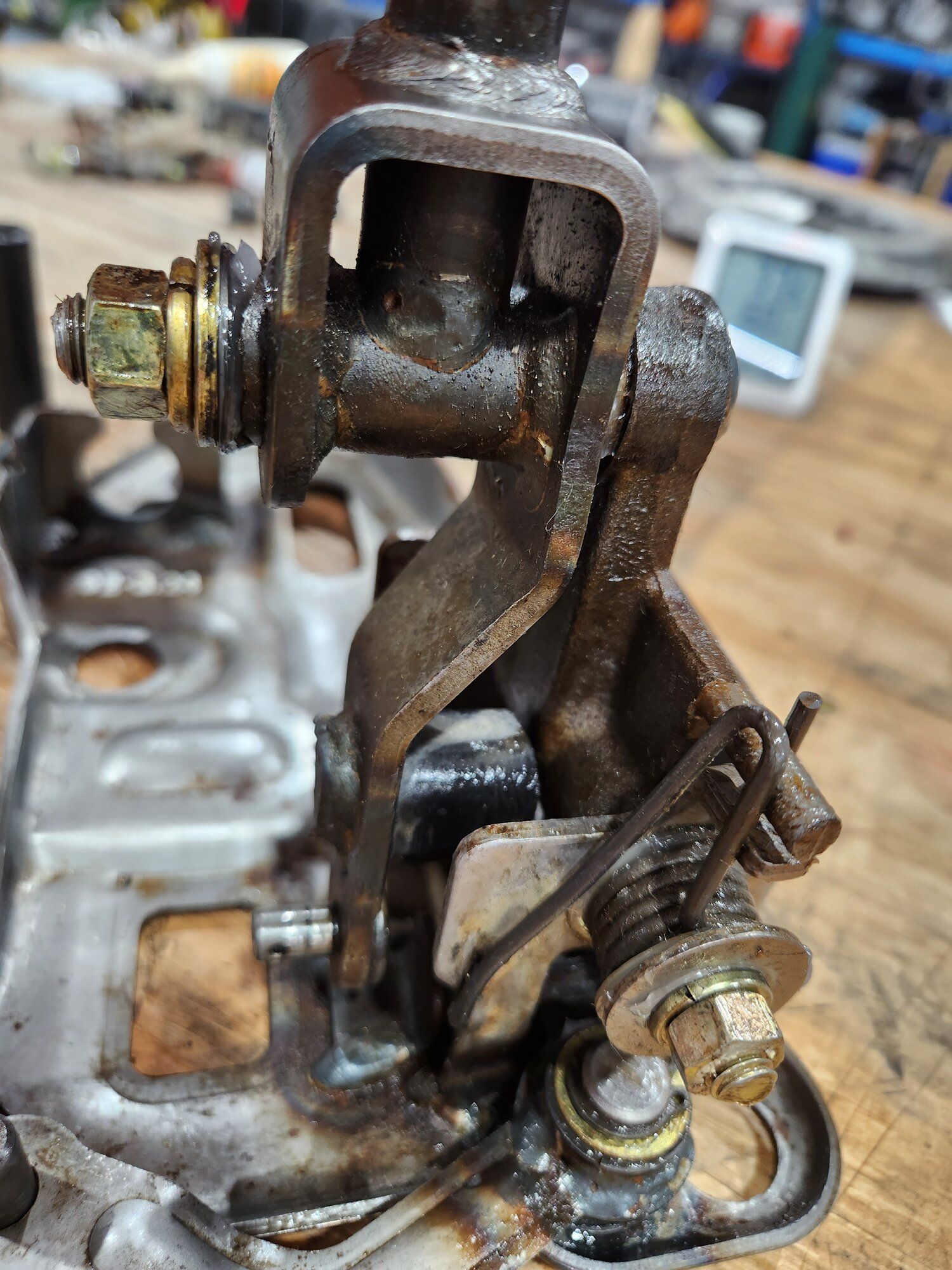

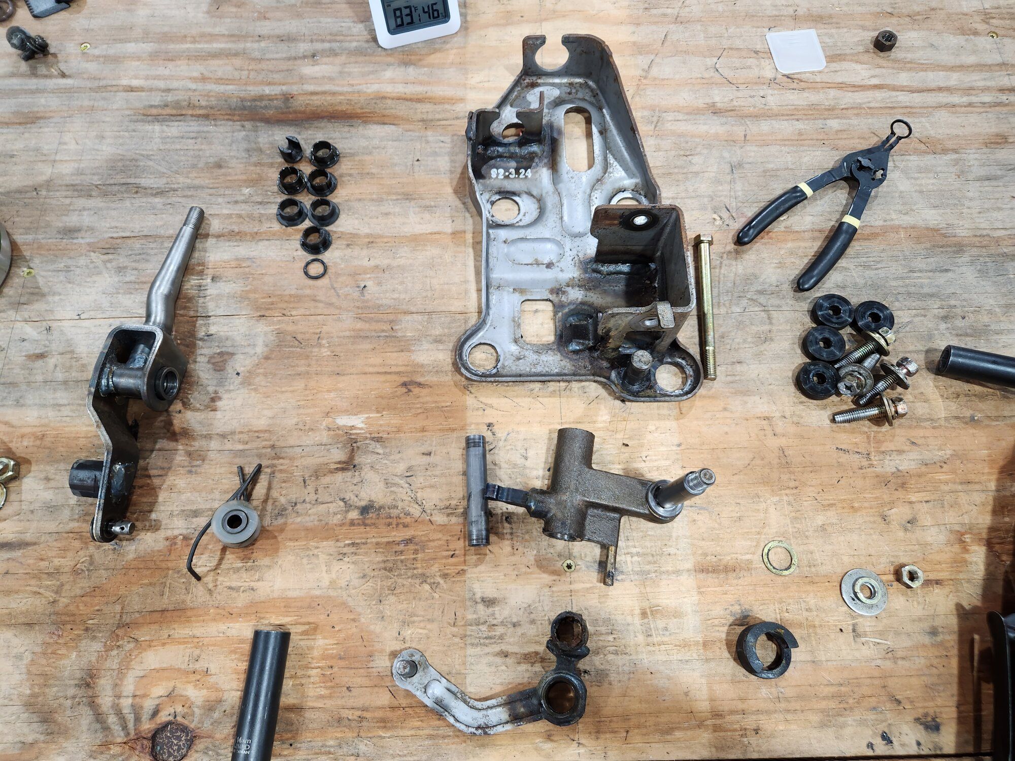

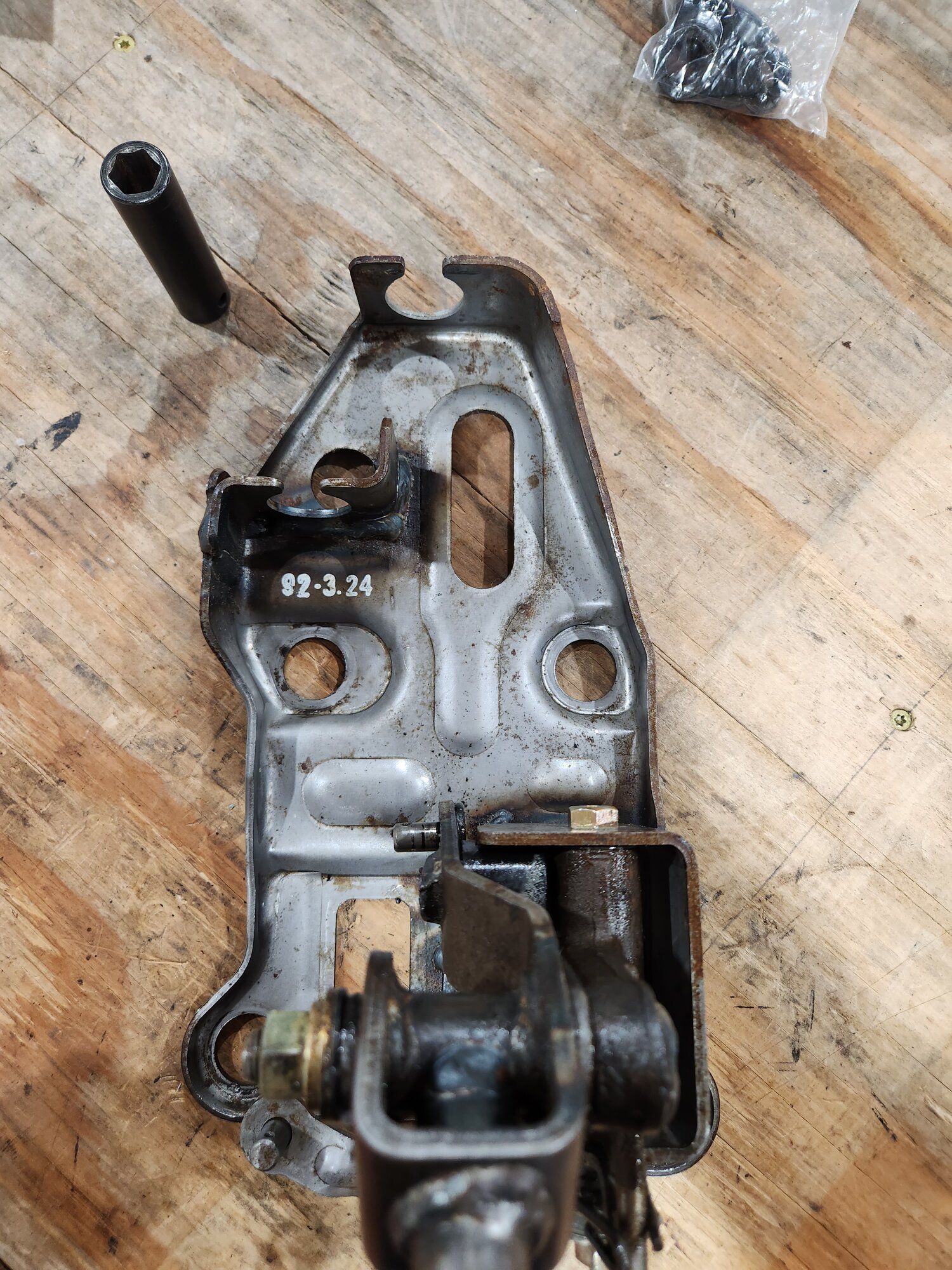

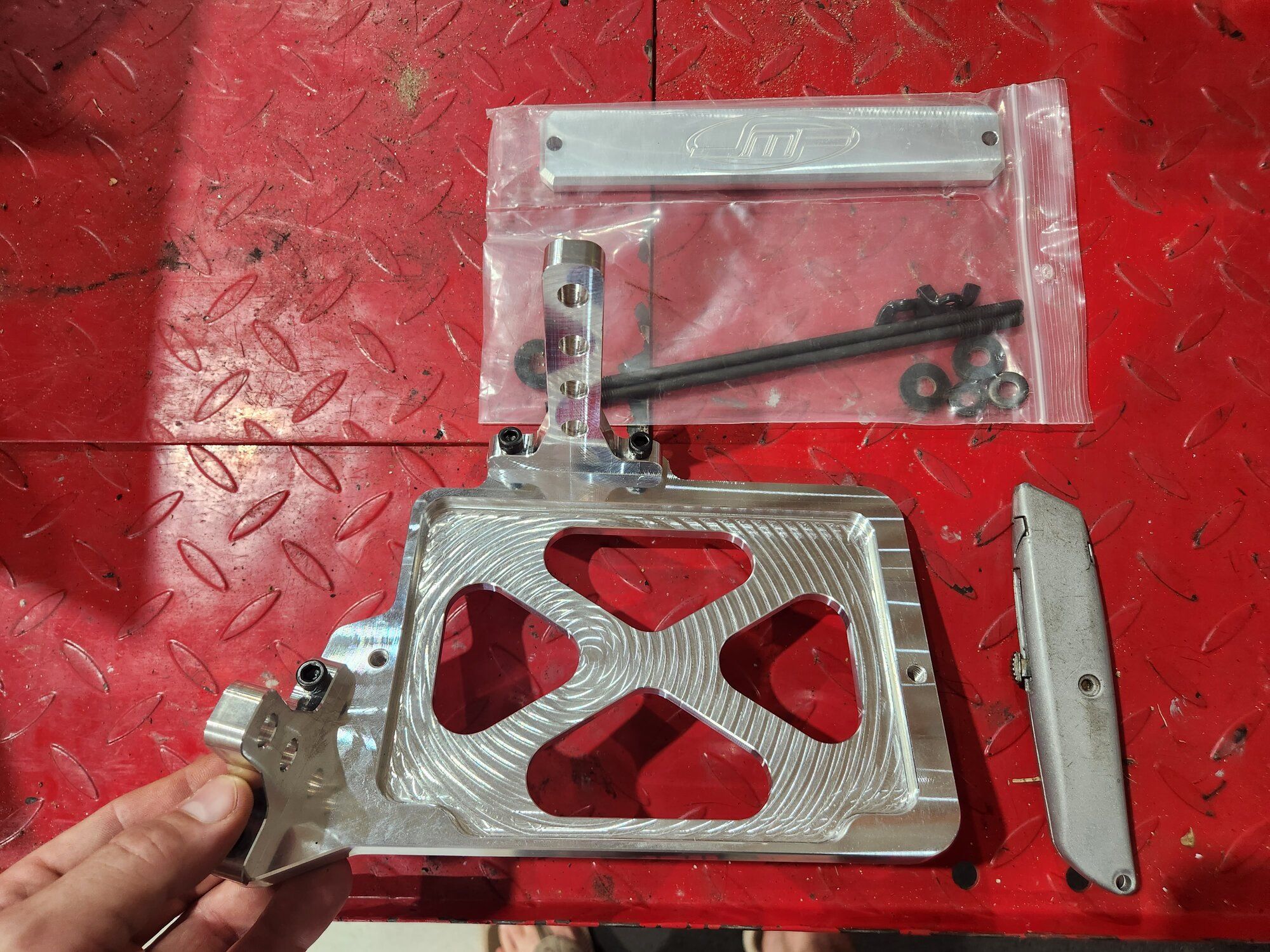

Torque solutions base mounts to round things off.
View attachment 706014View attachment 706015View attachment 706016View attachment 706017

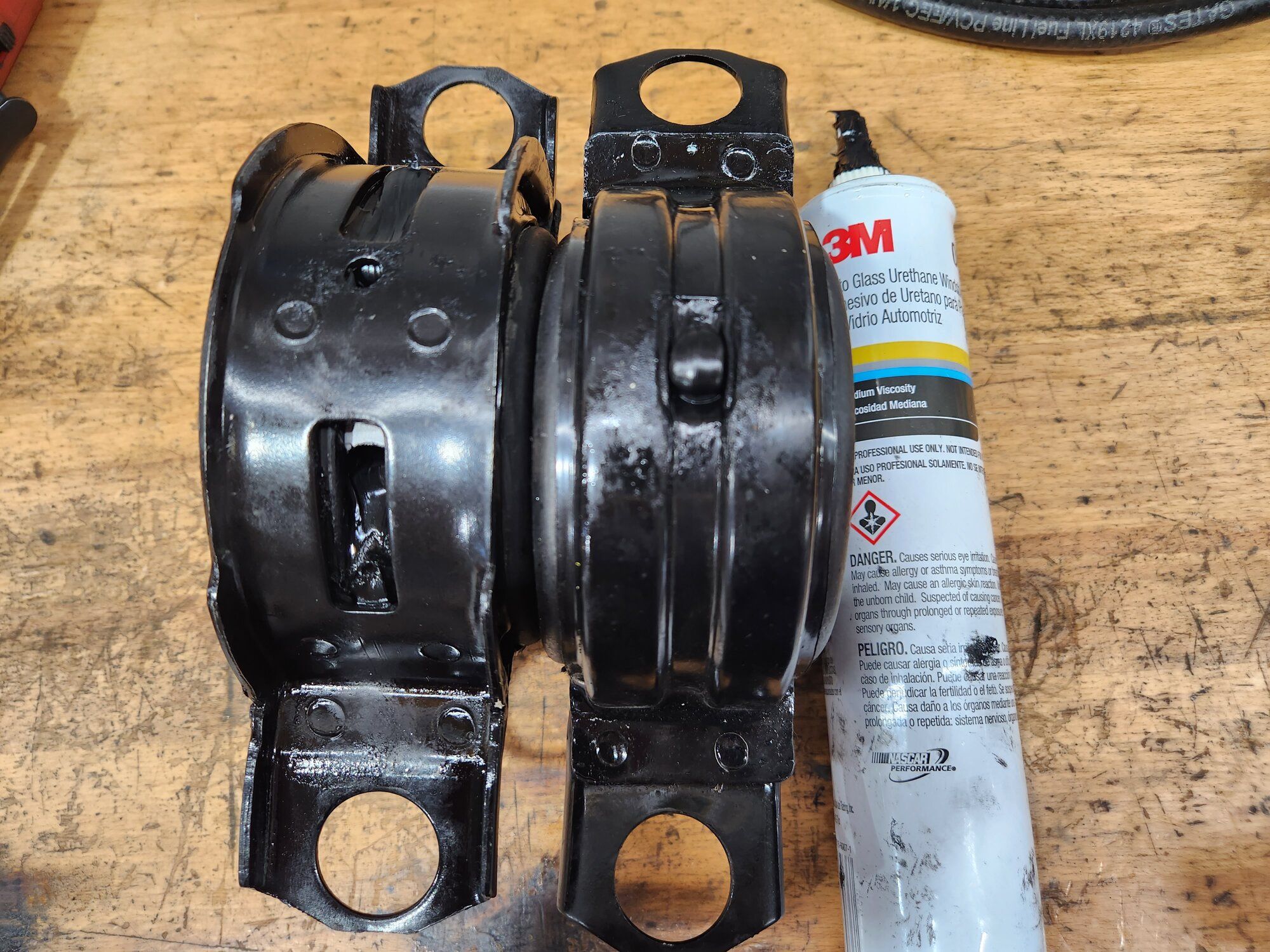

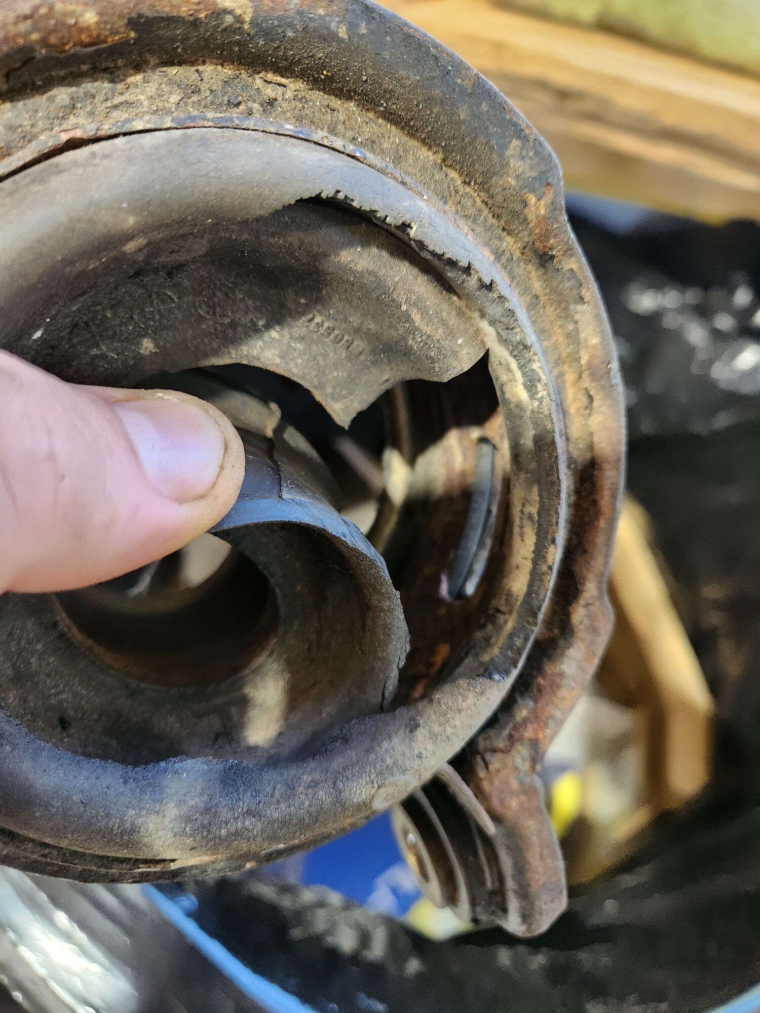

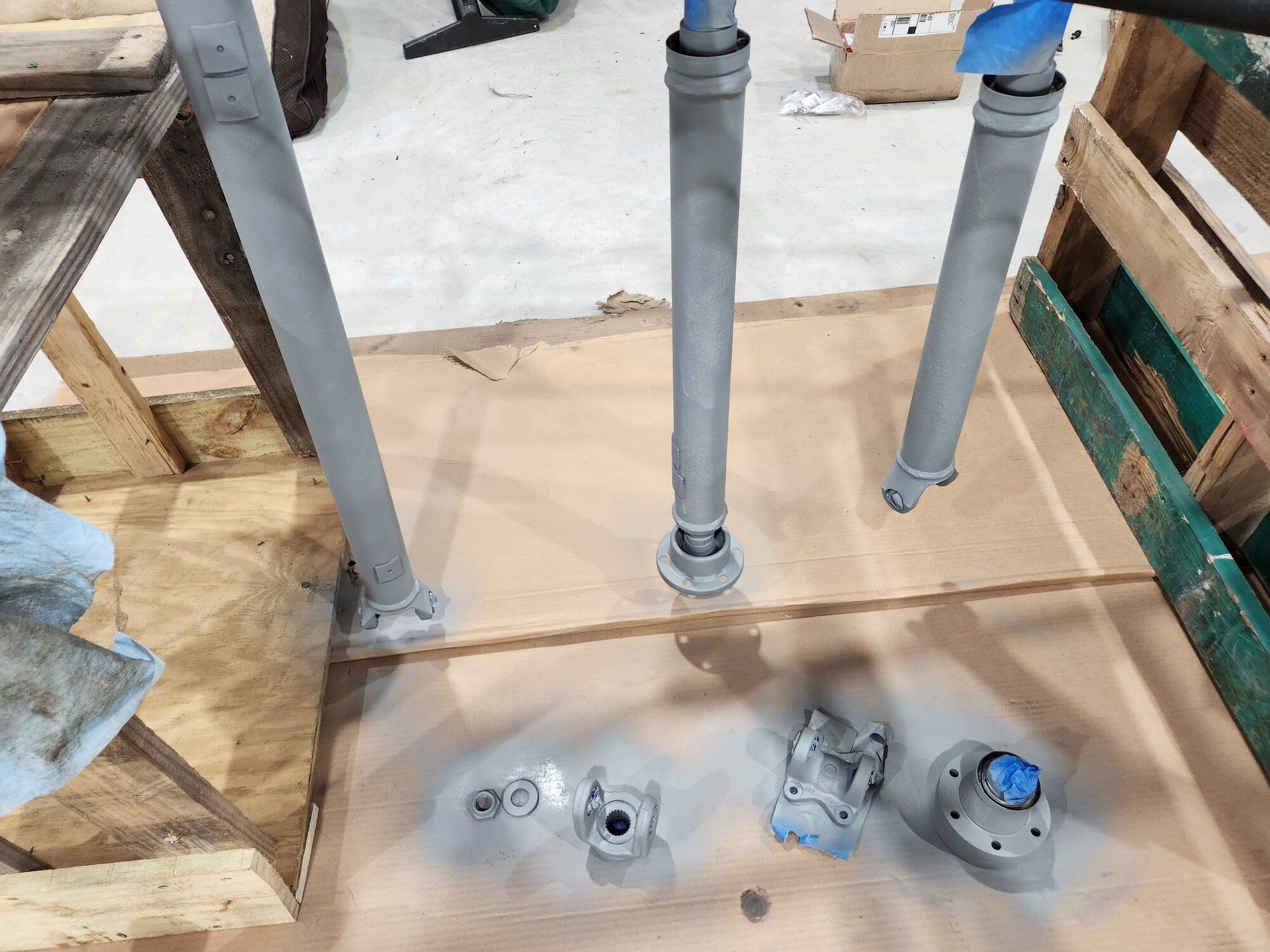

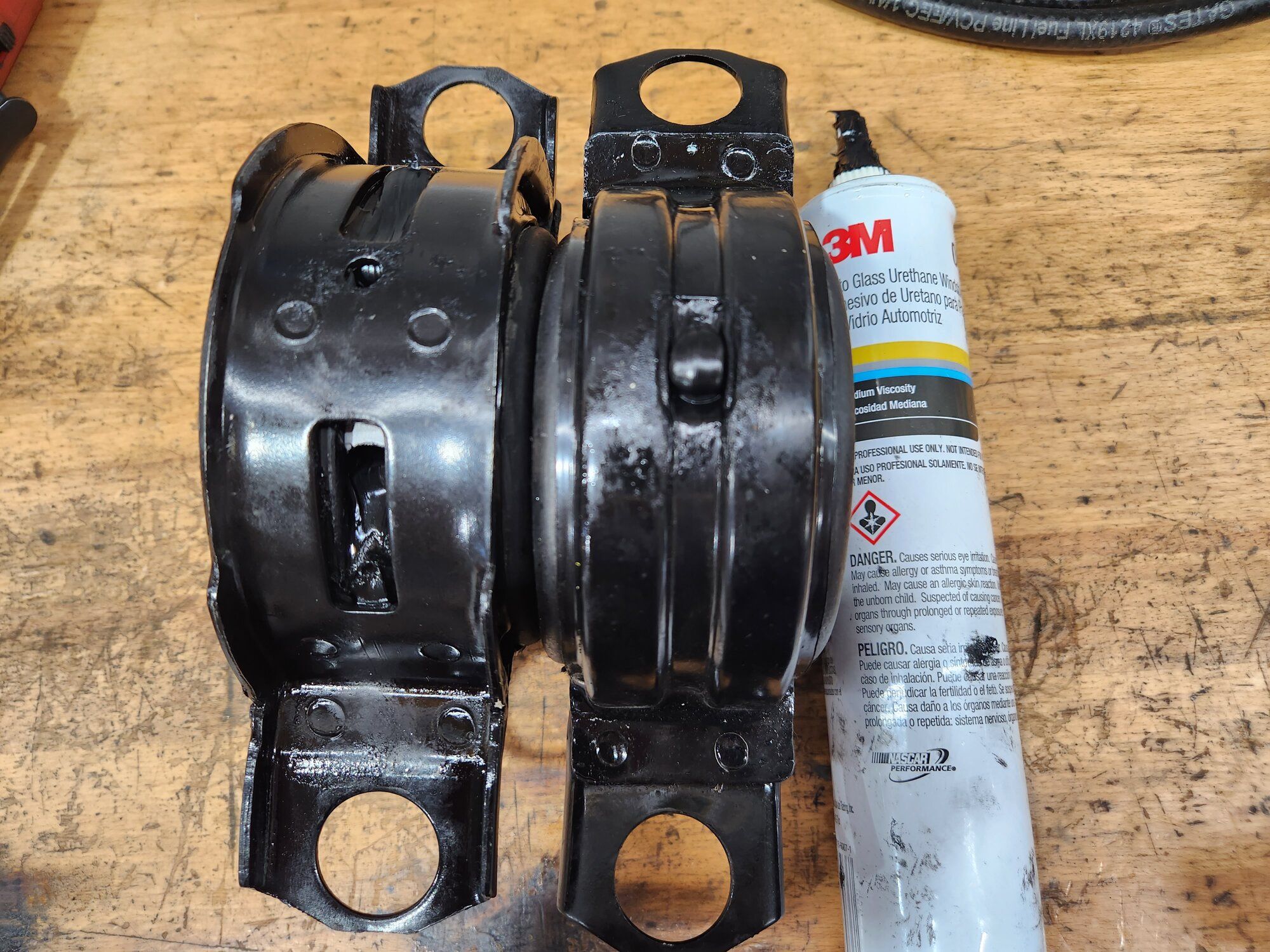

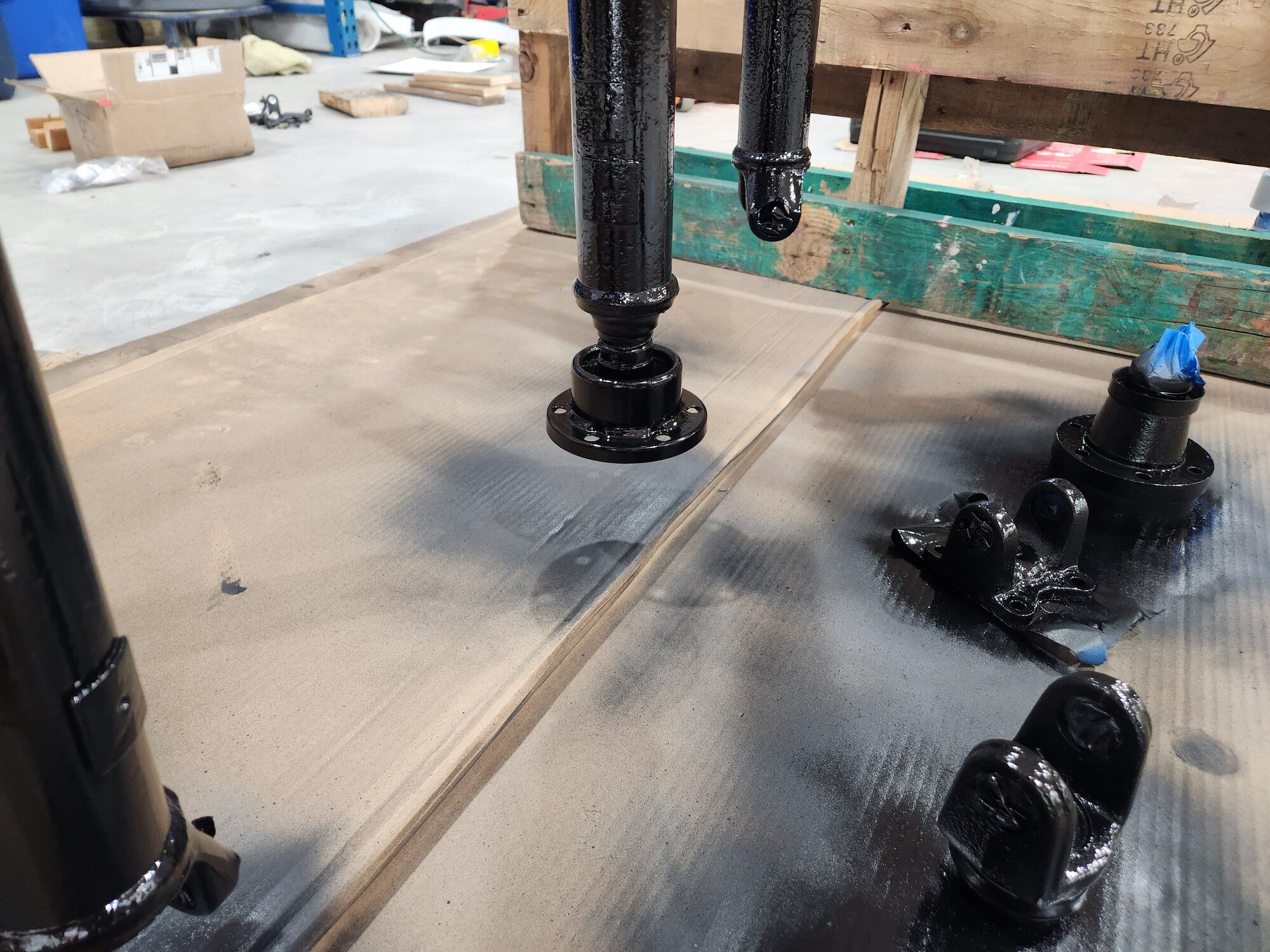

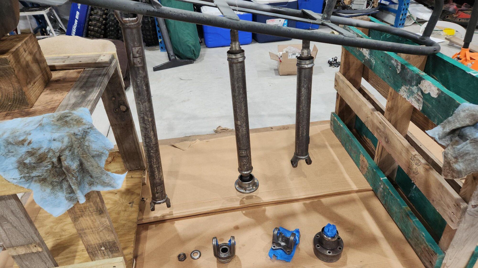

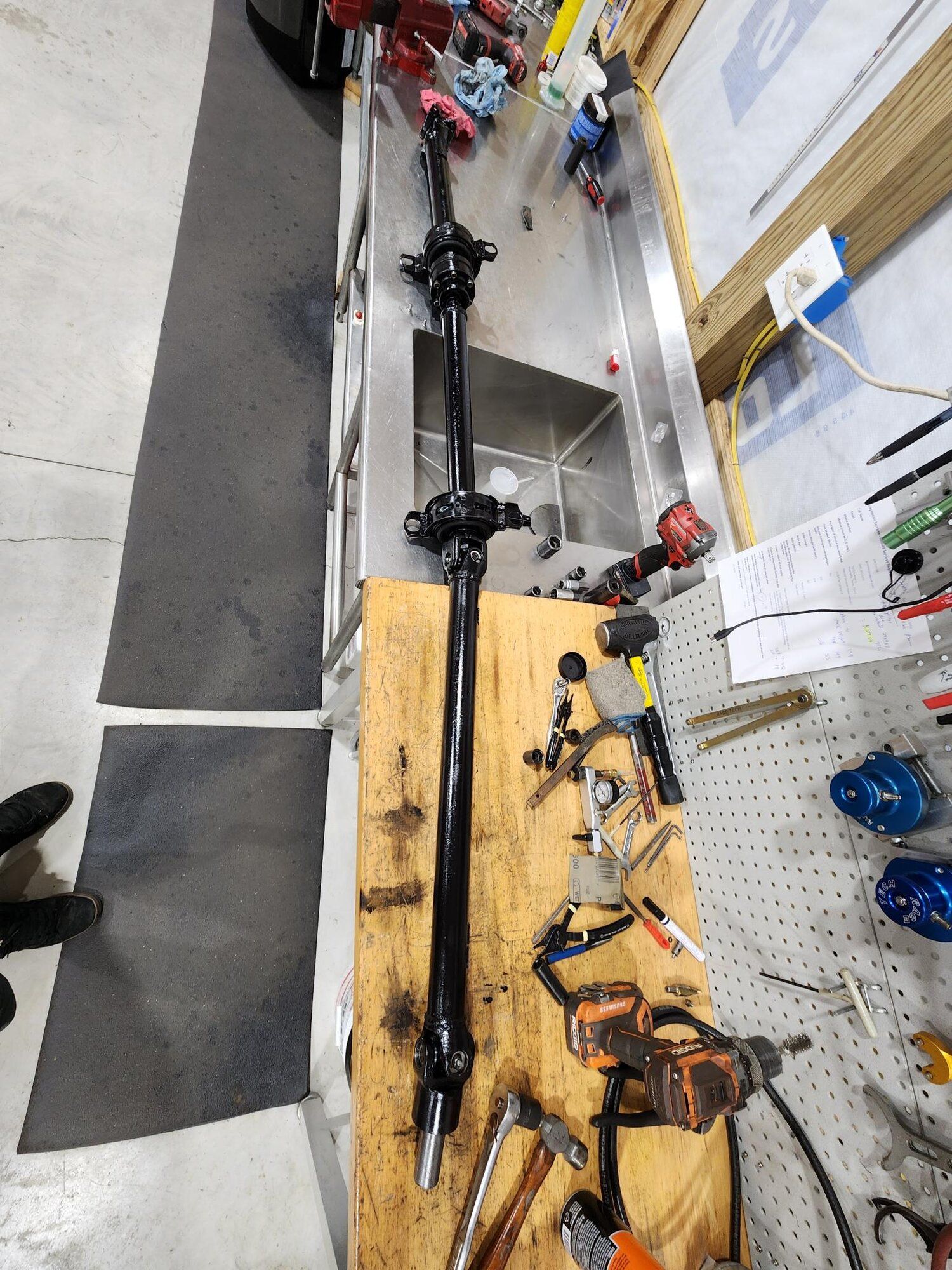

View attachment 706018View attachment 706019View attachment 706020View attachment 706021View attachment 706022View attachment 706024View attachment 706025

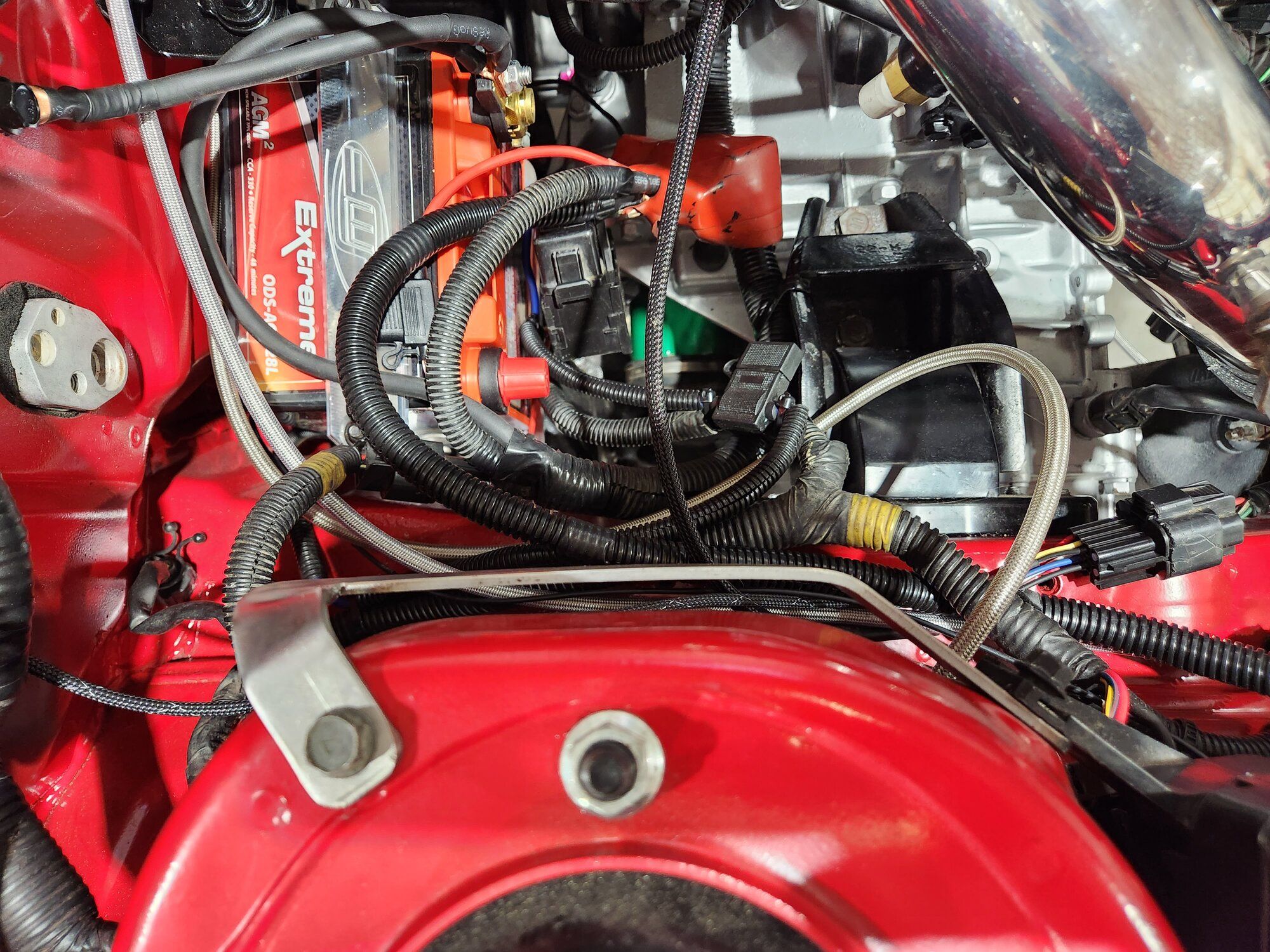

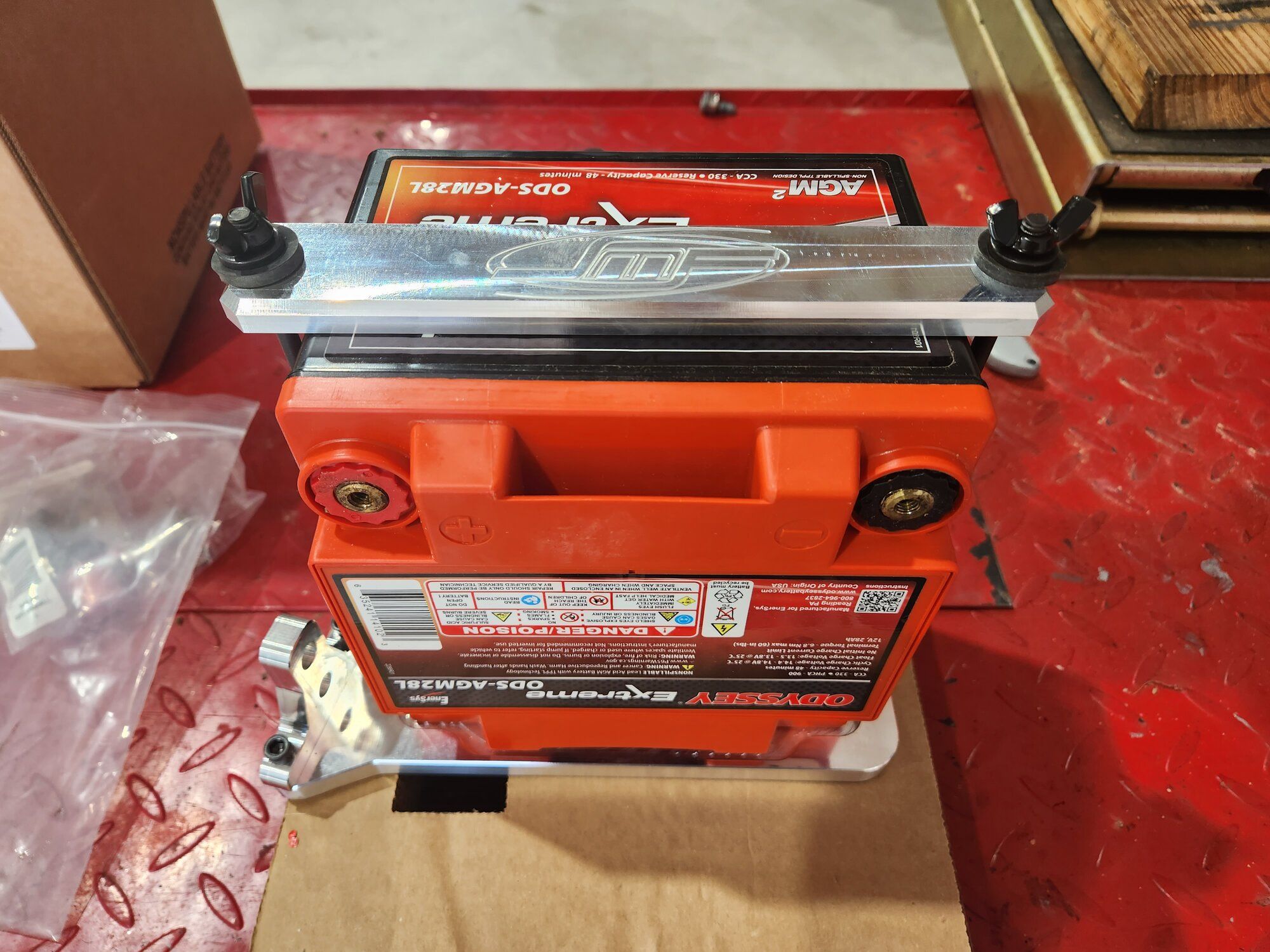

Have you went to buy a conventional battery lately? The prices are insane! There was only one choice at this point and it was to get a low/slim mount Odyssey for the Talon.

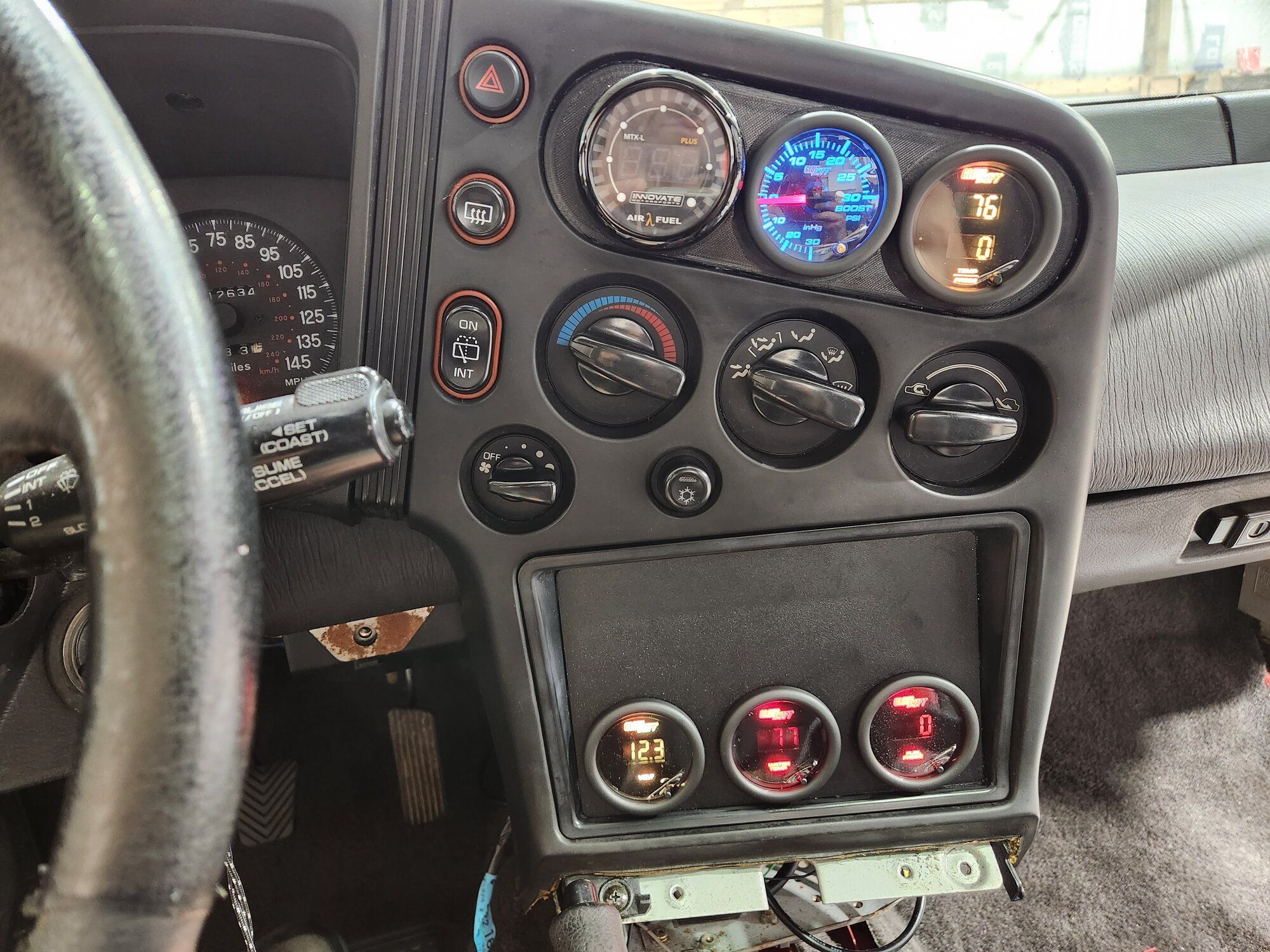

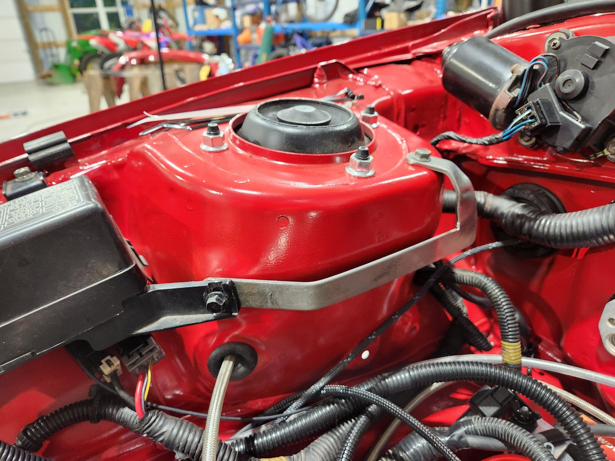

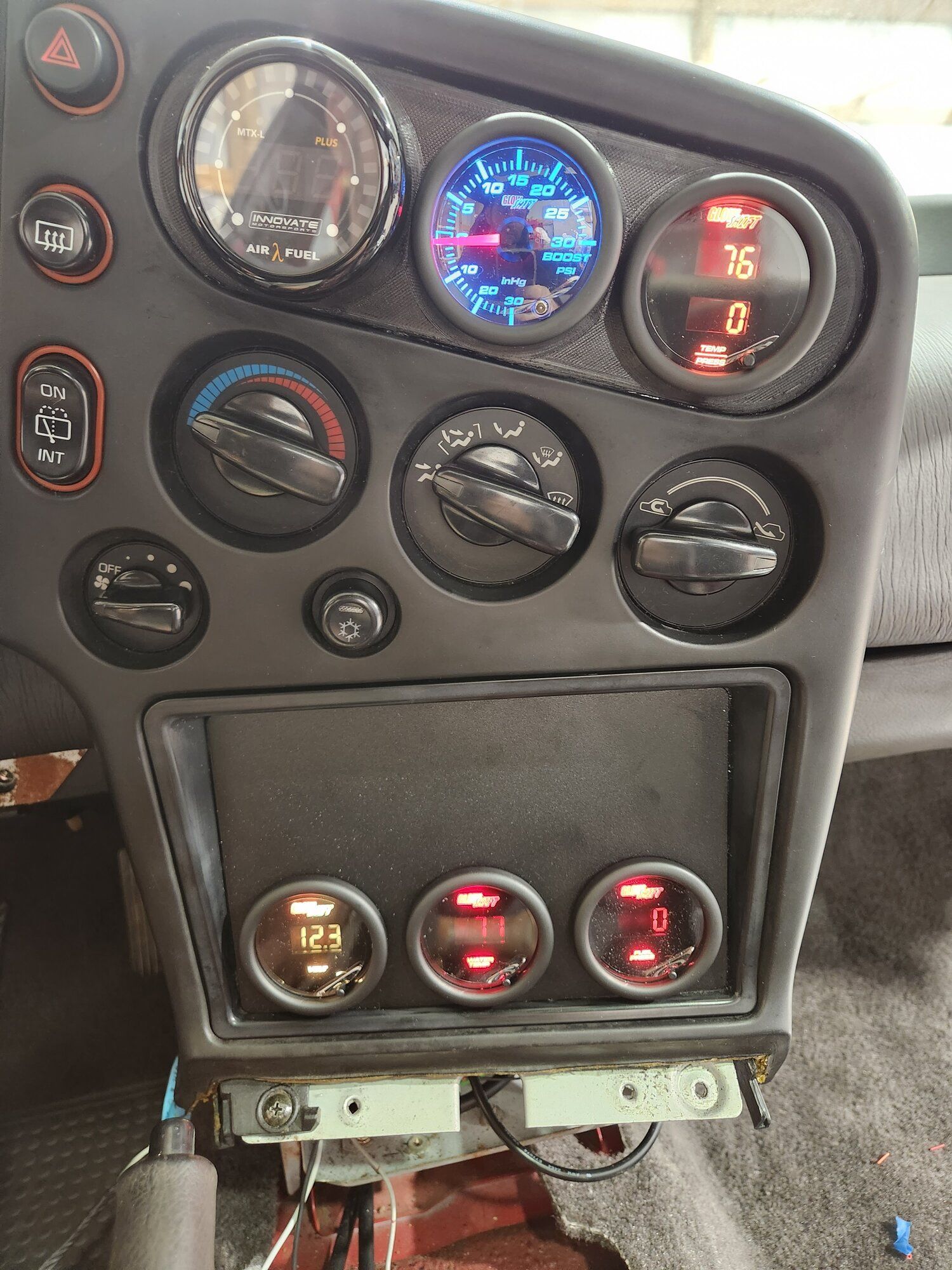

I really wanted badly to use the stock AC button to be able to manually hit the fans and I made it work! Just under the fan relay I was able to tap into the G/B wire and use the AC switch as a grounding switch, and voila!
All the guages and radio delete lined up really well and I've been enjoying them.

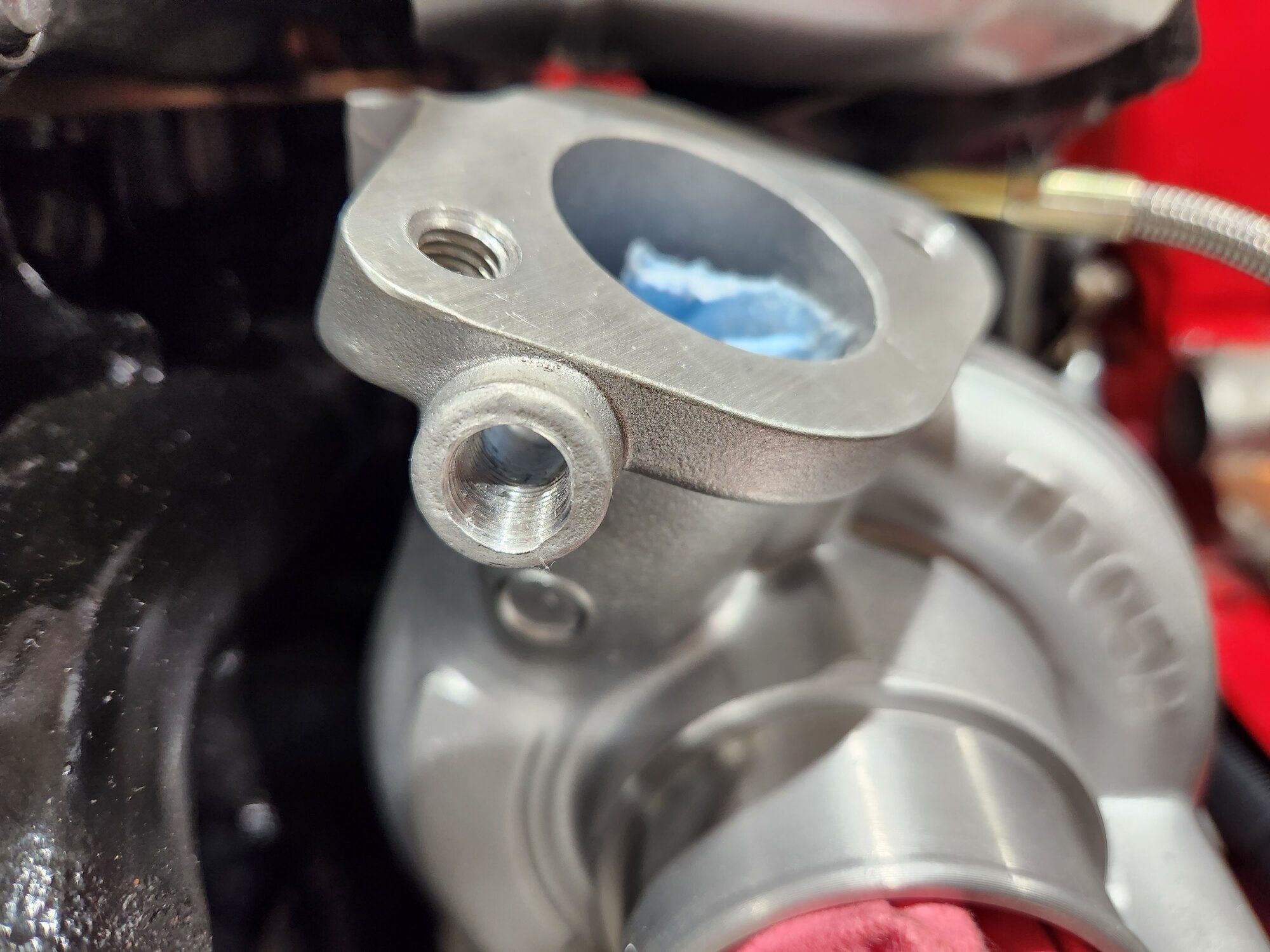

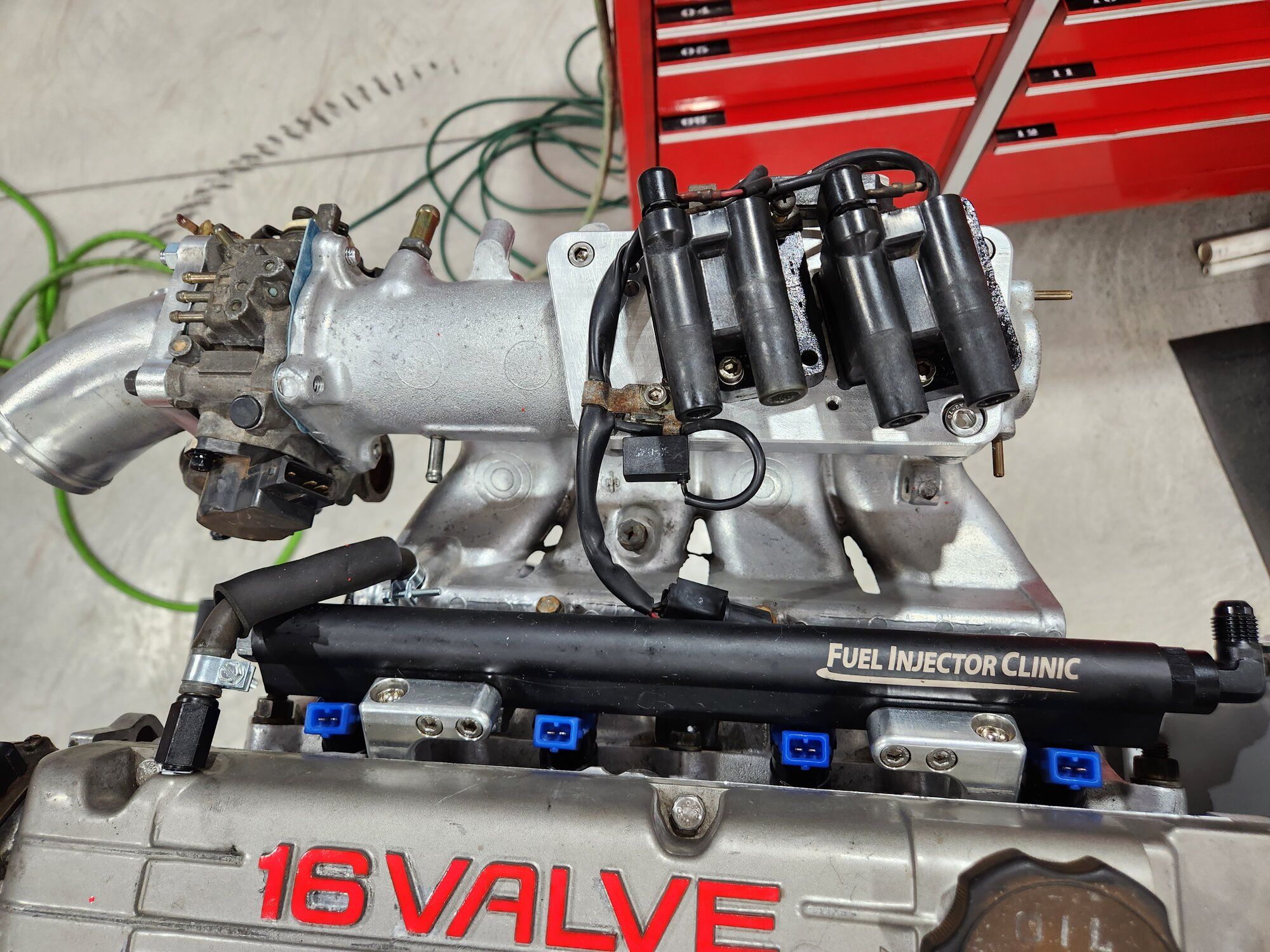

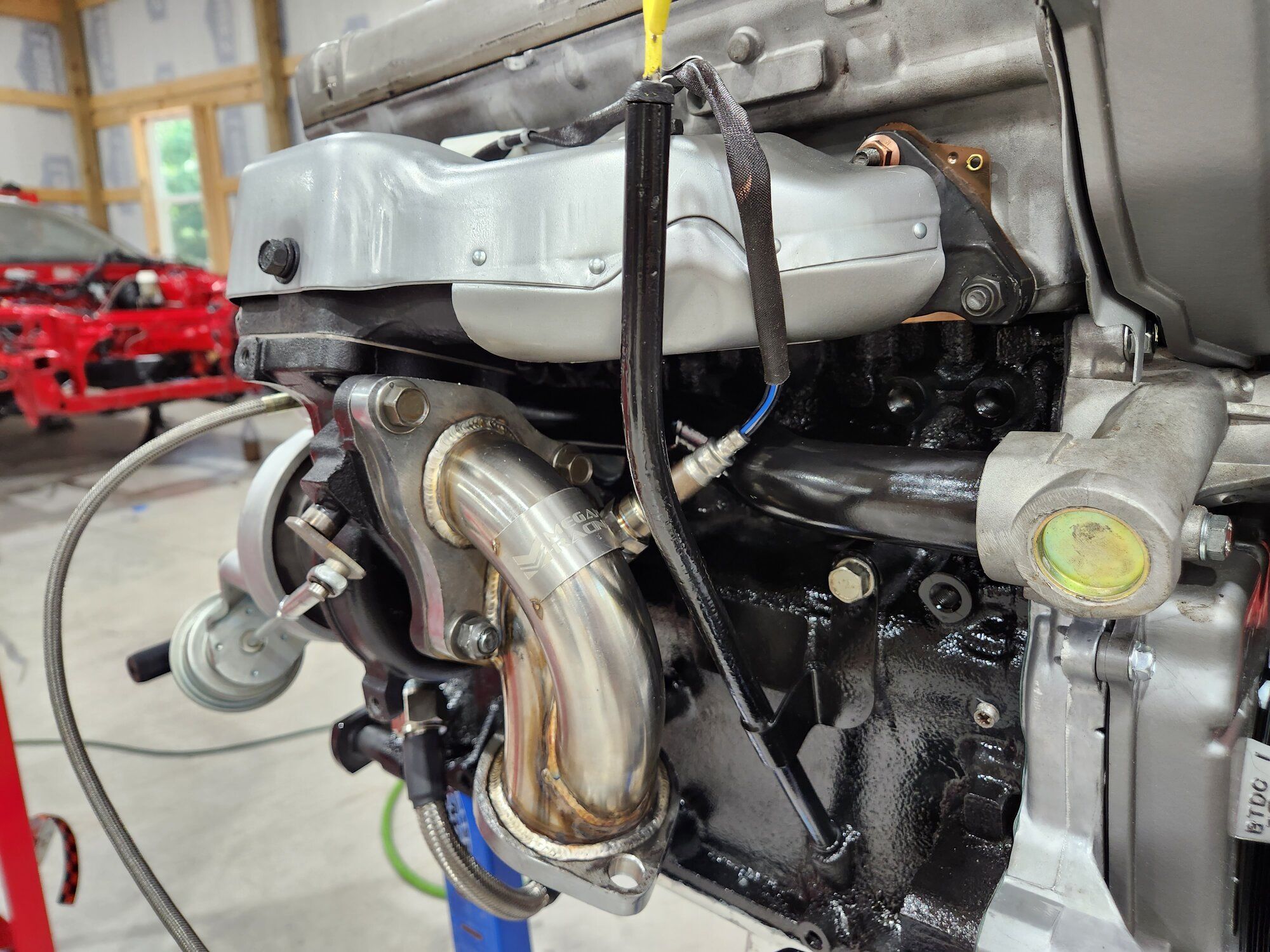

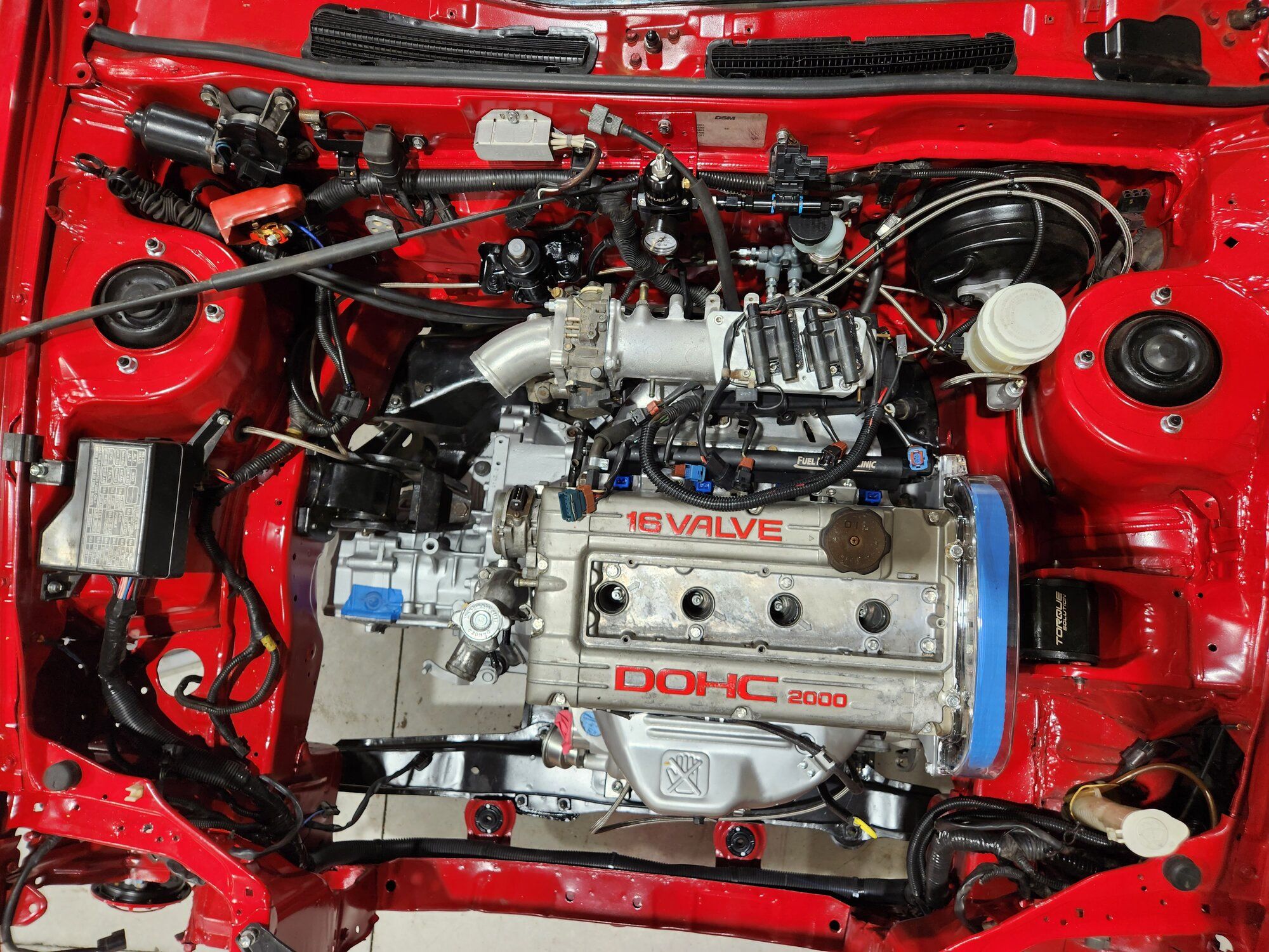

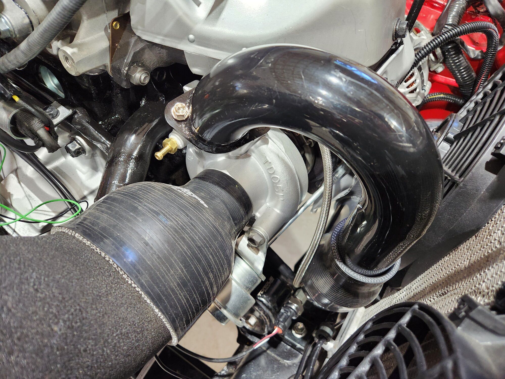

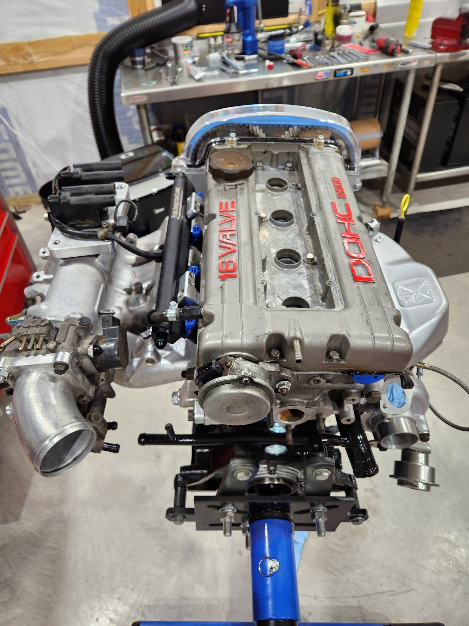

There wasn't a nipple on the charge/J pipe so with the suggestion of others on here I drilled, tapped, and added a boost source straight to the compressor housing to minimize plumbing to the wastgate. Bam!

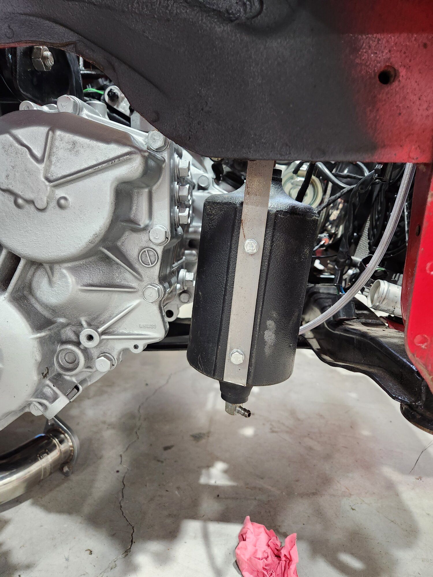

Fabbeb up a couple quickie brackets for the JAZ coolant overflow and the suggested #1 PCV improved factory

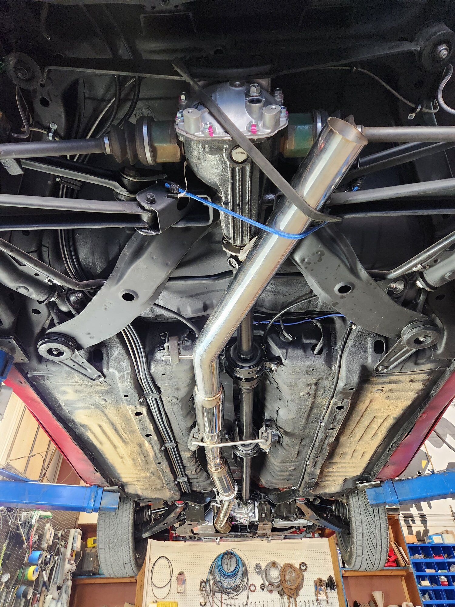

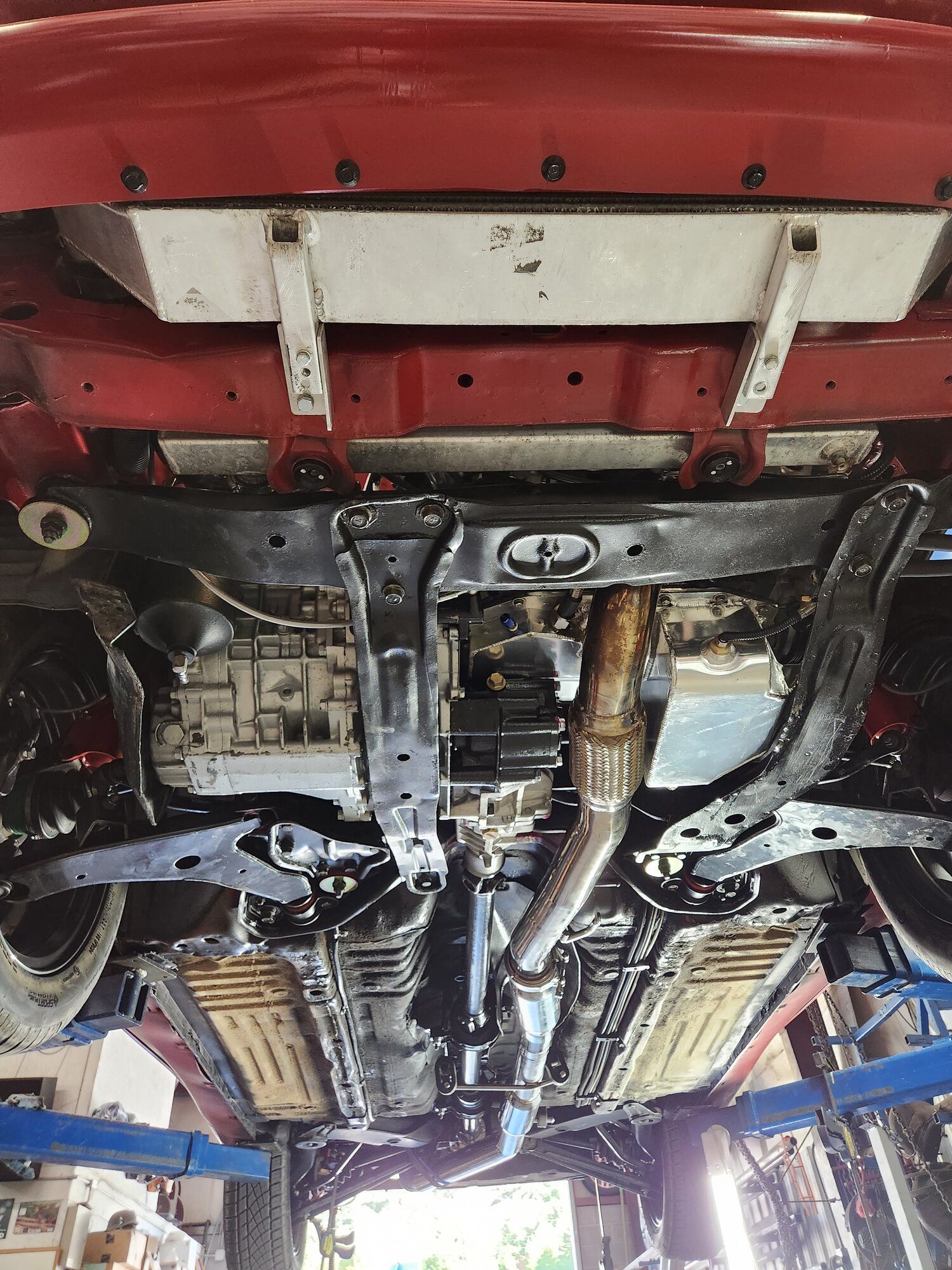

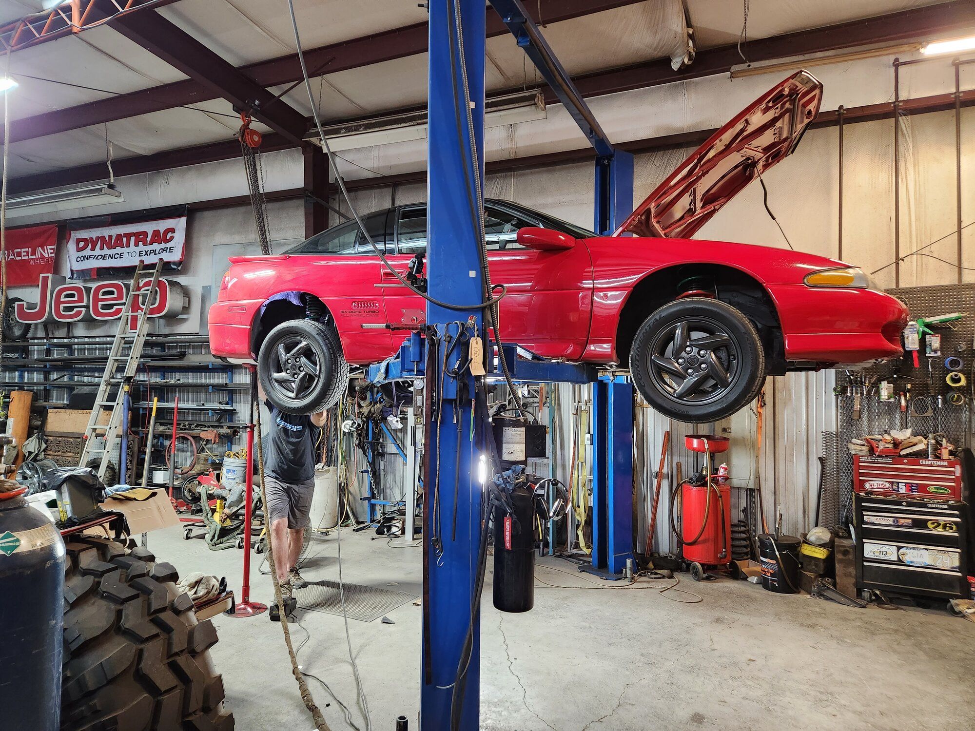

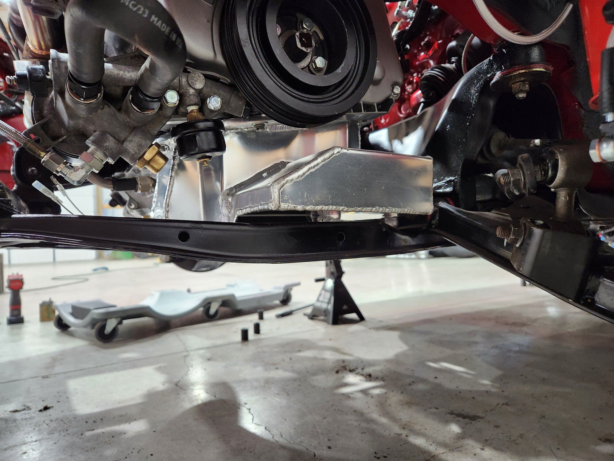

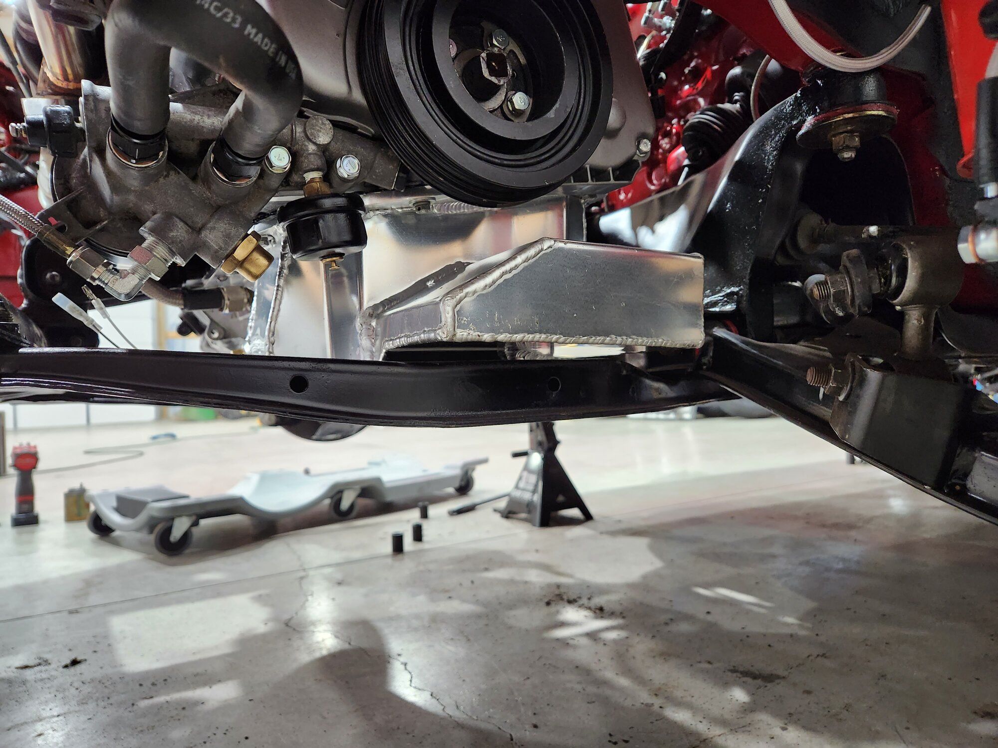

After wrestling with the brand new POS Megan 3" stainless exhaust with the awful flanges that didn't fit worth a crap, and bent into the driveshaft I gave up and enlisted the help of a local fabricator.
We cut the flanges off, added V band clamps, tucked it up as best as we could, and added the vibrant street performance muffler. It turned out perfect! Nice deep tone with both resonators taking out the rasp.

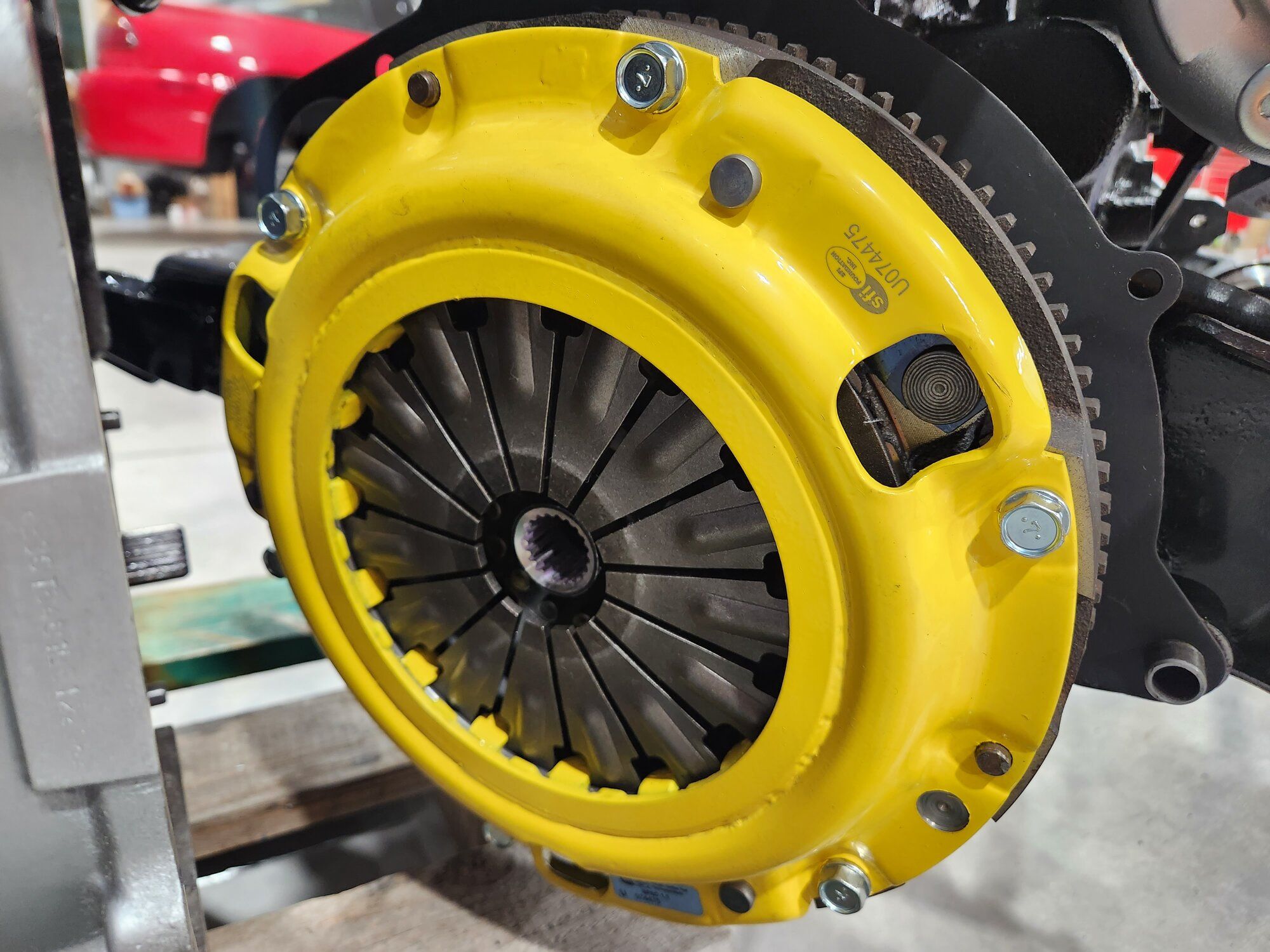

I ended up putting about 2.5 years worth of ripping arpund on the ole gal and fine tuning some things, new wheels...etc. It never let me down or left me stranded, which was the goal, build a tight, well running, reliable DSM. The local Subaru club hated when the 34 year old DSM would whip their STi asses through the mountains, but they secretly enjoyed the car, I think...haha. I had a bug to sell it as I stopped driving it and needed a van for work. So a super cool OG DSM'r (Joe) from Iowa came out and DROVE it 12 hours straight home! LOL.
