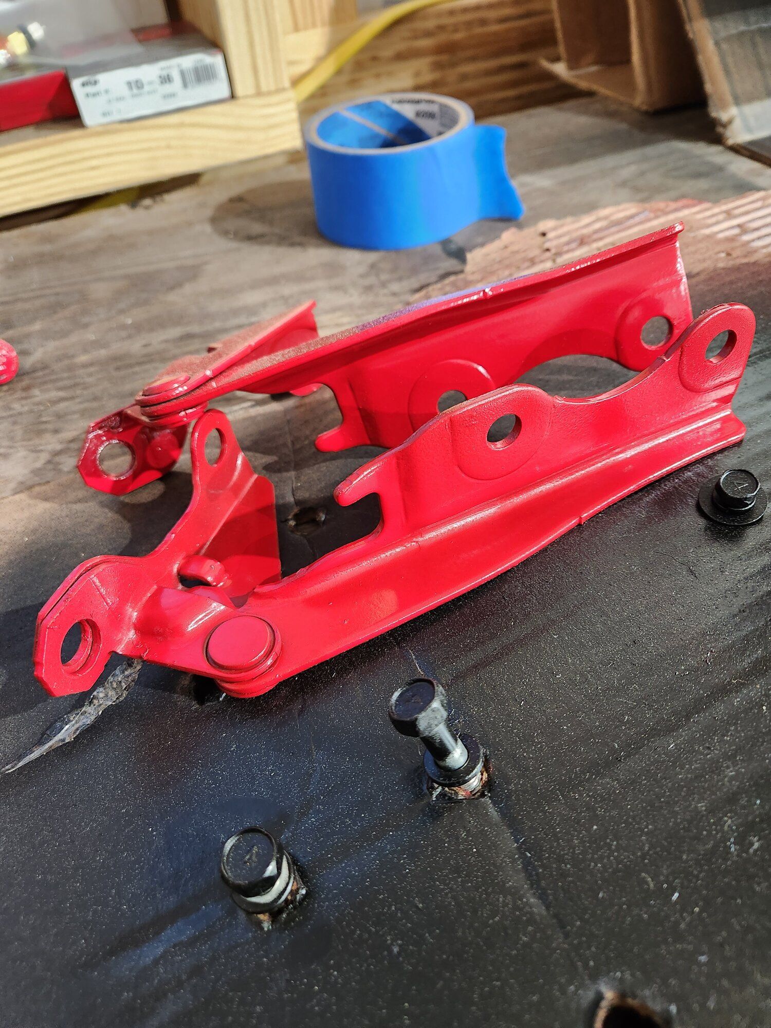

The bracketry paint bonanza continues and the hood hinges turned out well!

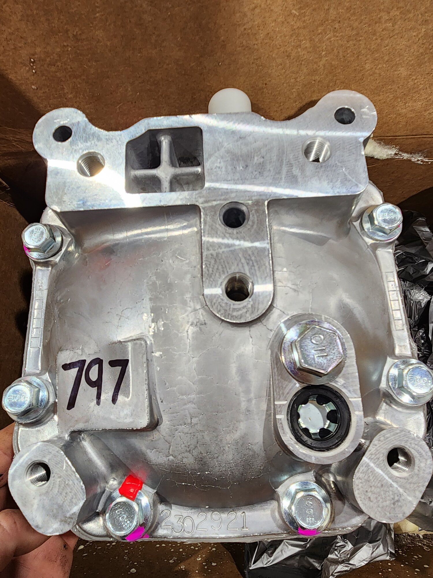

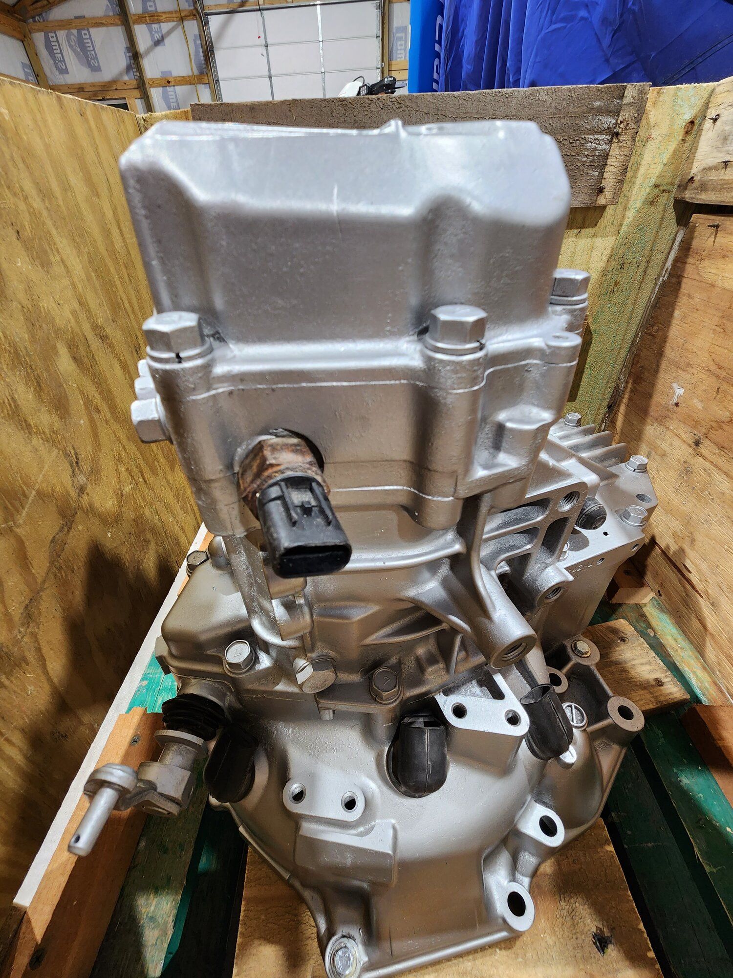

Amidst all that debacle, I was in the need of a completely new trans and posted up on here. Kurt @bastarddsm saved the day with an kick ass custom White Shed Speed built 5 speed, hell yeah! So stoked on this with all the upgrades and 90 gear set...etc.
Whiteshedspeed.com now I know where I'll be sending ANY of my future DSM drive train to. Thanks, man.

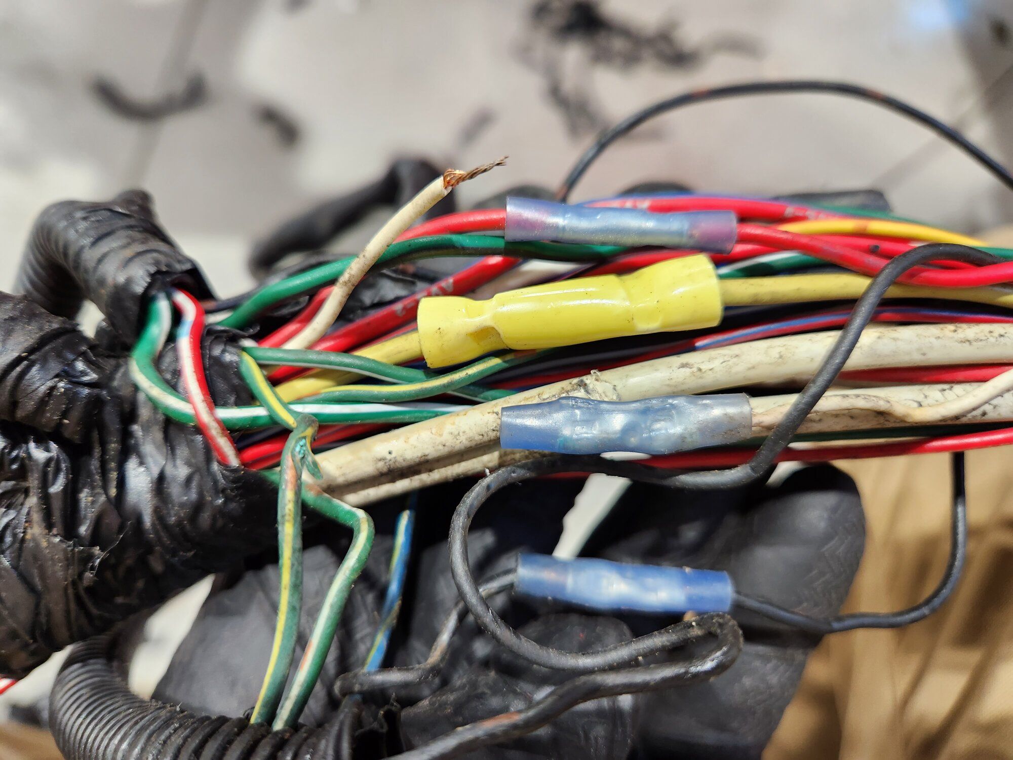

Onto the wiring!

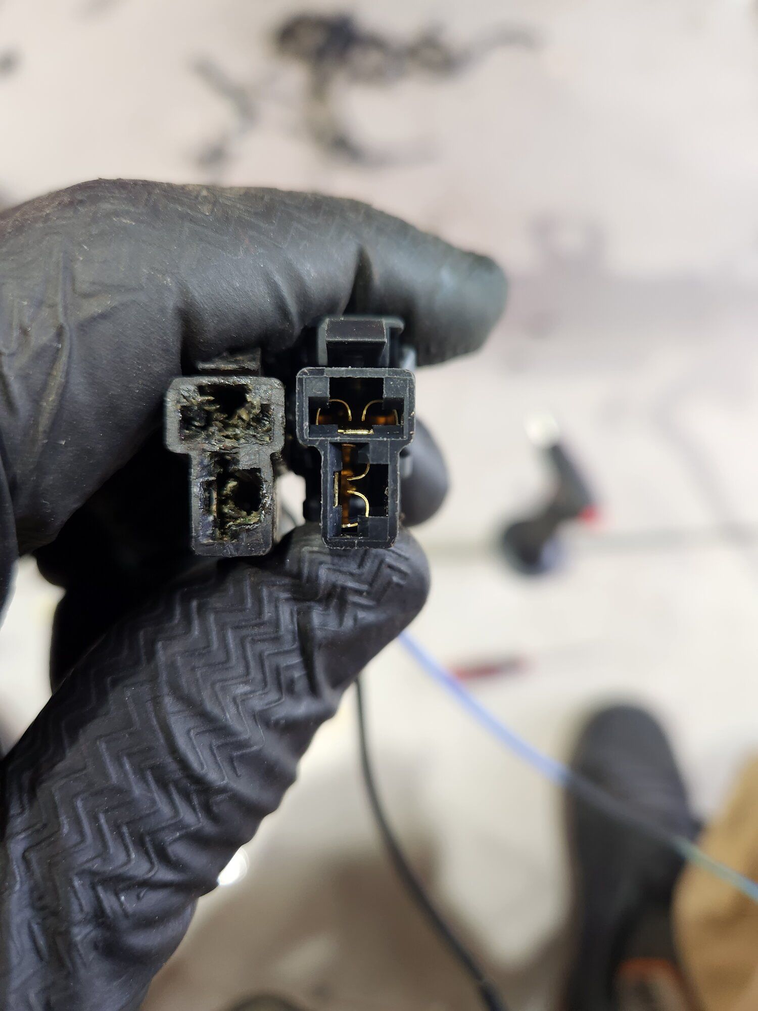

Fixing old repairs, yikes, shit wasn't even connected
Little soldering and marine heat shrink to wrap it up nice and tight.
Sheridan engineering to the rescue on these ancient hammered crusty eat connectors.

The bracketry paint bonanza continues and the hood hinges turned out well!View attachment 694666

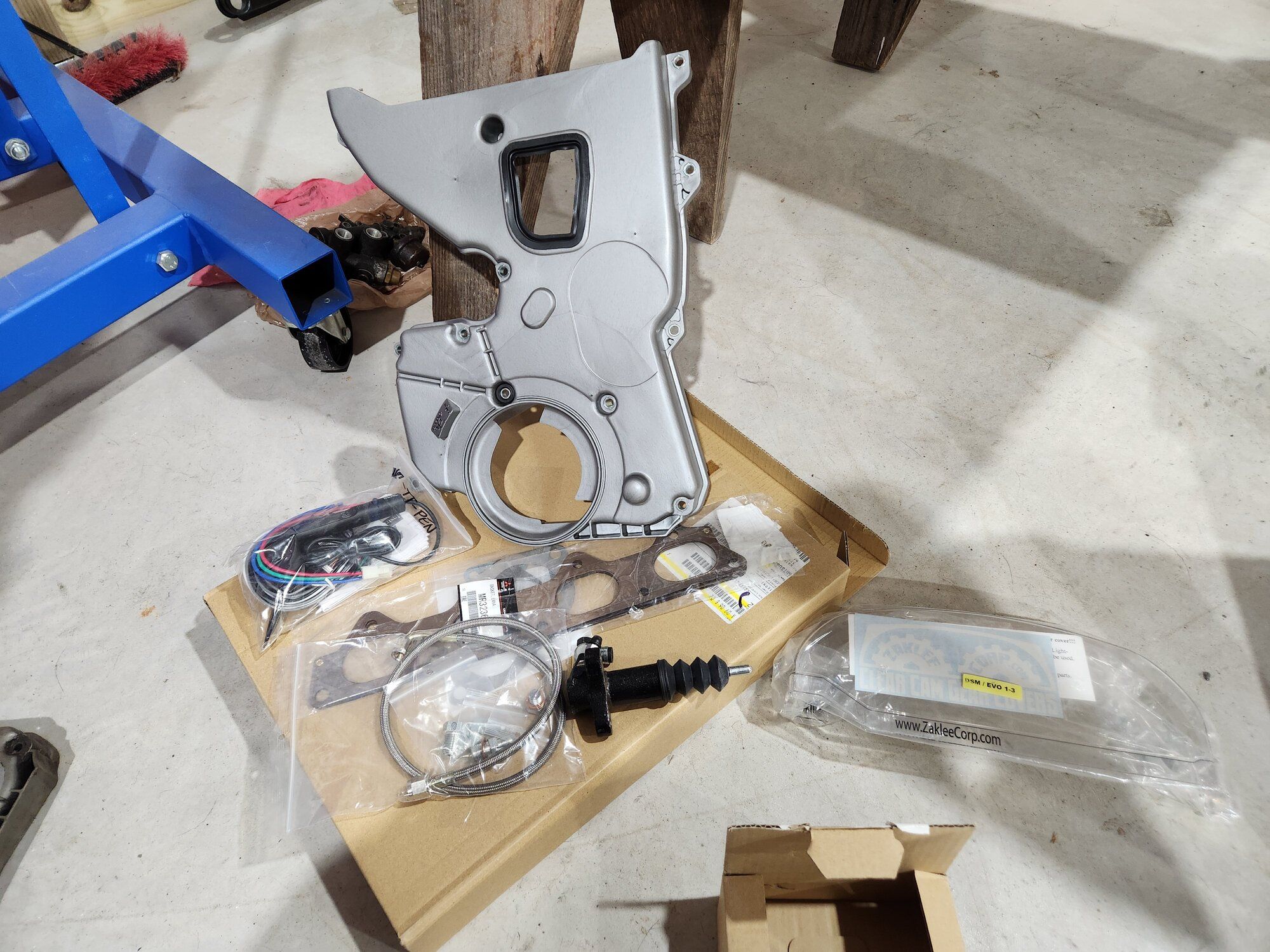

Picked up a bunch of key items over the last couple months that is bringing this thing closer to completion...and making more work for myself in the process. It's all good, though!
@Paul@RTM with the hookup on a lot of the parts. Thanks, man.

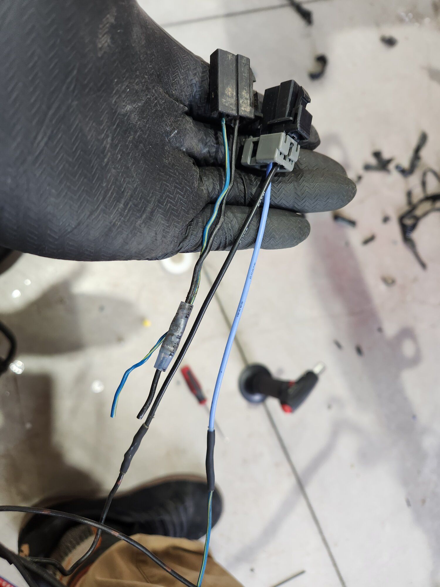

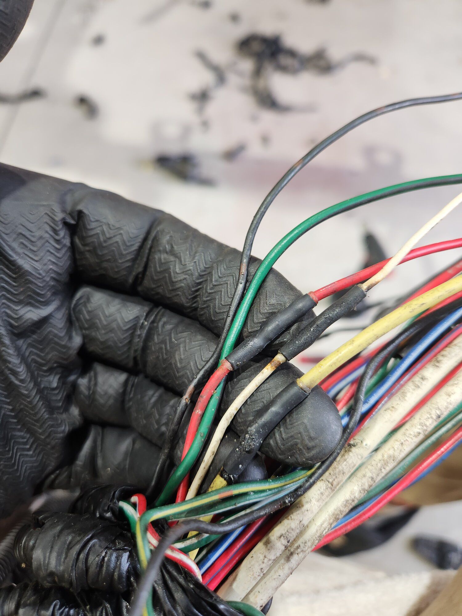

Onto the wiring!
View attachment 694676View attachment 694677

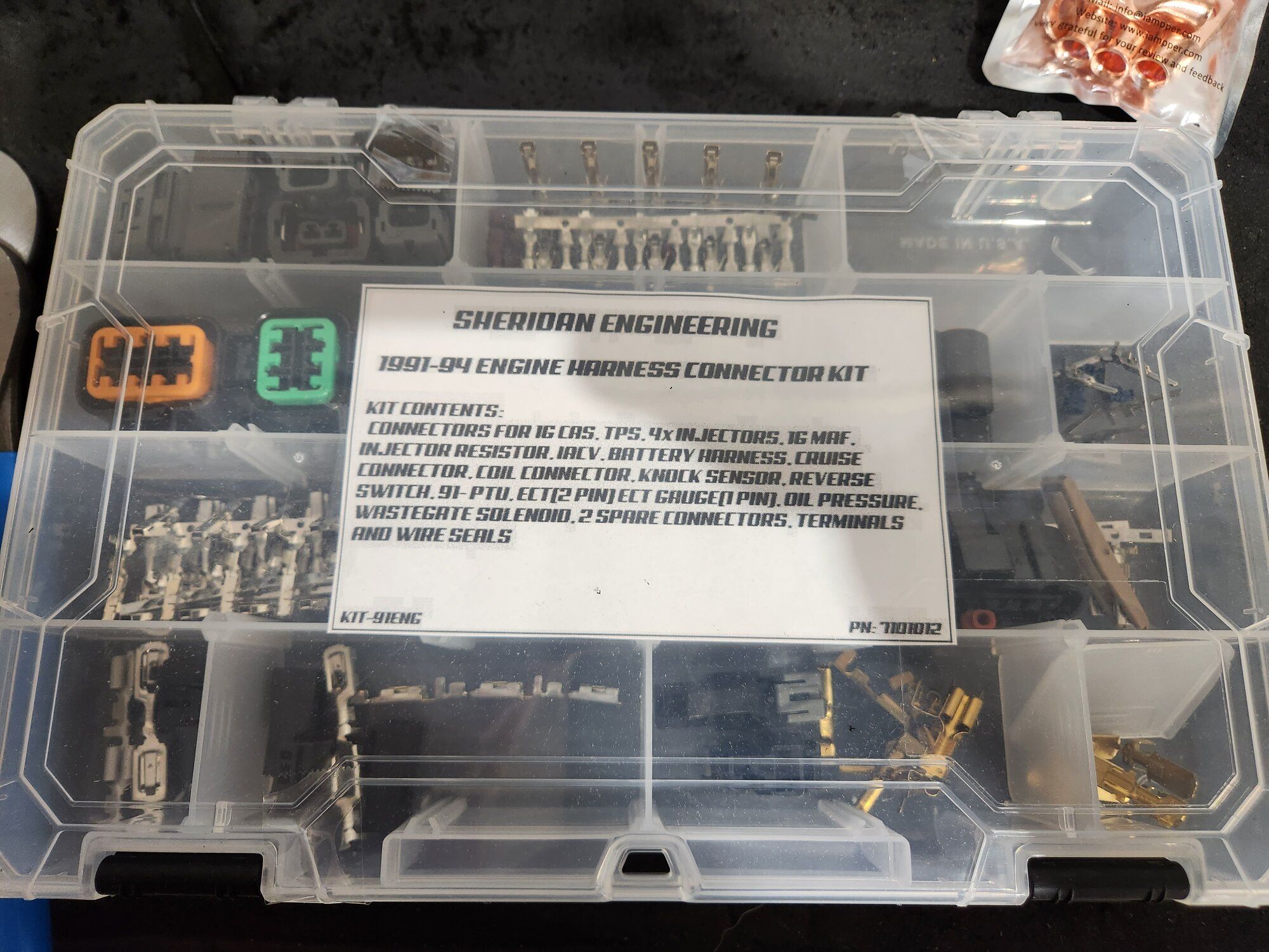

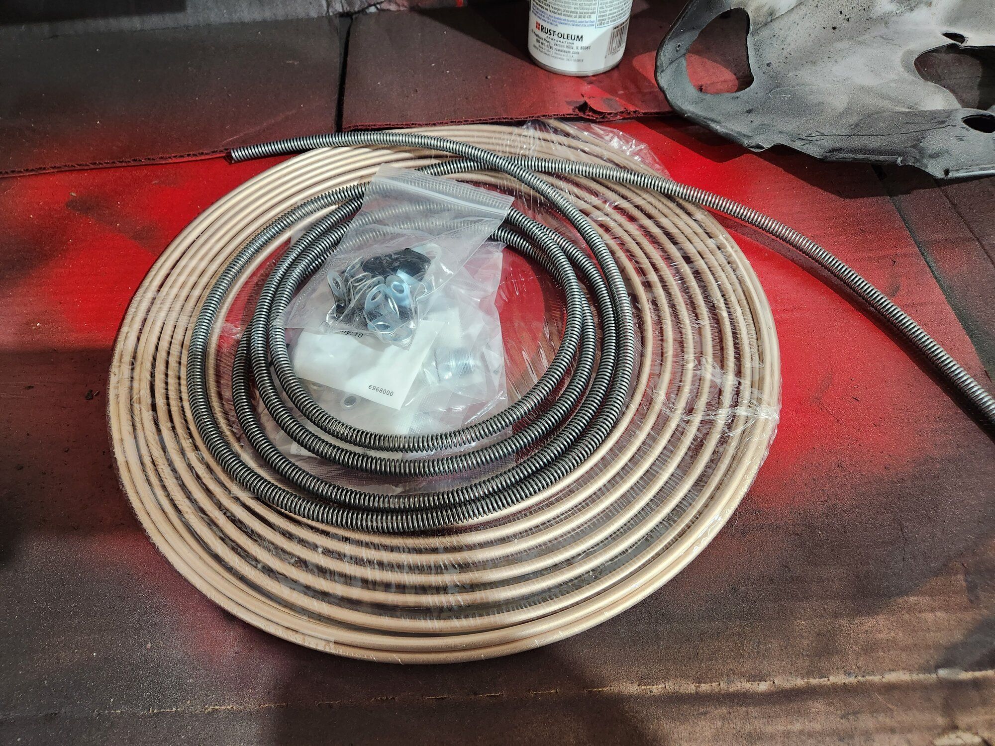

Where did you find the slinky cover (not sure what to call it) for the hard brake lines? Tried searching at RTM but can’t find it.
I took a page out of @Silverspyder book on using the rock guard over the brake line following the 1GB rust rebuild. Haha.
I got those off of Stop Tech on the 'zon (Amazon) along with the nickle copper 3/16 line kit. 🤘🤘

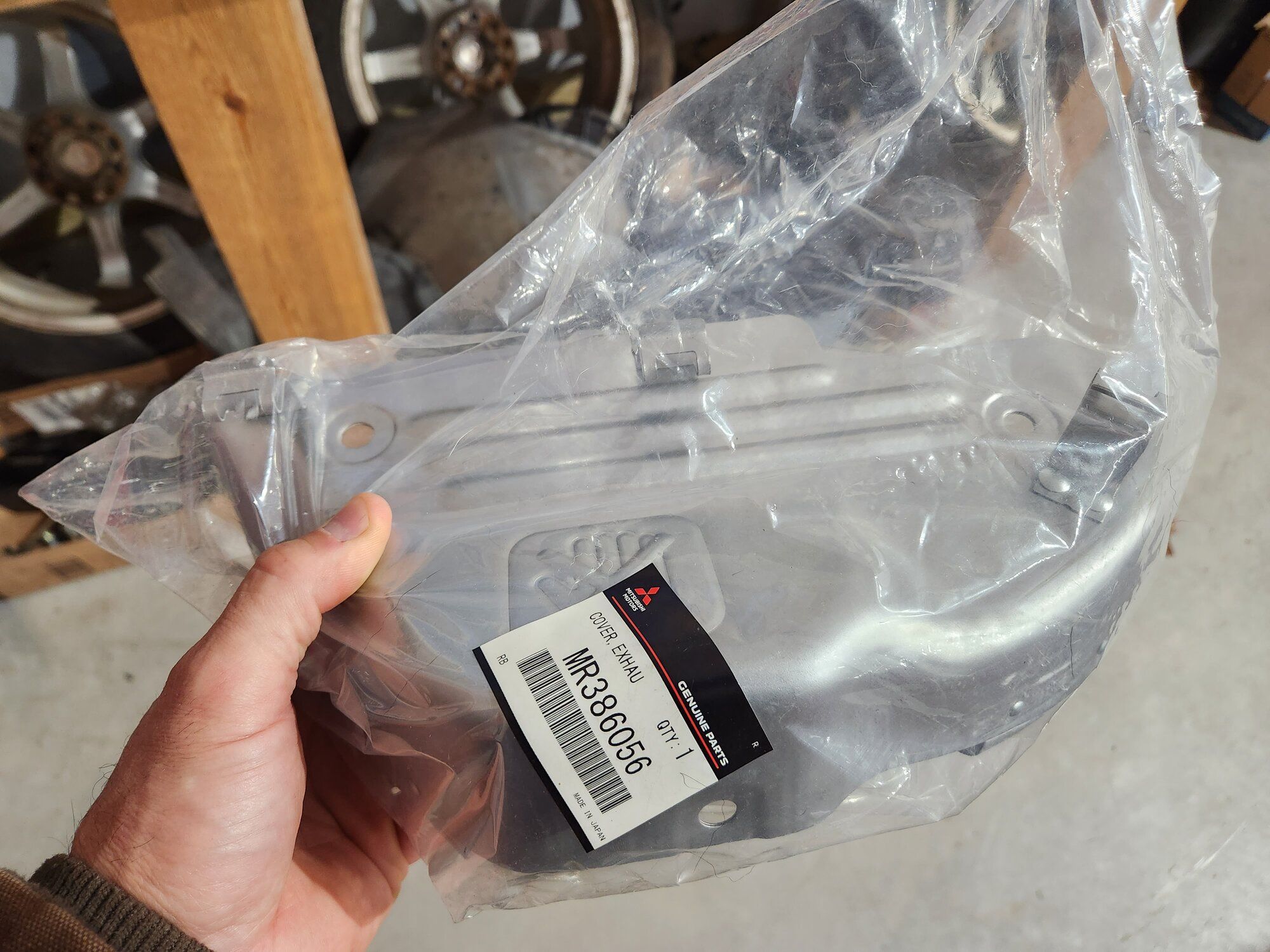

That heatshield for the manifold is drool worthy. My God that looks good.

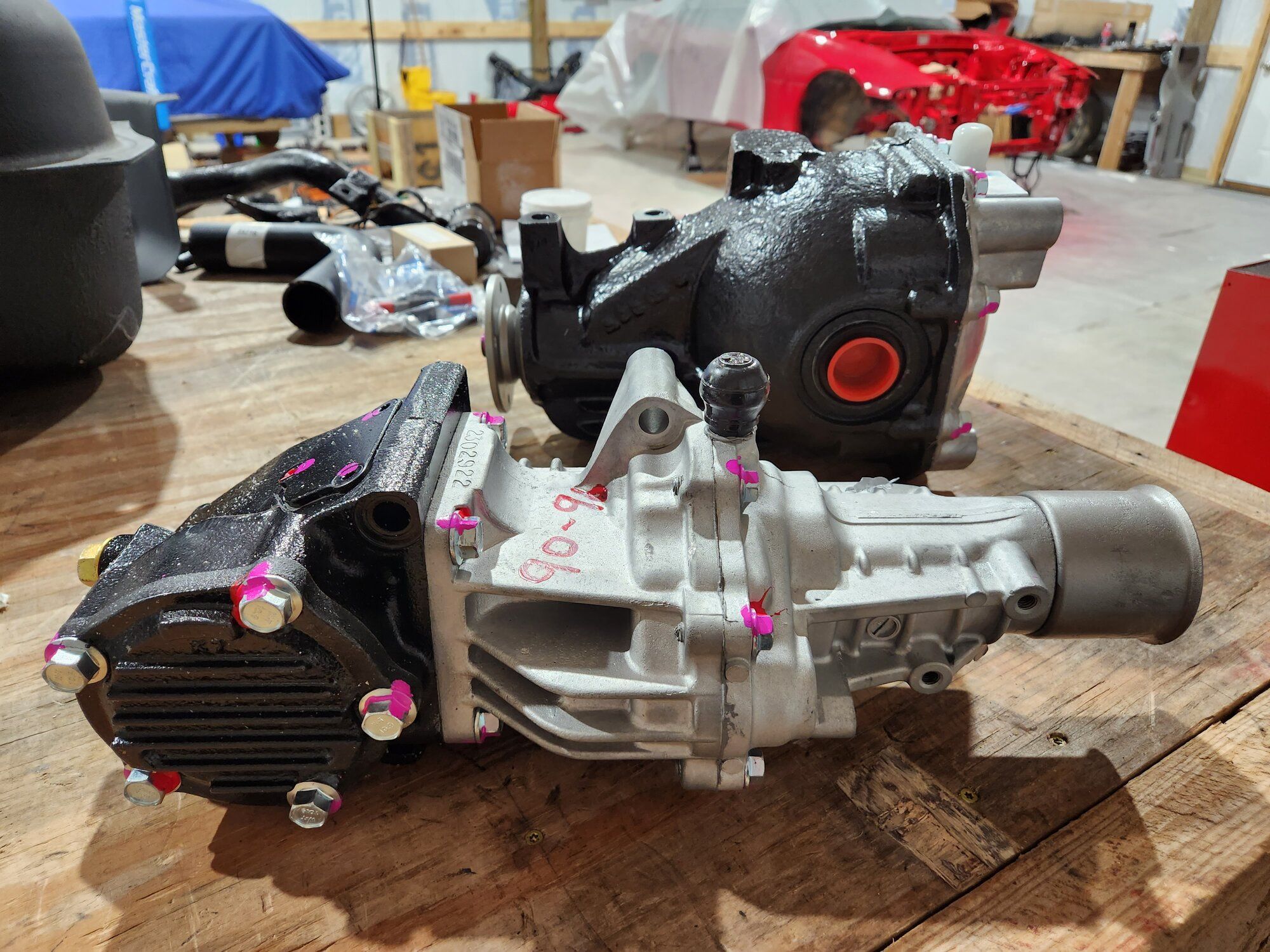

Also, what's the info on the trans? 4 spider diff and etc? Also, what rear diff is that? It all looks great though!
Lol, right! Man I just had to make it happen. I waited too long and the last one got sold on Extreme PSI, so I found that one on ebay from Japan from a parts warehouse called Megazip.net
I meant to post/ask if others have heard about it. Price was reasonable I thought, $68, shipping was a little pricey but hey, the shit isn't exactly available at the local flavor auto stores either. Haha
90 Gearset, WSS billet 1-2 and 3-4 rails, Torrington bearing mod, syncros, hmm a few others I can't remember off the top of my head. No 4 gear spider, just 2. With the power I'll be laying down it'll be just fine.
Rock guard, that makes sense. Got my ni-cop lines on the ‘zon too. Need that addition. Good call.

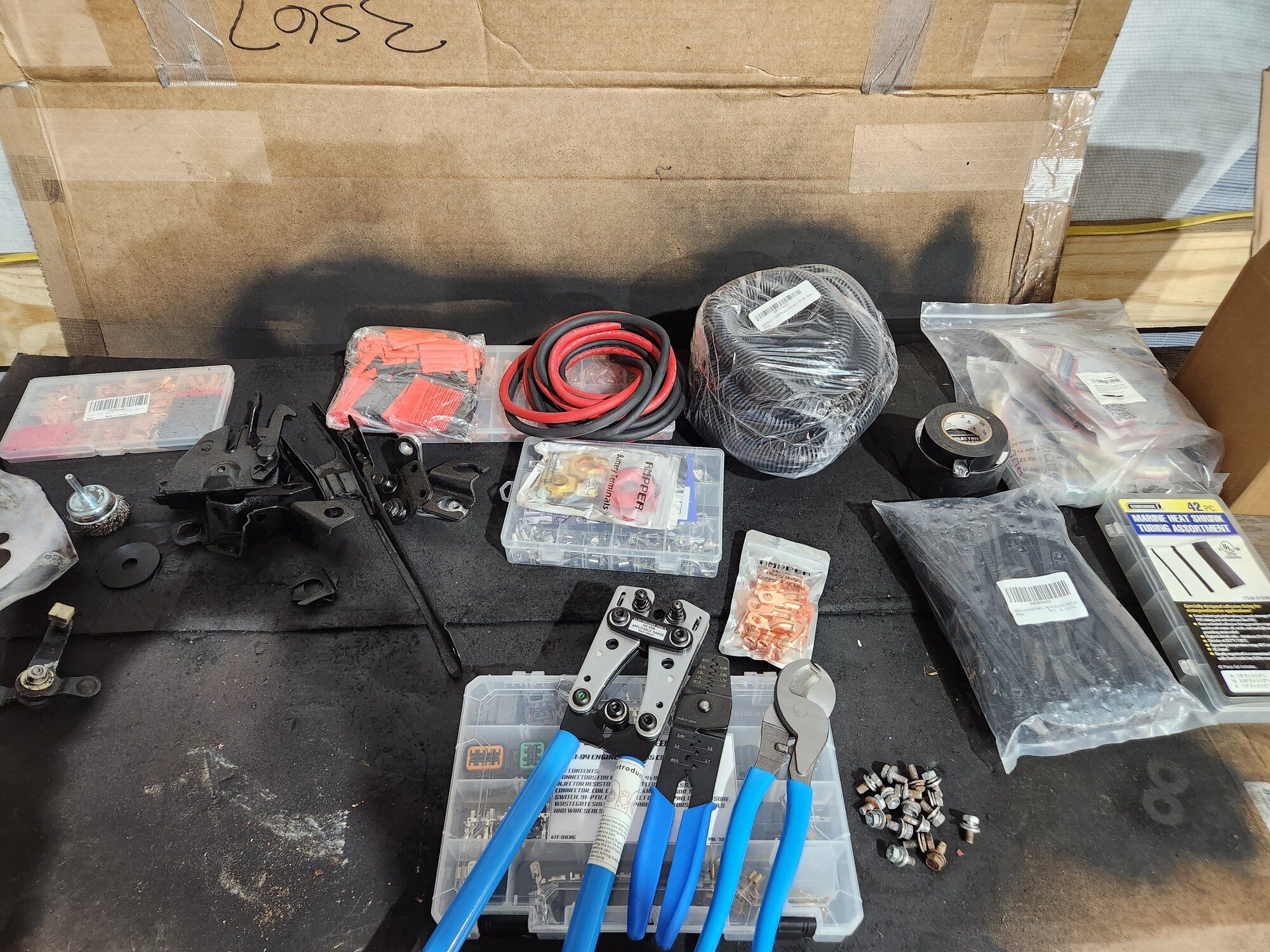

Funny how things always take longer than you think, but, this was 100% necessary! 30 year old crust and corrosion replaced with fresh USA made 4 guage and connectors.
I've got about 6 redundant ground straps to add to the complete setup as well when the drive train is in. 🤙
One step forward, 2 steps back. Haha.
Working on the fusible link center that connects to the battery and getting all that corrosion under control (that was a treat BTW, LOL). I'm going through the hassle now so that if I have a problem on the road it'll be much easier to bust out the 10mm and pop the stuff right apart. Pics are from after it was soaking in Evapo-Rust for about a day and a half. These connections are critical, might as well put the time in.
Due to the overwhelming alternator issues these cars are plagued with I decided to yank all 93" of the stock twin 12 guage white wire and will replace it with 4ga and a higher amperage fusible link. It was actually pretty easy and didn't take longer than about 20 minutes or so given the current state of things.
just a basic build with all the weak points fixed. Stock 2 spider holds up good if you are not trying to be john force, First thing that happens is the upper thrust washer gets welded to the cap, and smeared around, the upper torrington bearing helps a lot. Then the 3/4 fork gets the roll pin pulled out the bottom so we put a second one it that greatly improves the strength. Next the 3/4 shift rail on the early trans can break if you look at it wrong. I have a billet chrome moly replacement that I am getting close to releasing. Then the 1/2 shift fork gets the one finger broke off easily. Next stop for the piece is typically between the ring gear and the case, and the case never wins. I make a billet alumimum one that is much stronger and doesn't break. I have a couple mods to the synchronizer assemblies that I do to help out a bit. I think I also converted this one to a 91+ shift arm since it was a 90 trans. I had a local that was running one in a about full tilt 6262 car going low 10's at almost 150. It lasted through a couple tcases and a rear i think. Would have lasted longer but he put a quartermaster in it.
Anywho nice progress on the car. I regret sending that nasty reverse switch with that one. IIRC oreallys has new ones for like $9, not as nice as an OE but not rusty LOL.

Quick question, would you recommend the redline break in/LSD additive to the rear diff since happy Jack shot peened all the gears and needs a complete break in? Could never get a straightforward answer....haha.
Thank you, it's getting there, stoked to just wheel the car under mostly stock power and a big 16 G to get it on the road and work out the rest of the typical 30 year old DSM bugs.
I didn't pay attention, but does it have an evo LSD? If so, yeah put an lsd additive oil in it. If not, just a quality 80-90ish GL5 oil will be fine. I don't get too wrapped up in the whole breakin stuff. IMO the shotpeening should not change the surface enough to need a rebreakin. you are pelting a diamond with led balls basically.
Ah, ok. No, just the stock viscous B1H rear.
Picked up some Redline 80-140 for the rear diff, rated for limited slips diffs. Also redline 75-90NS for trans and Tranfer case. 🤘🤘
Ok, cool, thanks man! I'll just follow your instructions and giver an oil change.
