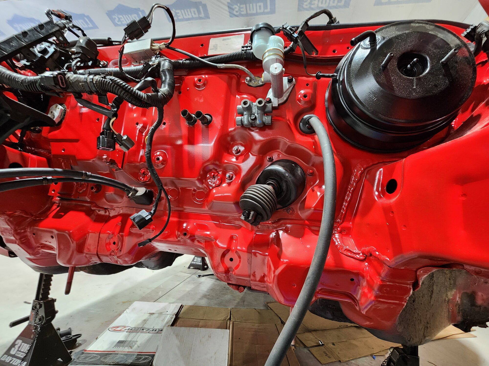

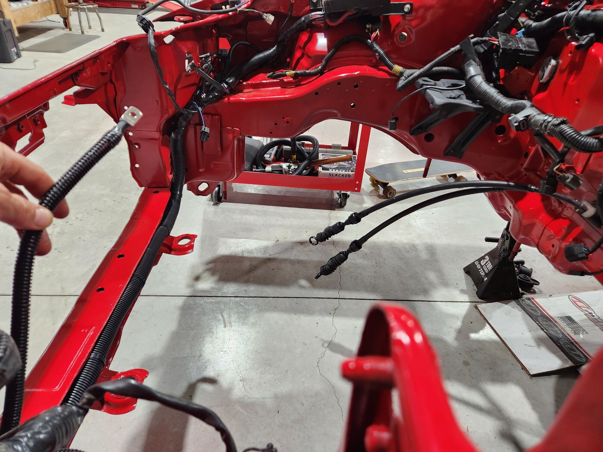

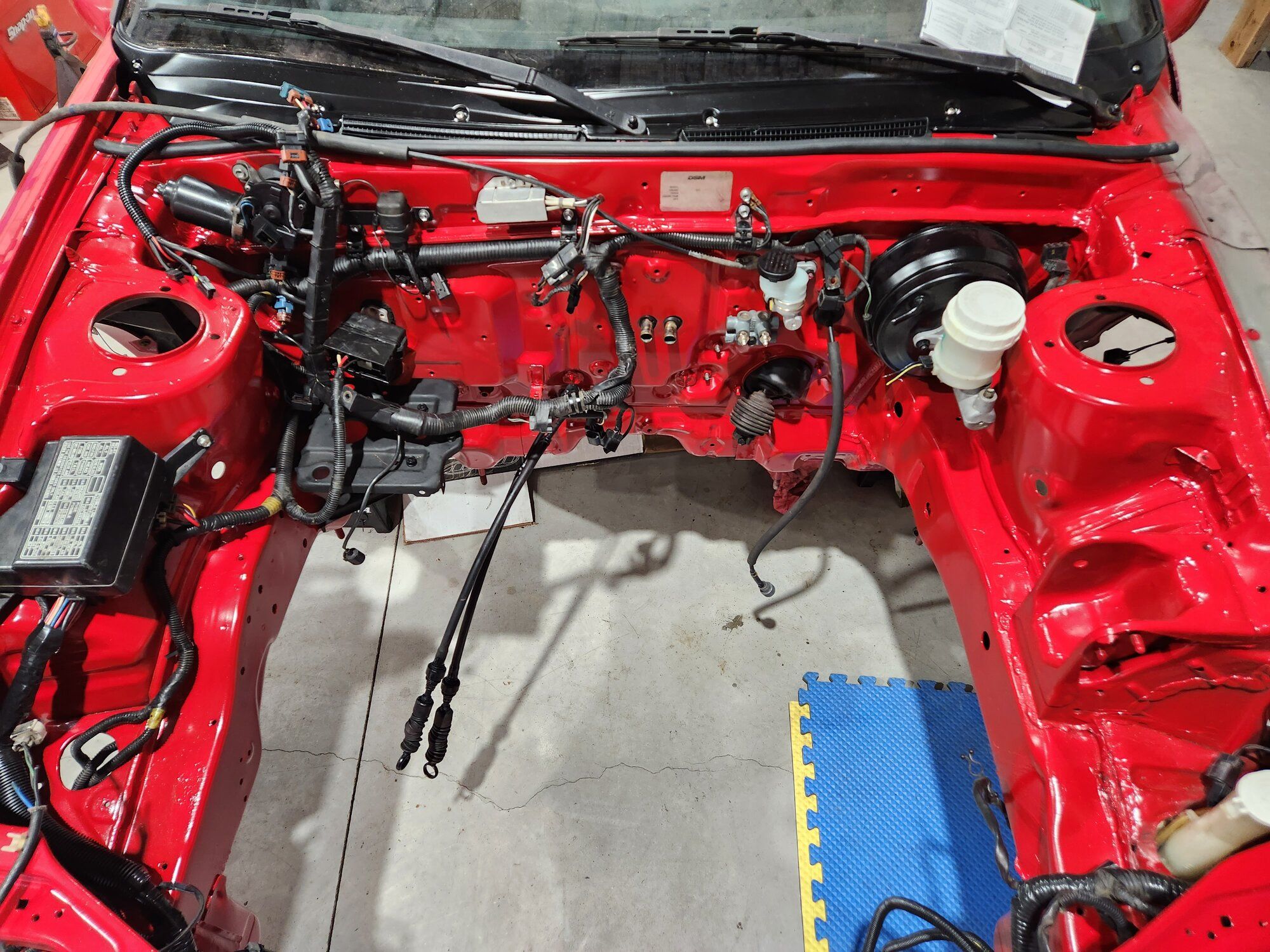

Welded a nut onto the end of the clutch master clevis, assembled/bolted all the cables onto the firewall, hooked all the pedals up...etc.

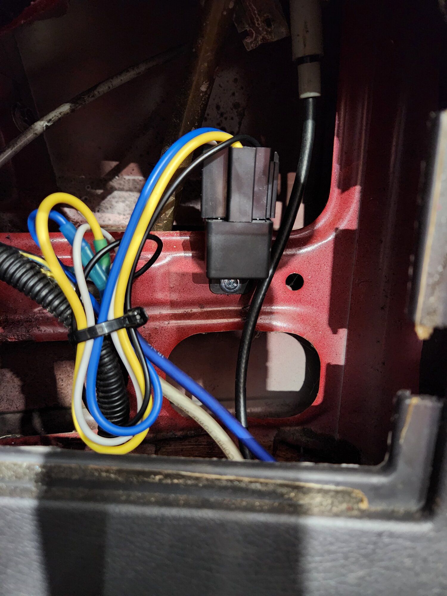

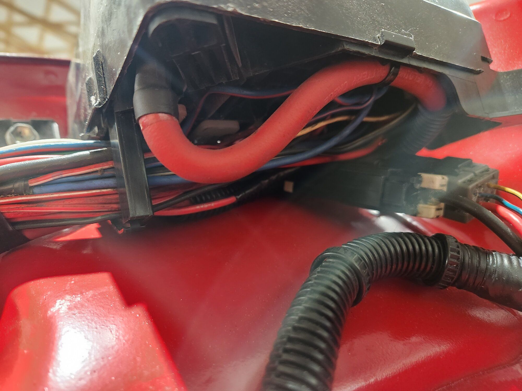

Buttoned up most of the wiring including some fatty 4ga from the alternator alllll the way over to the battery, approximately 10 foot! 100A fusible link with anticipation of at least the Galant 90A alternator to start.

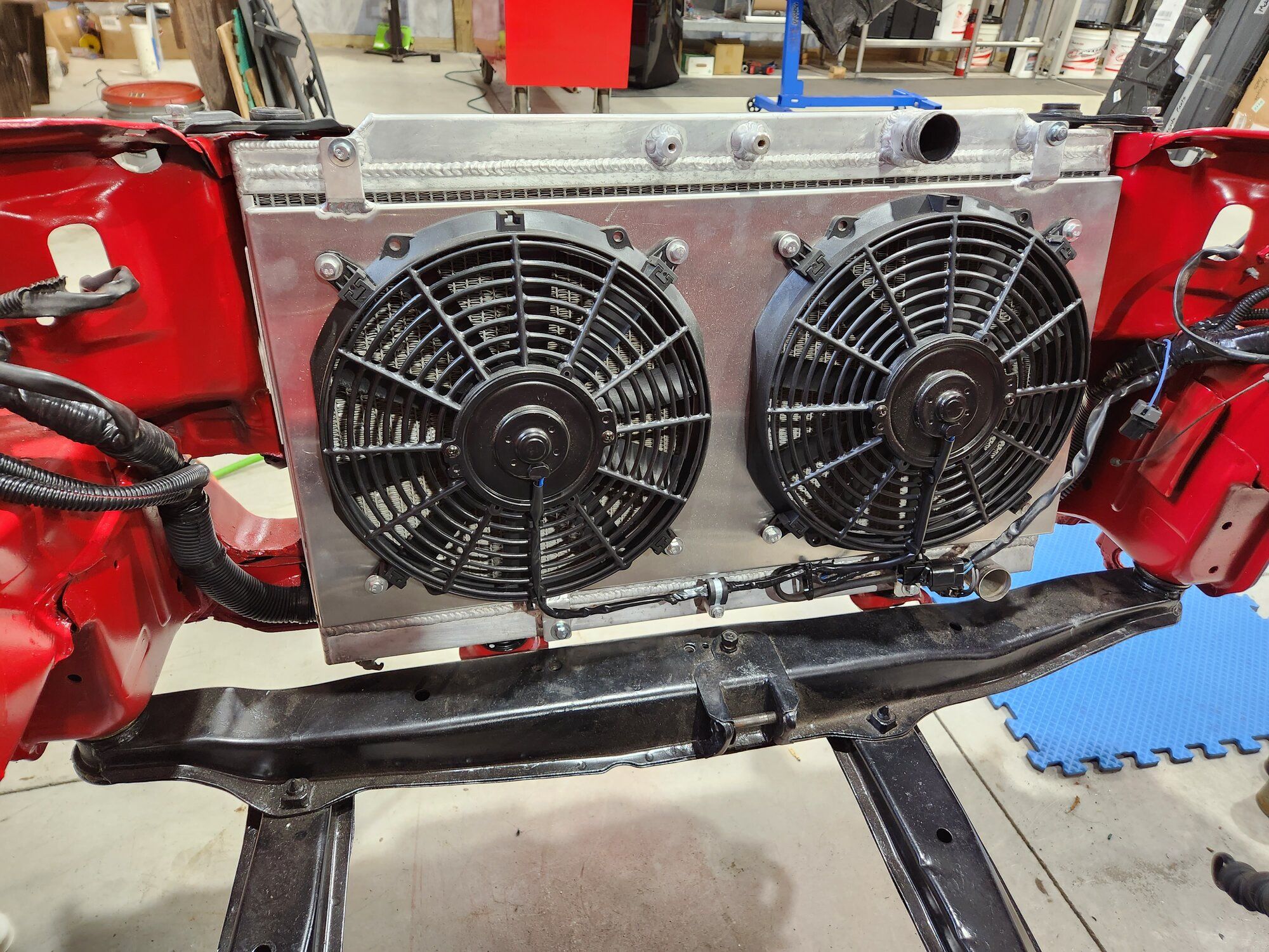

High amp relay and fuse holders on order for fan wiring..etc.

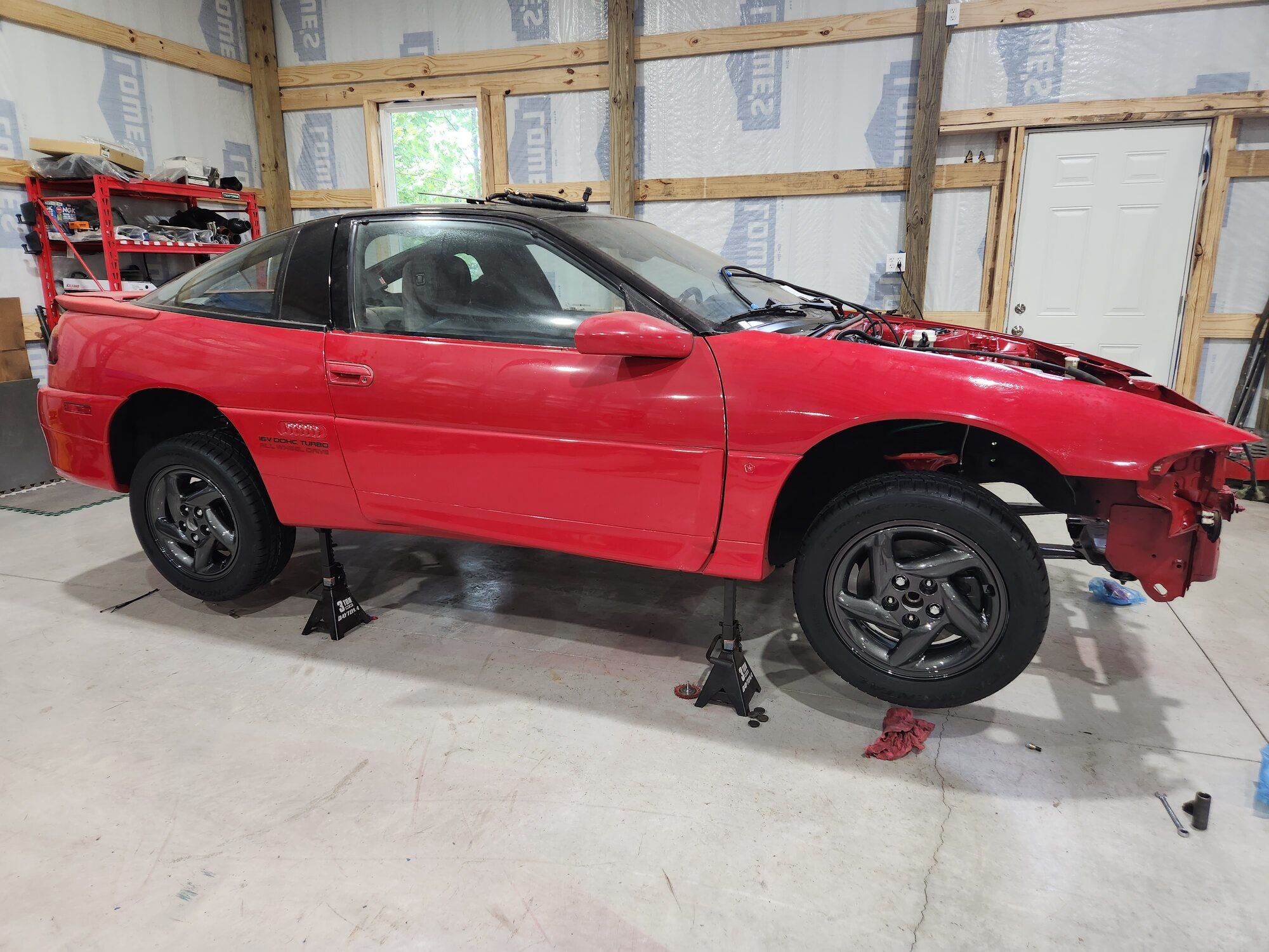

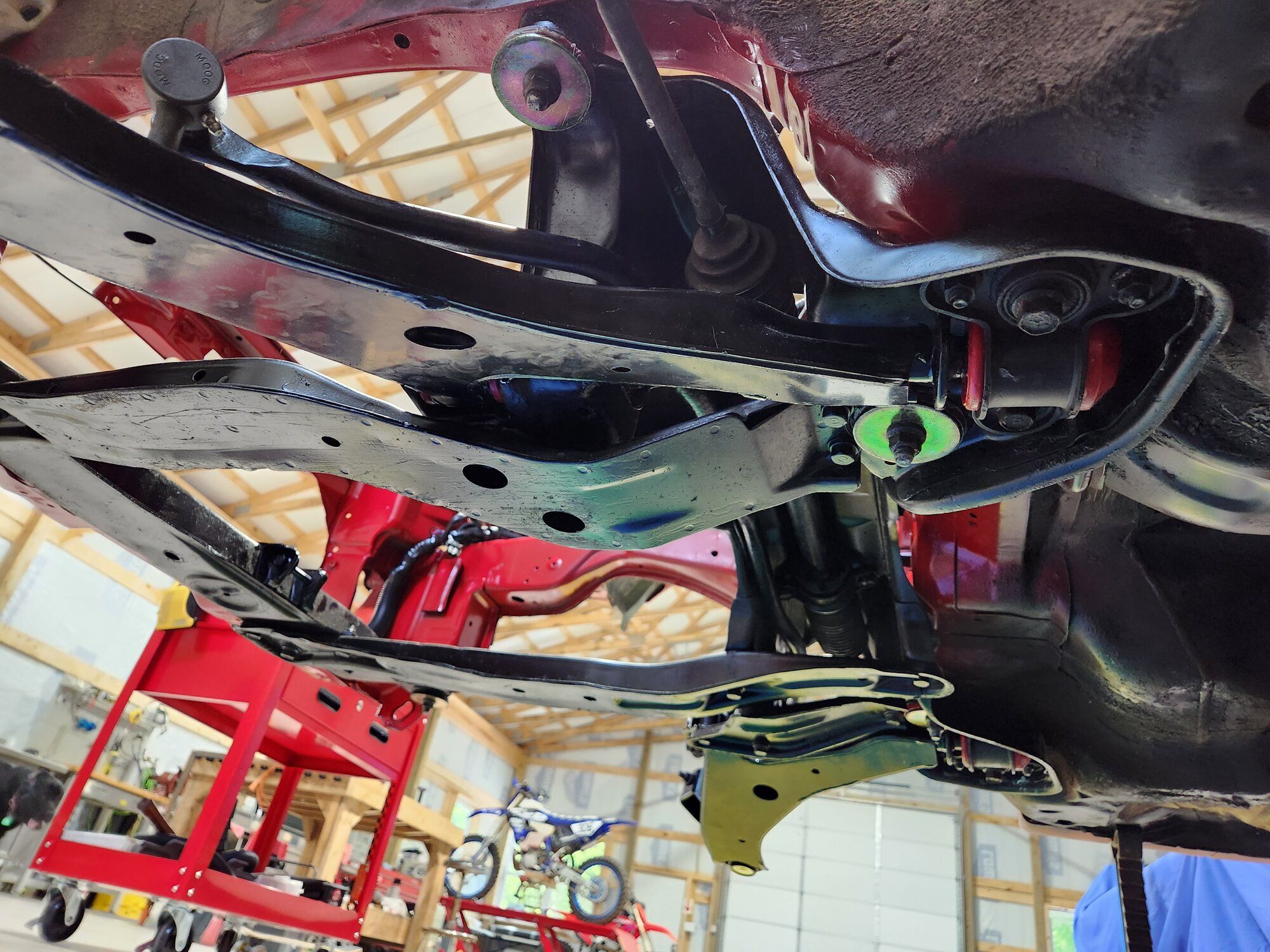

Time to bolt the subframes back in and run the 2 rear brake lines and rough in the fuel lines! Wahooo!

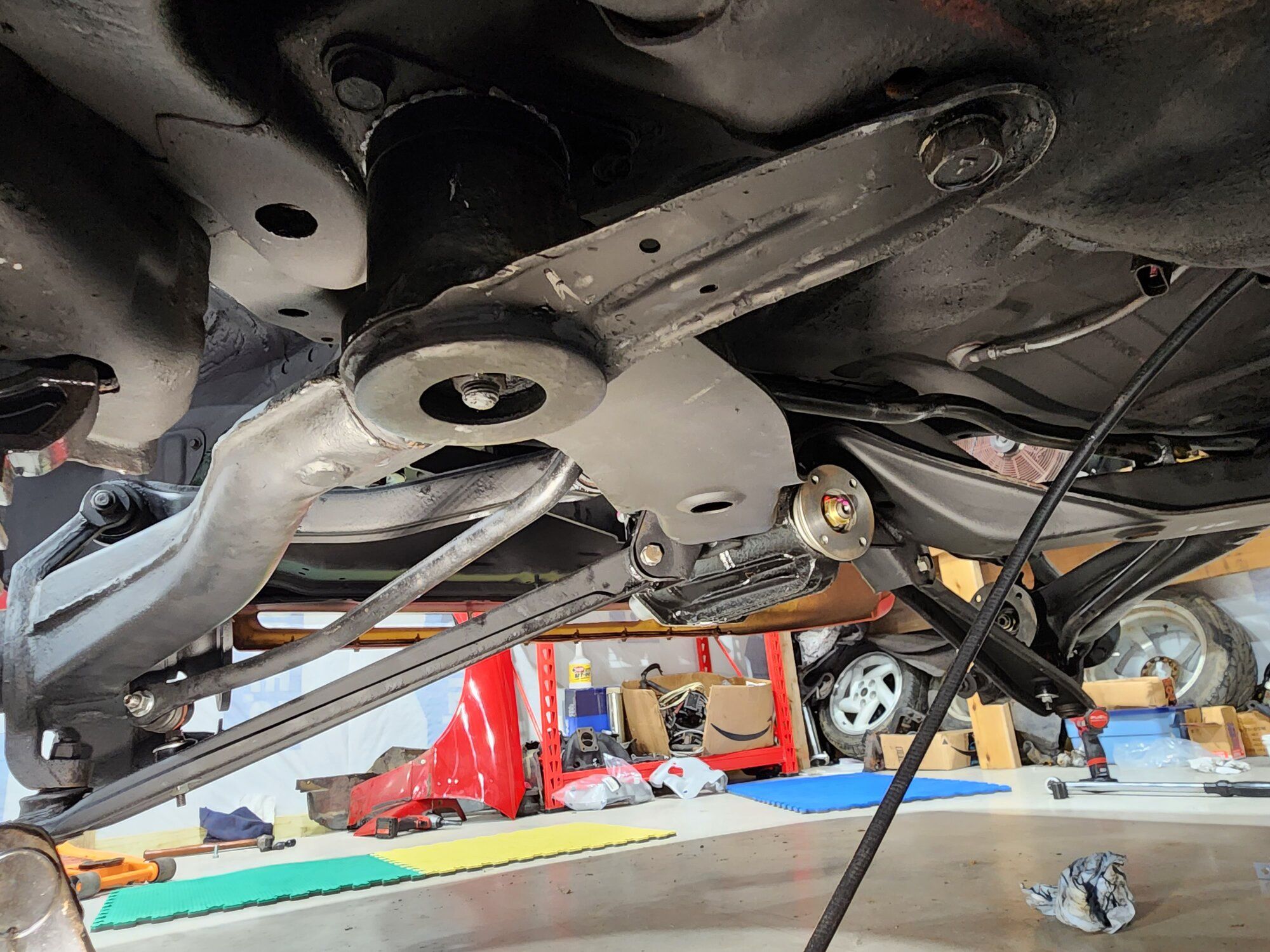

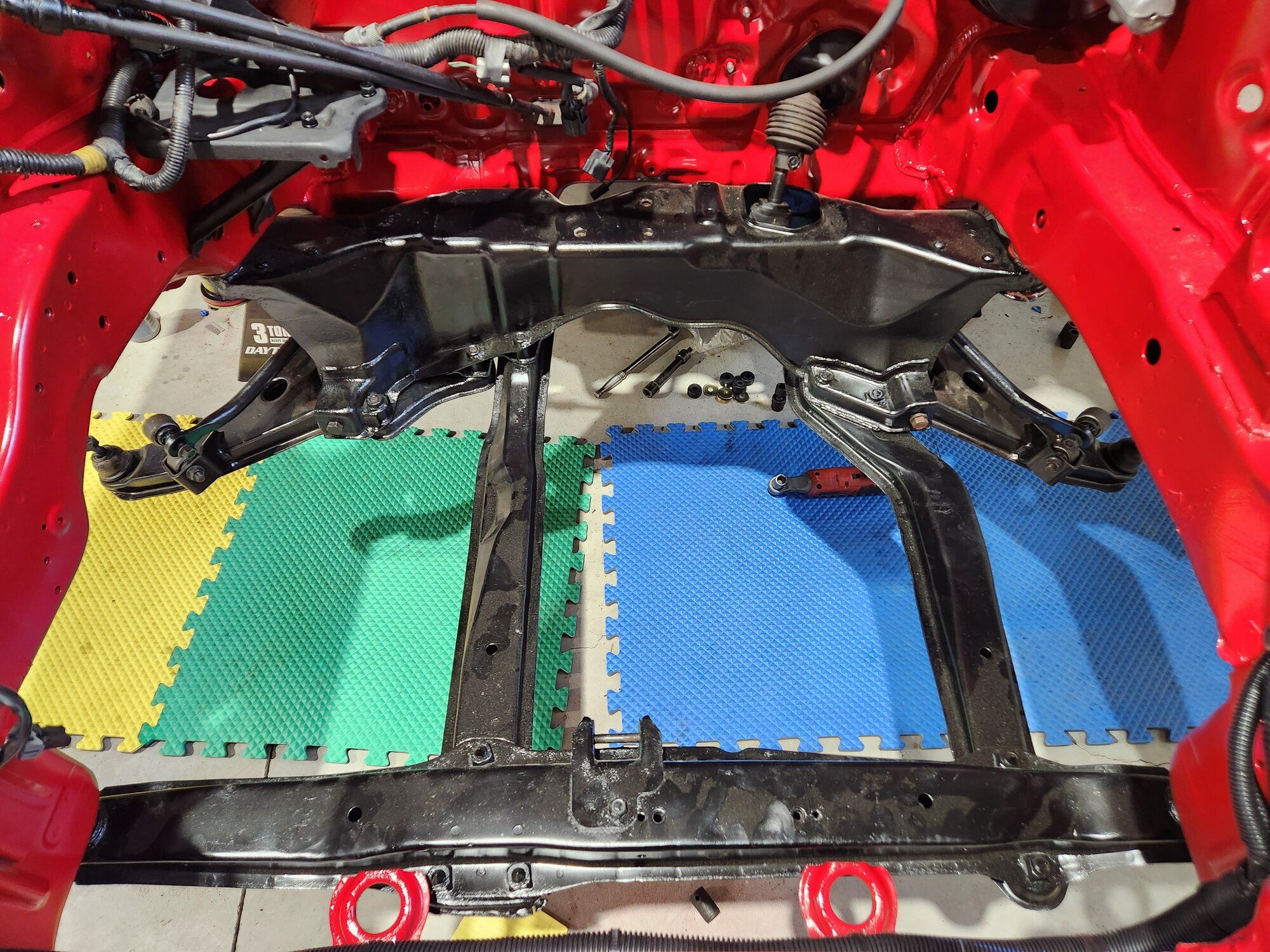

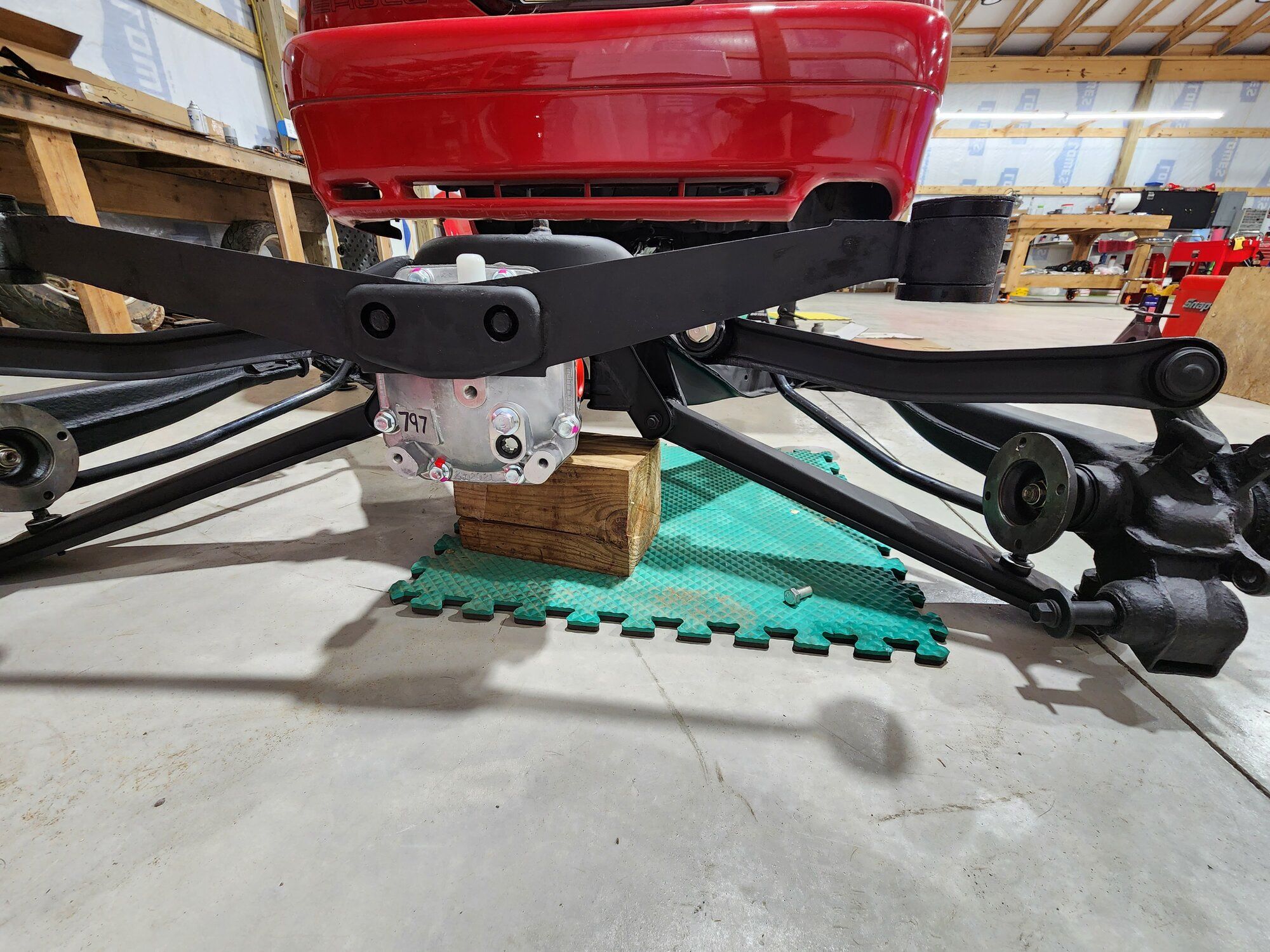

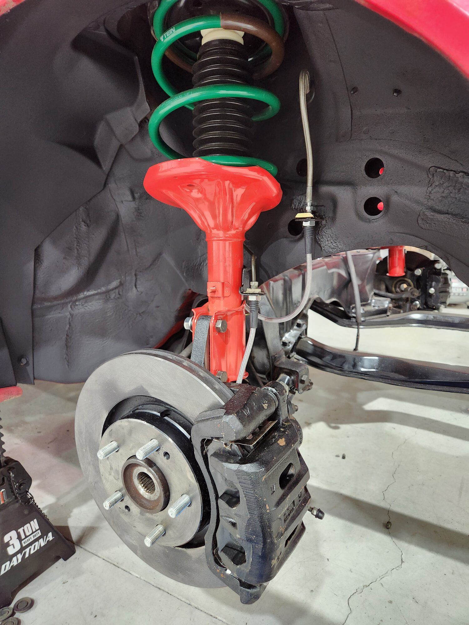

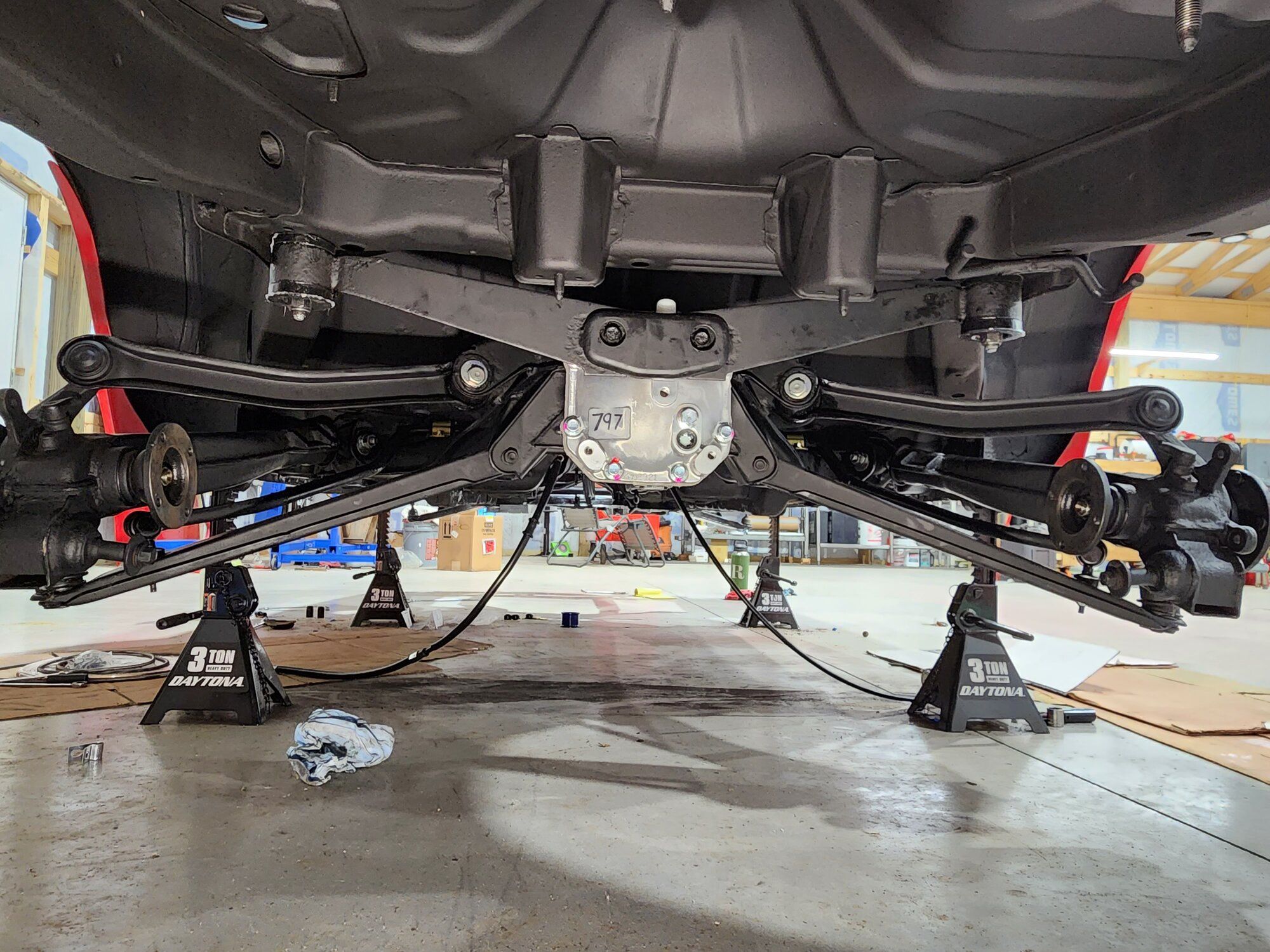

Over the last 2 evenings I kicked it into high gear and got all the bushings lubed up, installed the rack, stabilizer bar, and control arms and got everything torqued down
Attached the rear diff, mustache bar, bushings, and stuffed that pig in there all by myself. It's pretty amazing how well balanced both assemblies are. Just a floor jack and a couple planks, boom!
Fired up, son! 🤘🤘🤘

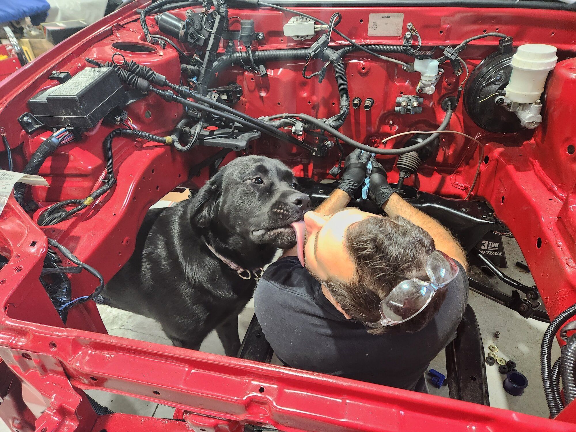

Hey, all! Hope everyone is doing good out there. Been lurking here and wrenching when I can.

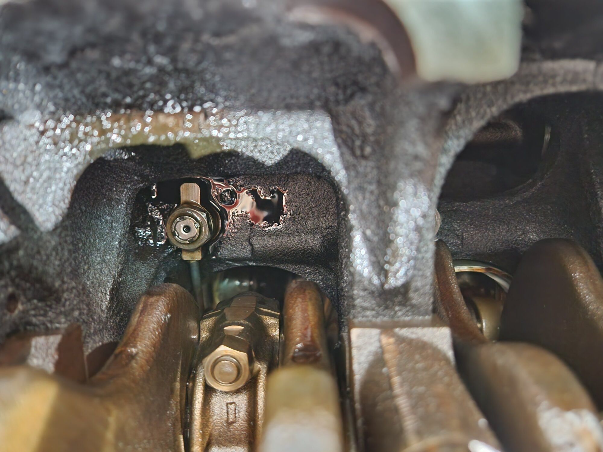

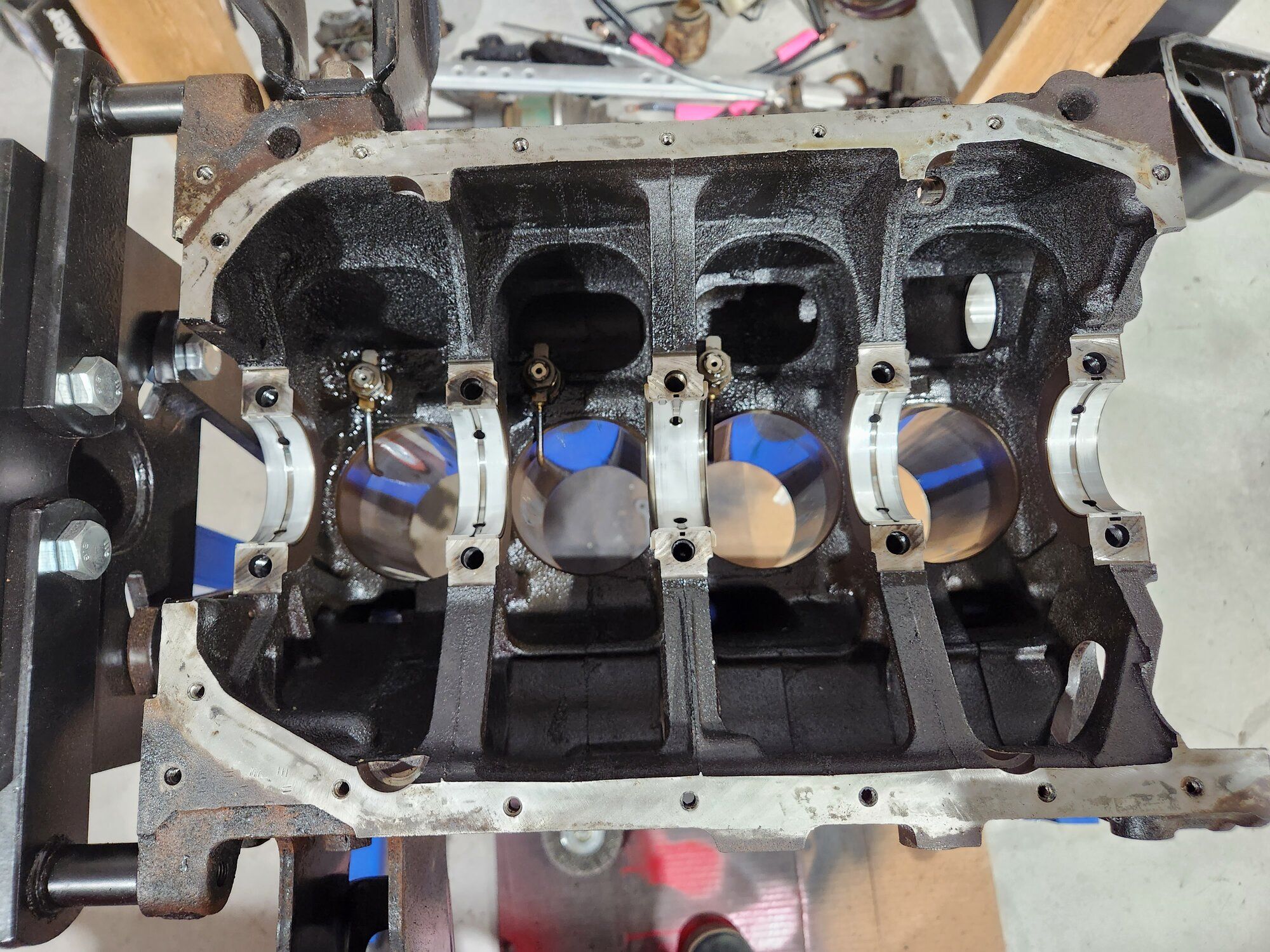

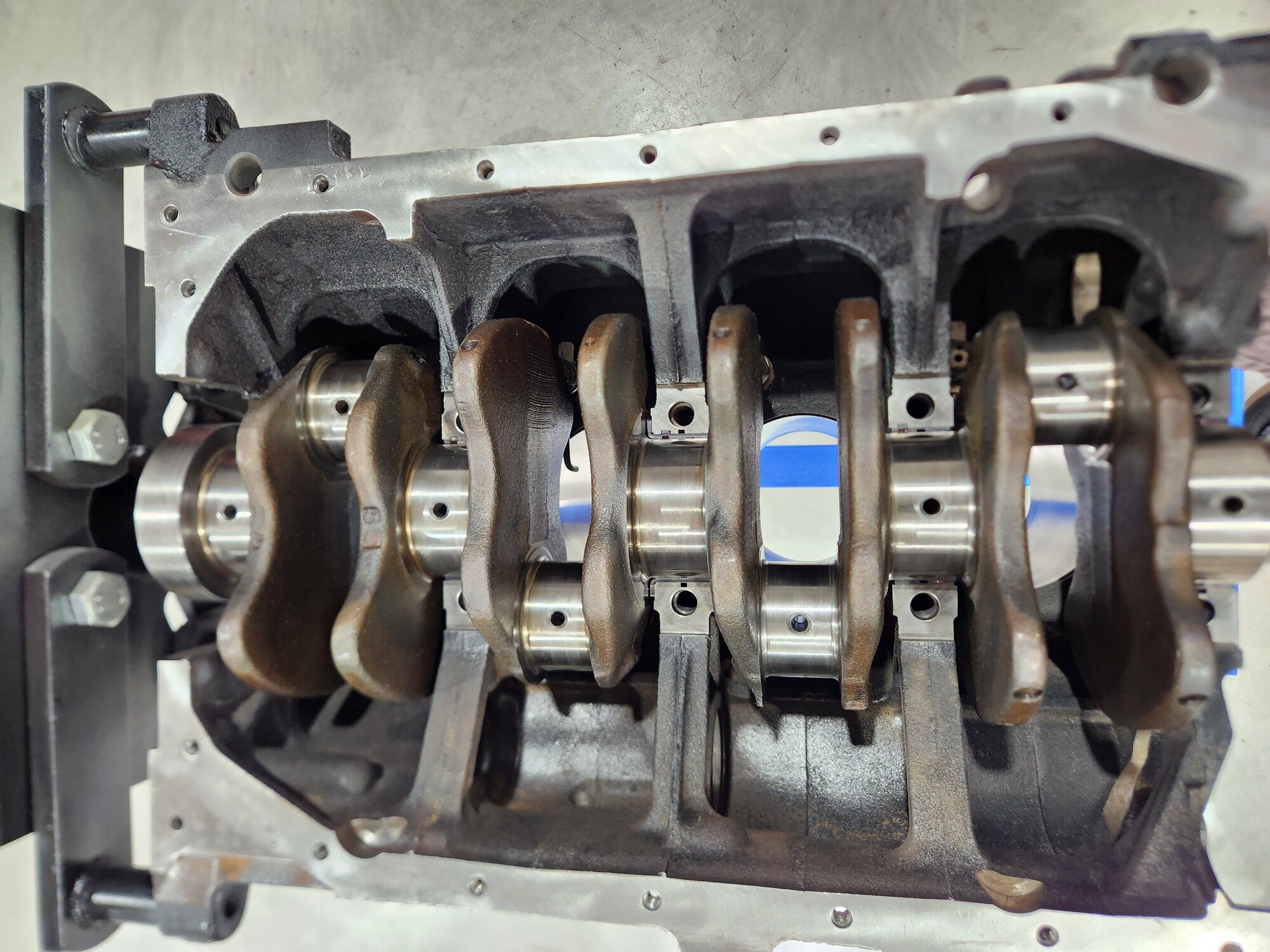

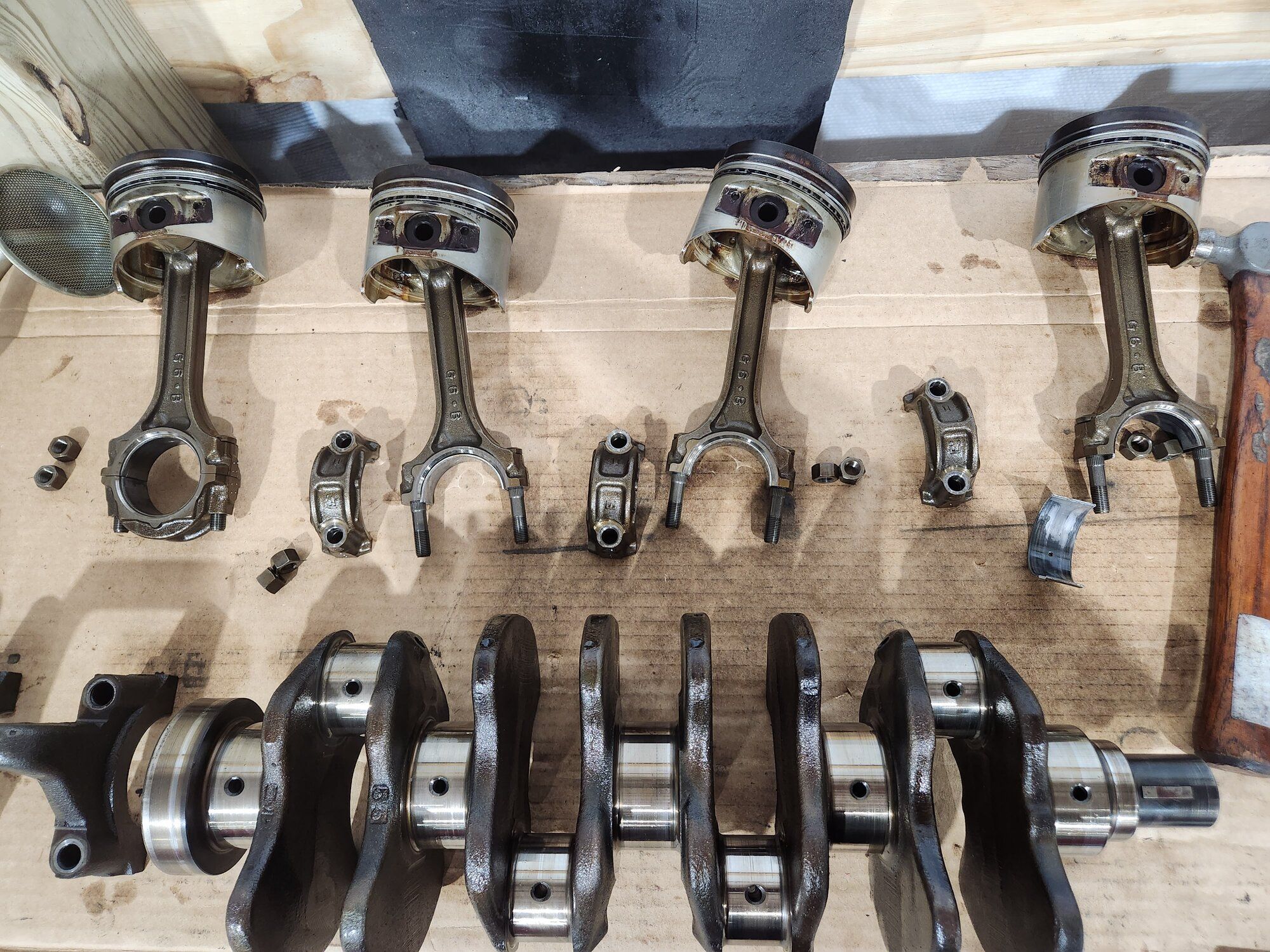

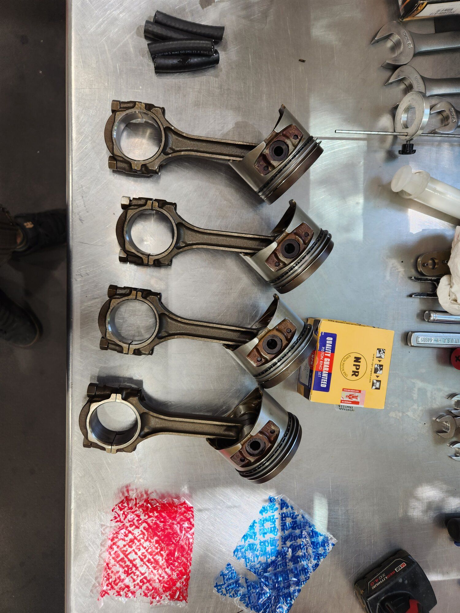

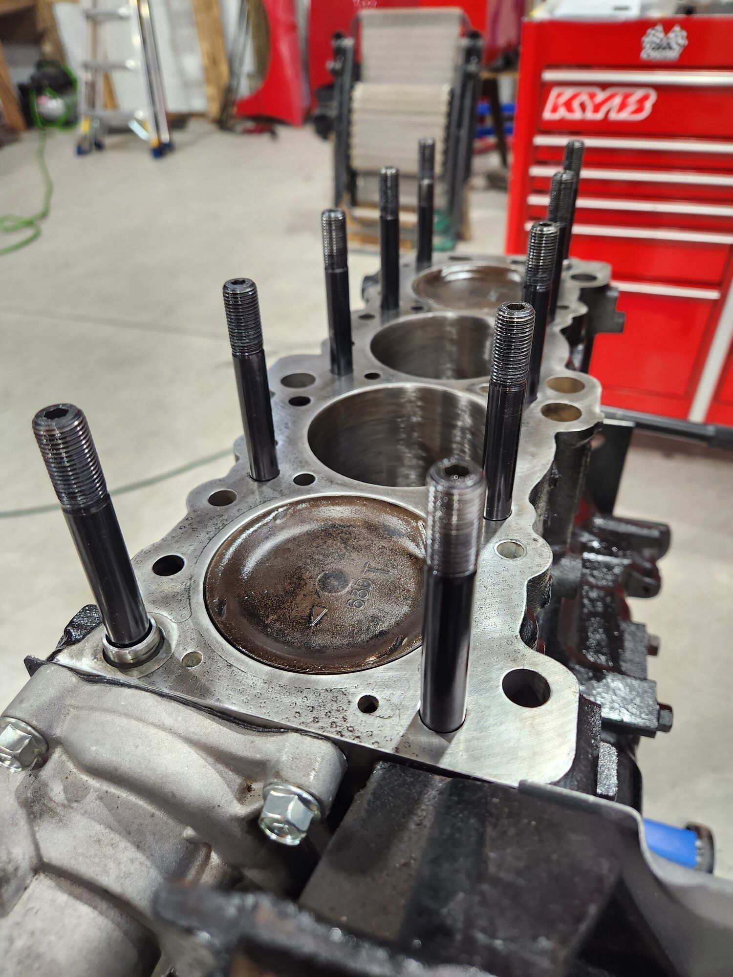

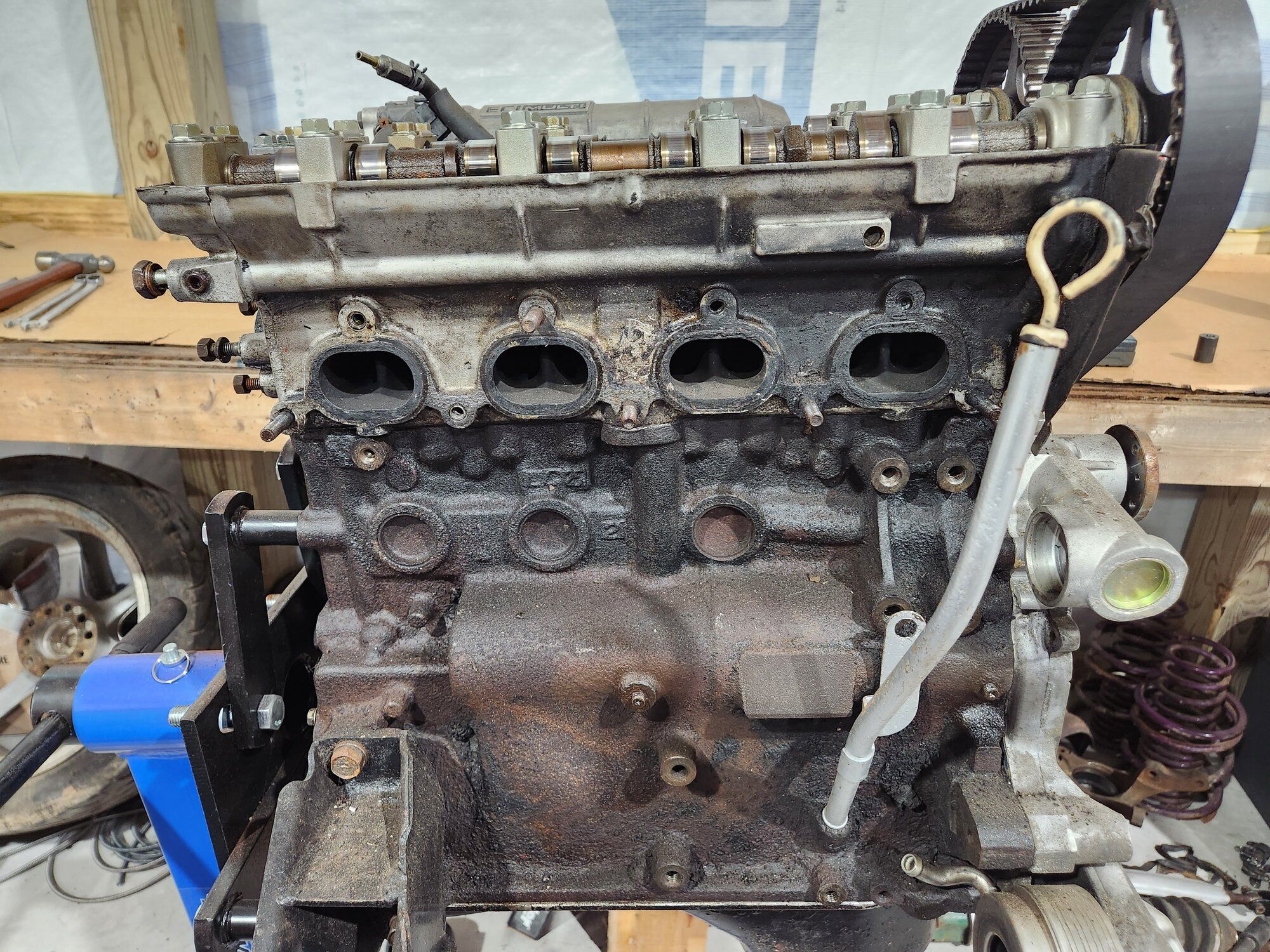

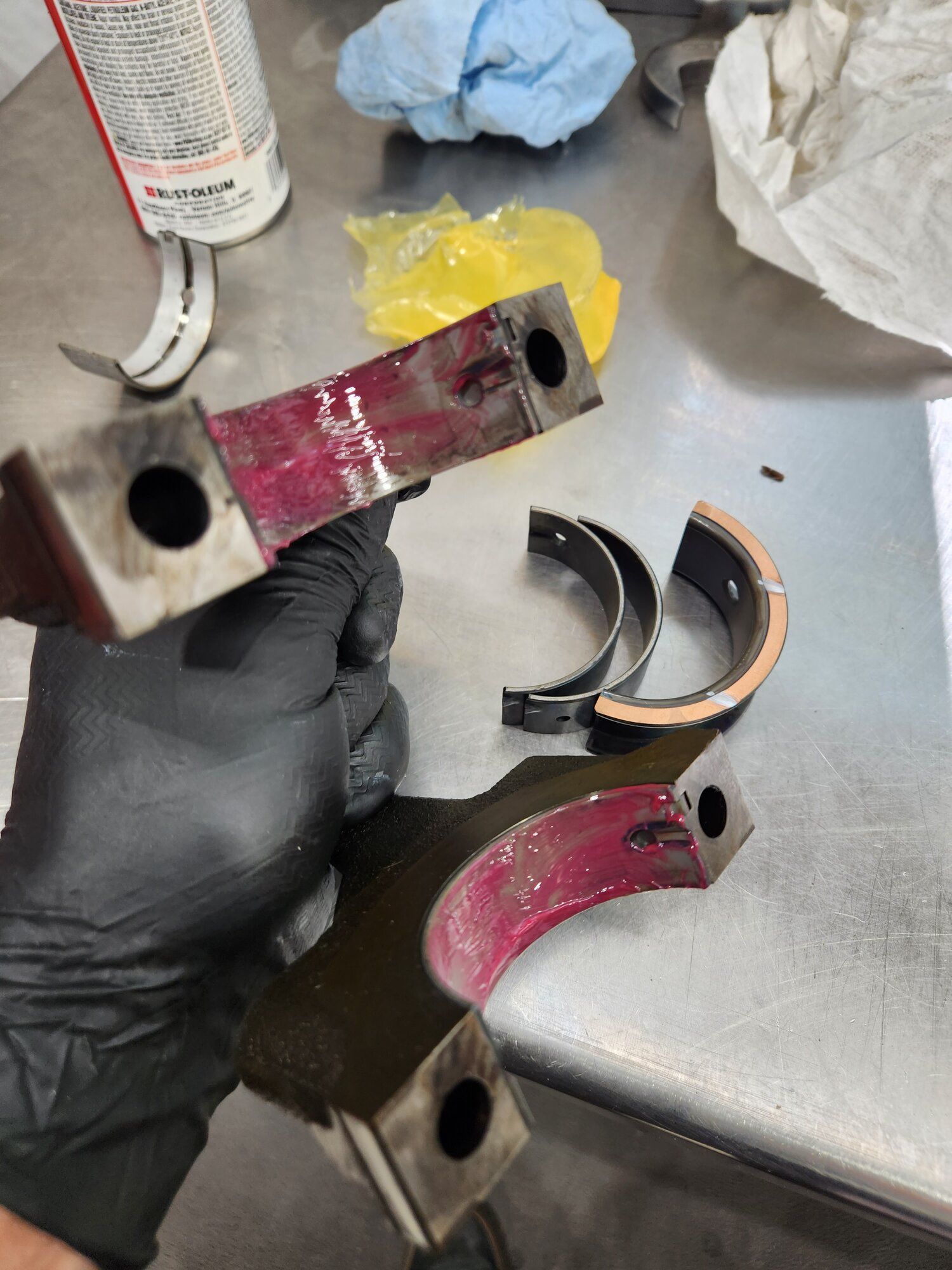

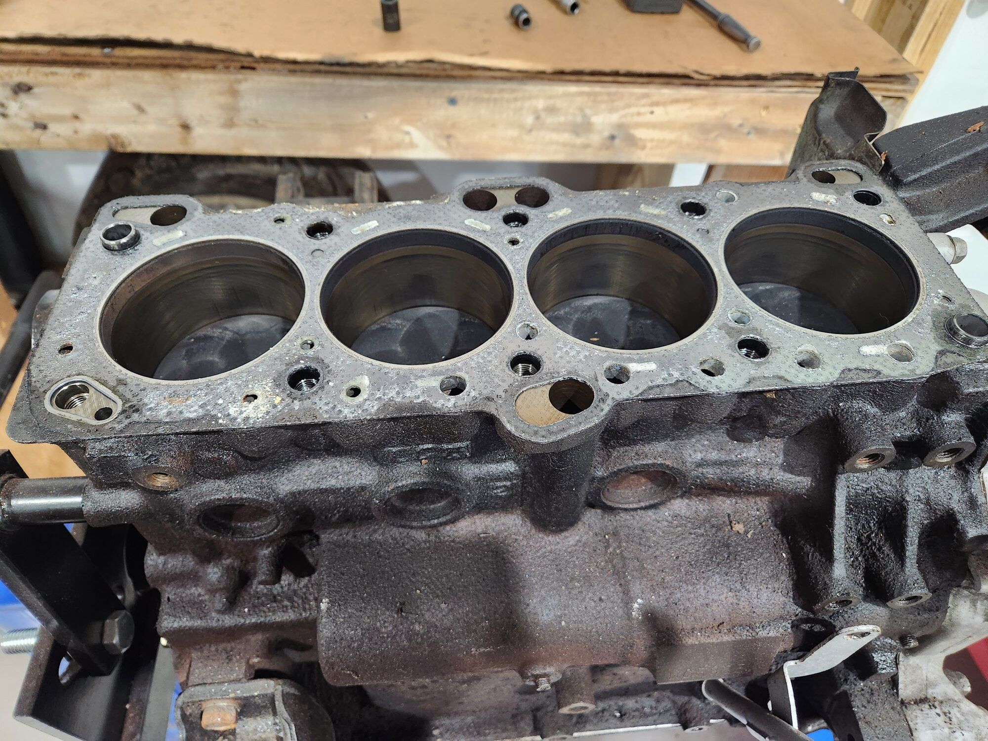

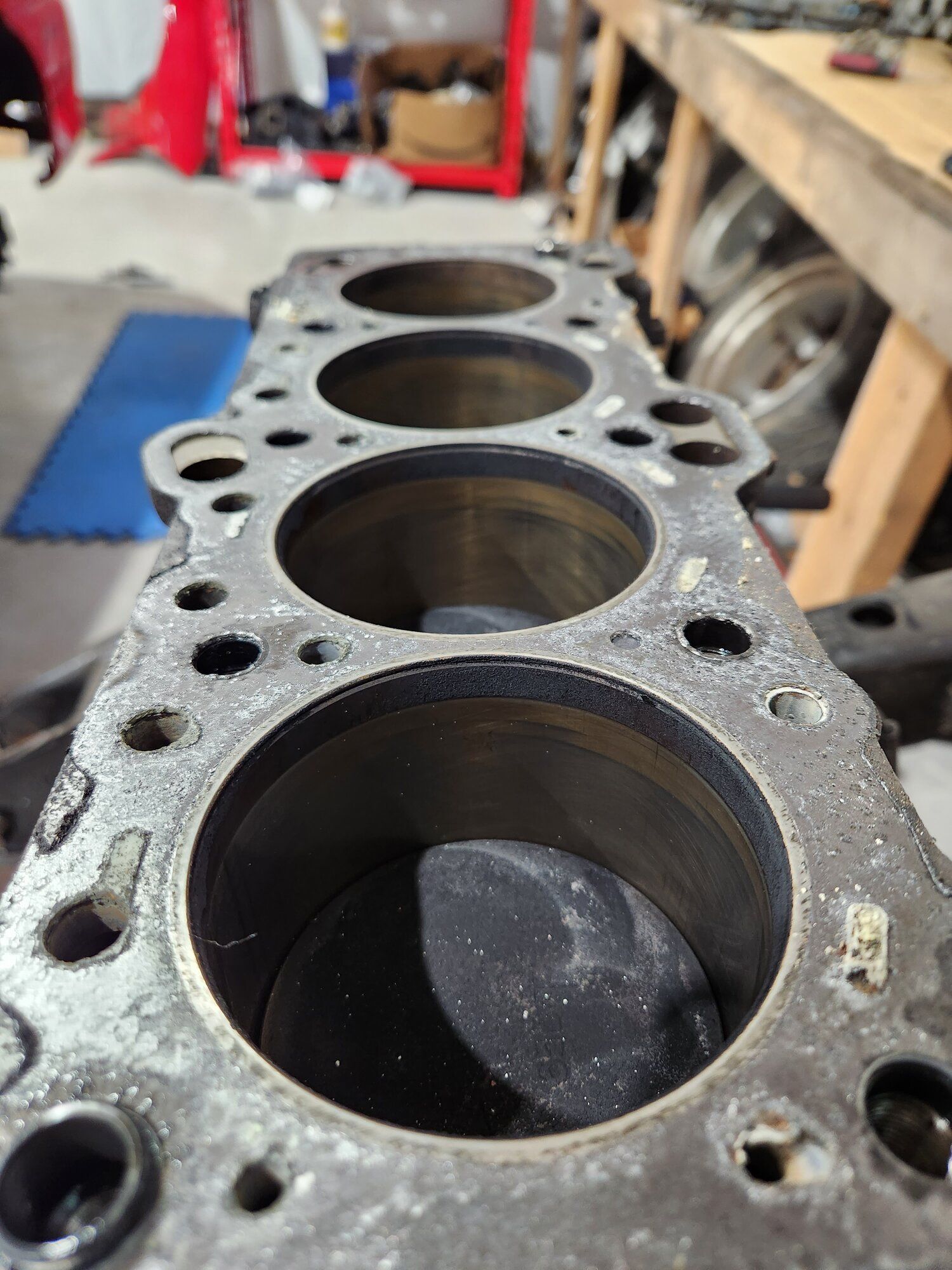

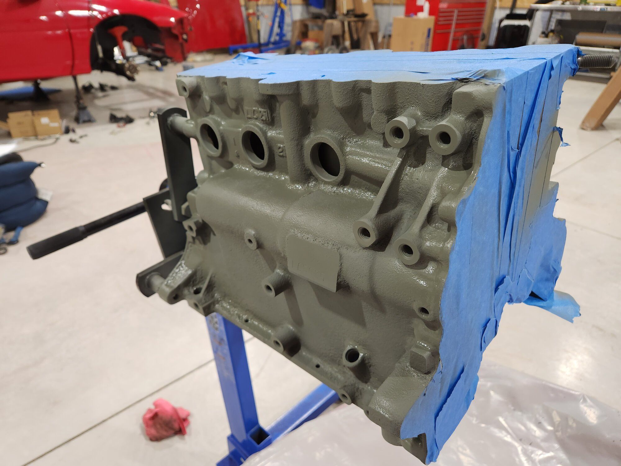

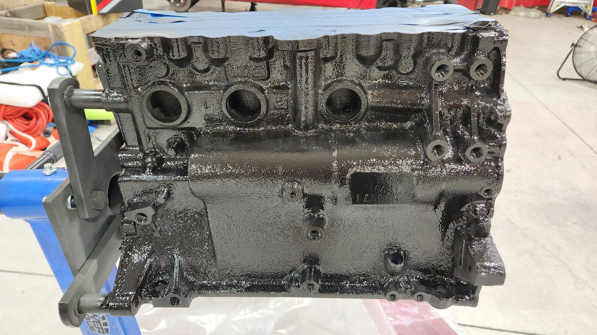

Finally tore into the crusty old beast. Bores look amazing, even the machinist was surprised. You'd never guess by looking at the outside, she was a dirty bird! Lmao.
Koda Bear with the cameo and helping hand. Haha.

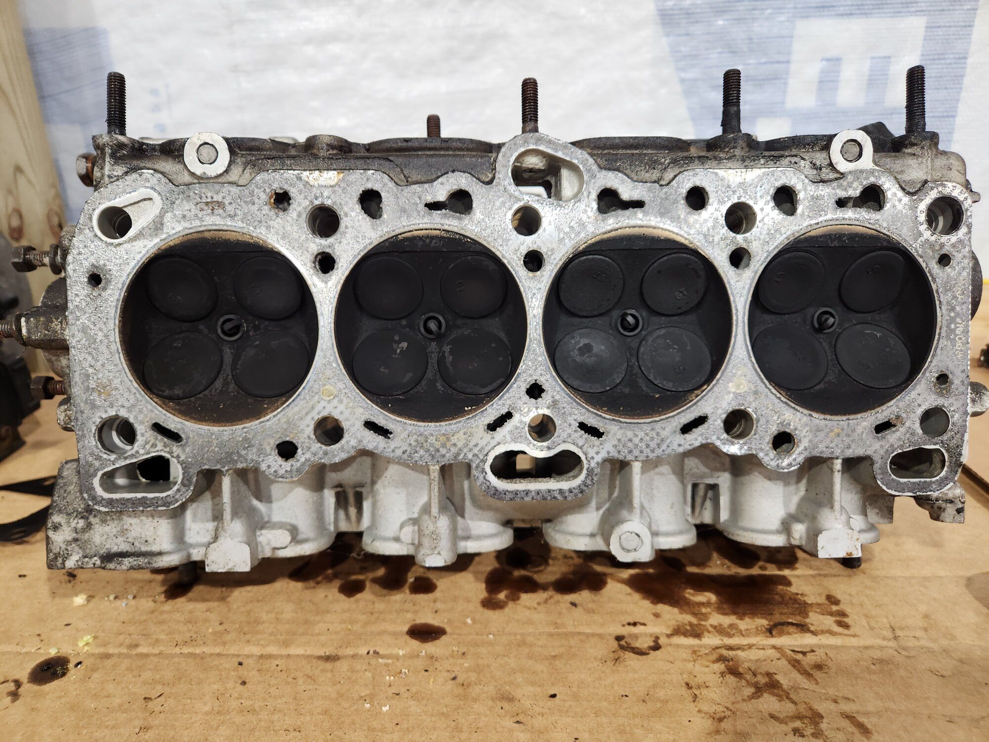

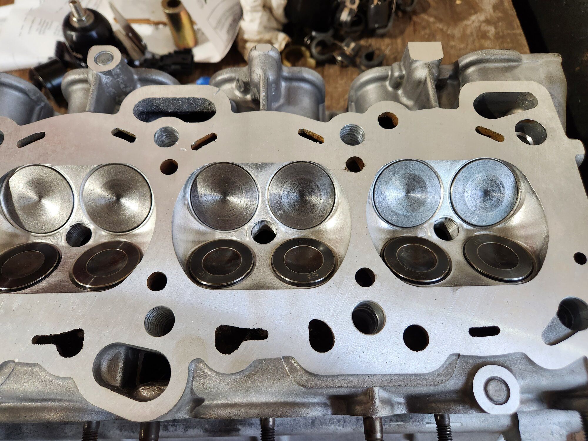

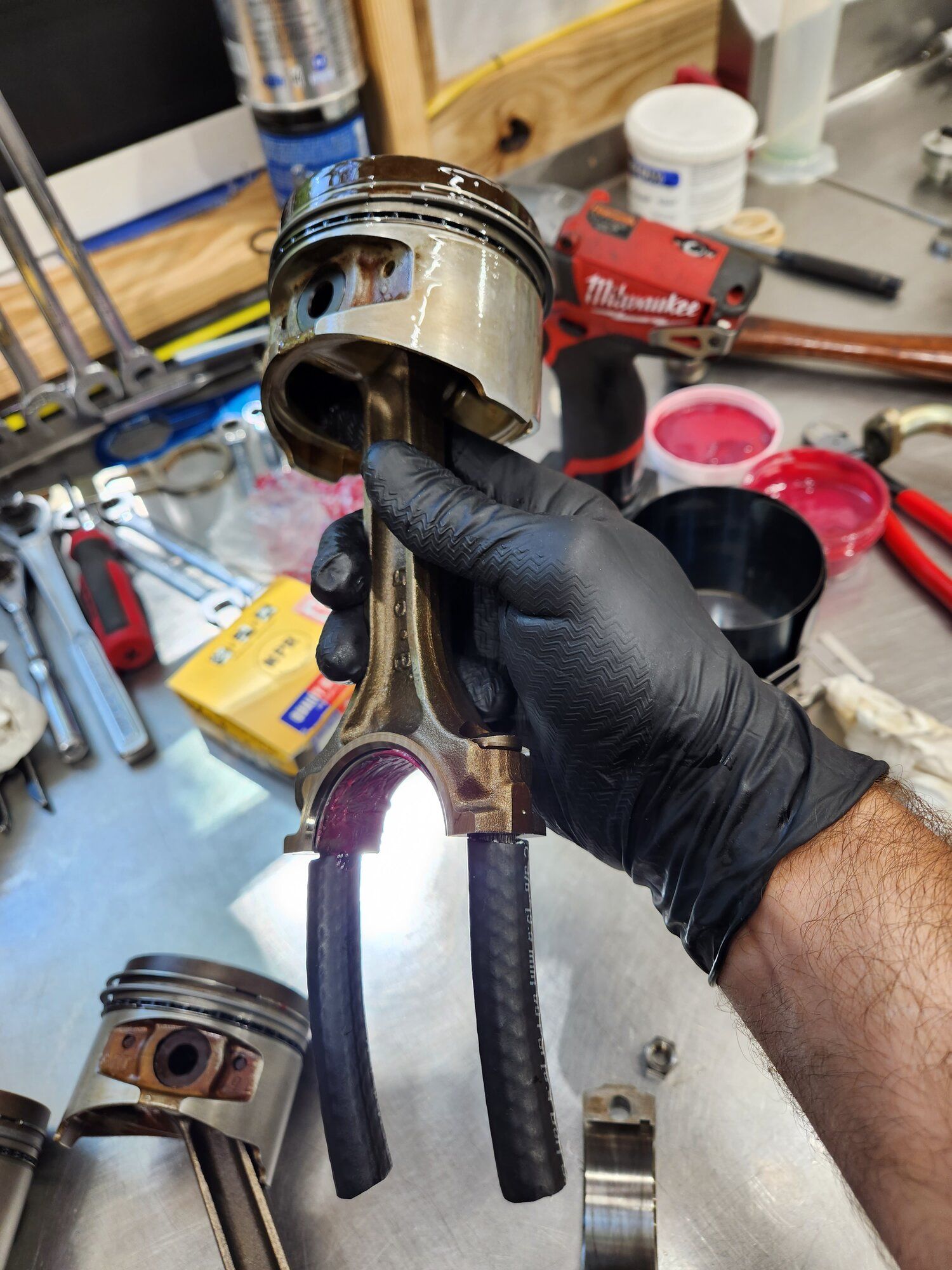

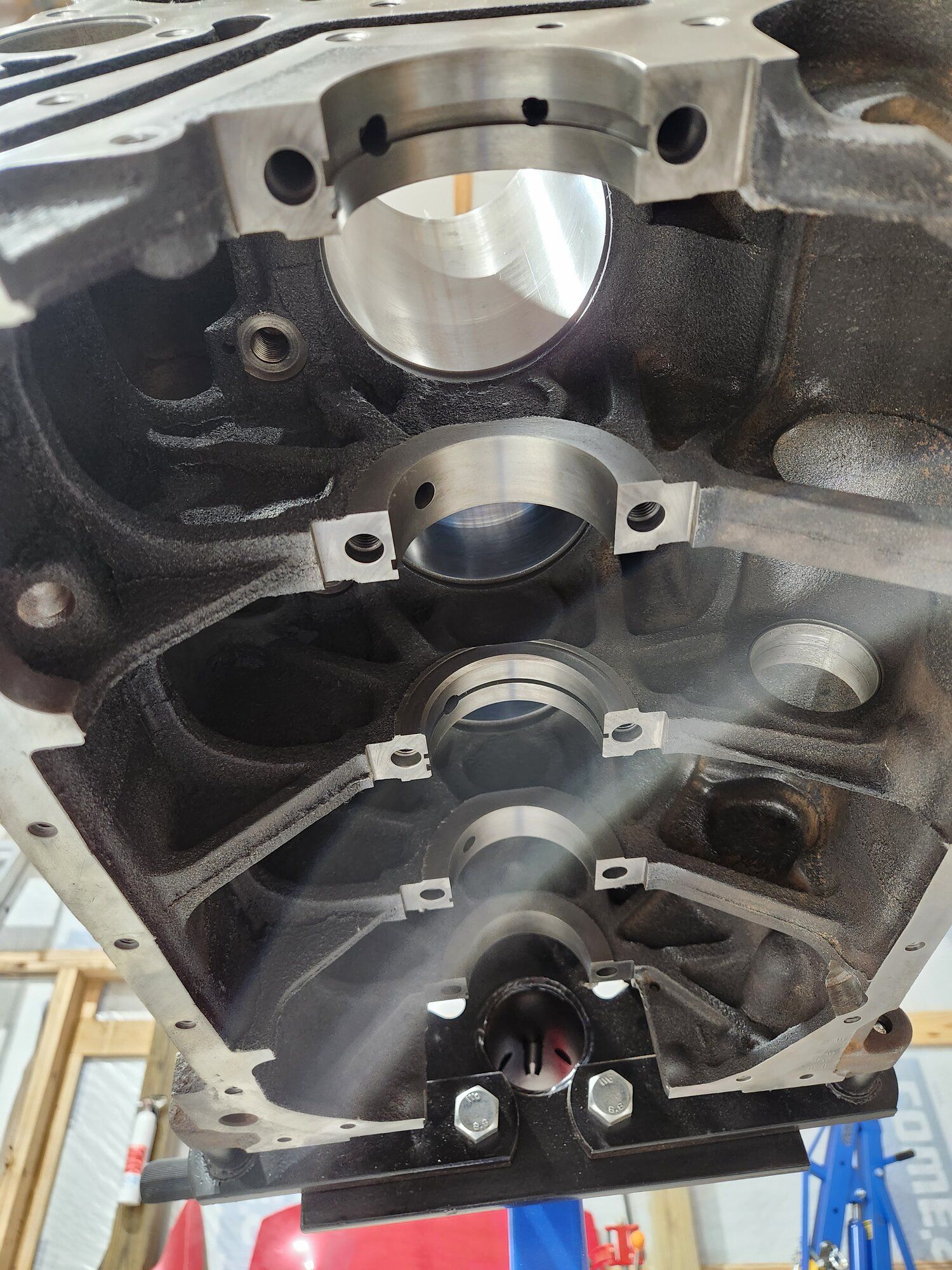

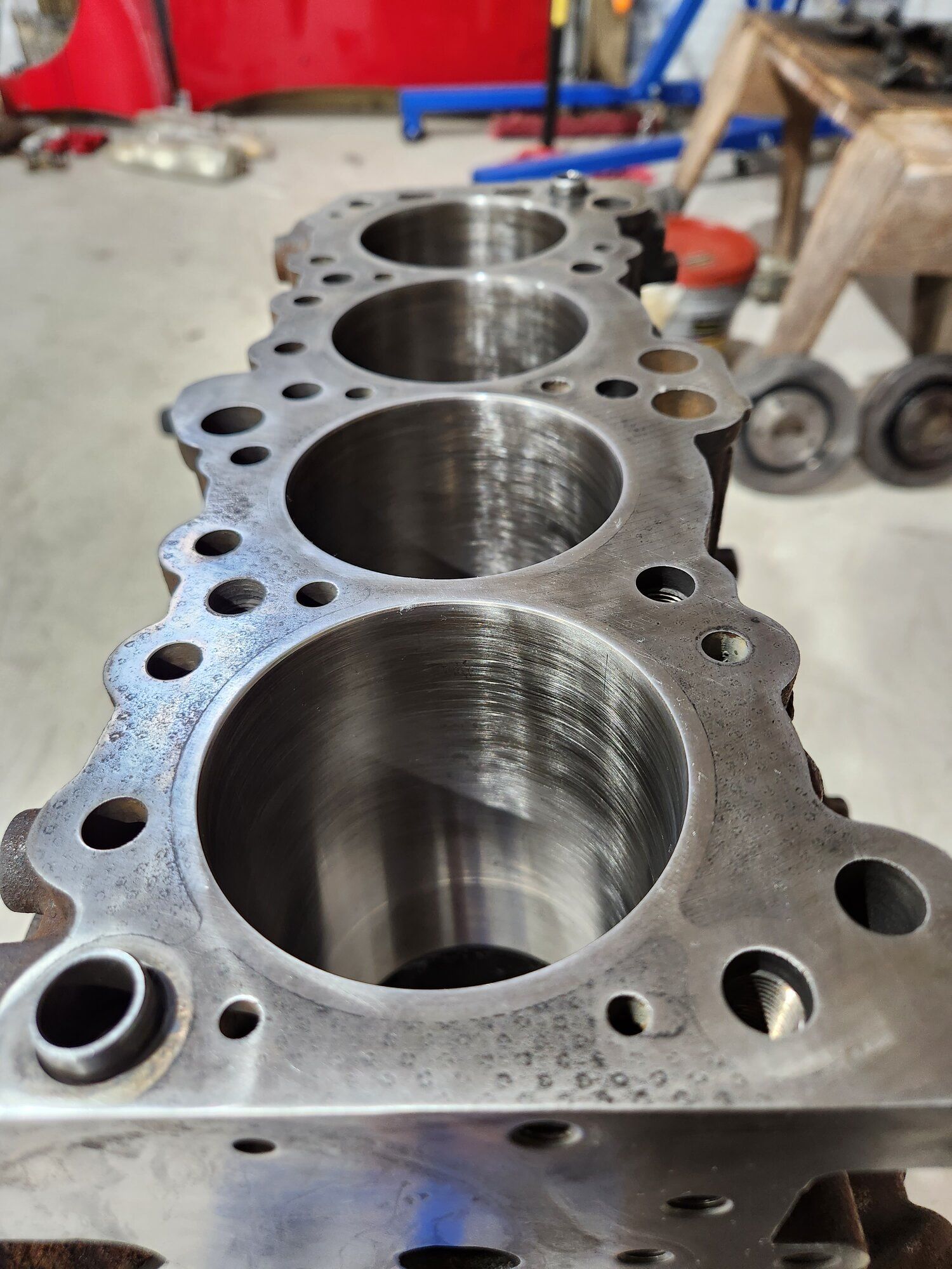

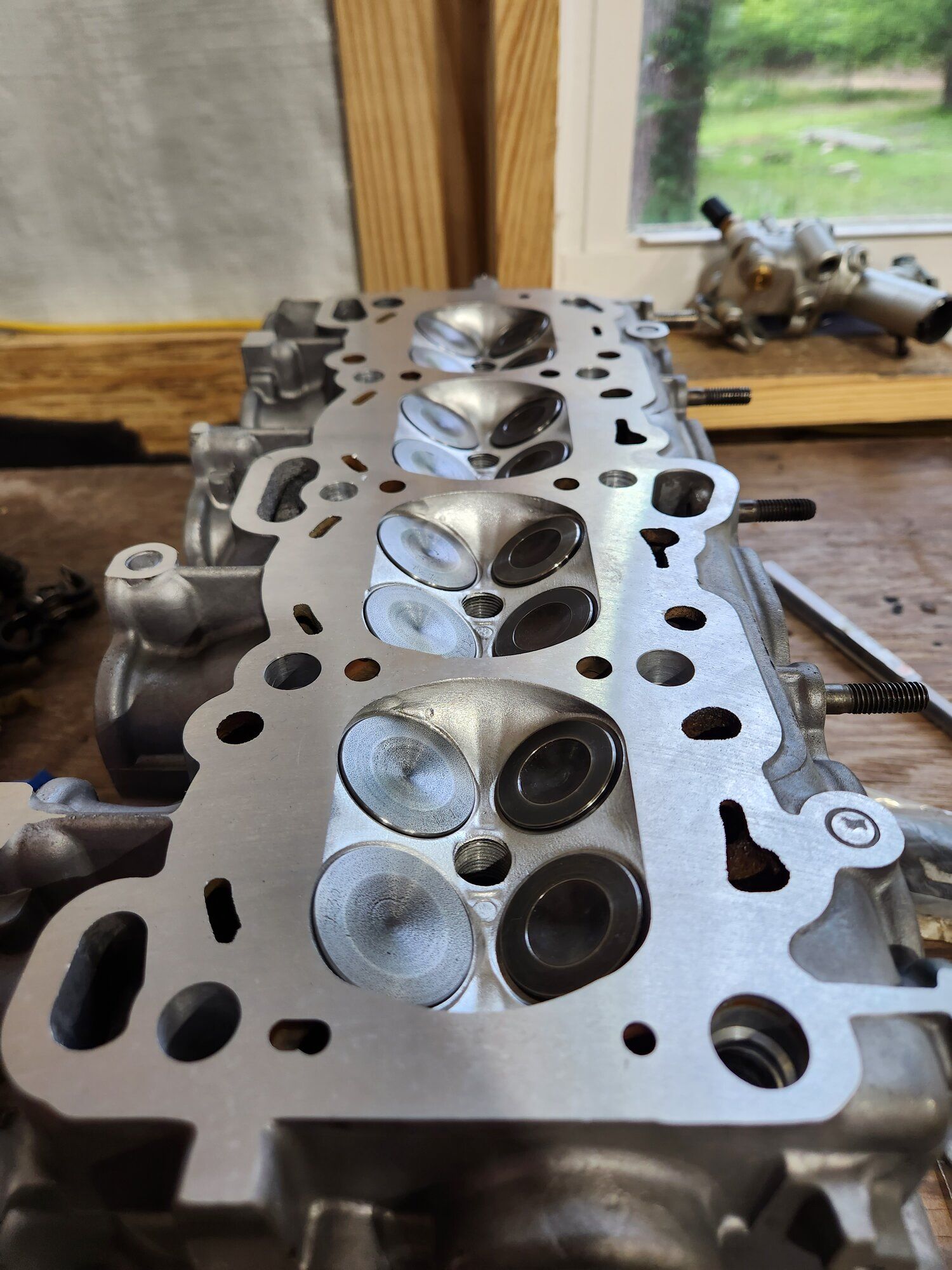

Cleaning up nicely! I just had the machinist hot tank the block, straighten the head and do a valve job. Cleaning up the pistons next. New rings and bearings for a freshie!

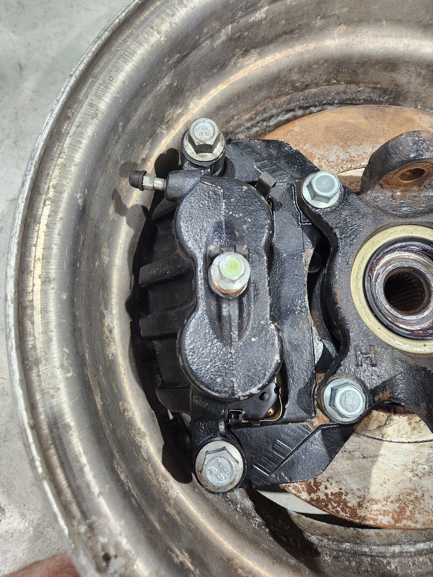

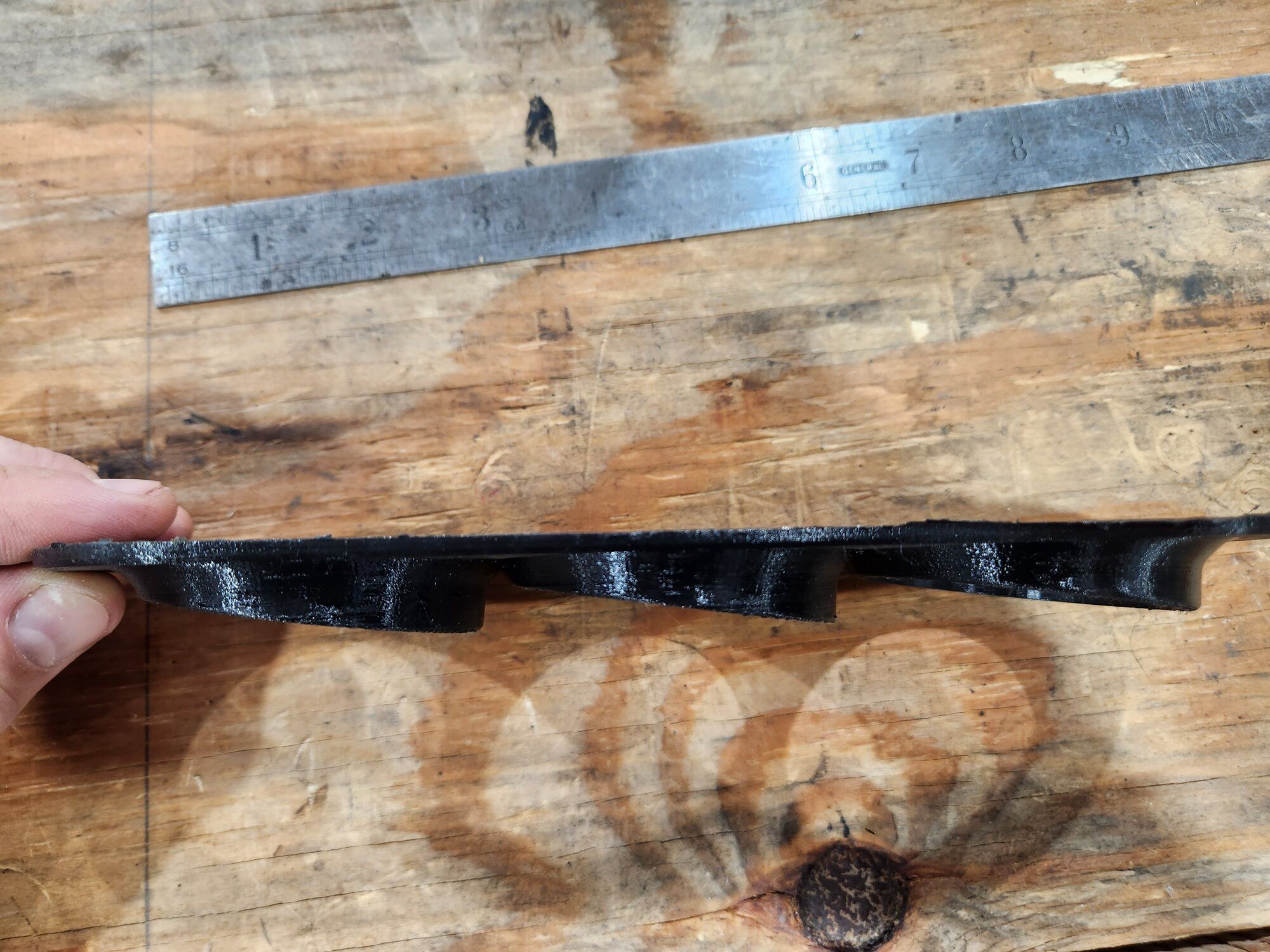

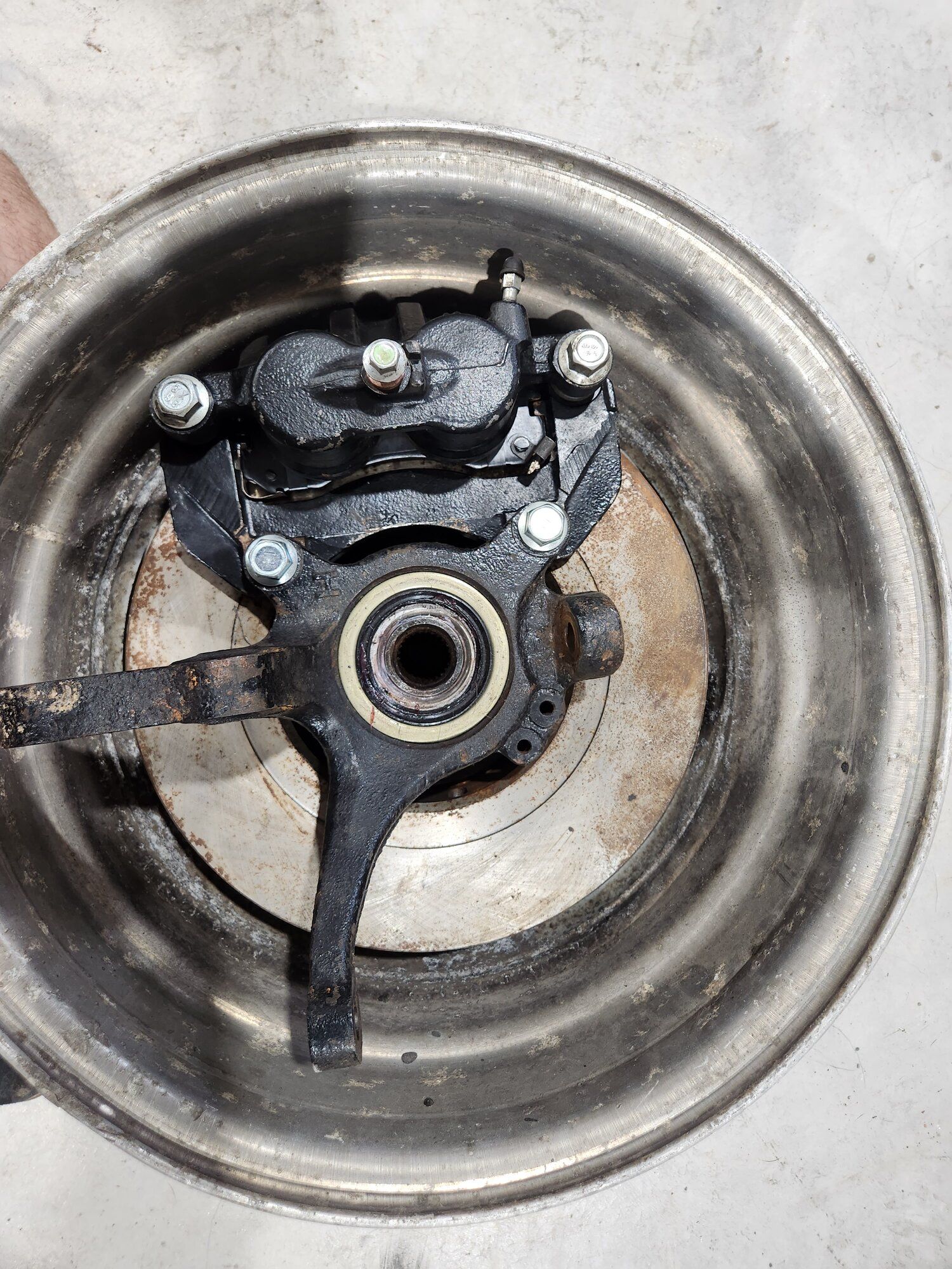

Picked up some crusty and slightly bent/small flat spot rims off Flea-bay. Had to see for myself if the big Outlander brakes were going to fit!

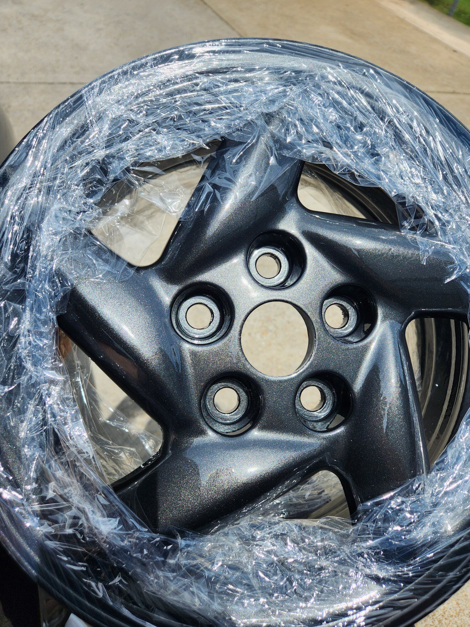

Took the rims a couple weeks ago to my wheel and powdercoat guy to have them blasted, fixed/straightened and powdercoated. I am so stoked to see how they turn out!!! Doing something a little different and can't wait to show you all. 🤘🤘

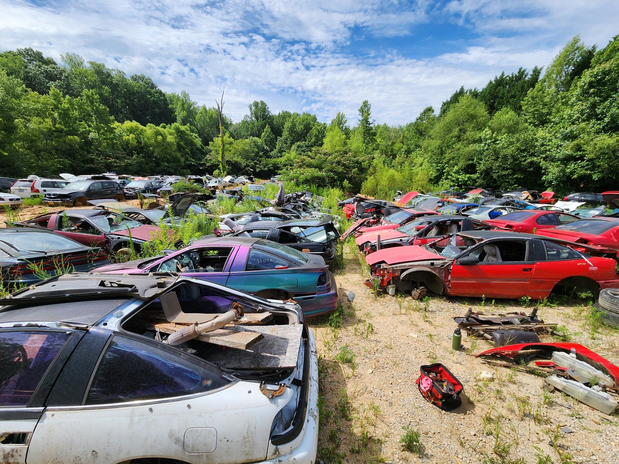

Stopped by Miller Import parts in Kannapolis, NC over the 4th while out seeing a buddy and snagged up a couple necessity items for the Talon. What a great resource!

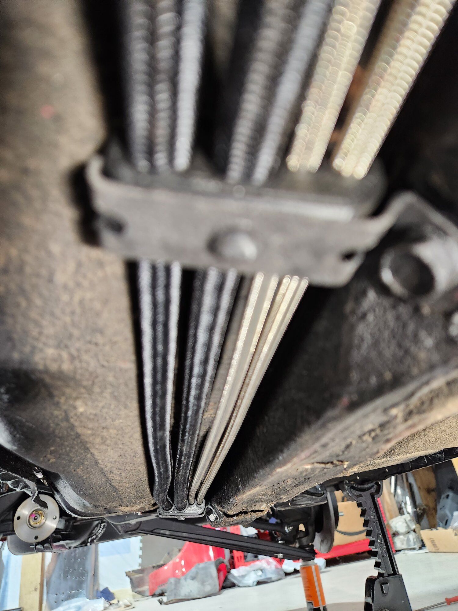

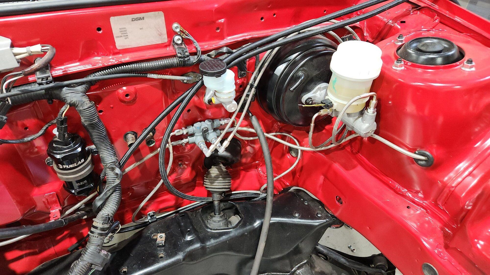

Finished running all the lines underneath and wouldn't you know it, the 2 braided lines from the rear fit just fine! Brakes all bled and 3G MC installed.

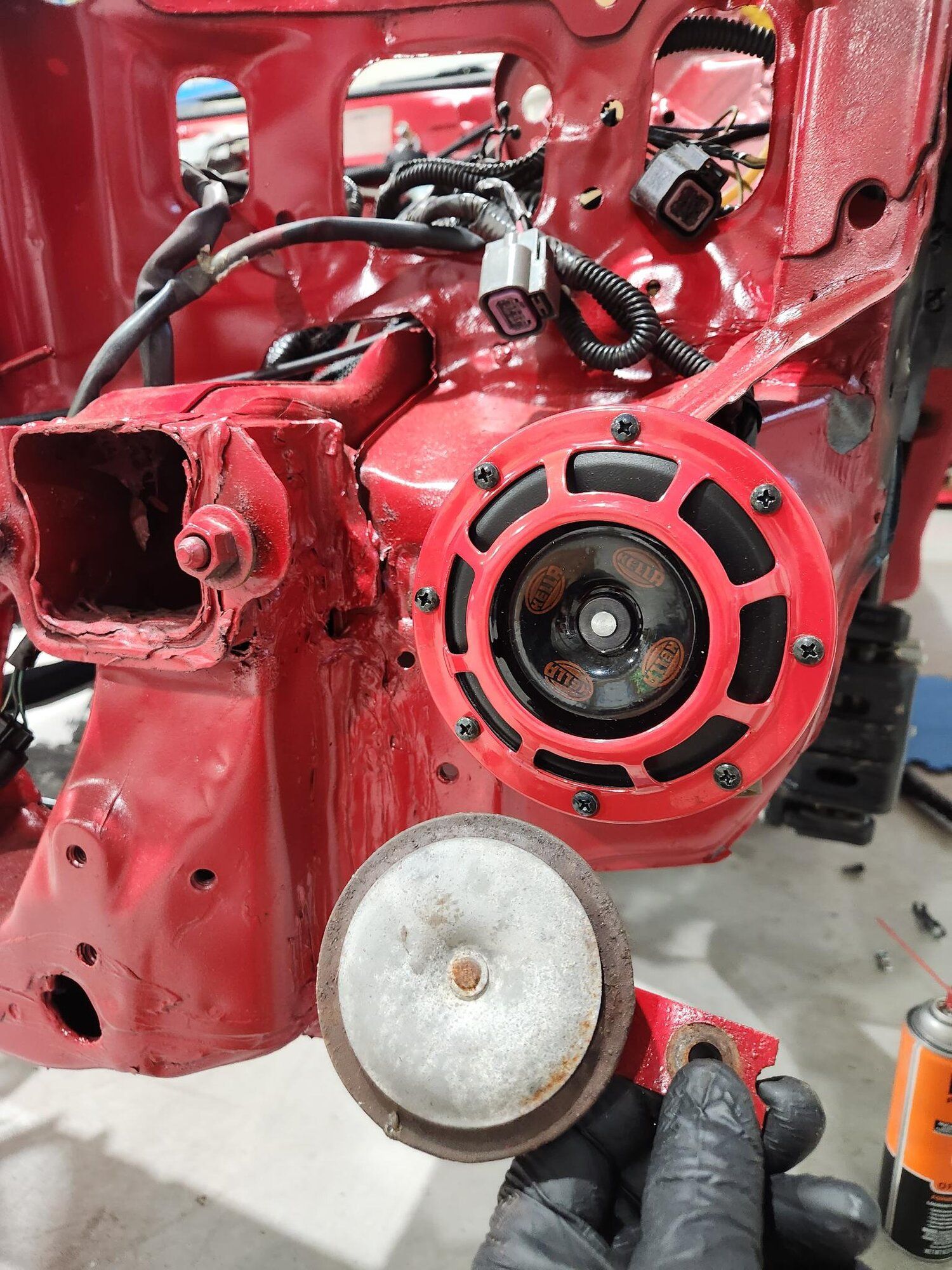

I saw @Silverspyder with the Hella horn upgrade and pulled the trigger on the same. Those stock horns had to go.

DOT 5.1 for that higher boiling point. Little motorcycle trick there instead of DOT 3 or 4.

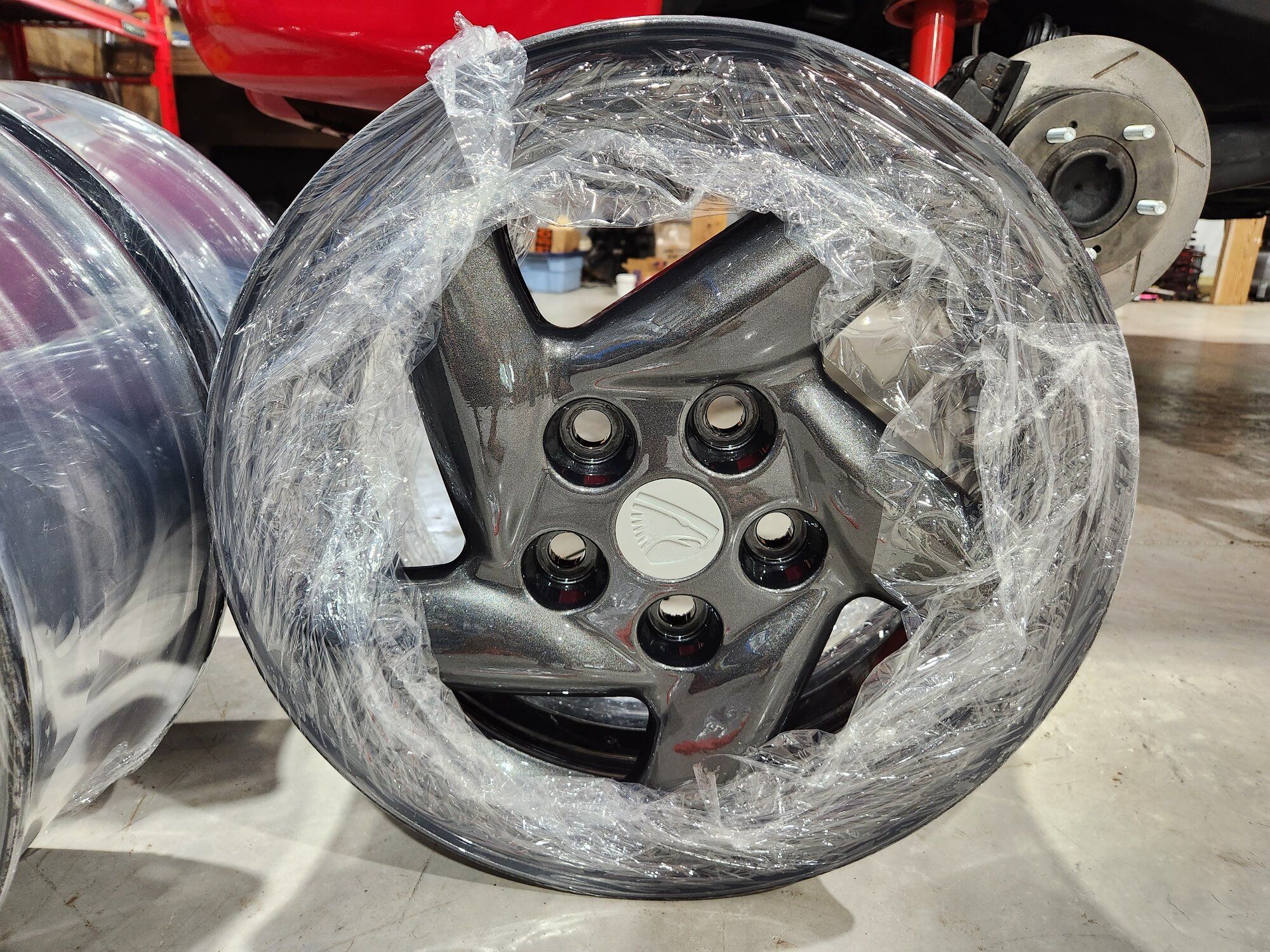

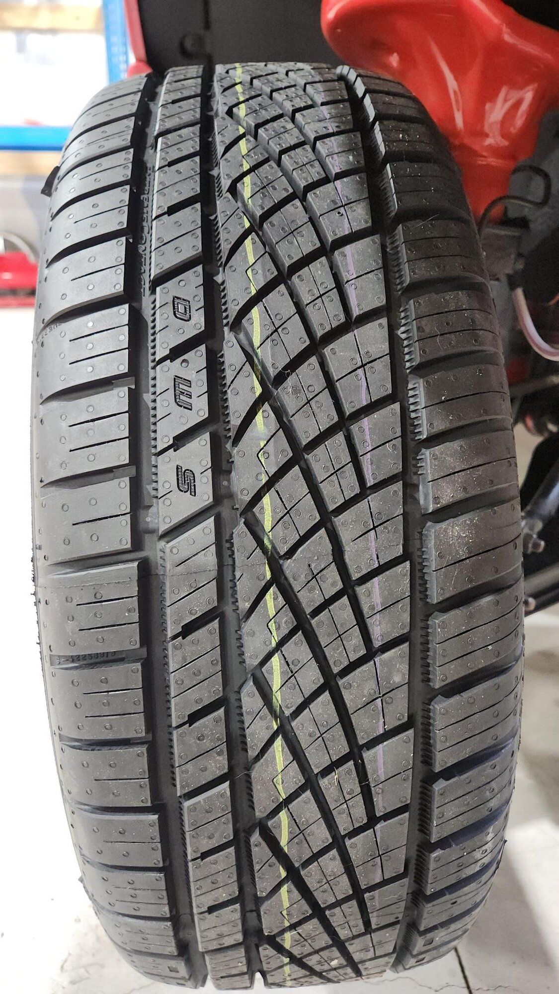

Sneak peak on the freshie powdercoated OG 1GB rims with fresh Continental Extreme A/S rubber!
I plan to drive this car as much as possible, so that means A/S tires for now. Surely the safest bet once the weather turns cold.
Next year, Feal coilovers, 27mm offset 17x9 fatties with the sticky track rubber for autox and road course. Antique DSM style, baby!!!

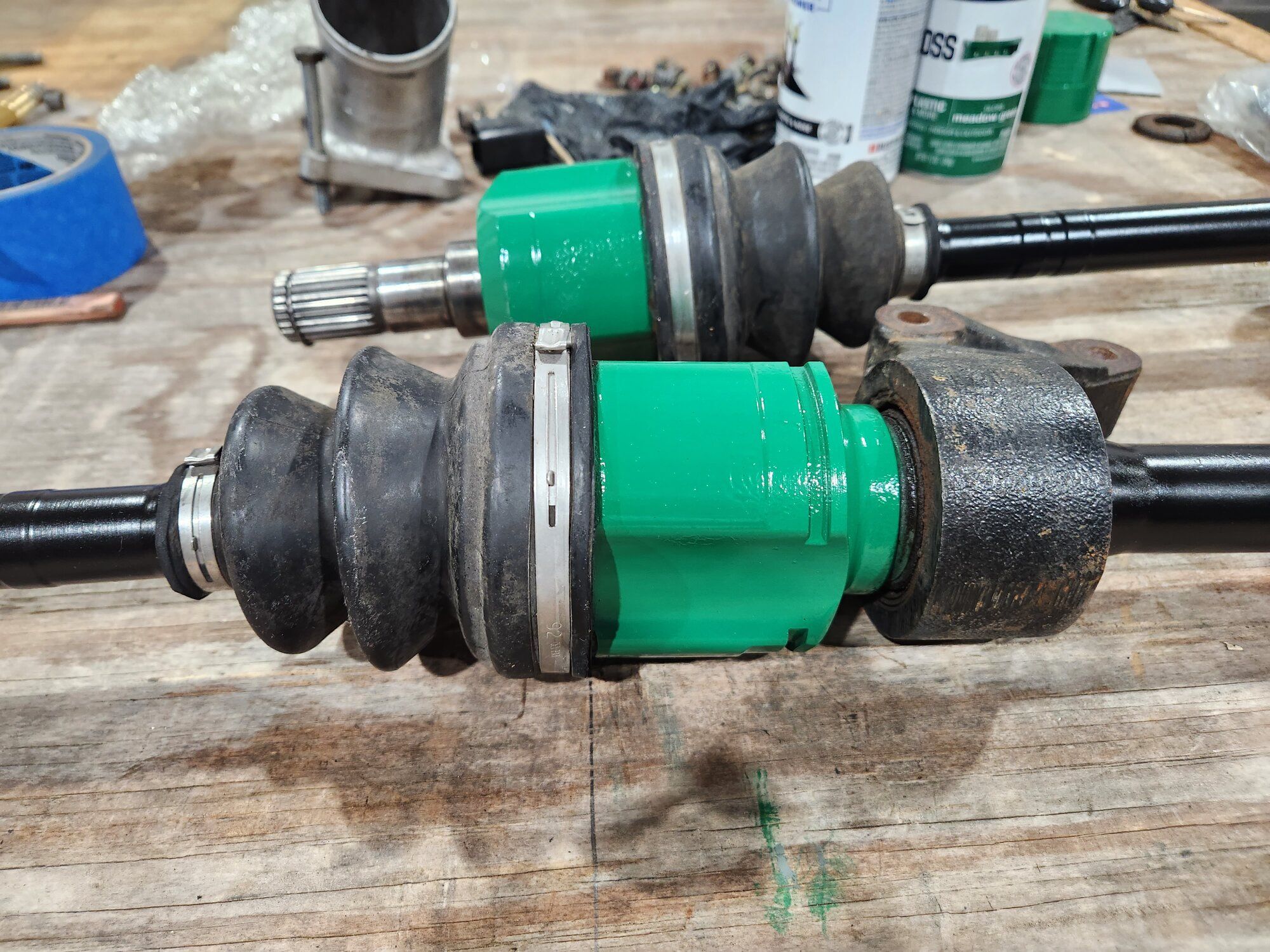

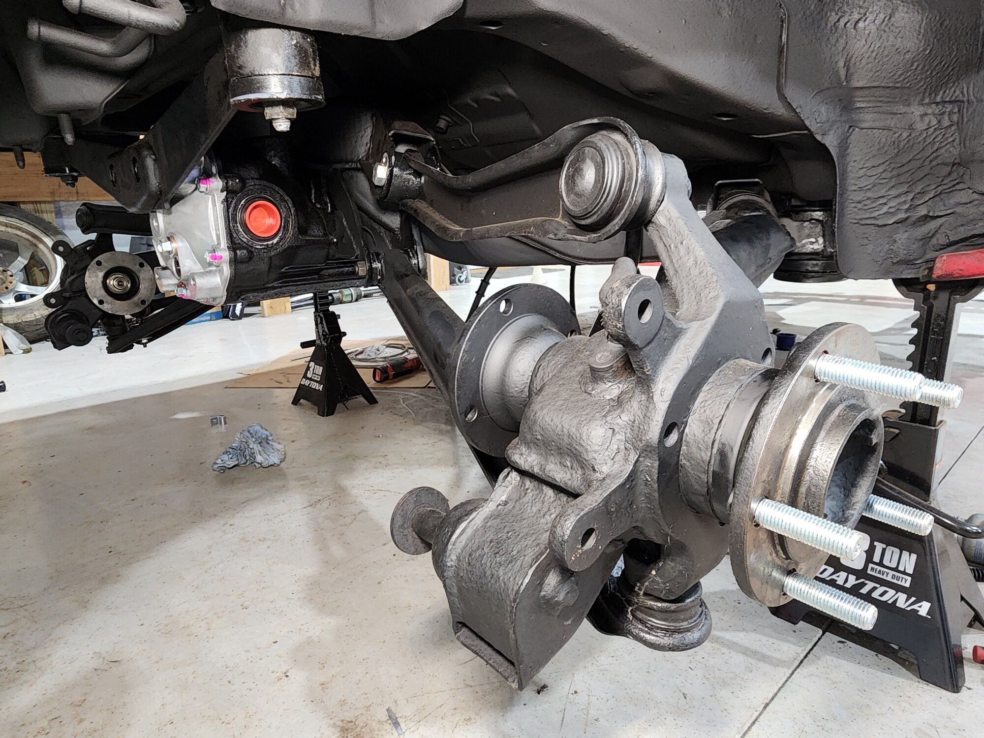

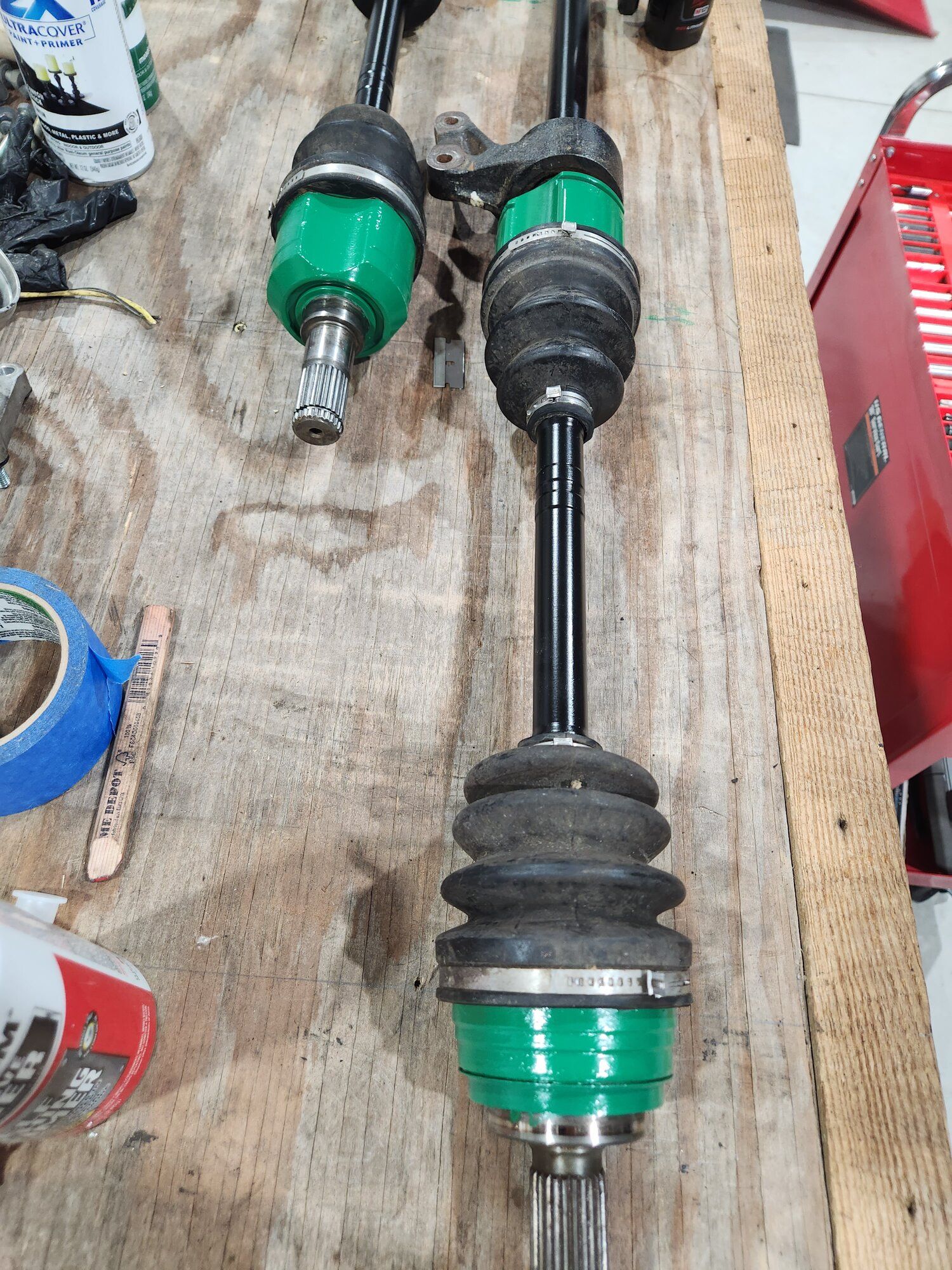

Just a quick front axle makeover;

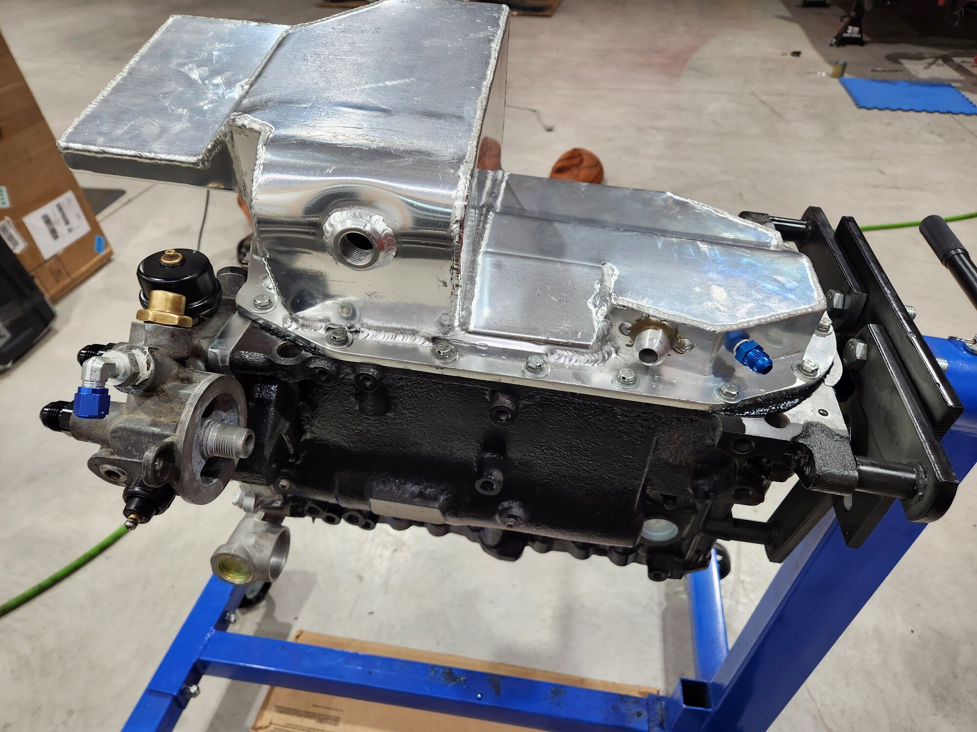

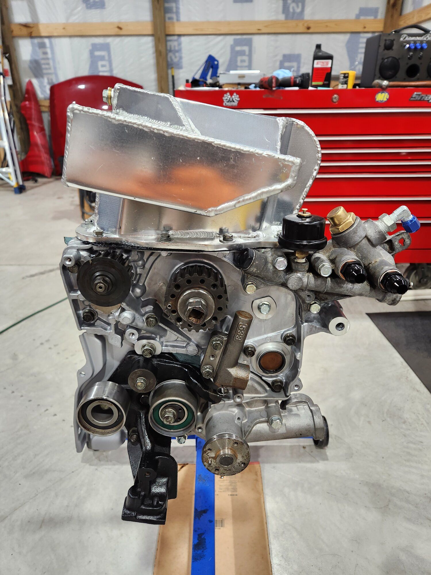

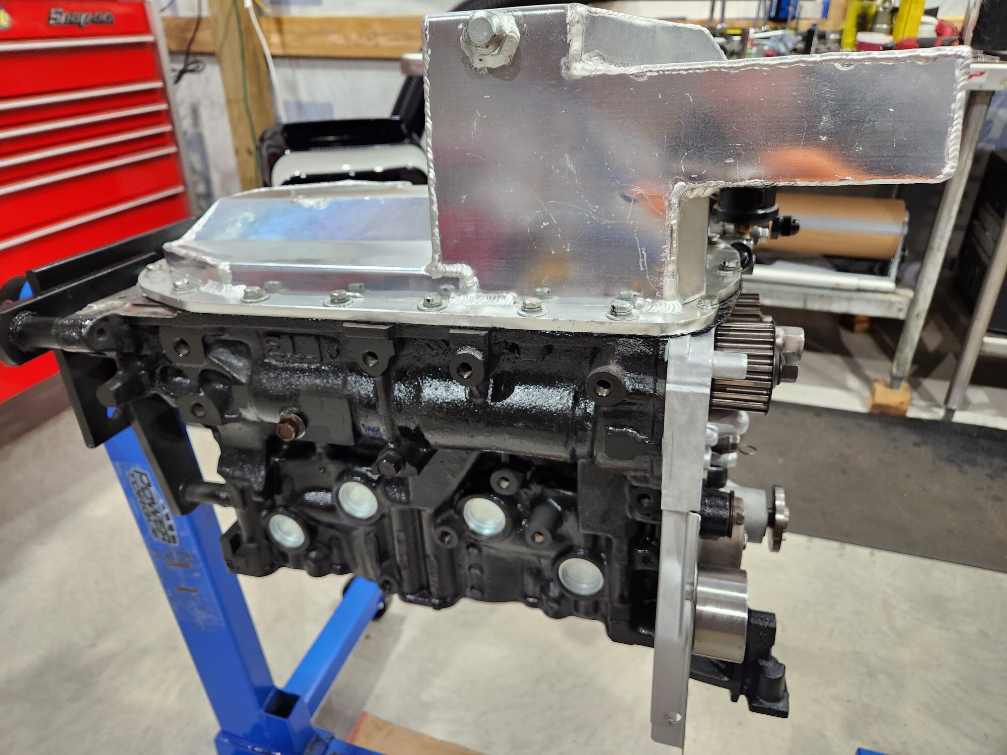

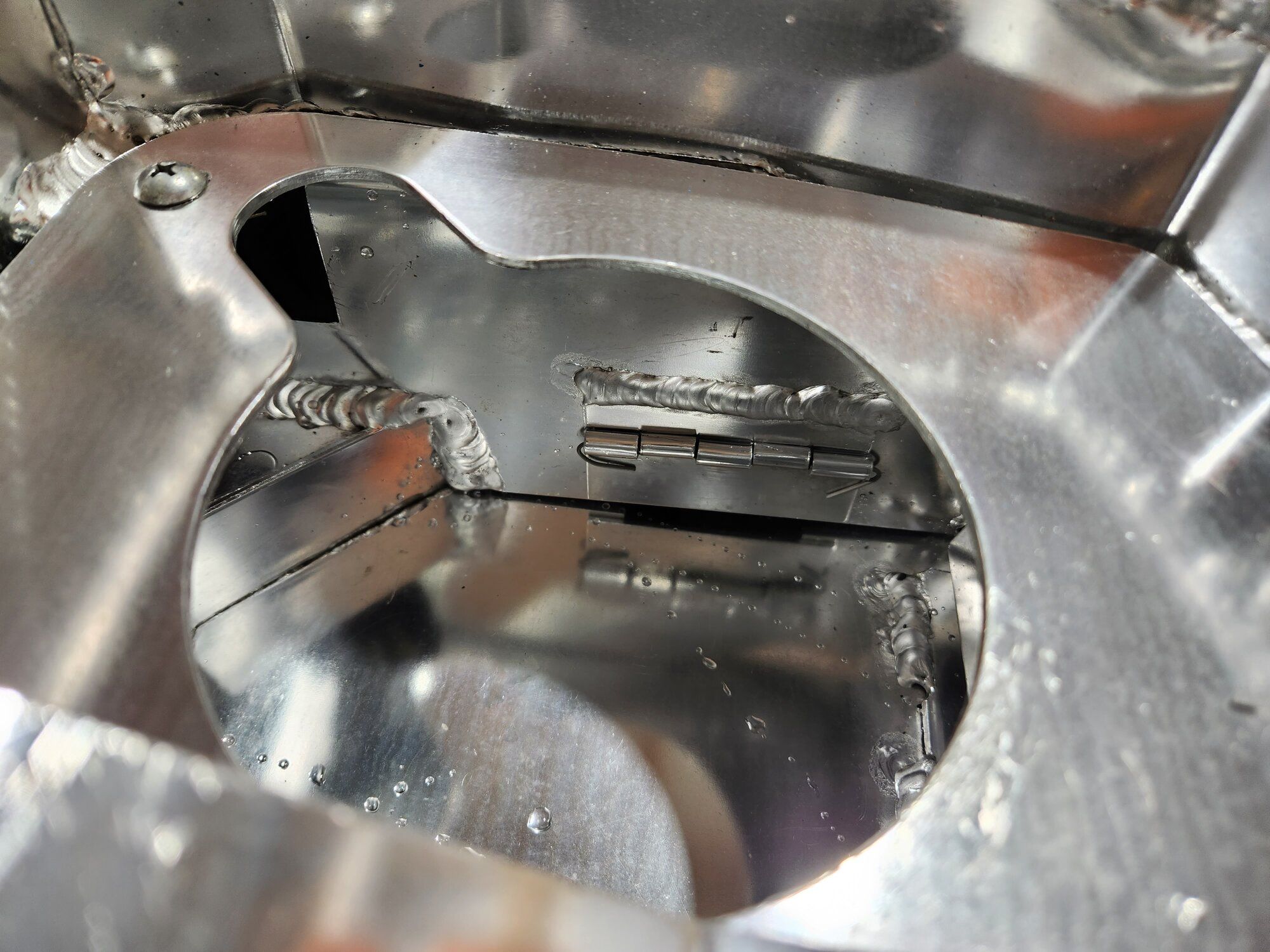

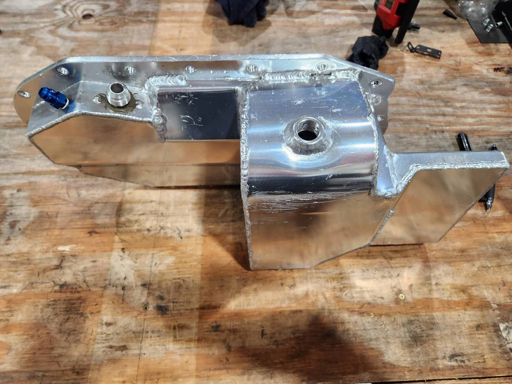

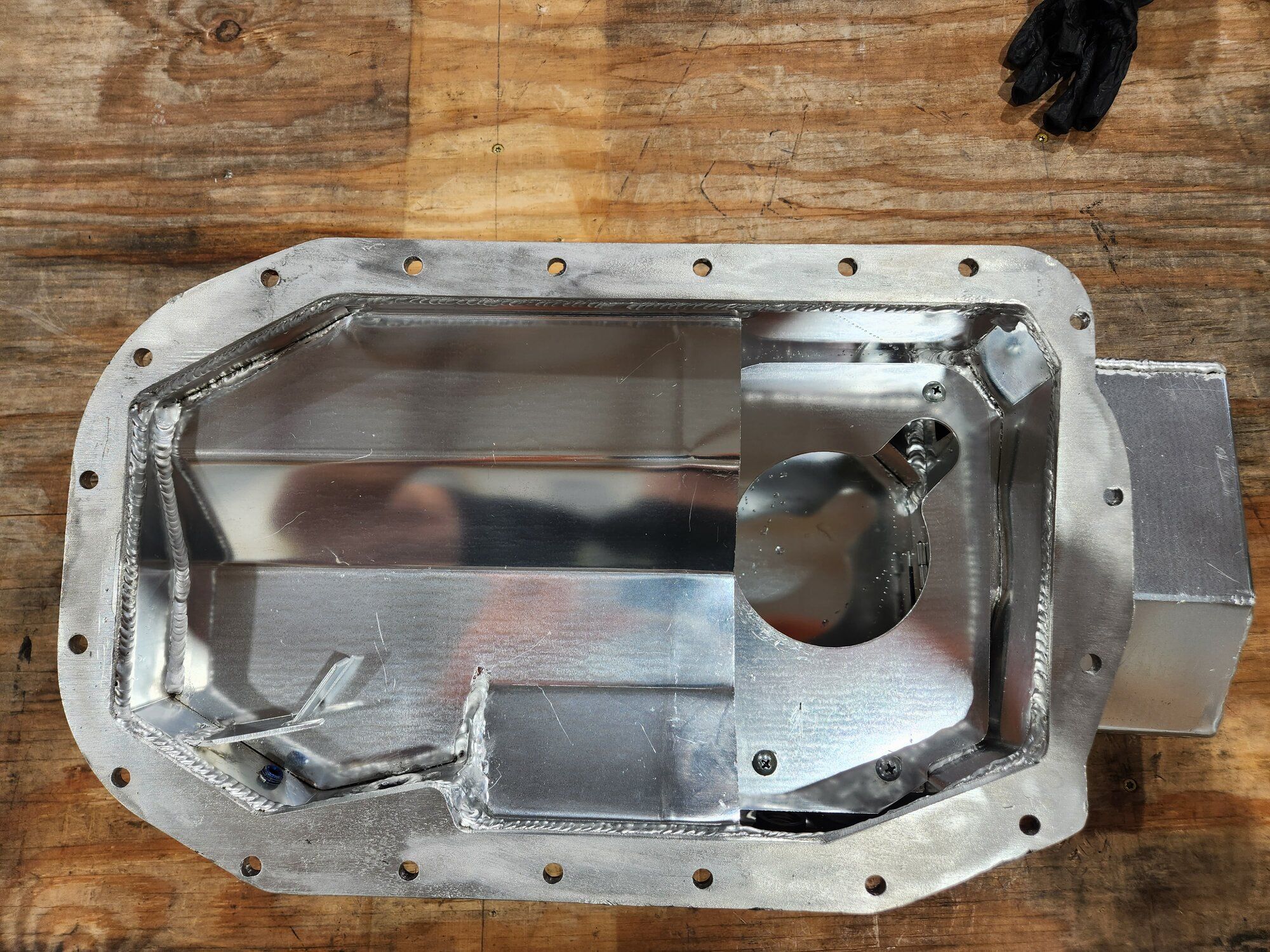

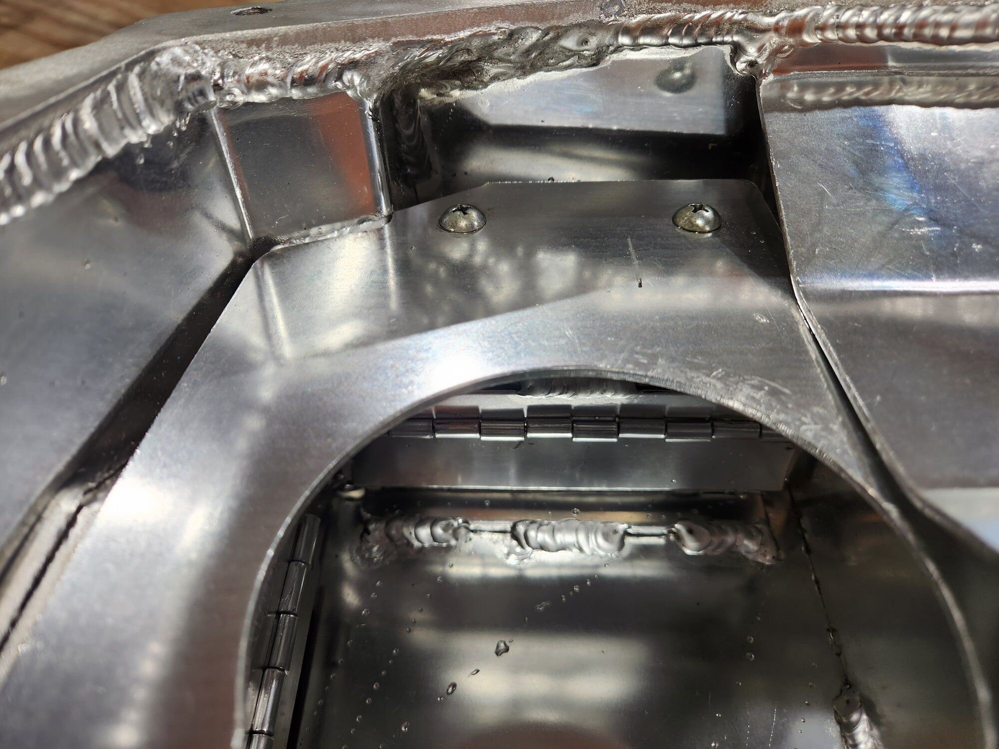

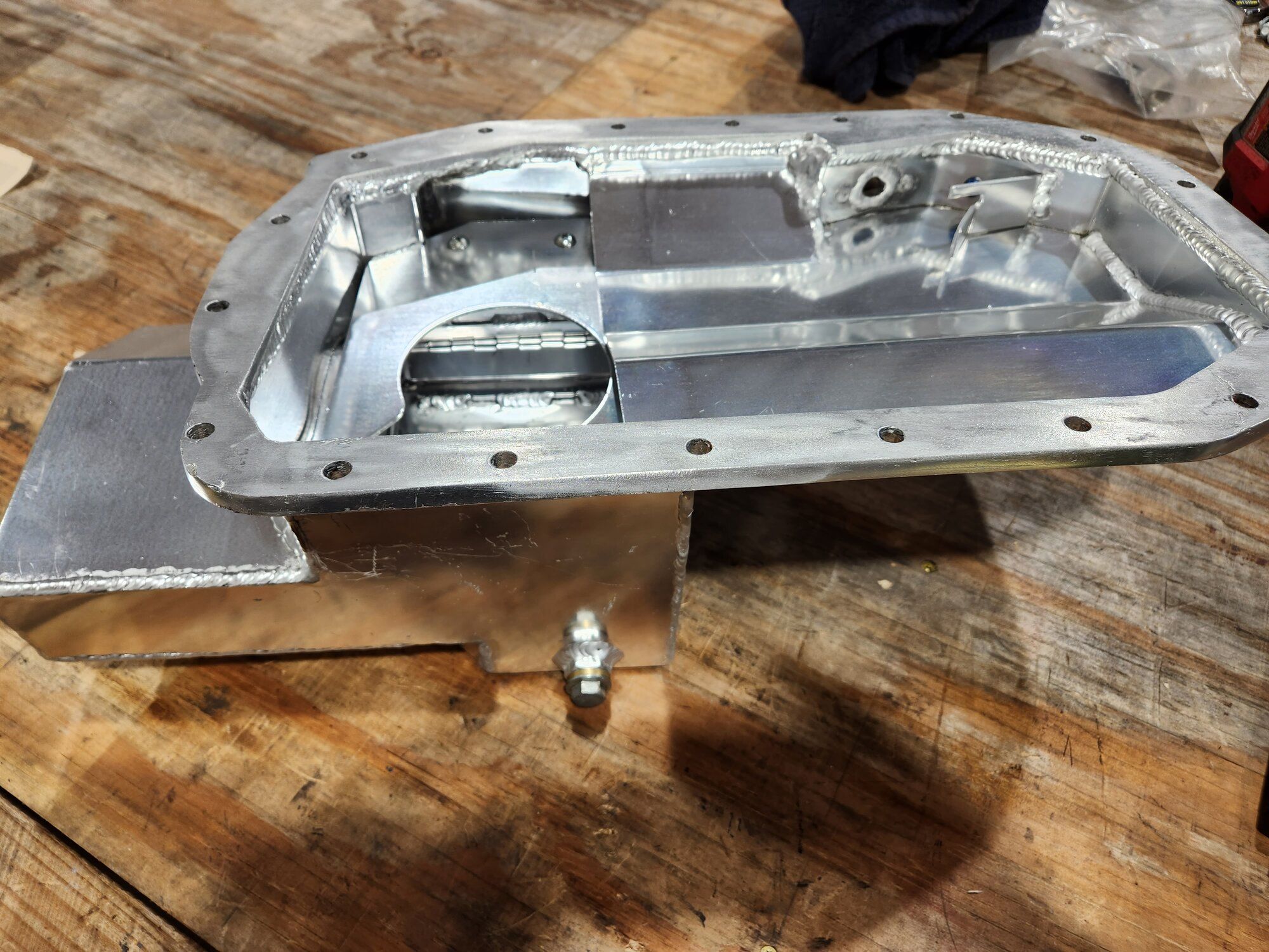

Anyway, I scooped up this custom aluminum oil pan and couldn't be more stoked! Extra capacity, sure, but the baffling and trap doors are what I'm most excited about! Hell yeah! This will be a nice addition with an accu-sump as well in the future. 🤘🤘
Hey, all. What are your thoughts on connecting up the oil port from the head (Stock turbo oil feed) and plumbing into the 6AN fitting on the pan? Or would that be too great of a pressure loss...hmmm. Otherwise I'll just cap it.

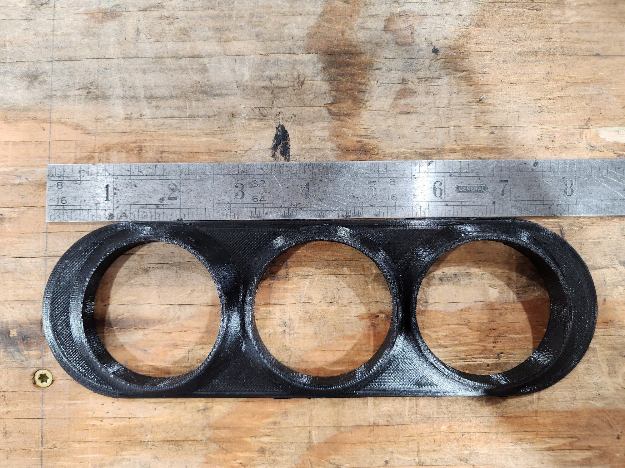

The new triple guage bezel from kuttzy.com showed up! Pumped about the look and angle the guages.

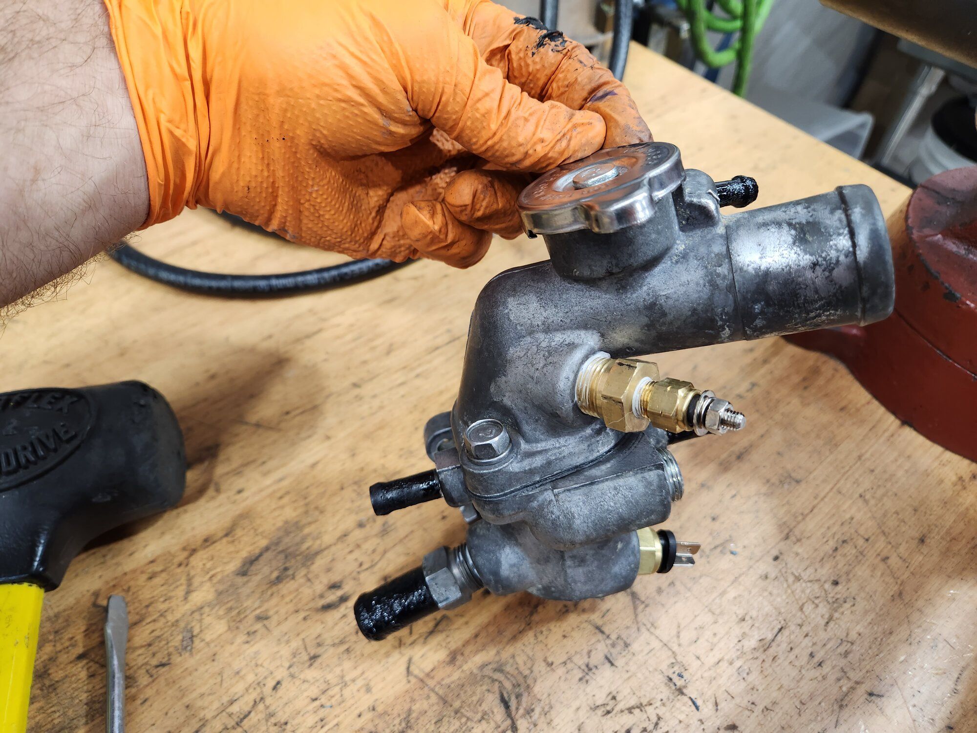

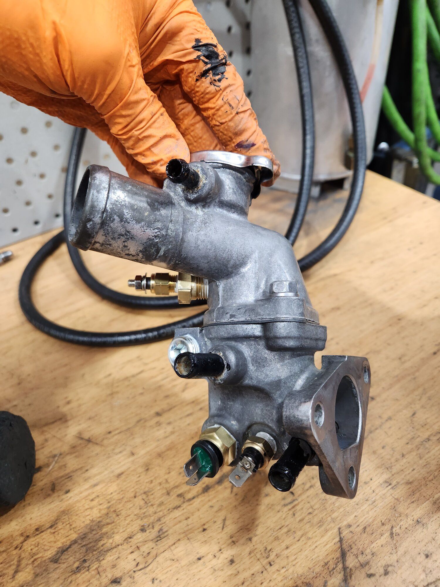

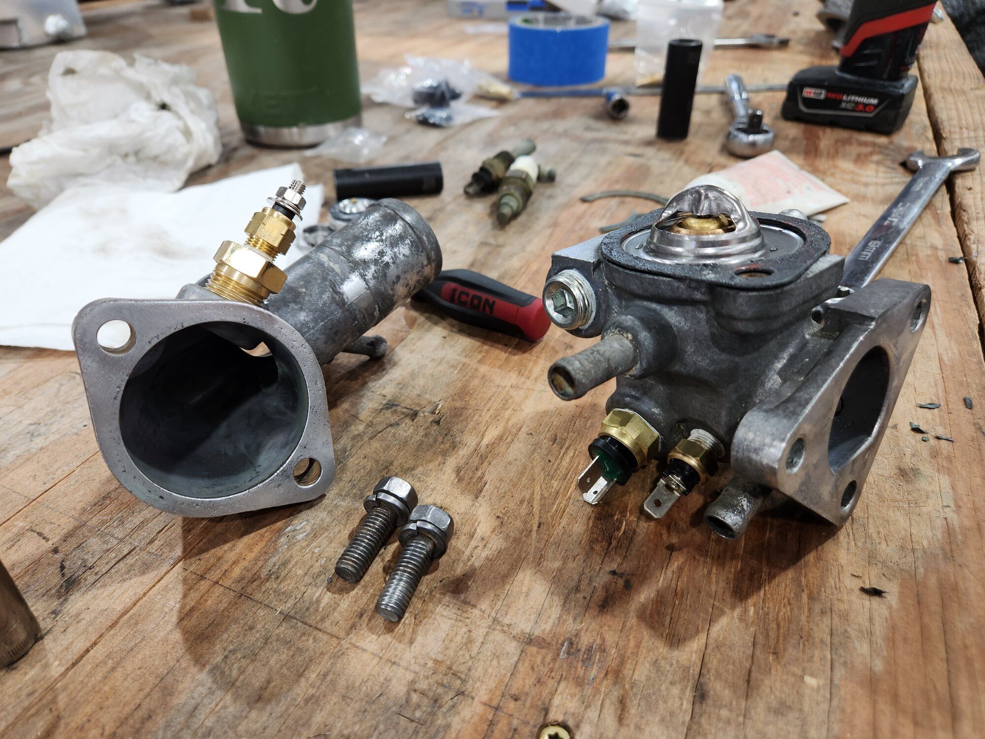

After a solid soak in Evapo Rust I rebuilt the thermostat housing, all new sensors, and re-sealed anything that would unscrew. Painted the raw steel nipples to keep corrosion at bay.

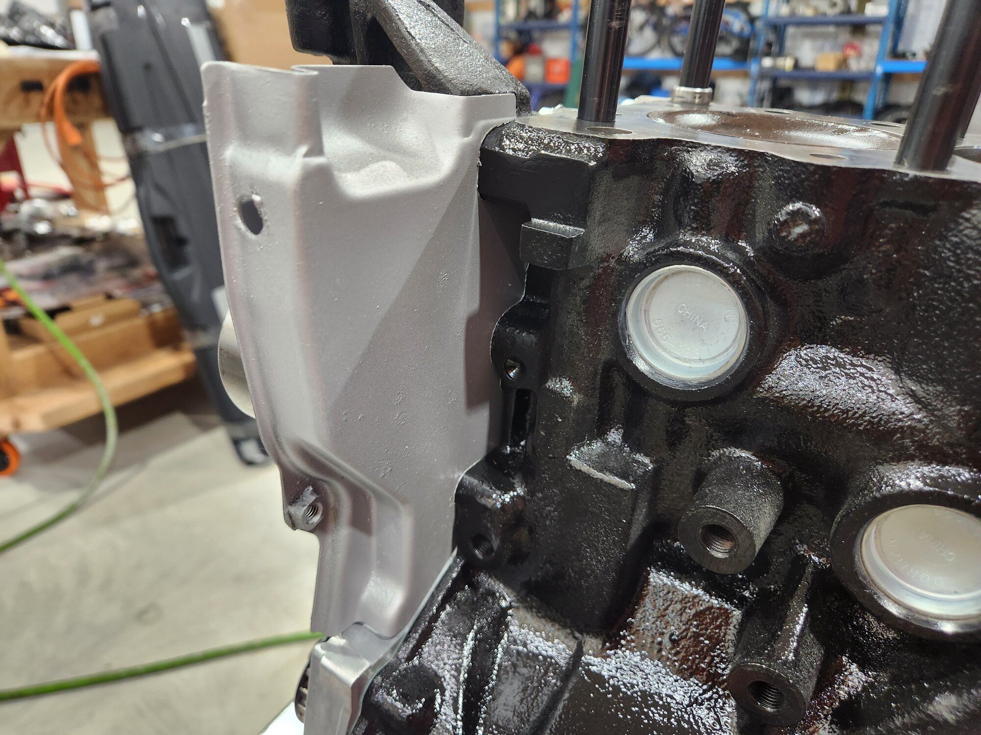

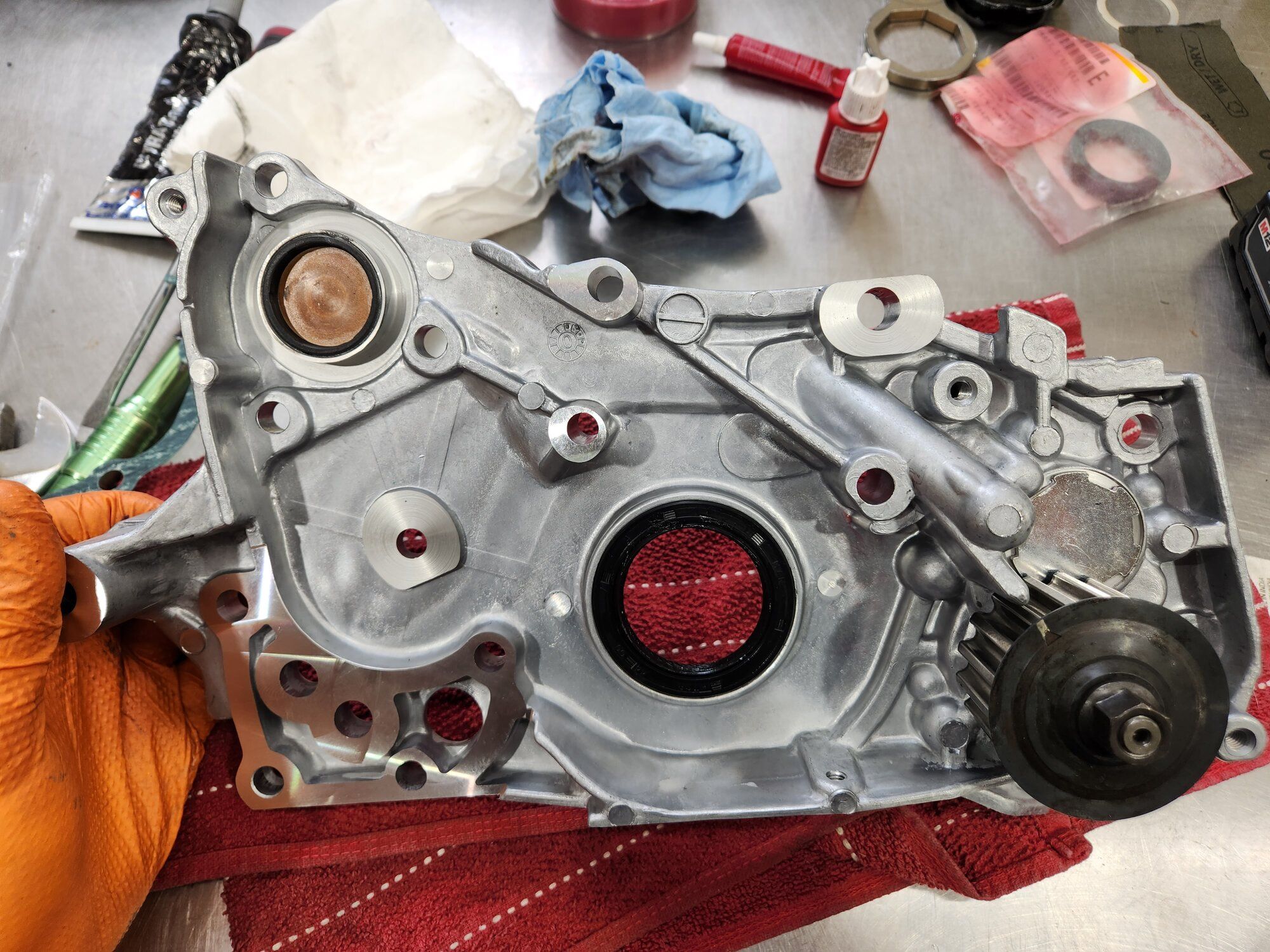

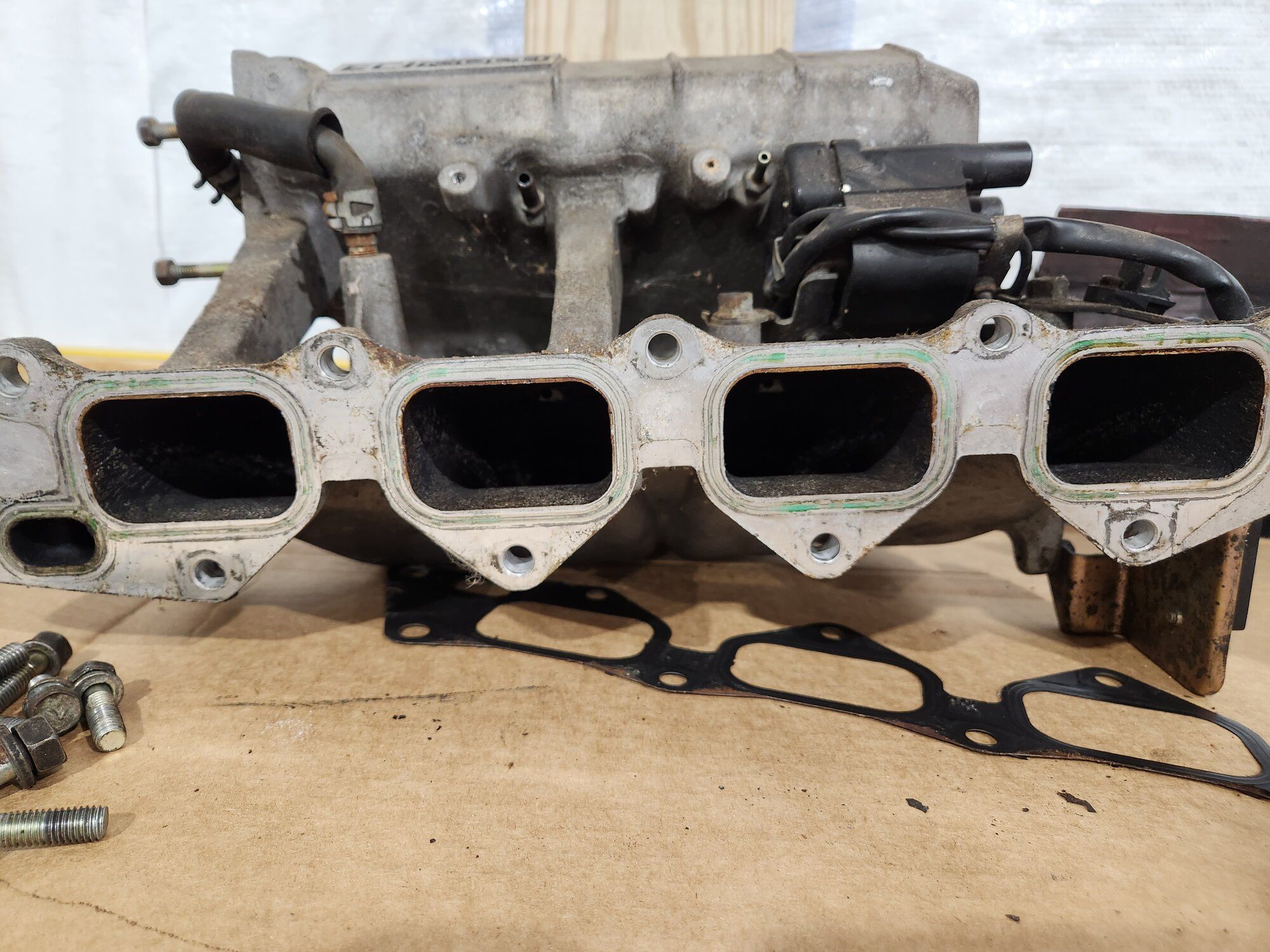

Stripped and cleaned the 90 OFH. I'm using the lower pressure Mirage spring since I deleted the balance shafts.

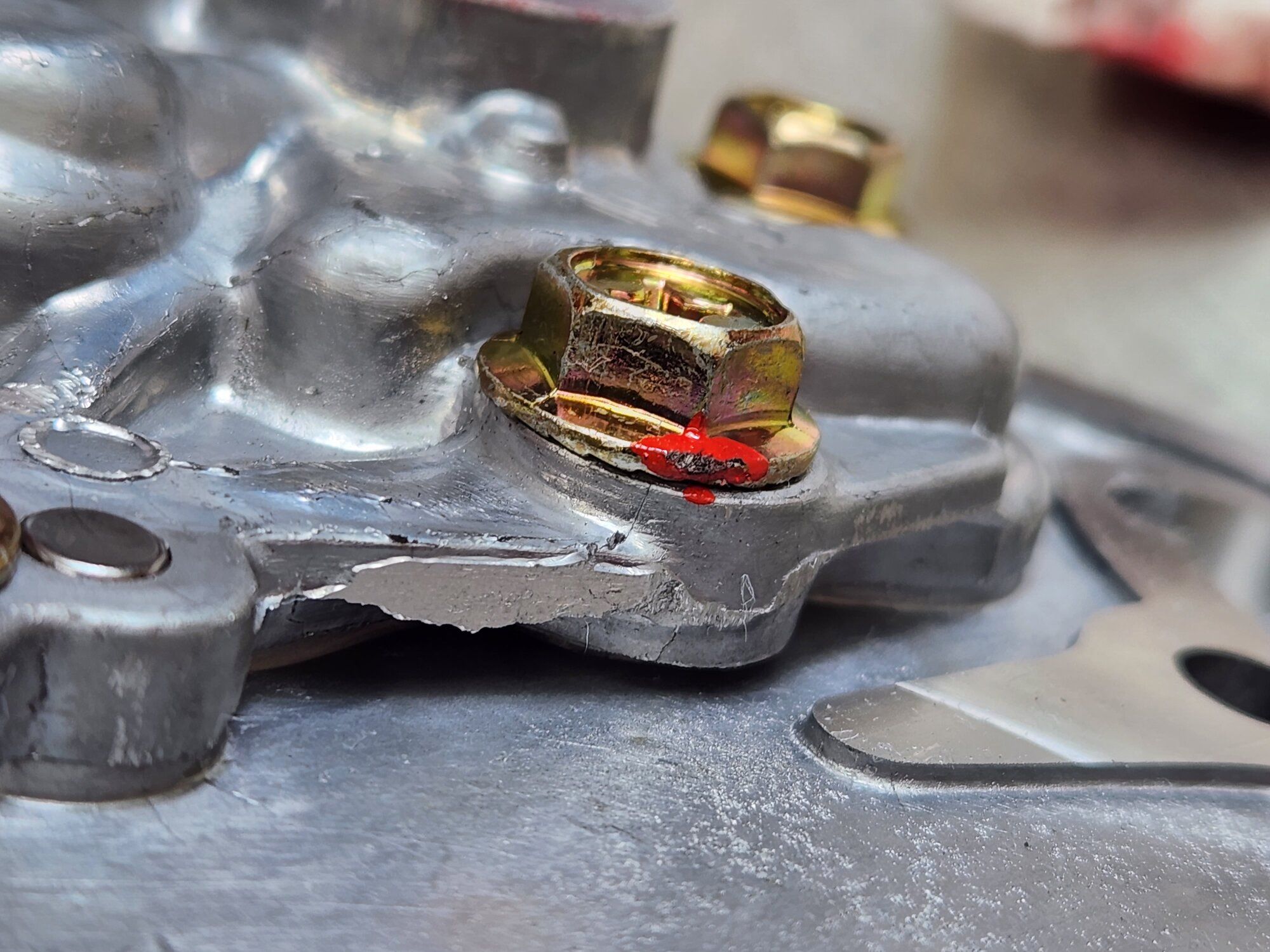

Had one of those aftermarket parts morning's when trying to bolt the ACL pump on. It didn’t fit without removing material from the pump bolt and a smidge off the block.

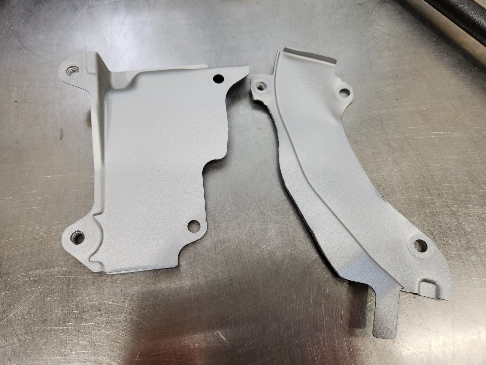

Refinishing bits and Pieces with some self etching primer, then high temp paint.

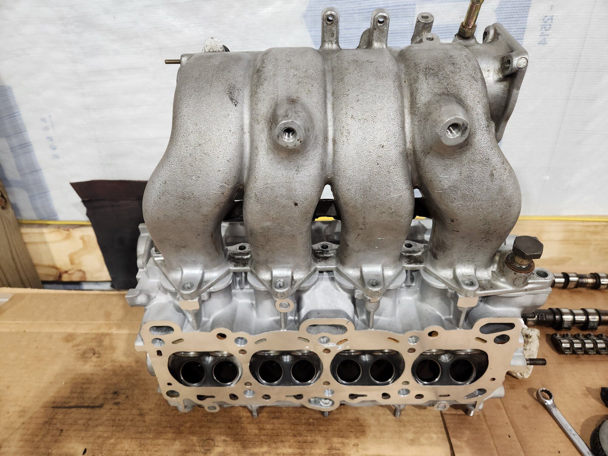

OFH built and installed, Balance shaft deleted and oil pan and pump installed. Brackets..etc

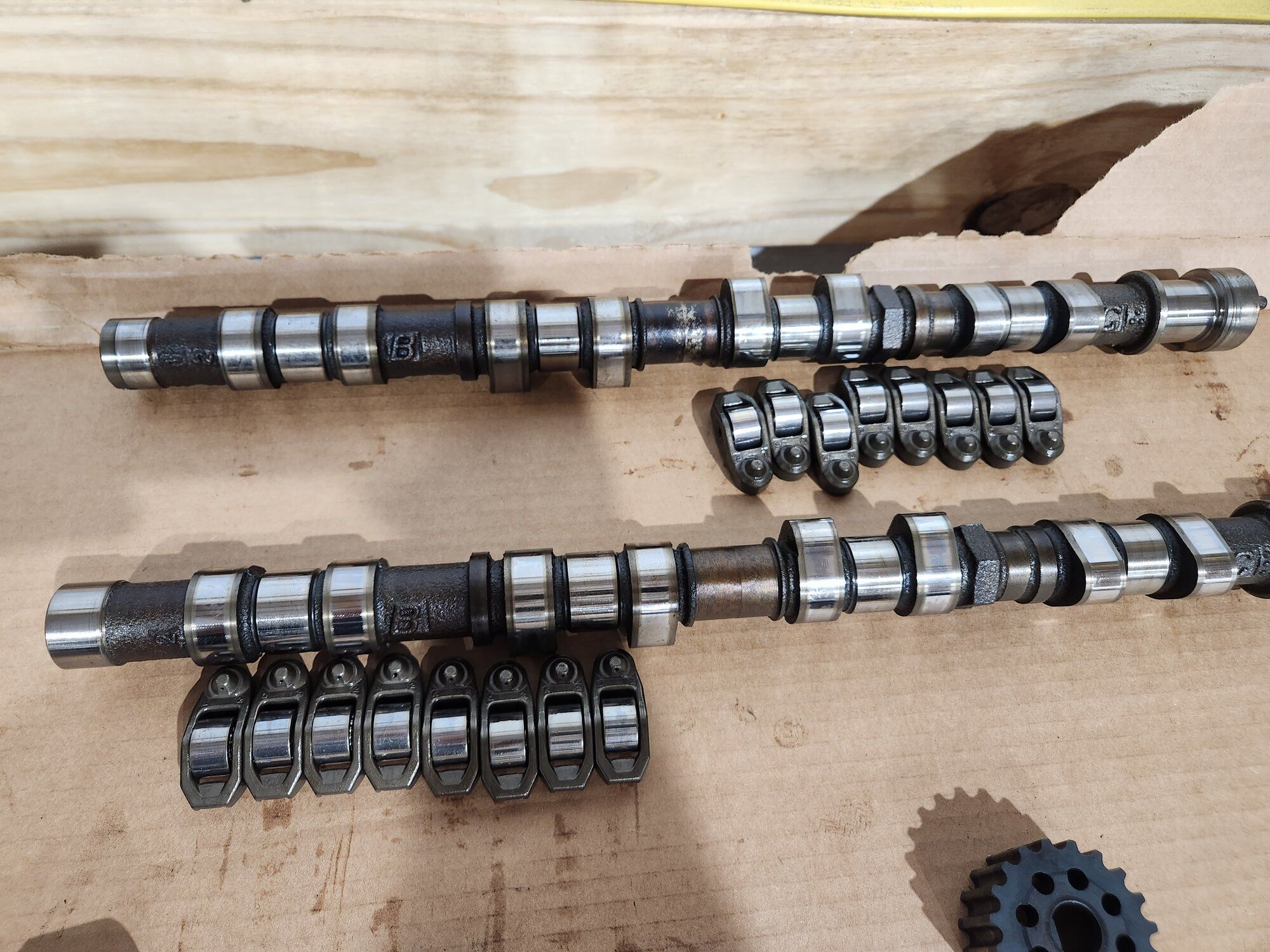

Head ready for install after a couple HLA comes in from John at performancepartout.com

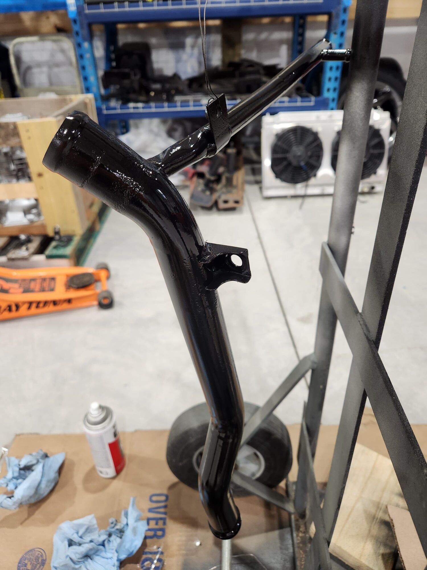

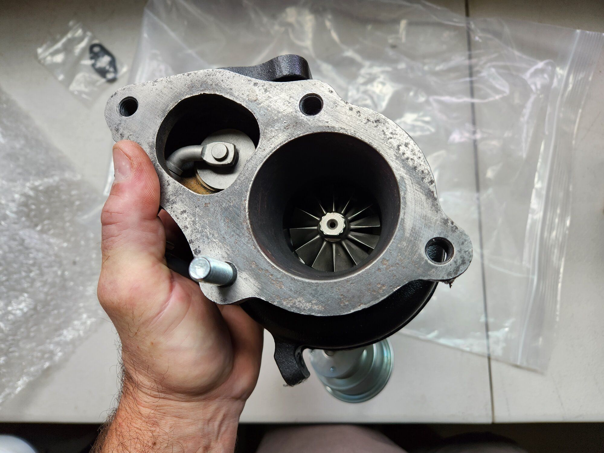

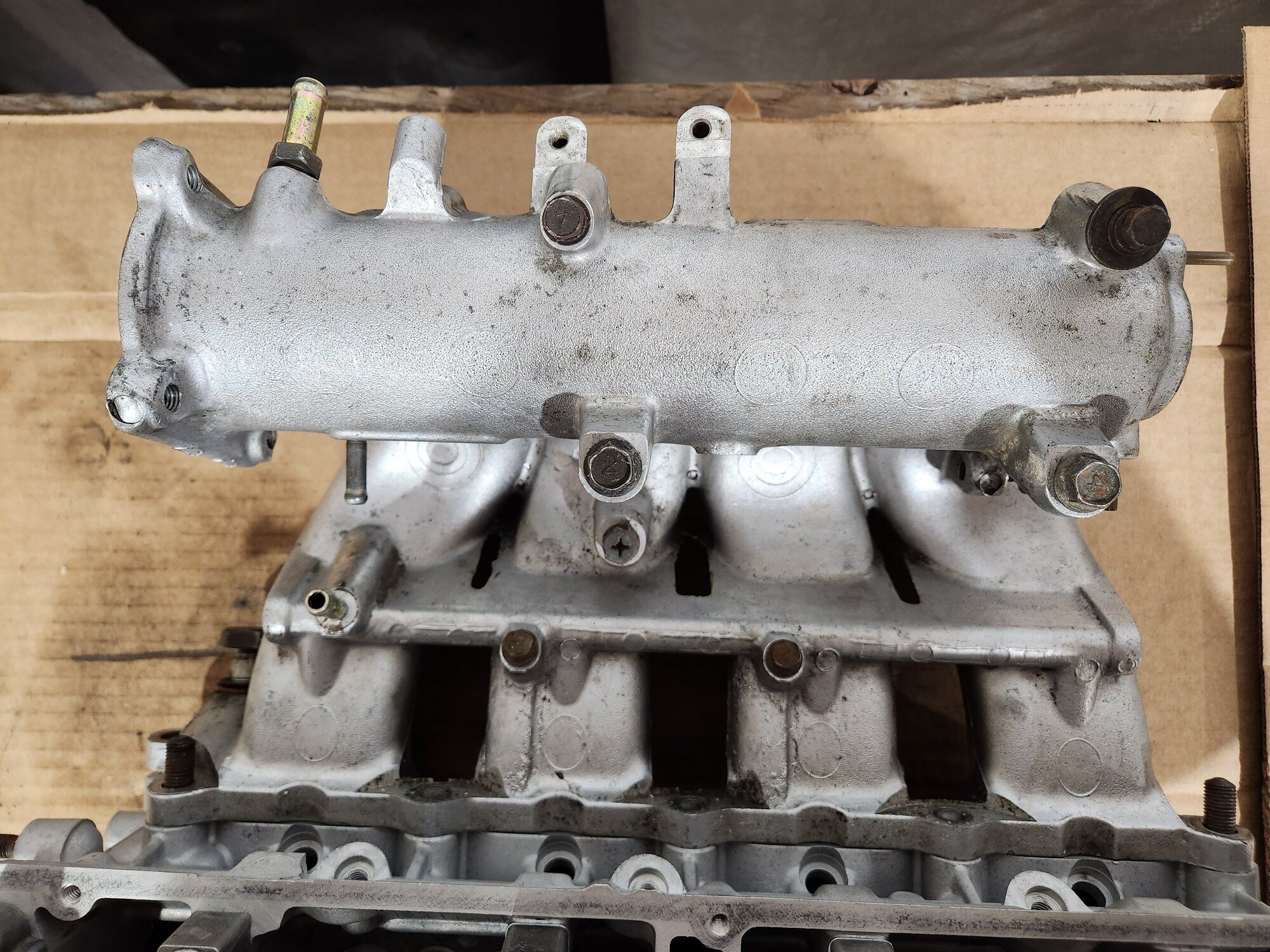

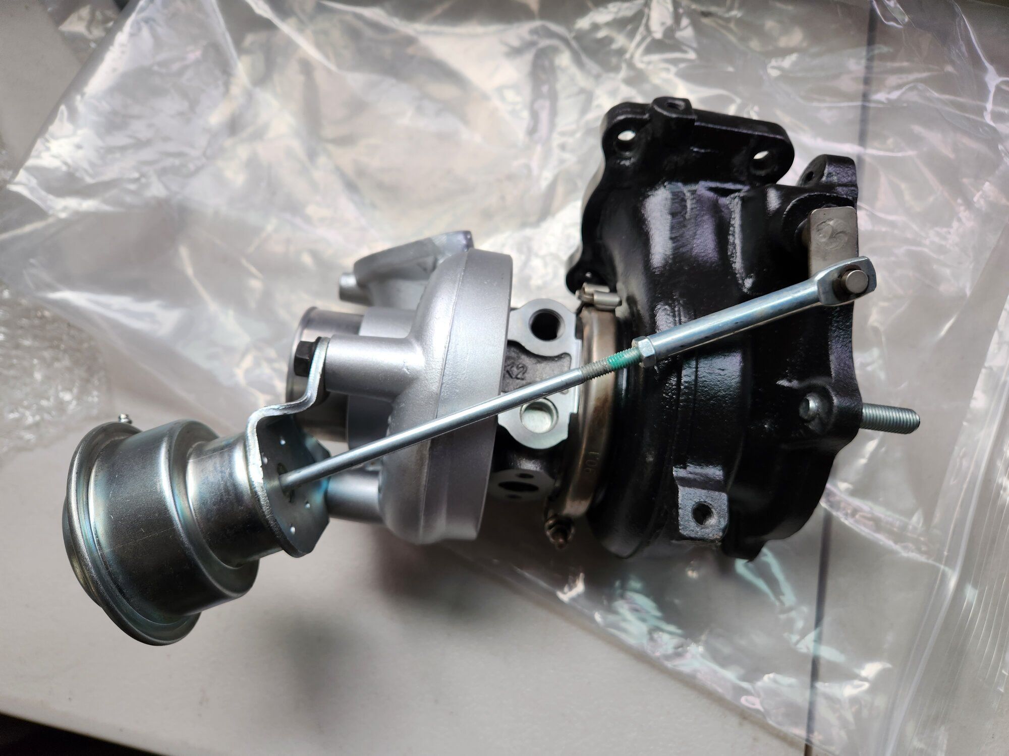

Non turbo water pipe, since I won't be feeding E3 16G coolant. I couldn't stand the aluminum paint it had on it, so I stripped it, self etching primer, then high temp enamel. Silly, but I think it's going to look real good and not stand out!

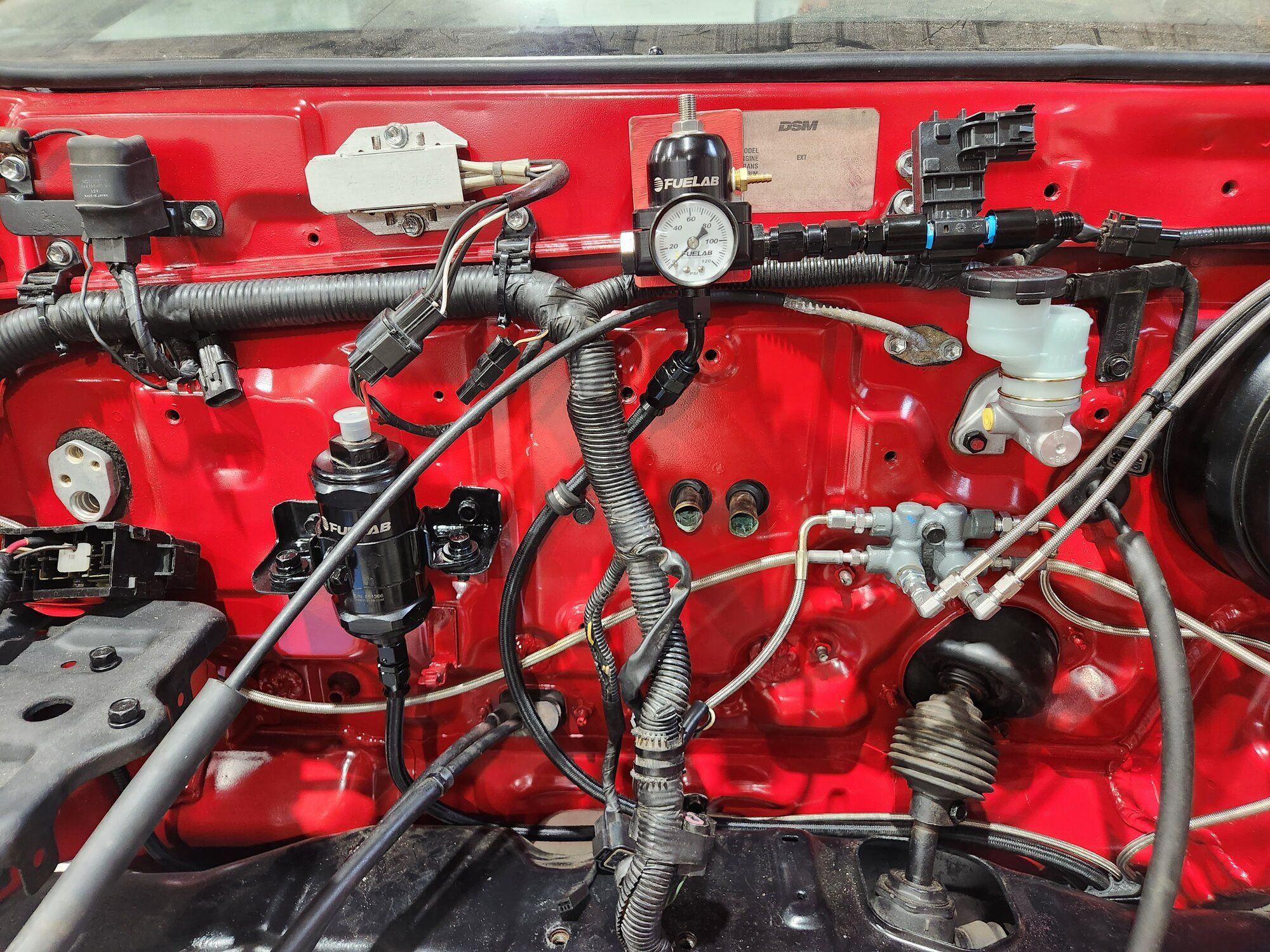

Wired up the fans, we'll see how they work. Need to add a grounding switch to GB on Pin A40 for some manual switch action. Nothing special here. Haha

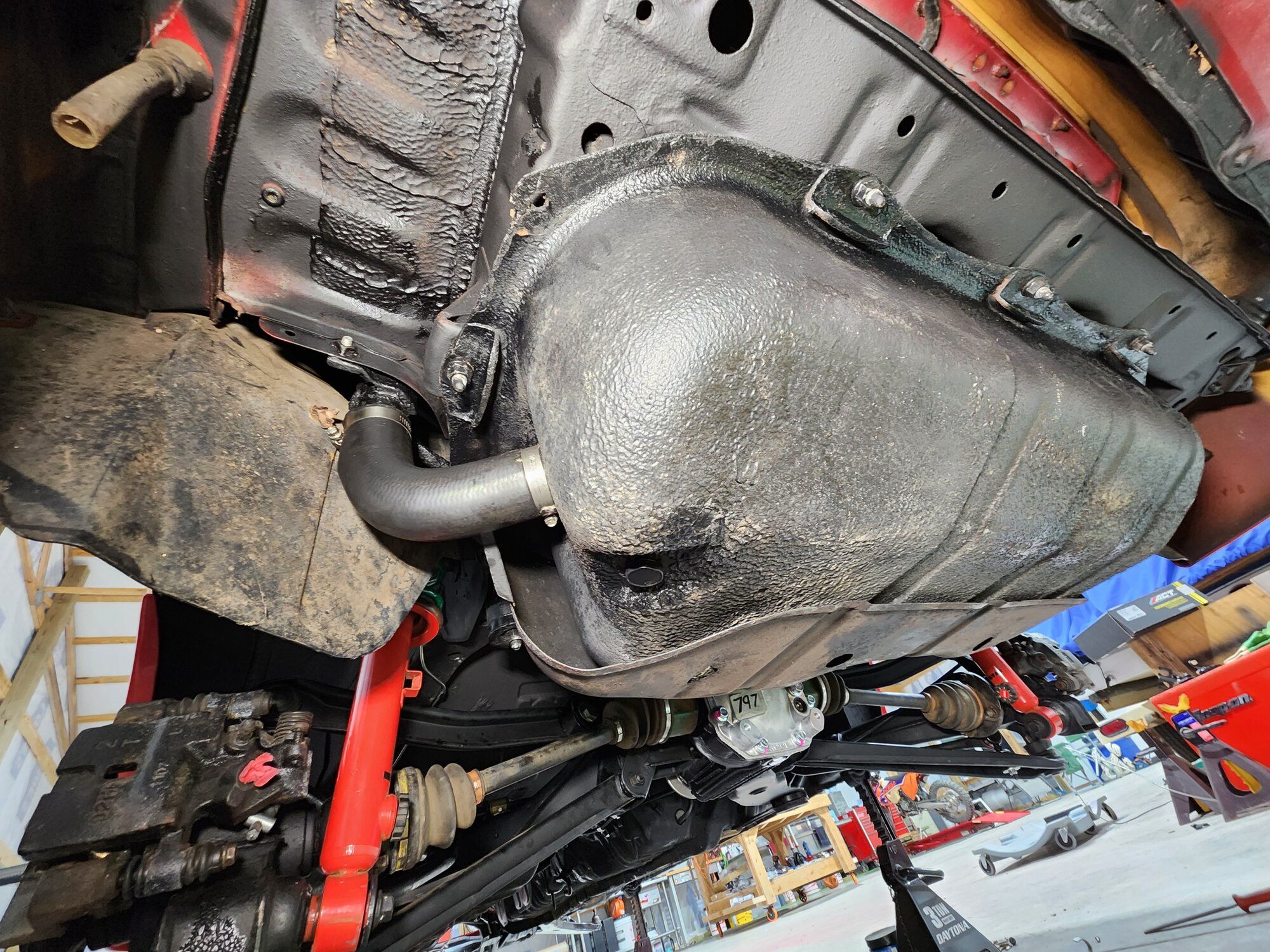

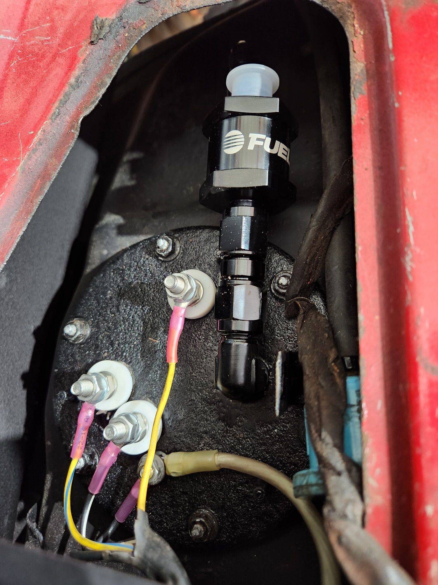

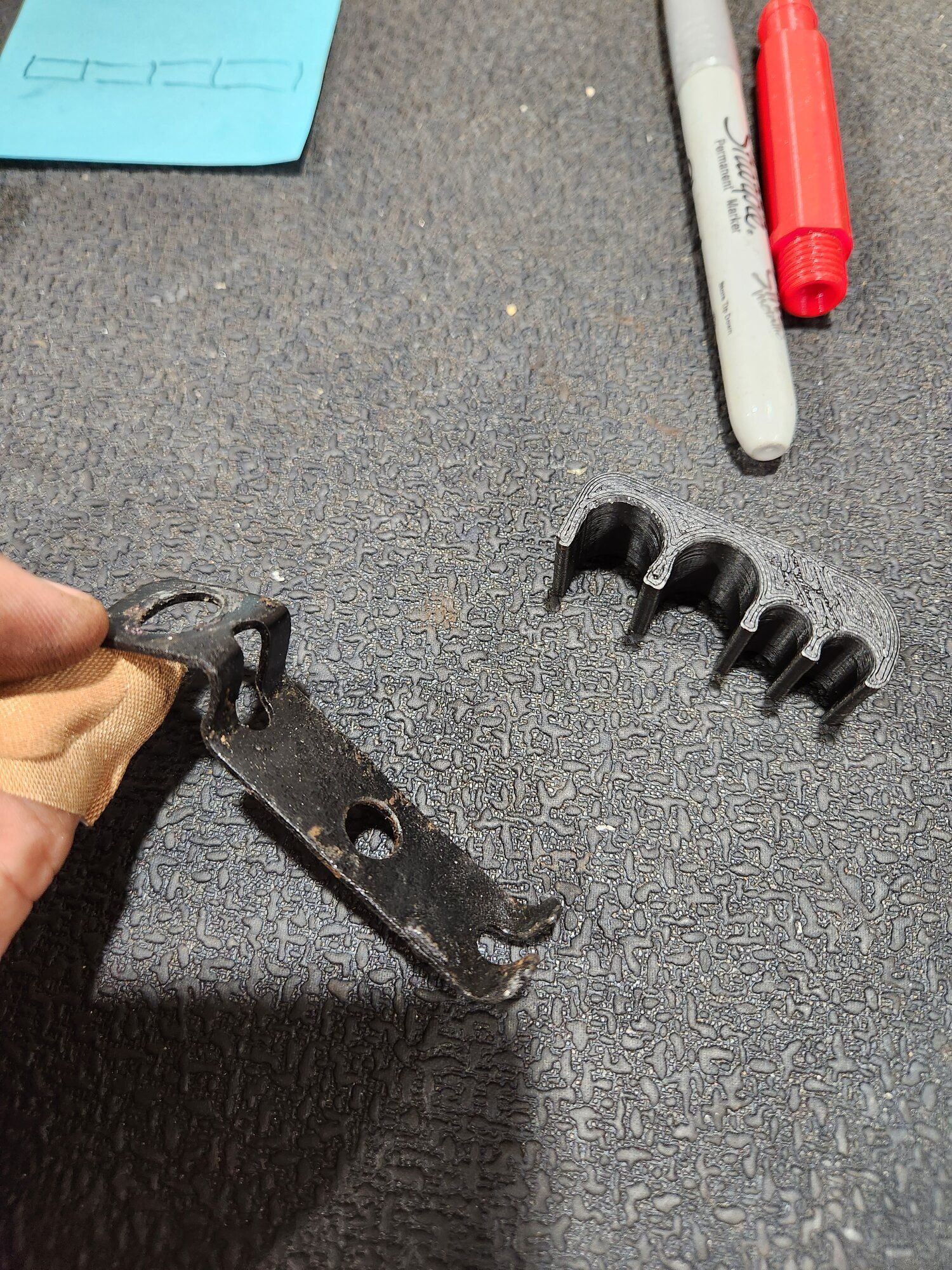

Man, I swear it takes me forever to mess with the fuel lines, and I poke the SHIT outta my fingers in the process. Lol. FPR and E85 sensor mounted.
