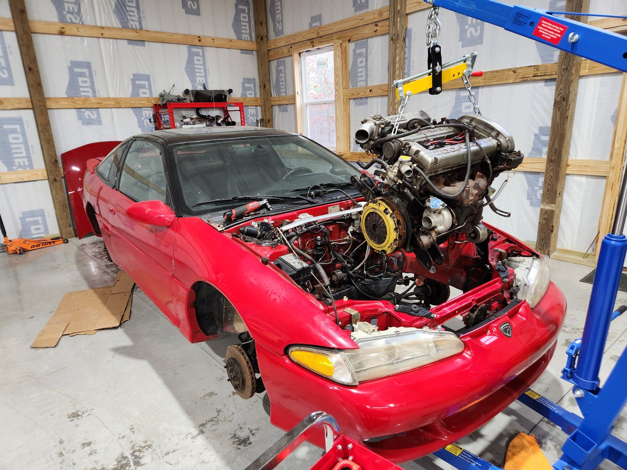

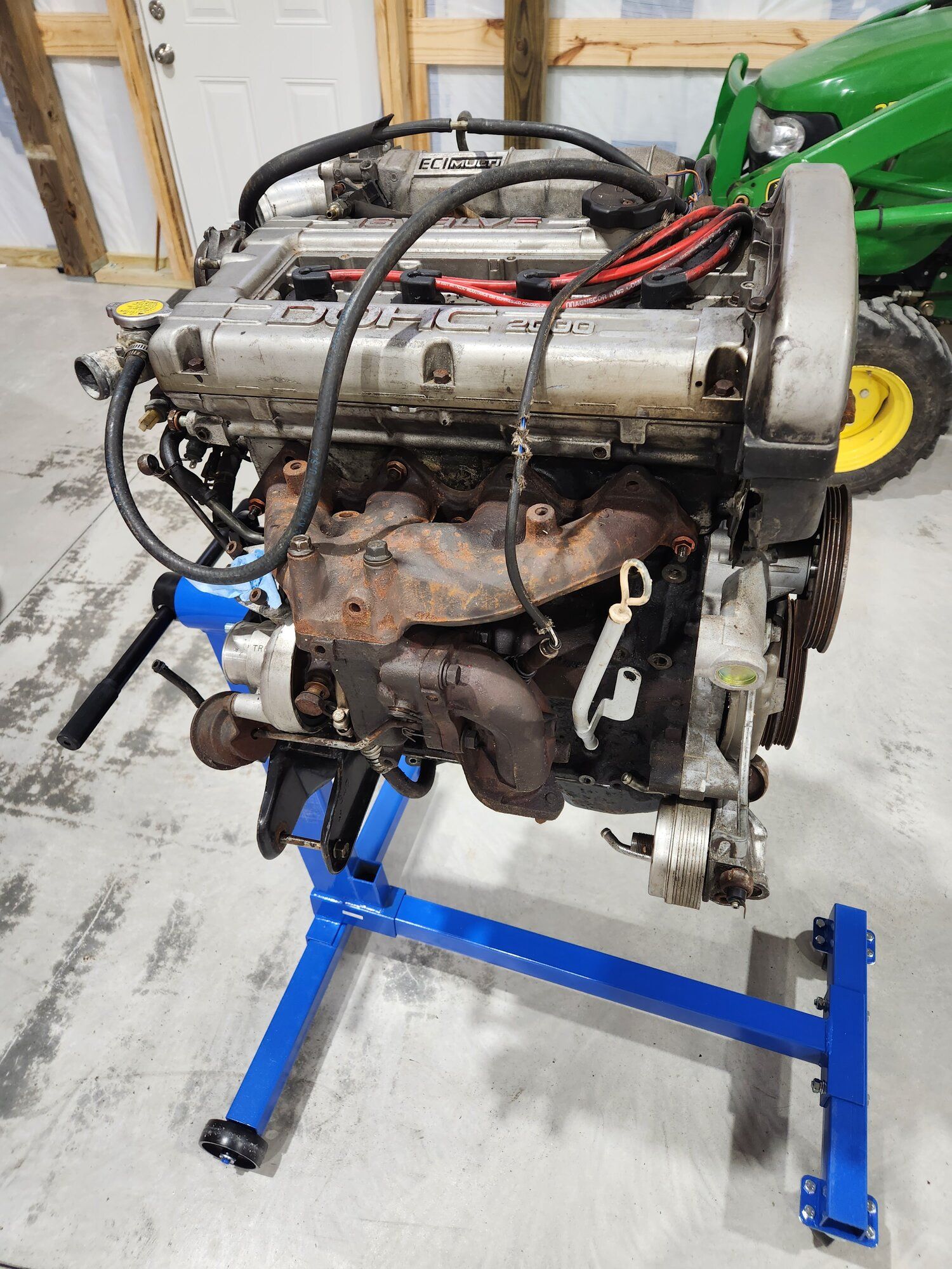

Yanked the motor, and awaiting time to tear down then inspect/measure the bores and pistons on the original 100k+ motor. Hoping to get by with fresh bearings and piston rings...we'll see.

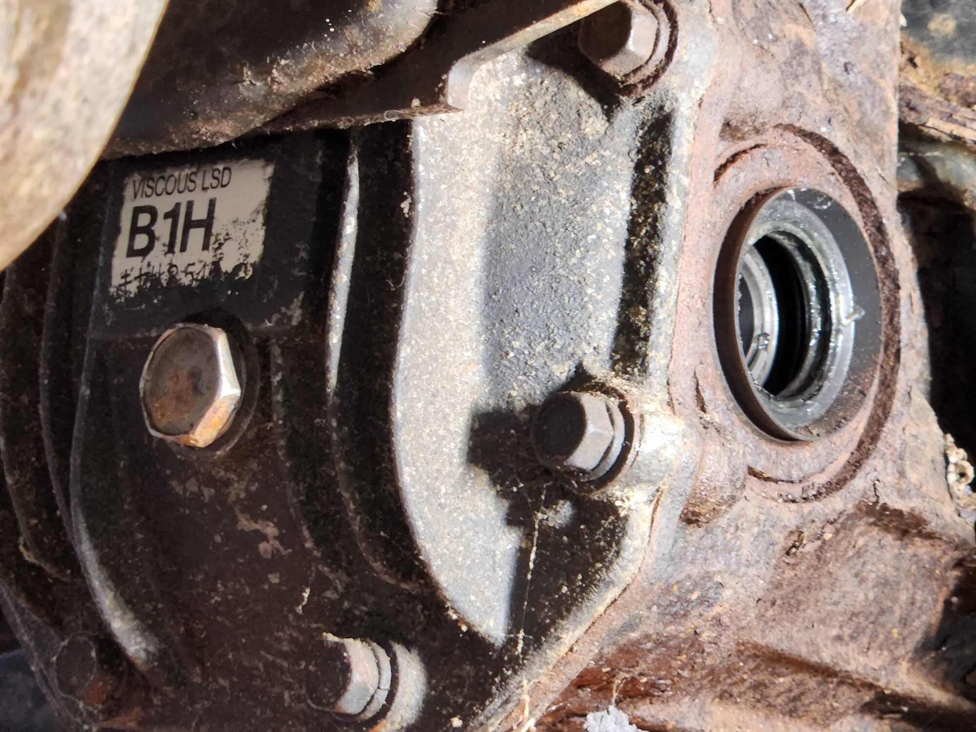

Need to drop the rear diff, pack it up along with the trans ans T case and ship to TRE in Michigan for a rebuild/freshen up.
Dropped the starter and high amp alternator off for a freshen up/rebuild.

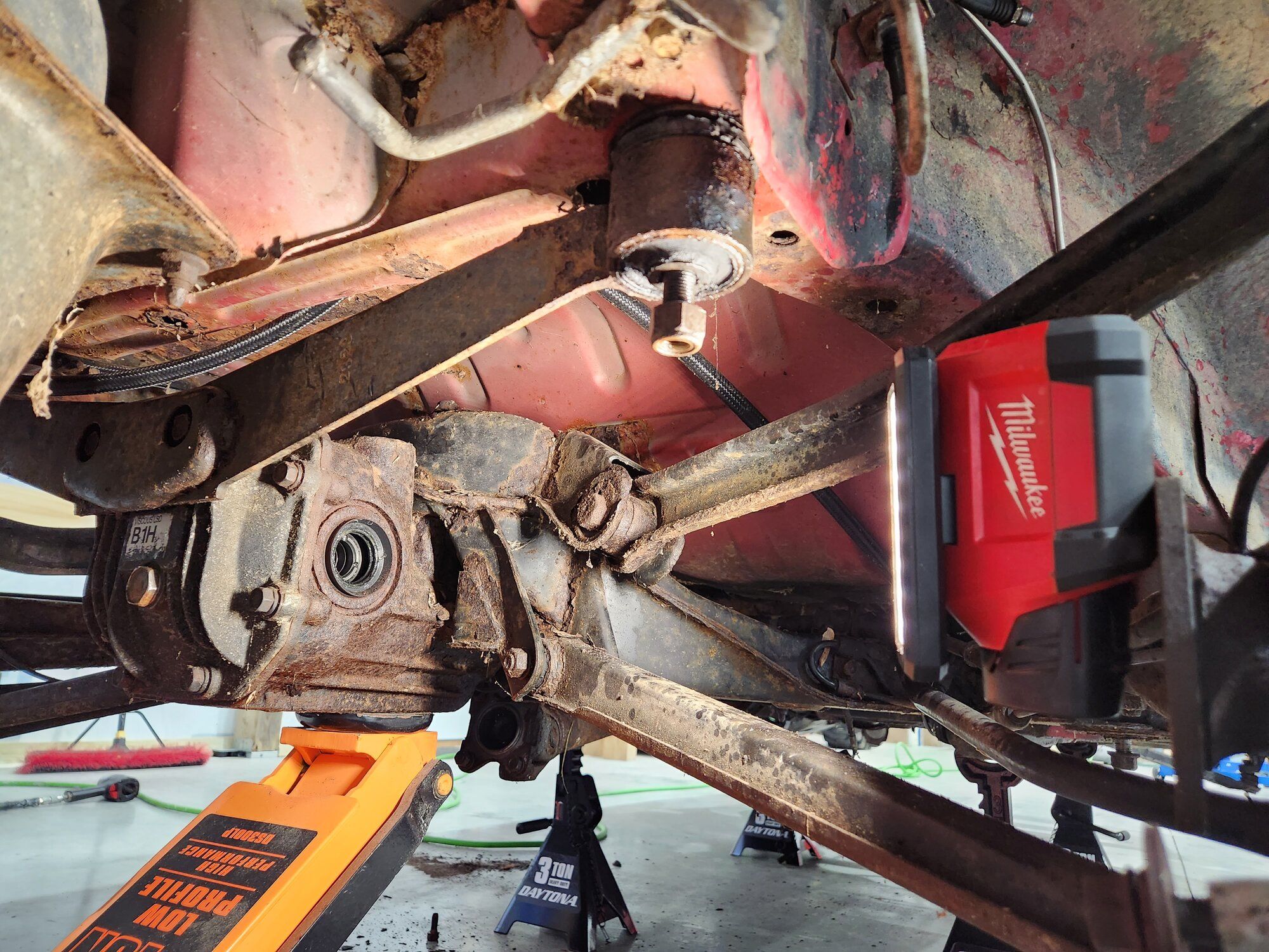

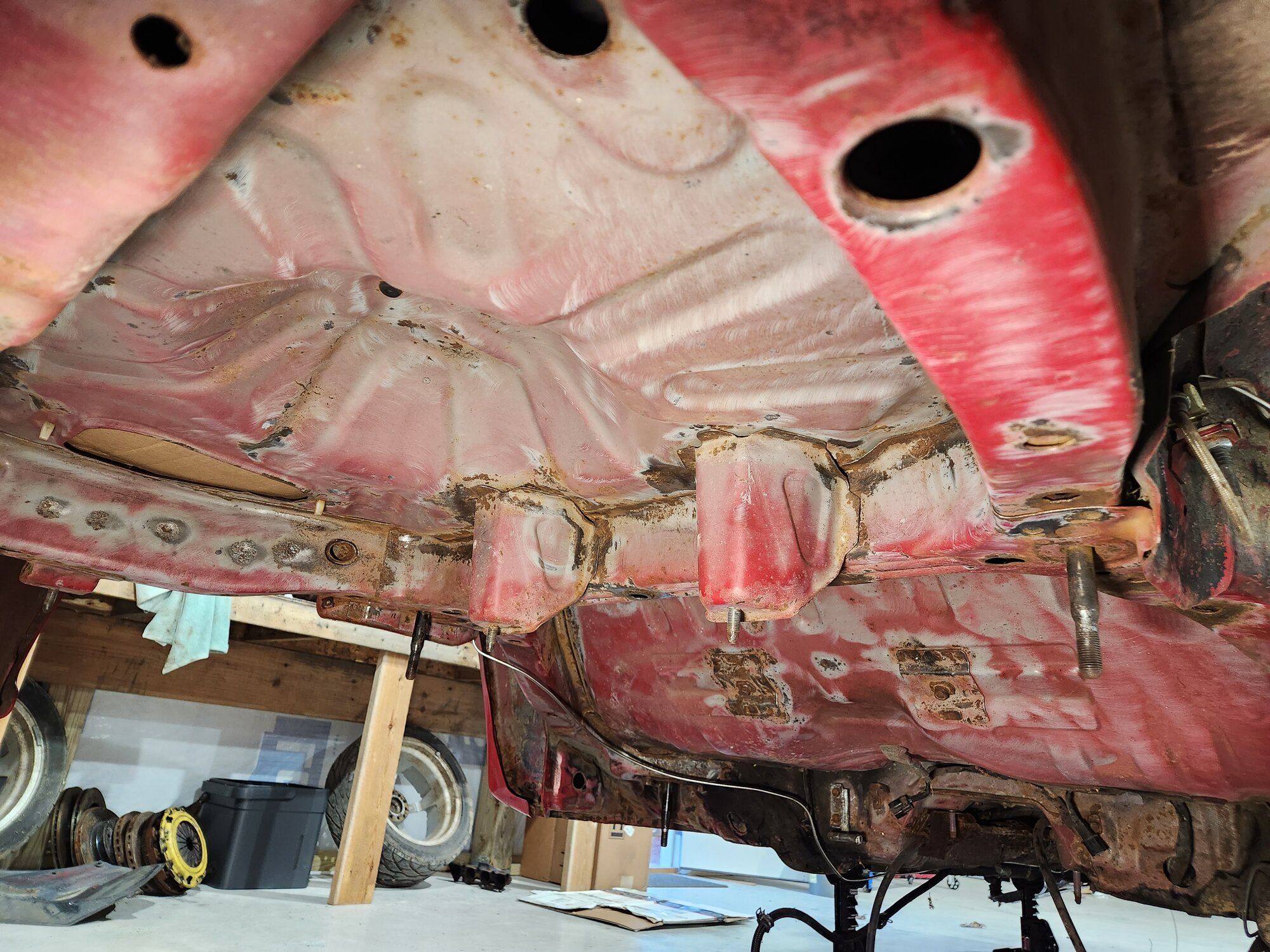

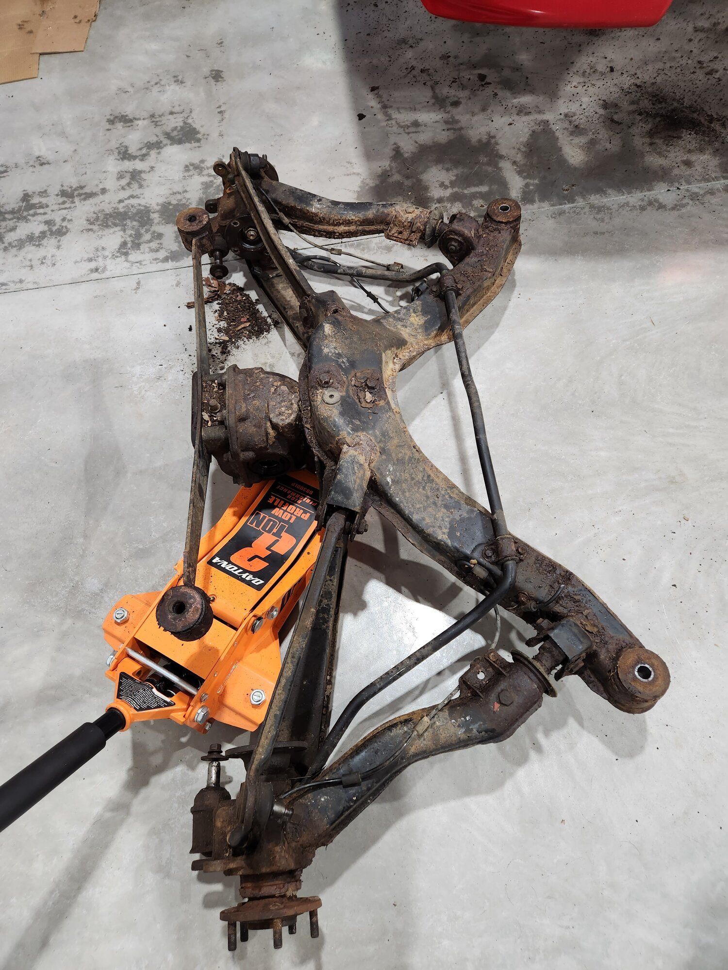

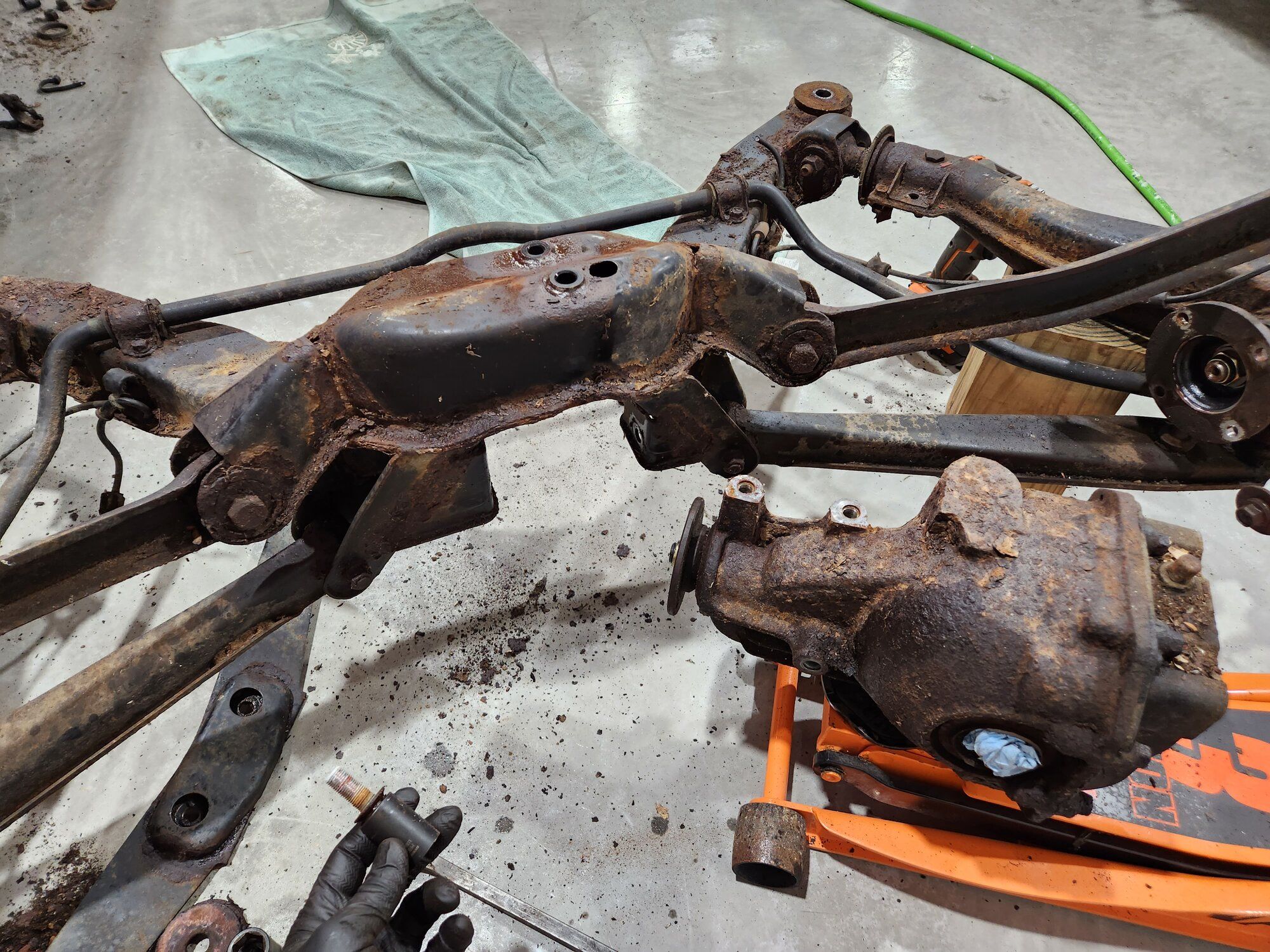

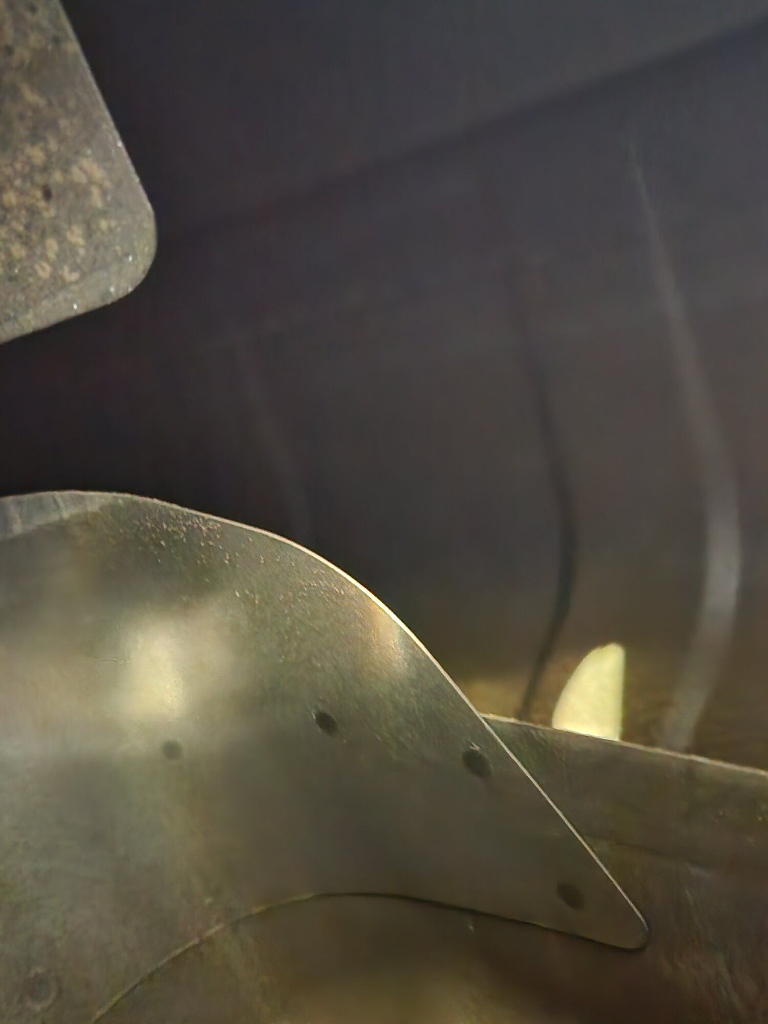

Well, finally got to dive into the belly of the beast and the rear cross member...she's a bit chewey with some *weight reduction*. But, all things considered, not bad for a PA car.

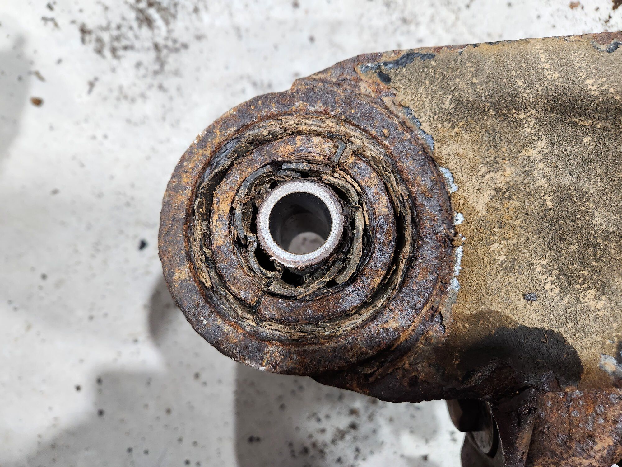

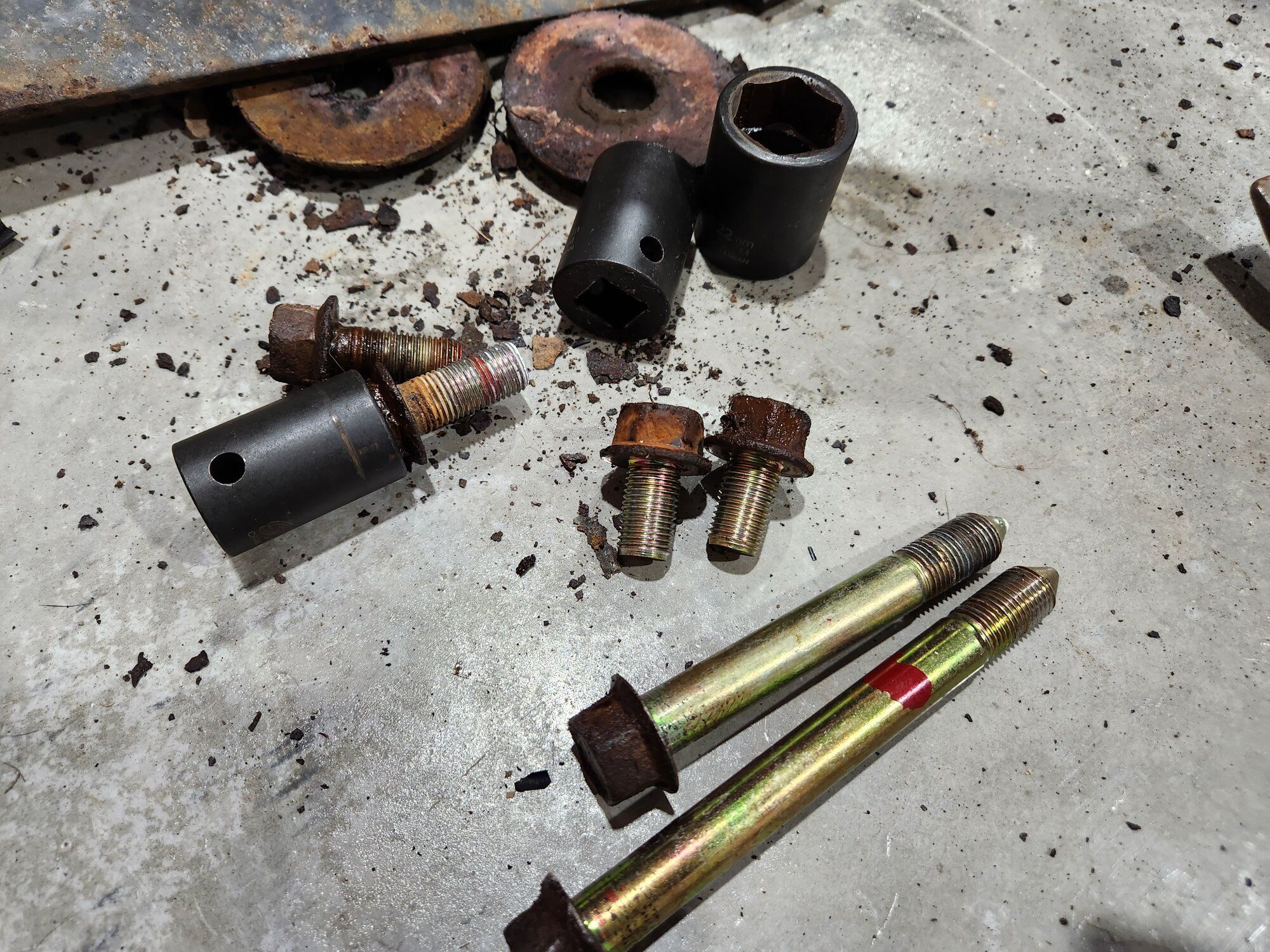

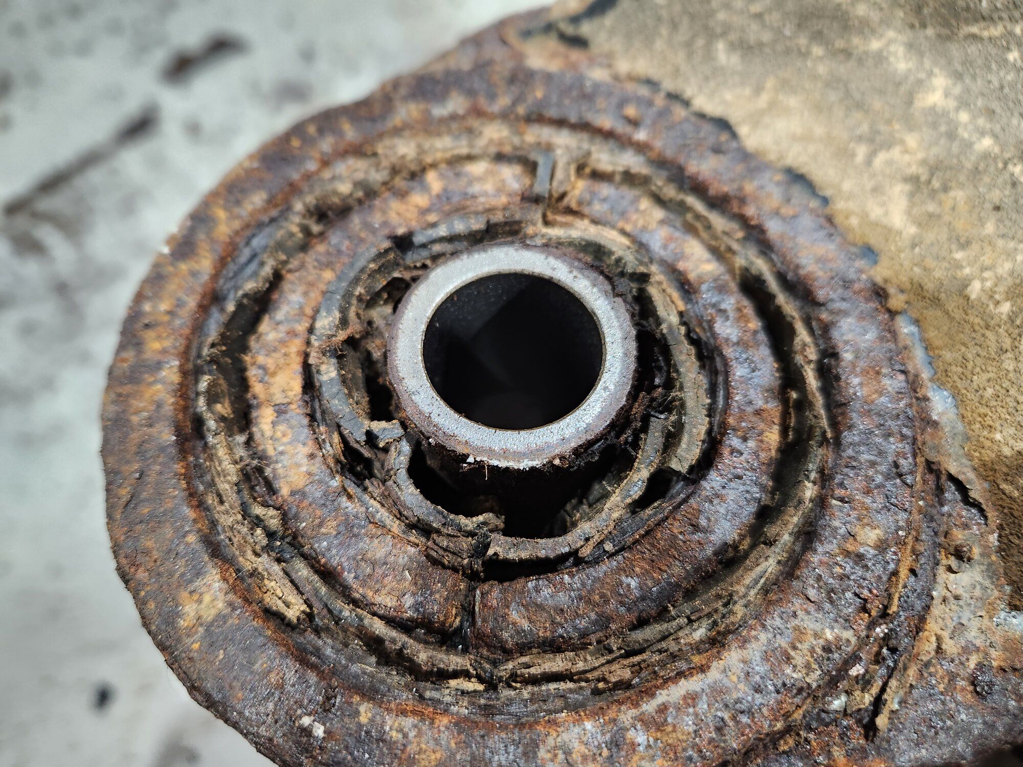

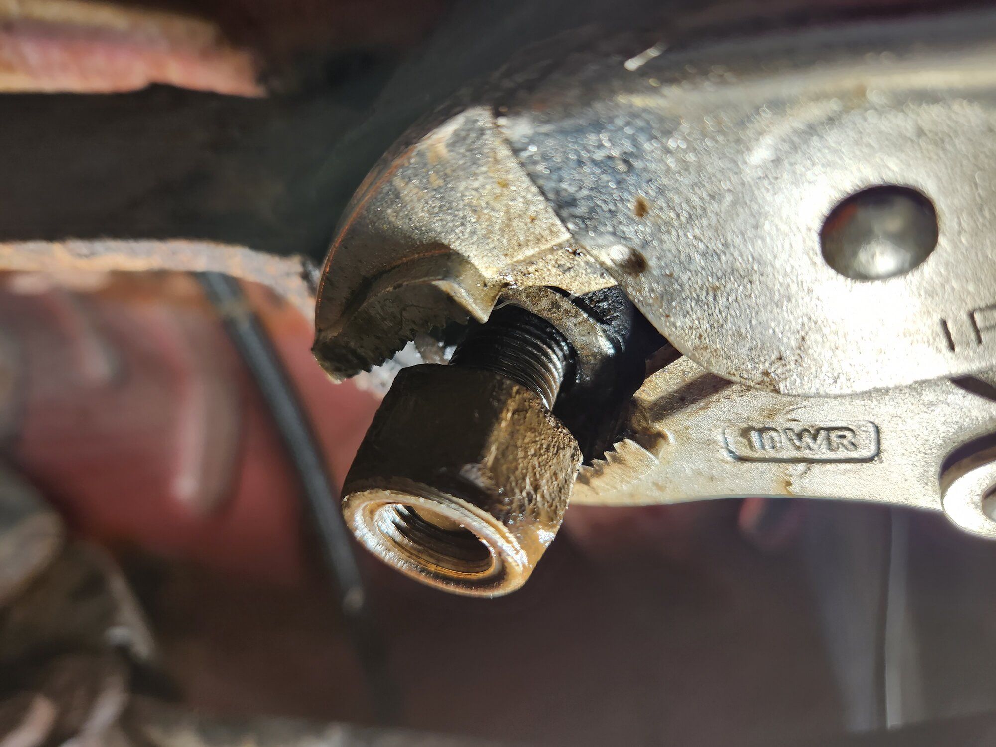

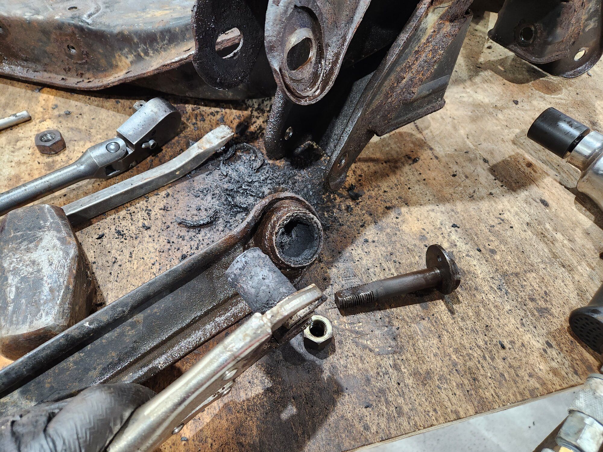

I've got to say, the hardware on these cars are top notch. Surprisingly things came apart without much of a fight. Only issues were passenger rear inner bushing where it meets the stud, froze to the stud, yay. Hammered it with some Kroil, little heat, used a pick to get the space between the stud and inner bushing sleeve opened up as much as possible. What worked after all that was to use vise grips and hammer the nose of them to shock the bushing sleeve free from the stud.
Just like that, I was able to easily lower the K member down, nice!!!
Only other small snag was one of the mustache bar bolts was so rusty I had to pound a 16mm socket on to get it off. Like I said, not bad, I'm impressed. Try that with your 30 year old GM car driven in PA. Ha!
Now that the Trans, transfer case, and rear diff are all out, I'll be boxing them up and sending to TRE (Team Rip Engineering) in Michigan for a refresh.

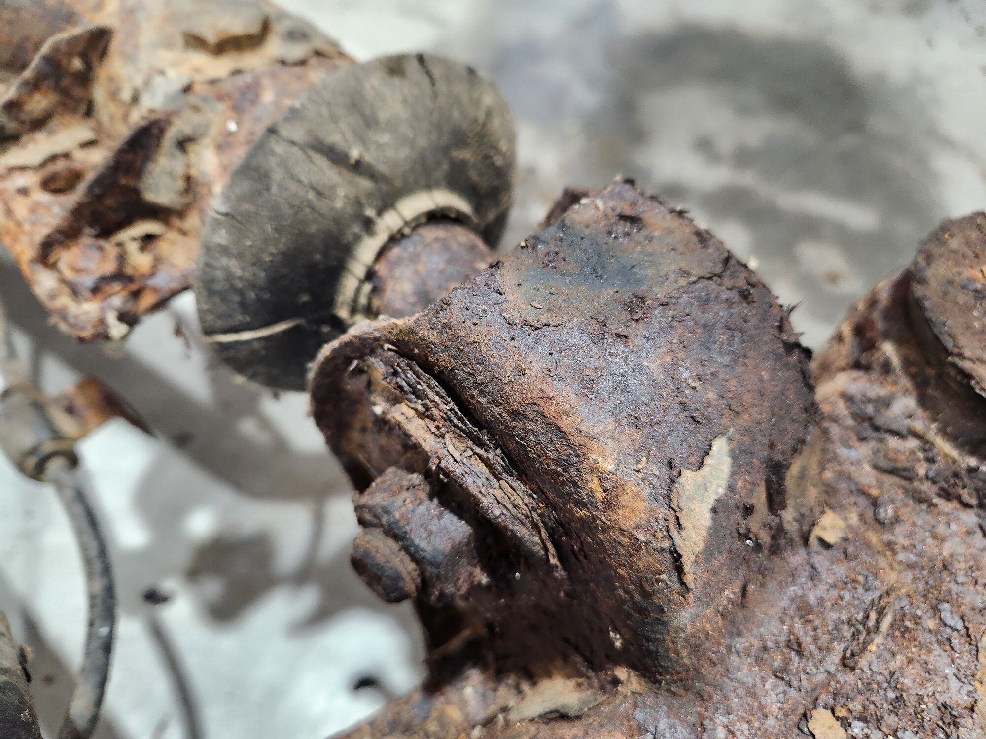

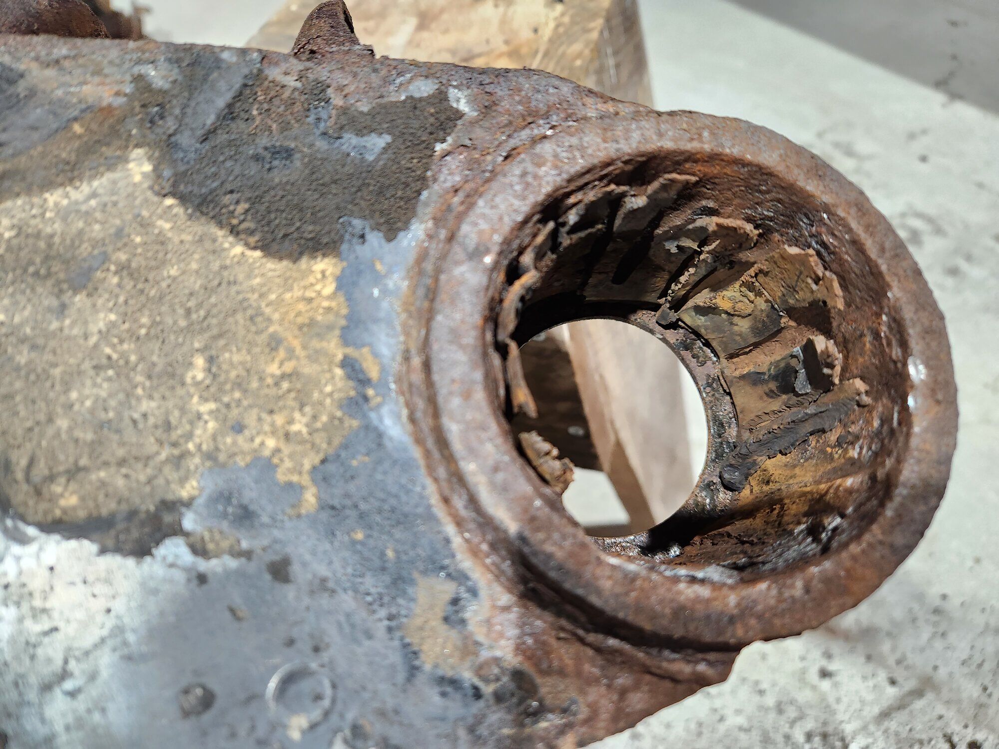

Please take a look at the upper sub frame mounts, do you think I can salvage the upper control arm mount area? I'll have to find some pics to see what it looks like stock. Definitely doing the toe Elim kit, and probably the Volk uppers.

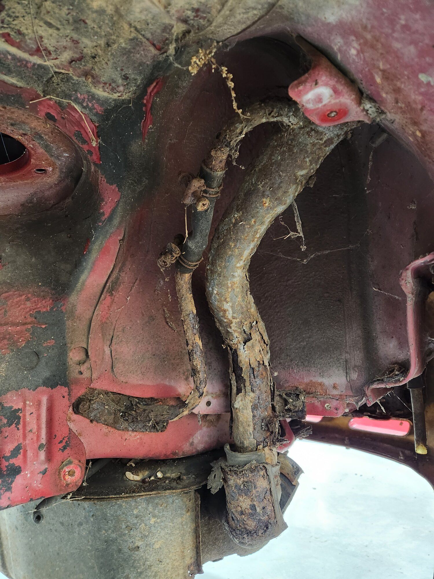

The lowers are so rough might have to go Raybestos or Dorman on these.

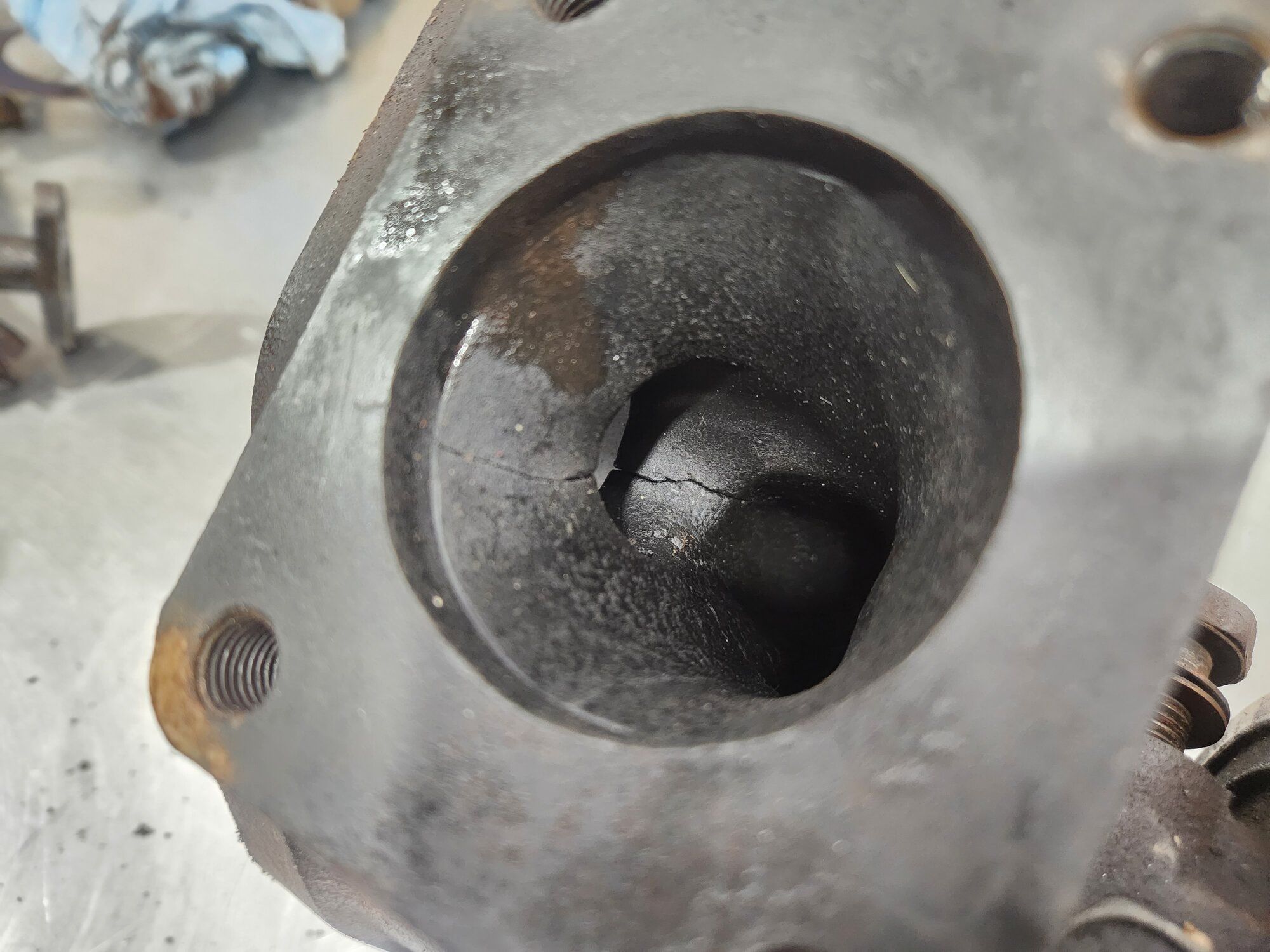

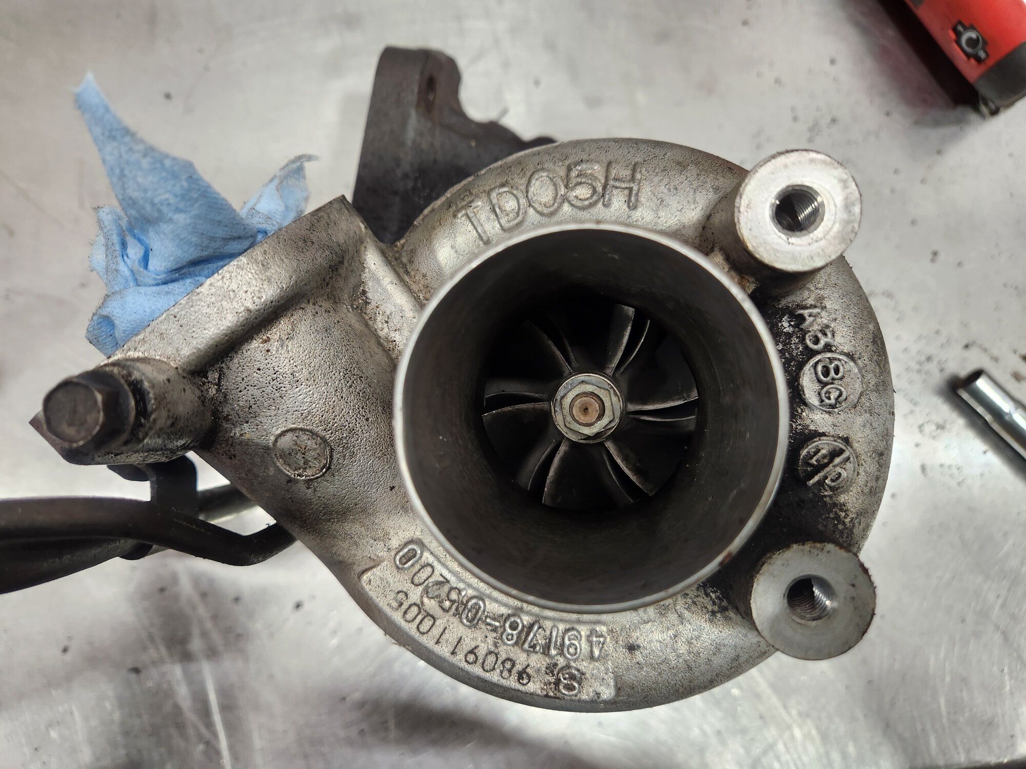

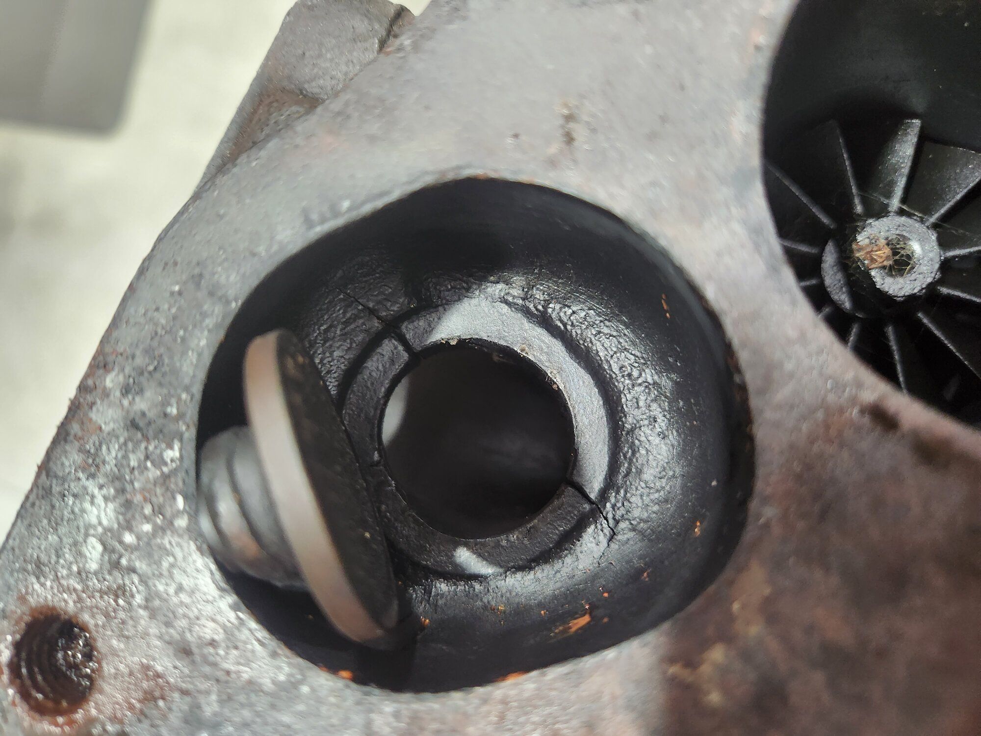

Well, the turbine housing looks like she gave up the ghost...damnit. Oh well, time to look for something a little larger that won't be too big/ have lag for auto x/ street.
Big 16g or 20g?

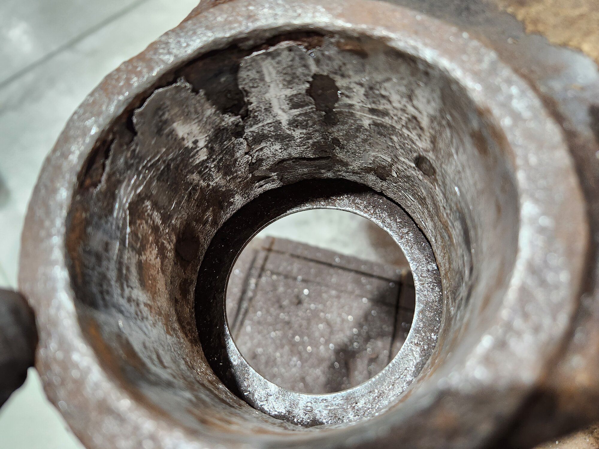

Man, the subframe camber bolts have been a pain in the ass! Haha, but with some patience, heat, plenty of Kroil they all came out without needing to be cut or broken!

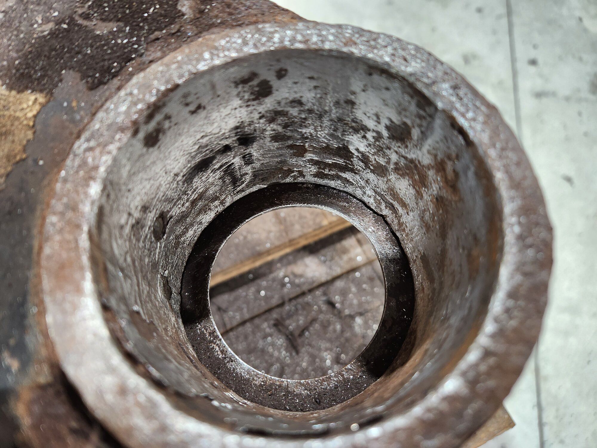

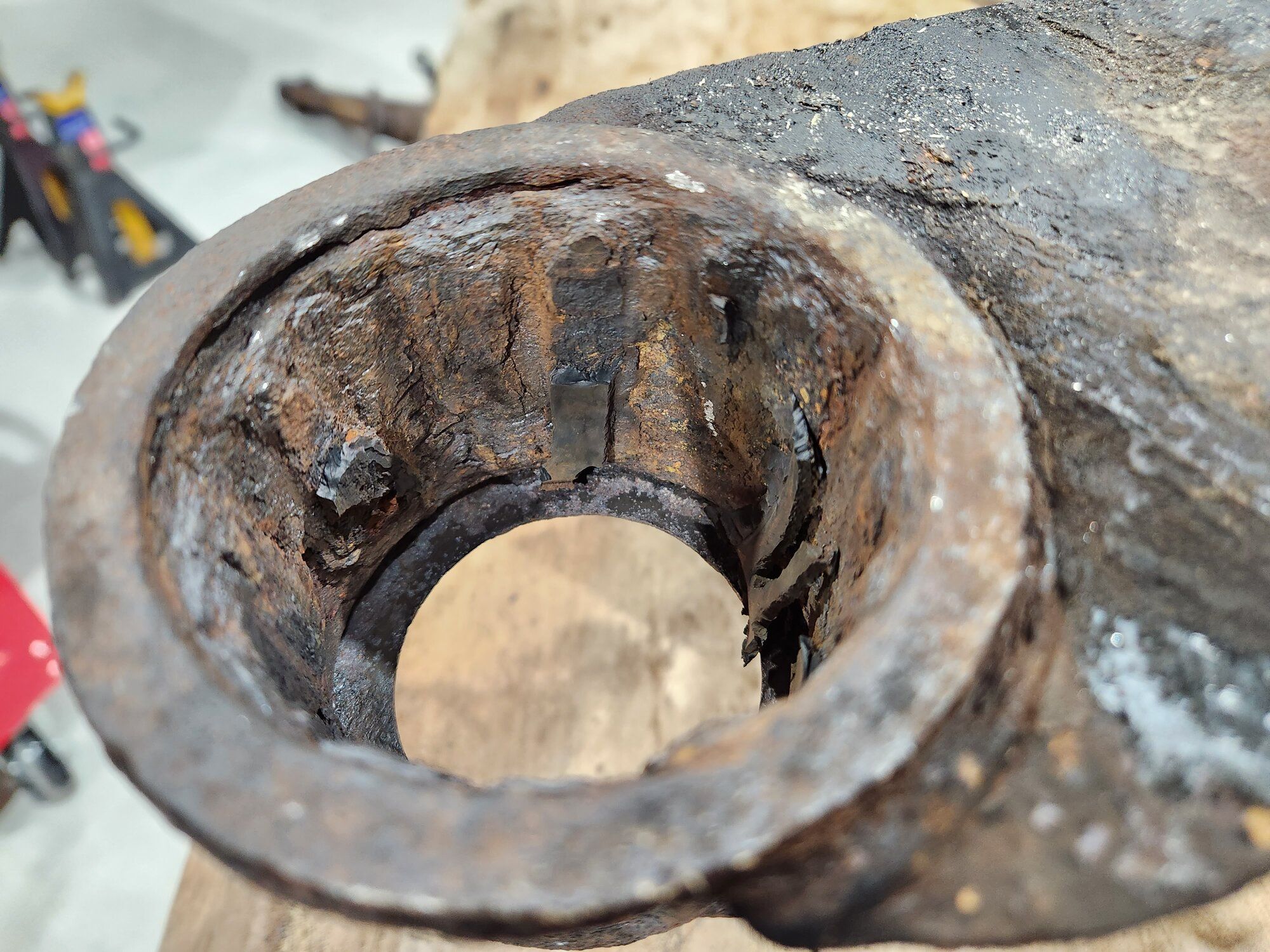

Looks like the sleeve will need to be cut out and the exhaust pipe method used to shim them up may be in order. I'll know as as soon as I have the bushings in hand.

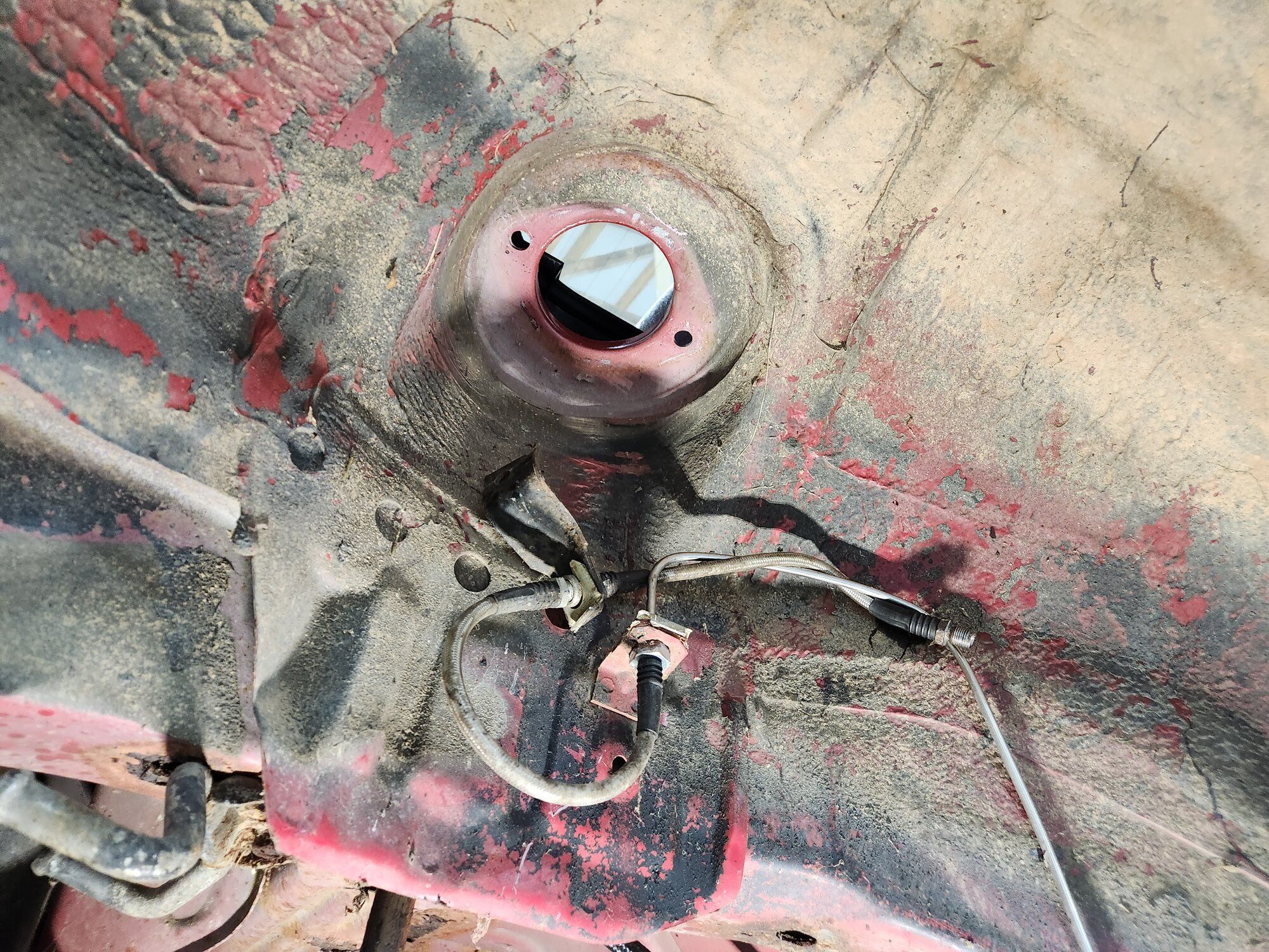

All the rear ball joints are tight so I'll probably leave them. All new poly bushings..etc. Still need to yank the gas tank and get a new filler neck as this one is toast.

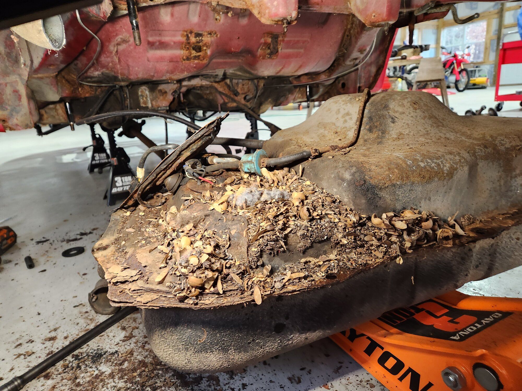

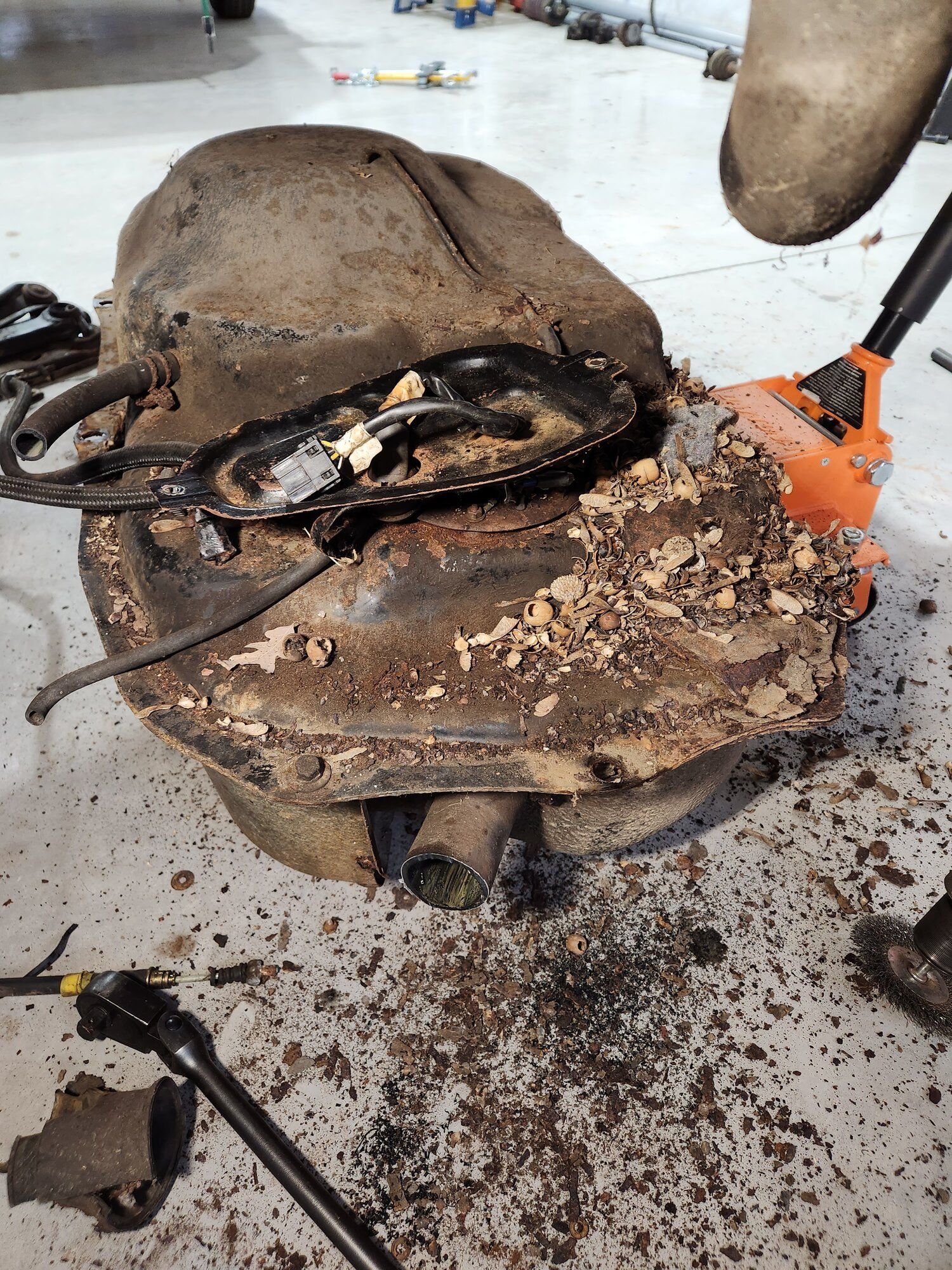

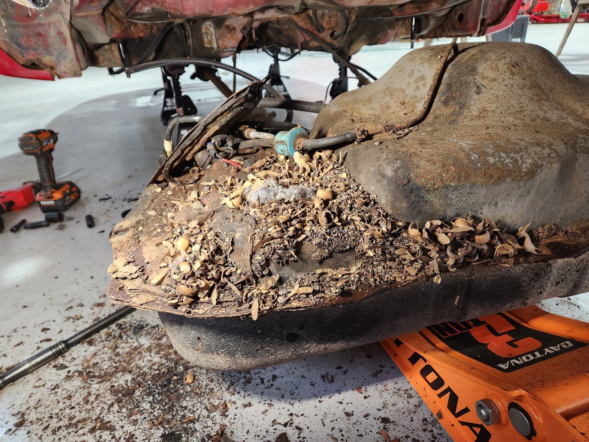

Finally made some time to drop the tank, again, without breaking any bolts! Woohoo!

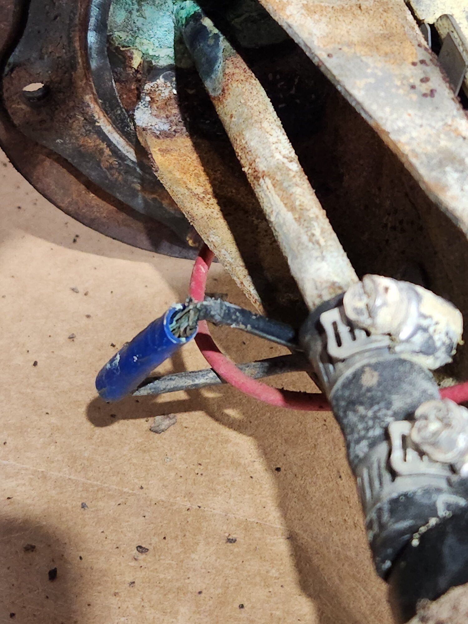

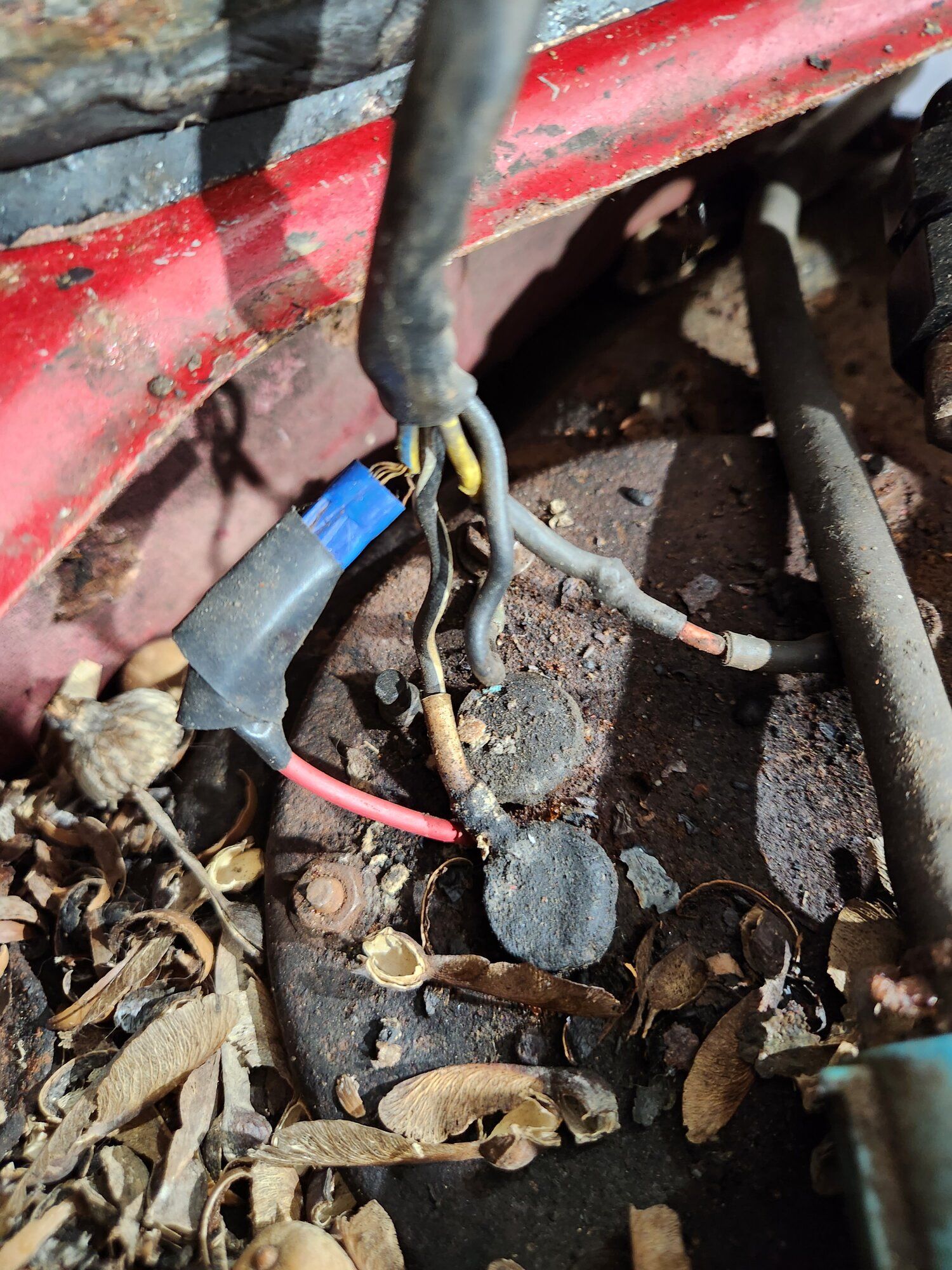

When people say DSMs are *unreliable*... look at that *custom* wiring job! 😂😂😂
Filler neck, well, she's thin and has some pin holes. Anyone have a nice clean AWD one they'd be willing to sell?

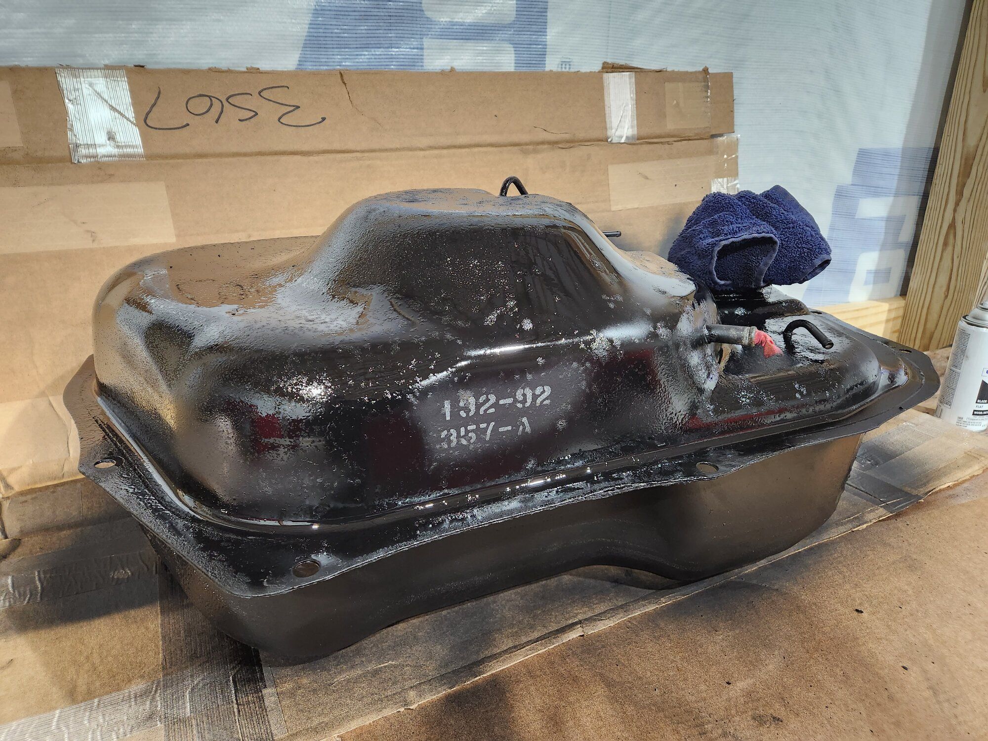

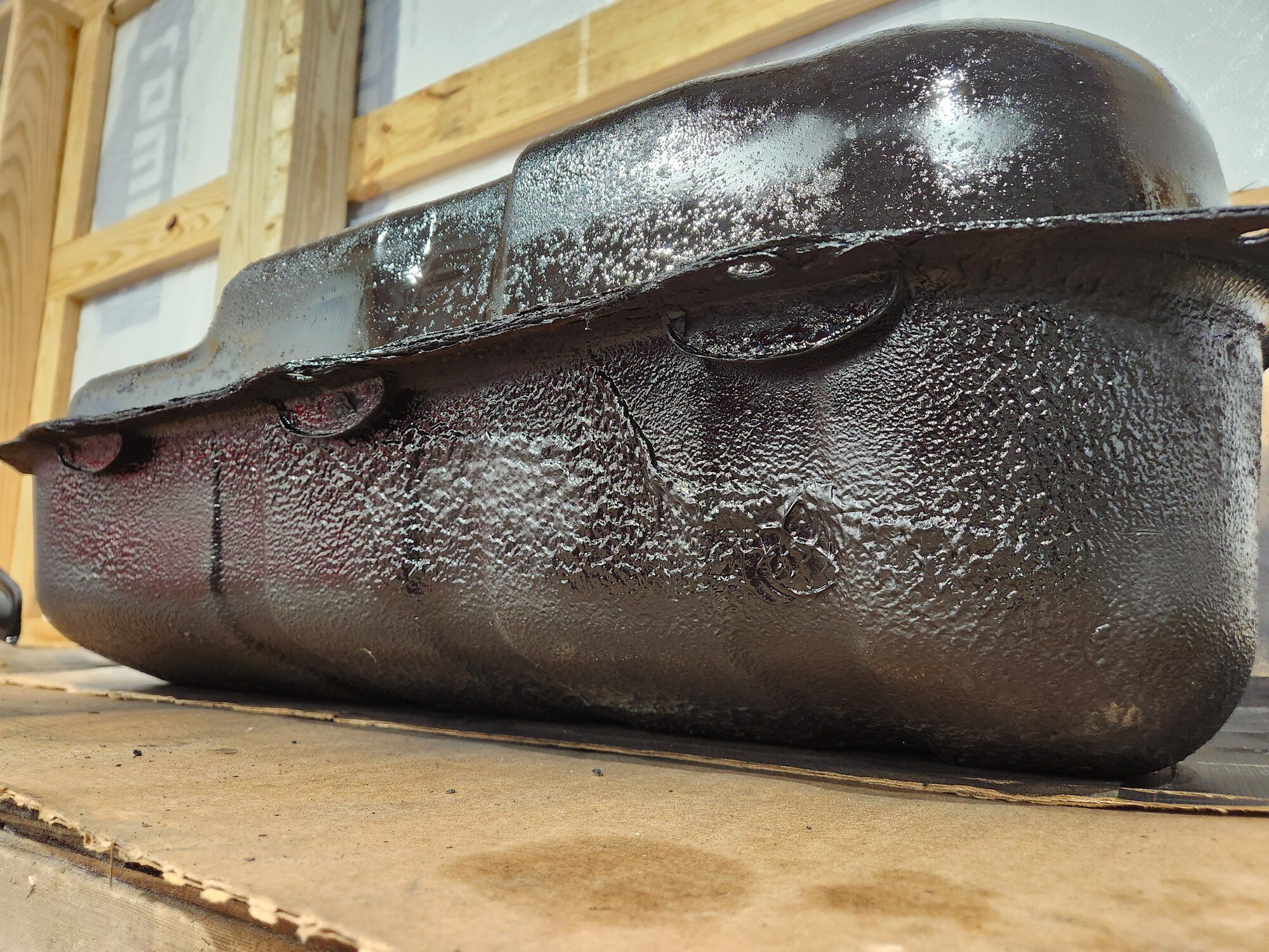

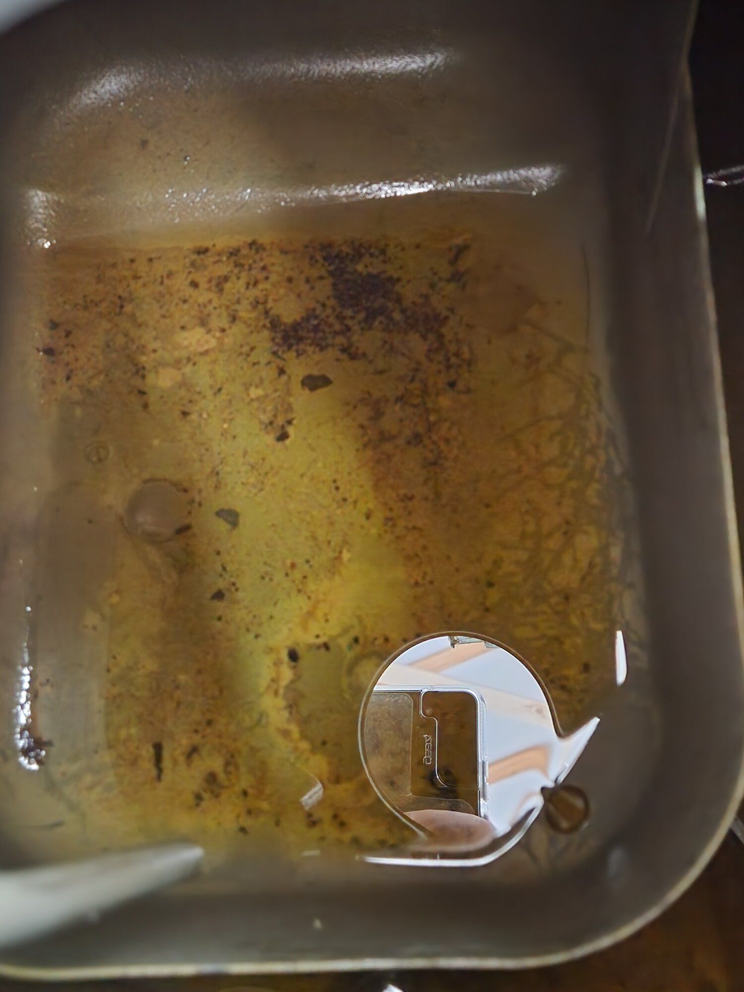

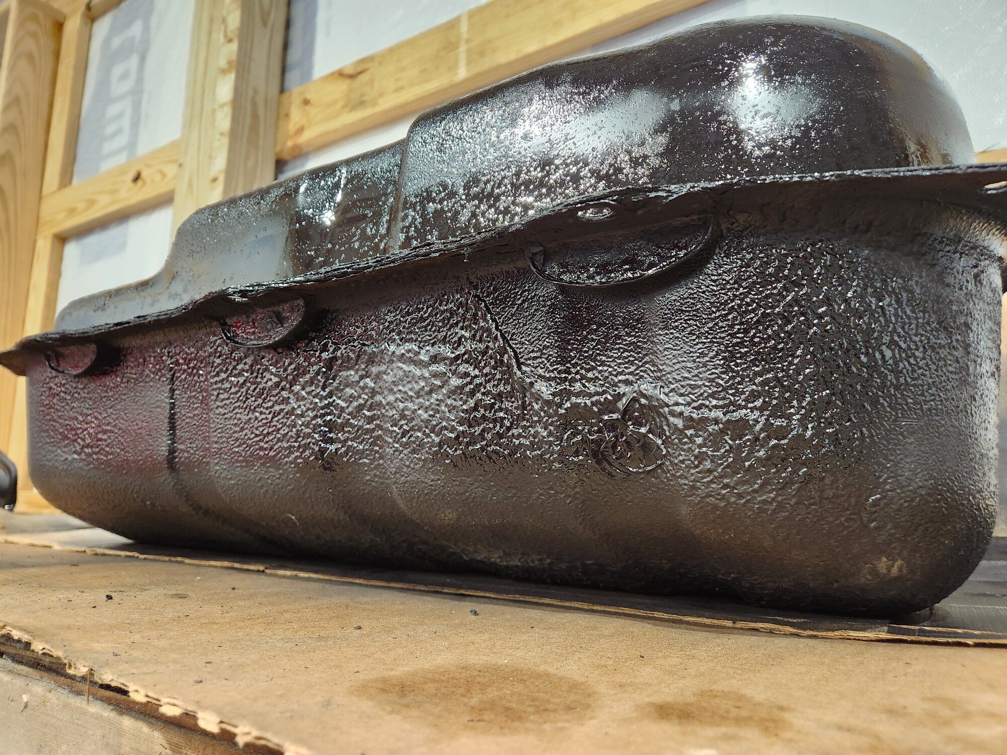

Also, good news, the tank looks solid and only needs a quick cleaning inside and a little rust converter on the exterior lip!

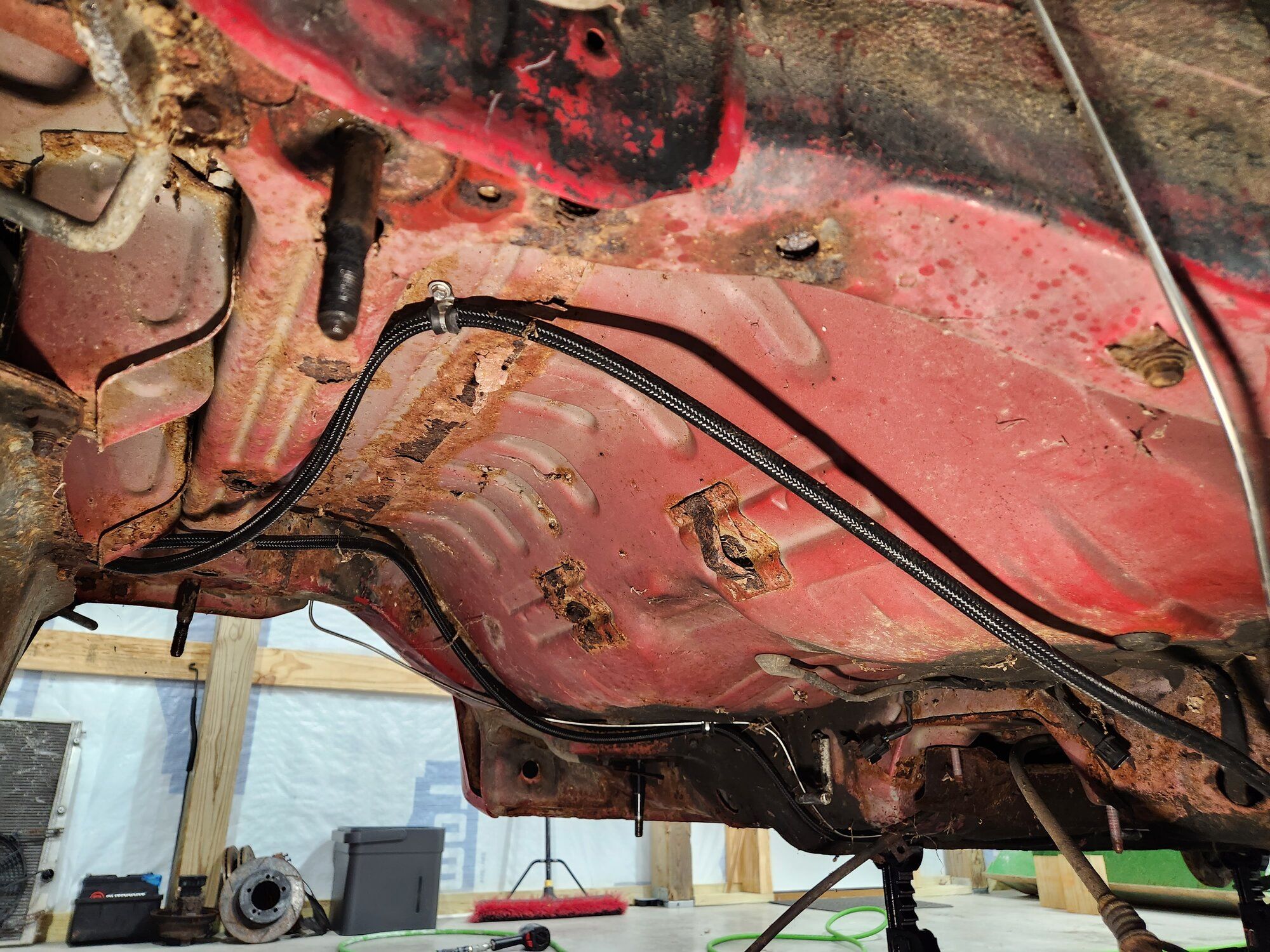

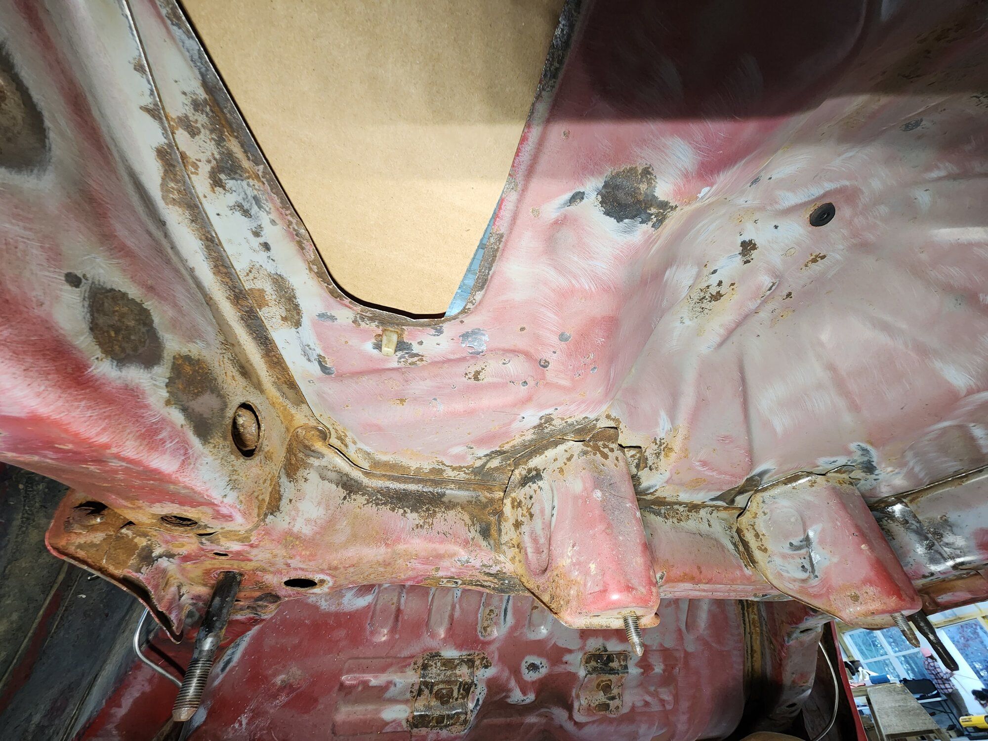

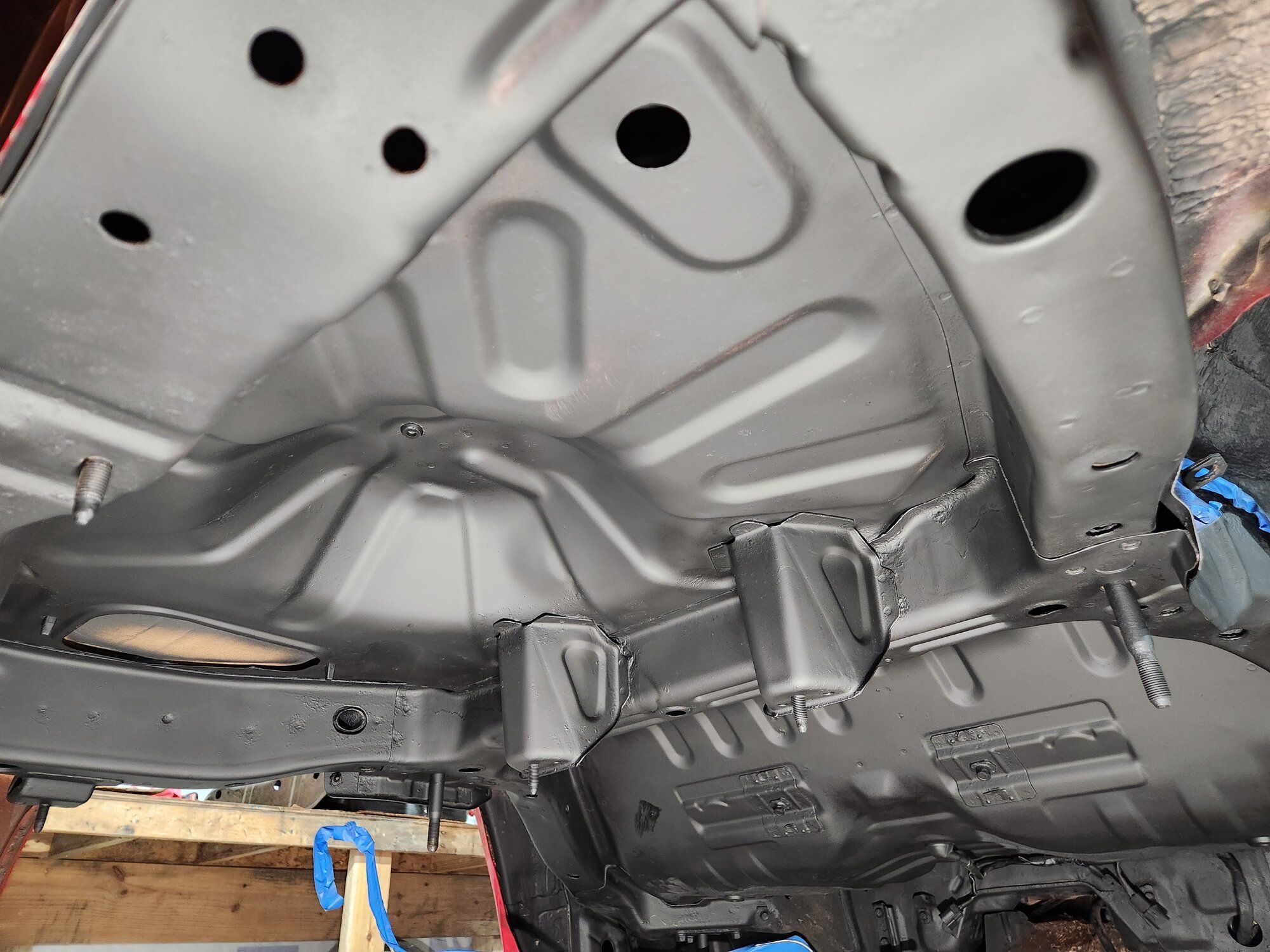

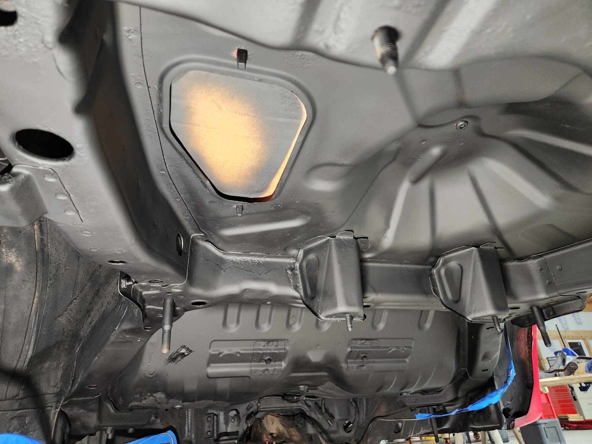

Wire wheel'd all the unibody seams, sprayed everything with rust reformer, and even got a coat of flat black on there before temps went to shit again.
For a 30 year old PA car, it's surprisingly not bad at all!

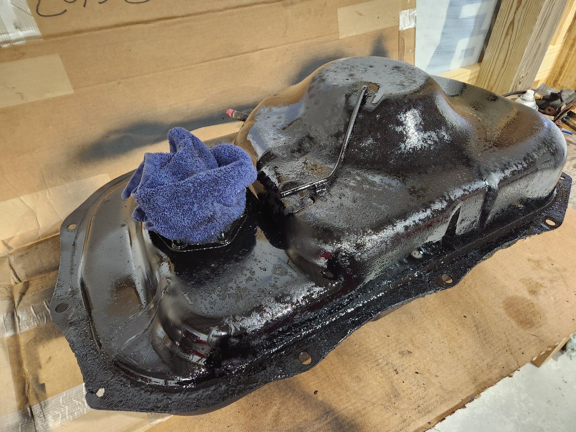

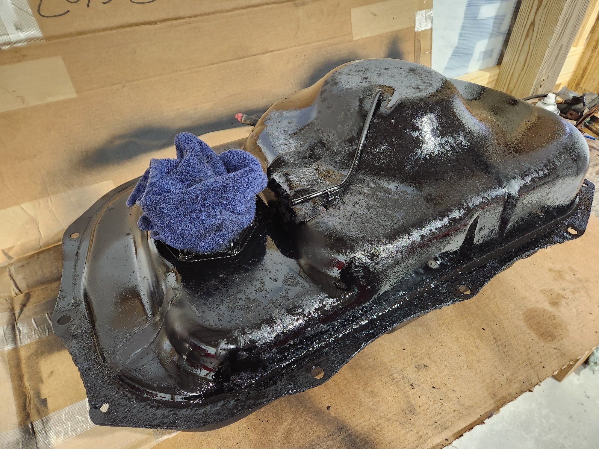

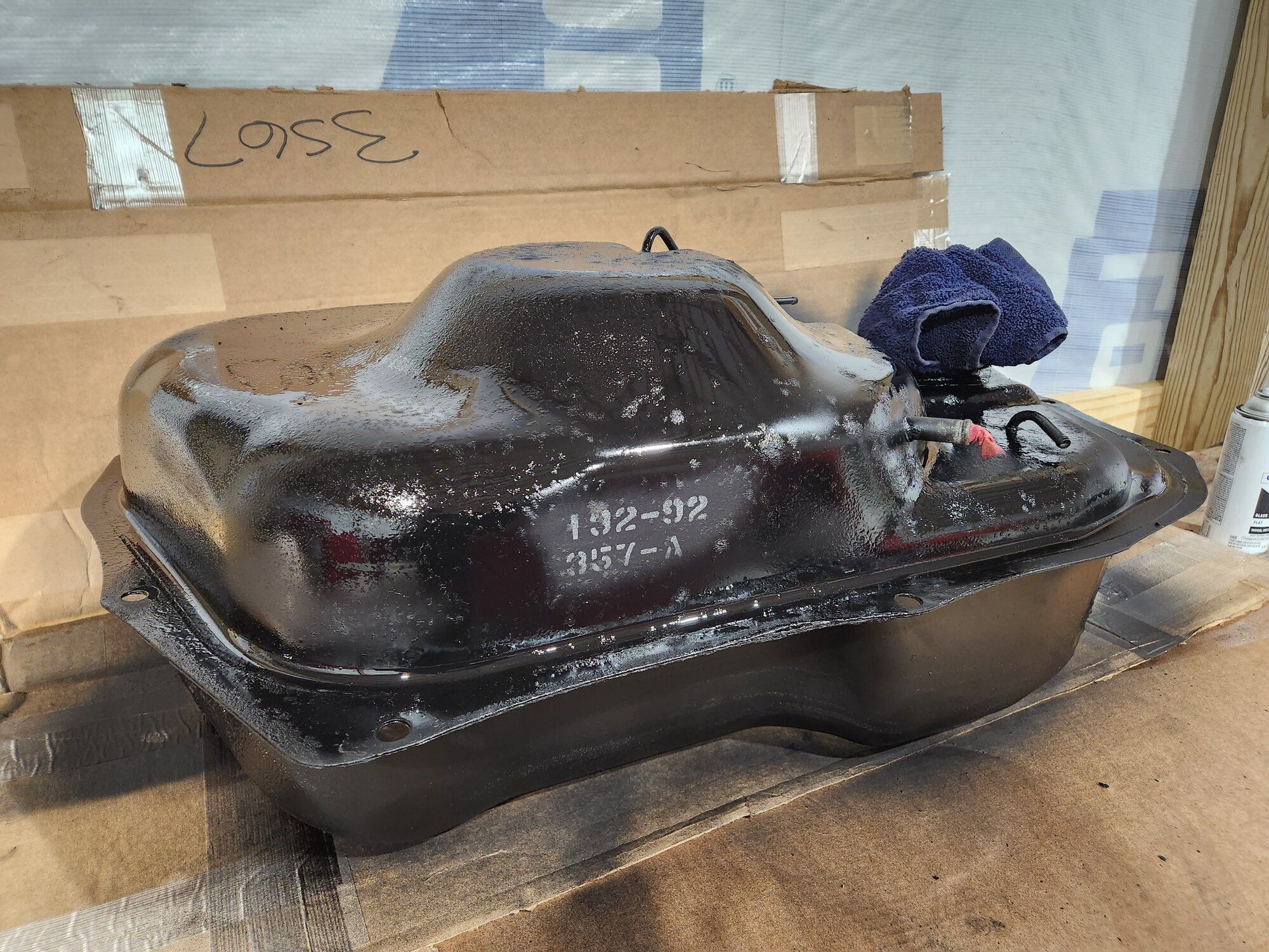

Hit the tank with some cleaner, washed it, some rust reformer, then a coat of flat black as well.

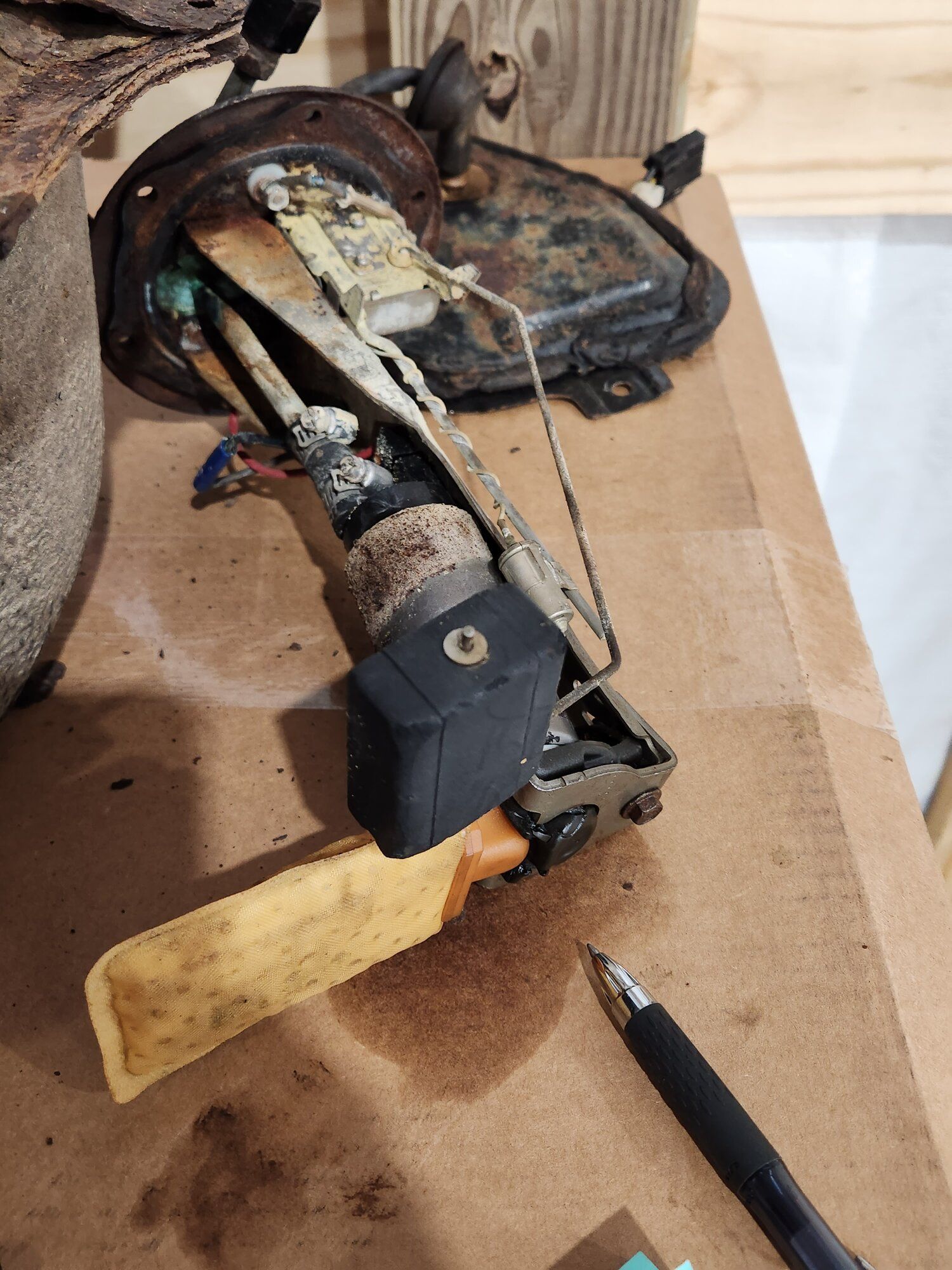

What are you guys doing for a fuel sender? I've yet to test it but I'd be shocked if it worked at all. RTM, or fabri-cobble something together??
Seen that one, looks great. Says on their site about the sending unit (for the fuel guage);
"Be assured that the fuel gauge sending unit is NOT included with your sending unit under any circumstances."
Need to find a new fuel guage sender, or fabri-cobble a new (other) unit.
That RTM unit sure is sweet though.
