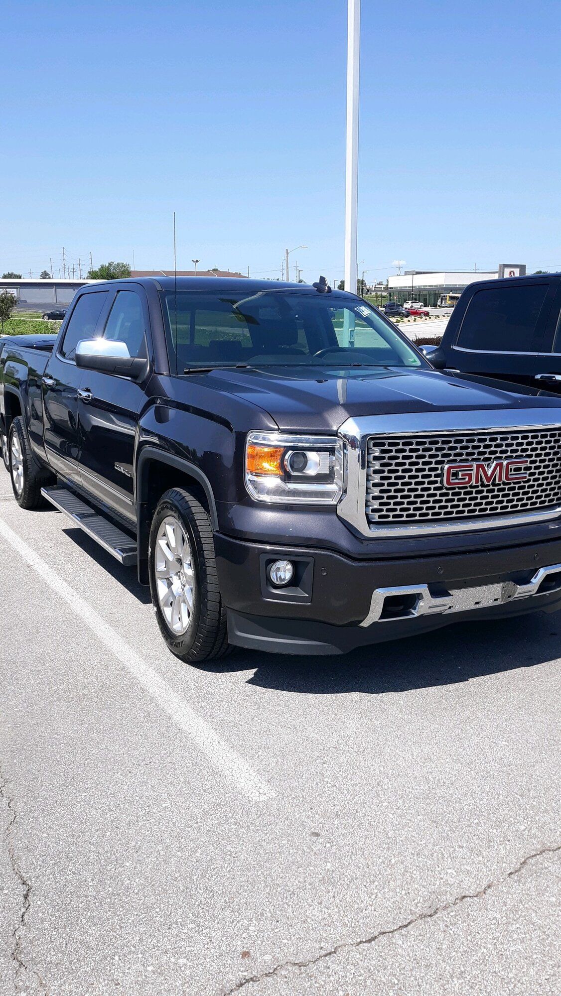

Getting the truck ready for some road trips. Last summer traded a 2500 and a R32 for a 1500 Denali. Changed out the front bumper to Chrome, 7 inch lift, 35 on 22 inch wheels, tow mirrors, A dash programmer,Flowmaster exhuast and S and B cold air intake. Waiting on some stuff to show up, tonue cover, rear weather tech, Head unit (full screen conversion) and a wireless phone charger. Later I want to add rear air bags, and change the gear ratio to 456. Reason I'm posting this, well I'm hualing a bunch of parts up to Tim Zimmer. A before and after.

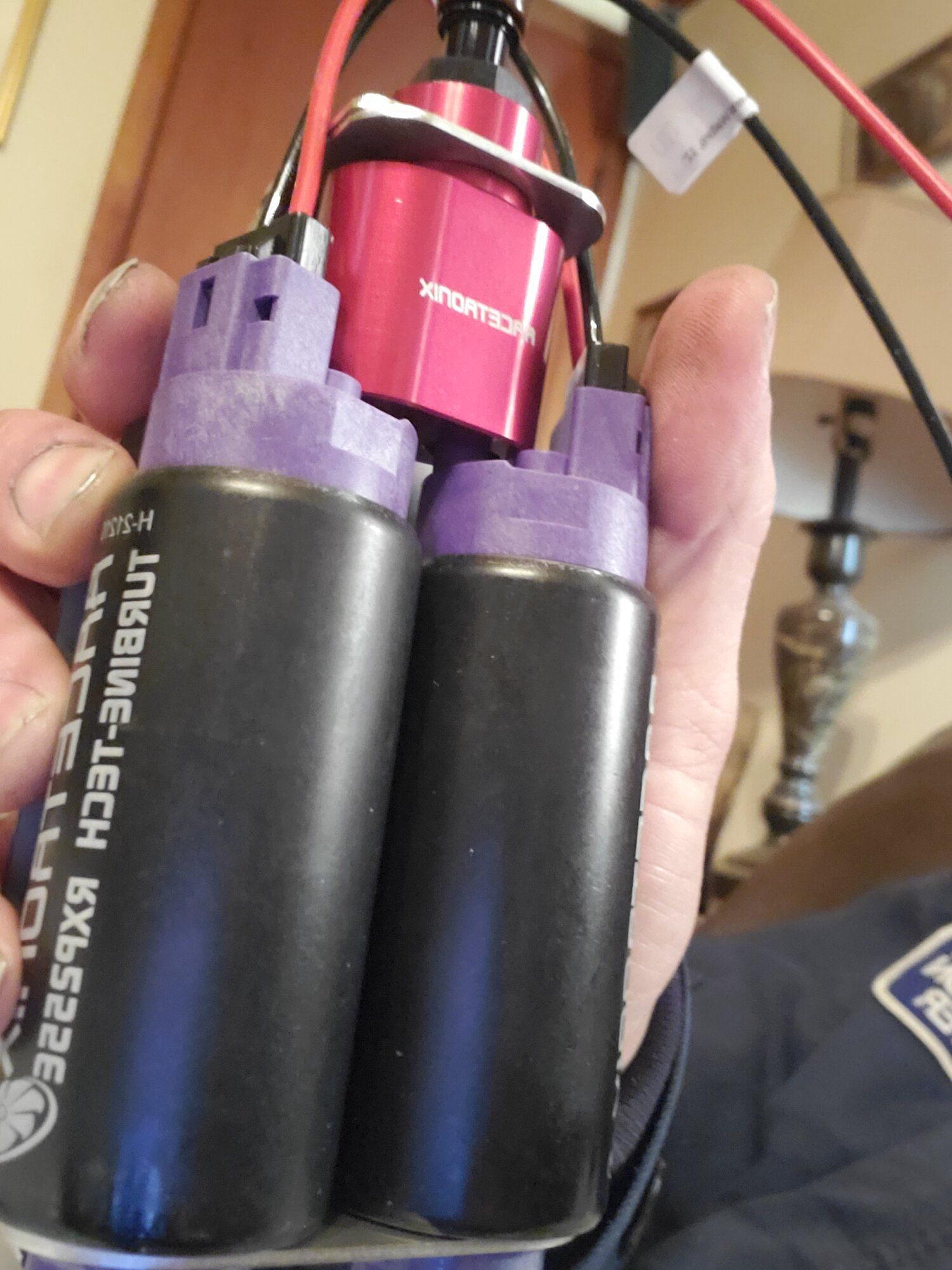

Not yet. Trans,tcase,rear diff, doors,hatch,sun roof plug ,rear subframe and header are on order. Still need to get machine work done to the block. Orderd some of the oiling system mon, a Peterson remote adjustable pressure regulator and a remote filter housing with thermostat.
