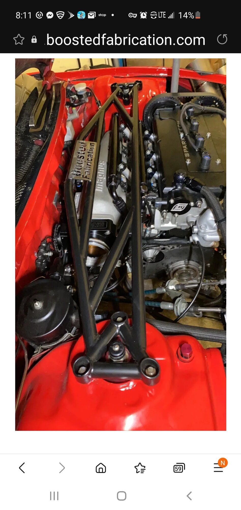

Well my strut tower brace showed up from Boosted Fab. Alot stronger mounting setup from the others I have seen from other manufacturers and light chromoly. ;) . This is not my car.

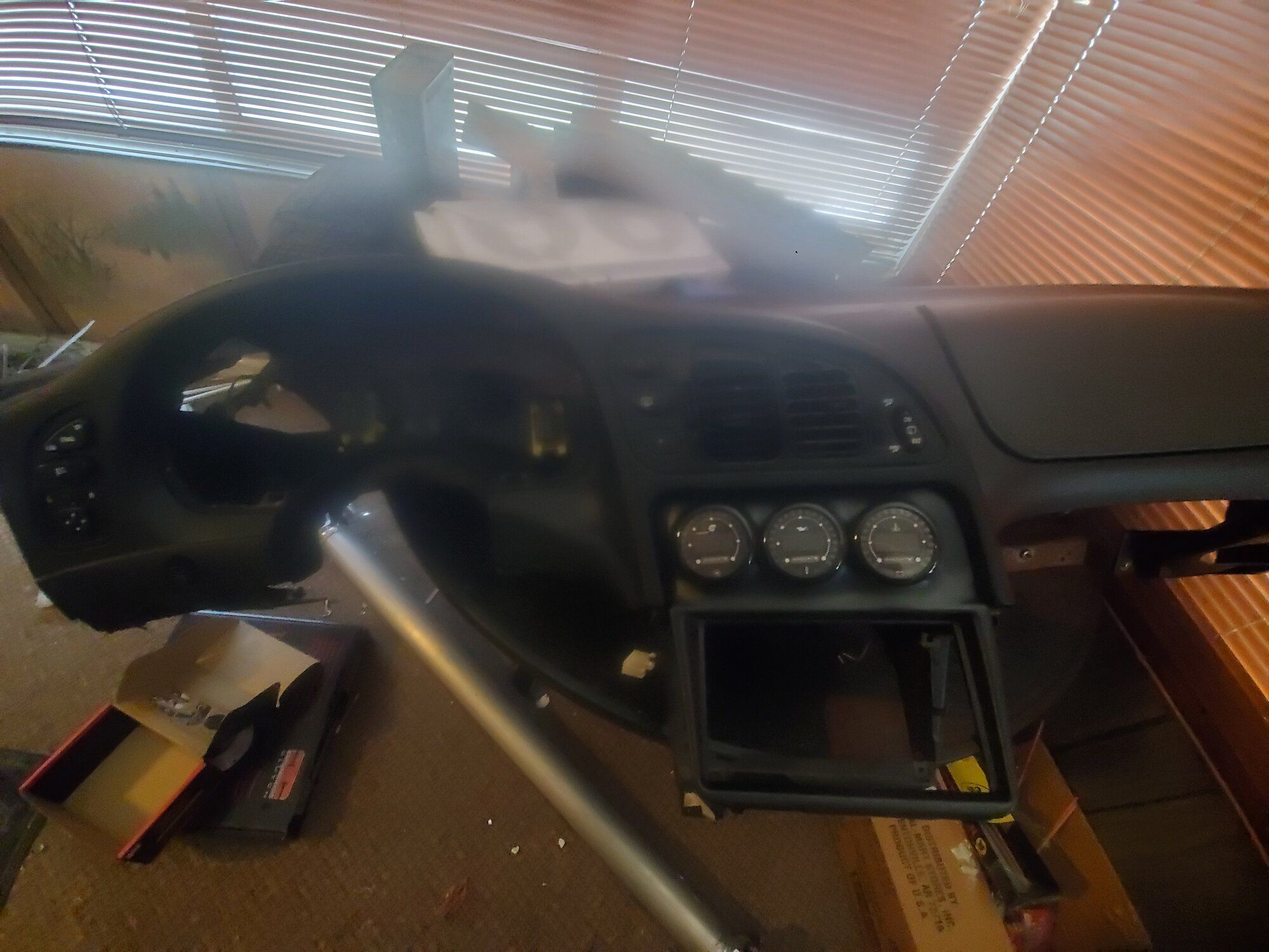

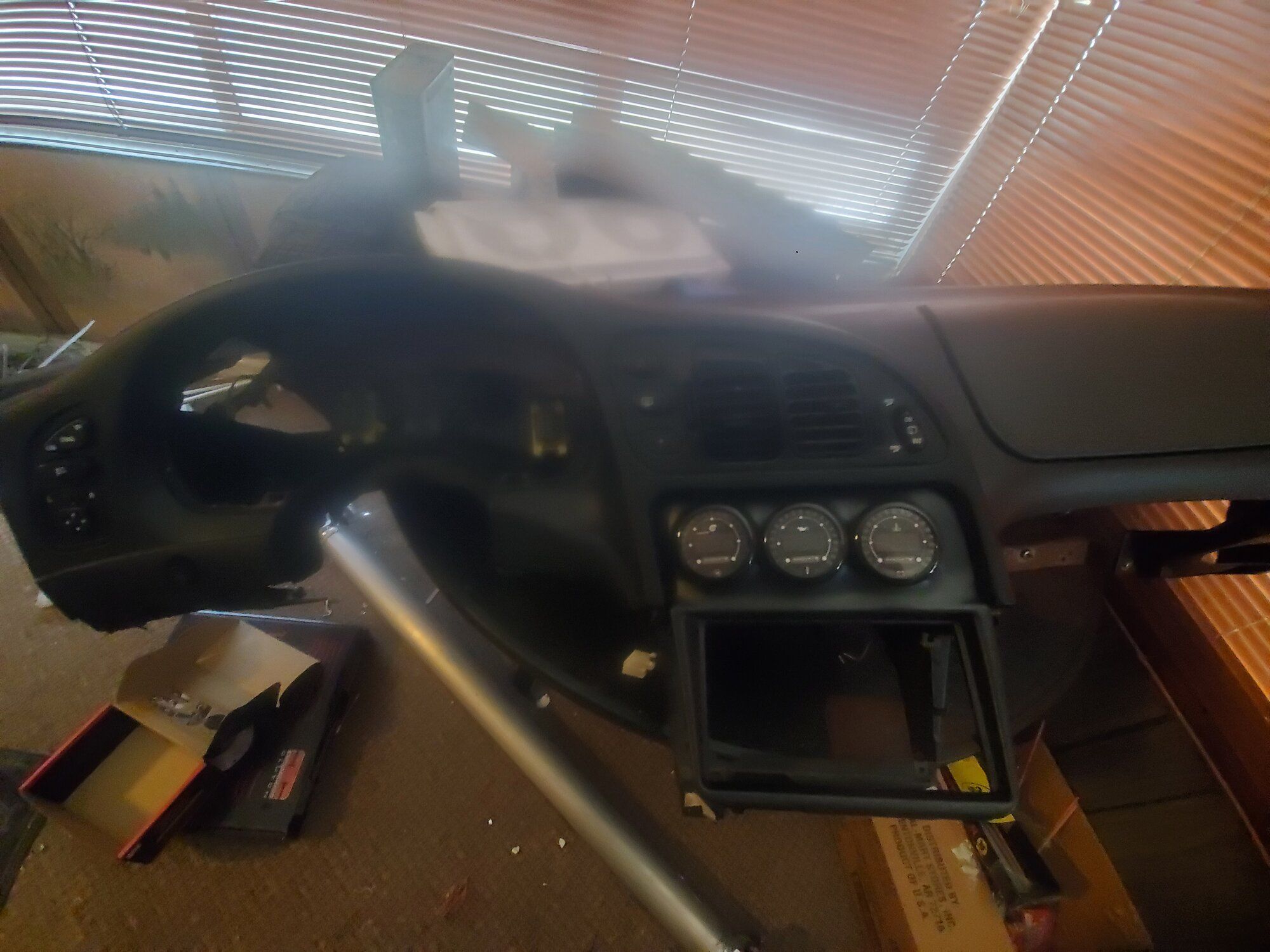

I got a set of these. Haven't installed them, but they look amazing.

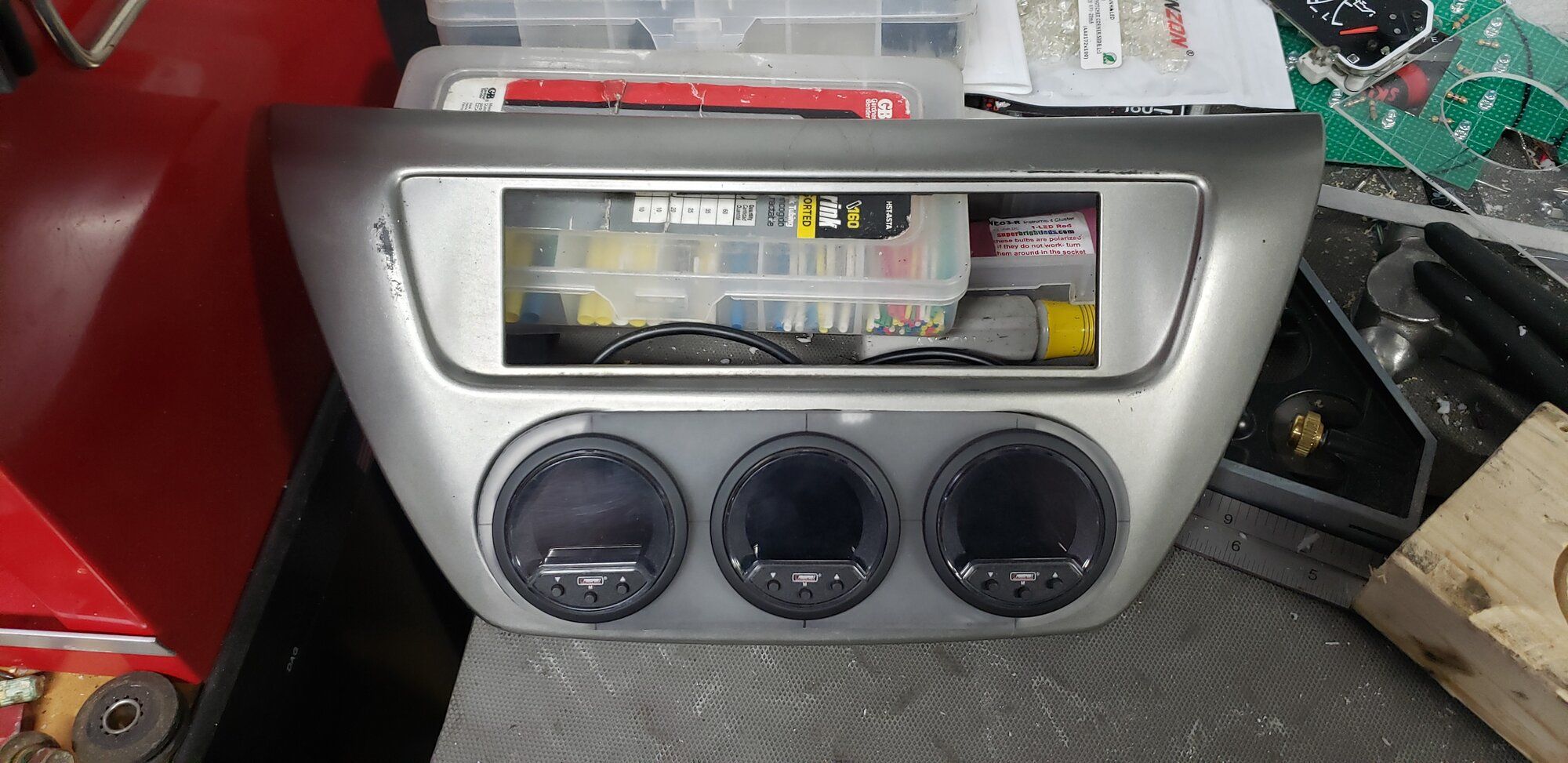

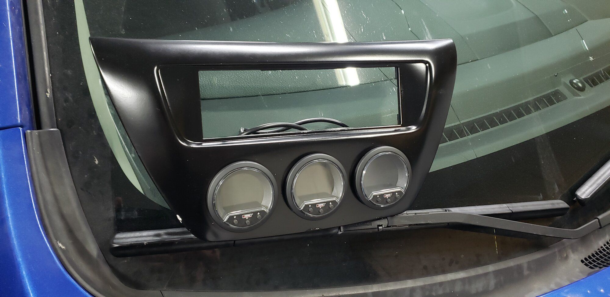

Maybe I'm being picky. But the body man in me says thier quality sucks. Broken tab on the back, lumpy bodywork, a couple of pin holes, and the guages are a little uneven (tilt) and off center. Time to file a complaint.
Let me guess. Ortiz "custom" pods?

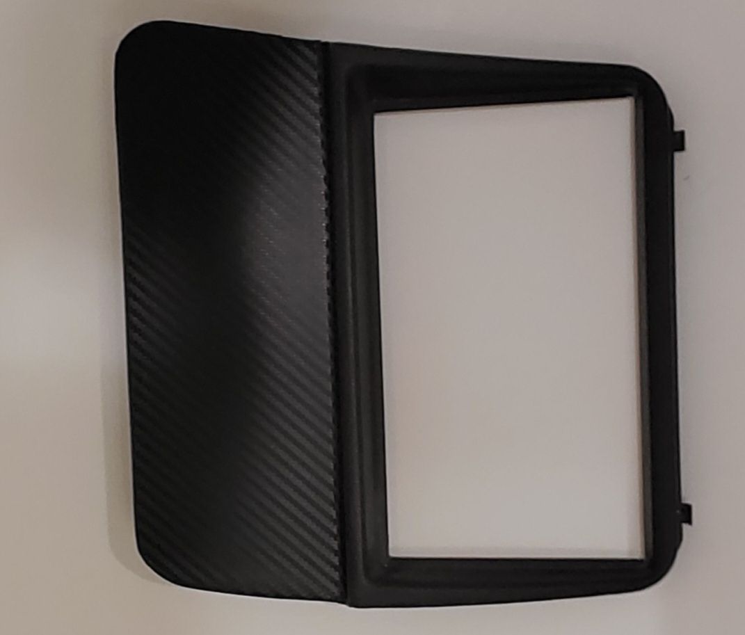

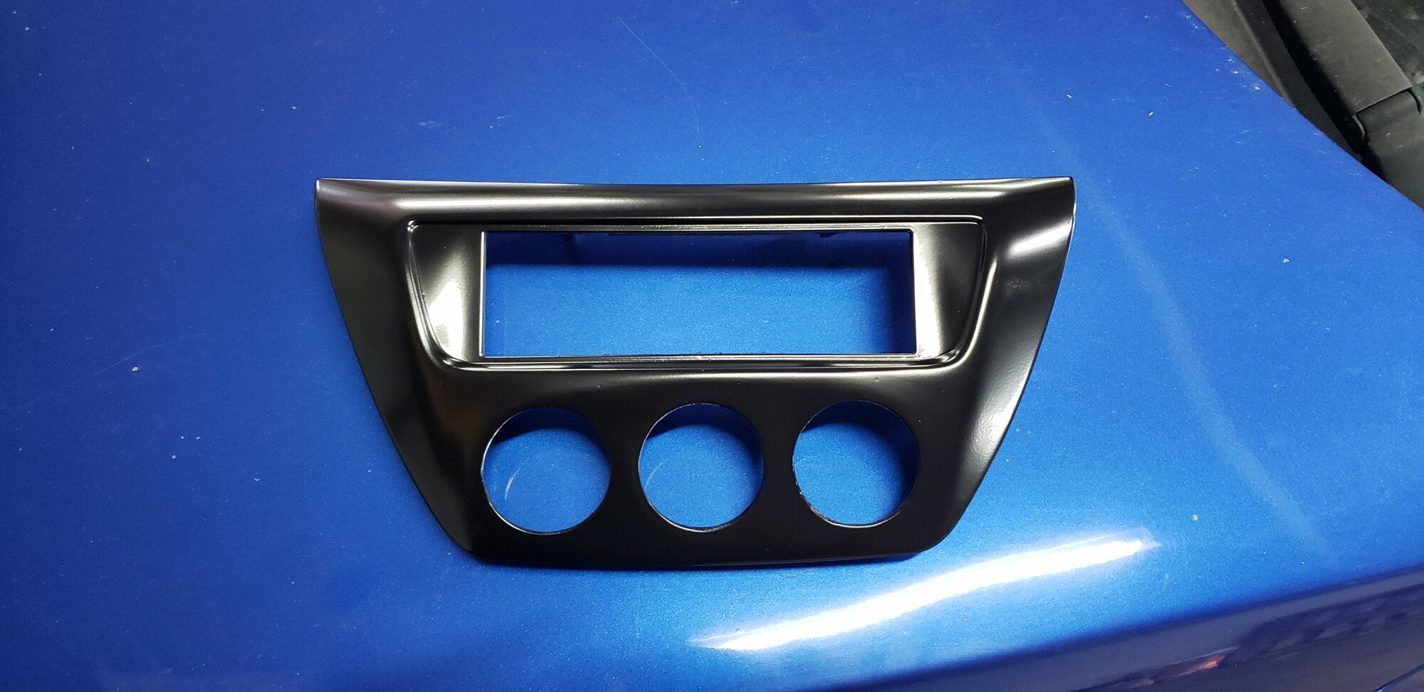

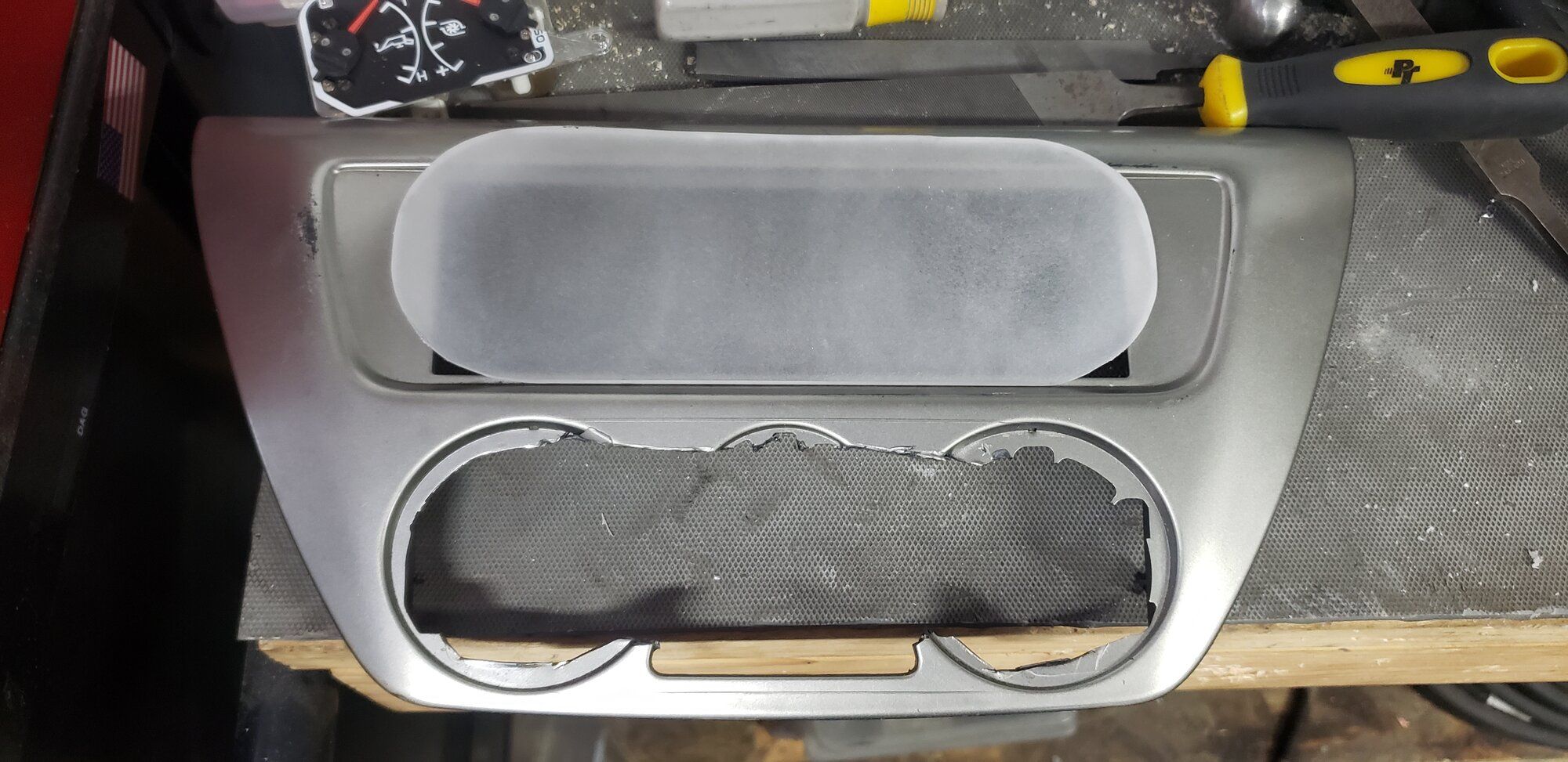

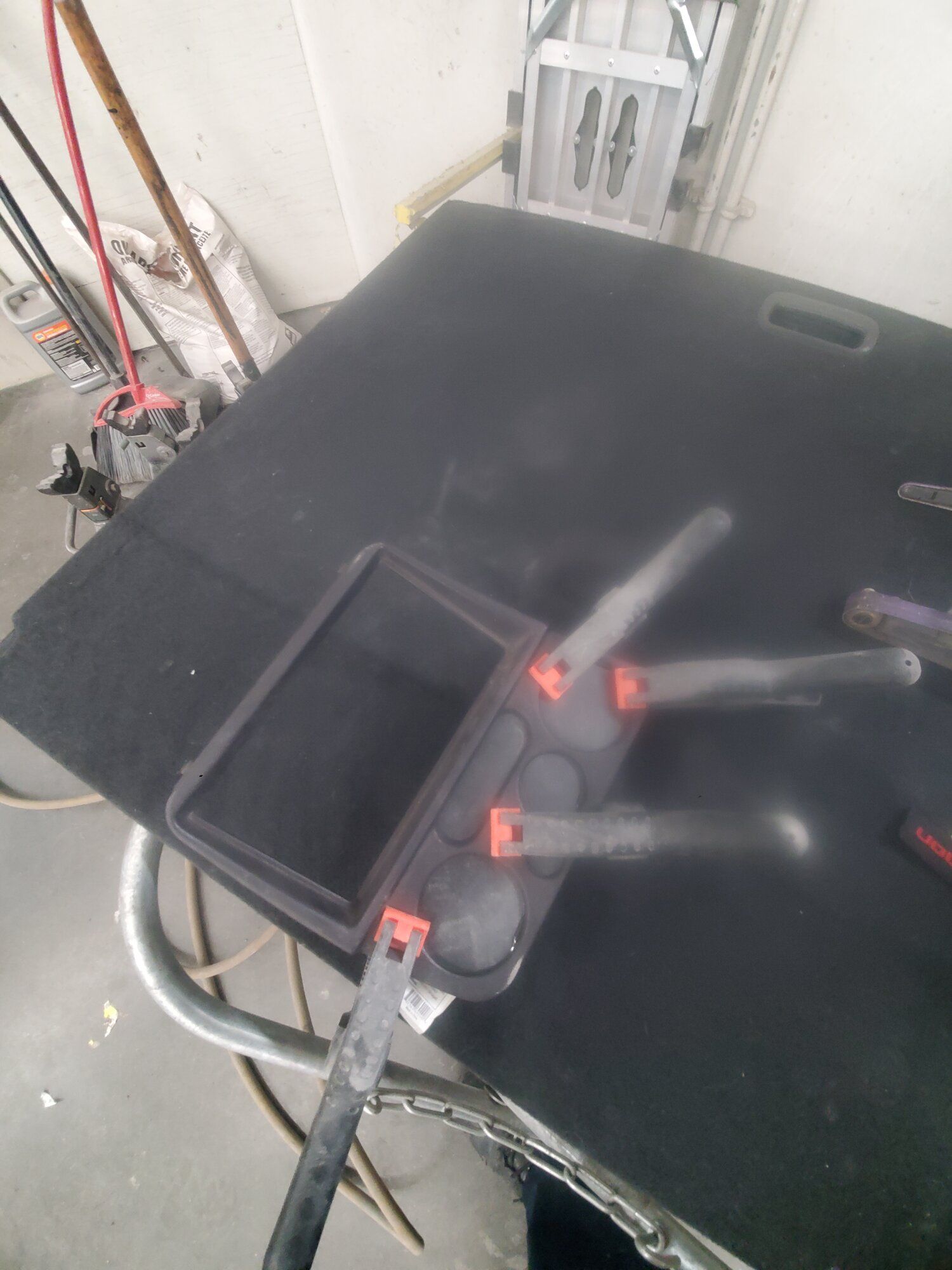

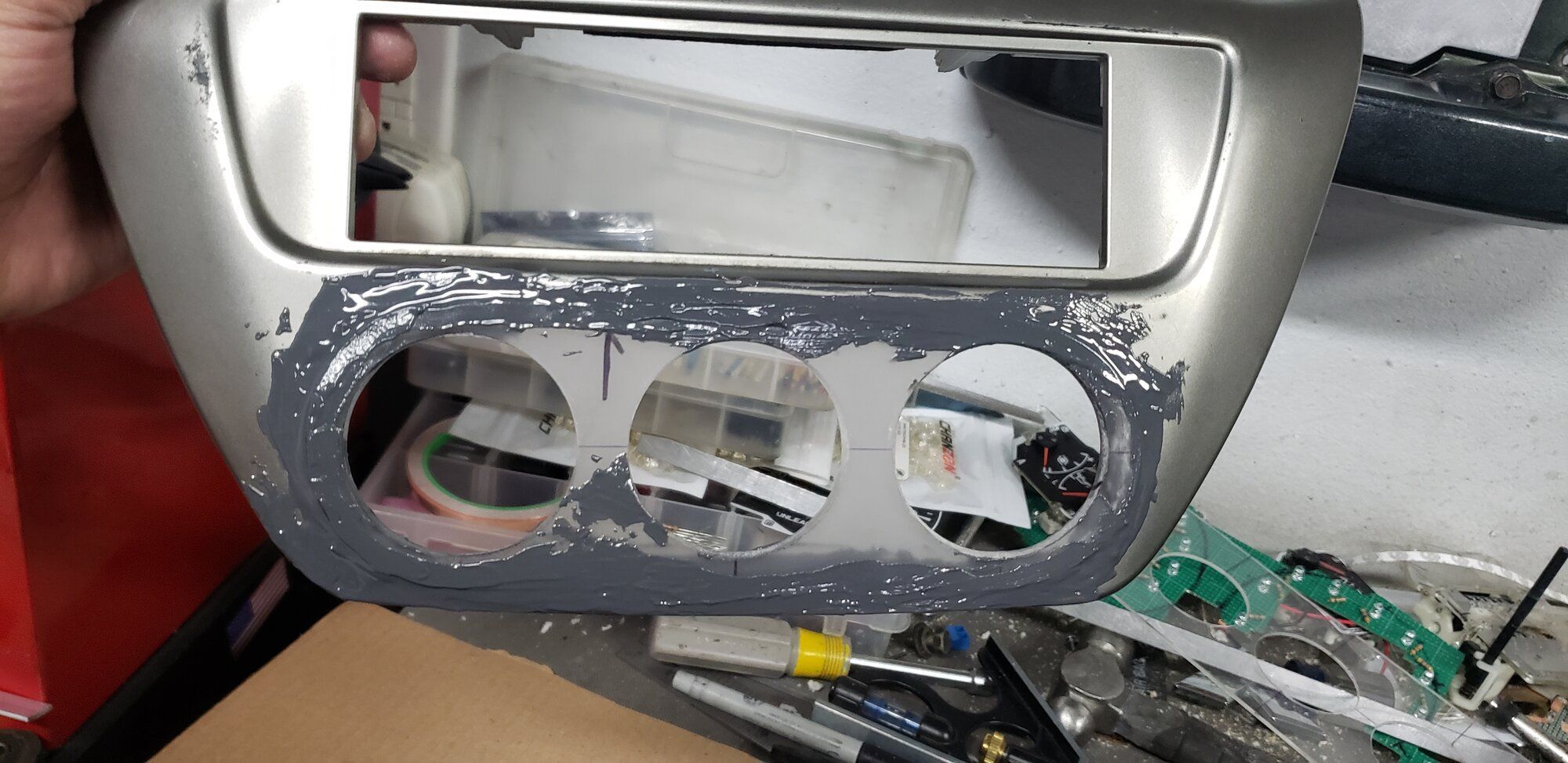

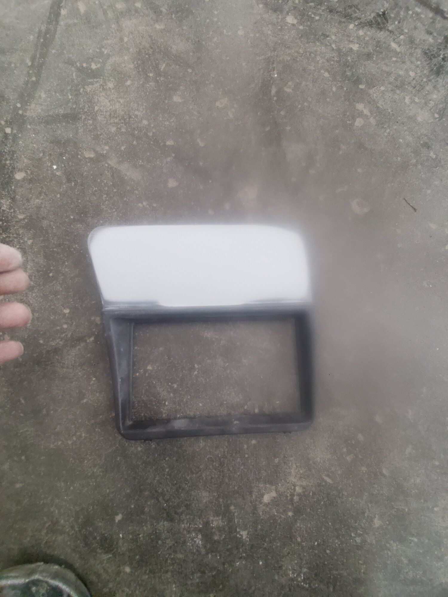

So after some thought I made my own guage holder for the a/c, heater switch area. I bought a clip board from Walmart (pvc) cheap. Carved it out to make a backing plate, glued it to back using panel bond adhesive. Filled in the front with autobody filler and sanded smooth. Marked and drilled the pilot holes. Then using a flat black carbon fiber decal cover the switch area. Ugh waiting on the 2 1/16 hole saw bit.
