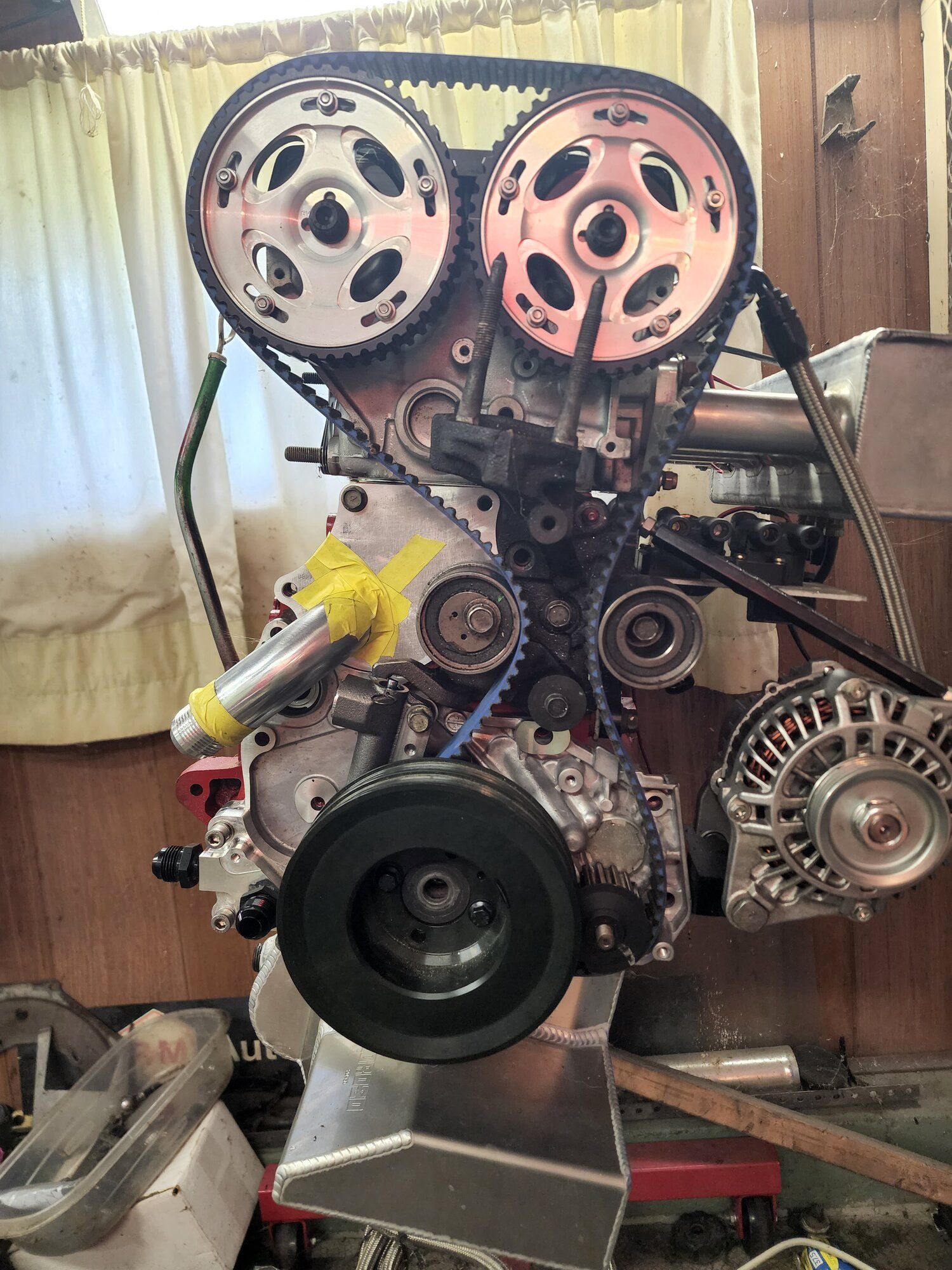

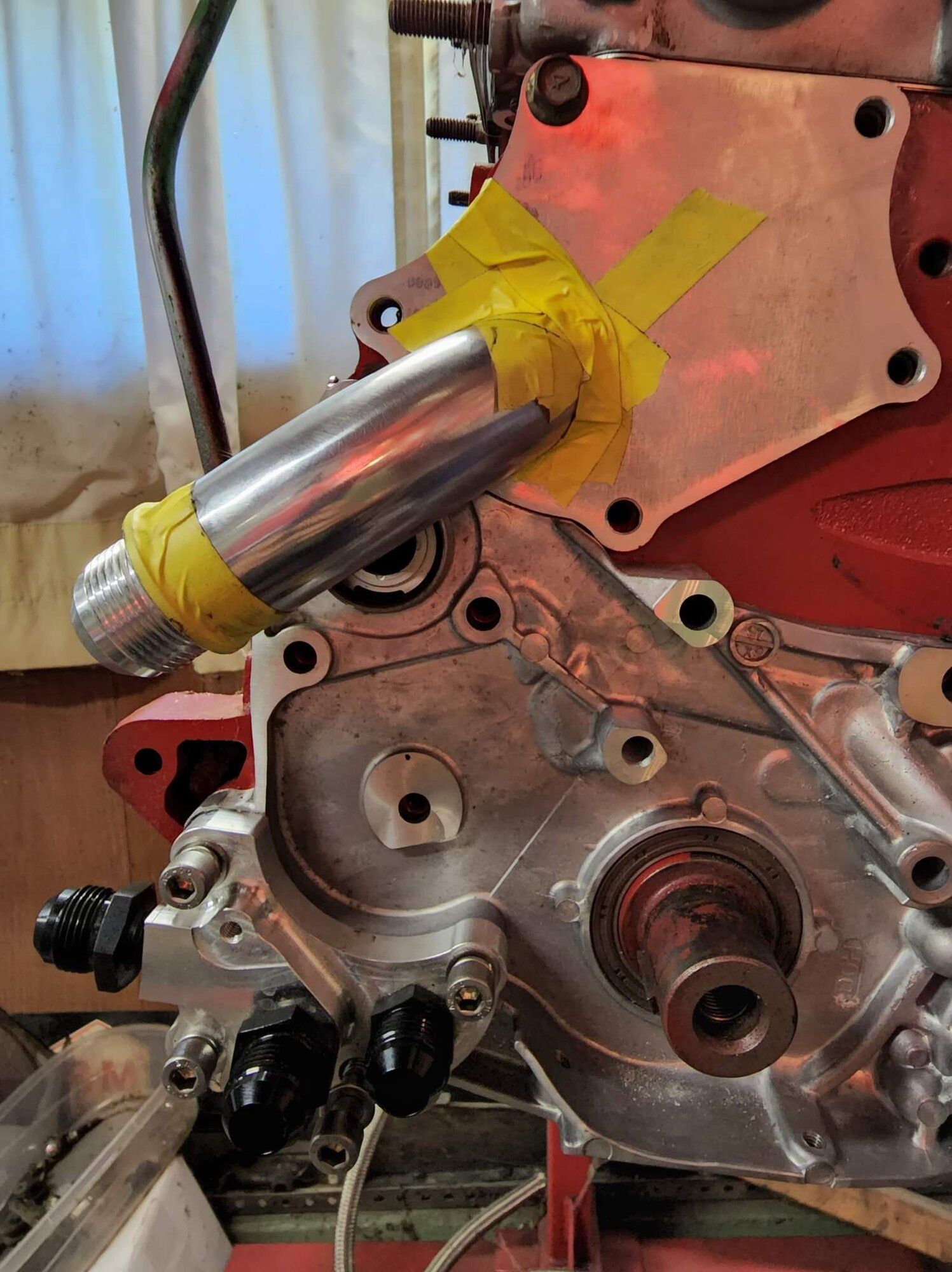

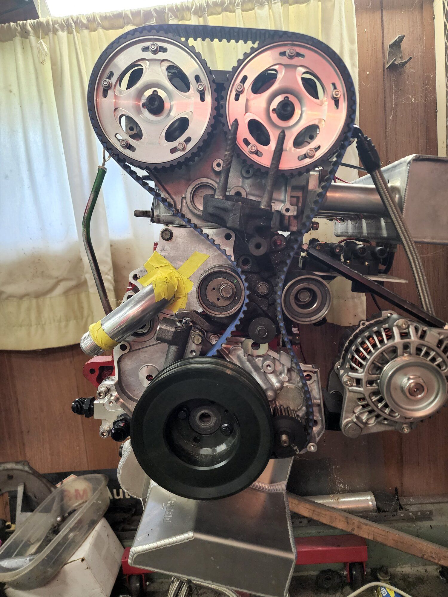

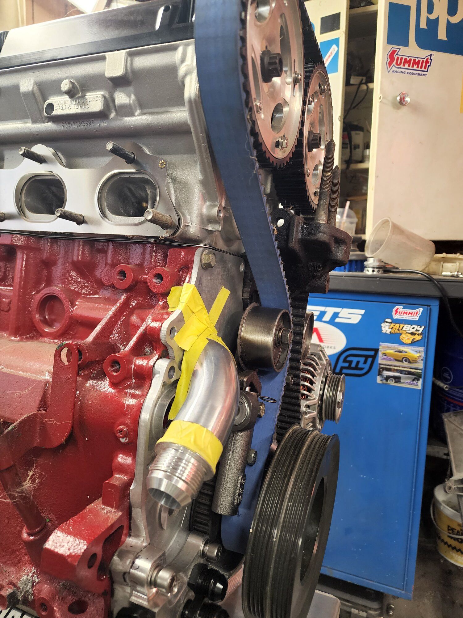

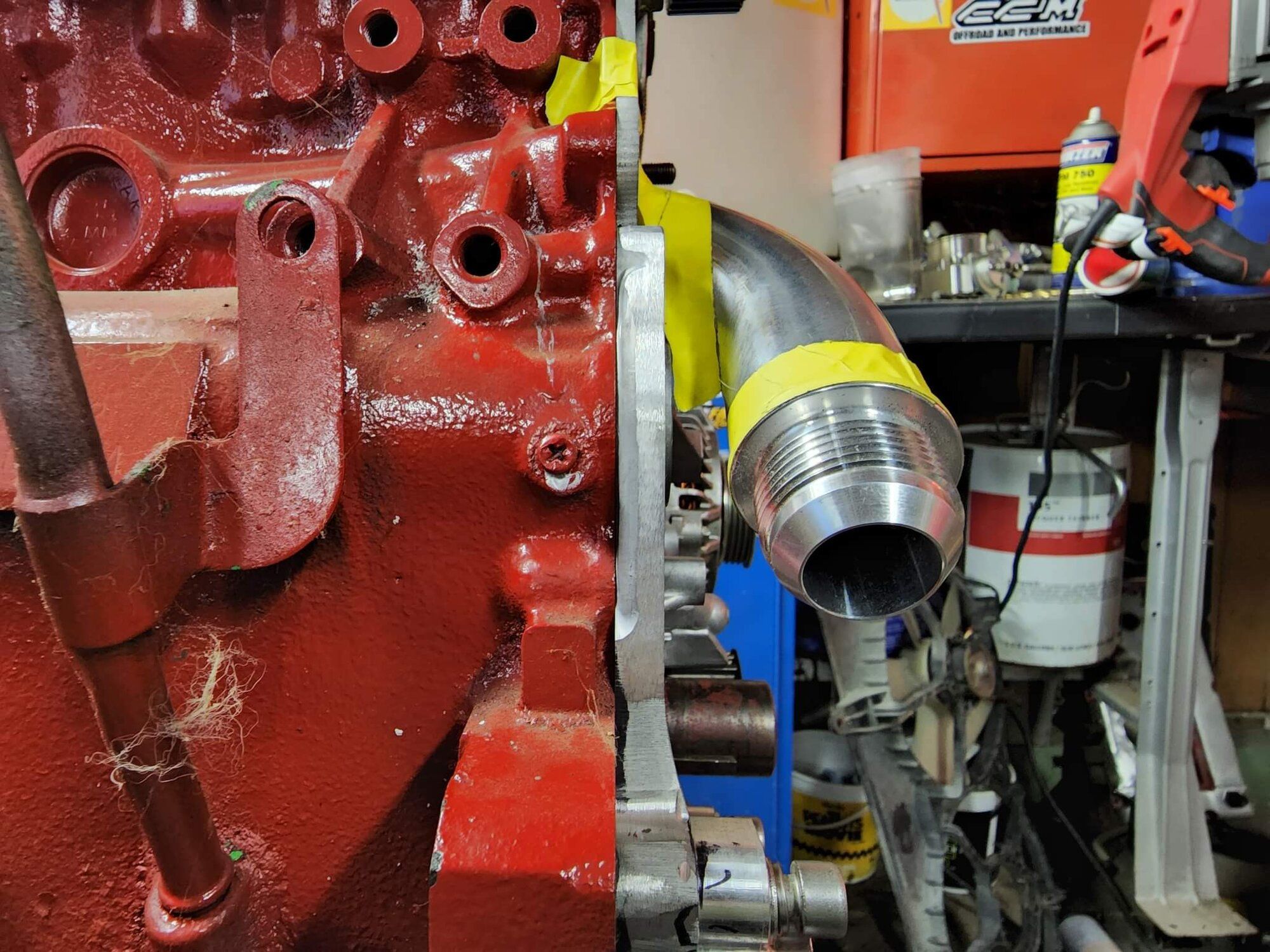

Yeah its nice to see the rotating assembly that I bought years ago finnaly getting installed in a block. I've been on a weeks vacation cleaning up the garage and can actually see the garage floor finnaly. I shaved the alternator ear off the oil pump months ago, so last night I was up late shaving the alternator ear off the engine block. Today placed a order for bolts, gaskets,seals, evo 9 Kevlar timing belt, I want as little color (reds,blue,yellow) as possible. Changing out things yet again (small) order a RMR 75 throttle body and going Saturn rear mount alternator. So im getting ready to really start building this winter.

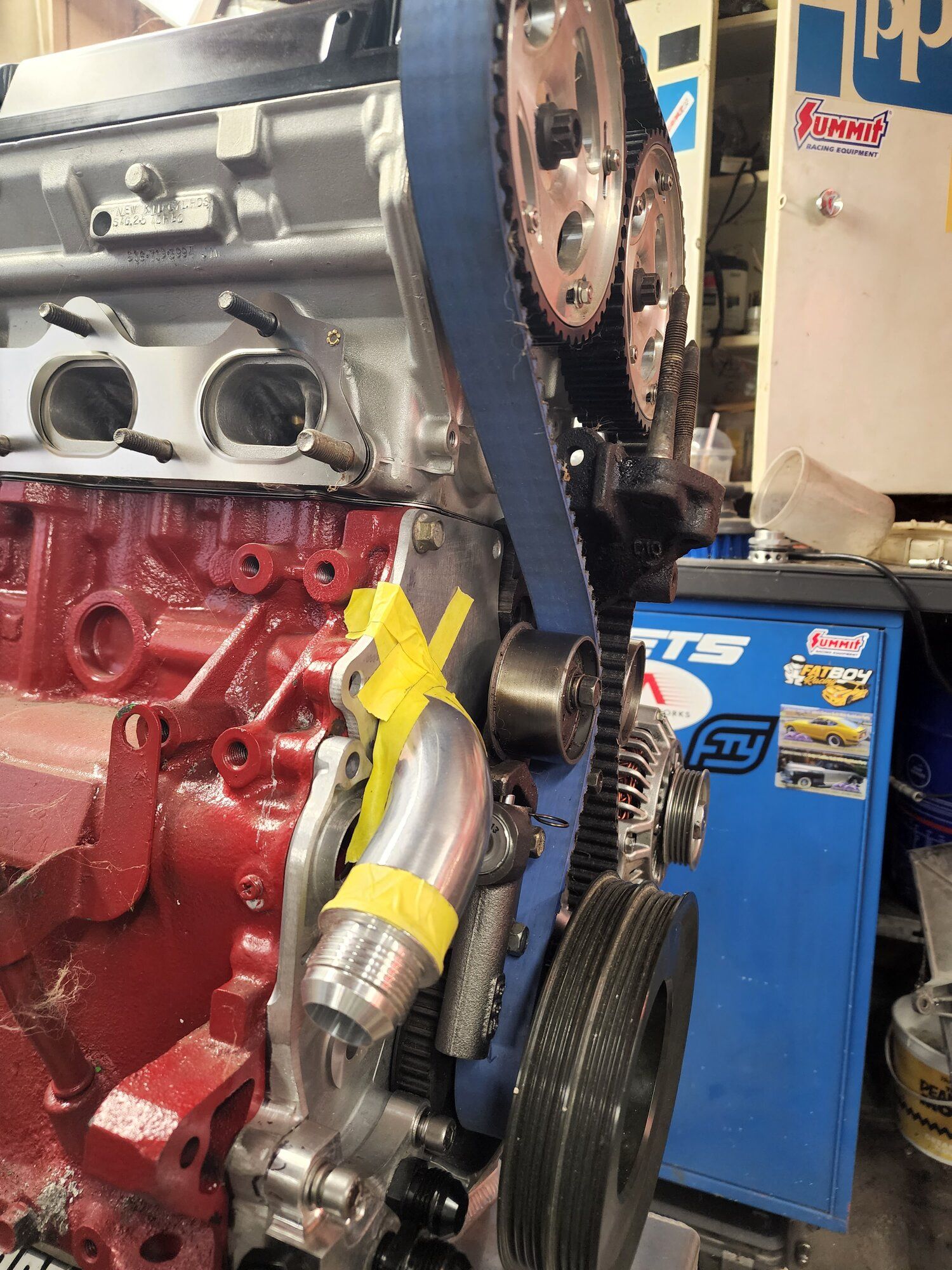

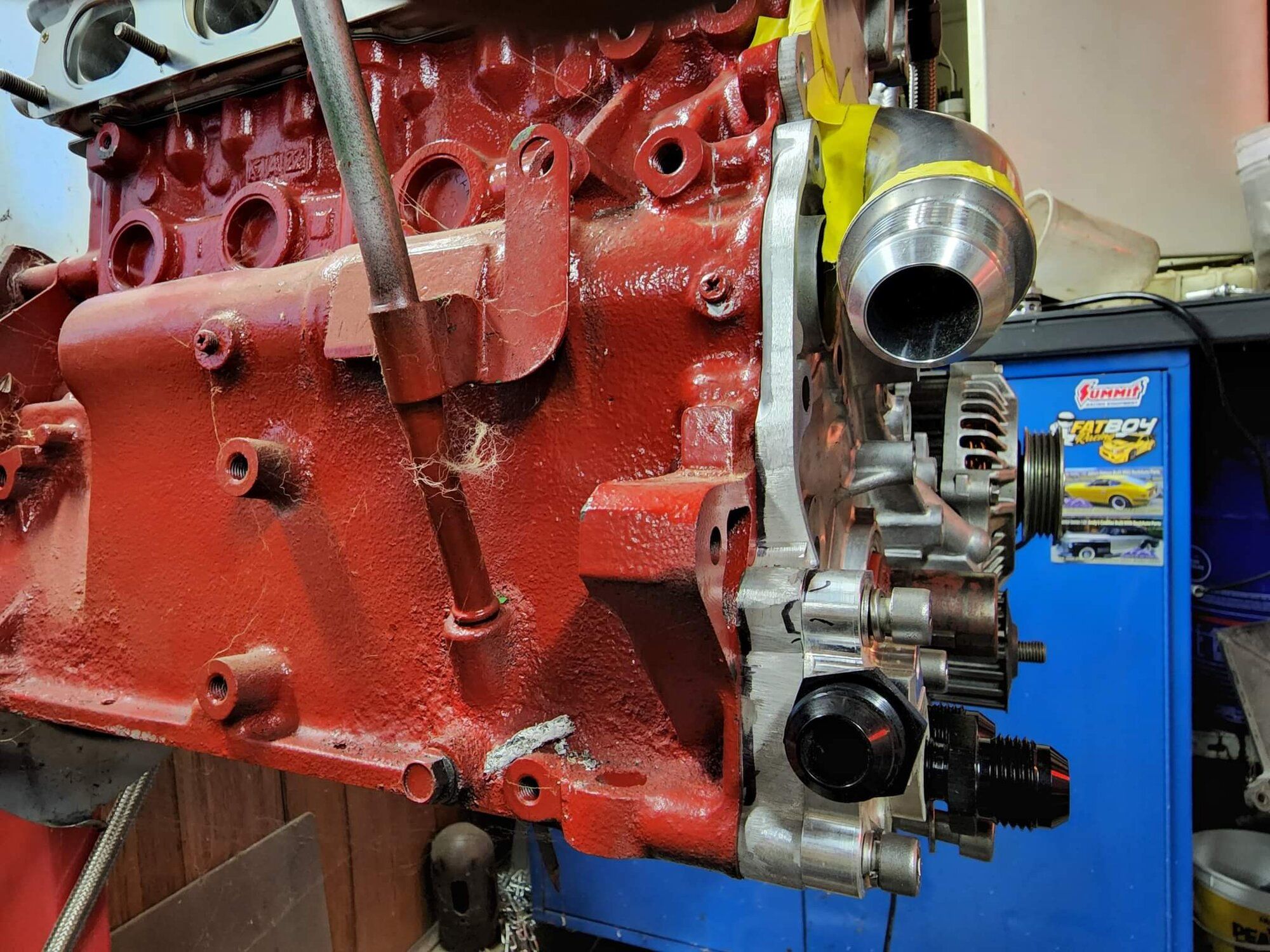

Good thing to do a mock up and get things settled before final assembly. 2 issues. 1 this motor had the old school 7 bolt oil pump in a 6 bolt, so I need to track down a 6 bolt tensioner arm. 2 the bung on the remote filter housing is to close to the fluid damper, so going to change it out to 8orb banjo fitting and hopefully that should give me the clearance.

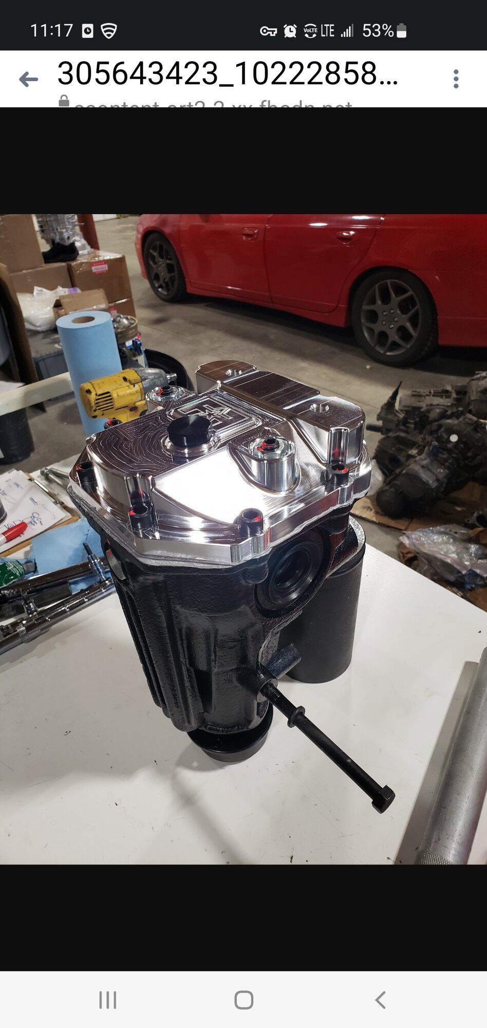

So I'm in the same boat basically. FWD to AWD conversion. Dog box, transfer case and rear differential from Tim. Need a DSS driveshaft and rear axles. Will use an OEM rear subframe until Volk is ready to take my money. Have most of the suspension pieces from Bobby and Volk, just need the front upper arms. Front subframe ordered from Bobby. Build the motor, paint engine bay and body. Haltech, OHM Racing harnesses, etc etc.
Confusing this is so can you clear it up for me please. as 7 bolt pumps can only use a 7 bolt tensioners but your using a 6 bolt tensioner but say its a 7 bolt pump? How does that work out? I thought the bolt pattern was different so could not be done that way?
