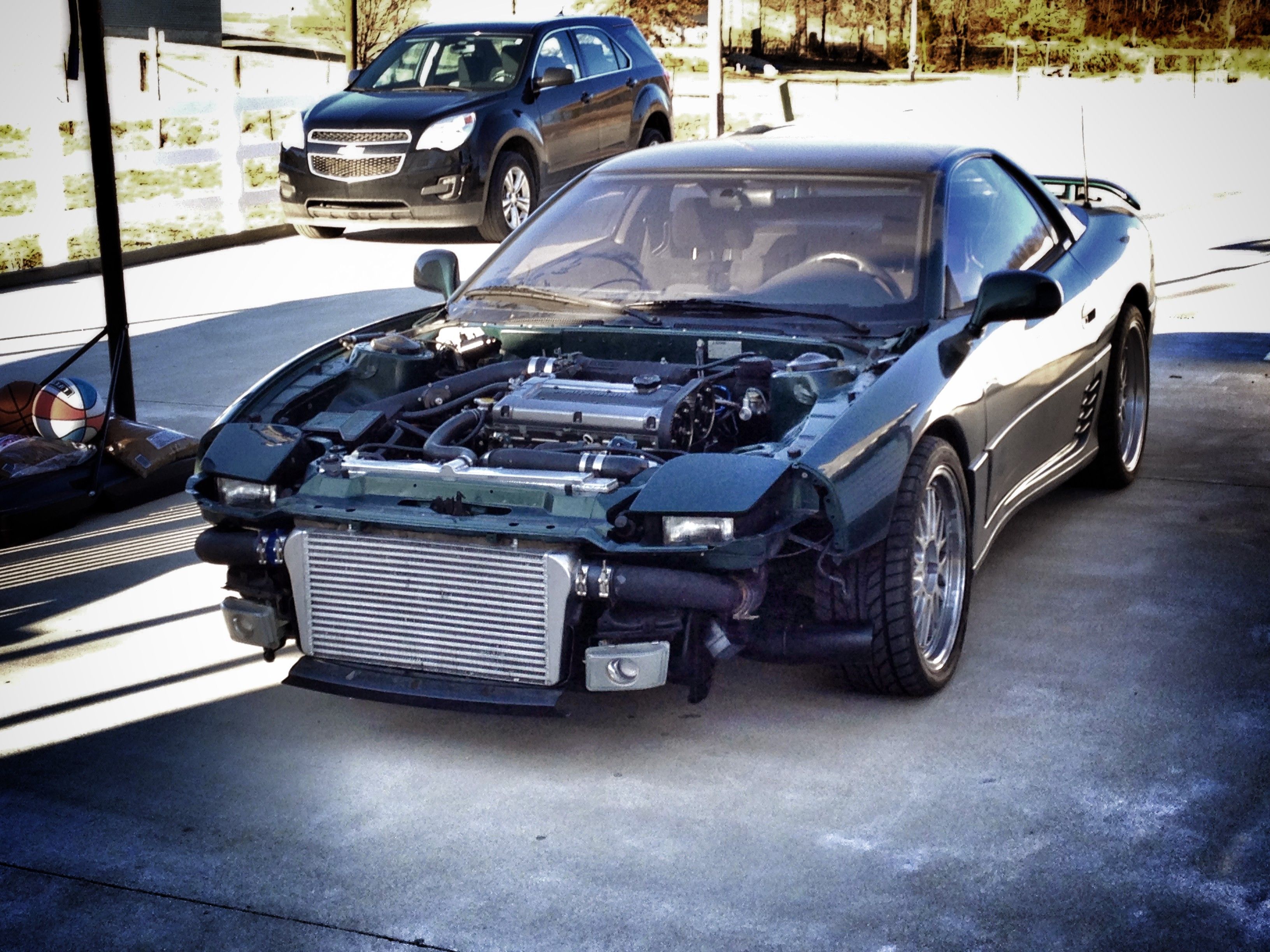

familyMAN's swapped 3000GT VR4, now with more LS

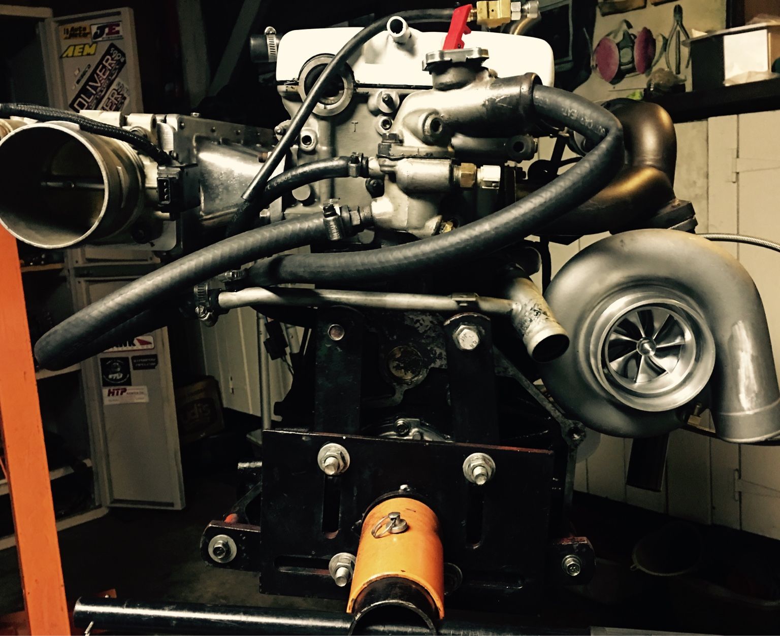

Oil feed and return flanges came in. Turbo fits...barely. Looks like my downpipe will work, but it will be tight since turbine outlet is offset to the driver side a bit more than HX40.

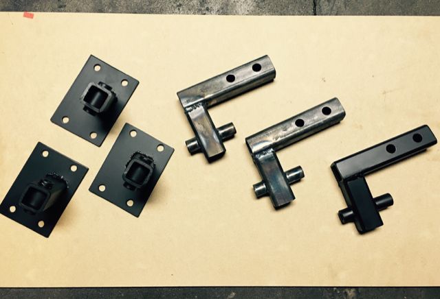

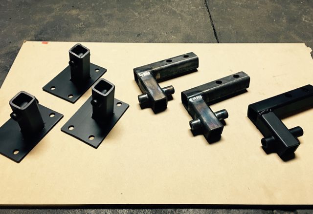

Also have been busy building more mounts for other crazy folks doing 4Gswaps.
